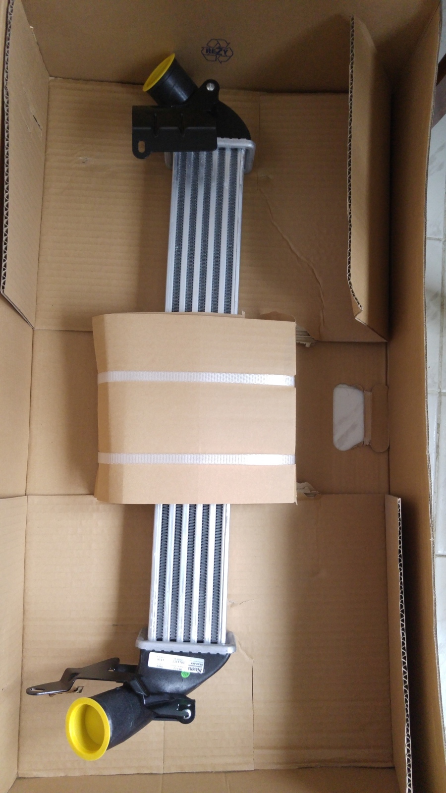

The intercooler

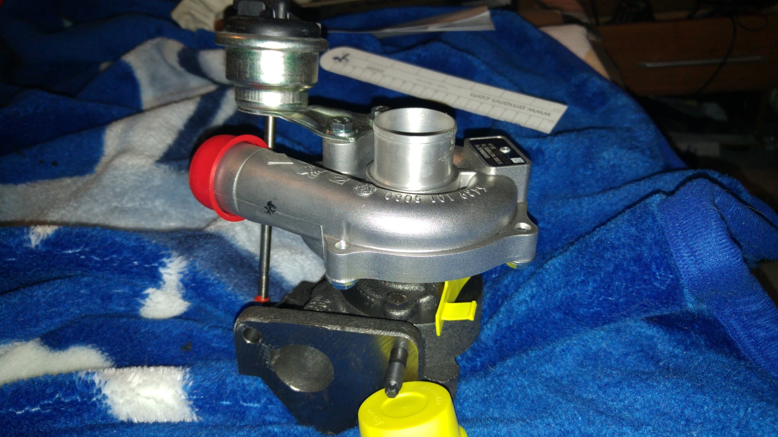

The Turbo

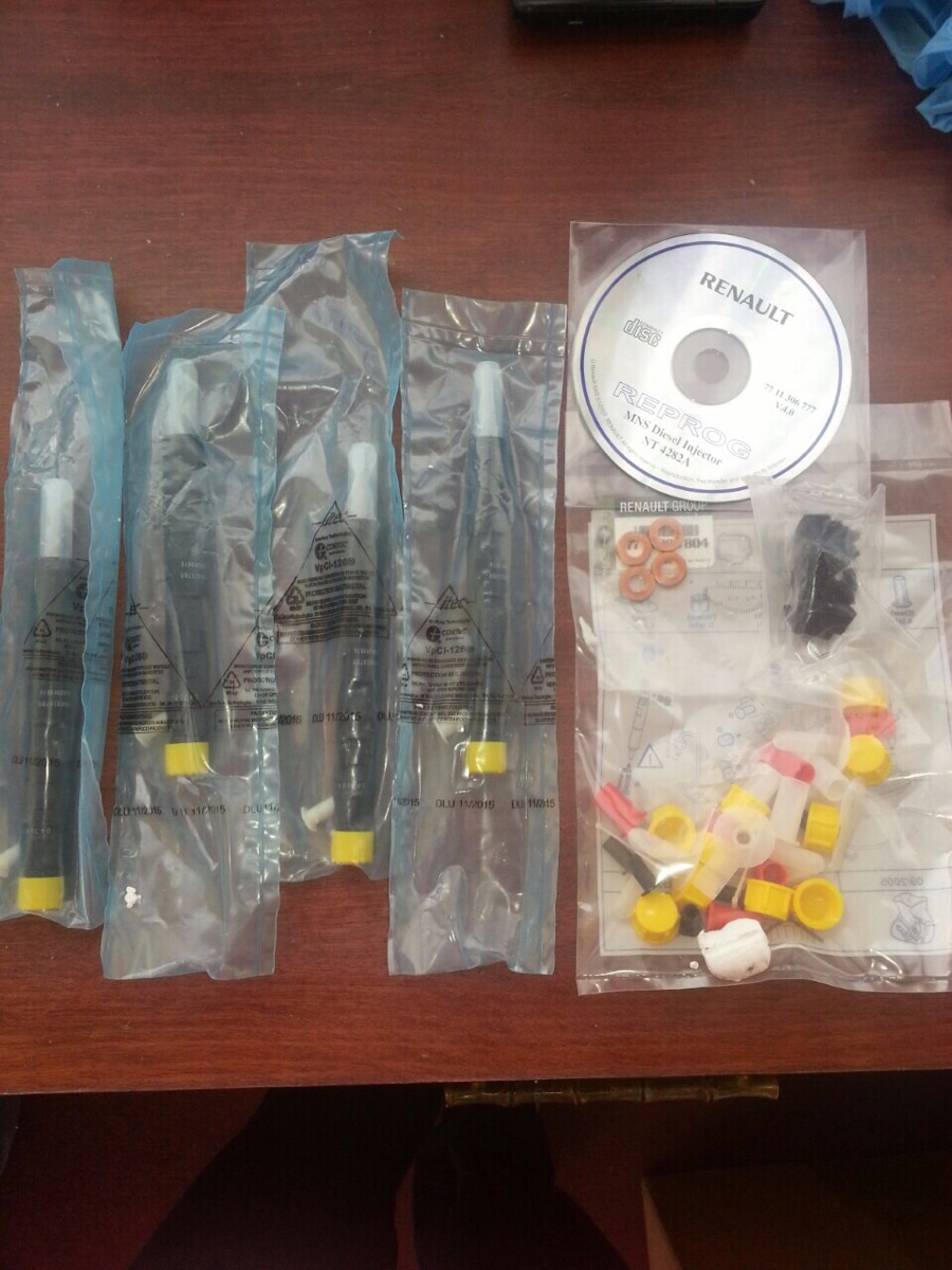

The injectors

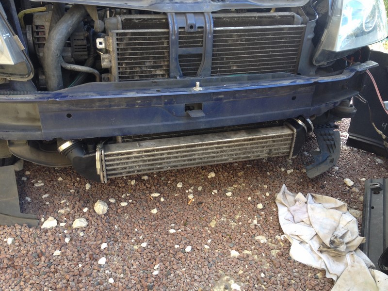

Do I have to mount the radiator on front buffer behind the plastic bumper, or every coolant radiator has the mounting holes for the brackets on my radiator.

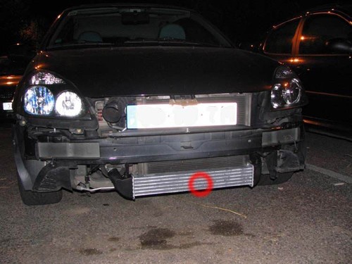

This is similar photo from internet with the same intercooler mounted
