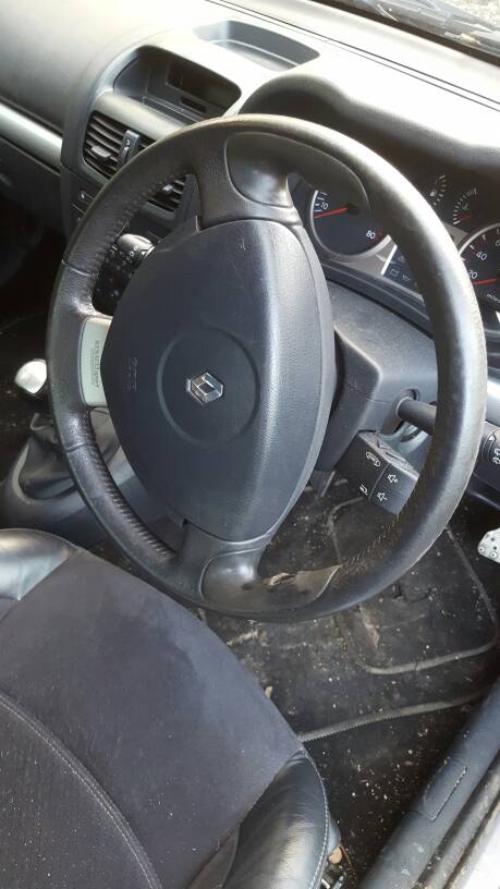

Right guys im new to this stuff im used to making them more a mess than clean.
Ive bought a 172 that the seats n carpet need a "deep" clean whats best for me to get.

Cheers for that. I dont have a wet vac just a std dyson. I can remove seats and carpet aint really took any pics of inside

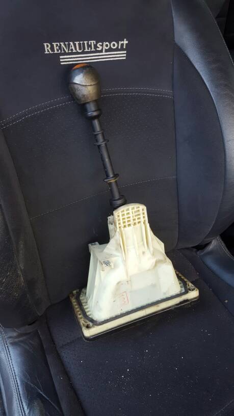

Just a small thread bump, what do you recommend for cleaning the plastics with ? as mine especially the door handles around the window switches are a bit "gooey"
An all purpose cleaner is fine for cleaning the plastics.
Doesn't need to be automotive specific- Tesco Daisy is a popular choice.
