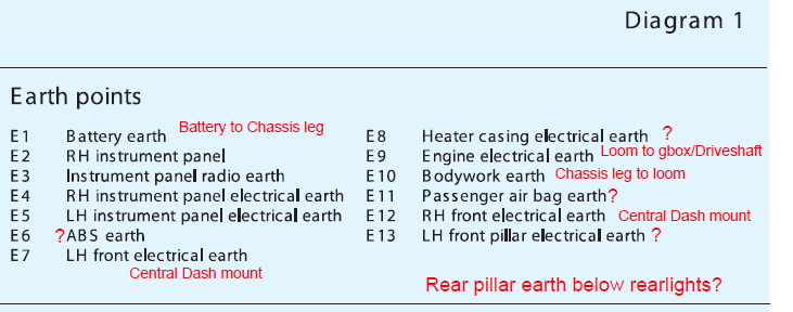

Looking to identify all the earth points in the car.
So far I have found.
Left Dash mount. (Behind/beside tweeter)
Right Bulkhead mount (Behind instrument cluster)
Central dash (Behind dash/clock)
Rear Corner (Below rear lights)
However there seems to be more listed on the wiring diagram. I suspect some are where 2 wires mount to the same earth point, but think im missing some.
1428778
For the dash loom there is one behind the airbag. Depending on the loom spec there are some next to the side impact sensors but I’ve only seen that on dcis
