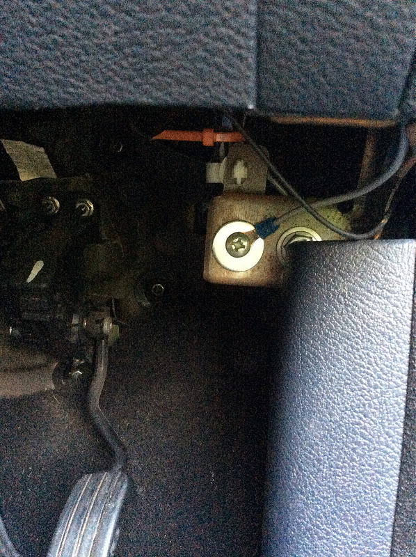

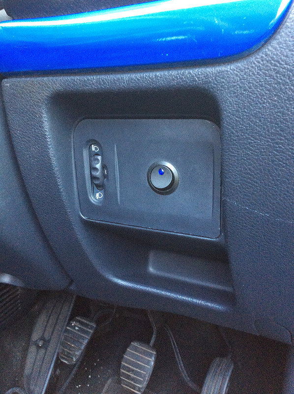

tbh for my footwell leds, i bought a switch for like £1.50 and fitted it to the small panel which pops out where the light adjustment is. I then earthed it from a bolt behind this and ran a cable under the plastics to the cigarette lighter to crimp into that to access power to the switch. The last wire ran from the led strips to the switch. Ive also done this with my gf ka.

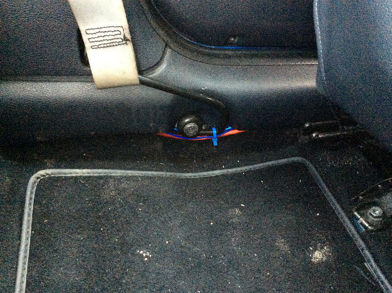

Maybe you could do this with your light, just run a cable to the back of the car under the side panels running along the floor. My sub wires run under the,m so it is accessible.

SWITCH
IMG_0125 by Reed Hopewell, on Flickr
EARTHED
IMG_0127 by Reed Hopewell, on Flickr
WIRE UNDER SIDE PLASTICS
IMG_0128 by Reed Hopewell, on Flickr
Obviously you wouldn't have large cables running down the side for a light so it wouldn't be that big.
