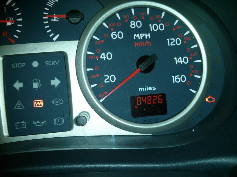

Does it flash any lights up on the dash when it does it?
The electrical one in the middle, not the other one. (pic is not my car)

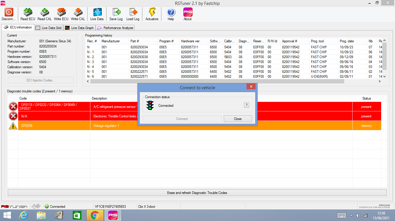

DaveDreads
Drove perfect today, no problems at all.
For all your advice and similar issues, it looks more and more likely that it's an intermittent short.

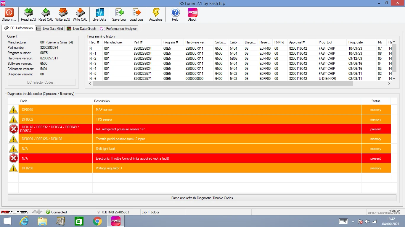

DaveDreads
It f*cked up and cut out about 10 times in a row today, went to the park and back fine, went across the other end of the city no problem, but when I tried to go home it wouldn't even stay running for 10 seconds.
I had the electric and check engine light on, no amount of code clearing would fix it, every time I blipped the throttle the dash lit up and it cut out instantly.
Then as quickly as it went mental, it went away and drove home perfect.
Starting to think it's a dodgy throttle body rather than a short, it could be the throttle pedal but that got swapped, is the TPS is part of the throttle pedal or separate?

DaveDreads
F*cking did it again, cut out on a D/C this time which scared the sh*t out of me, looks like I might have more than one problem, this time both the electric and engine light came on, but after turning it off and on again i'm only left with the engine lght.
Plus it only has one fault code this time, looks like the TB solved the other two.
Pretty sure voltage regulator is alternator? It was a refurbed unit from about 6-8 years ago.
