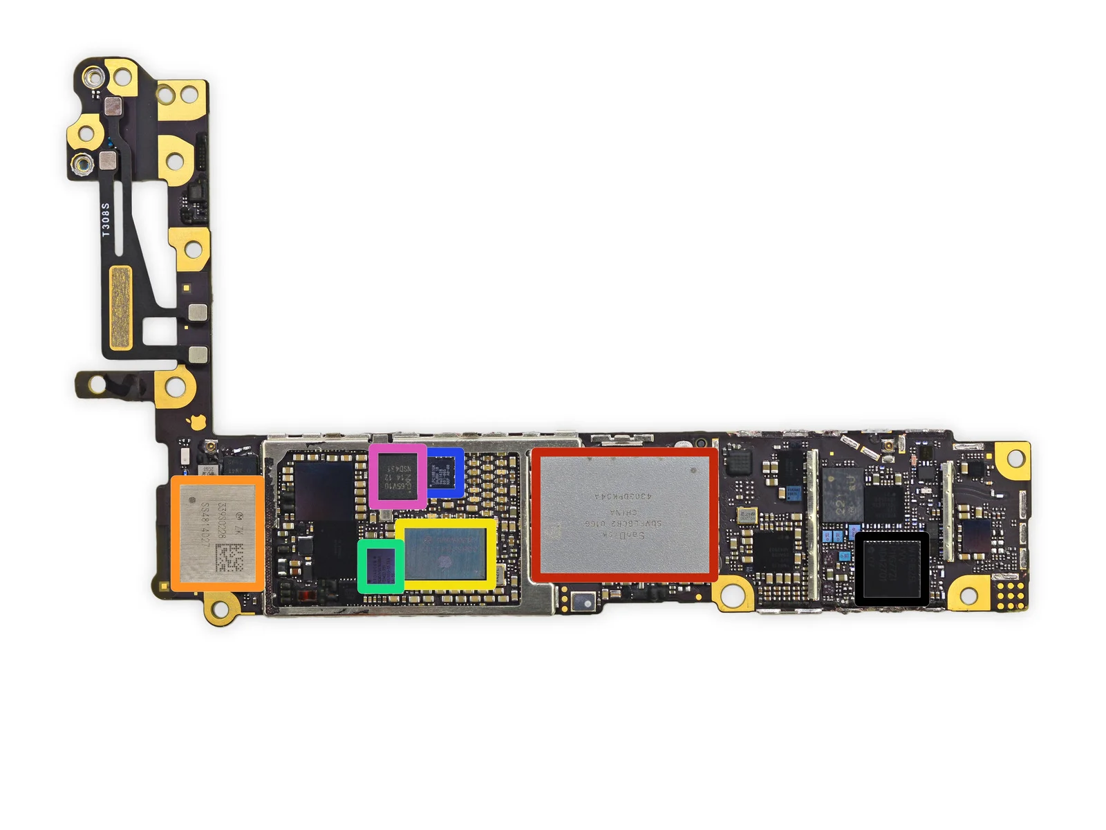

There is no "harddrive" it's a memory chip on the main board, you have no chance of recovering it imo.
See the red chip on Step 17: https://www.ifixit.com/Teardown/iPhone 6 Teardown/29213
aka:
You could probably try putting that board in a new phone, but you could also kill the new phone doing it if that's knackered.

Cheers mate! Yeah, didn't know how to word it to be perfectly honest! I just have a feeling the board may have been shorted out which in theory would make it pointless replacing the whole board in the 'new' phone. Is each memory chip encoded to each board or are they 'universal'? Do you know how they are seated?
Pass to all of them I'm afraid (not sure), but if it's like some of the newer things I've soldered, not a chance in hell of even getting it off, nevermind onto a new board :(

Impossible to repair. The 6's are a touch more resistant to water but a washing machine would f**k it.
Putting a new board in it would just make it a new phone? You aren't going to manage to get hold of chips and then fit them.

Easy peasy.
1. Infrared reflow on the memory device and remove it from the fucked board.
2. Clean up bottom of removed memory device and reball (and reflow device)
3. Infrared BGA reflow and remove the memory device on doner board.
4. Clean up pads on doner board.
5. Apply solder paste to removed device (or the PCB, whichever is easiest)
6. Place part onto doner board and reflow.
You'll need several hundred thousands of pounds worth of kit though and it won't work as the encryption keys for the flash will be CPU specific.
