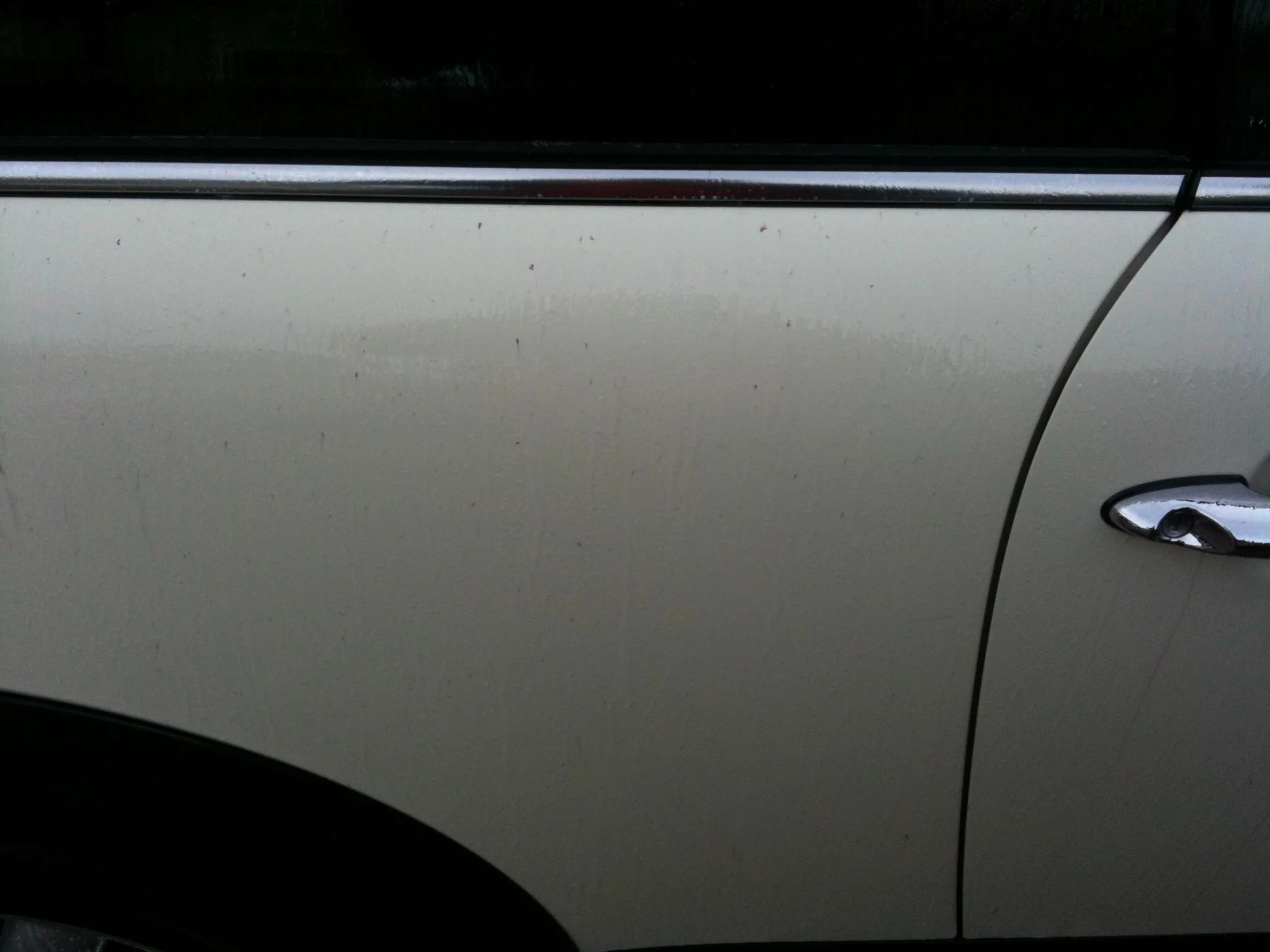

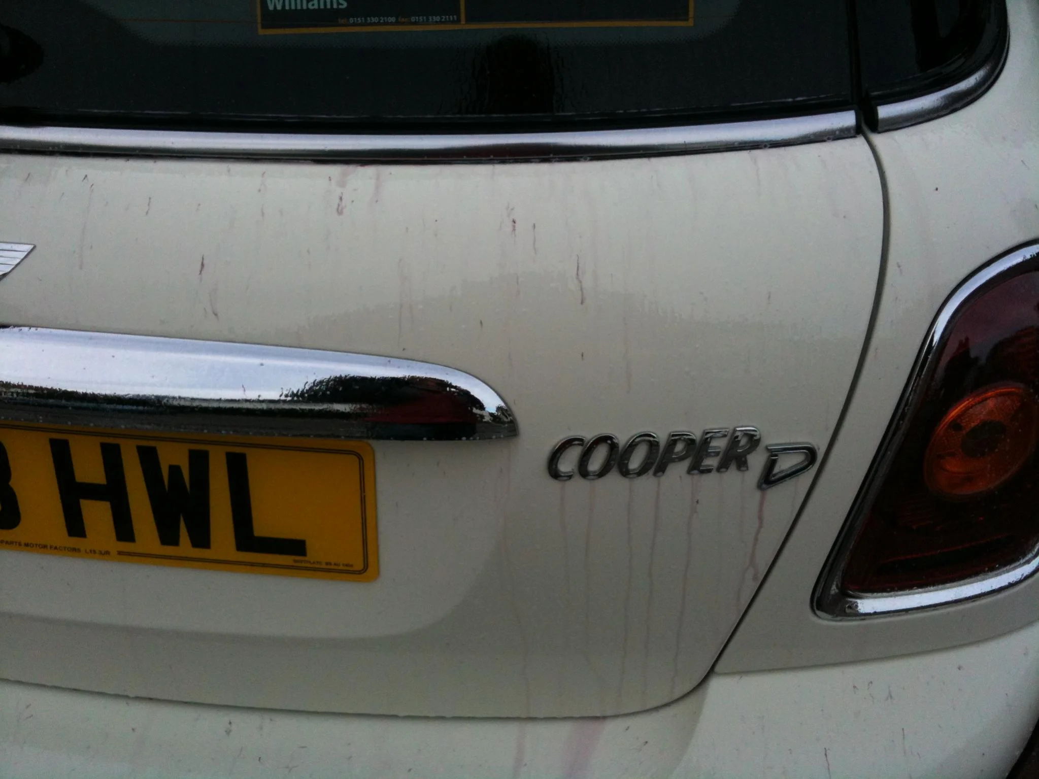

car was bad, gf's mini in cream, used over half a bottle. Would it be more economical to apply to a wet car?

the pic of the ironX working is not that bad at all, if the whole car was like that you're over applying to use that much in one detail. Especially on a Mini. I would have though the car would be rinsed after washing / de tarring, so leave it wet and spray it on lightly, let it start to work. if it shows signs of drying out lightly mist again, if it's still drawing out iron aggitate with with a detailing brush.
If you still find you're using a lot, try switching to the ironx soap gel. takes a little longer to start working but you use less and using it with a sponge aggitates helps lift off the iron so make sure you wash out the sponge afterwards

Cheers Dave, just wondered because the day that I did mini it was very cold.The Iron X had been in garage over night and was very thick
