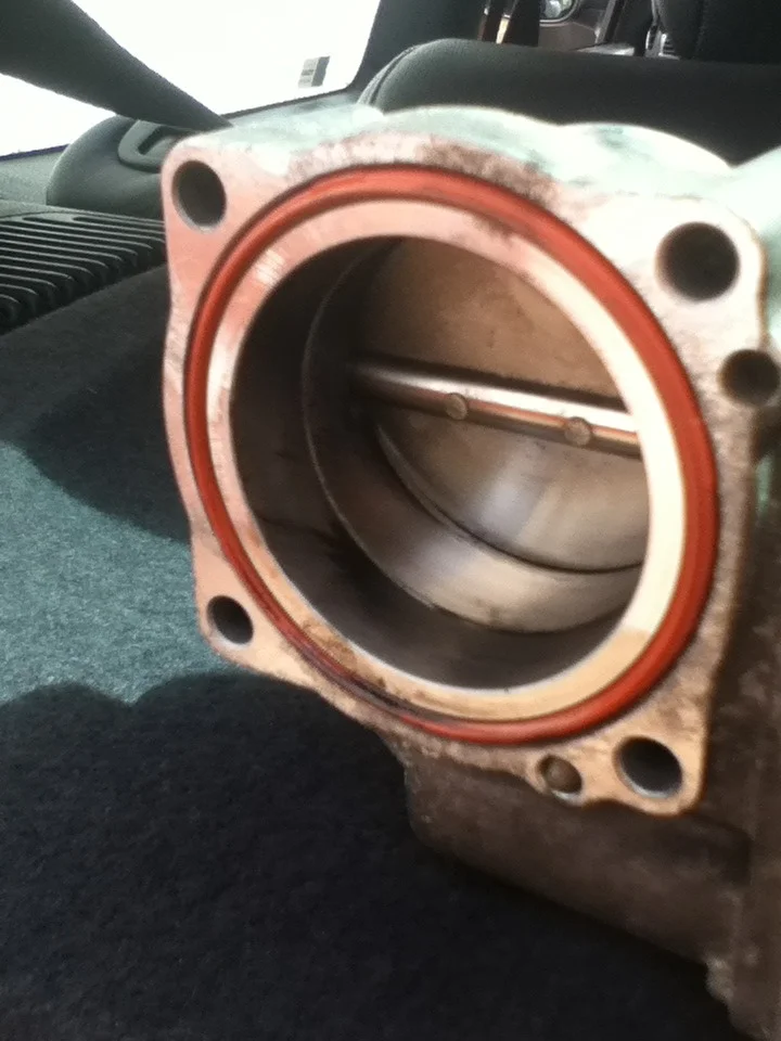

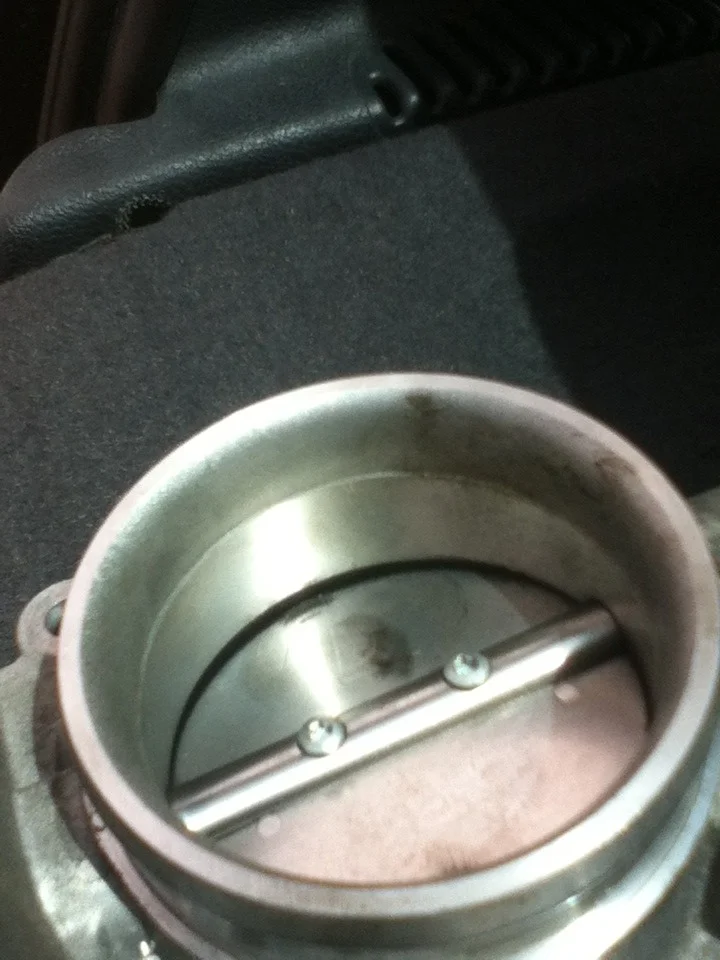

Ok, iv just taken it off and inside is pretty dirty, also iv noticed that the butterfly doesnt seem to be shutting 100%, iv got a couple of pics here. Should it close completely flat is in 90degrees to the housing? ImageUploadedByTapatalk1341147633.055027.webpImageUploadedByTapatalk1341147656.337682.webp

It should spring back yes

Ph2, right all fitted and the car idles perfect now (touch wood) at about 800rpm, needle sits perfectly still whereas it used to be up and down like a yo yo. After i had a think about it i came to the conclusion that if the butterfly was to shut 100% then it wouldn't idle because no air would get in?
Yep spot on, cheers for the advice everyone.

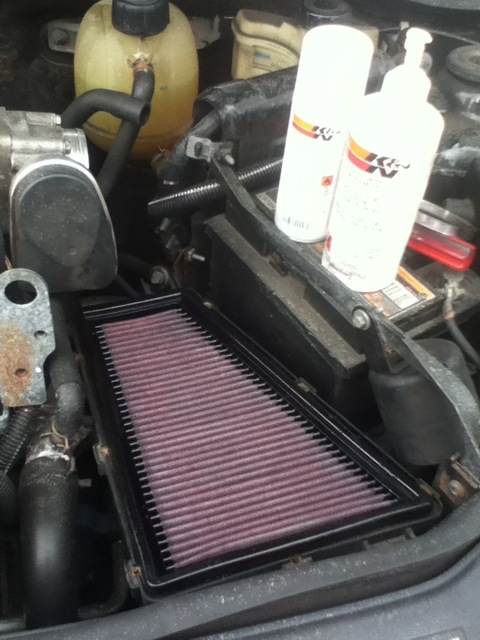

Also gave my panel filter a clean and oil which probably helped!
