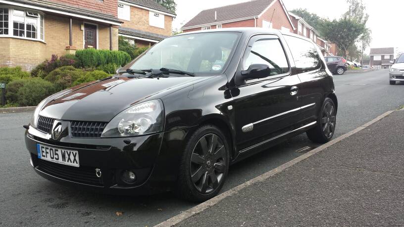

Hi guys, just went to fit, what I've been told are Cup o. E dampers to my 182 holes on hub don't line up, making me think ive been sold either non Cup damper or mine isn't a full fat..
Reg is ef05 wxx,

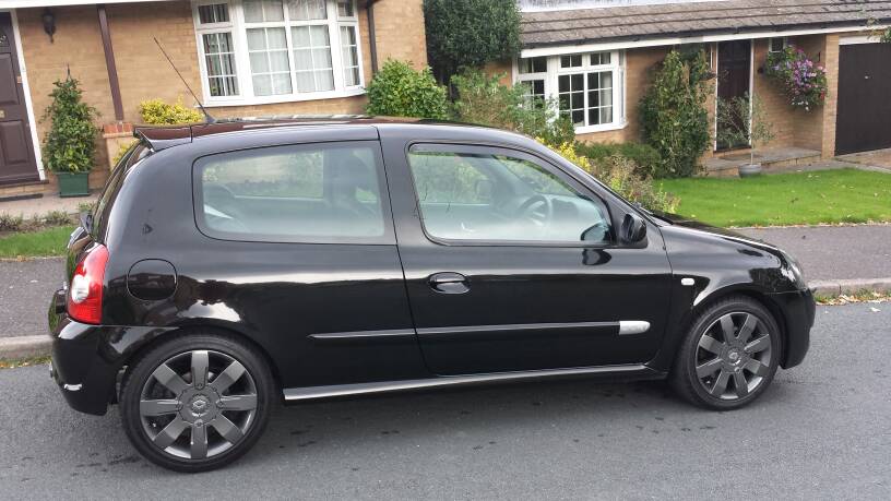

Pics of car here
cafcross
The wheels do look a darker anthracite than standard, so it could be that a previous owner has had a refurb done to change the wheels from silver (non-cup pack) to anthracite.

The cup splitter could've snapped off, or the cup spoiler could've been added. And the wheels could've been sprayed

As above, spoiler is cup, wheels look darker than standard so could have been sprayed either way, splitter could have come off.

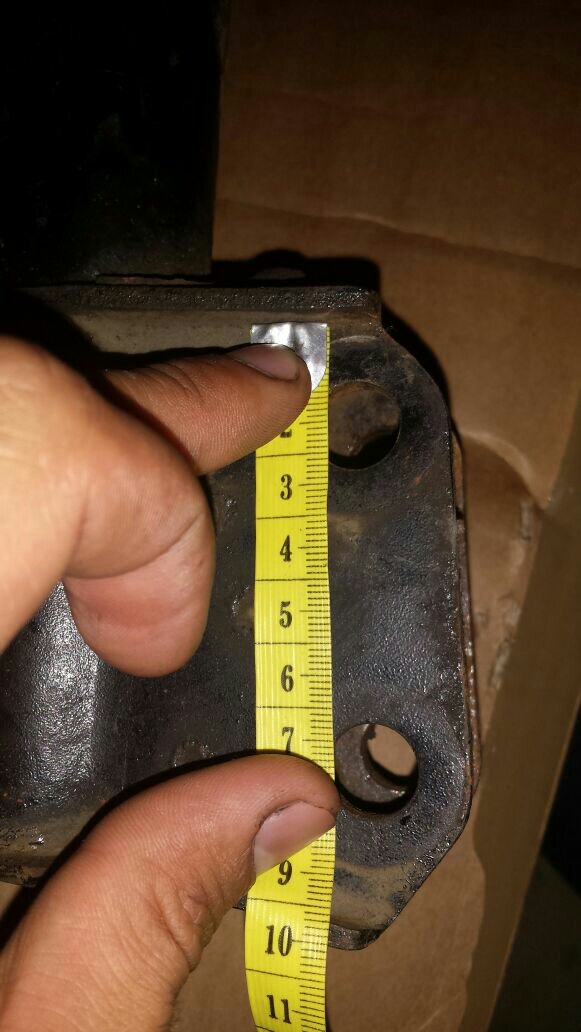

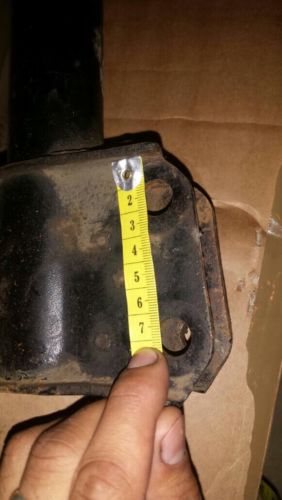

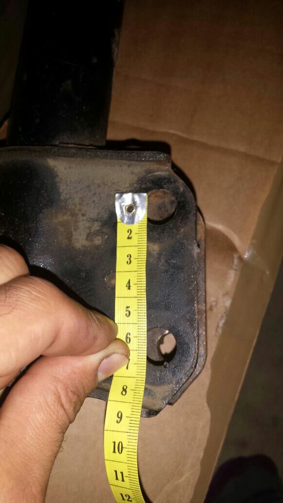

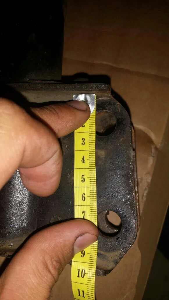

Those pics show a 54mm hole spacing --> you have a non cup 182
It looks as though from your third picture if you were to move the tape measure (silver end) up slightly to the top centre of the top bolt hole and measure down to the top centre of the bottom bolt hole you would get a spacing of 54mm which would suggest non cup suspension.
if that makes sense?
If they are the dampers you have bought then the spacing would suggest they are not cup dampers as opposed to the car not being a cup.
