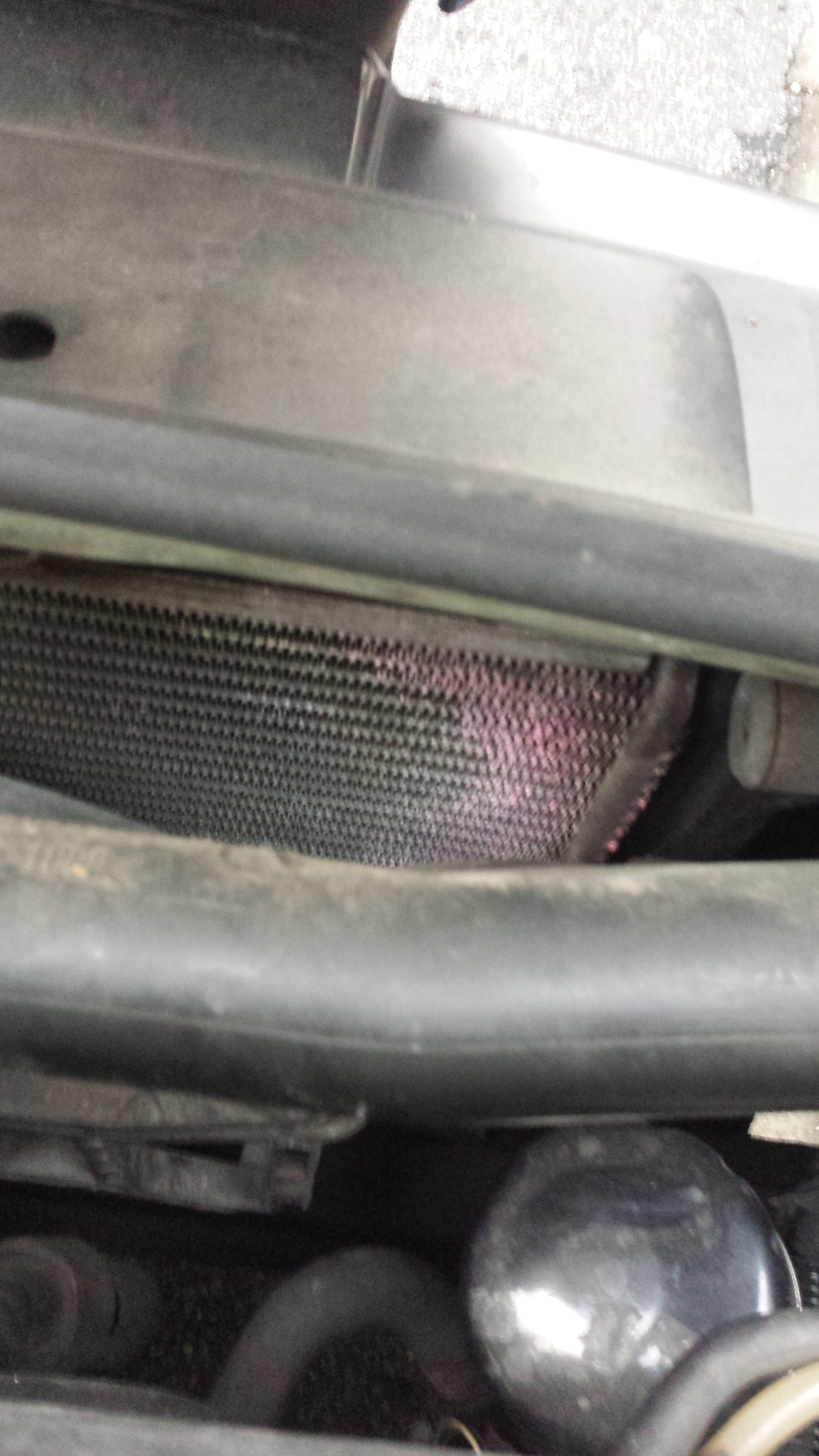

I think I may have found something related to this. Take a look at the image.
It looks like there might be a leak there leaving the residue of the solution (seeing as it's the same colour). Is this plausible?

Fair enough, so I need to get the whole radiator replaced then? Problem is that if I pick up a second hand on, I can't be sure that it doesn't have the same problem until I've fitted it. Unless I pick up a brand new one, of course.

Update: Radiator has been replaced, but the car is still loosing fluid. Could there be a leak in one of the pipes? It looks like this is going to turn into an exploration job!
