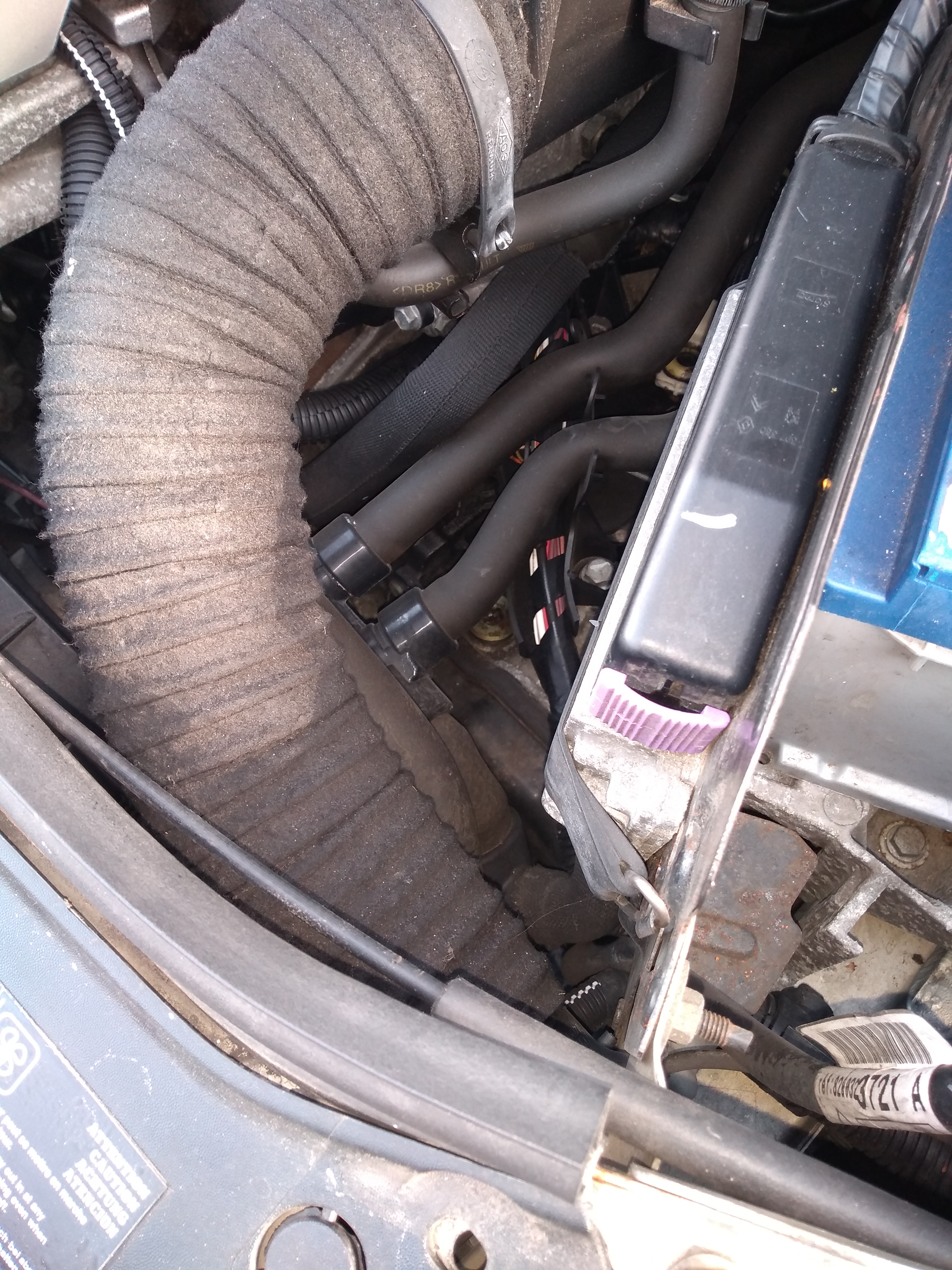

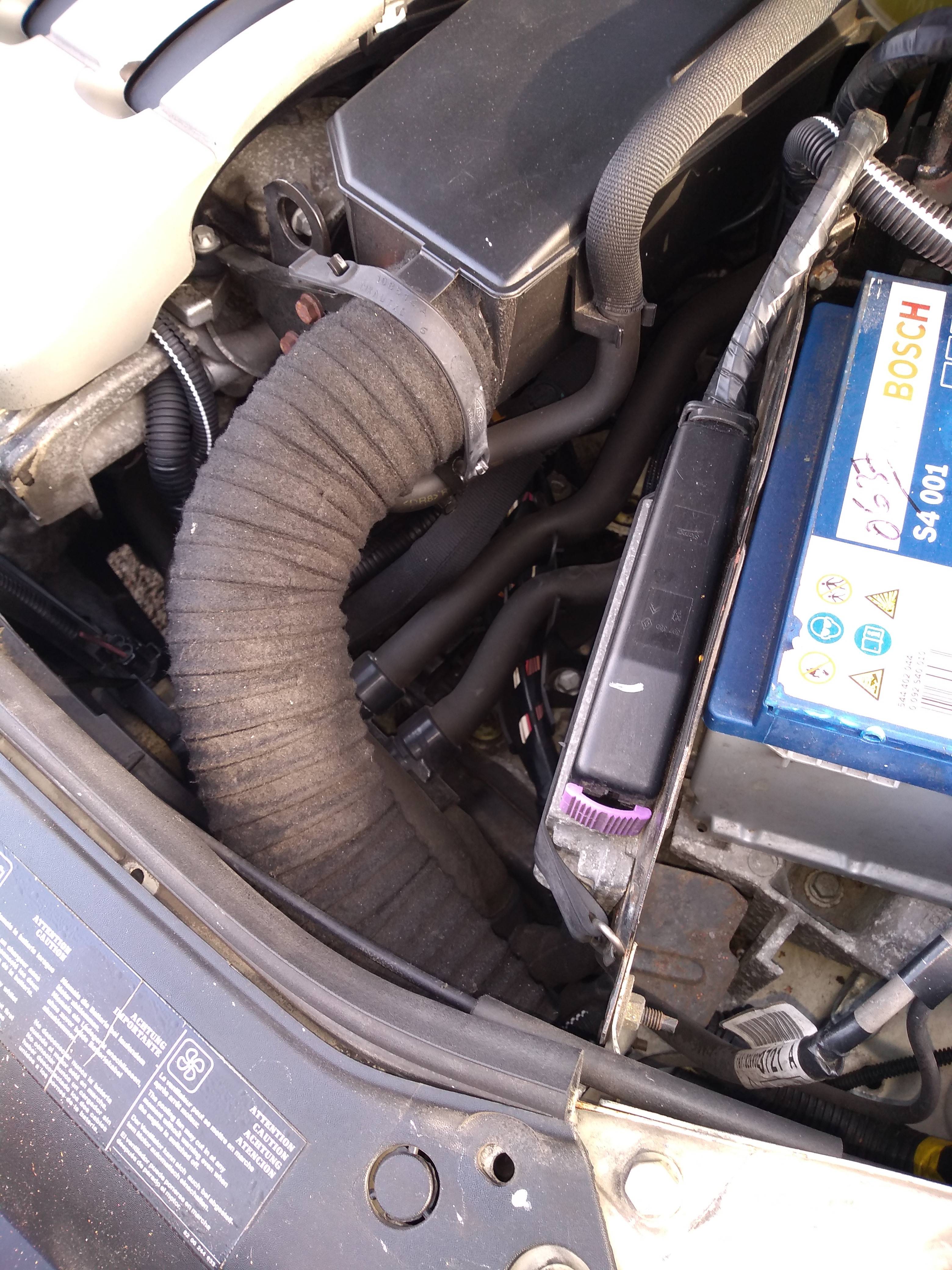

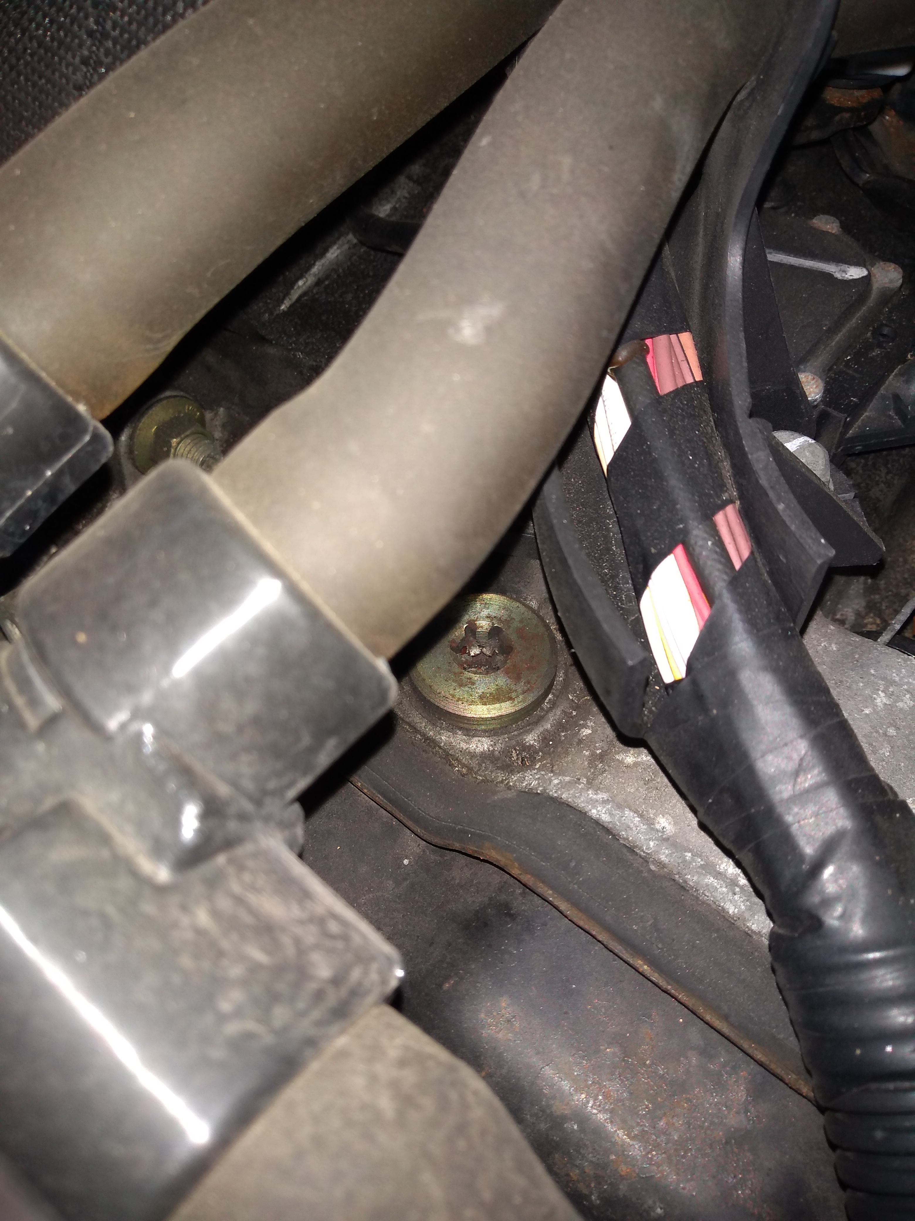

Can anyone tell me if the brass torque screw in these photos, to the left of the purple clip, is the filler plug for a 2004 mk2 1.4 Clio automatic. If not, where roughly should it be as I can't see anything else yet

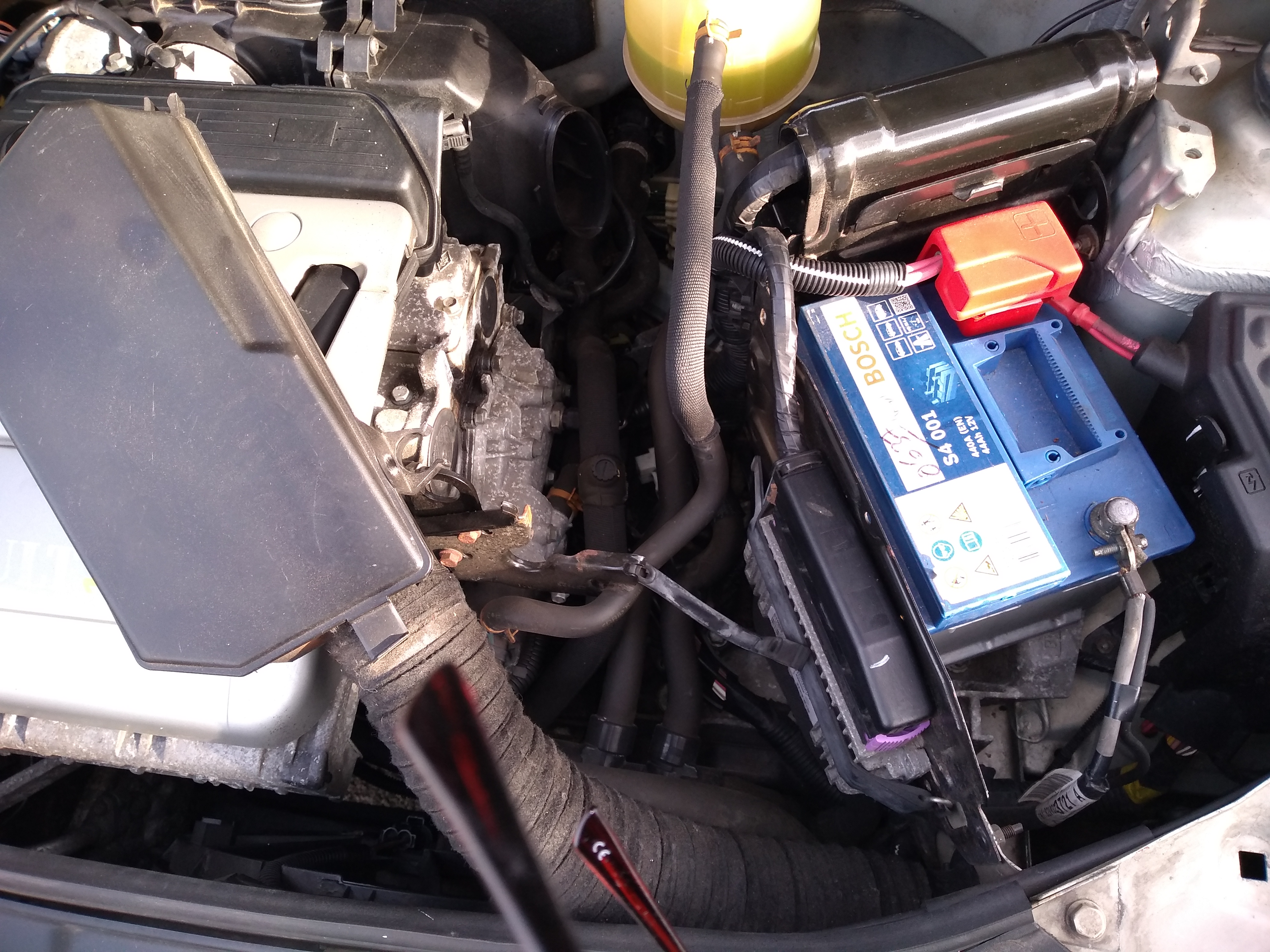

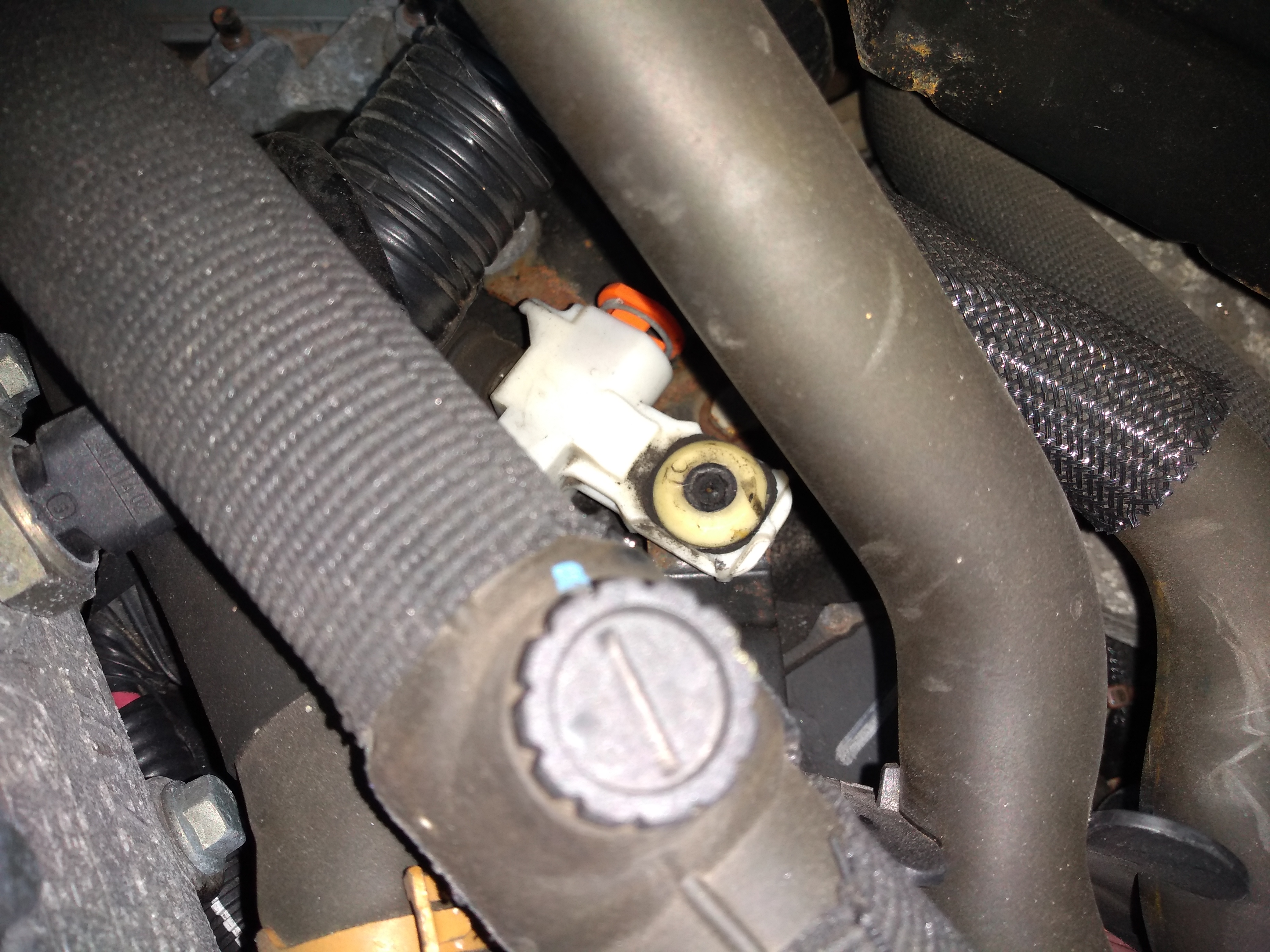

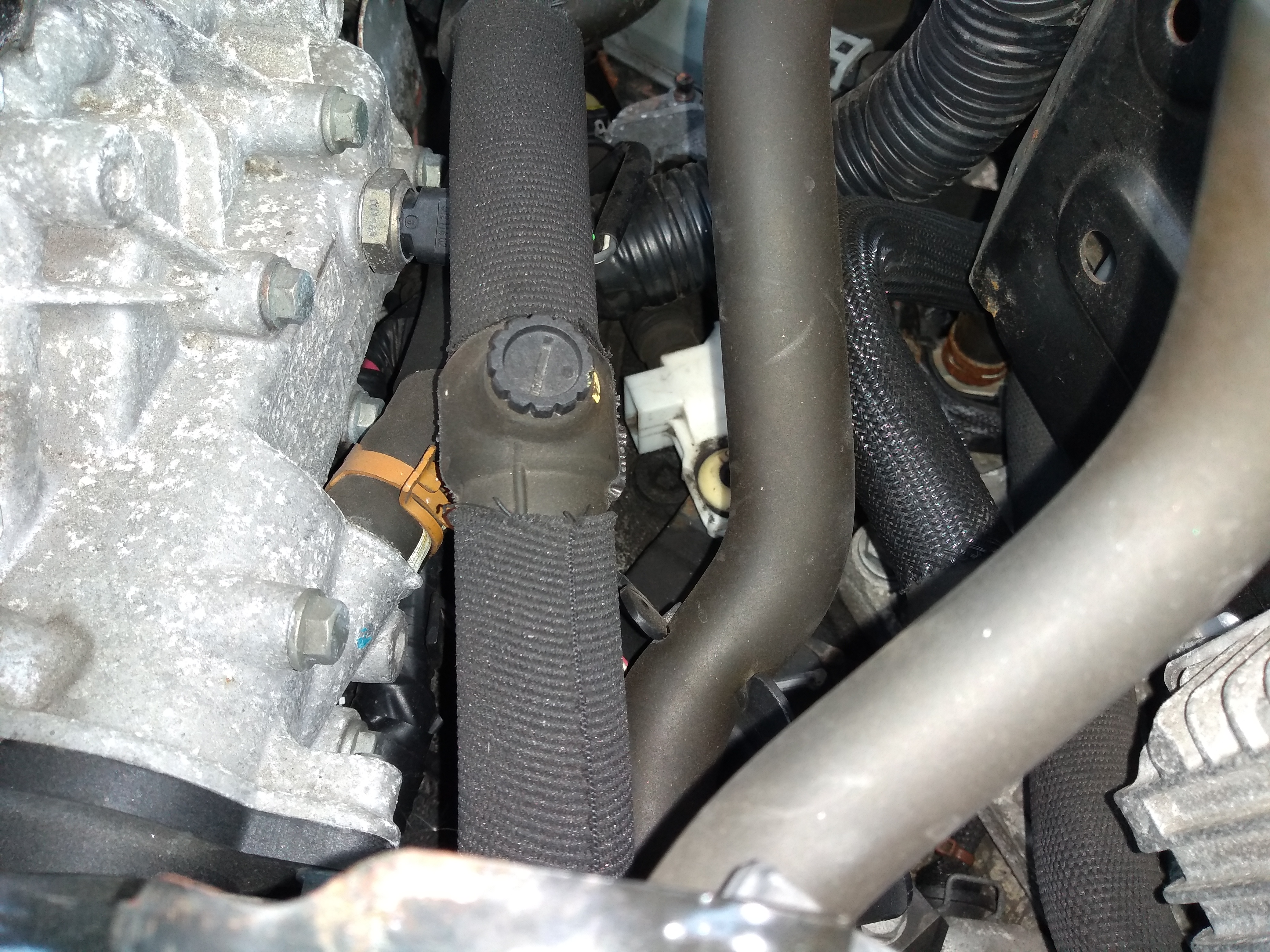

Well I think that's not it. After removing the air inlet duct I'm pretty sure I've found it. Only problem is it is half covered by some kind of white switch or sensor. Any easy way to undo it. I'm going to have to get at it to get the 8mm plug in to undo it. You can see it under the corner of the white thing in the middle photo.
  Clio
Well! What an easy and interesting job! Did it today. The white thing in the pictures is to do with the gear selector. I put it in Neutral and it was clear of the filler plug.
