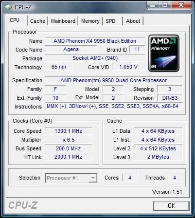

I've got an AMD Phenom X4 9950 Black Edition, which should be running at 2.6Ghz standard. When looking at CPU-Z however, i get given this:
And thats the same through all 4 cores.
If i try use AMD's Overdrive OC utility it also shows each core running at 1.3, with the multiplier at 6.5. If i try change it, all cores will revert back to 1.3 and the 6.5 mutliplier in a matter of seconds.
Is this possibly my mobo holding things back?
Cheers
Tom

Power saving function probably (kicks in when the CPU isn't under any load). Try running a CPU intensive program in the background (like Prime95) and see if it changes.
thank you guys, your quite right.
Now that is established then, how do i go about turning the clock up a little bit if it just reverts back to the basic power saving numbers whenever i try tweak things?
