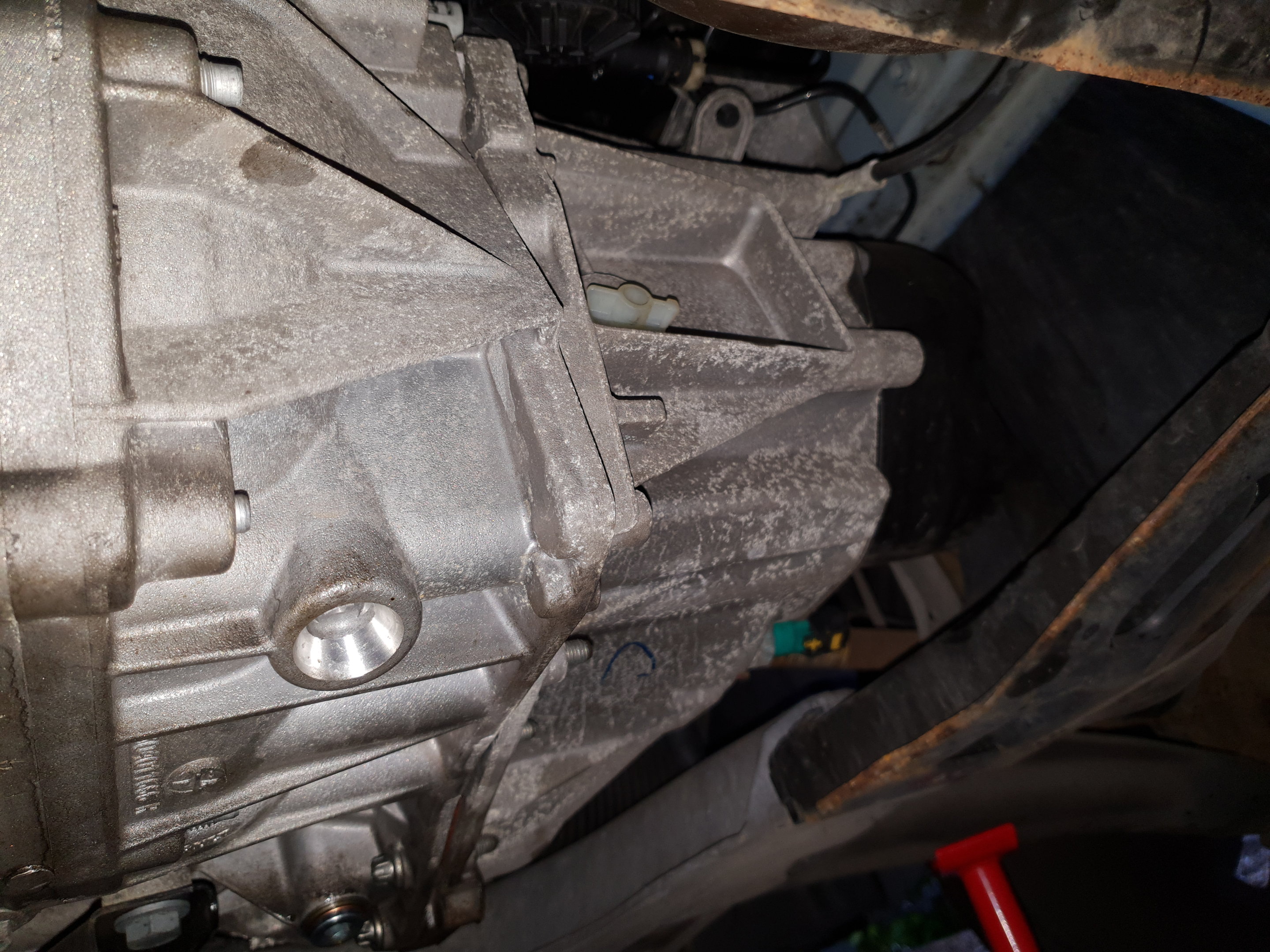

Is this the gearbox filler?
Car  clio
Hi,
First time trying anything like this and I'm wondering if this is the right place!
Hoping this the the but I'm looking for...
Thanks

I put the car down off the stands so that the car was level but when i seemed to loose a lot of oil by the time I got the but back in.
How will I know if I've lost too much?

it will be fine, it only needs filling till it starts to spill out. Obviously with the car level.
you always end up getting a lot of spill on a 200 for some reason.
There seemed to be a quite a lot came out but maybe I just filled it with a bit too much. If there isn't enough oil in would I feel it when changing gears.
I meant to ask about the oil, Renault parts said they think it's 75w80 buy couldn't tell me how much. The local motor store said 75w90. The car is a 2013 tce 90 eco. I ended up going with the 75w90 fully synthetic gl4.

I left the oil change to the end thinking it would take me 30 mins only to realise that the bolt holding the plastic tray on was rusted solid and it took me an hour to get it off. In a rush I took out the first plug I saw, which I later realised was the gearbox but not before I poured in 4 litres of new engine oil!

You need to fill it while the car is flat on the ground. If you've got the front jacked up then it will overfill and spill out when you put the car level.

I had it down off the stands on the drive and I used the hose pipe and funnel. There is a tiny slope on the drive but it's pretty level so I'm hoping that I just put too much in. The problem was trying to get my hand in to get the plug back on.

Fair enough, it will be ok then. The correct level is when it starts to dribble out, and if it's on a flat surface it can't dribble out to a level below the correct level so will be fine.
