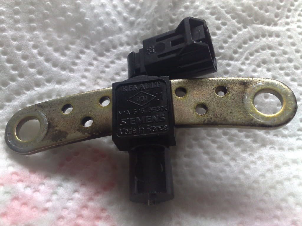

Is this the tdc sensor?
Reckon this could be my problem too.
Where is the TDC sensor though? Do I need to remove other bits to get to it?

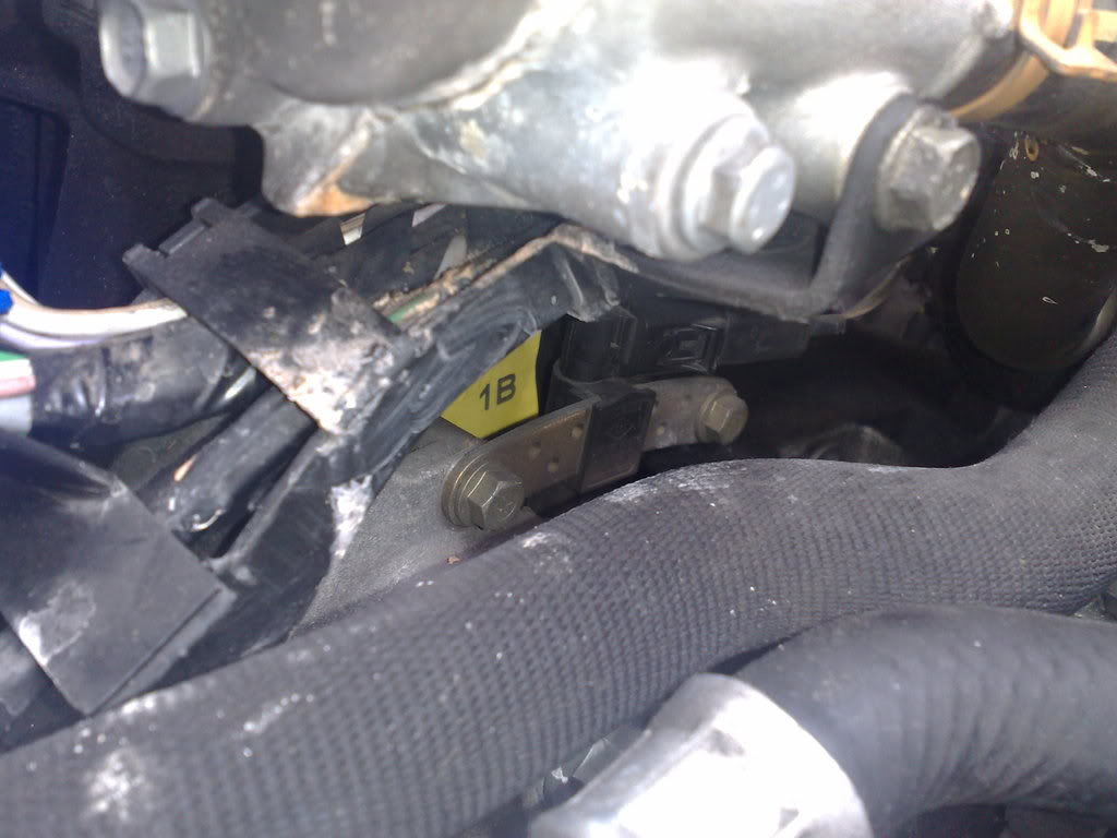

dragging an old post out... what is the location of the sensor? cannot see it as per pic above which seems to suggest its below the plastic bracket :-(
Any help greatly appreciated.
Car is a RHD 2008 Clio Sport.
Assuming it’s a Clio 2 with an F4R engine, it’s basically under the throttle body from memory. Need to take the air box out of the way.
Thanks pulled airbox out but its not obvious, unless i'm missing something :-(
Look at the side of engine, see those 2 black round caps ? (For camshafts) ok now point between them and follow a vertical line going down.. until you find where gearbox joins engine. In that point you will find the sensor it has a black roundish connector if first type, or nice blue if newer type.
As per @hopgop1 above, the sensor is indeed in front of the g'box. Accessible from under the car after removing the tray. A tad fiddly buy relatively easy to access. Quick clean and back in for the time being. Now to source a replacement :)
