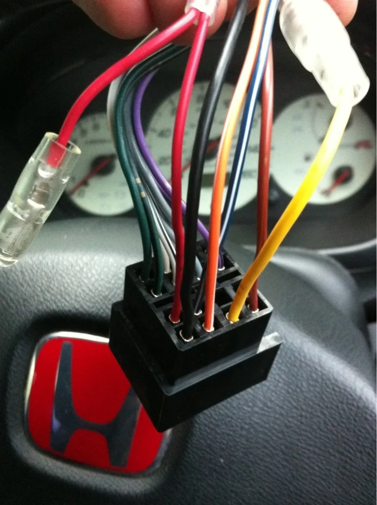

ISO block, which is Remote for Amp?
Car  1995 Renault Clio 1.8 16v
Out of the five closest wires, so:
Black,
Red,
Orange/white,
Blue/white,
Yellow,
Brown,
which one is the remote for amp?
Red has a plug with another plug coming off halfway along, as does yellow. The rest are straight wired from block to connector.
Thanks for your help!!!!
Normally blue, but an ignition live will do. As long as the amp is not left on therefore draining your battery over night.
I thought its normally always blue too, so blue and white striped is most likely on this yeah? Cheers!
itll be a blue wire coming from HU end not ISO end, if not just bullet it onto the red or yellow female bullets which aren't being used..done :)
