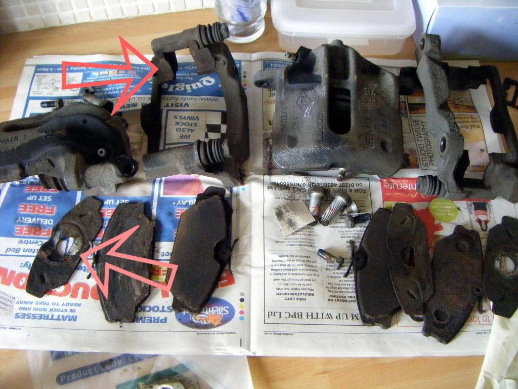

  Lionel Richie
did you remove the pads shims? thin shiny metal things
the slider pins are the bit the wee 13mm bolts go into, you pull them out

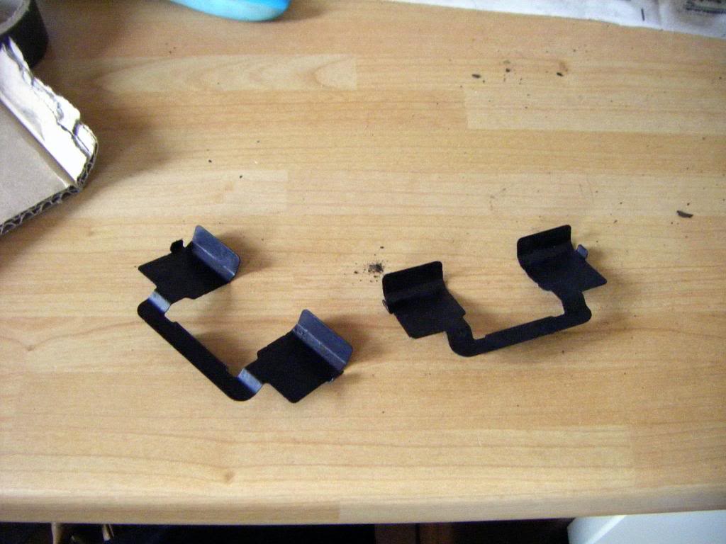

As for the Shims I presume that these are the Thin metal "brackets" that i think are made of Copper or something that sit at the top and bottom of the carrier?
If so No I didnt... Should i have?
Edit* these things? -
If so they are still on.
-J-
  RS2'ed 172 Cup
Hang on... These things?
If these I didnt Notice that there were any in there? Possibly stuck to the back of the old pads? Do i need them?
  Lionel Richie
yeah they go in the bin (post 15) and you must file the ends of the pads down so you can move the pad vertically about 1mm in the carrier
i can 99% guarantee you have a binding issue
the plates in post 17 go in the bin too

i thought they were needed to hold the pads in... i will rip them off at the weekend and see who i go without them in! i presume there is a top and bottom one on each carrier?
i presume you just Pri them off with a Screw driver, then Copper slip the Carrier where the pads sit?
  Lionel Richie
yup, but make sure you have a good 1mm of movement of the pads in the carrier, also make sure the spring on top of the pad is seated correctly
