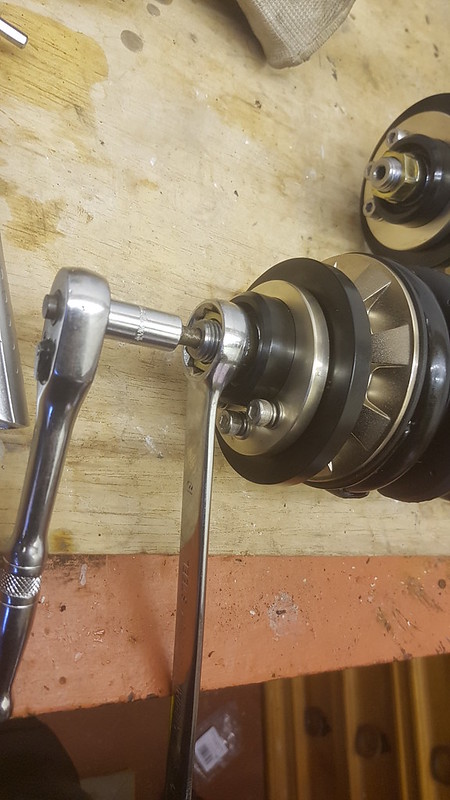

I am in the process of fitting BC coilovers, and am struggling to remove the top mounts from the new coilovers.
According to this video at 1.15, with a ring spanner and an allen key, you should be able to remove the nut to separate the coilovers and the top mounts...
However, mine seem STUPIDLY tight. And I don't want to risk rounding off the Allen key part on a brand new set of coilovers. I have tried using a bit of WD40 with no luck.

Ive got an impact gun. However that wont help as all it would do is spin the shaft really fast. You need the allen key to hold it.
No, but I need to split the top mounts and coilover to fit them
If you pulse the gun it'll take them off. I did mine this way with an air gun with my last top mounts. Didn't have to hold the Allen key.
