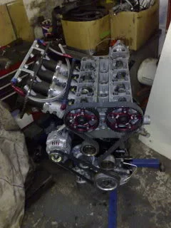

has anyone tried them direct to head bodies and any pics?????
you know the ones that dont have a seperate inlet manifold between hear and throttle bodies
  alien green rs133

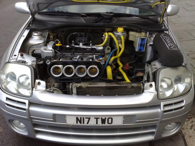

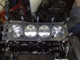

here are some rather crappy phone pics of rally cars honda blackbird bodies on jenvey inlet manifold with lpg sandwich plate

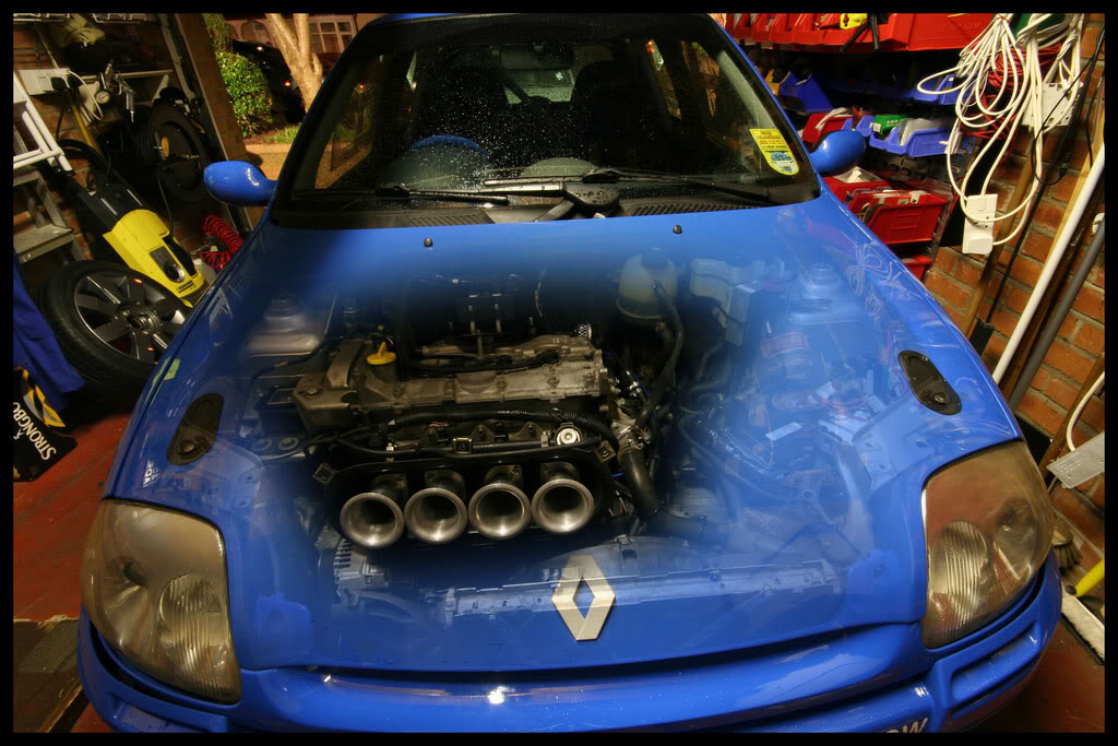

Hope you don't mind Bazzon but you had a couple of good pics there, so I did a quick photoshop. :)
:D

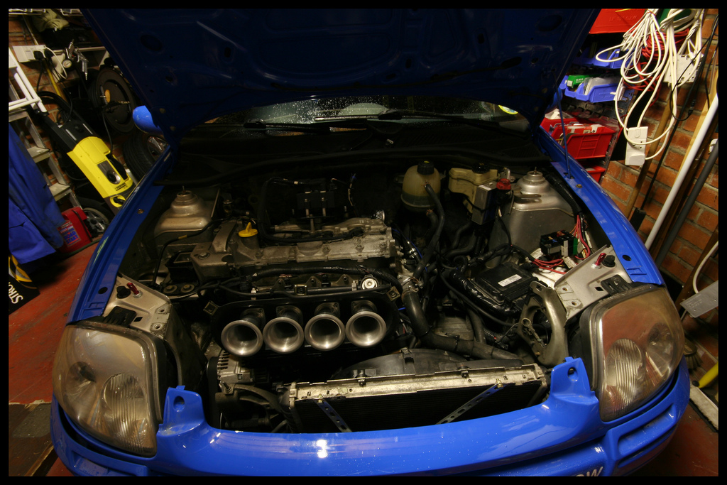

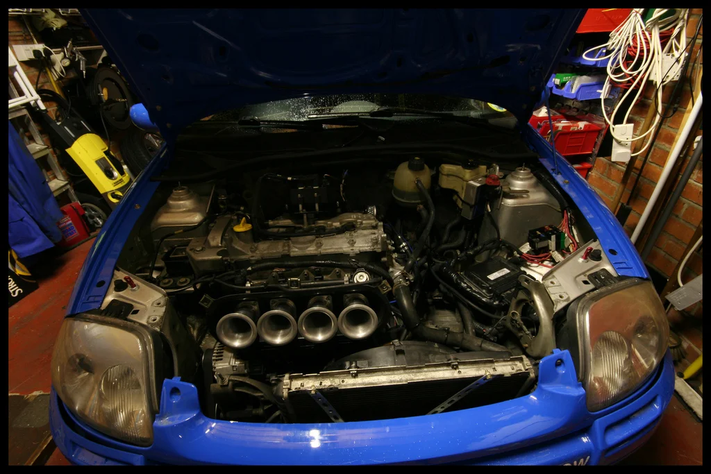

Pointless ITB install with aircon!!! Get a grip son!!
I will admit i am getting rid of the aircon but work perfectly fine with it.
I have quite a firm grip thank you dad!

I'm with Ben 100% on this - I have a pretty unique background in that I've been on pure race projects where nothing matters but meeting the power and reliability requirements and low volume OEM projects where you need to meet the power and (much longer term) reliability requirements whilst still hitting NVH, HVAC and ease of servicing requirements.
If you really want a 230bhp+ engine then why on earth do you want air-con as well? Essentialy you have an endurance rance engine package. Okay in some of the racers we want Aircon - but these are cars racing for 24hrs in the middle of France in the height of summer and we're just using up mass that would be balast otherwise (ignoring the implications of CofG).
I think few understand the massive work of a truely perfect spec engine package - I say it quite often but "you can get 90% there with 50% of the work" that last 10% is a big undertaking.
The Clio engine is packaging compromised anyway - this only gets more of a concern when changing induction/inlet/filtration setups due to the available room to fit induction/filtration. It isn't easy engineering your way out of this and if you insist on maintaining air-con etc. then it will be packaging compromised i.e sock filters etc.

Completely the point I was trying to make. Why have the possibility to have a 220+bhp engine, but have it only make >215?

If the customer WANTS an extra 30bhp from their engine and WANTS ITBS and WANTS to keep aircon then there is a solution, and no one is doubting its not the peak of performance, but with the packaging issues surrounding this its a compromise. There are lots of things that are a compromise.
No one is also doubting that to achieve the ULTIMATE result achievable the frilly bits have to go, but this is two different requirements from the customer..
However the gains from an ITB kit on a std aircon car are still good, and if thats what people want then they can have it,
IF they want to get more they have the choice......
