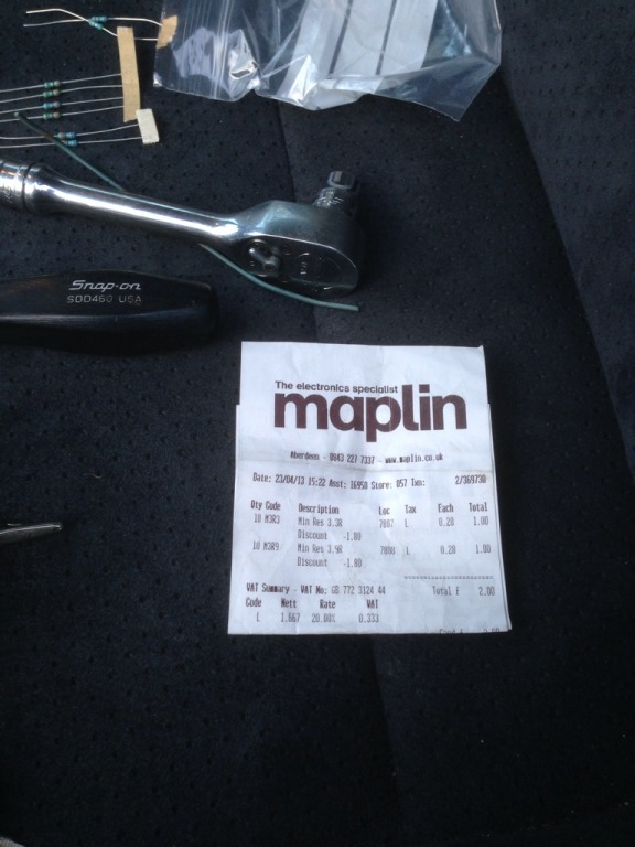

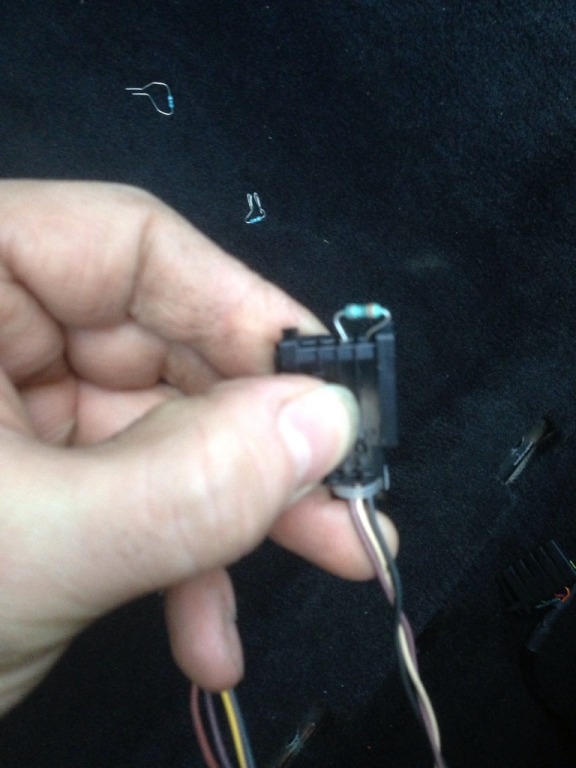

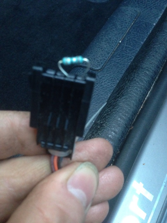

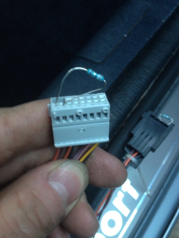

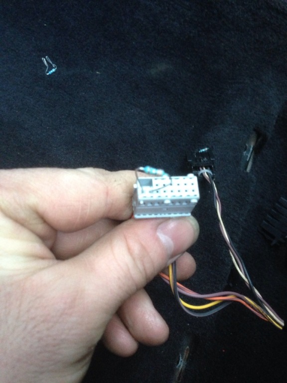

*I've already searched* What connections/wires do I put Maplin resistors into ?
After buying 3.3ohm and 3.9ohm resistors (3.6ohm ones were out of stock)from Maplin and following various guides on here.
My airbag light still won't go off.
The wires under the passenger seat used to turn the light off if you wiggled them.
But fails to do it now, and I thought resistors would be the fix.
Assistance in this matter would be greatly appreciated.
See pics below.
DRIVERS SIDE
PASSENGER SIDE

resistance is way too high for airbag. 2-2.5k is the ideal range. if you put too high resistance in, the computer sees open circuit

I had normal 182 seats and then bought trendlines so i needed to wipe out the lights. Off the top of my head i think they're 3.3 but if not they was 3.9. Ive had a look and the grey block is still connected to existing wires so ive only put the resistor in the black block above.

But has he fitted 3.3ohm or 3.3k as he stated in the first post, as this is nearly a short circuit 3.3 ohm is nothing or have I read this wrong?
  DON'T SEND ME PM'S!!
well spotted Russ, 3.3ohm is almost nothing, 3.3kohm is quite a lot, but you might get away with it
