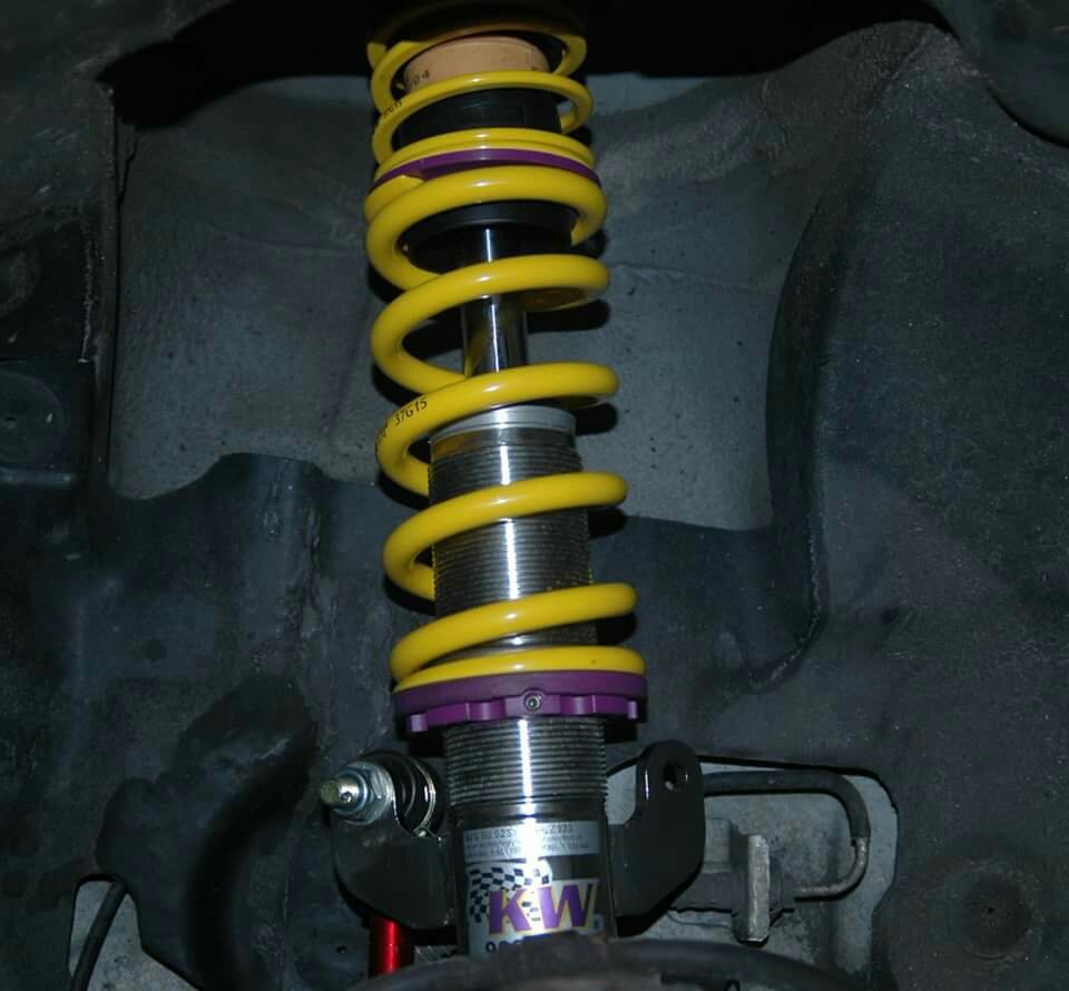

Plans next year if I'm still enjoying the car which I'm sure I will be.. are a set of KW V3/Clubsport coilovers, airtec intercooler and a stage 1 remap from RS Tuning.

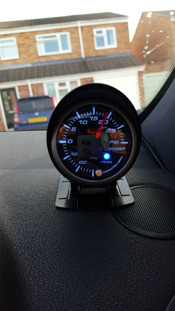

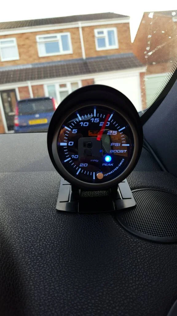

I also fitted a boost gauge just after Christmas mainly to make sure I have no leaks. Was a right pain to do and wish I had never started it! But finally got it all sorted

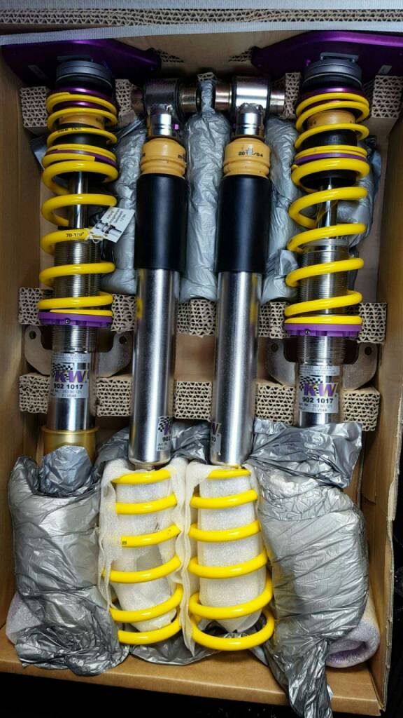

Back down to K-Tec on Thursday to get the following done;
Coilovers
Set up
Stud and nut kit
Braided lines
Brake fluid

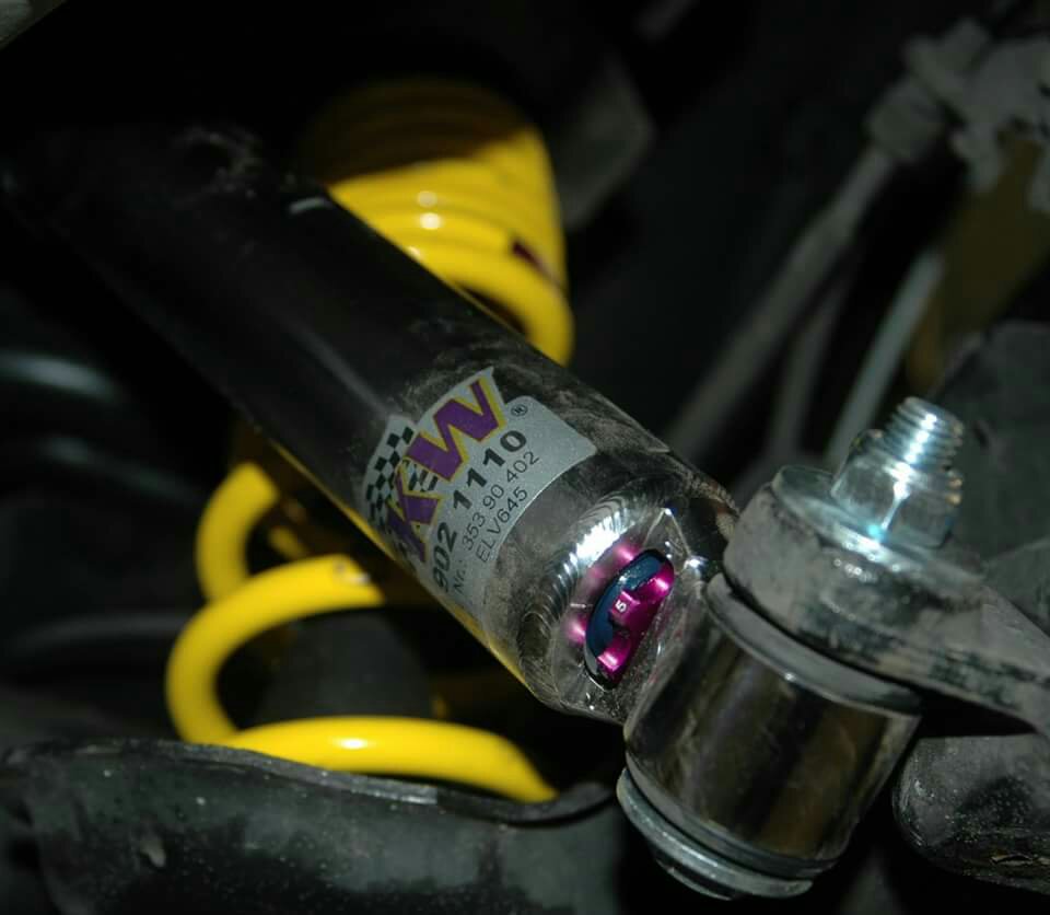

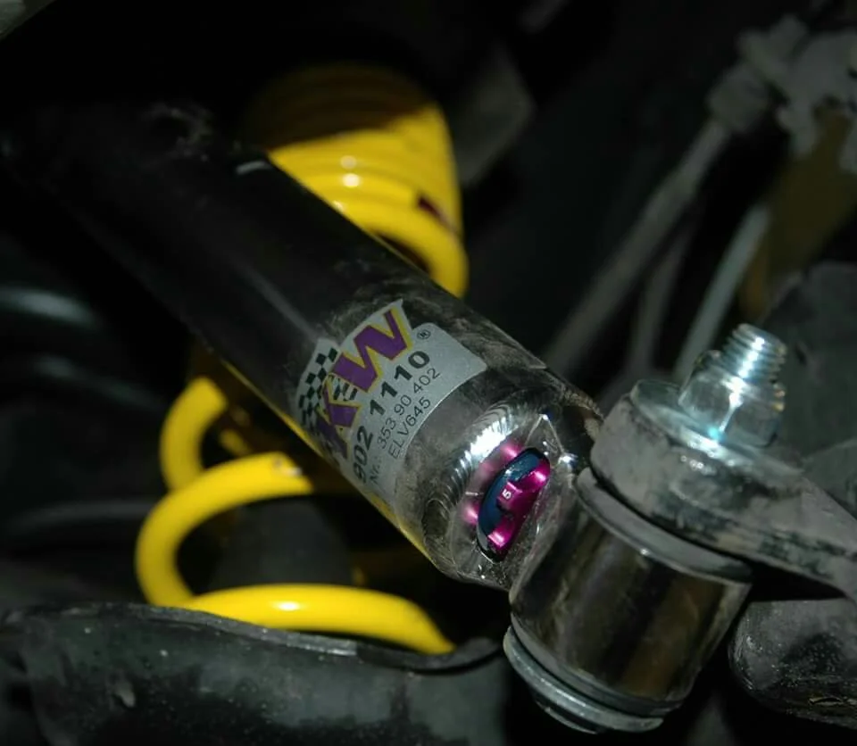

I was set on a set of AST 5100's, Curtis' customer service was absolutely shocking so decided not to go with them and ordered a set of KW clubsports from France as it worked out around the same price I was getting the AST's for.

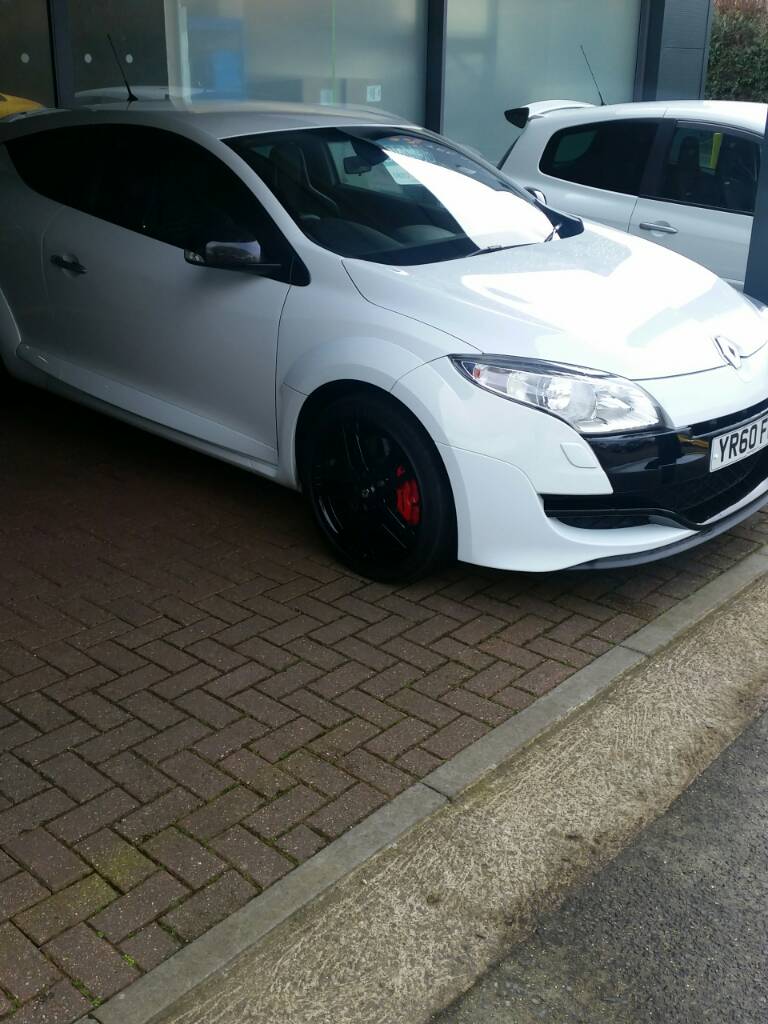

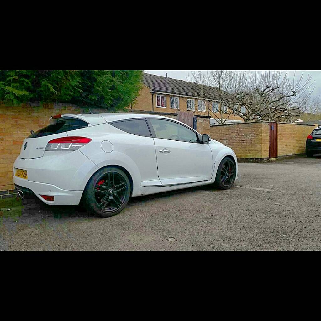

Picked the car up from K-Tec this morning, cracking service once again. Seriously can't recommend them enough, I wish I had more money to keep going back there lol! Really enjoy the drive down to, lovely roads and especially on the way back this morning car felt stuck to the road!
Anyway pulled up to find my car the first one on the end, definitely looked a lot lower, running -2 degree camber up front wheel stud kit brakes feel a lot better with the lines and fluid. All that's left to do now is wait till Bedford next week, the stuff that's getting done at RST, get the wheels refurbed. I would like a new set of wheels to fill the arches (I've heard spacers ruin the handling) but I'll see how much money.
I've only got the one picture of how the car sits at the moment, I'll get some more in the week or at Bedford.

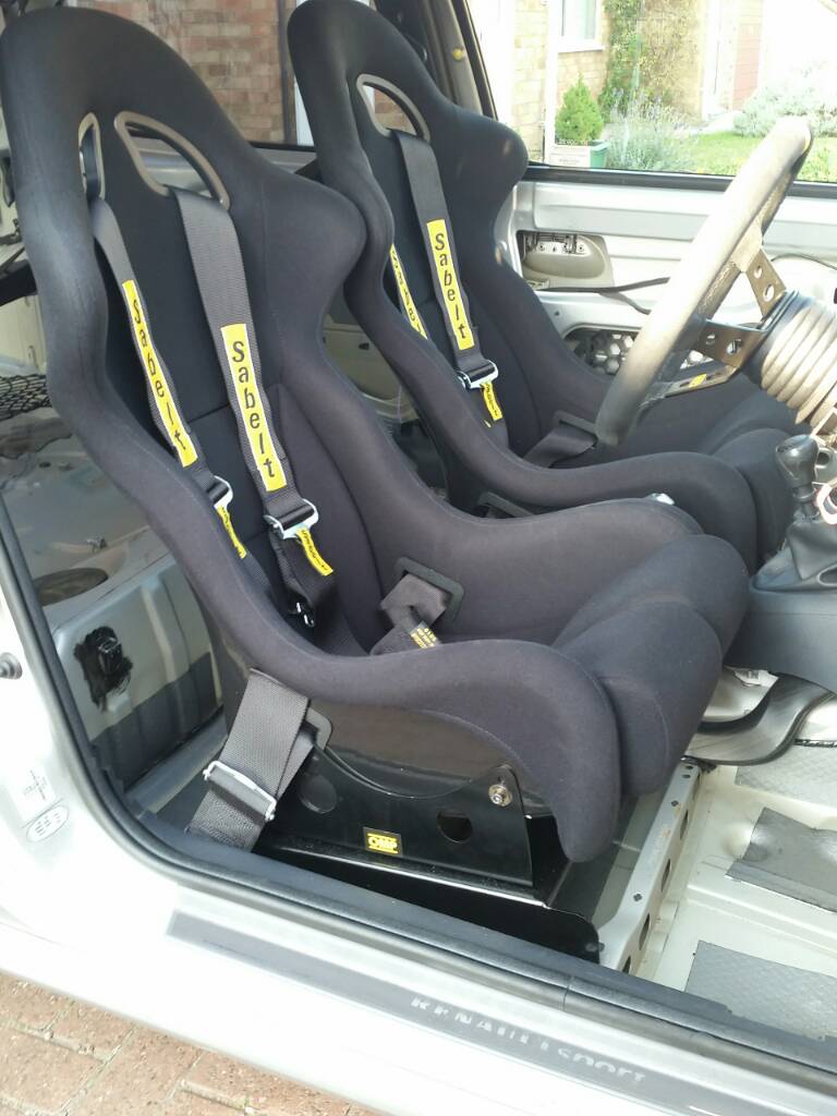

Was suppose to message you actually, where have you mounted your harnesses to? I know where in the back but are you using eye bolts? I was all over the place and don't really want to go bucket seat route haha
-Jamie-
I'm pretty sure I typed Jake LOL!
Clubsports are good tbh, but knowing first hand what Nitrons are like I would rather them, especially now the euro isn't as weak and the £1400 clubsports are now not far off Nitrons haha.
Rear belts are on eyebolts to where the original mounting points for seats and belts are, same as where the Trophy has them mounted, Shall be getting a harness bar welded in soon though, inner lap belt and crotch straps are on eyelets that have been welded in with spreader plate etc and the outer is just on a bracket to where the seat belt mounts
