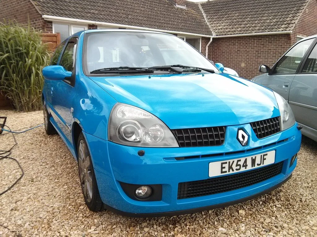

I'm new to the forum and have recently acquired myself a RB 182. This is it after some TLC today. Stupidly I didn't take any pictures before I started tinkering with it, was too busy enjoying driving it!

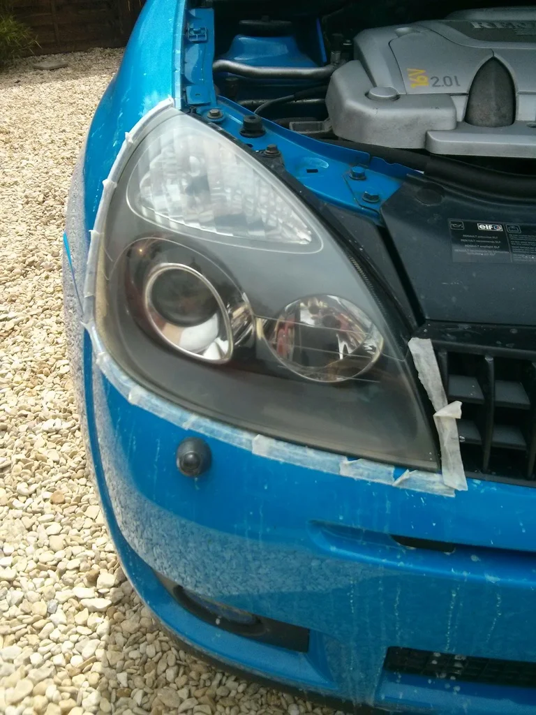

Headlights were suffering from the standard hazing/discolouration problem. They also had some quite deep marks on the sides:
After doing some research on here I decided to take the wet and dry approach. Masked off the bumper and wing and used 1200 wet for about 30 mins on each side followed by 2500 wet for about 15 mins each side. This left them looking like this:
At this point I had to stop and leave them overnight (also worrying a bit that I'd ruined them!) I'd read that G3 brought them up pretty nicely so I used that today. Comparison with passenger side treated with G3, drivers side just after sanding:
And here's the finished drivers side light:
They're not perfect by any means, they still seem to have a very slight haze to them but they're much better than they were so I'm happy :smile:

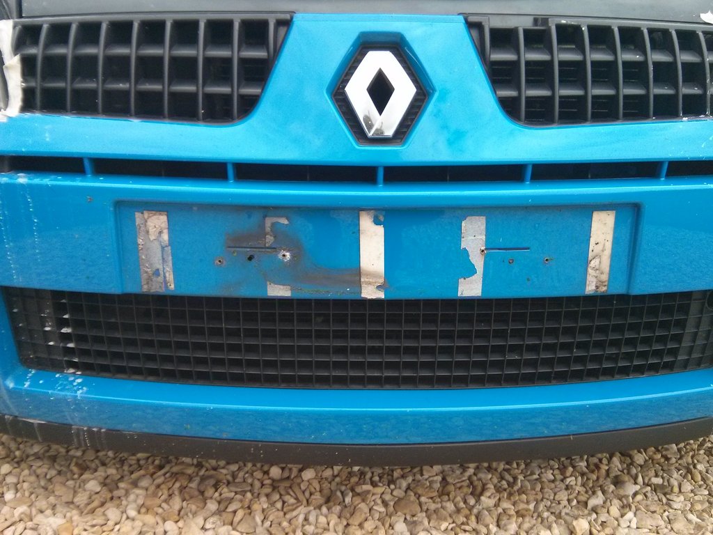

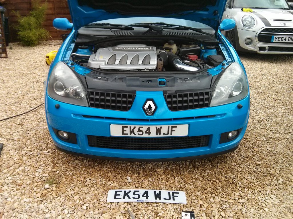

Next up was changing the front plate from the one above to a 3/4 size (again found the guide on here)
Unfortunately the previous owner had used about a million sticky pads (well 5 if you're not a fan of exaggerating like me :tonguewink and they were an absolute b**ch to remove.
I used 45mm velcro coins to fix the new plate and am really happy with how it looks

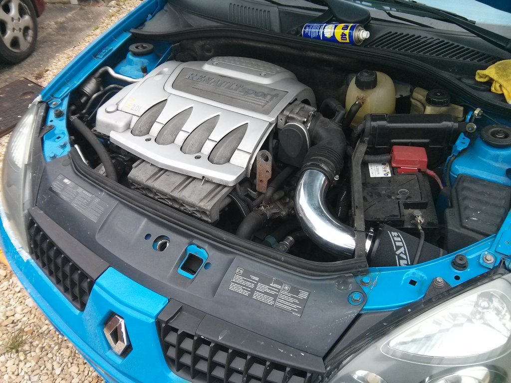

The eagle eyed among you may have spotted I've also changed the standard airbox to the "fatty induction kit" setup. I'd intended to keep it standard but the child in me wanted more induction noise. Wasn't sure how loud it would be and when driving along normally could barely notice the difference. However as soon as you use full throttle it sounds insane!!

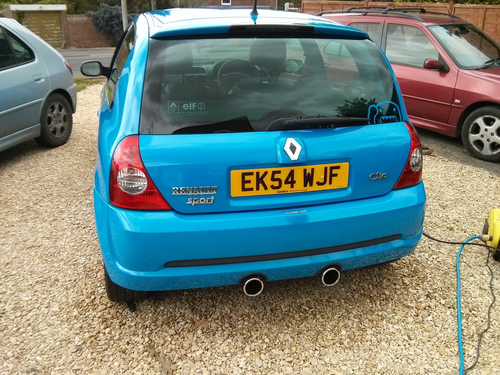

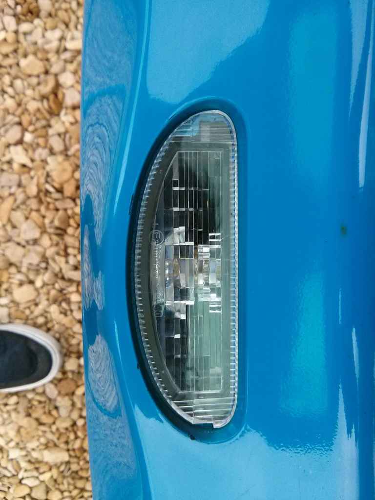

Next up was changing the rear numberplate light unit as the old one looked horrendous :fearscream:
Much happier with the new one:
Then I just gave it a good clean and wax and that was me done for the day! I'm amazed by how good the bodywork is considering it's an 11 year old car. I'm absolutely in love with the colour, love how vibrant and unusual it is and it cleans up really well.
