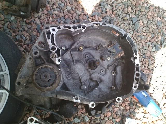

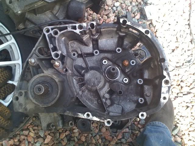

well I hunted around the local scrappy for renault boxes and came across a megane scenic box that looked pretty close. couple of lugs in the wrong place and needed to move the big bolt under the starter area over one hole but that was about it. was missing two of the mounting holes at the top also beside the tdc sensor but Ill have to live with that. There is also an opening where the tdc sensor is which isnt on the megane box but it doesnt seem to be needed and doesnt obstruct anything.
couple of pics of the boxes:
182 box:
megane box:

looks almost identical to the clio one, tdc sensor etc. clio box has a cutout and a bolt hole each side that the megane one doesnt have tho
