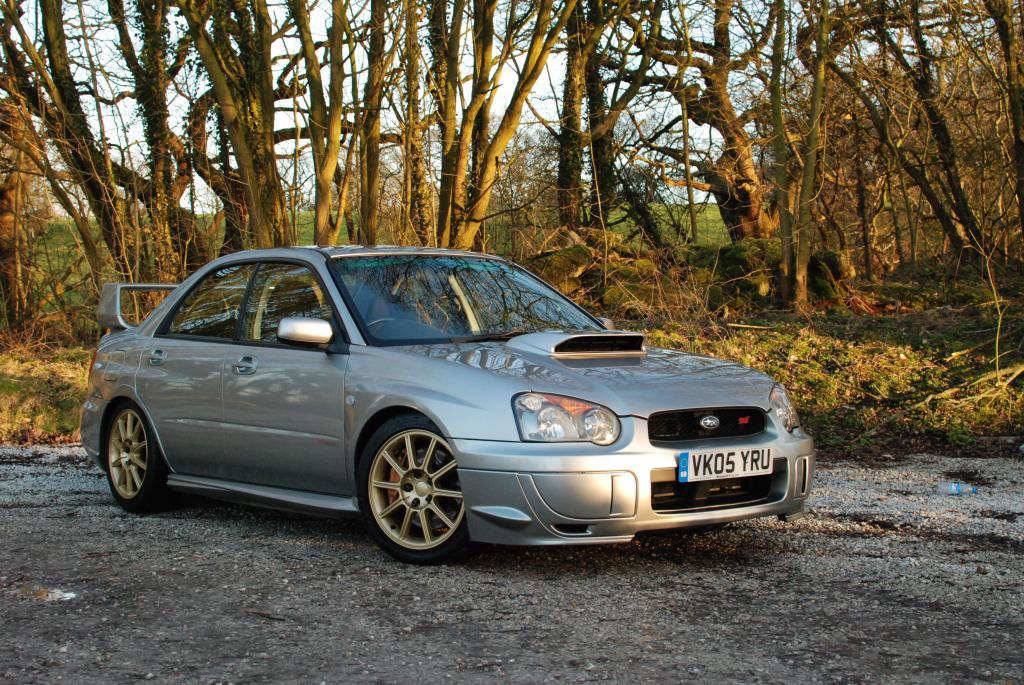

Right then. For a while I owned this:
Loved driving it, ended up at quite a decent spec, 330bhp, coilovers, Spec C interior etc, but it cost me a fortune as a daily. Plus it was too scary having the best part of £10,000 (total I'd put into it) on track. I couldn't push myself. The main thing was running costs though.

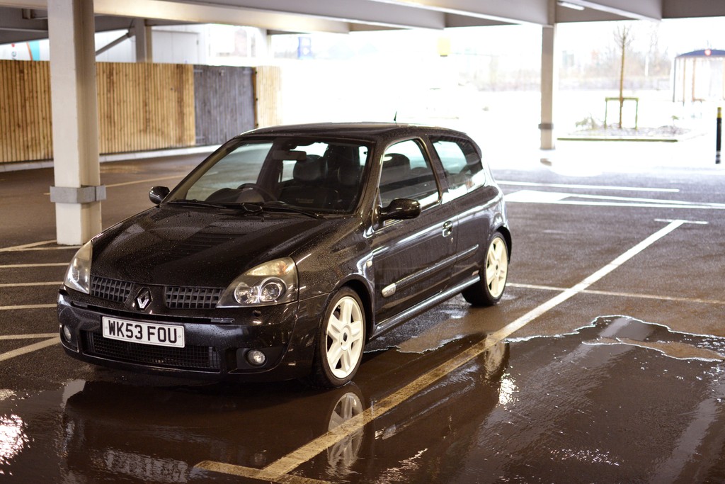

So here it is! My 2003 Renault Clio 172!
It's a hilarious little car. Revs forever, more torque than I was expecting, great handling fun little machine.
I had a lot of Peugeots when I was younger (Pug306 for lyfe yo) including a tuned 306 D Turbo and a GTi6, and it's genuinely nice to get back into something rattly, French and with a big engine!

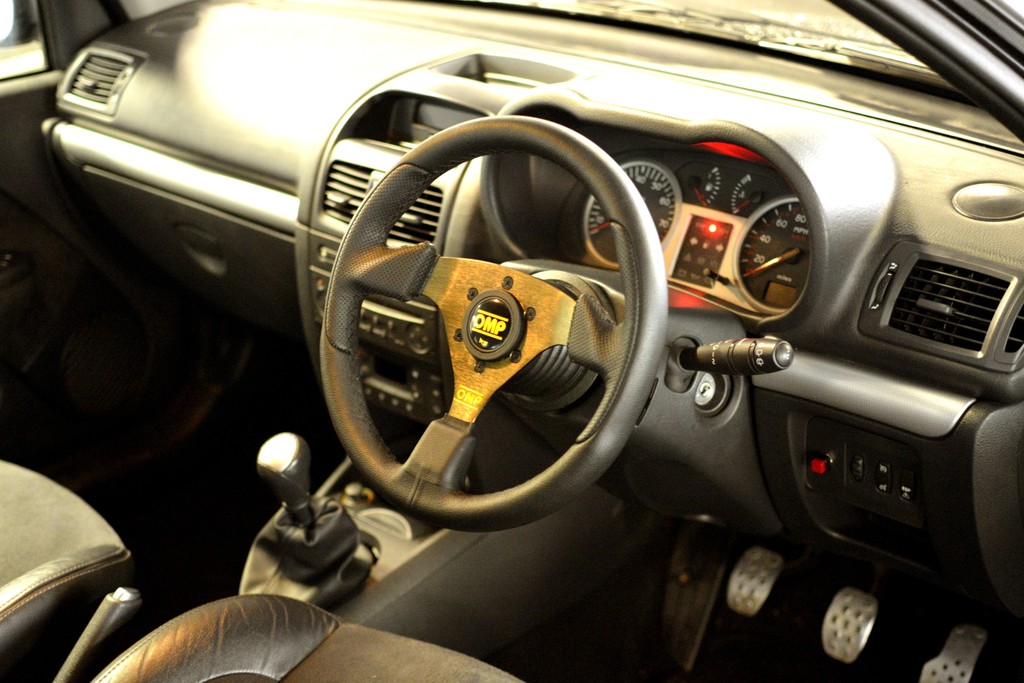

It's currently got an OMP wheel which will be getting swapped for my Personal Neo Grinta, it's lowered on springs with KYB shocks (firm but predictable ride), polybushed engine mounts; and what's more it hasn't been fitted with an aftermarket exhaust so the subtle rear hasn't been ruined!

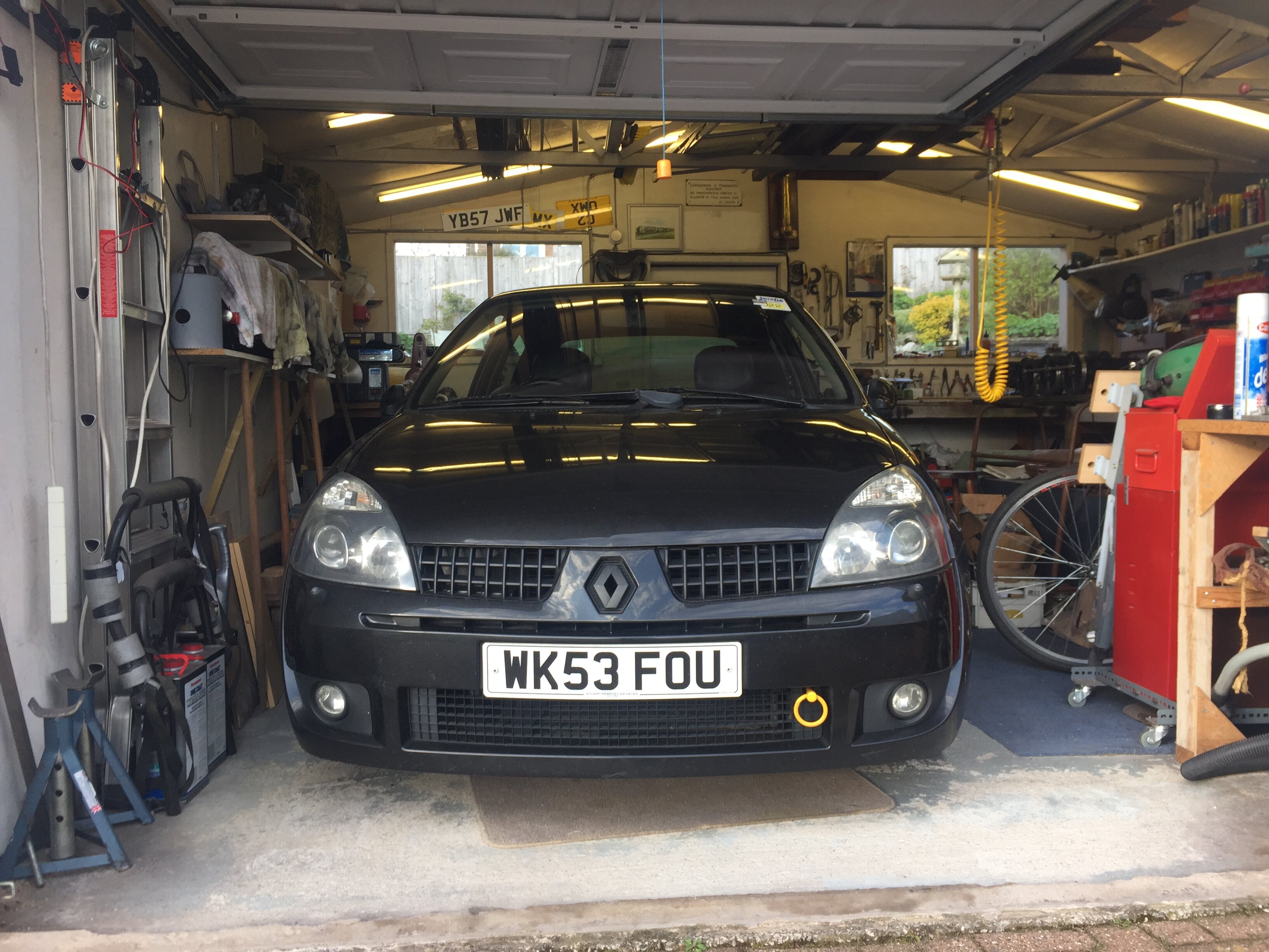

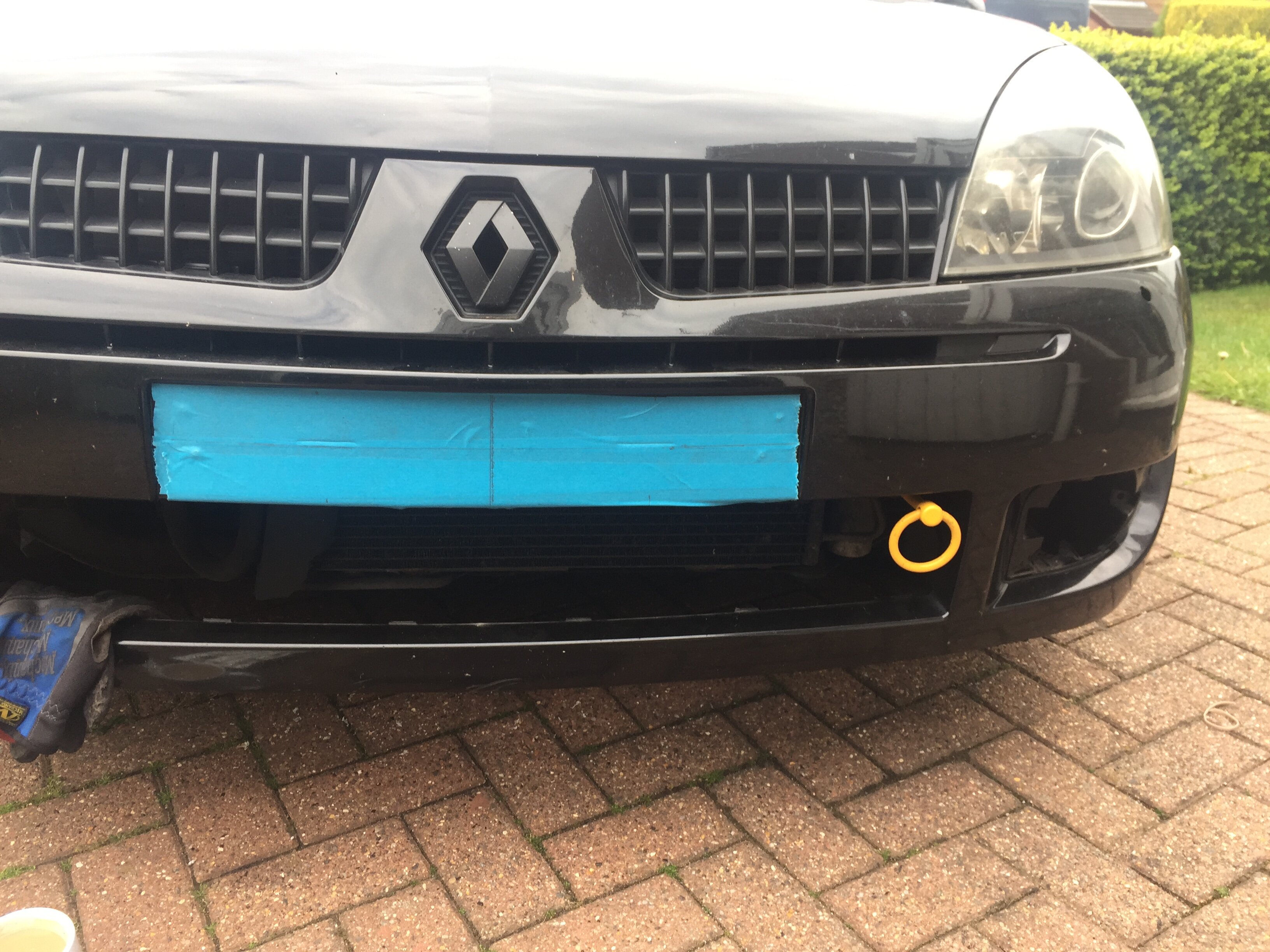

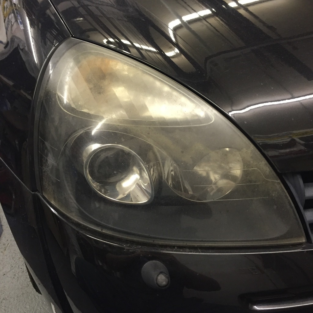

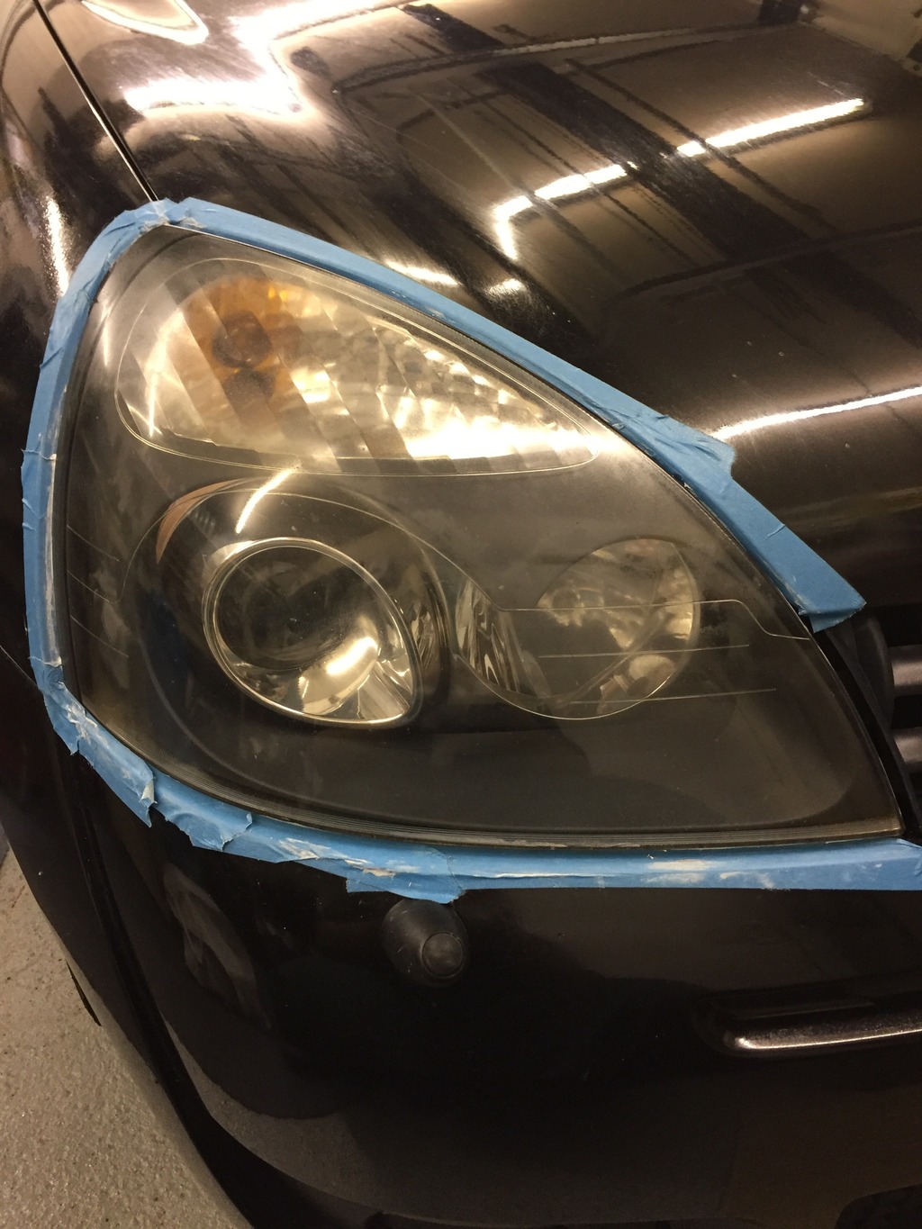

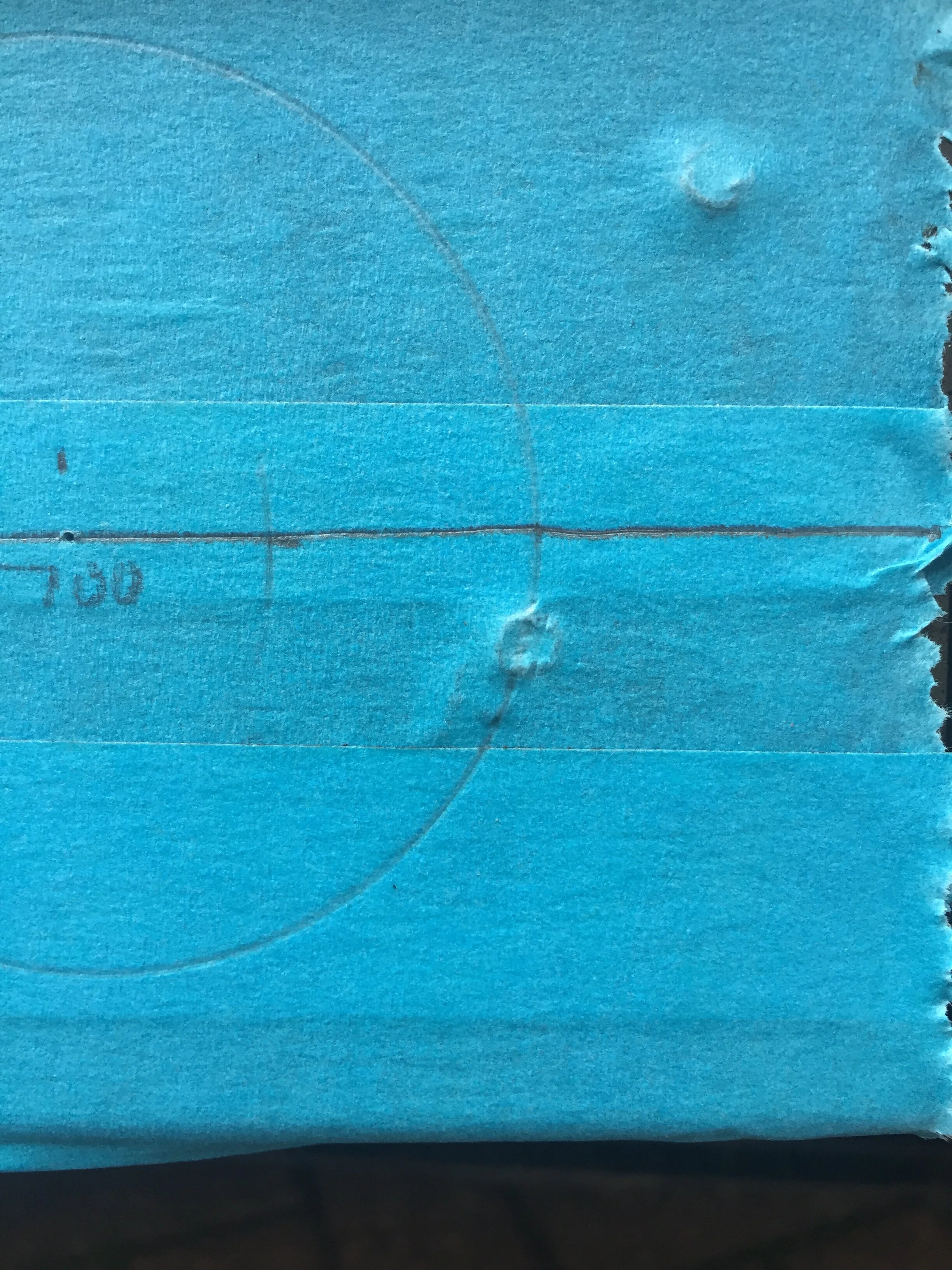

Not much of an update, but tried every product in my garage to try and sort out the yellow headlights. Didn’t seem to be making much progress but compared to the other side it seemed an improvement. Will probably just use wet & dry next time! I’m doing it by hand, tempted to get the same place that polished my Impreza headlights to do it, but that costs money; whereas if I do it myself, it is free!
Think I need more practice applying the scene tape!
Gave it a bit of a wipe down now it’s in the garage (it’s been raining pretty much since I bought it, and when its been dry its been dirty), and the paintwork seems a lot better than I was expecting. With it being at the bottom end of 172 prices I expected the paint to be a foregone conclusion, but it seems alright!

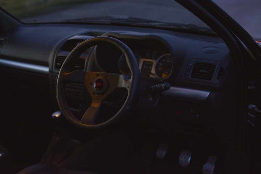

Also managed to get my beautiful Personal wheel fitted (Personal is the modern side of the Nardi brand). The quality is so much better than the OMP one it replaced. That said the price was a lot more!

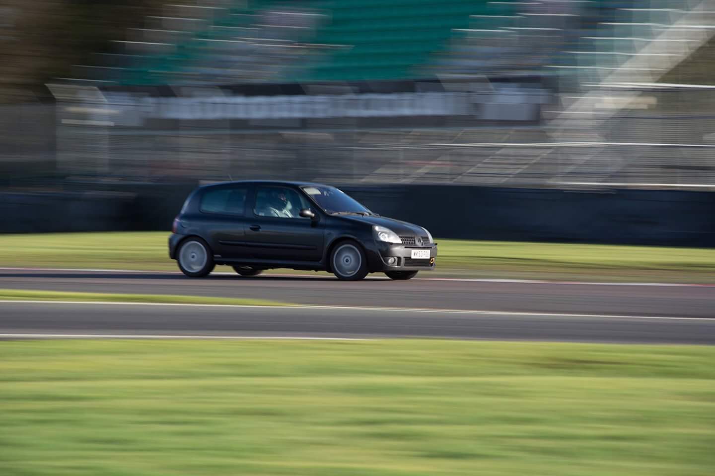

Had a run out last weekend, performed well with the big boys!

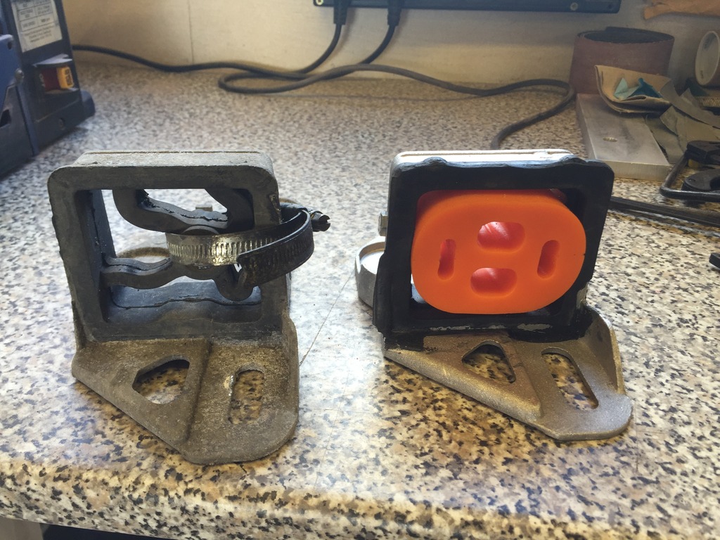

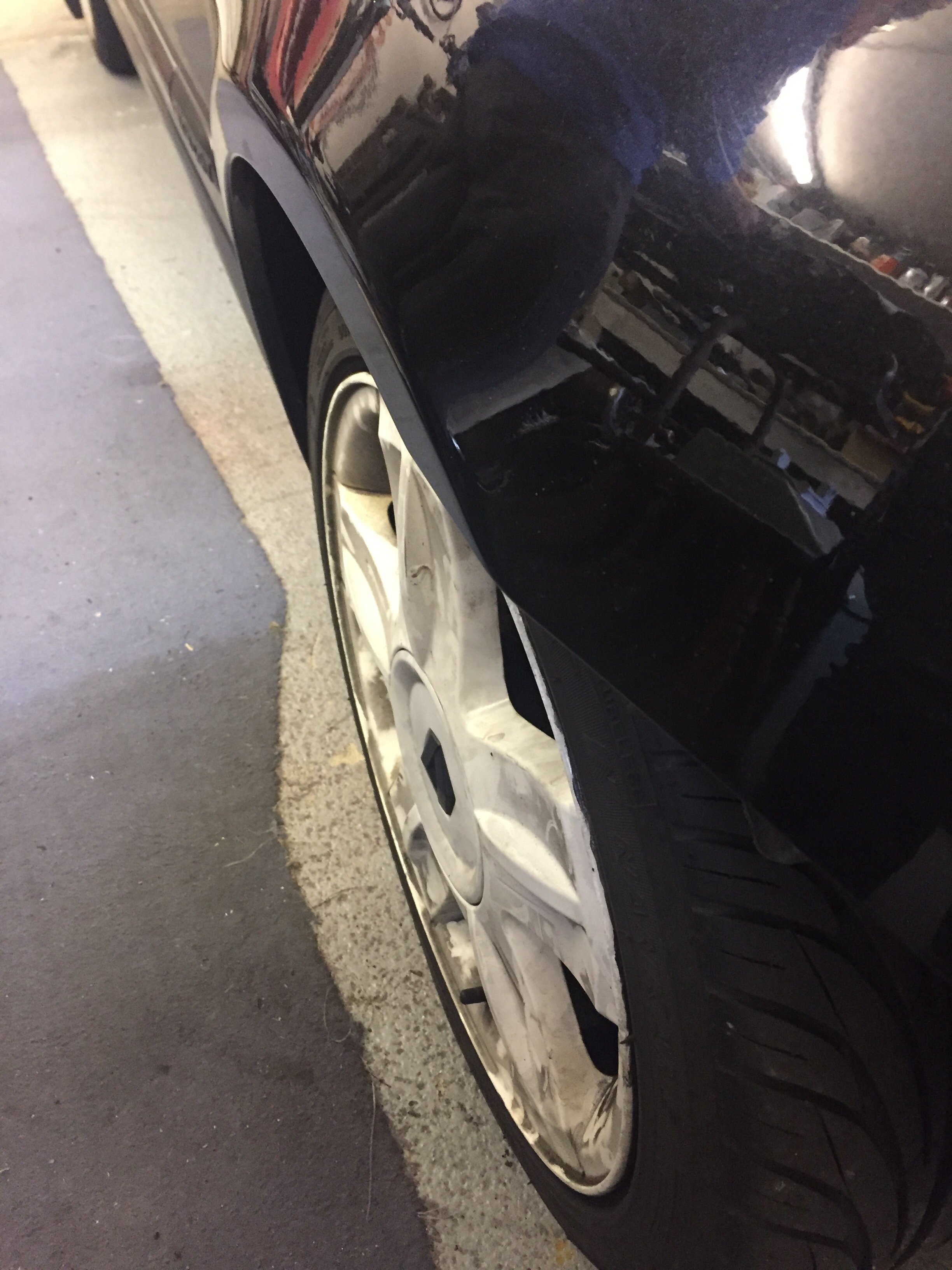

Also aimed to address a few niggles this weekend, had a patch of wheel wobble but after checking runout on the wheels it just seems to be a wheel out of balance.
Had some knocking from the rear, thought it was the top mounts or something but turns out it to be this:
(Video)
So that turned out to be cheaper than expected! After getting the old exhaust mount out and placing it side by side with the new one, I don't get why it wobbled, they were virtually the same....
/Sarcasm off
That's all sorted now!

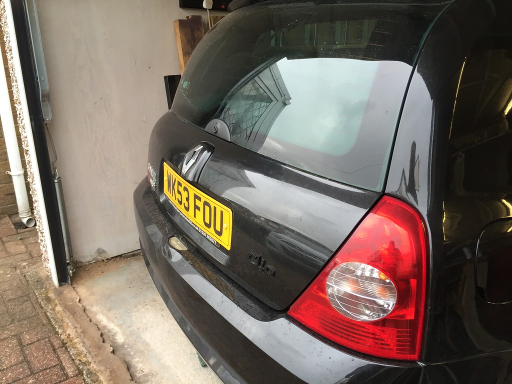

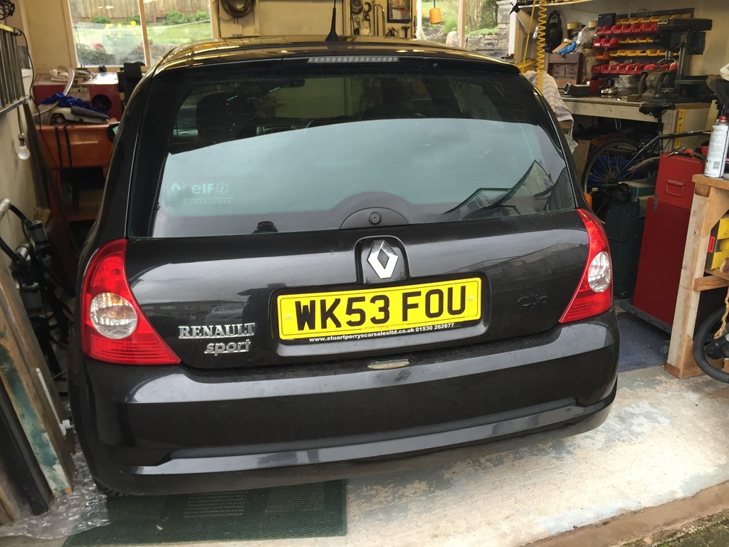

Also had a few spare minutes so dewipered it. Looks much better, just need to make sure it's watertight!

Cheers! Yeah it's on the list to remove. Will get a little rubber bung for the hole. Going to debadge the otherside too.

Weight saving :smile:
No, its simply a looks thing. Really don't like rear wipers. Never use them, plus the car isn't a daily so it doesn't need to be super practical.

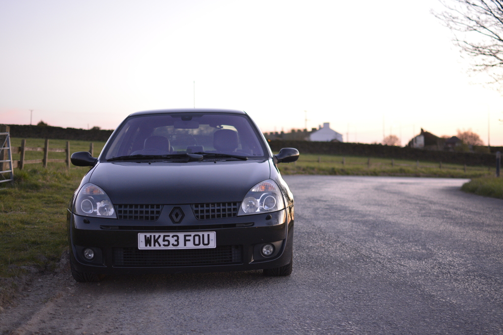

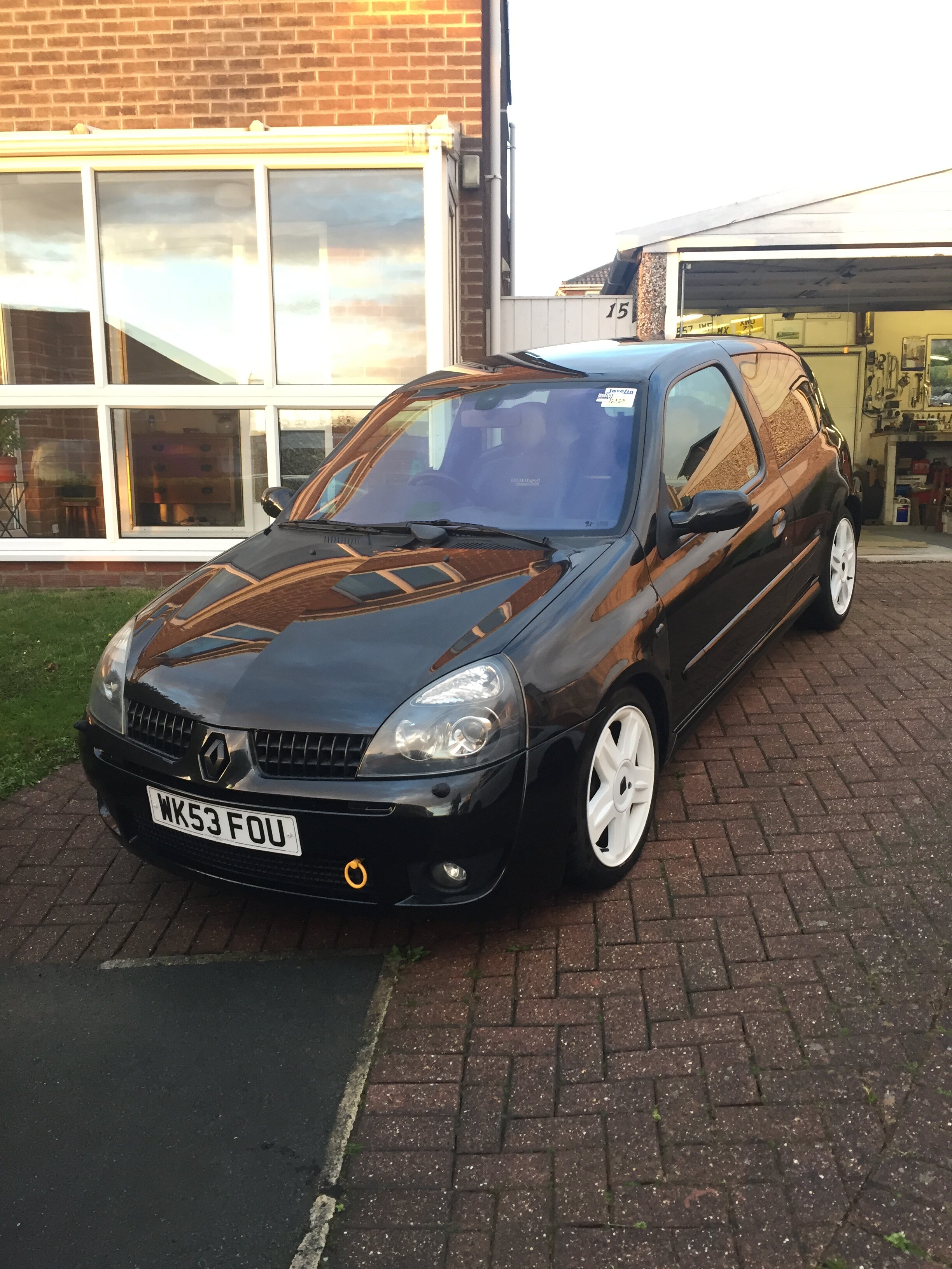

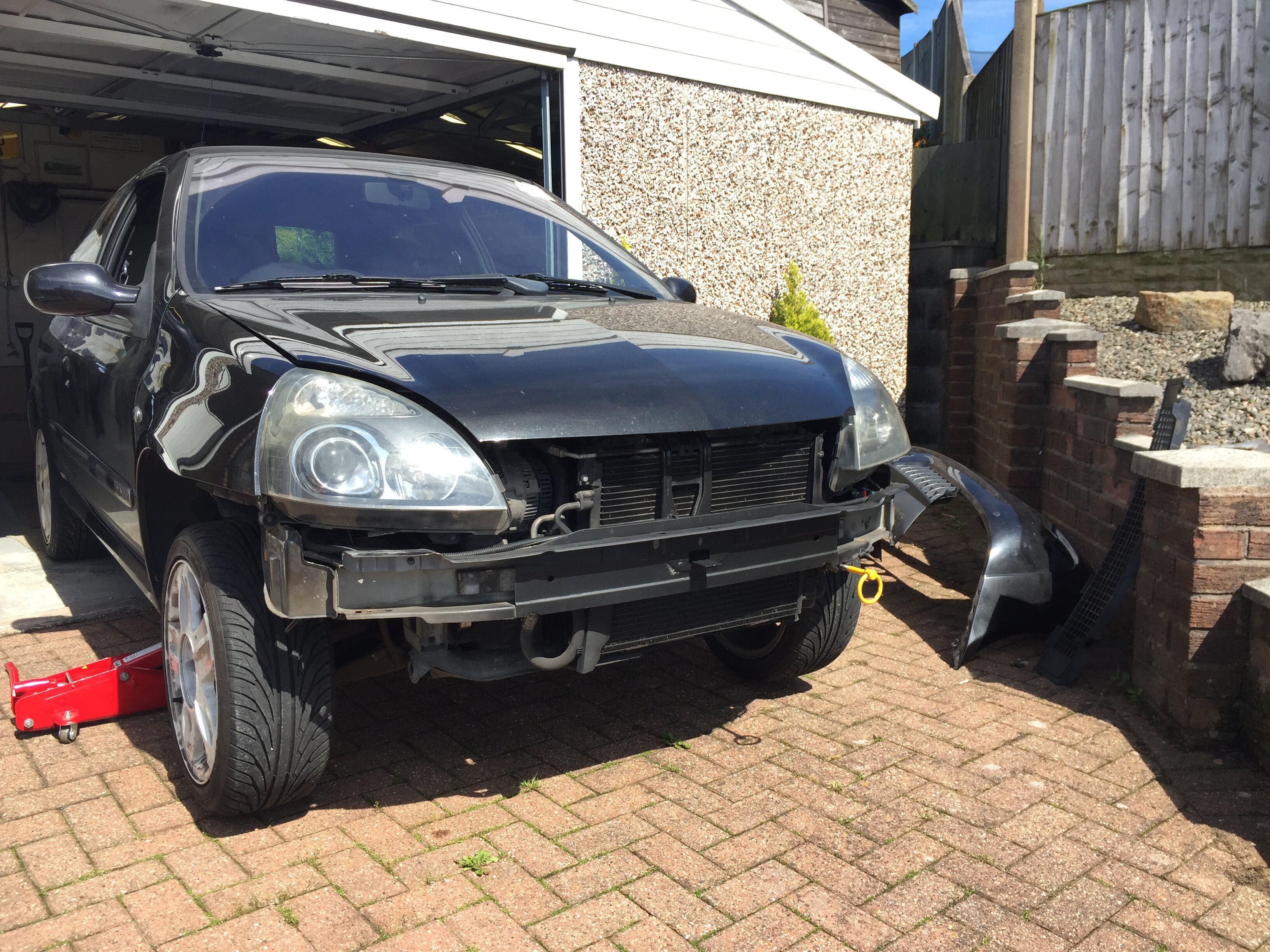

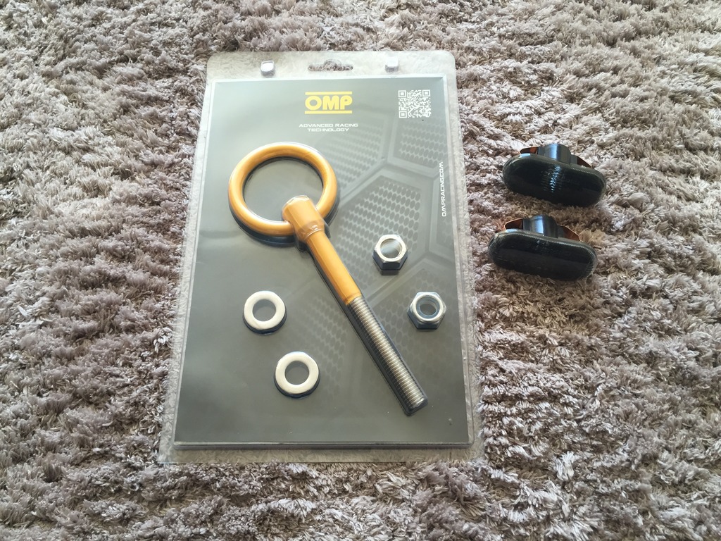

Some treats arrived.
The tow hook isn't fitted as I ordered over eagerly and presumed it would screw into the standard fitting. It didn't. Contemplating re-ordering a different one or making this fit. The fact I already have this is a big factor. Got the side repeaters fitted, as expected, they required some manipulation in order to fit. Really starting to wonder if products are getting more and more poorly made these days or people just have lower standards than me.
Decided to get out and abuse my DSLR with my hamfisted photographic inadequacy:

Already got mine fitted. Just turned a sleeve and threaded it. Fits like a dream now. Regarding the price, he's probably out of stock, I've seen a few sellers do that.

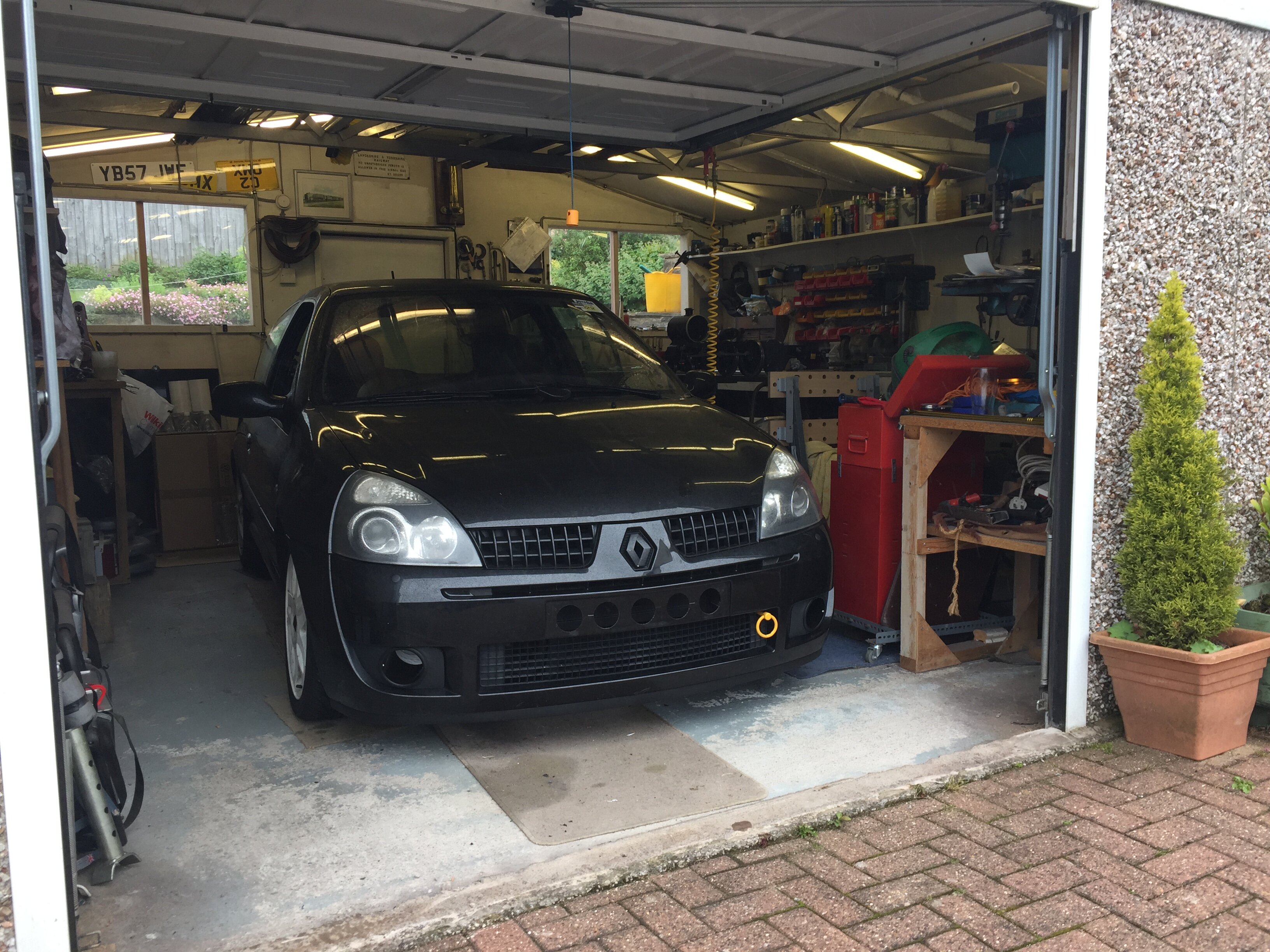

Not much of an update but I'm bored on my lunch and thought I'd put something up.

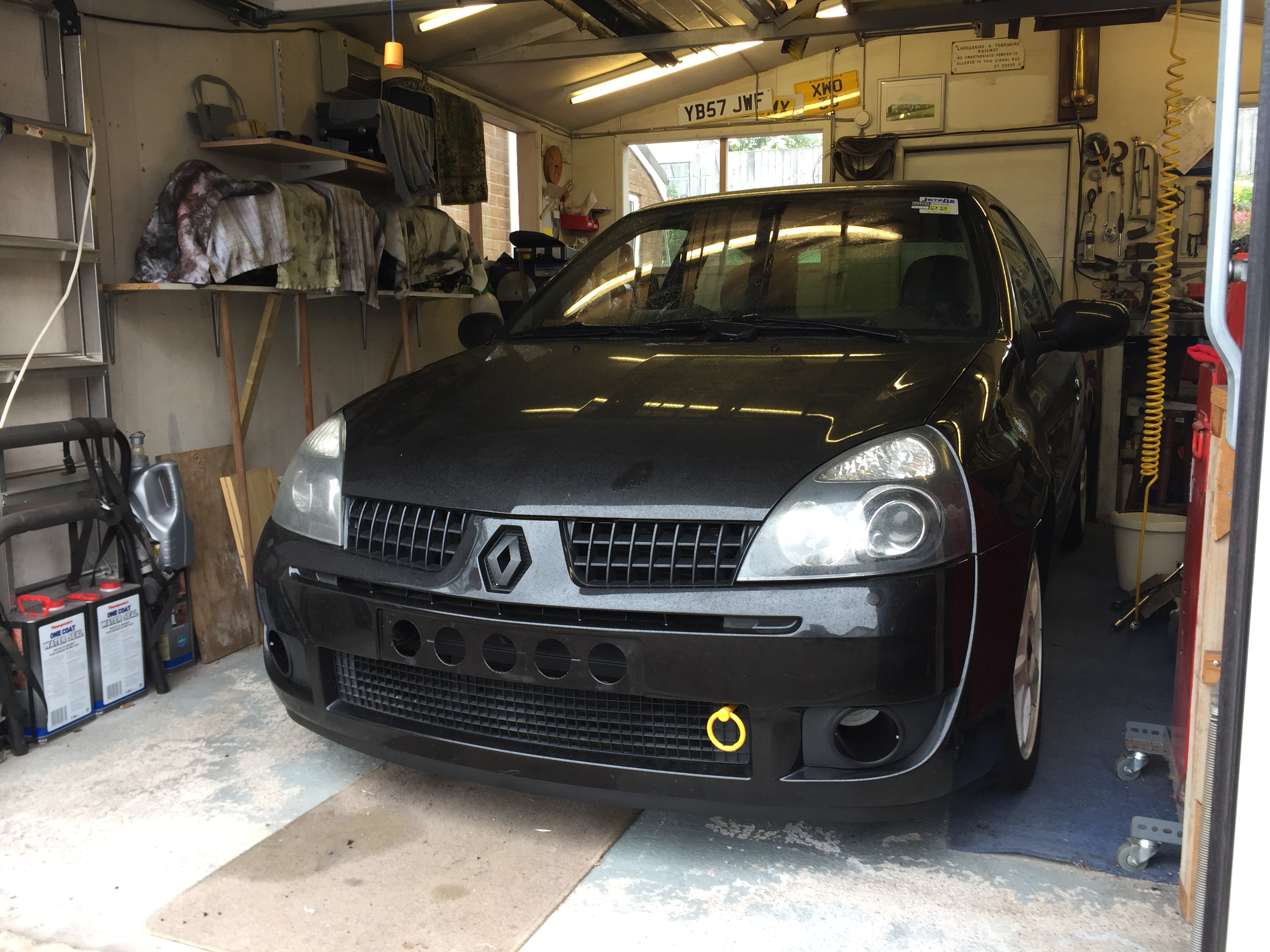

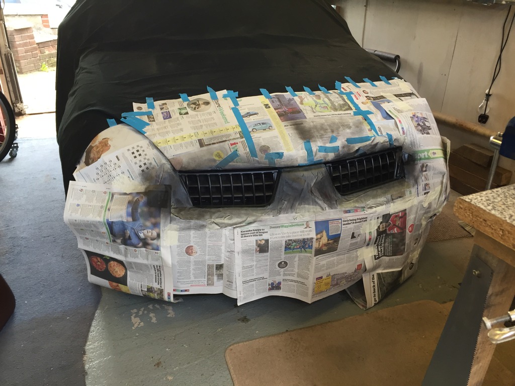

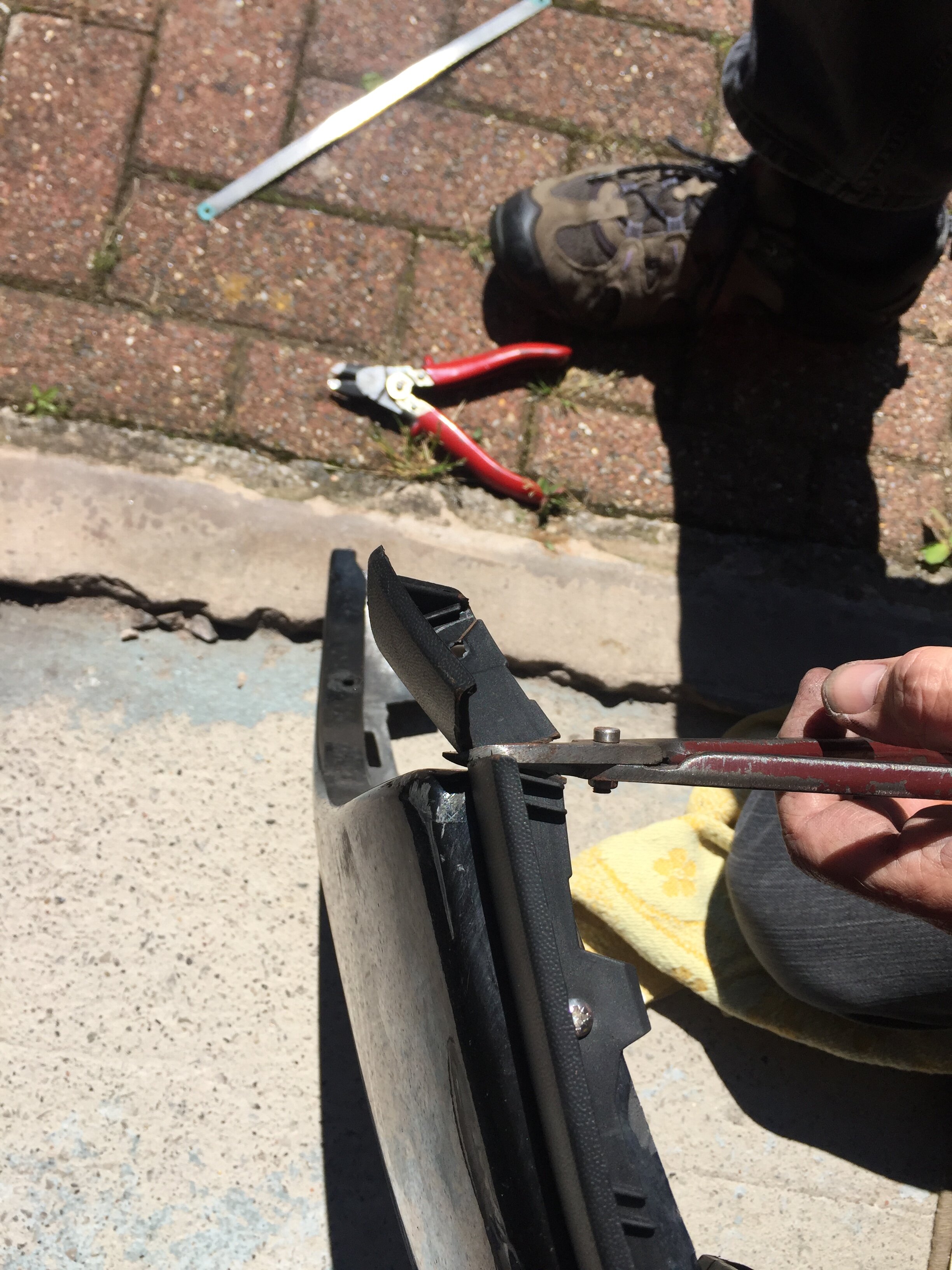

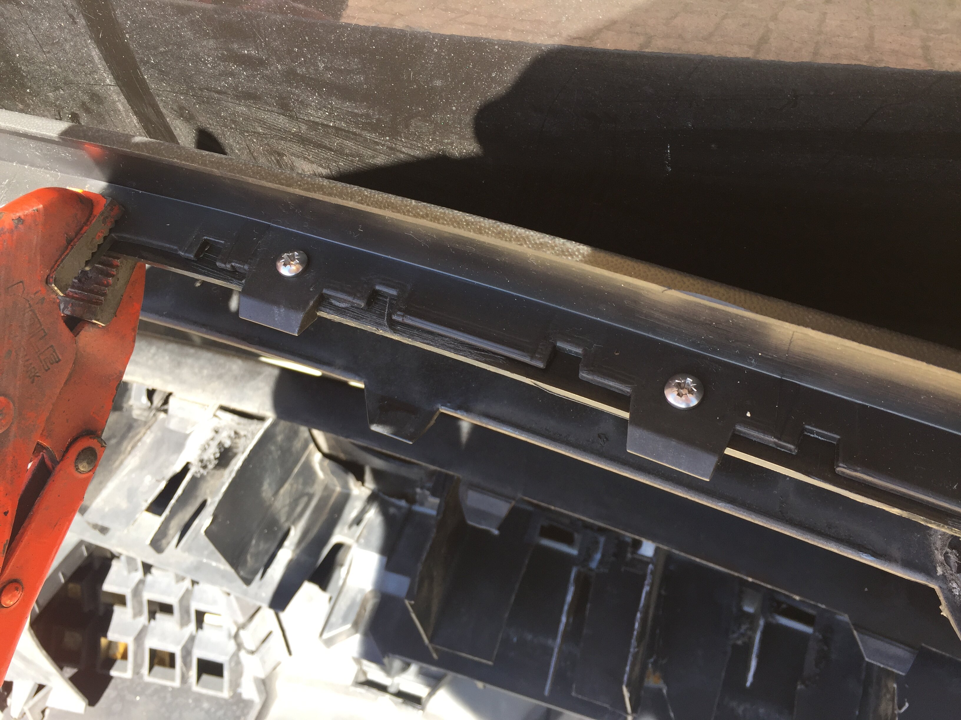

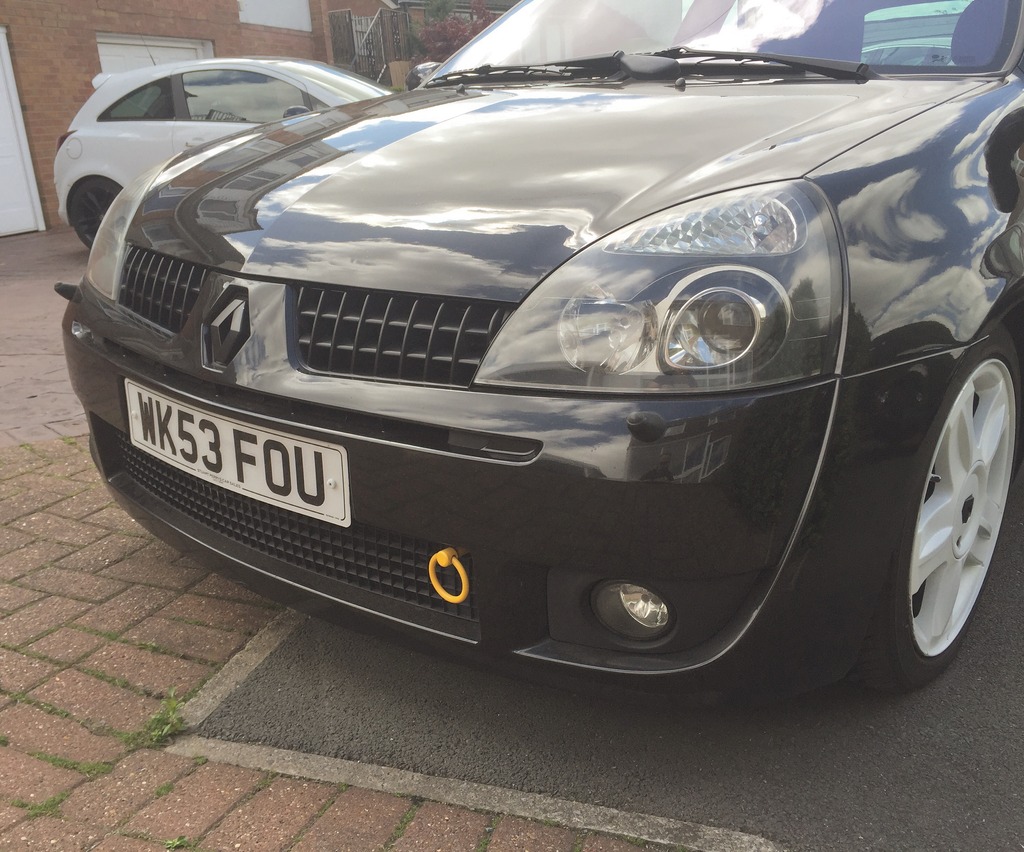

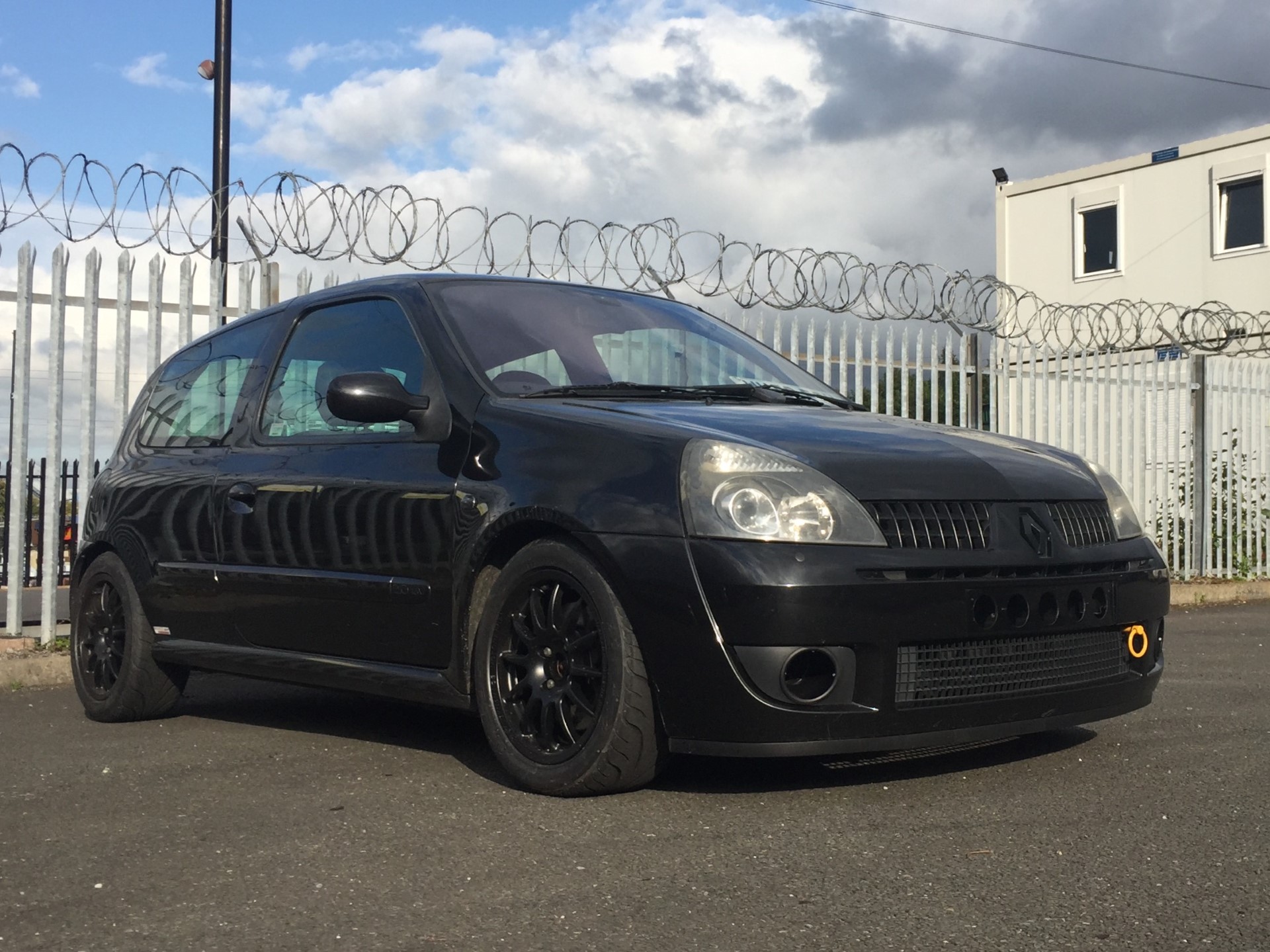

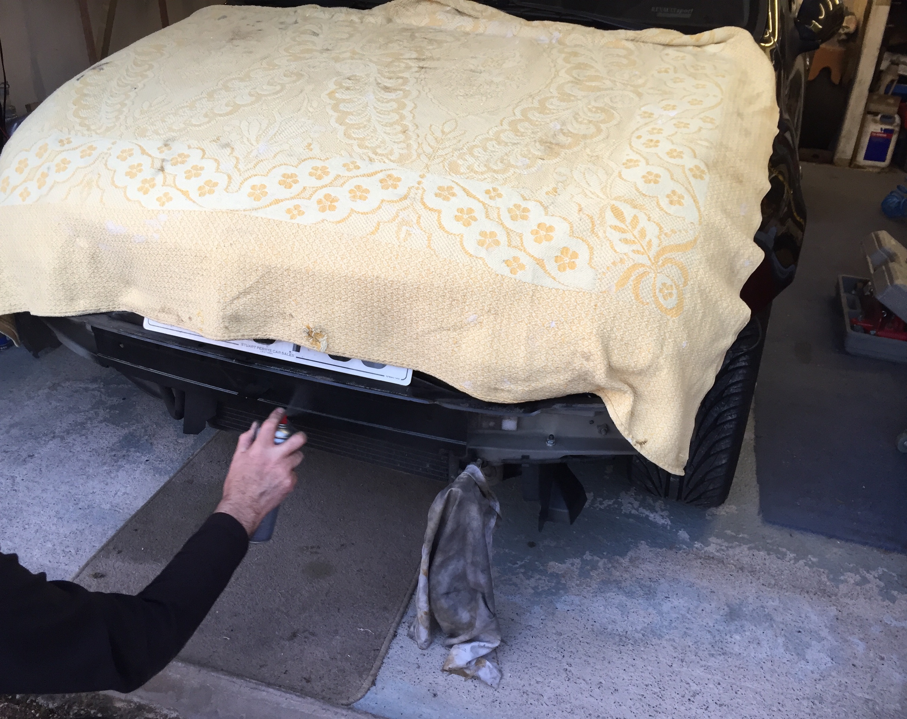

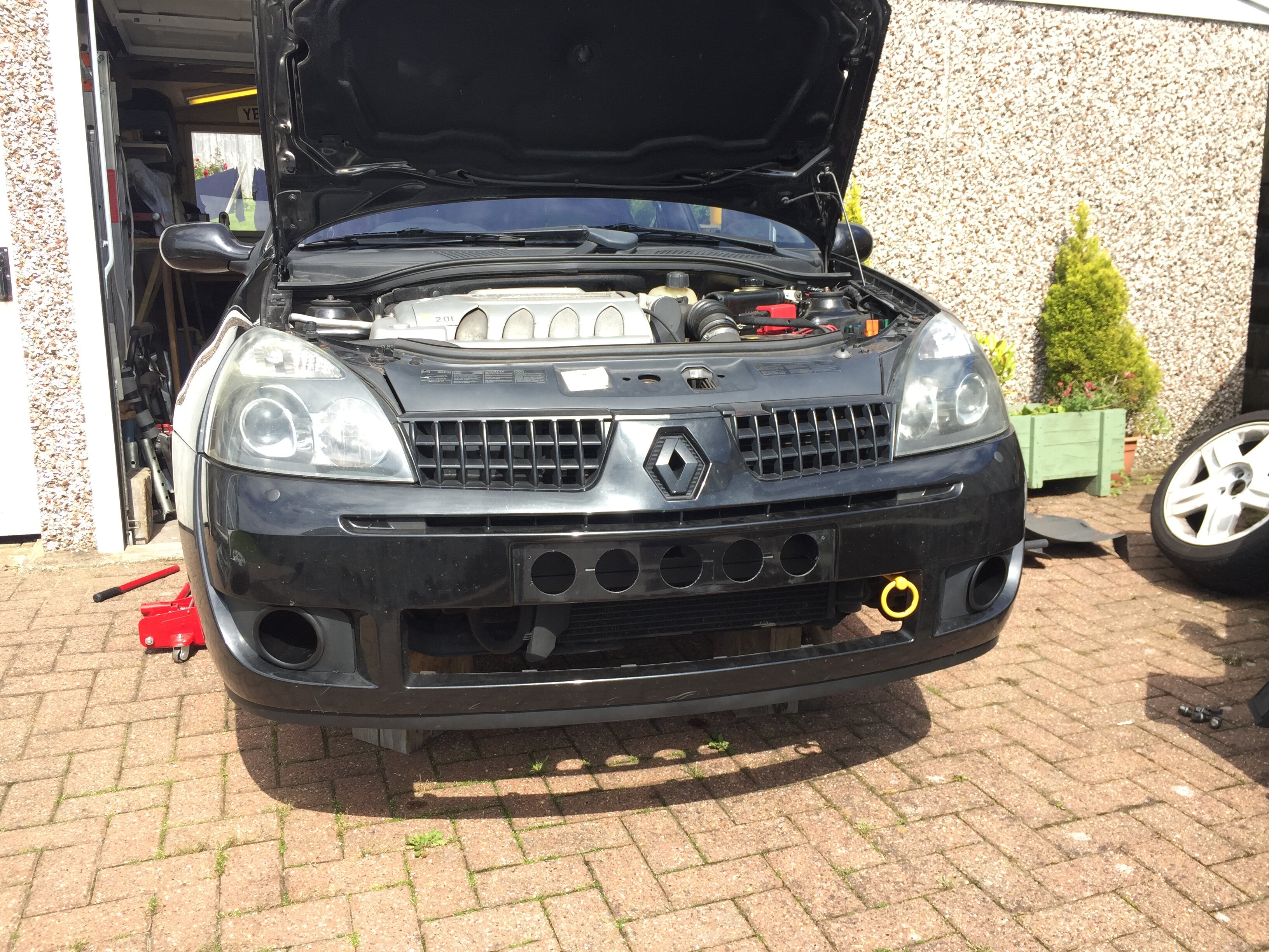

After thinking the grills had faded and tried a few methods to restore their blackness, I realised it was actually painted a graphite grey colour. So, as per my obsession, out came the satin black.
Yes the grills are supposed to come out. No, they didnt want to, and I didnt fancy taking the bumper off.

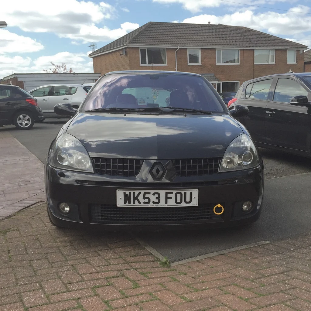

Finished look (Also got my tow loop fitted)

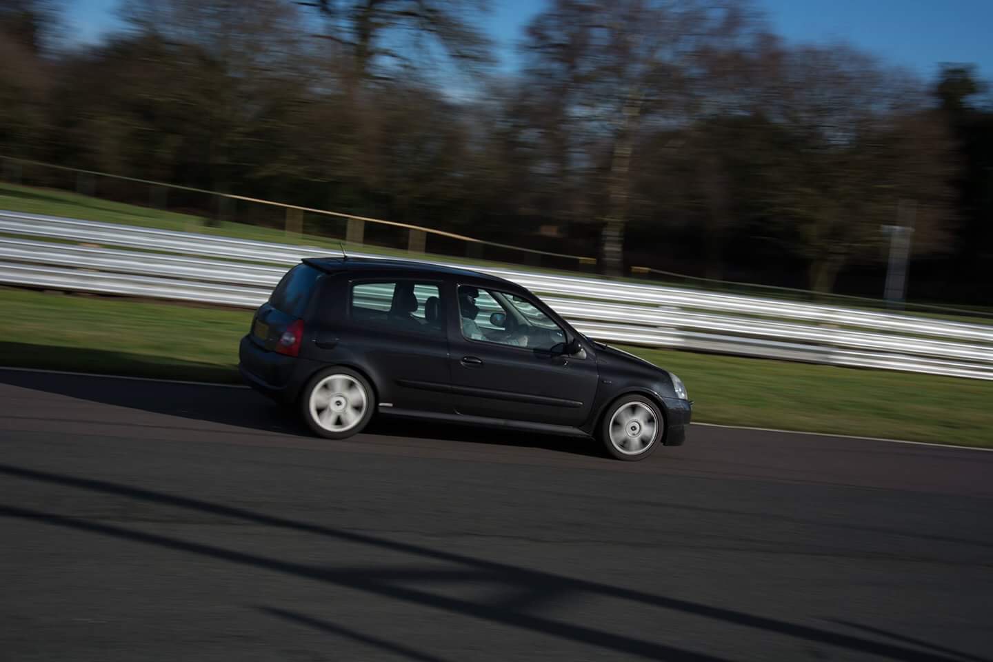

Starting off with no context random shots circa 2017:
Oulton Park

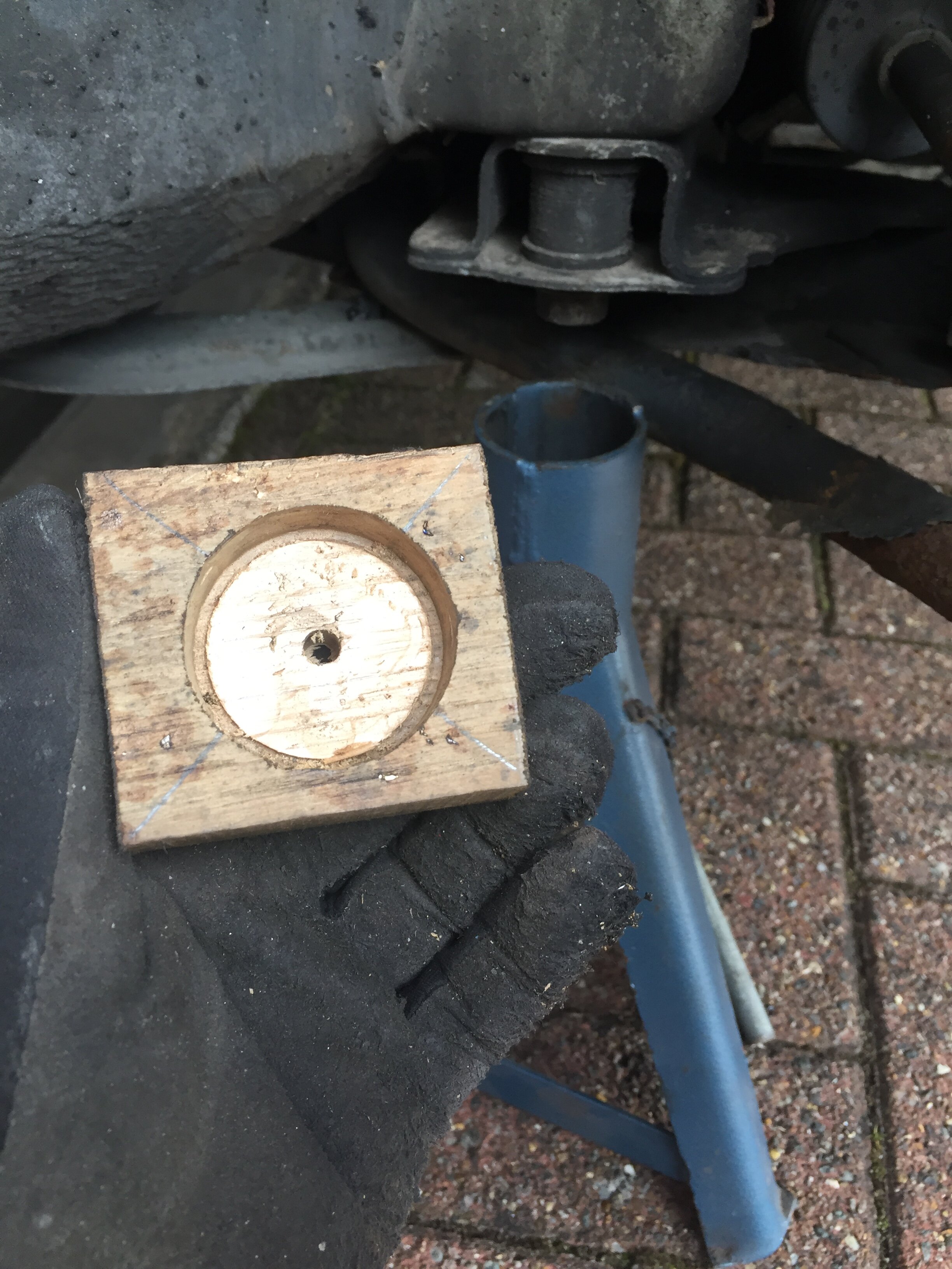

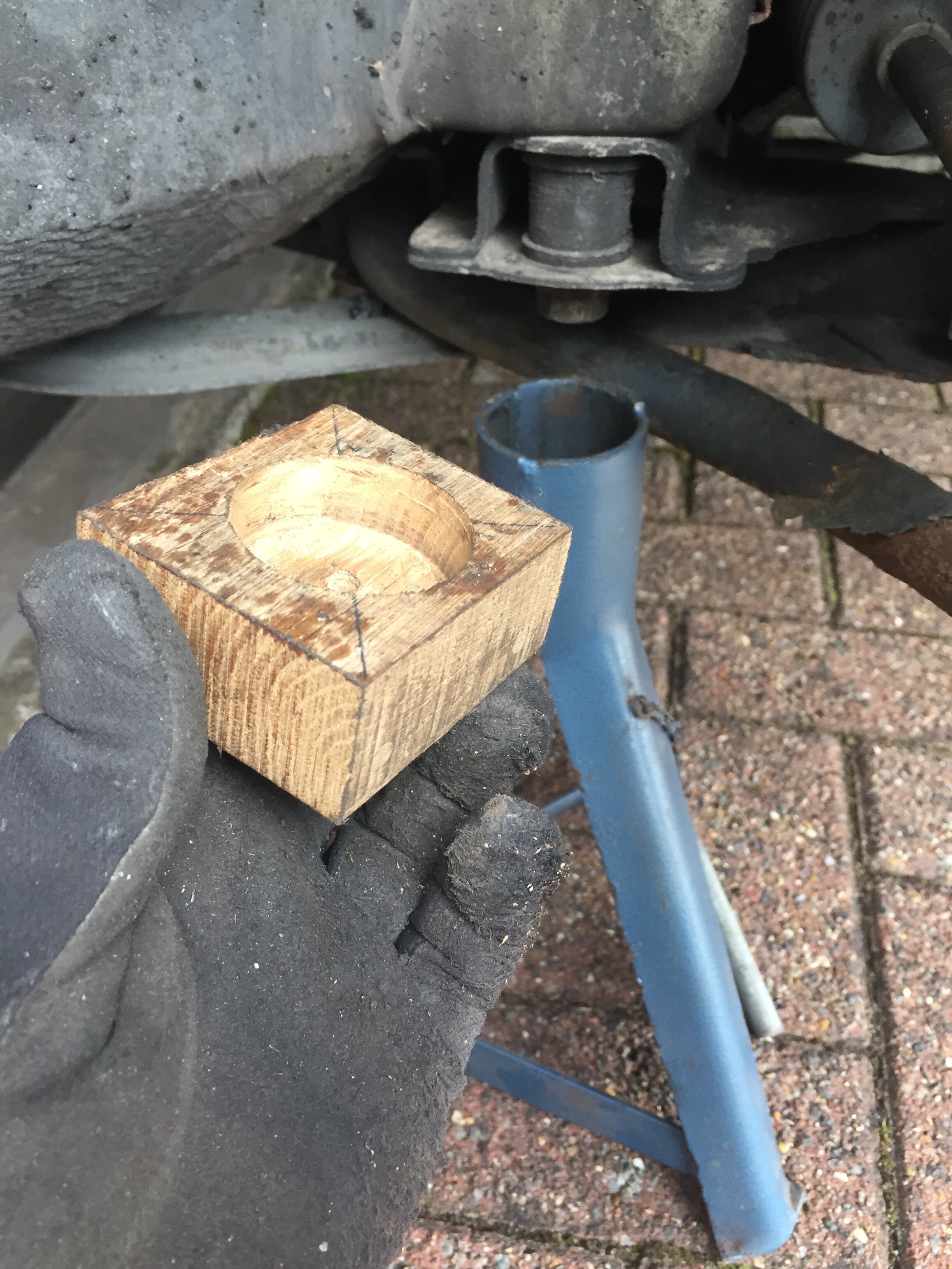

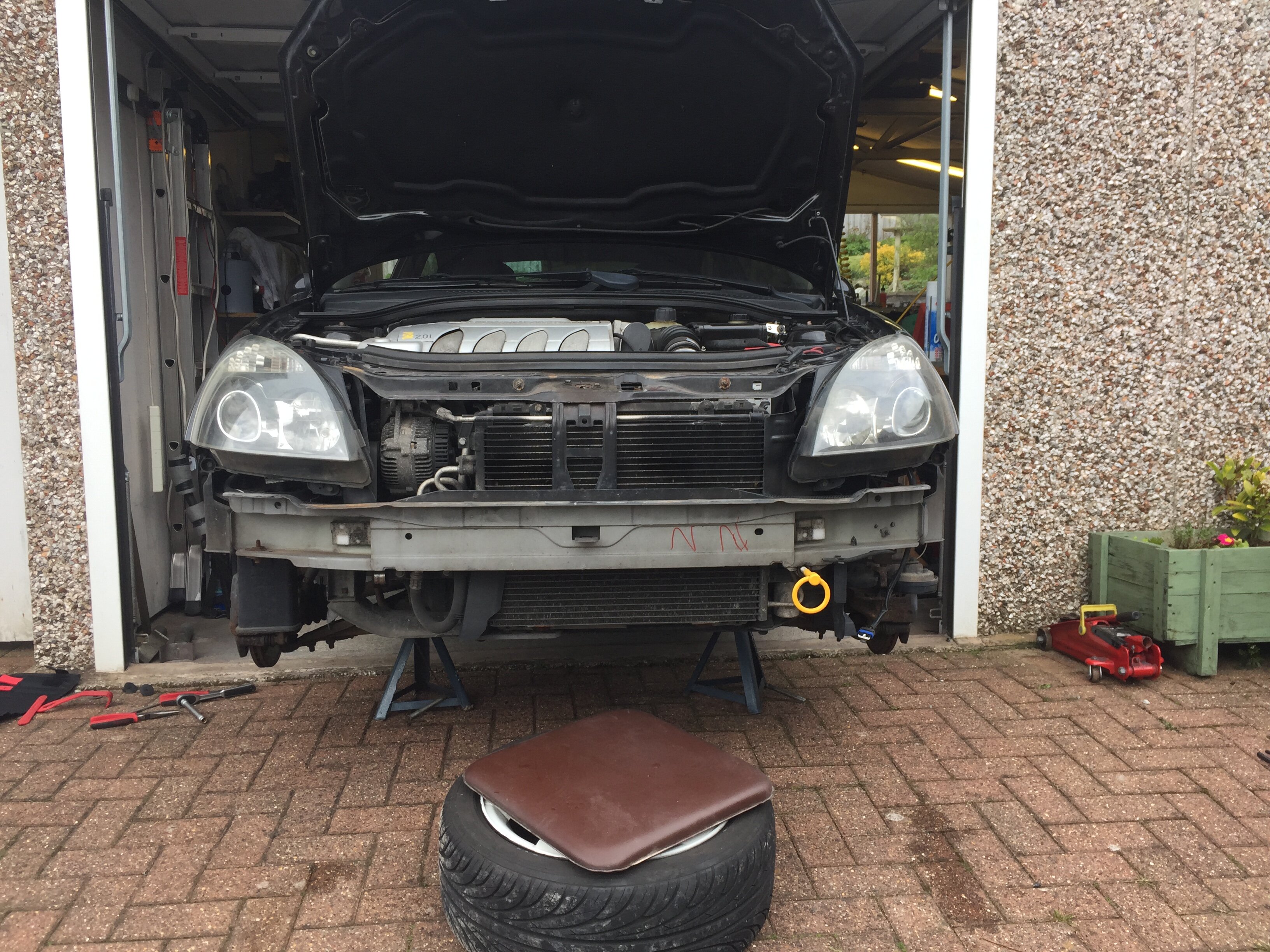

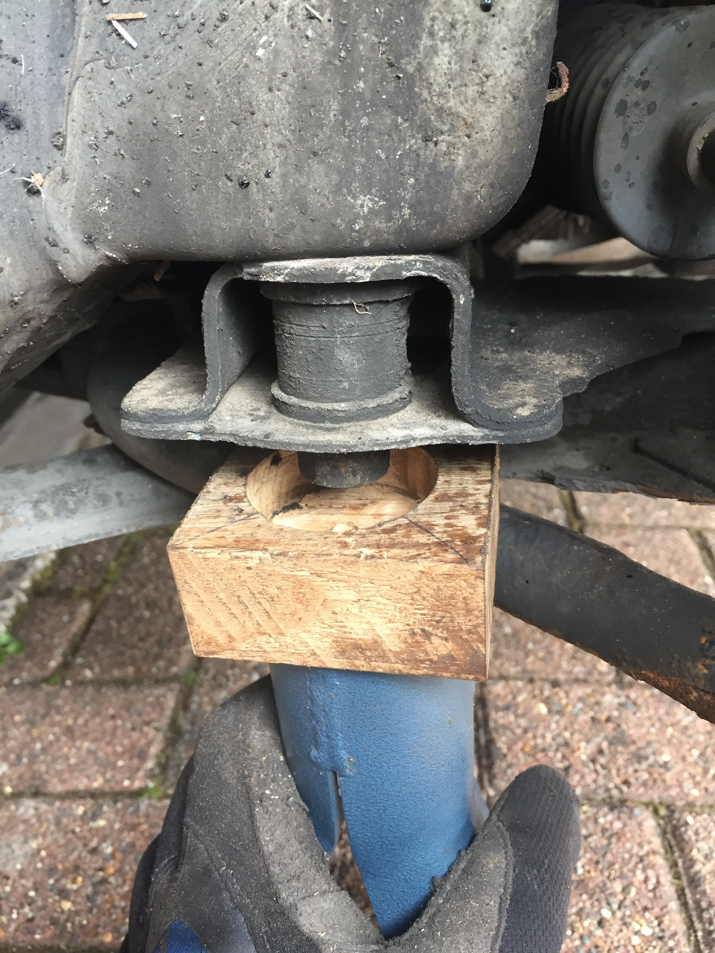

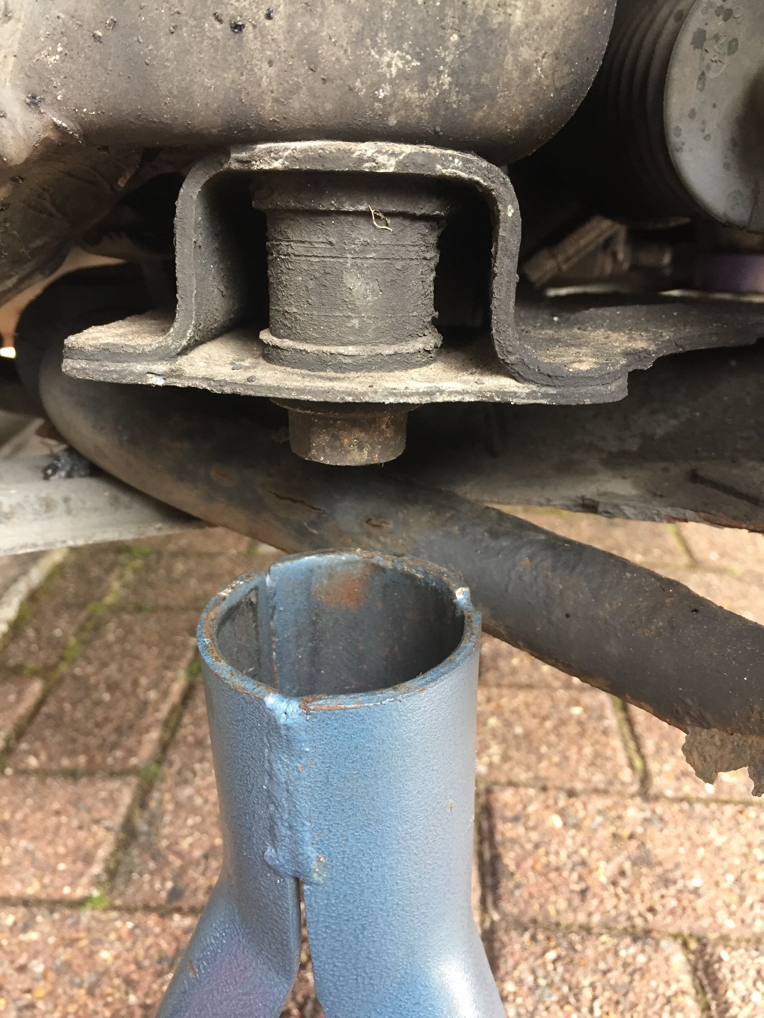

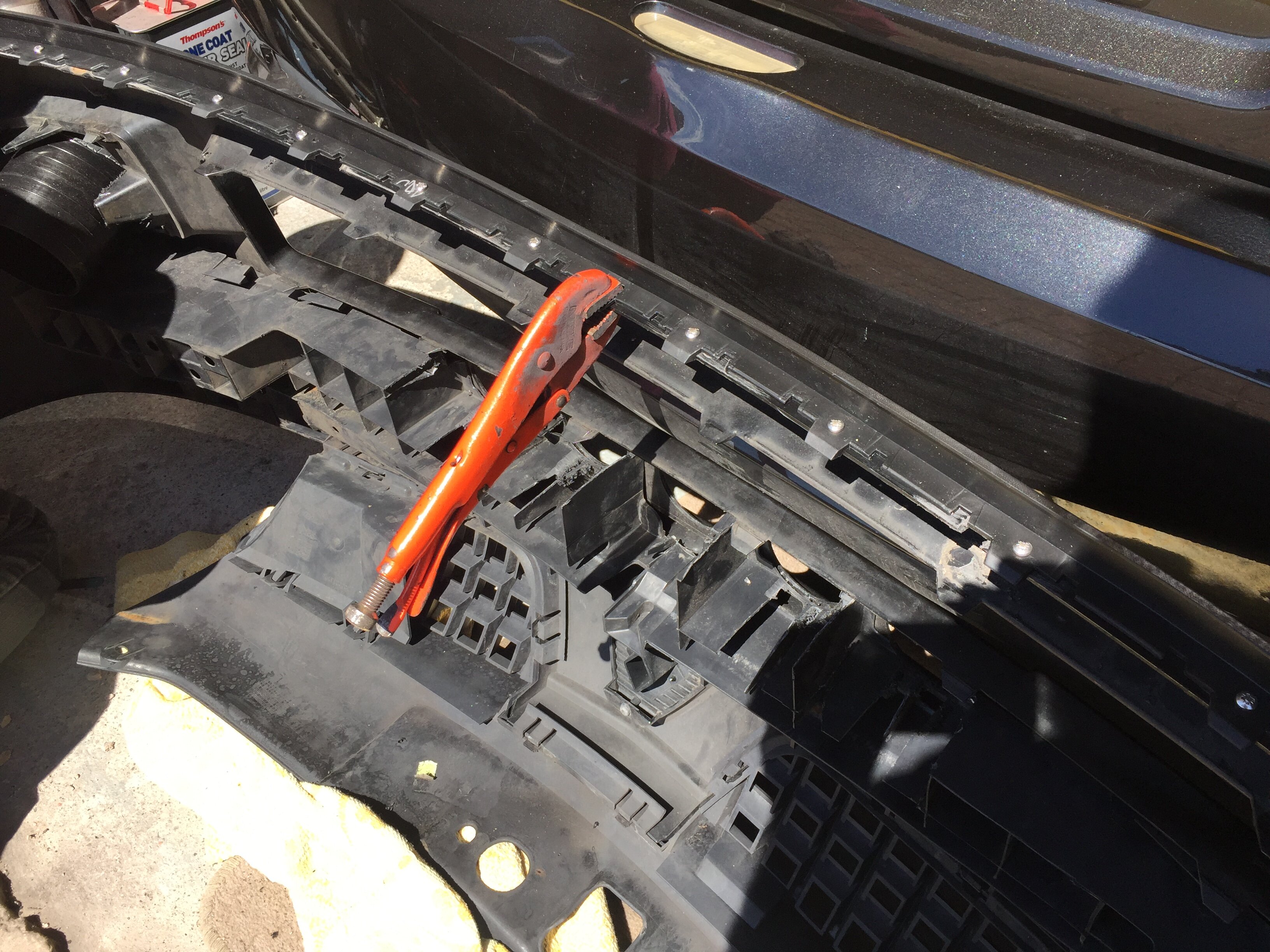

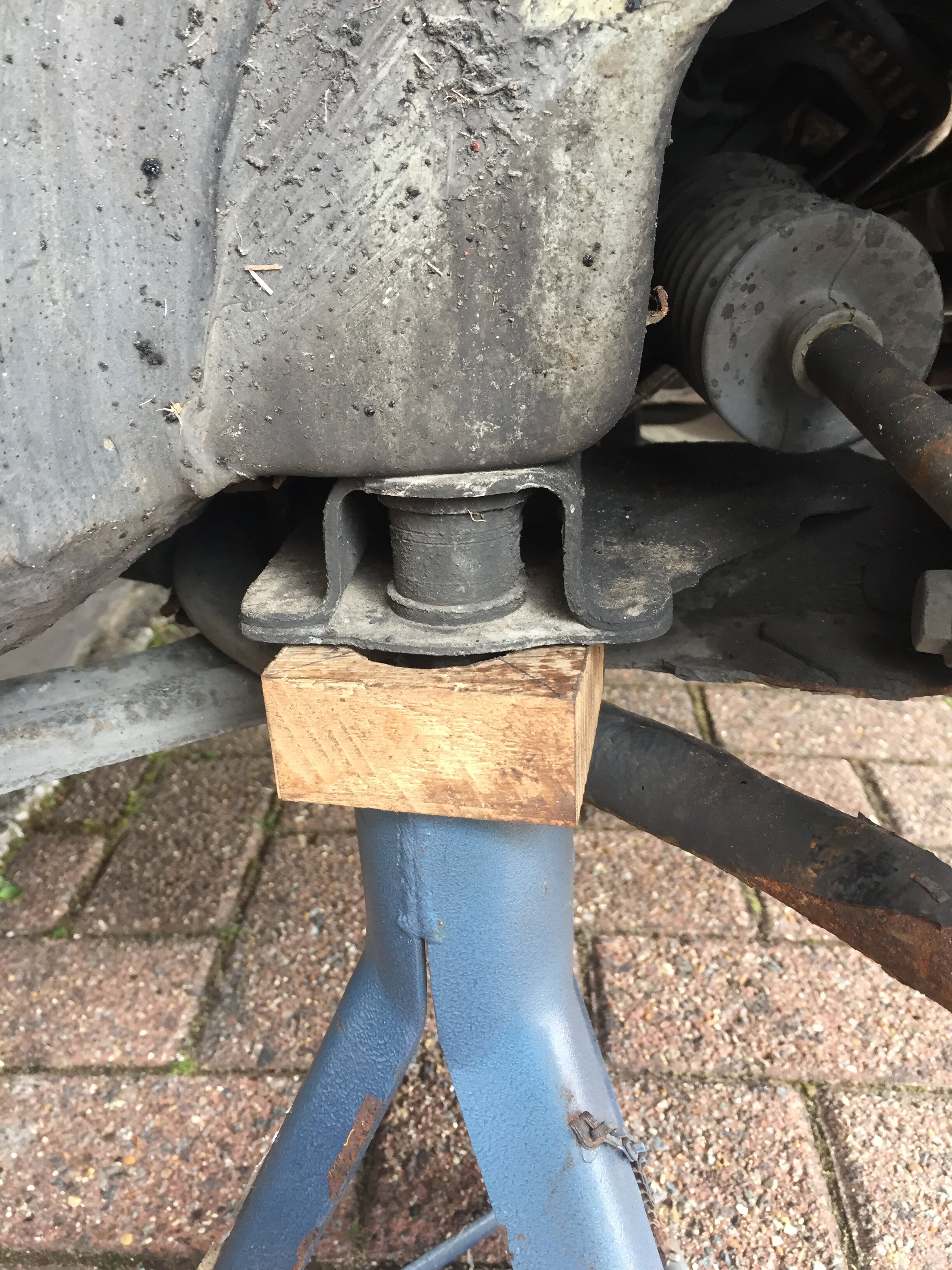

I went through a spell of using axle stands on the subframe to support it, and then realised I could take the axle stand "seat" out of the body so I didn't need to jack it as high (i.e. higher than my jack went, so had to use two and blocks of wood).
Neatly fits there! But then I wasn't sure about forces, weight distribution on the lip of the jack stand etc...
So did a bodge:
Pretty much pointless, but made me feel better about not having the weight of the car on the head of that bolt, or on one side of the jack stand tube.

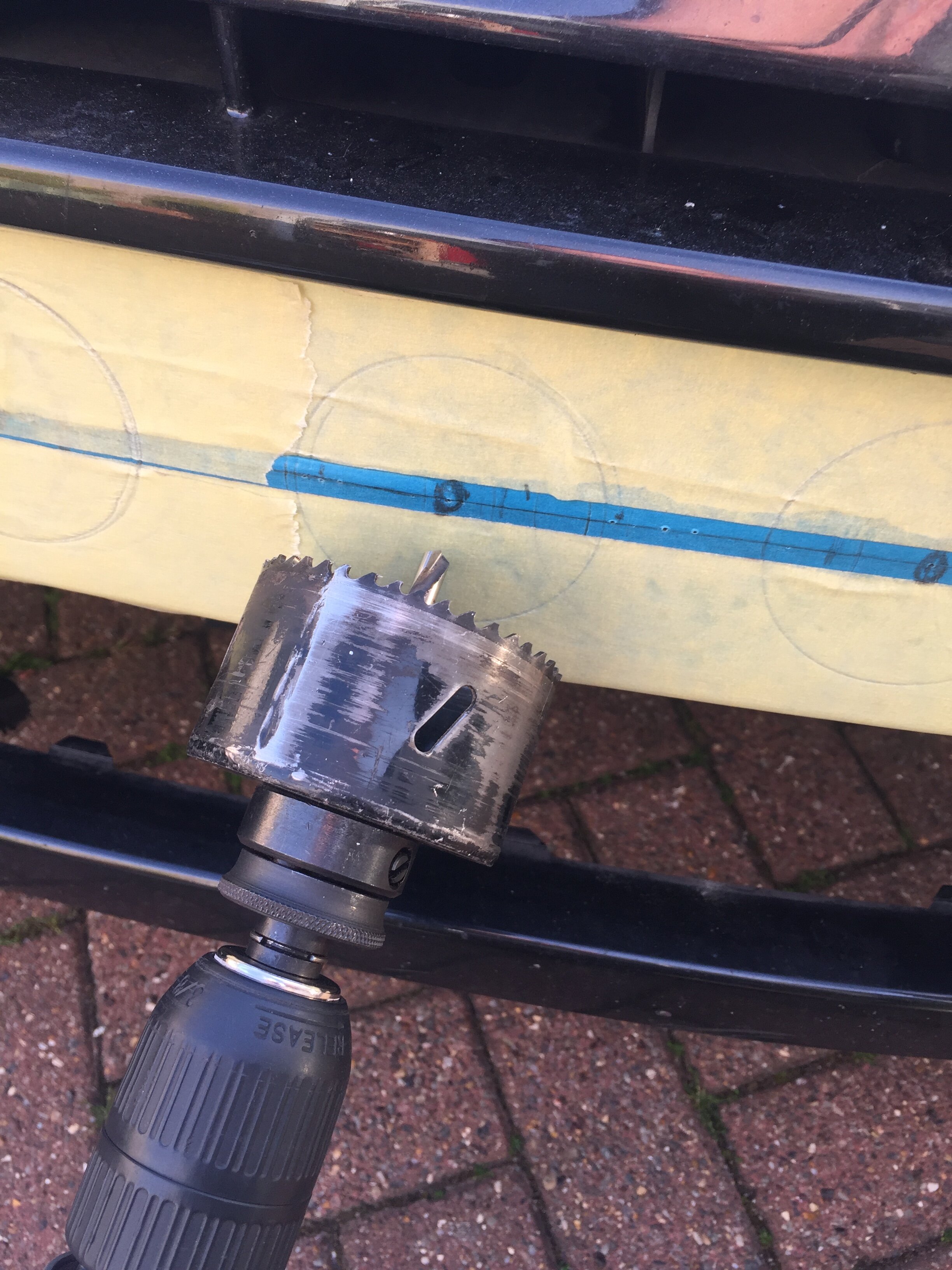

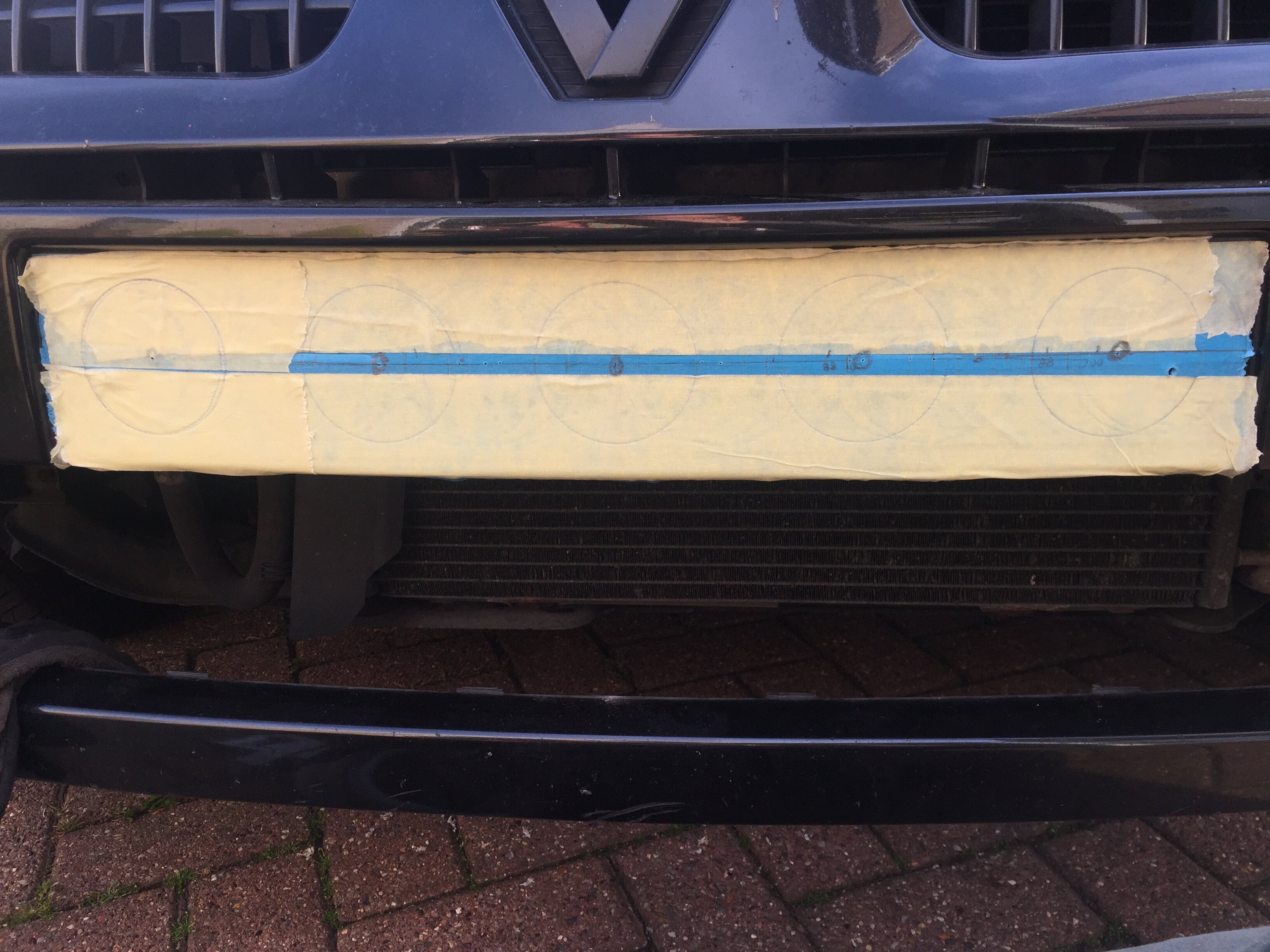

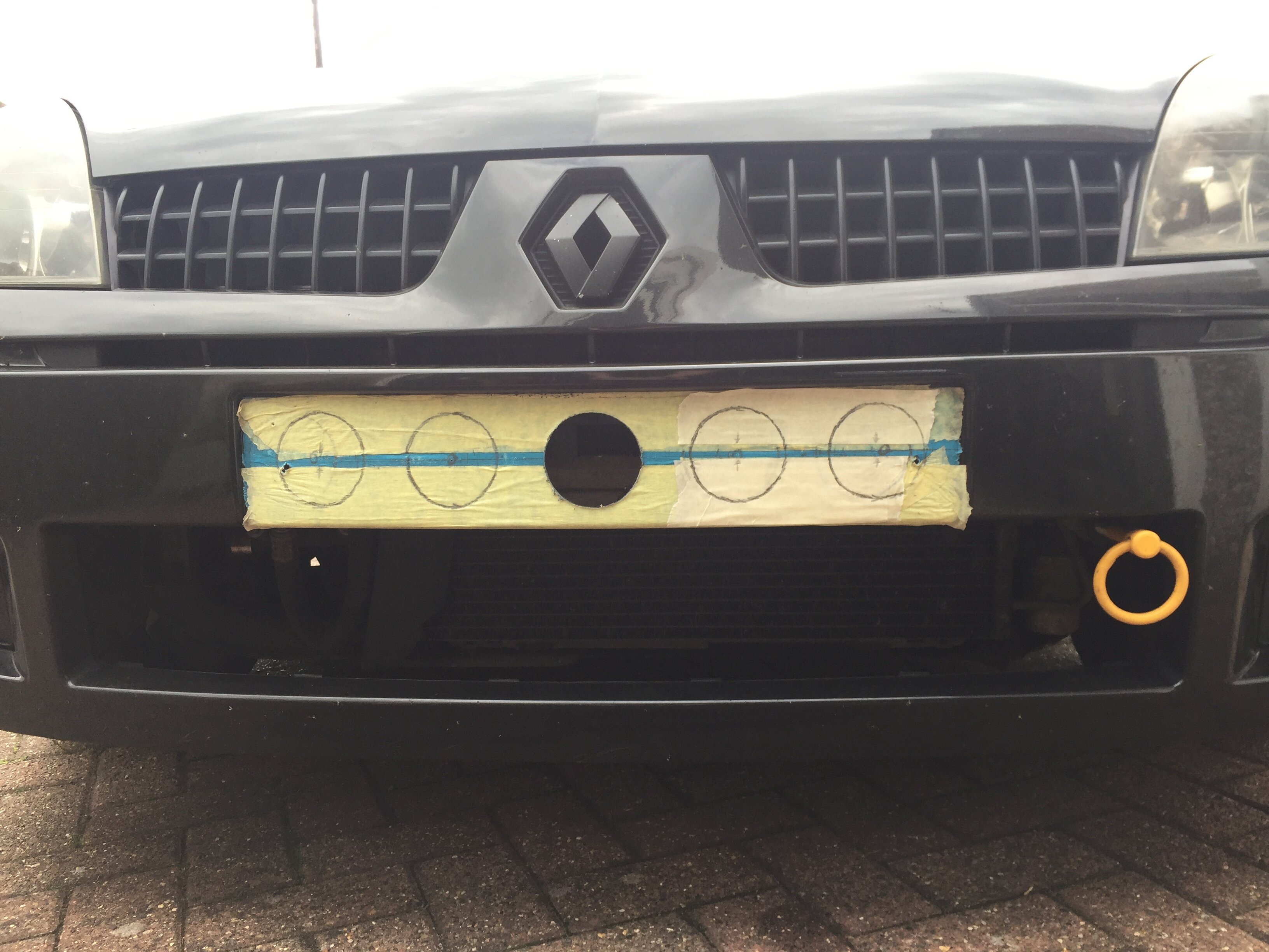

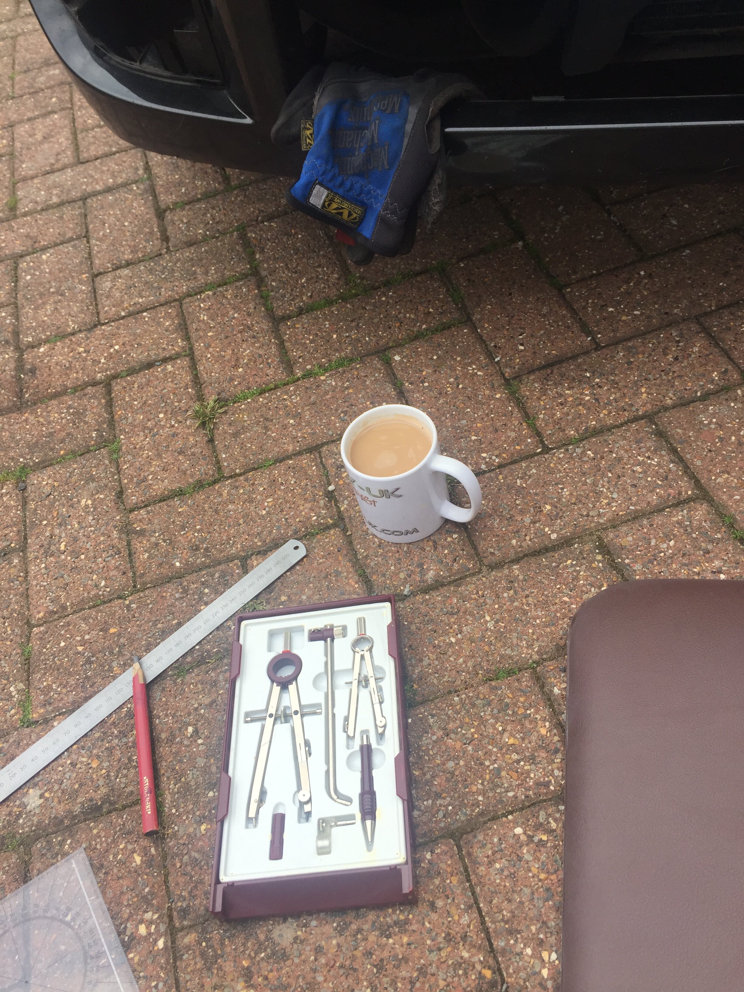

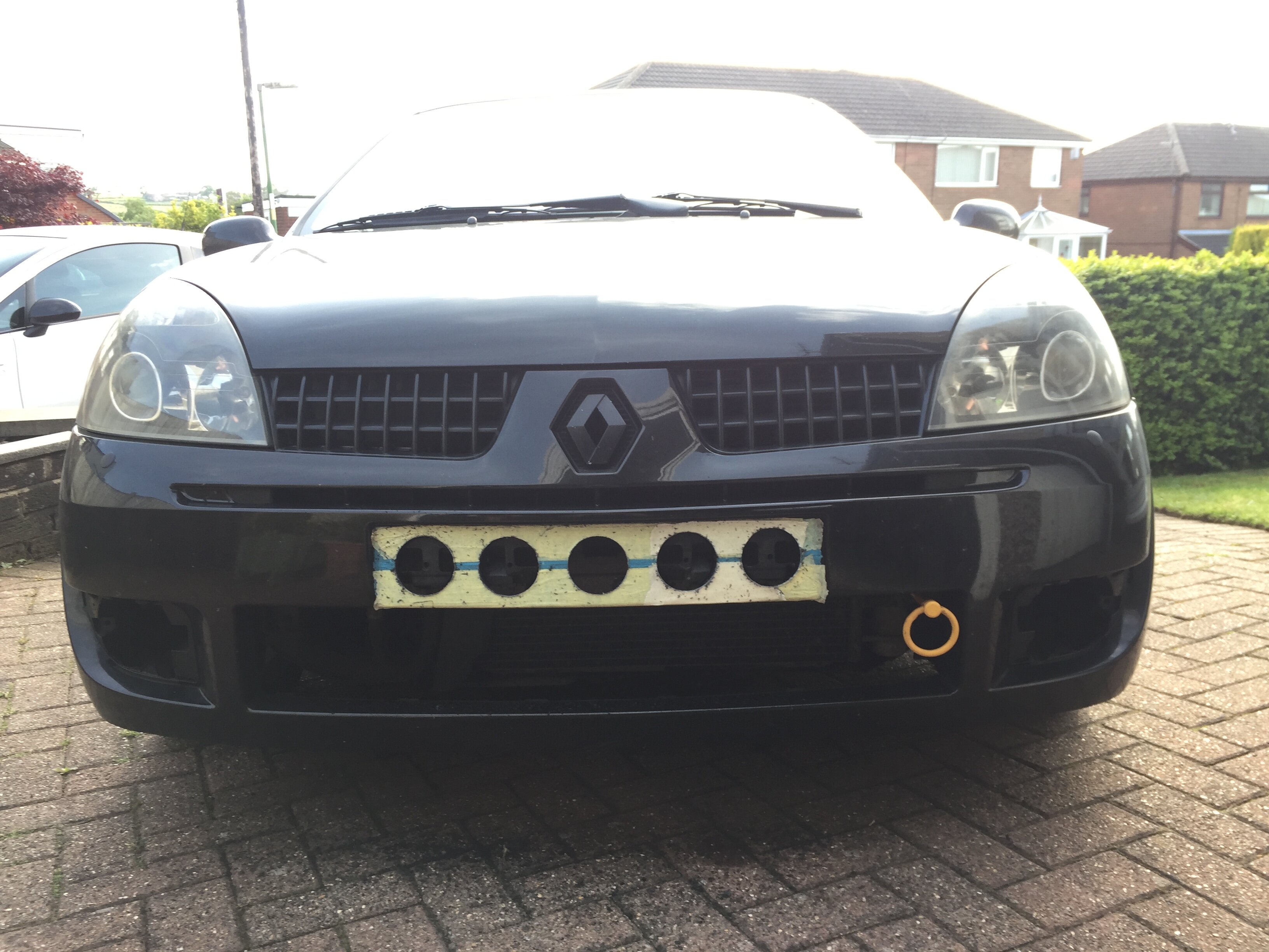

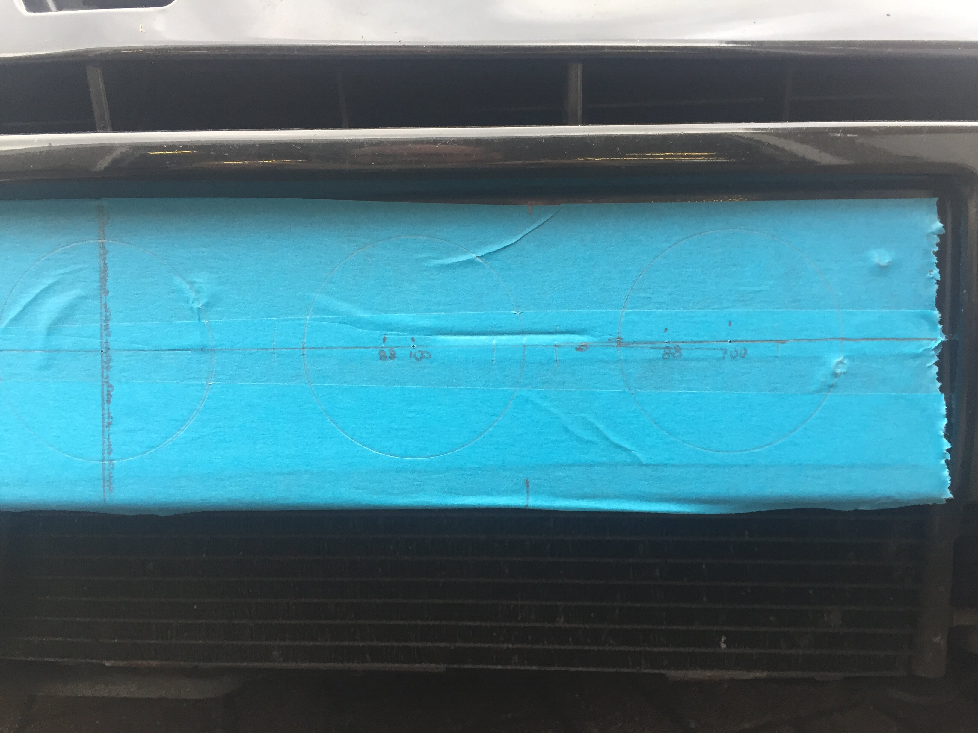

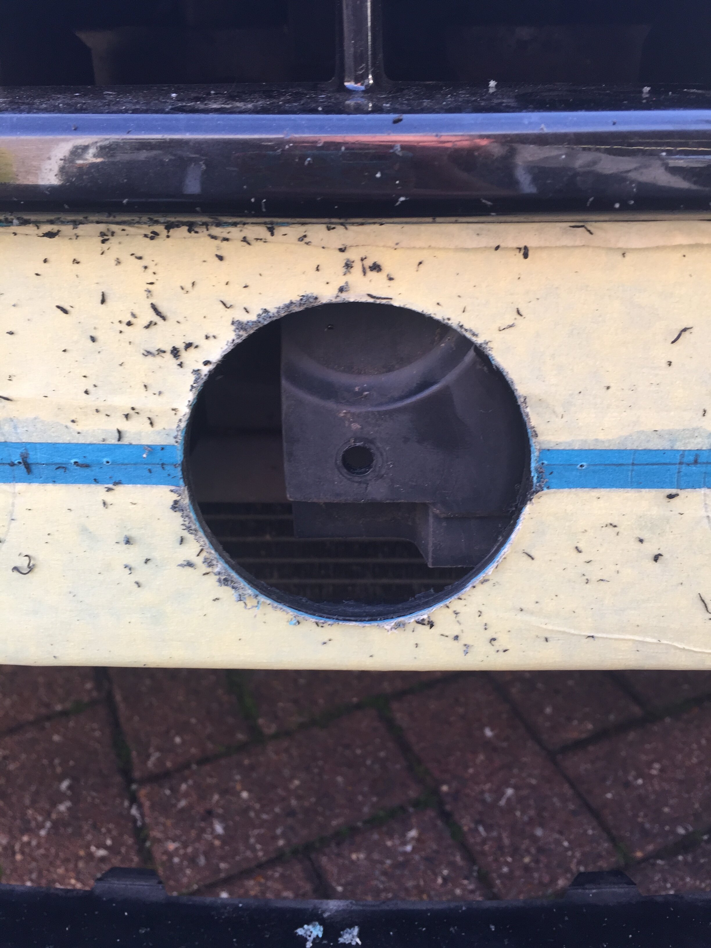

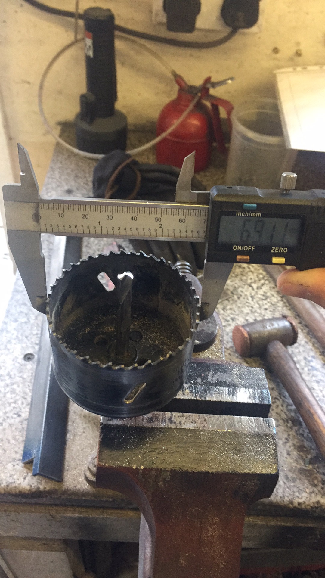

Measure twice cut once and all that shite. Getting the school tools out again!

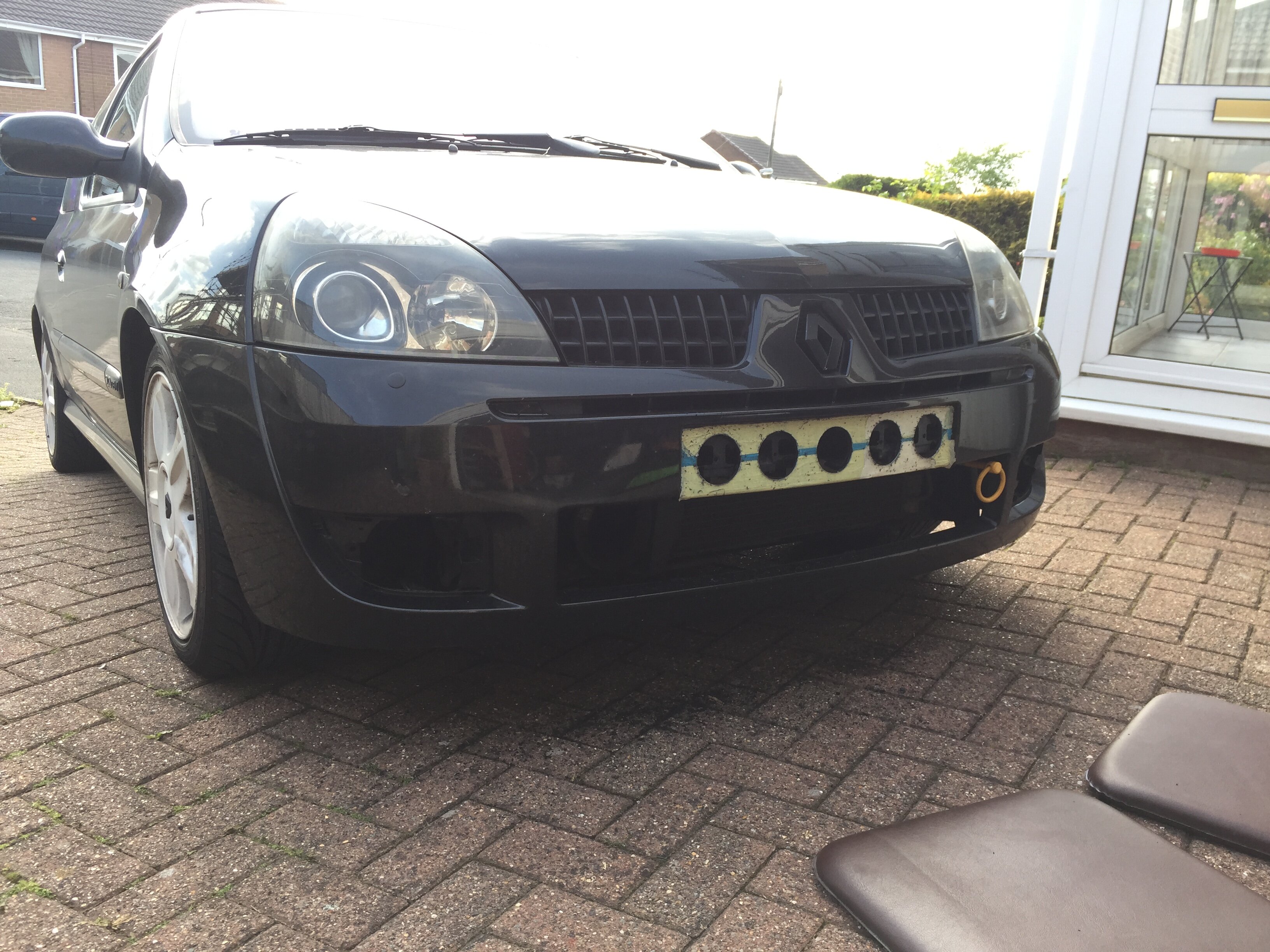

Basically was trying to figure out what size holesaw to attack the bumper with!
Trying to cut out the numberplate screw holes as well! Two birds with one stone...

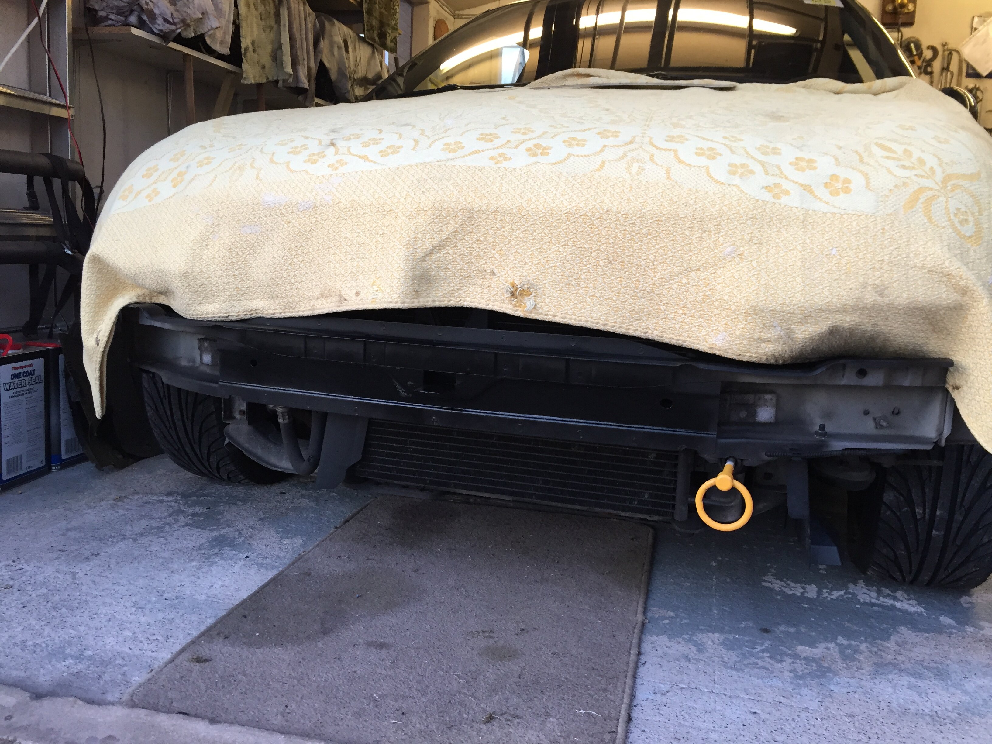

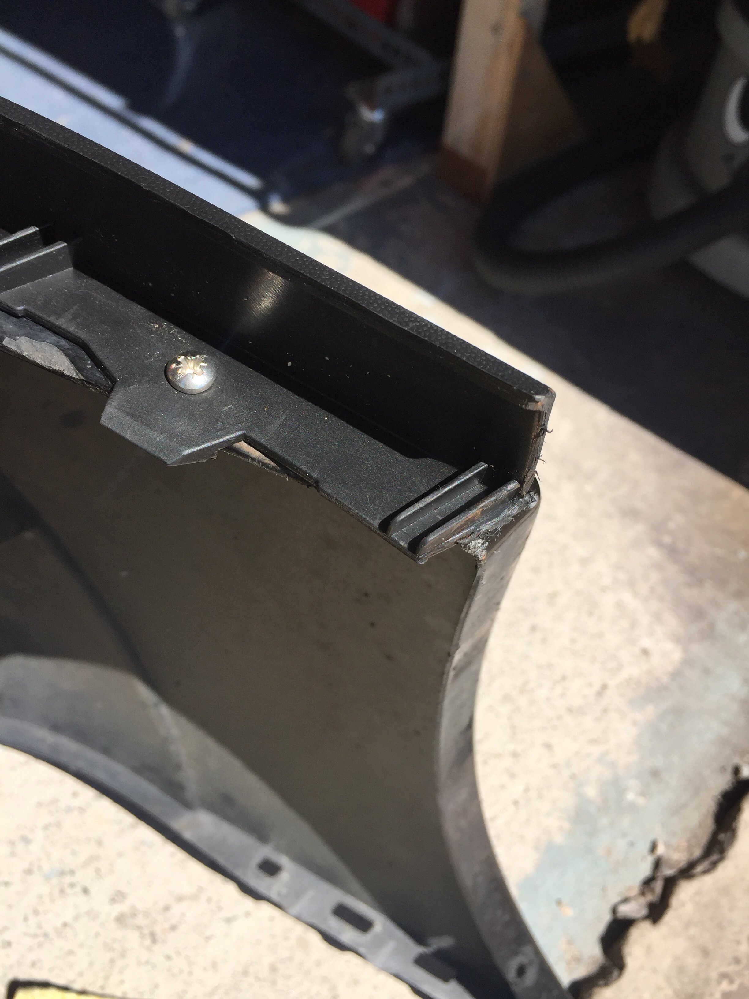

The Skoda Fabia splitter seemed like a correct choice, seeing as I'd be smashing it off the drive most of the time.
The paint dried on the crasher (like that's important lol)

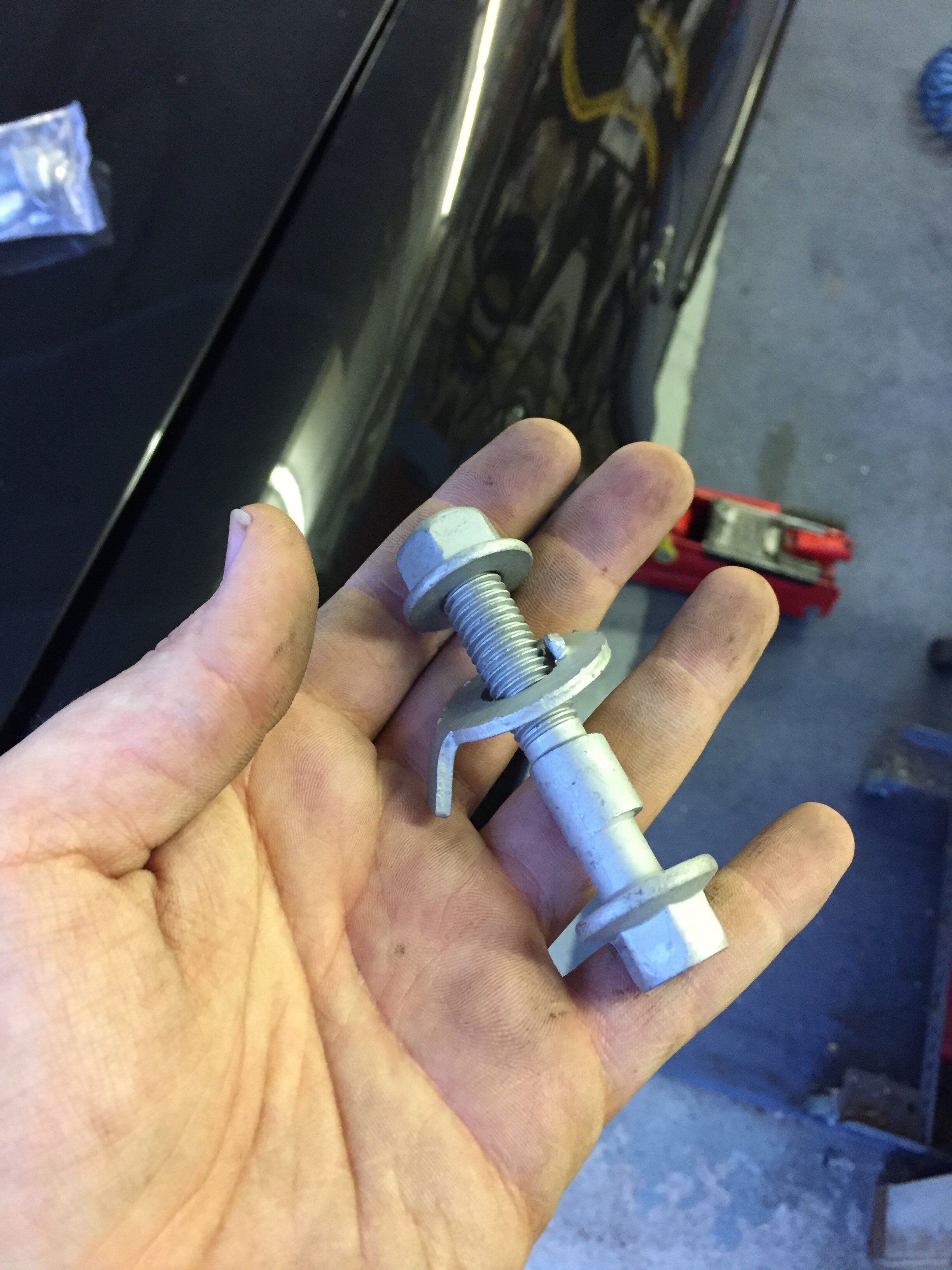

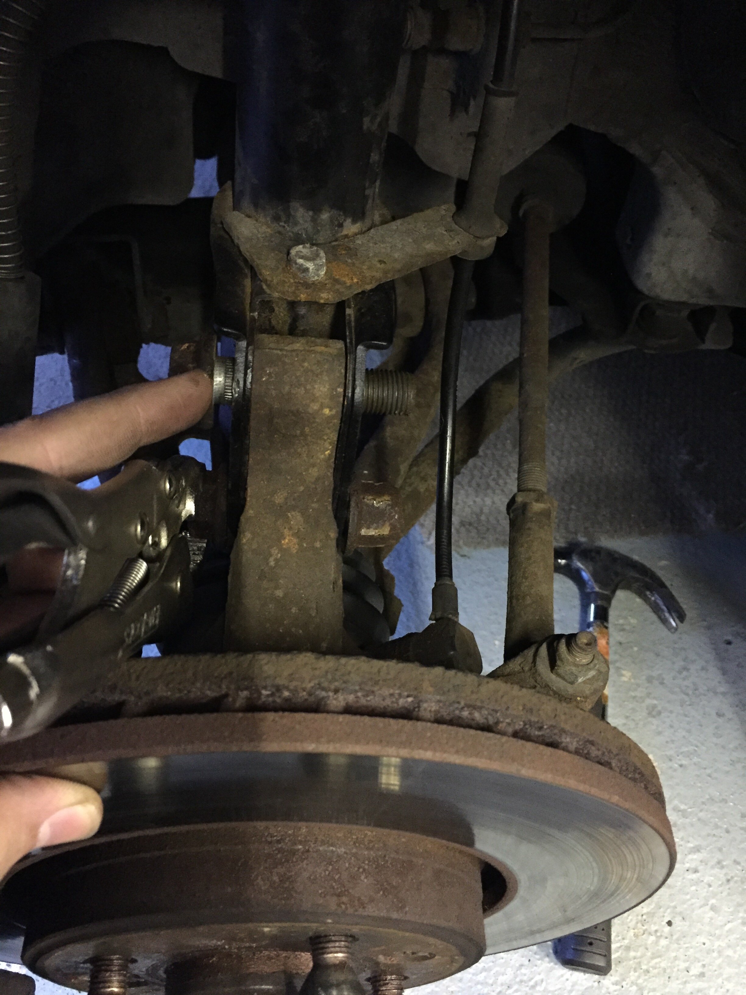

Still in 2017, I decided to do a functional mod!

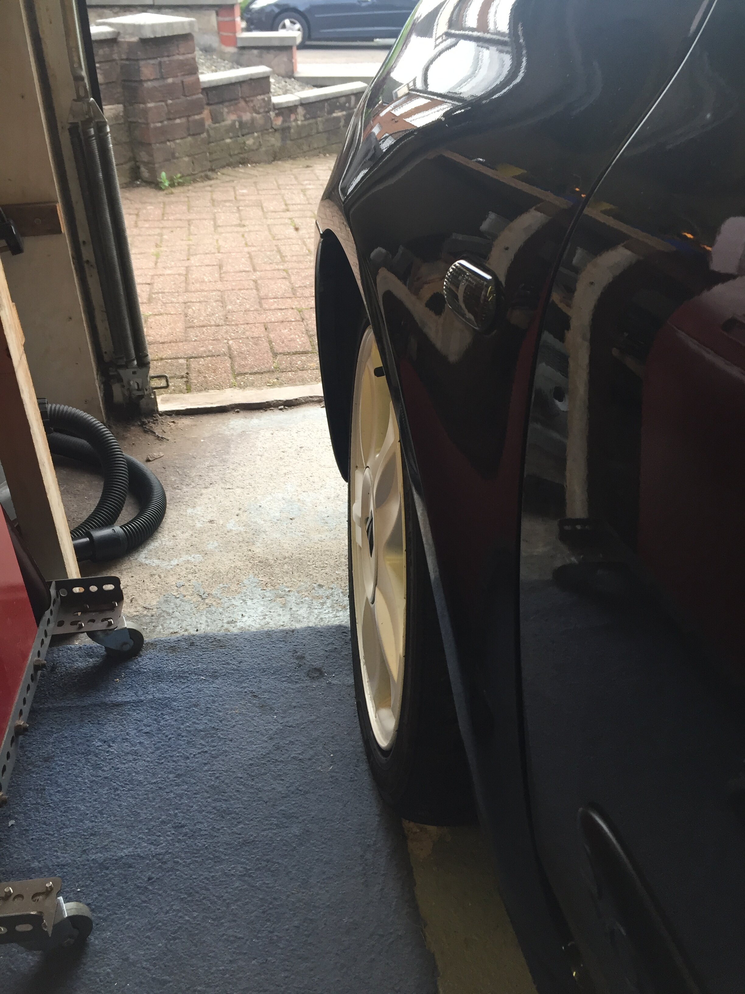

Good old Eibach camber bolts!
Subsequently adjusted to offer all the camber
JimF
  Clio 172
It drove fantastically like this, but did like to snatch the wheel out of your hands over uneven ground/potholes. I did a couple of Sunday B-road blasts with friends with it like this, then my daily got crashed into so the camber had to get set back to more normal settings.
