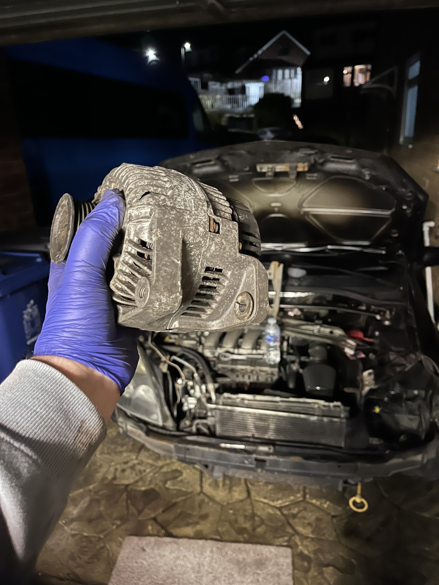

6) Remove, repair, and subsequently refit alternator.
That was this weekend's job!

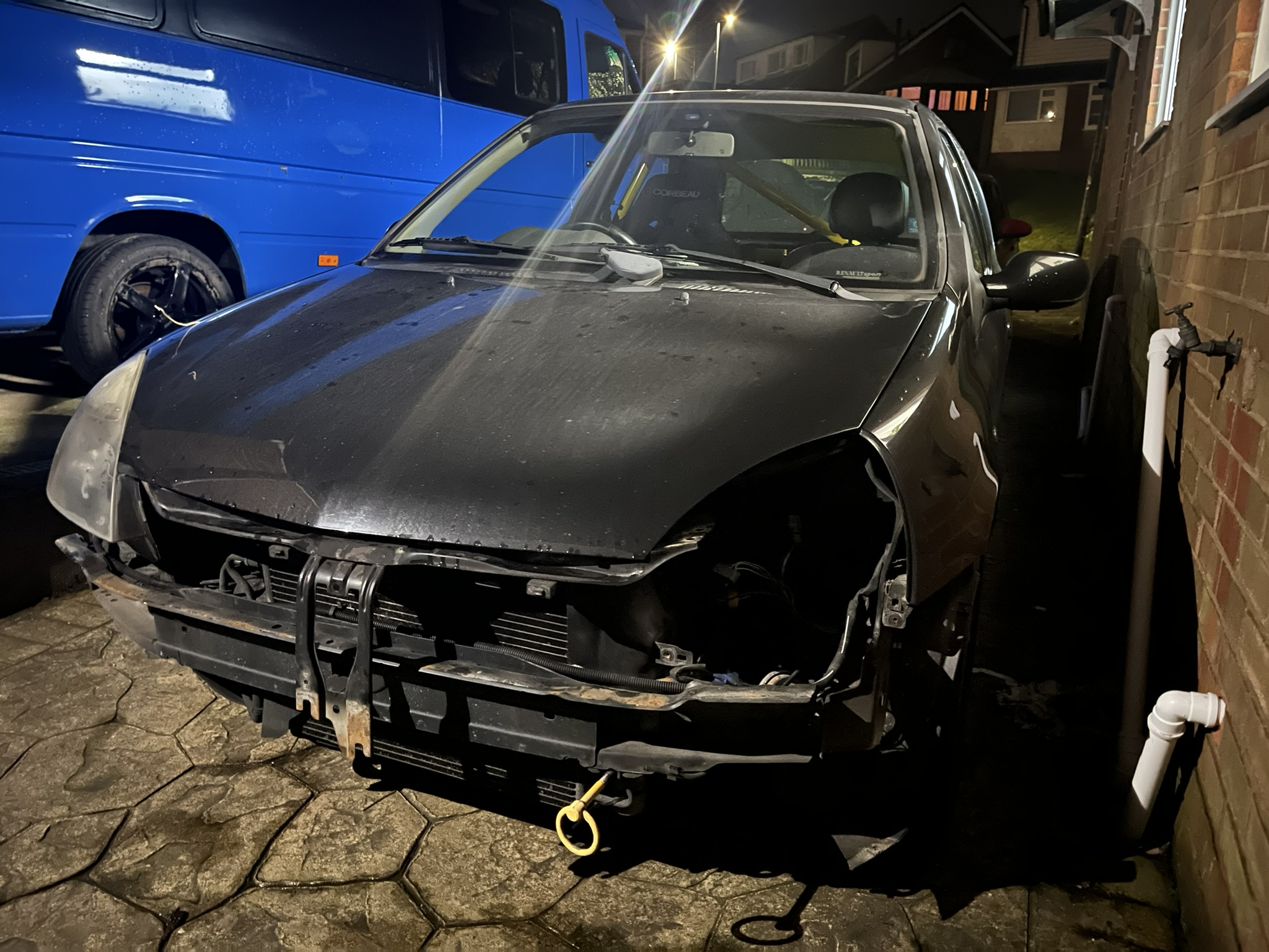

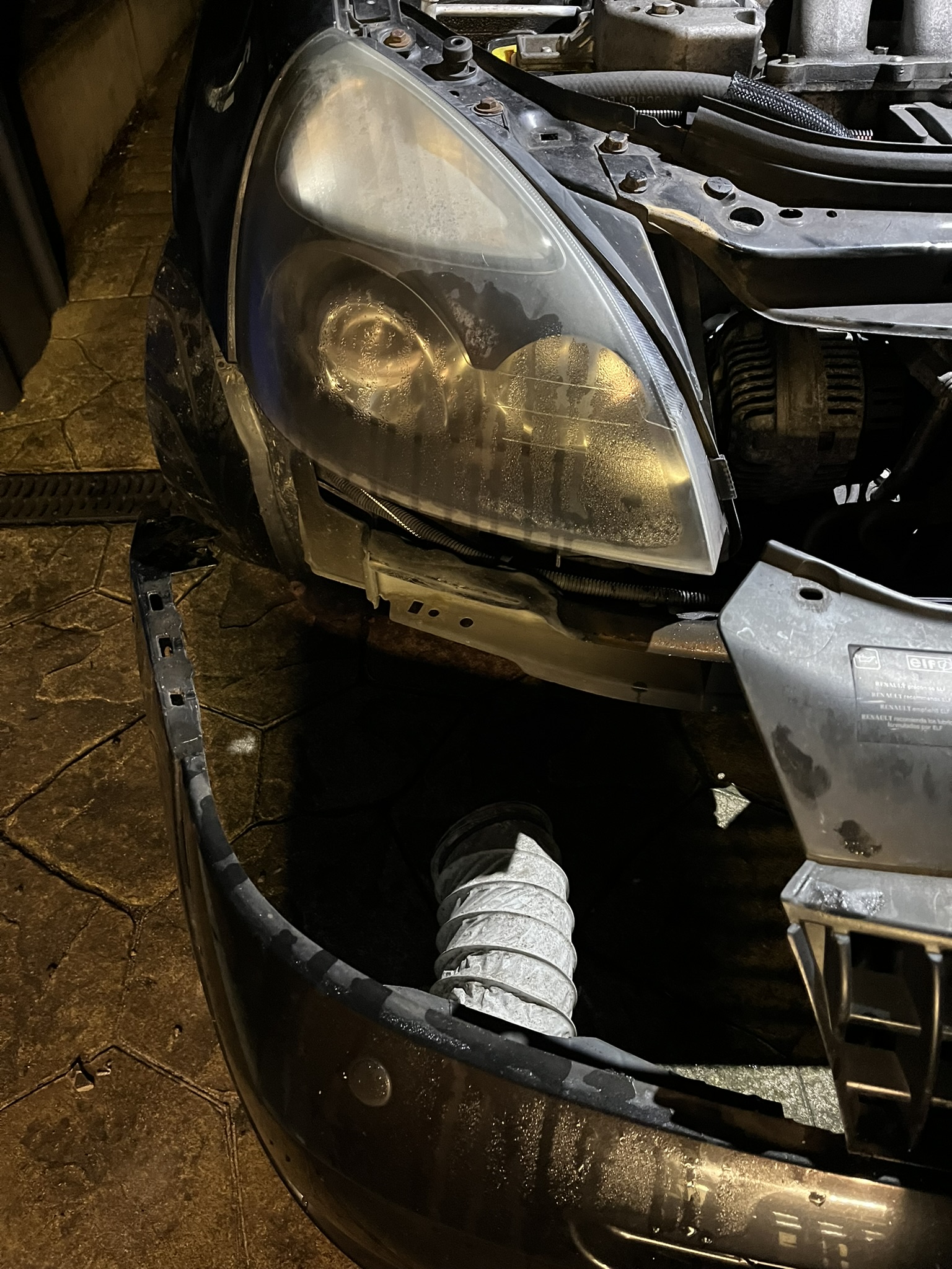

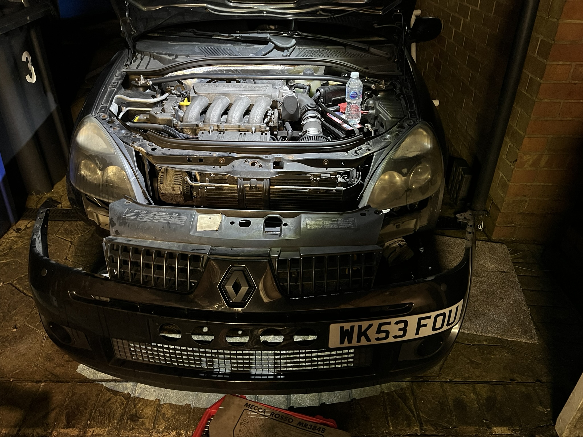

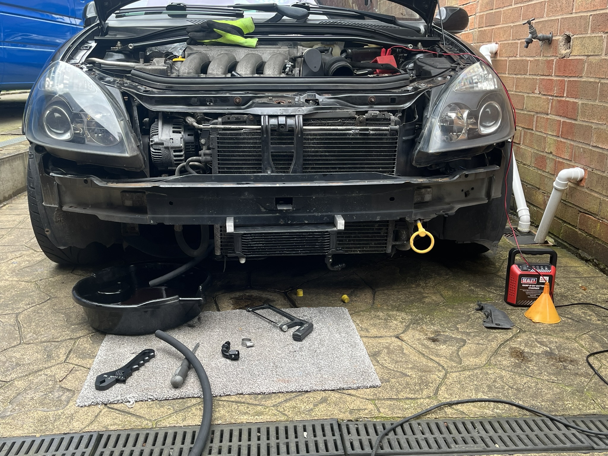

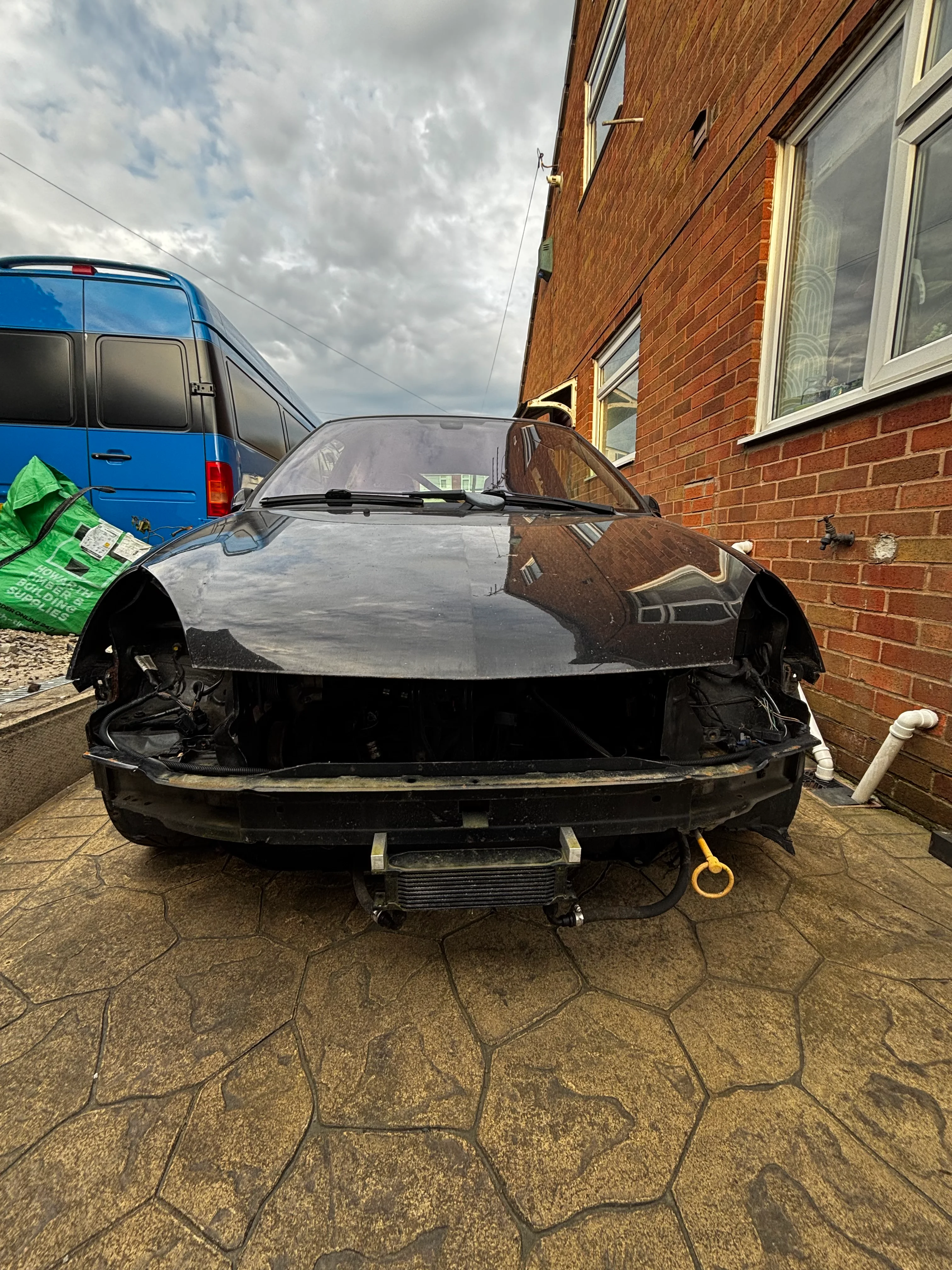

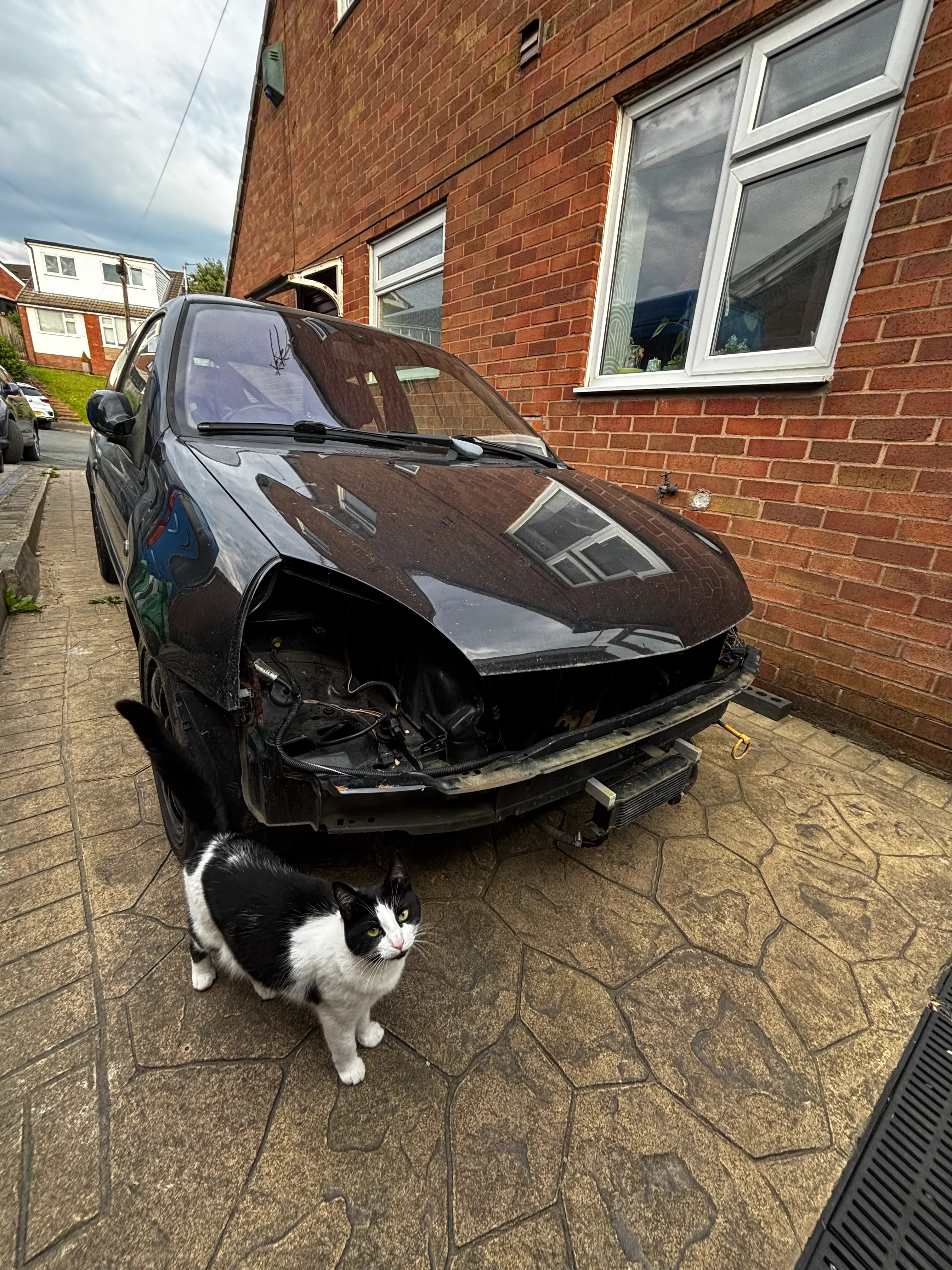

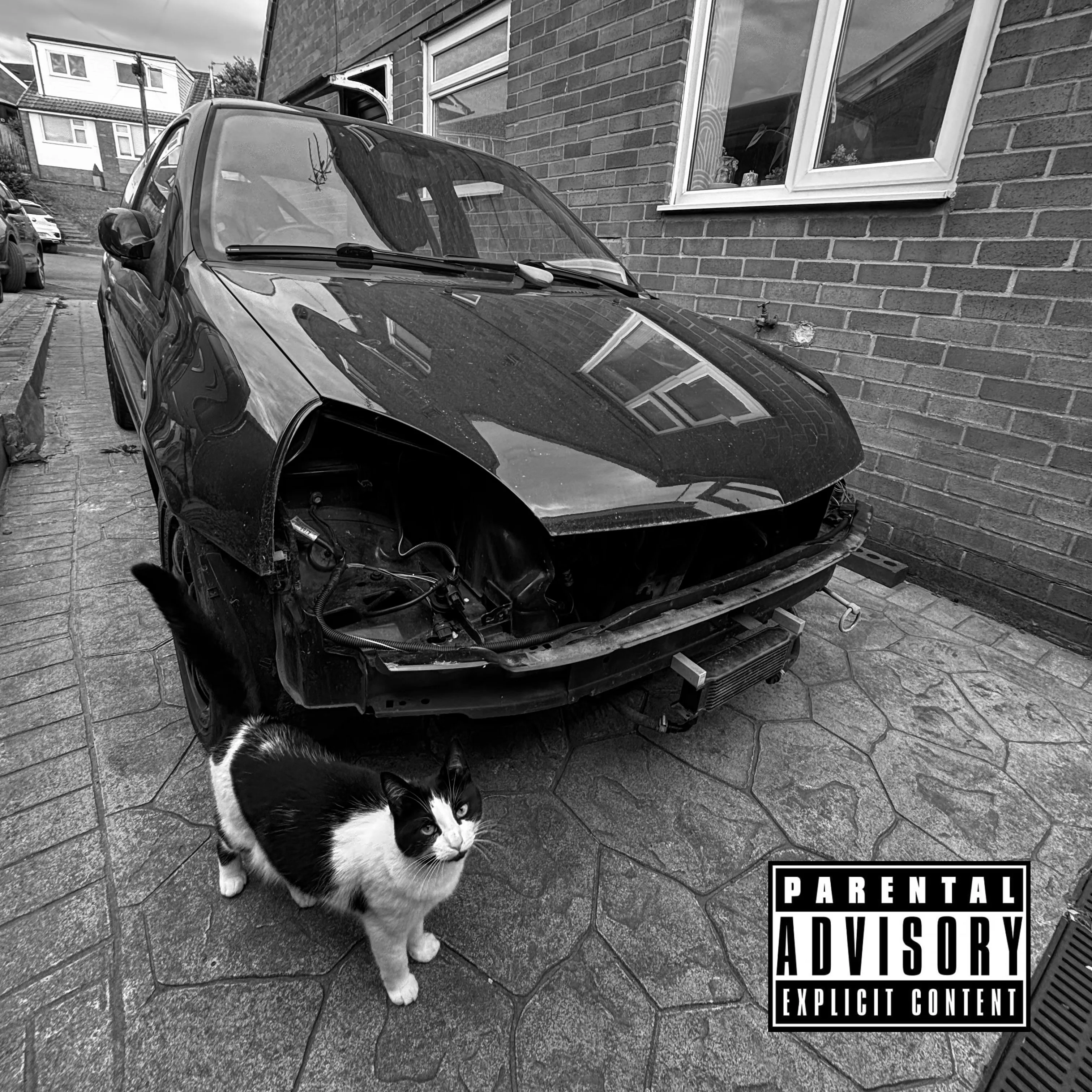

Still get kinda surprised when I remember I own a house. A work in progress, but got a shot of the other work in progress at the same time!

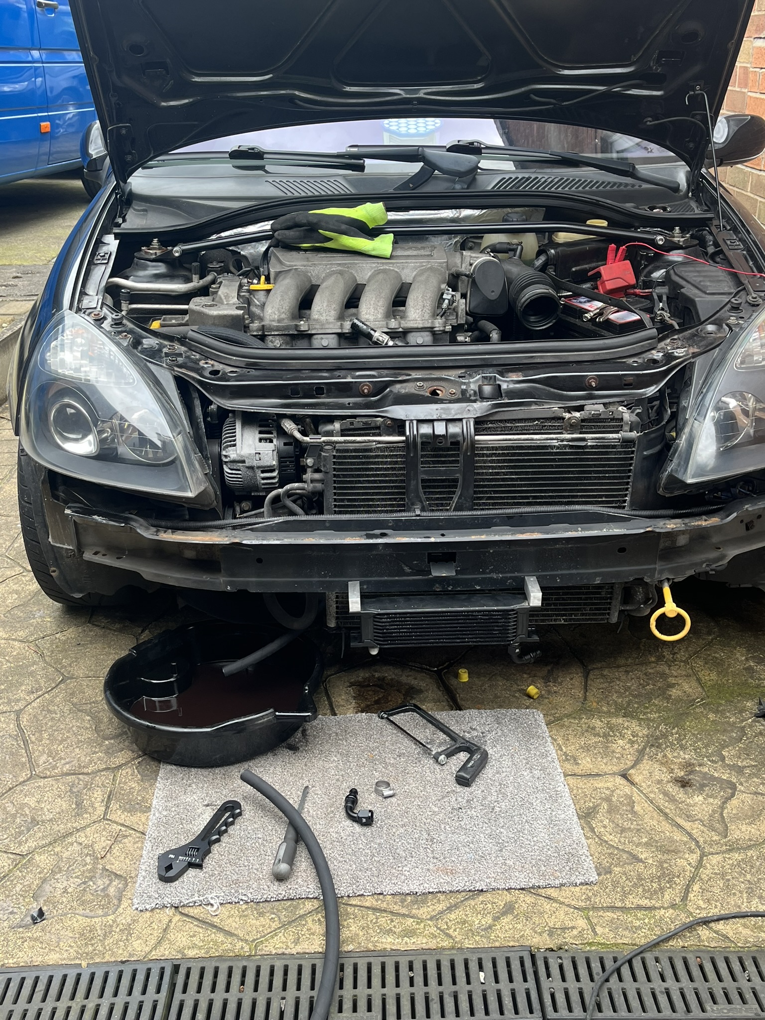

Bumper off!
Closeup of my tumble dryer hose bespoke self designed brake ducts

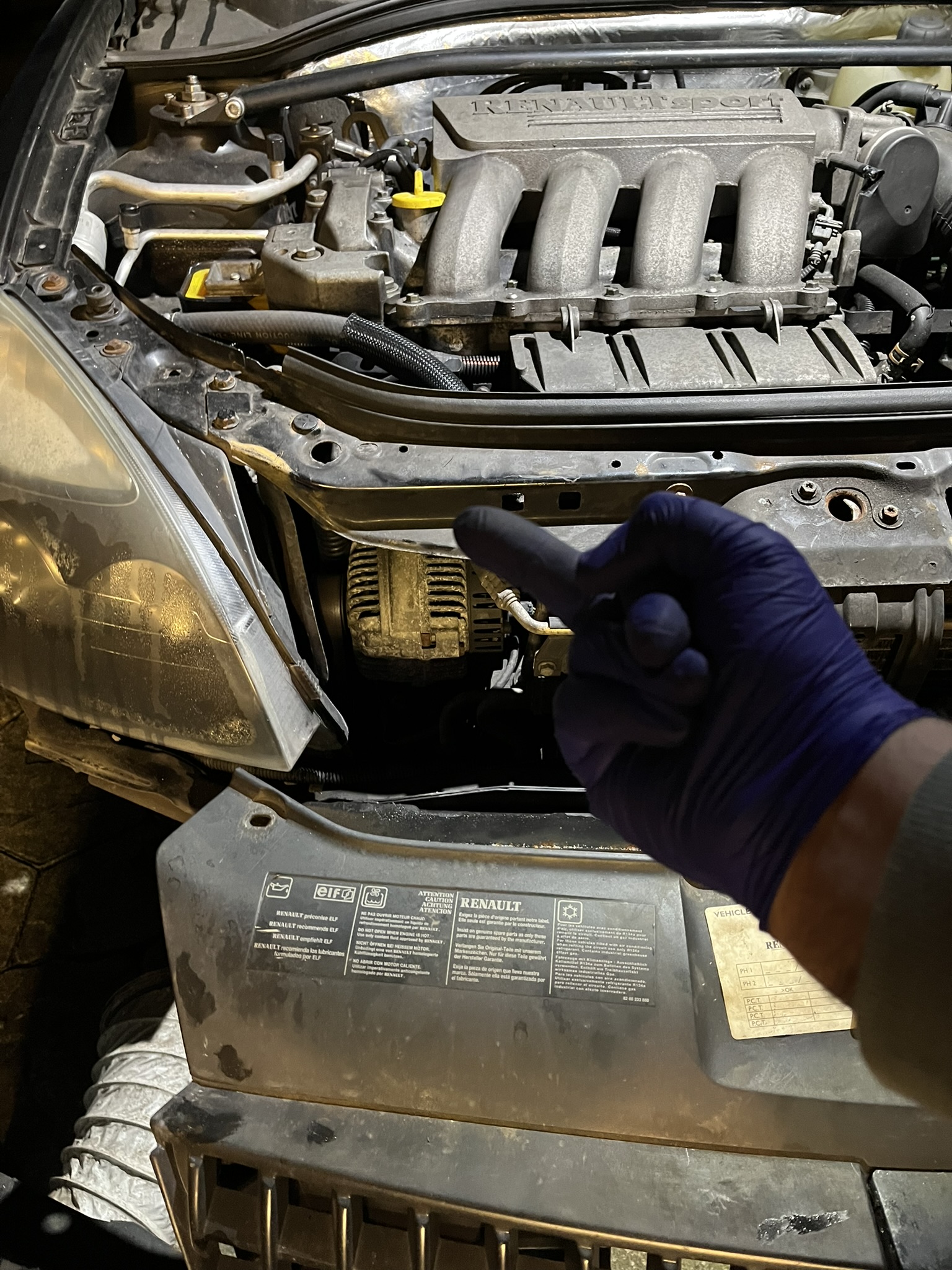

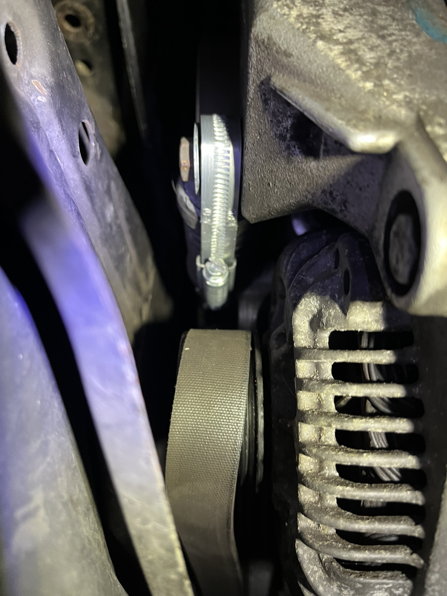

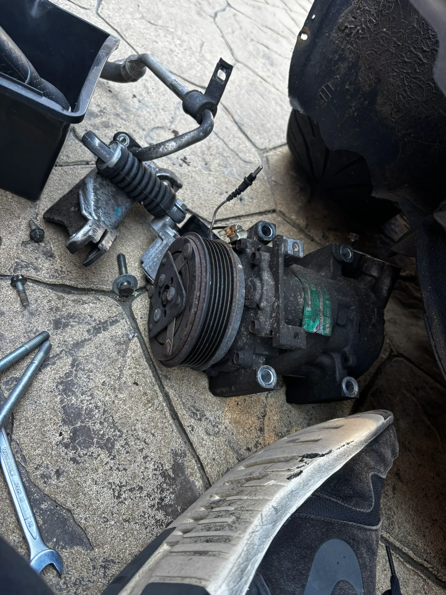

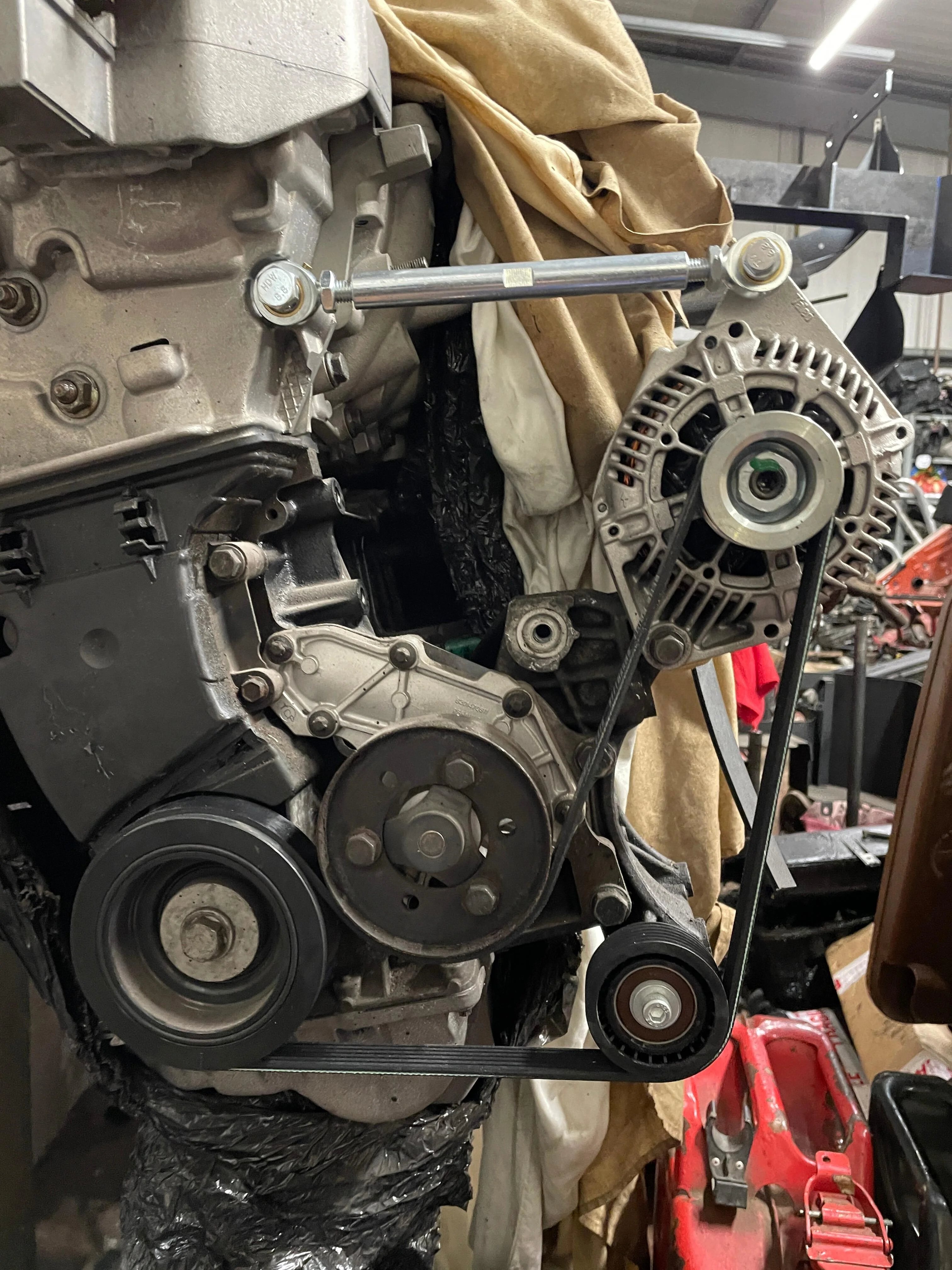

God bless whoever found out this jubilee clip trick for the tensioner (I was halfway through getting the belt off, don't worry!)
Pretty tricky getting it out of the engine bay actually, must have rotated it around every direction. However it finally emerged, like a dirty metal egg.
Now its off to get rebuilt and should be back by the end of the week.
Car looks in a bit of a sorry state!

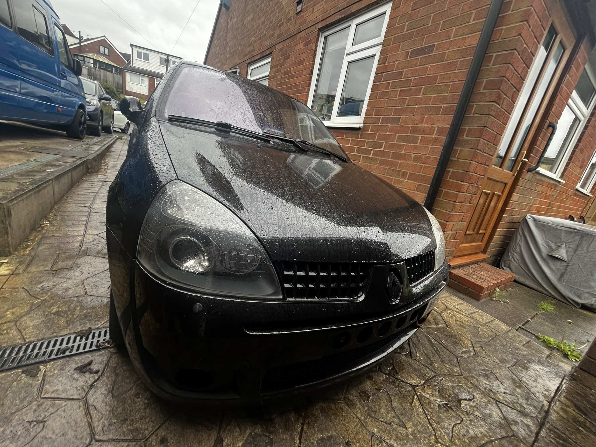

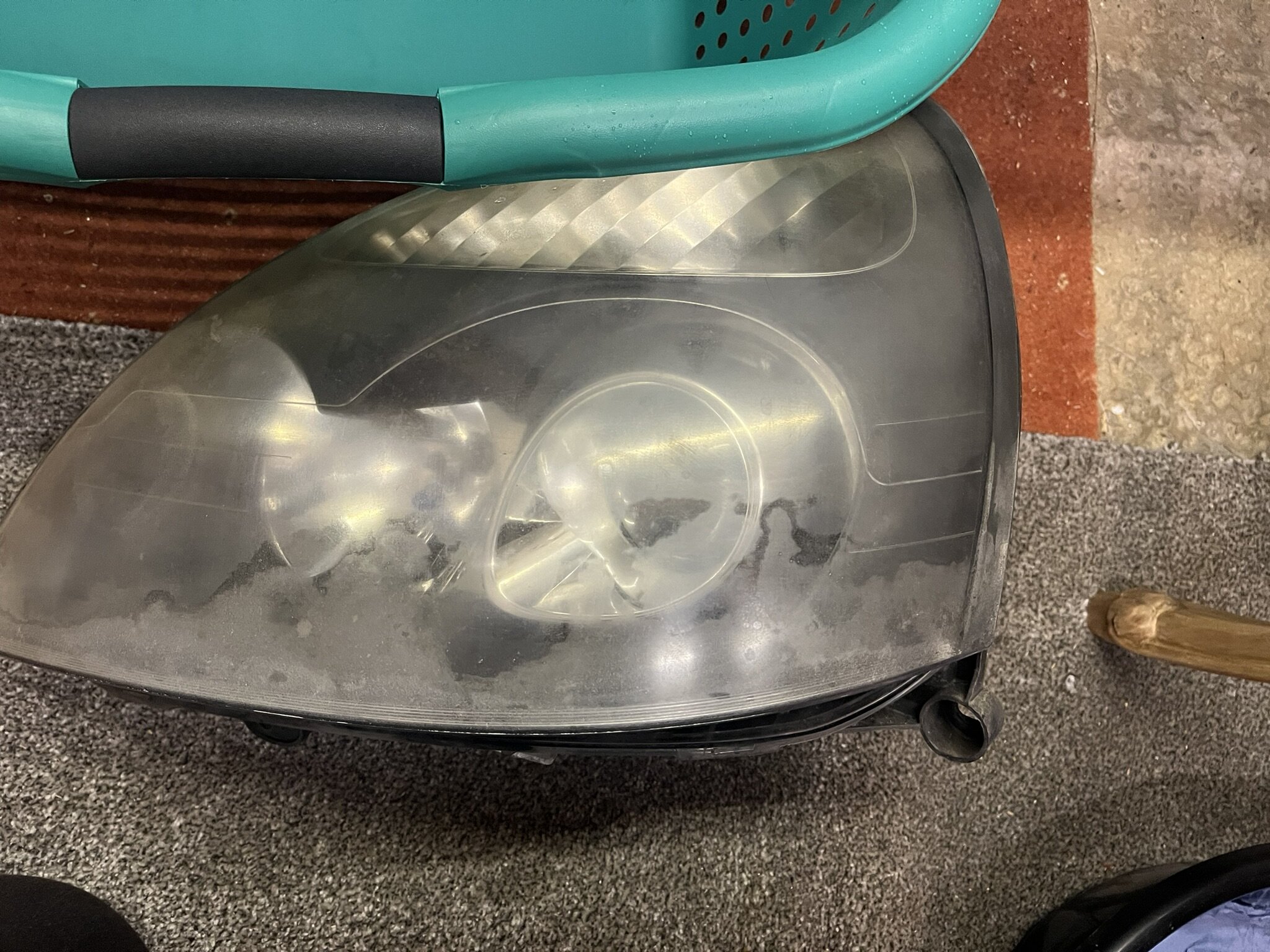

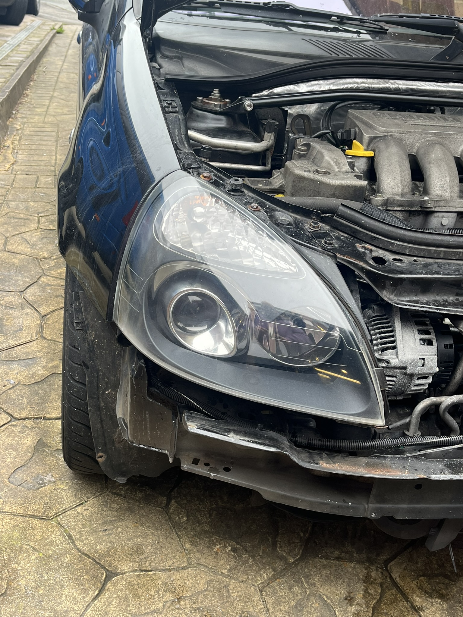

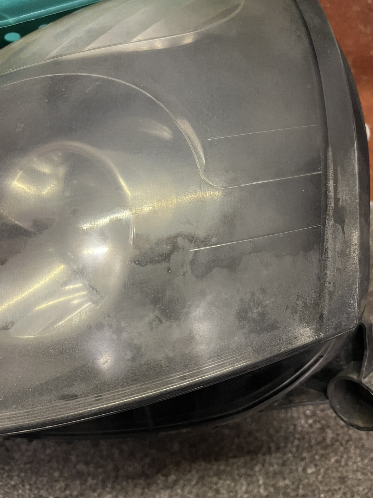

As mentioned previously, I've tried a few times to polish my headlights with no joy. There's this cloudiness that you can feel from the outside. Is it inside the lens or do I just need to polish more? The lenses are pretty smooth...
martynrg
  Clio 182
It’s on the outside. I’ve used the Meguiars headlight restoration kit on my lights and works well, finished off with some UV sealant.
It’s almost an annual job though, but it is rewarding
JimF
  Clio 172
Was that by hand or with a machine? I've tried by hand with sandpaper, the Turtle Wax restoration kit and also using a drill with a flexipad and sanding discs.
martynrg
  Clio 182
Sounds like a similar sort of thing. The Megs kit comes with small pads of different graded wet and dry that you use by hand and also a woolly buffing pad you use with a drill along with the supplied PlastRx (I think it’s called) to polish them up.

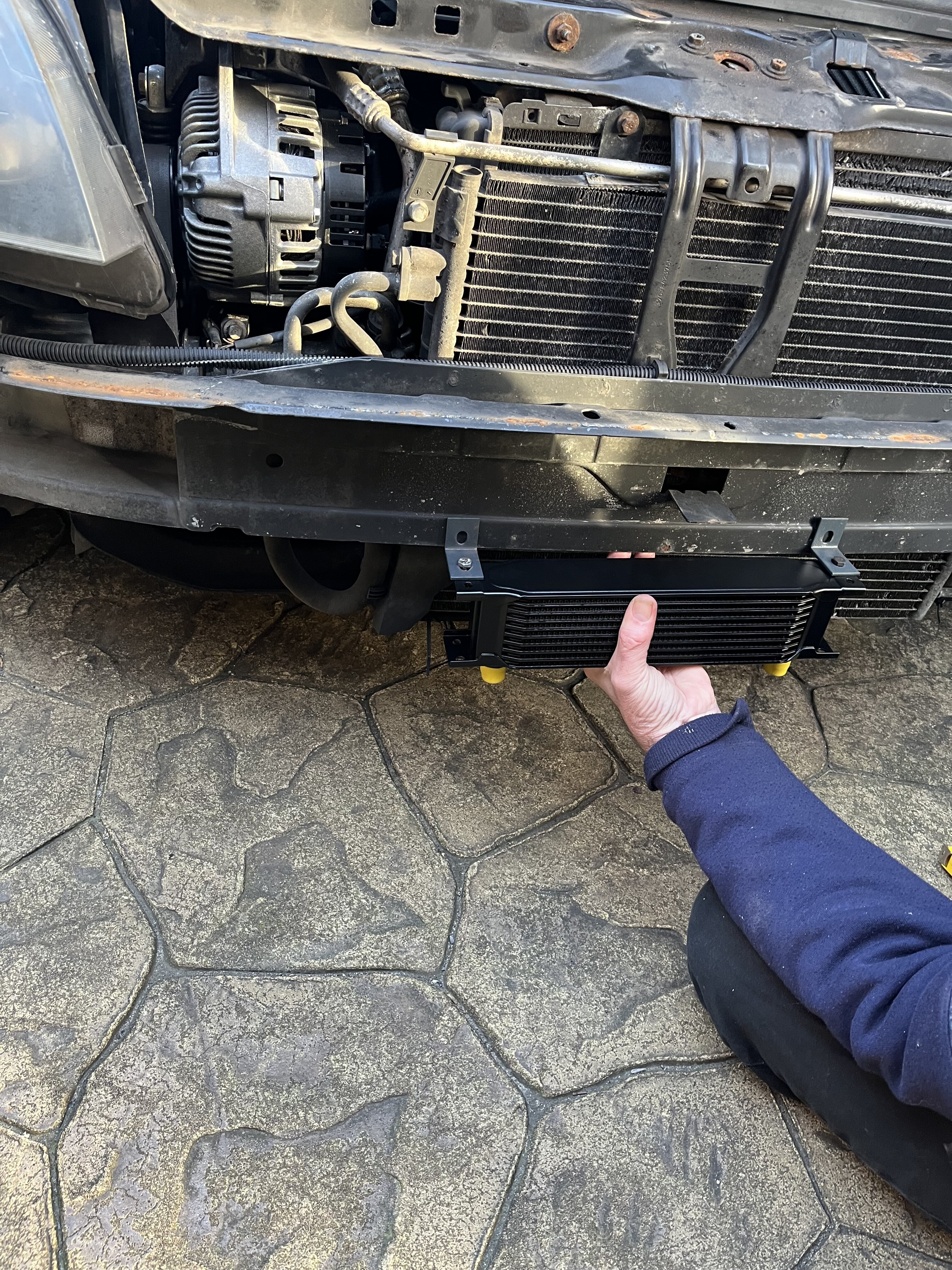

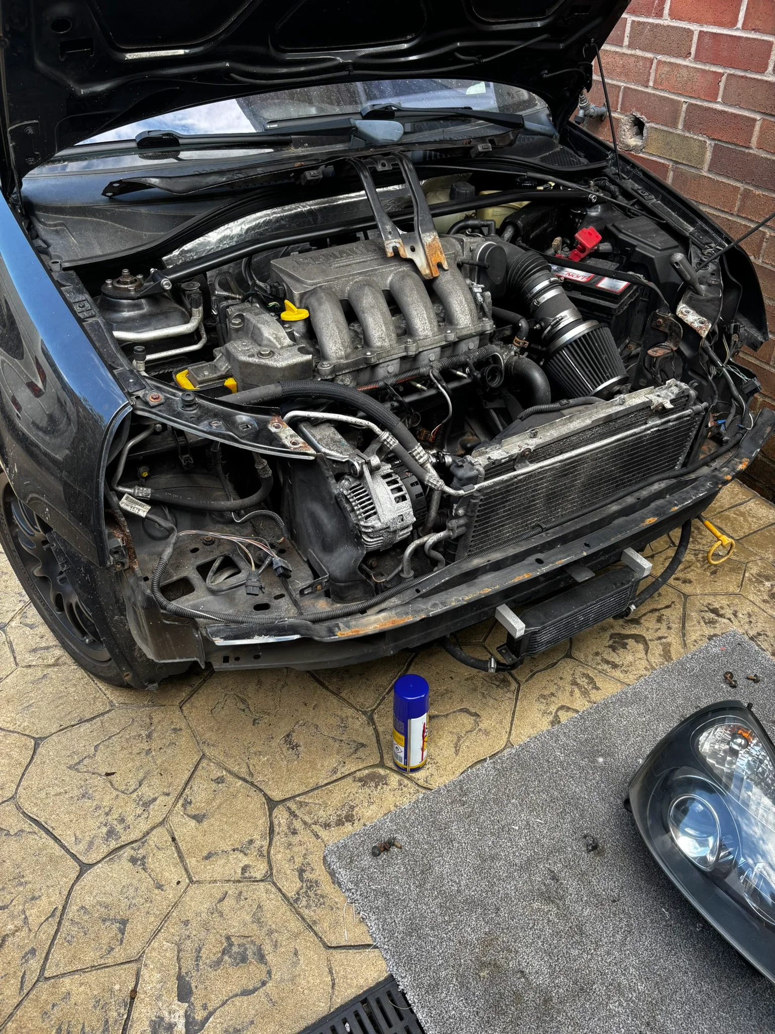

Mocked up the cooler, I've since made some ridiculous billet blocks to act as brackets, because why not?!
I've also been buying bits, so along with the 8AN fittings, Aeroquip hose etc, I've also ordered a set of Grams springs, and a Volantech cruise control steering wheel mounted panel. Tempted with that PMS rear ARB in the classifieds at the minute, but want to do one thing at once really.

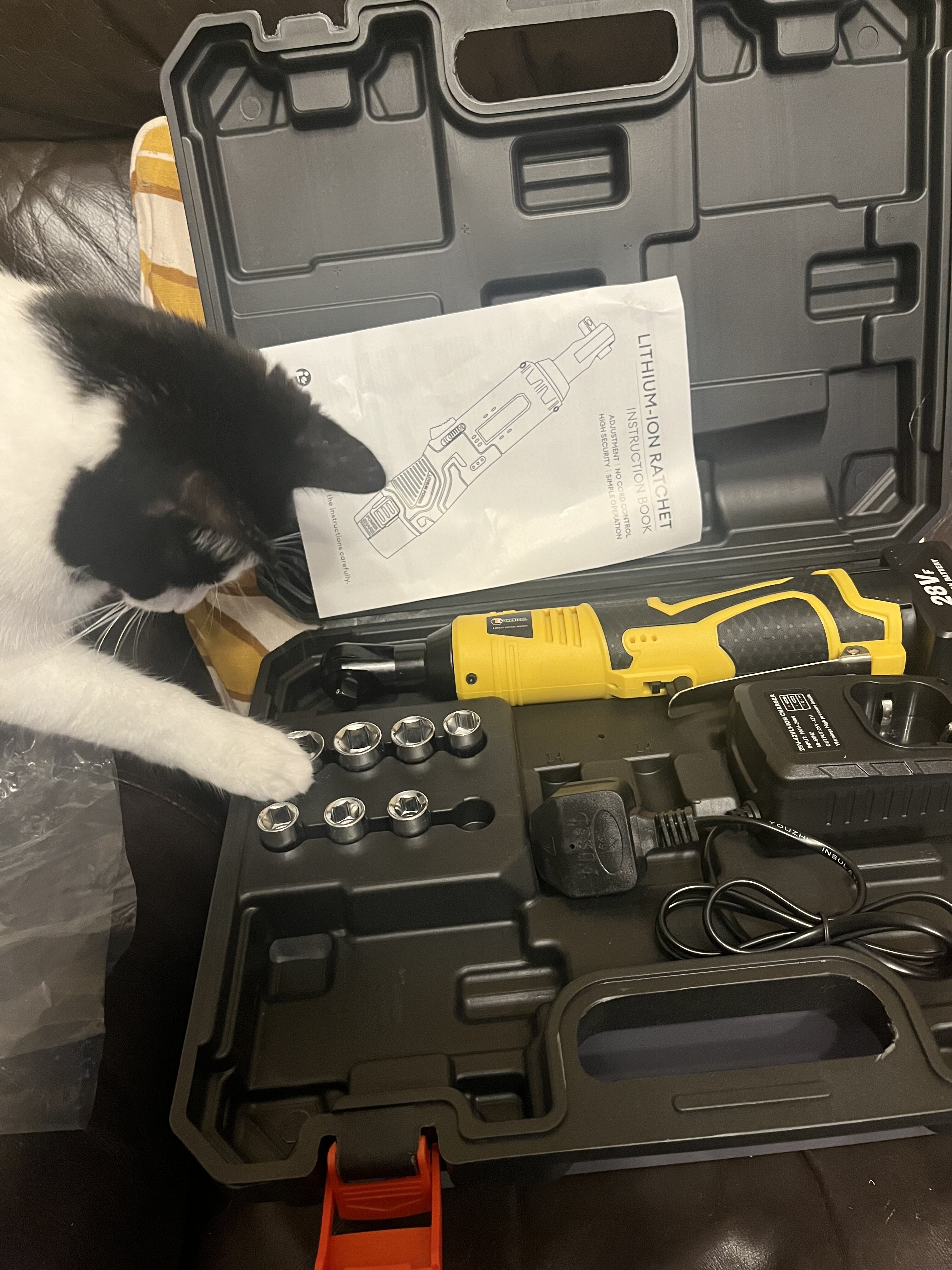

As well as that, my birthday coincided with realising I needed to buy some tools that me and my Dad had been sharing whilst we shared a garage.
Any excuse (Wera fanboy)
Always fancied a battery ratchet so looking forward to breaking plenty of bolts with this!
Think it passed inspection :LOL:

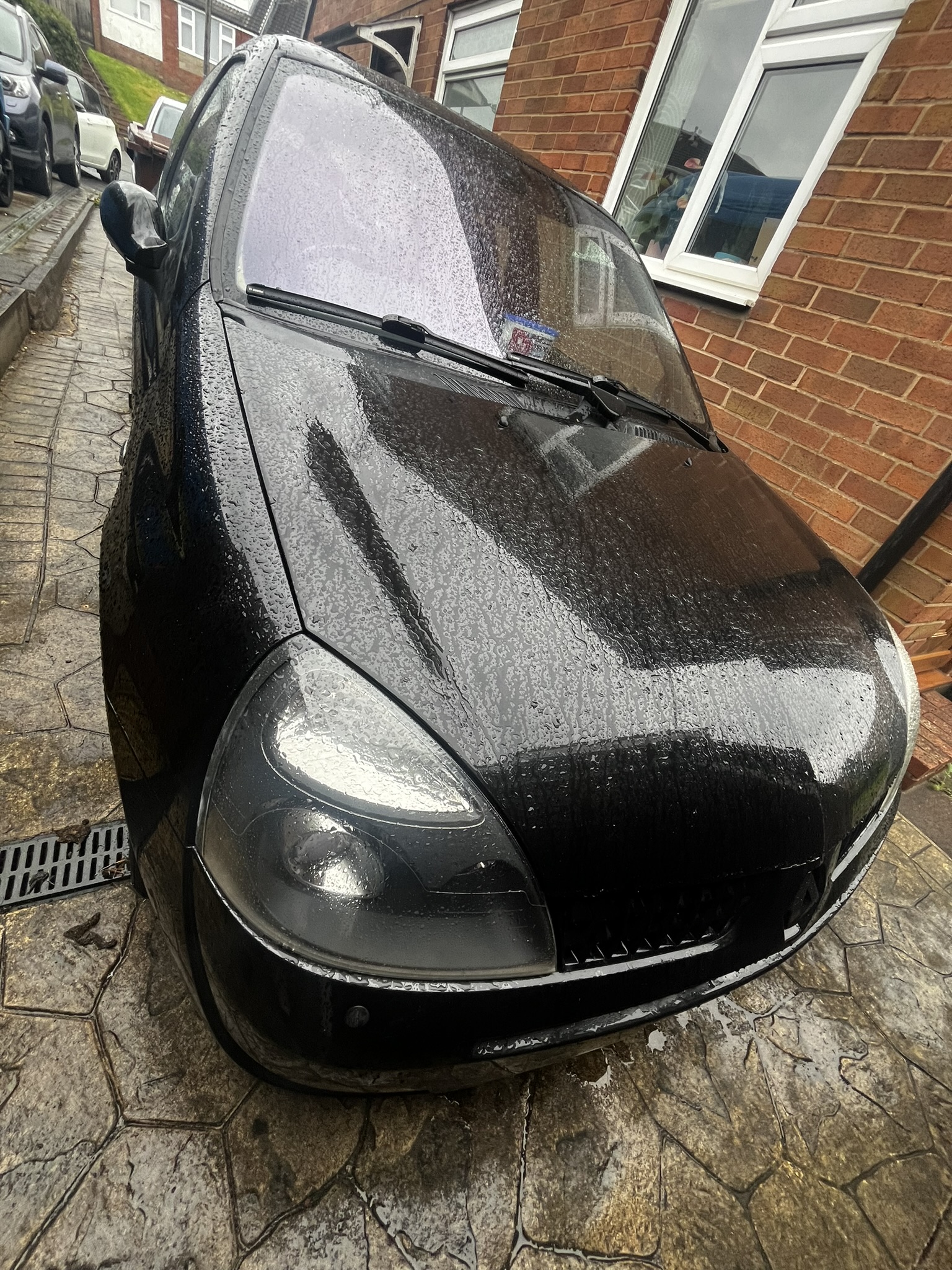

First off, I had a proper go at polishing the headlights. They came up great. Not sure why I never got results like this before. I used a drill and a velcro foam backing pad, and 2" discs from 800grit up to 3000grit, the finished off with Mothers polish.
I've got some UV proof lacquer to finish them off too, but I bought some cutting compound (for another job on the daily driver) so fancy having another bash.

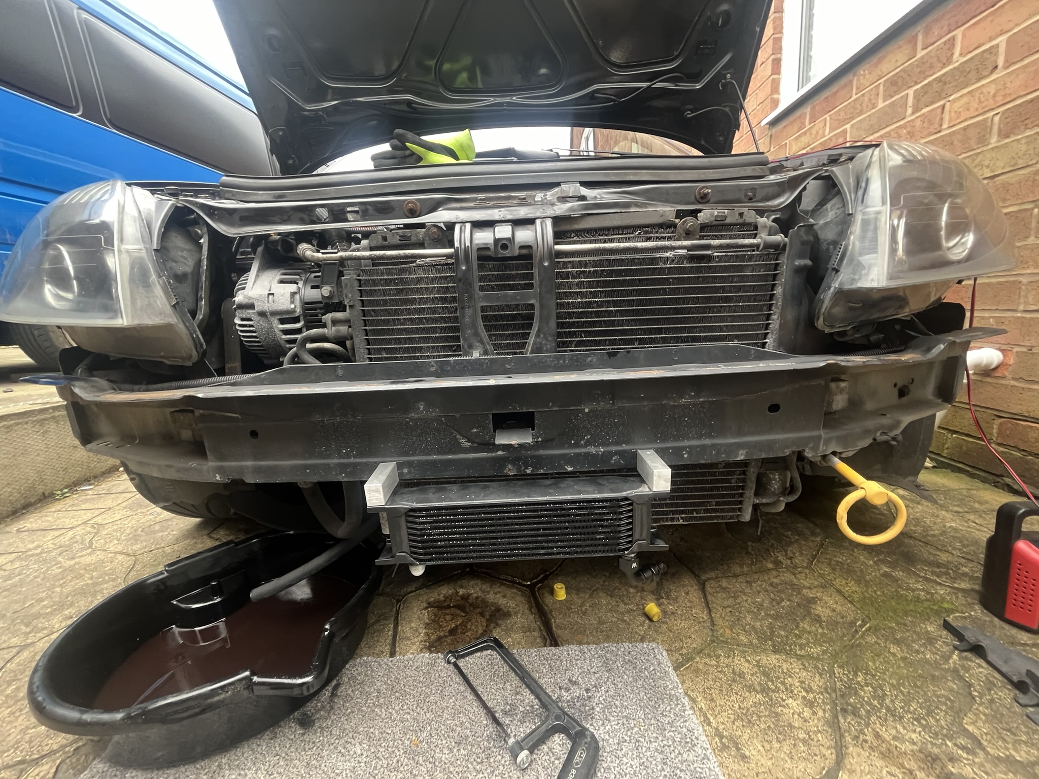

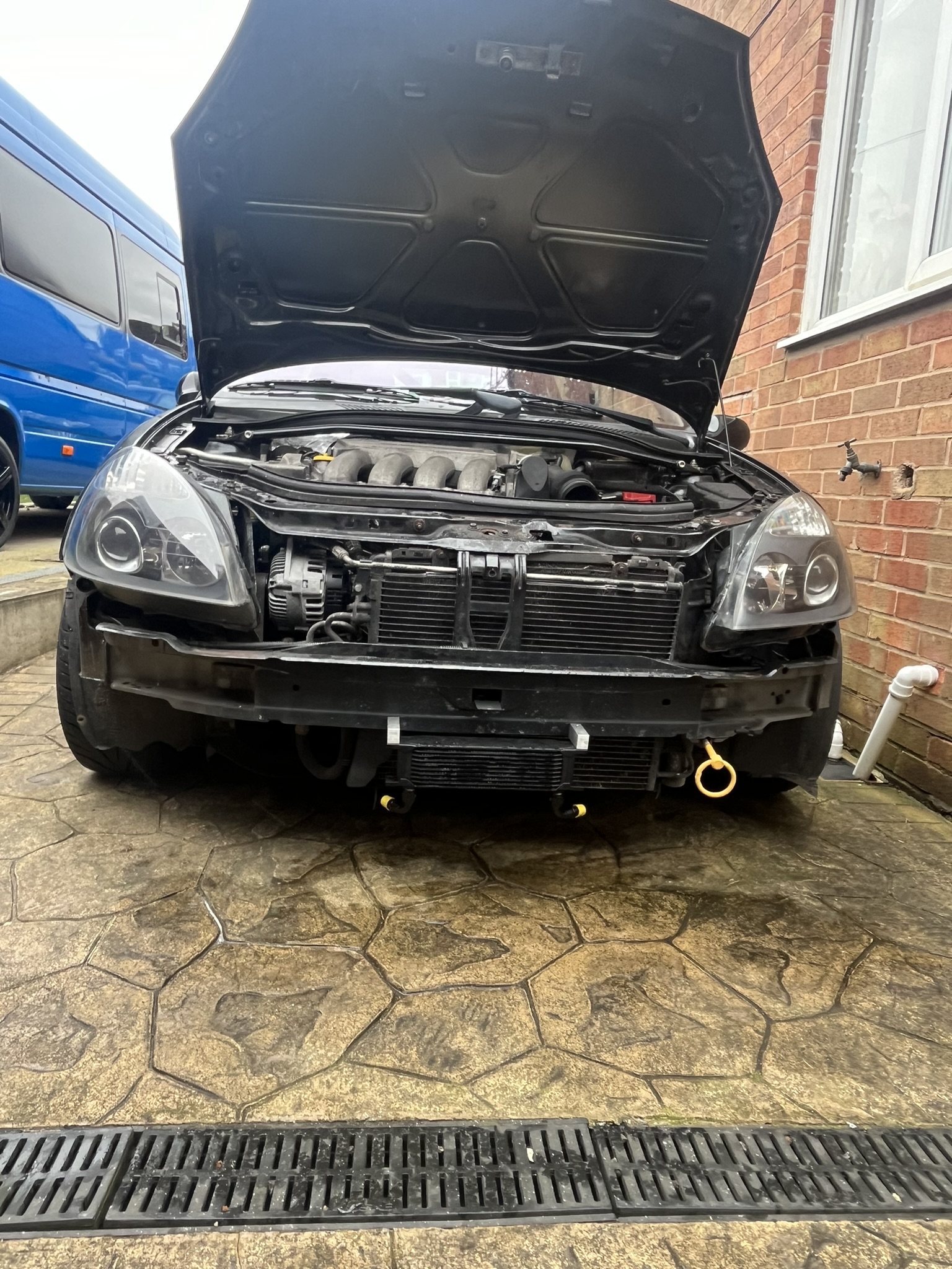

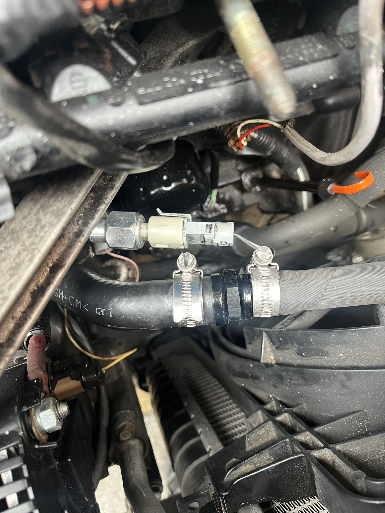

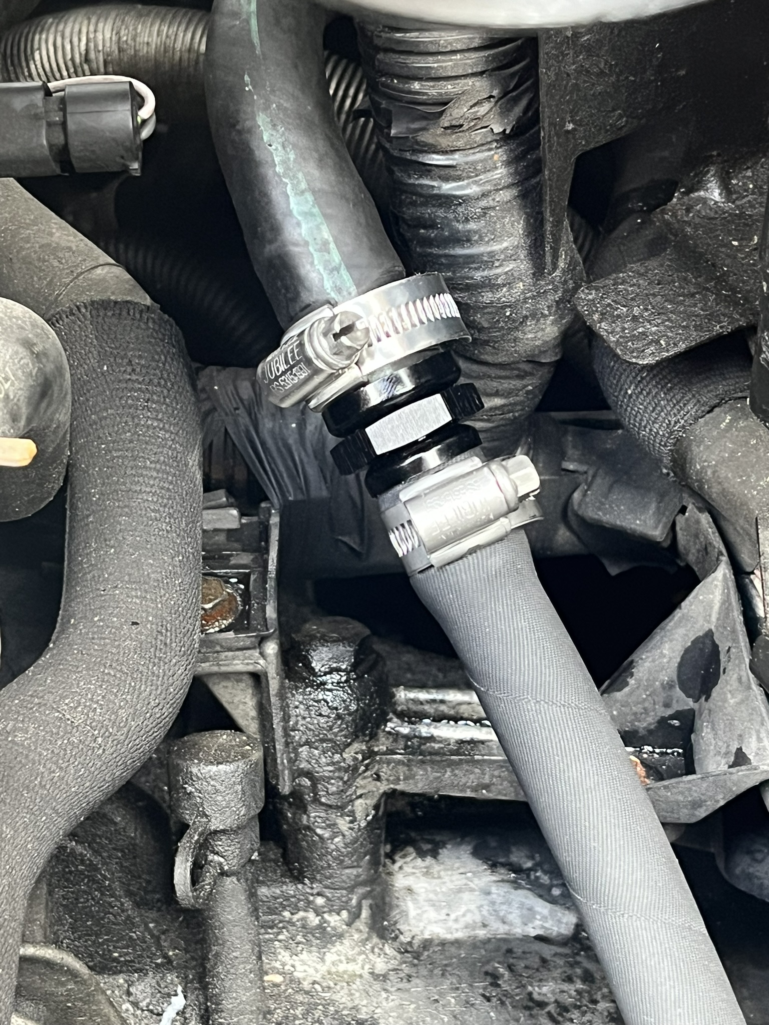

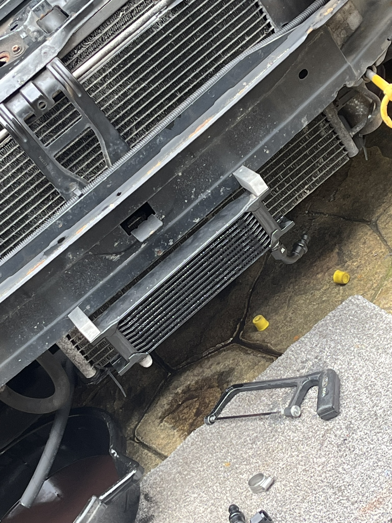

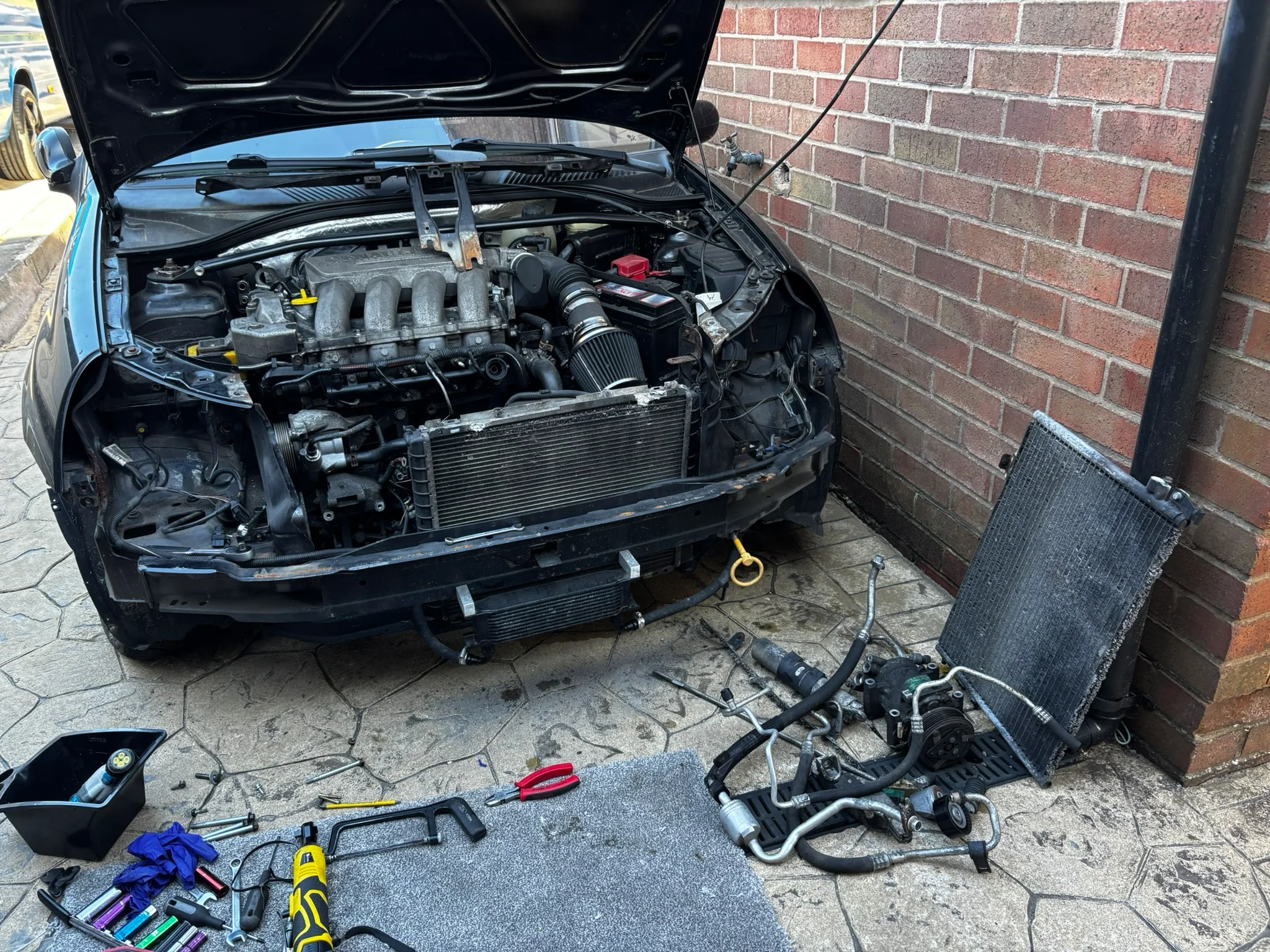

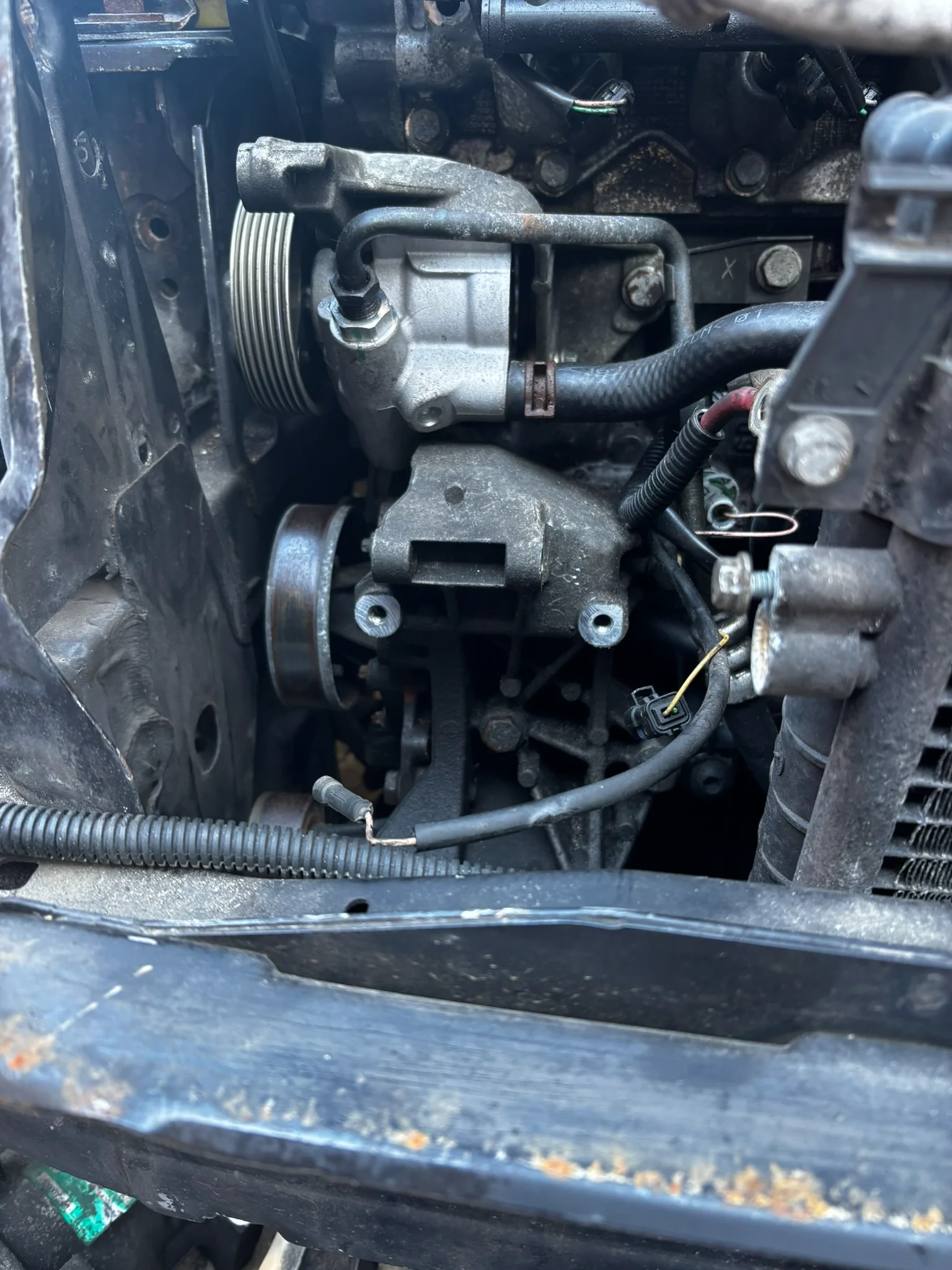

Next job was to sort out the powersteering cooler. Whilst the L brackets I used for the test fit/mock up, look a bit neater, I wanted to totally over engineer these mounts and have no chance of failure. It was enough of a pain getting the PAS pump changed etc that if something happened and I lost fluid and killed another pump I'd be furious :lol: so better safe than sorry! Made some mounts out of ally bar drilled and tapped.
I cut the PAS return to reservoir pipe just before the hardpipe section, and used some spare hose to catch the spillage drain it off.
I've used -8 Aeroquip hose, and push on fittings. That said, due to power steering issues being the bane of my life on track (cut short two trackdays) I've used jubilee clips as well. Most likely totally redundant, but like with the brackets, if something goes wrong I can rule out underengineering!
I've used a reducer on the pump return to the -8 cooler feed line, -8 right angle to -8 screw fitting to cooler core, then the reverse of that feeding to the other side of the return hardpipe up to the reservoir.
I've cable tied this to the fan shroud to avoid any fouling against the sensor plug/wiring.
Also, these fittings are a right b*****d to get into the hose. Saw a good tip on YouTube - soak the end of the hose in pan of boiling water.

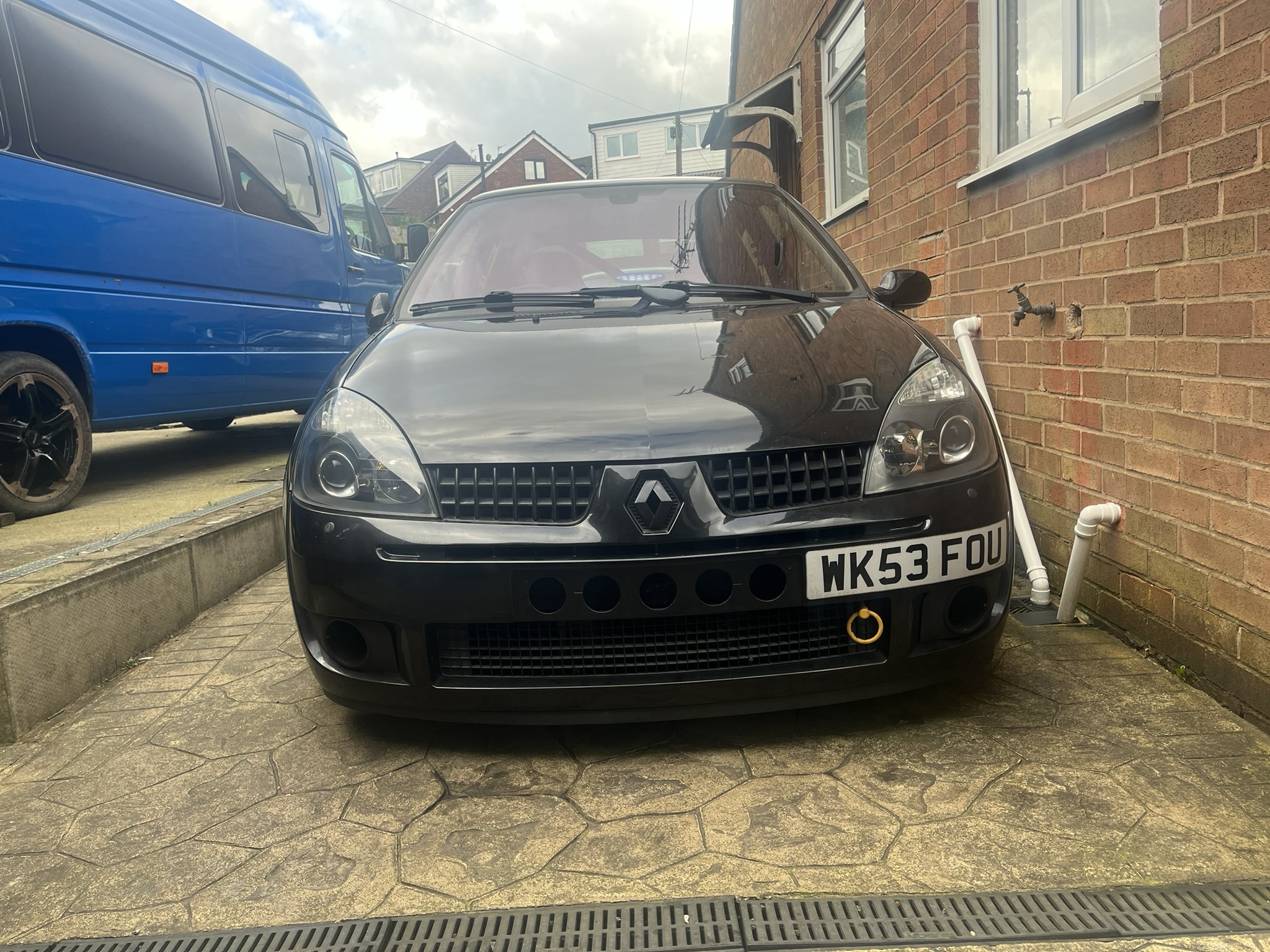

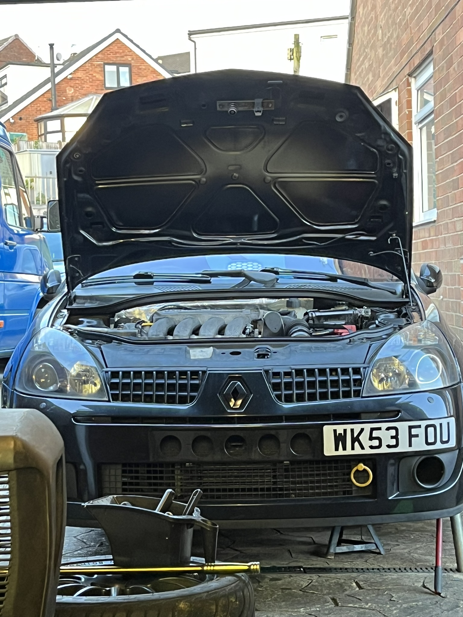

Re-assembled and not looking like a scrapper for the first time in weeks!

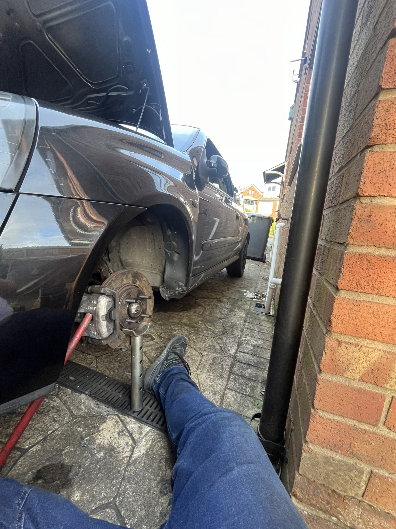

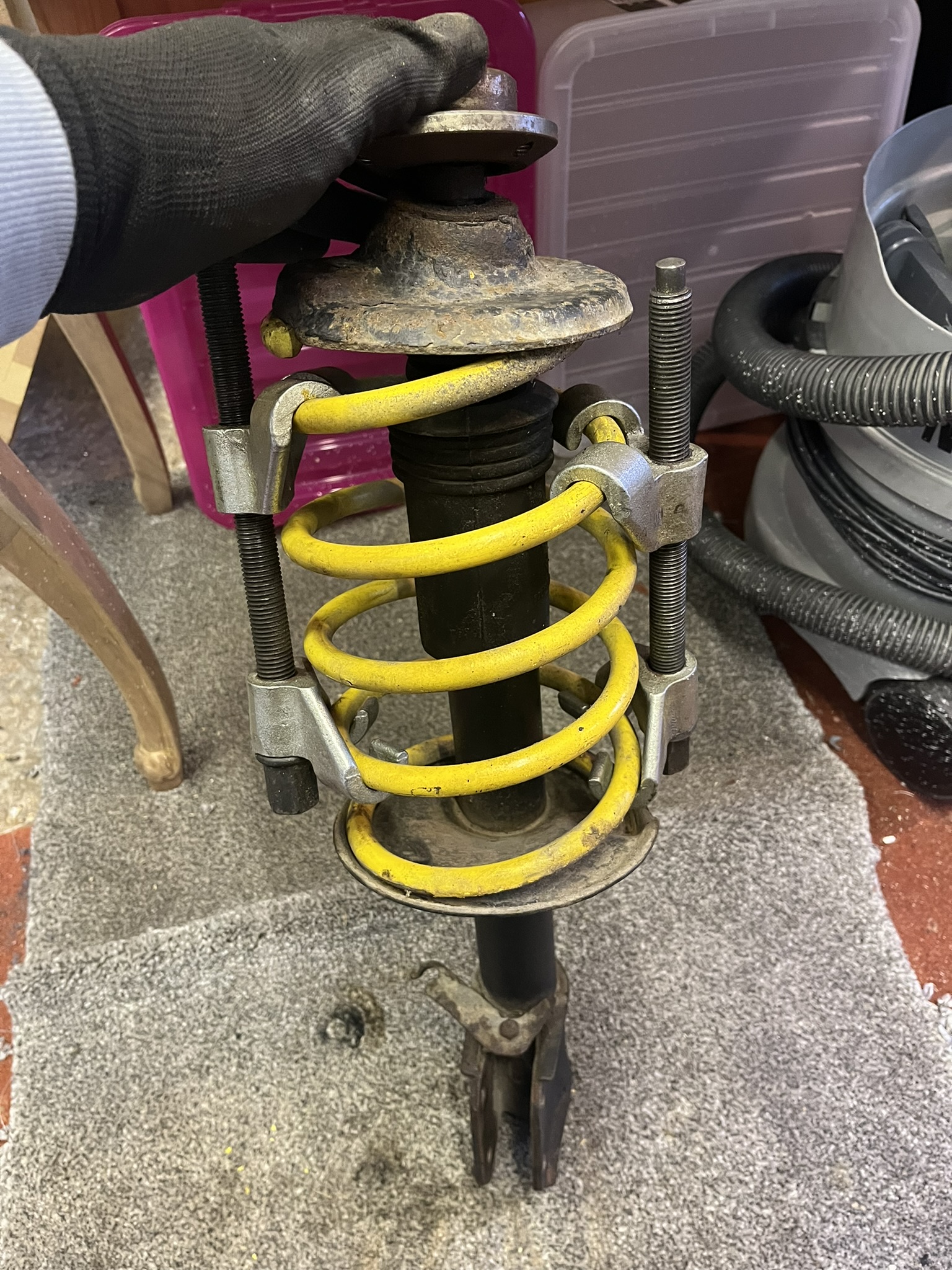

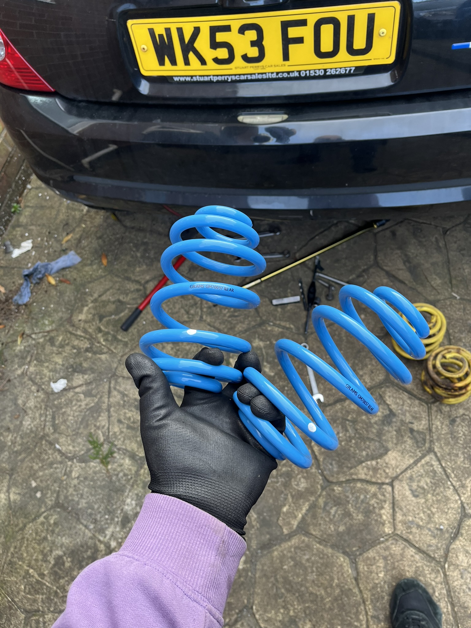

A few days after that I decided to make a start fitting the new springs. Due to the way my brain works, my thought process goes:
'Should I start fitting the new springs?' -> 'Can I finish it today?' -> 'If no, don't bother'
But then I realise I've been doing that since February.

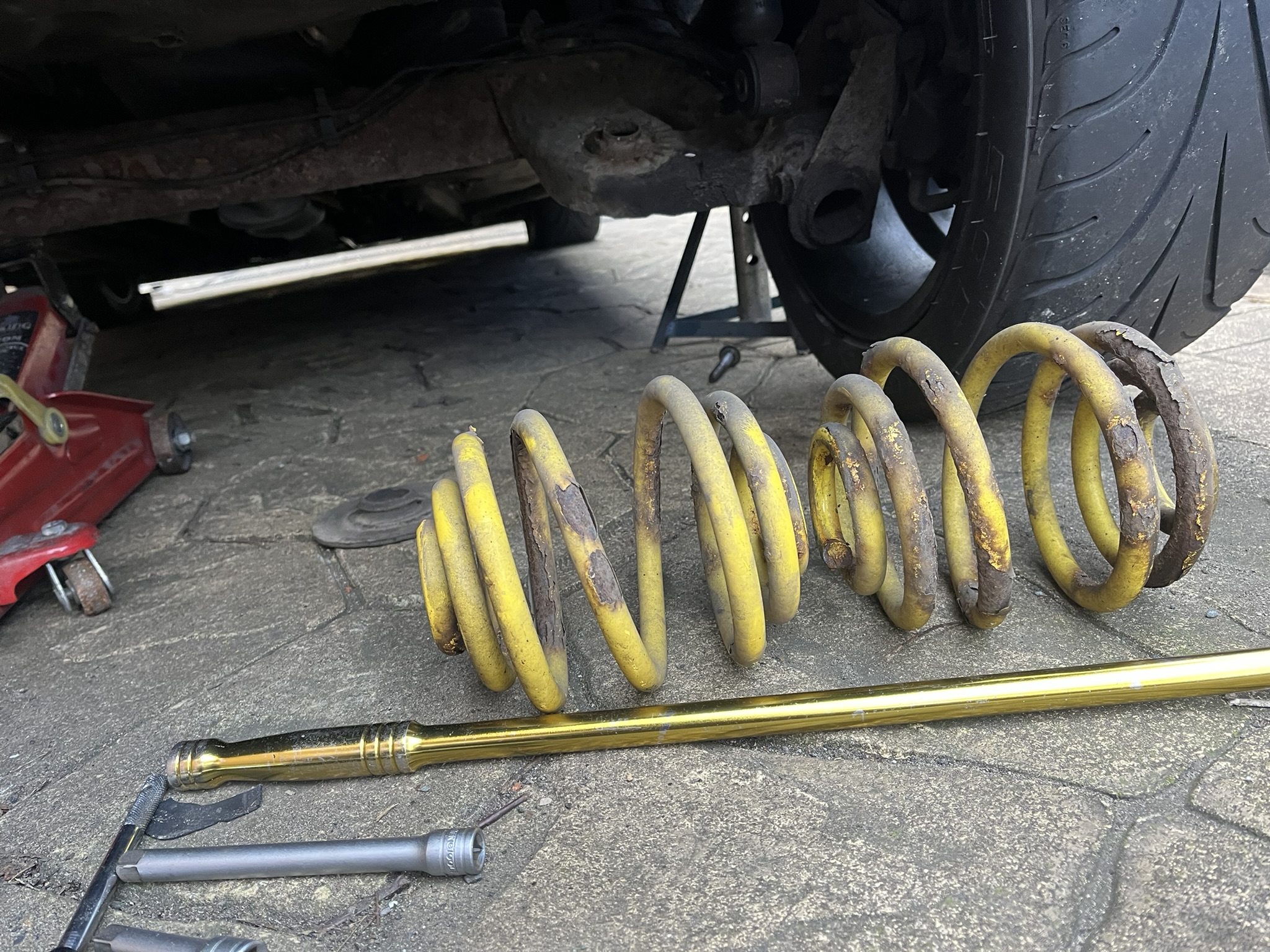

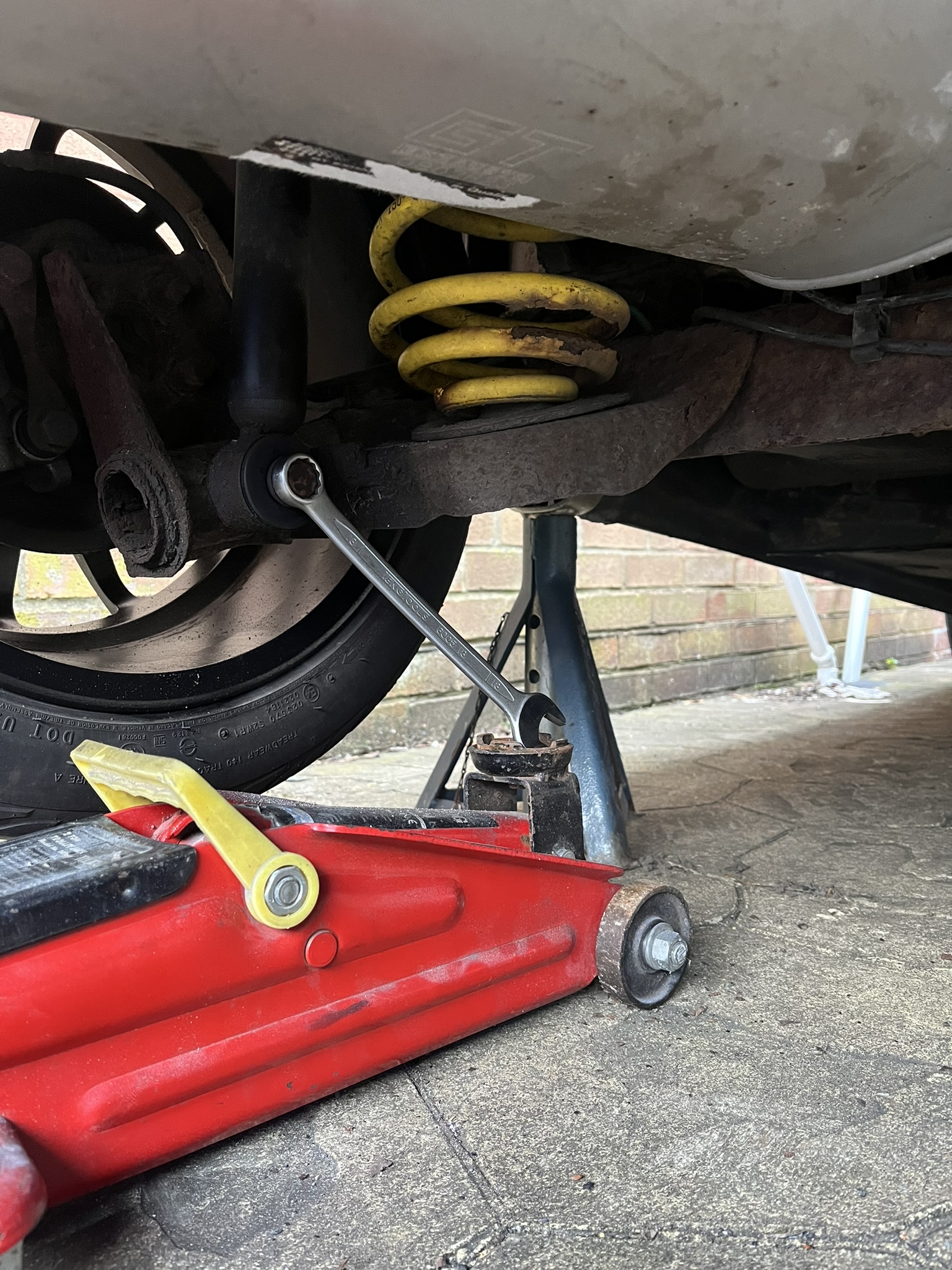

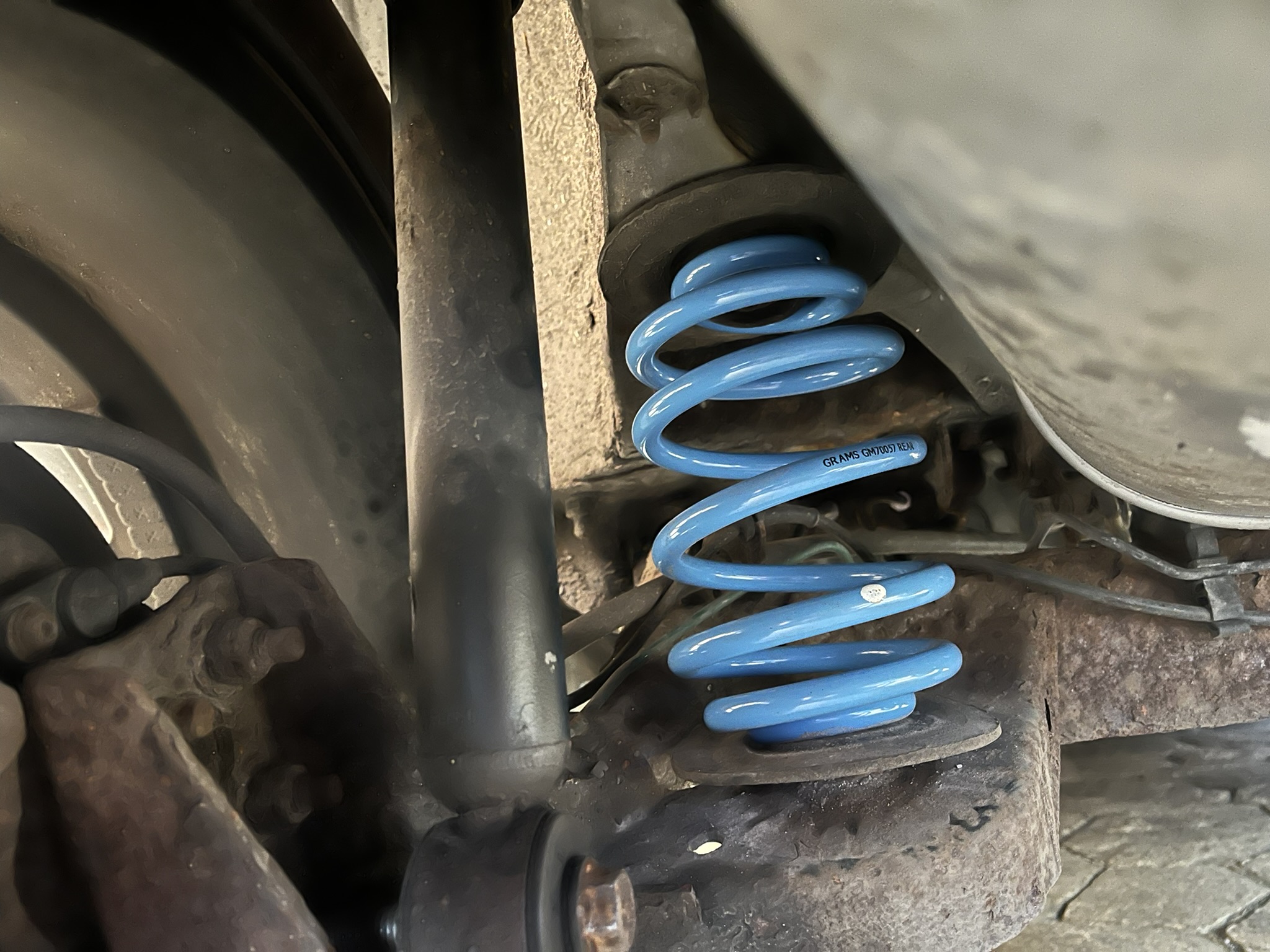

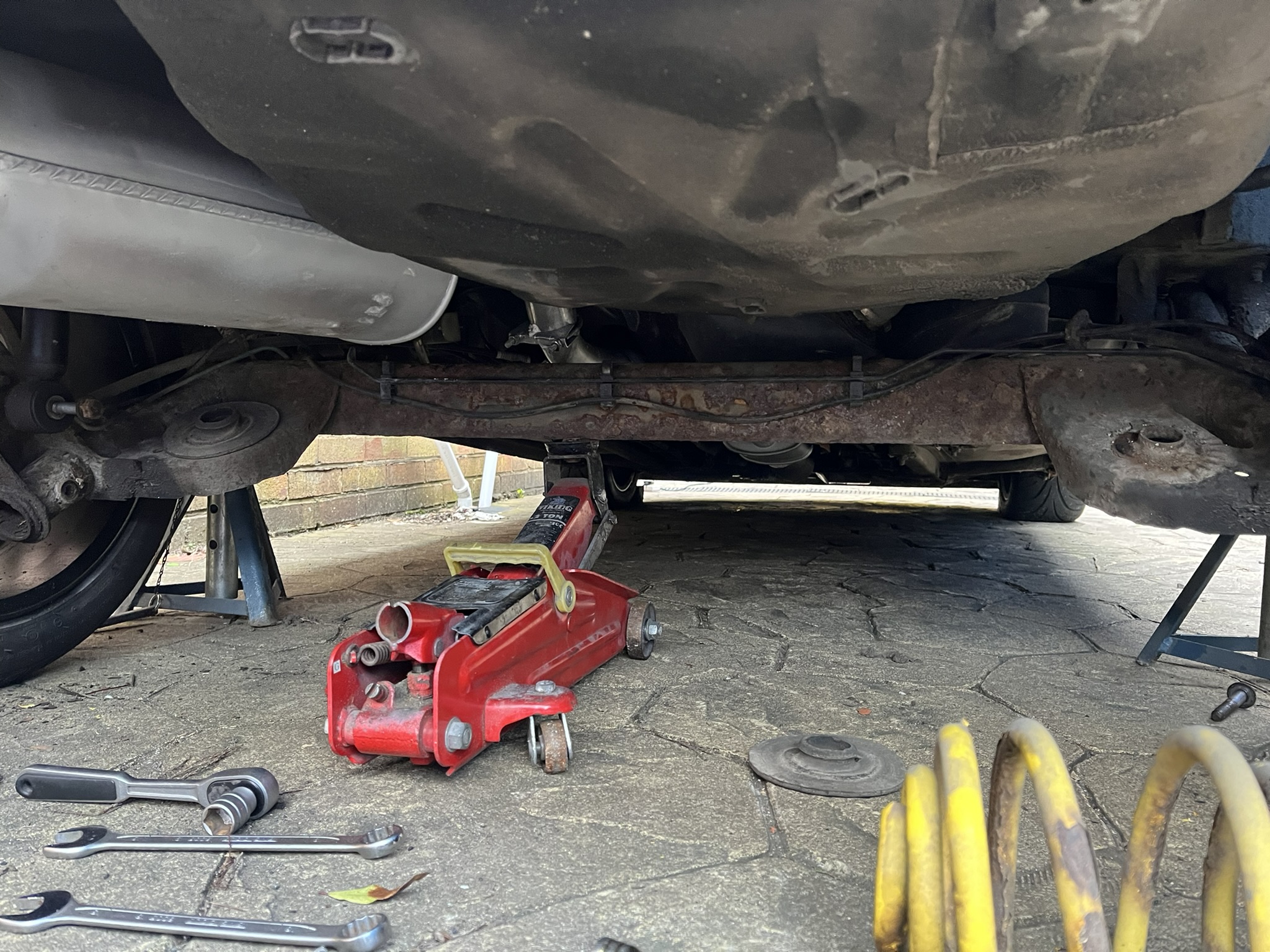

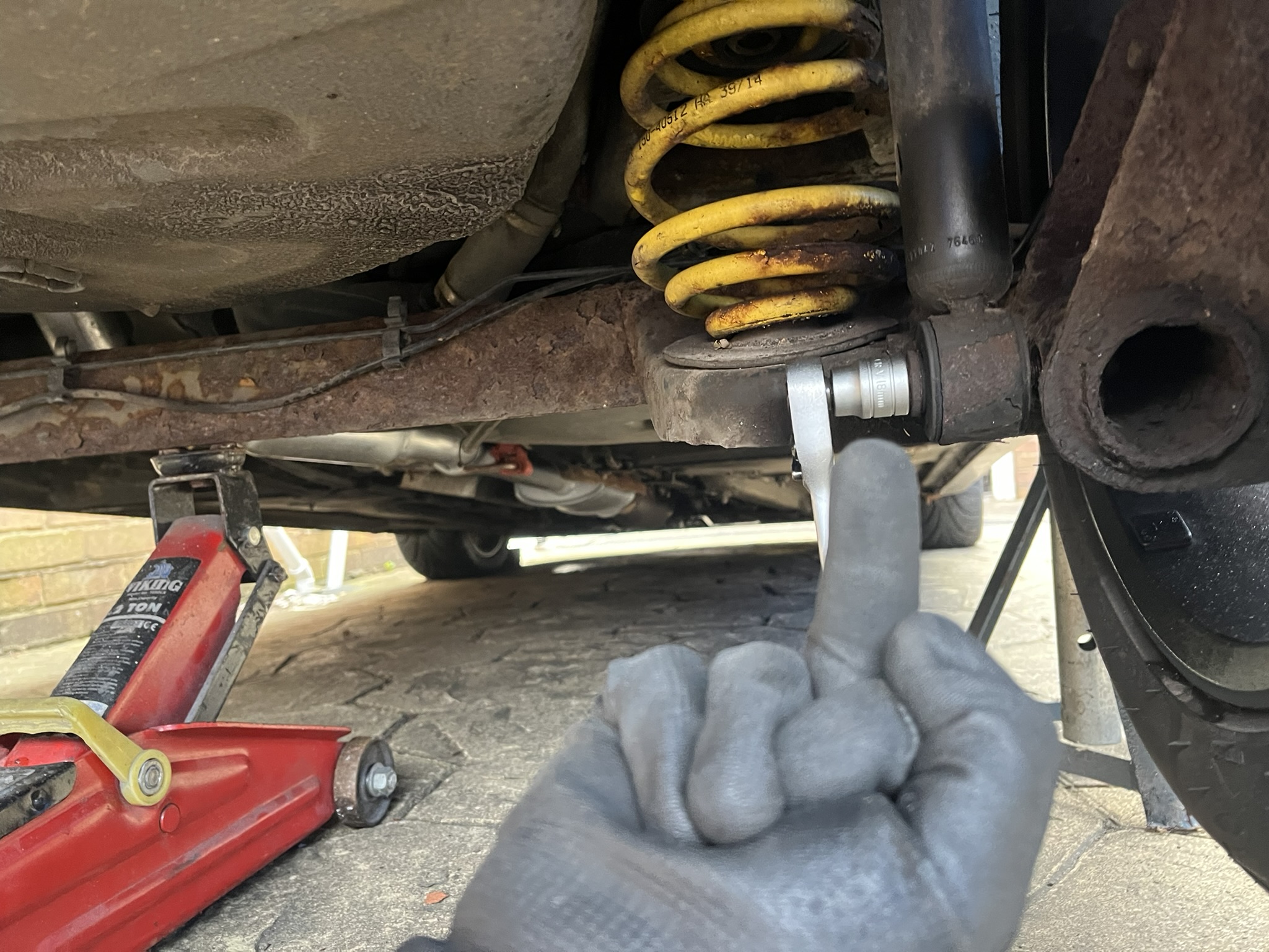

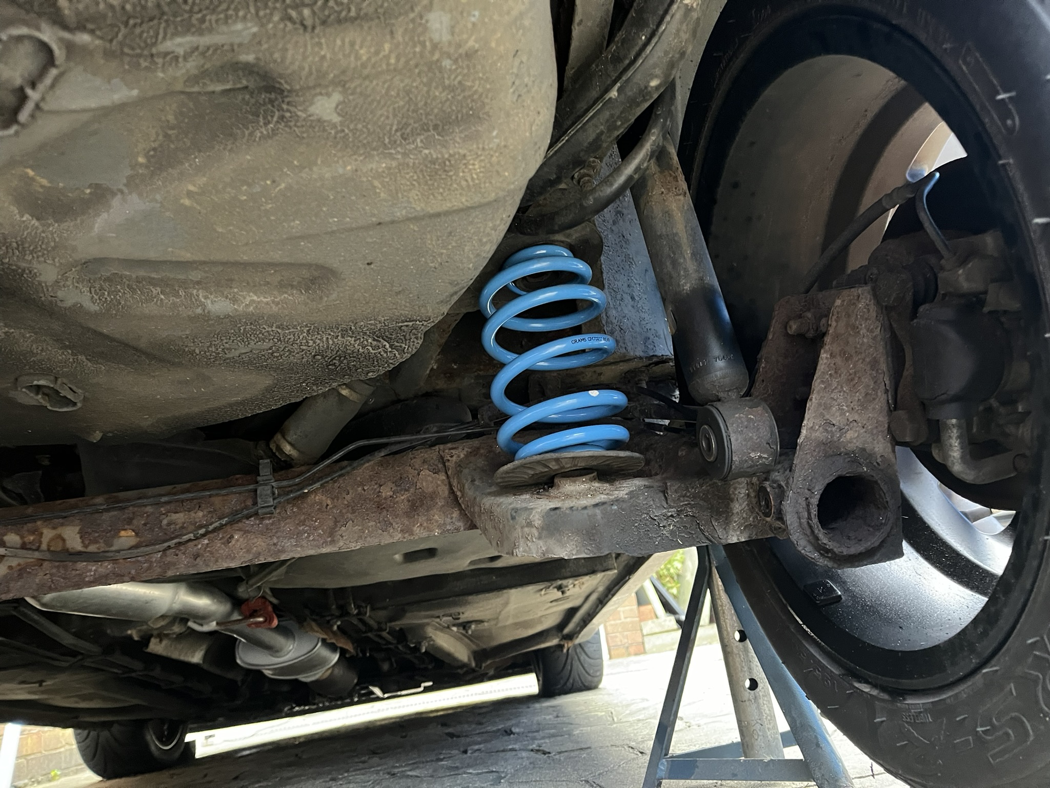

After remembering how simple the rears would be, I made a start last weekend.
Despite a generous application of WD40 a day prior, these were quite tight! I've finally ordered an impact wrench but its not due in till next week.
Looks like I need to add "brush the rear beam and apply some rust converter" to my to-do list!
Whoever mentioned on an older post that the springs drop out with a rather satisfying clang is 100% correct!
JimF
  Clio 172
I shouldn't love this colour as much as I do, but its almost a shame to hide them away!
I made sure this was properly seated after taking the pic.

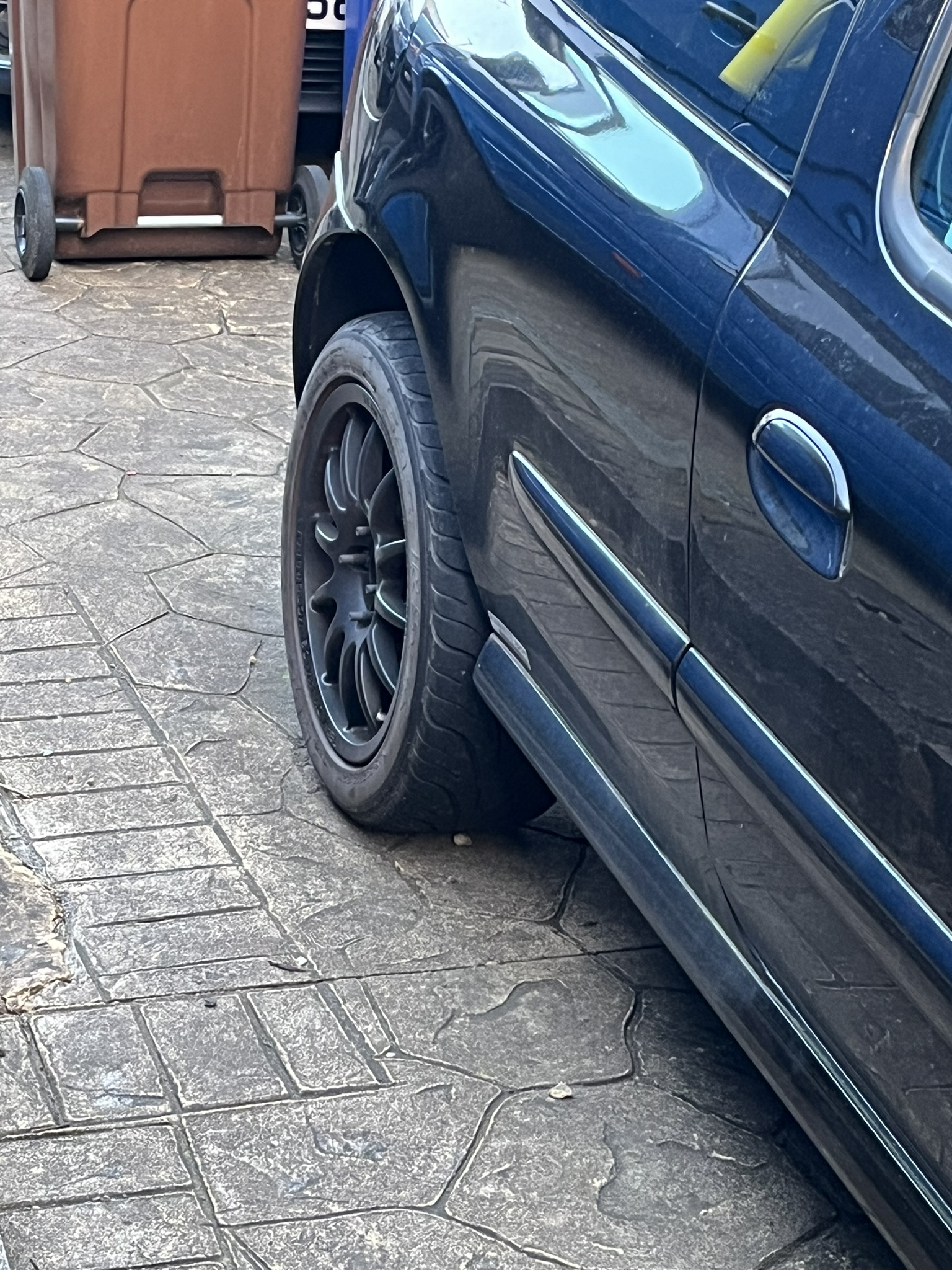

Lowered the car off the stands and trolley jack and was a bit surprised at how high it sat.
Then I removed the handbrake and rolled it a few inches and it all got a bit more sensible.

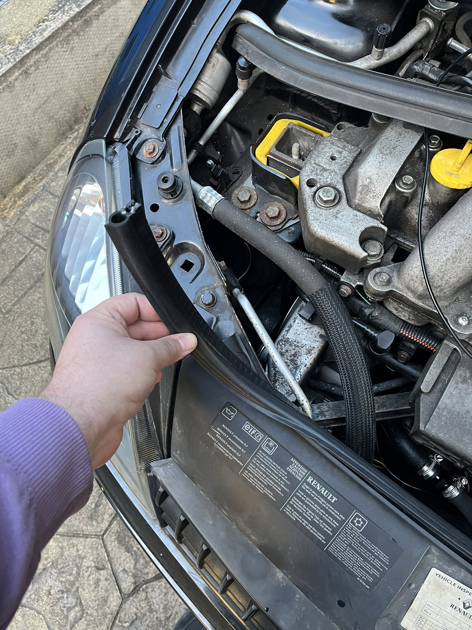

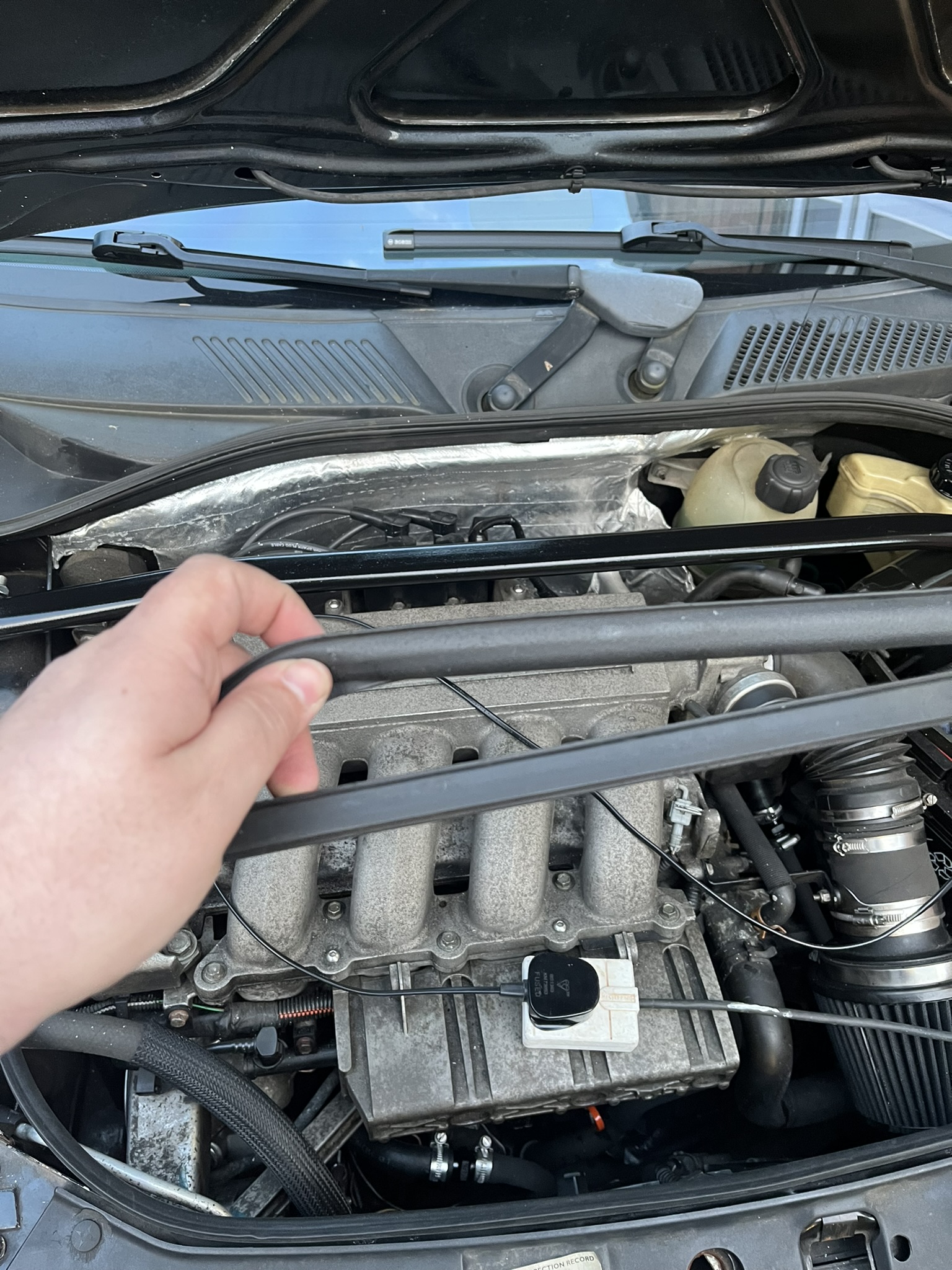

I also fitting a new slam panel/bonnet seal as the old one had split and was winding me up.

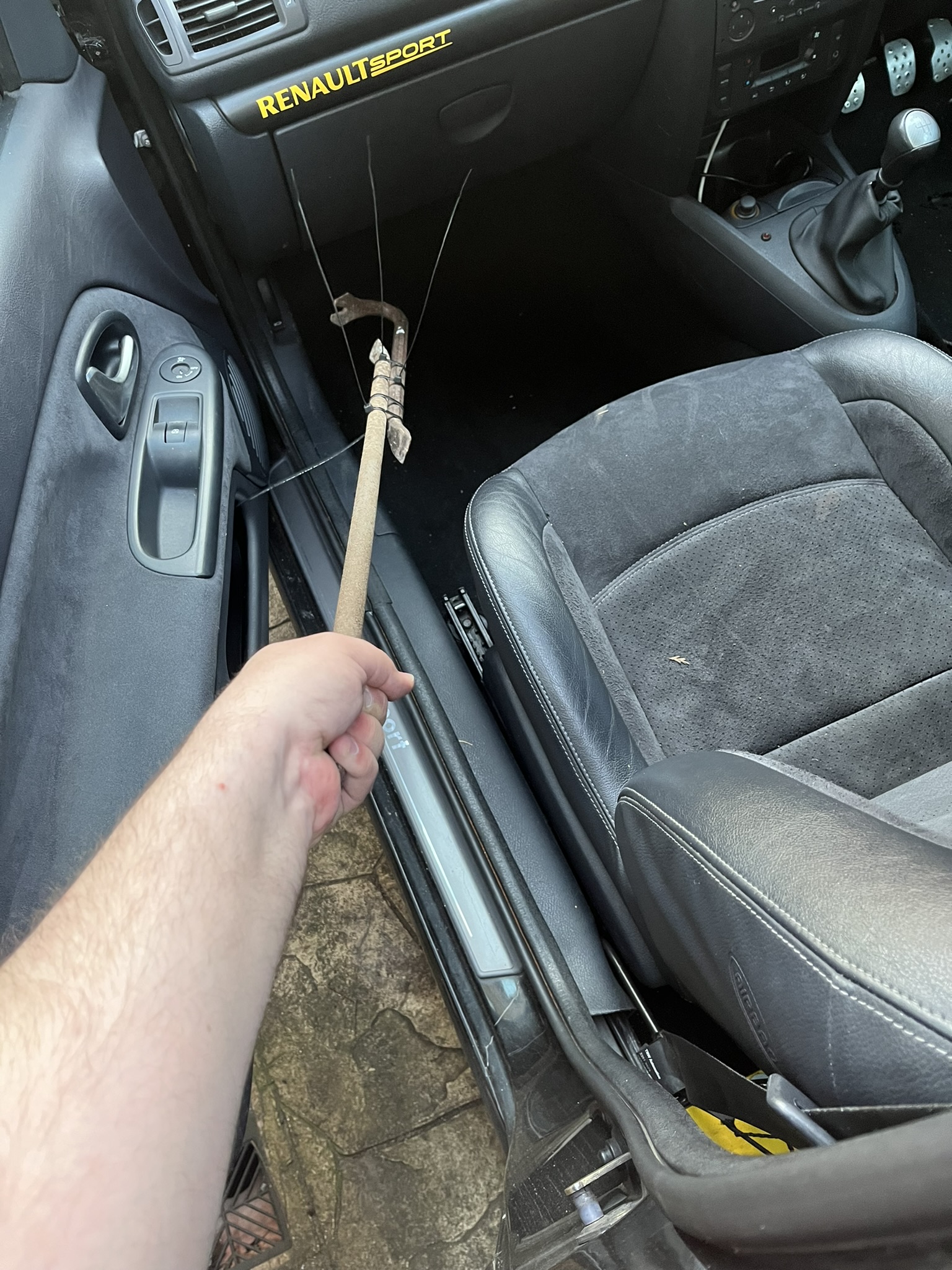

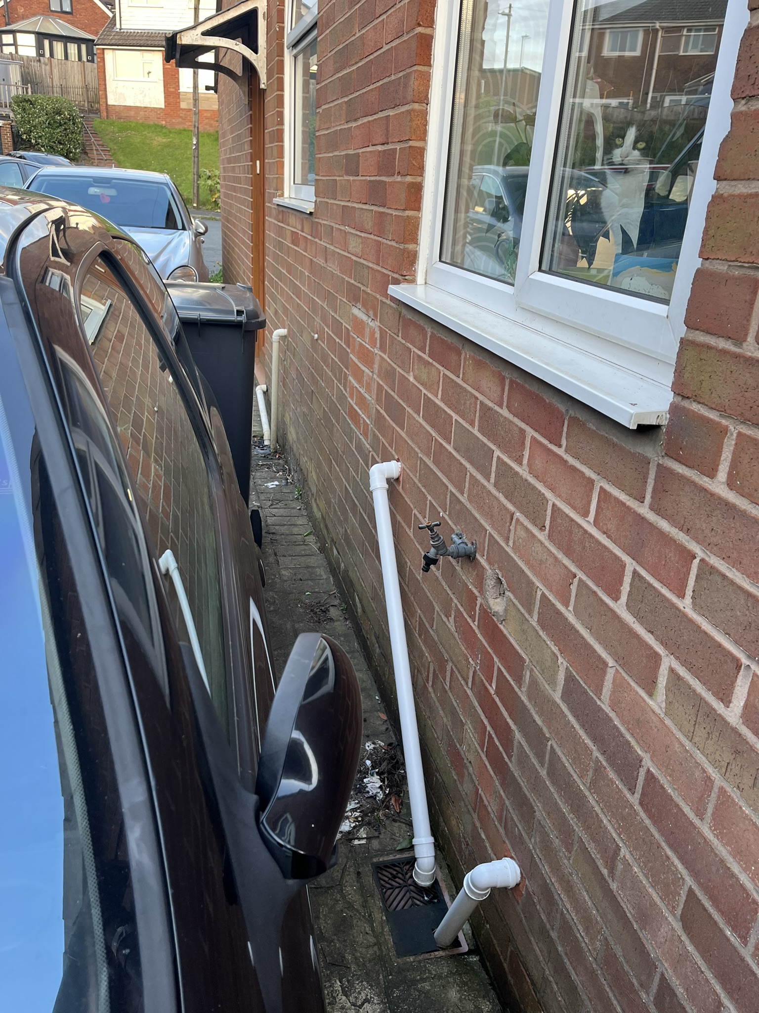

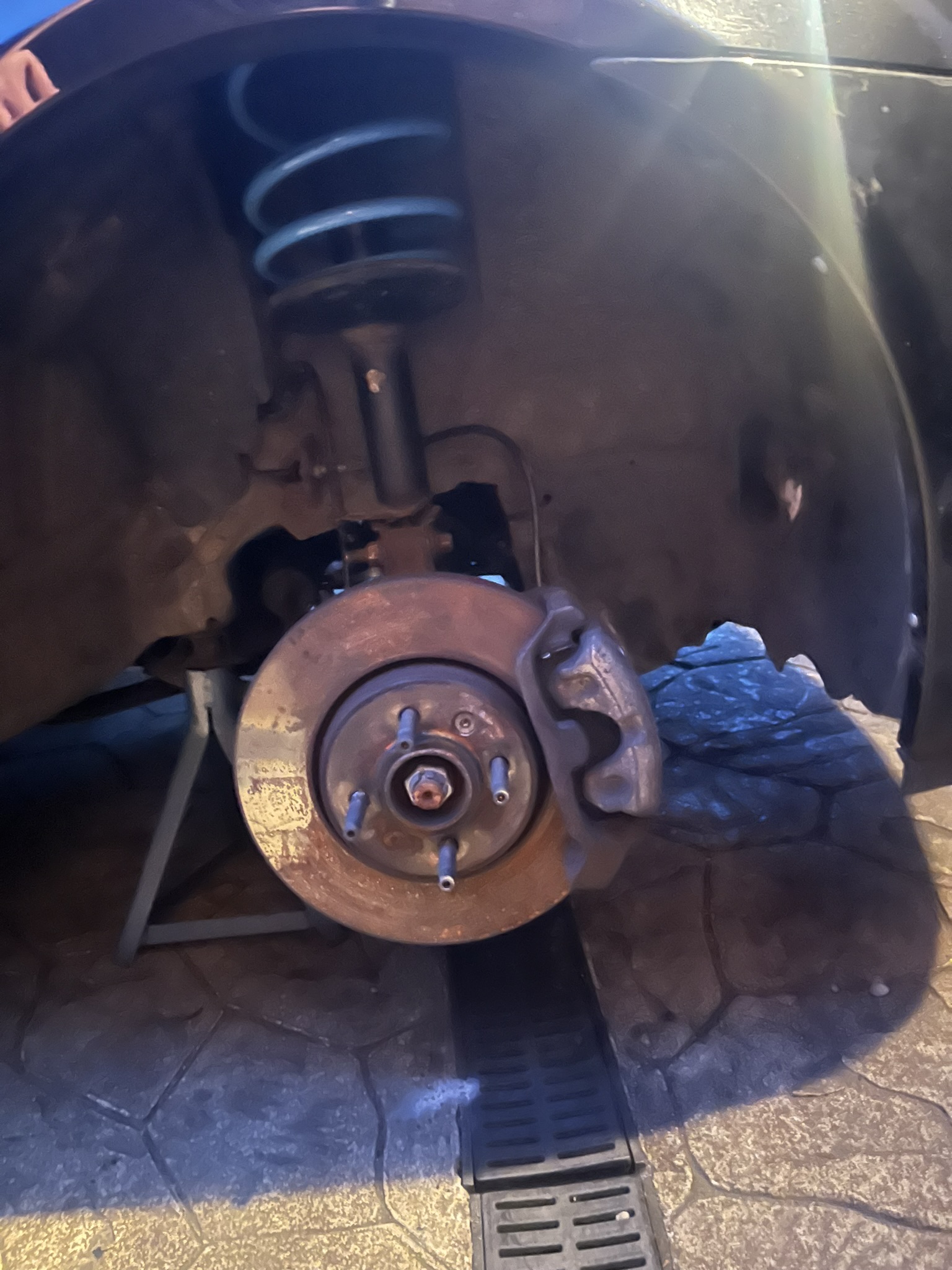

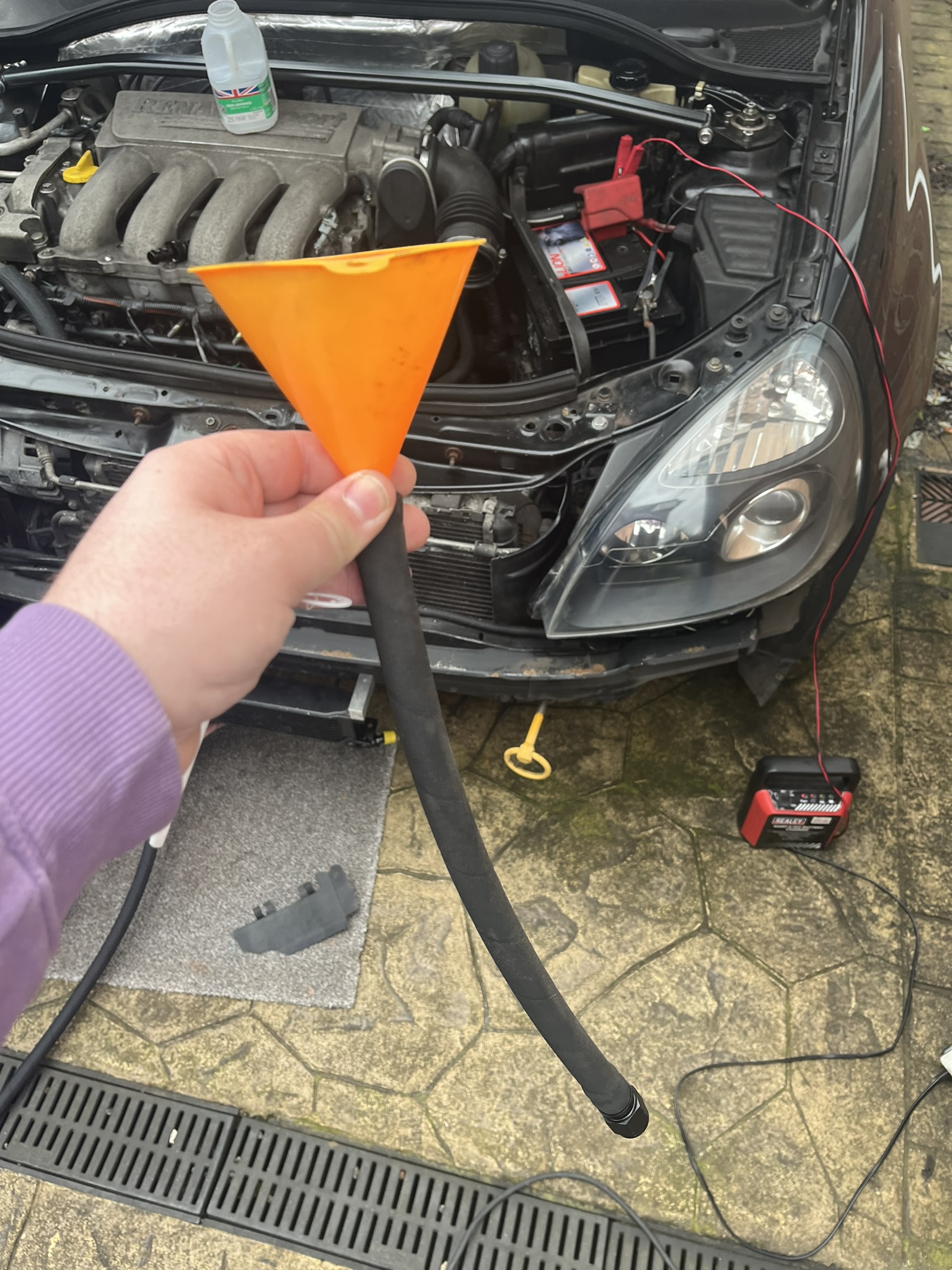

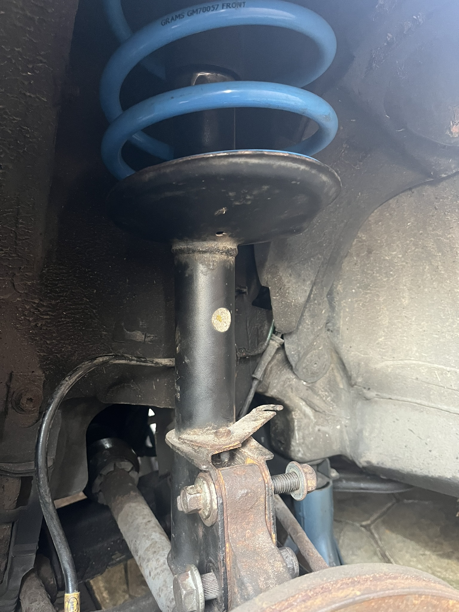

Decided to tackle the fronts. Due to lack of use, the battery keeps dying. I'm in the process of adding an external socket to my house so I can keep it on a battery conditioner, but in the meantime I just have to chance it. This isn't normally an issue, but due to the fact I'd taken the fronts off the other day, it was on axle stands. and because of my drive setup (I won't bore you) it was nudged over to one side. This means the passenger door (i.e. the only place you can put the key) was up against the house, and I'm not built for sneaking into narrow spaces.
An outside tap in the kidney is a great motivator to try and find a different way of doing things.

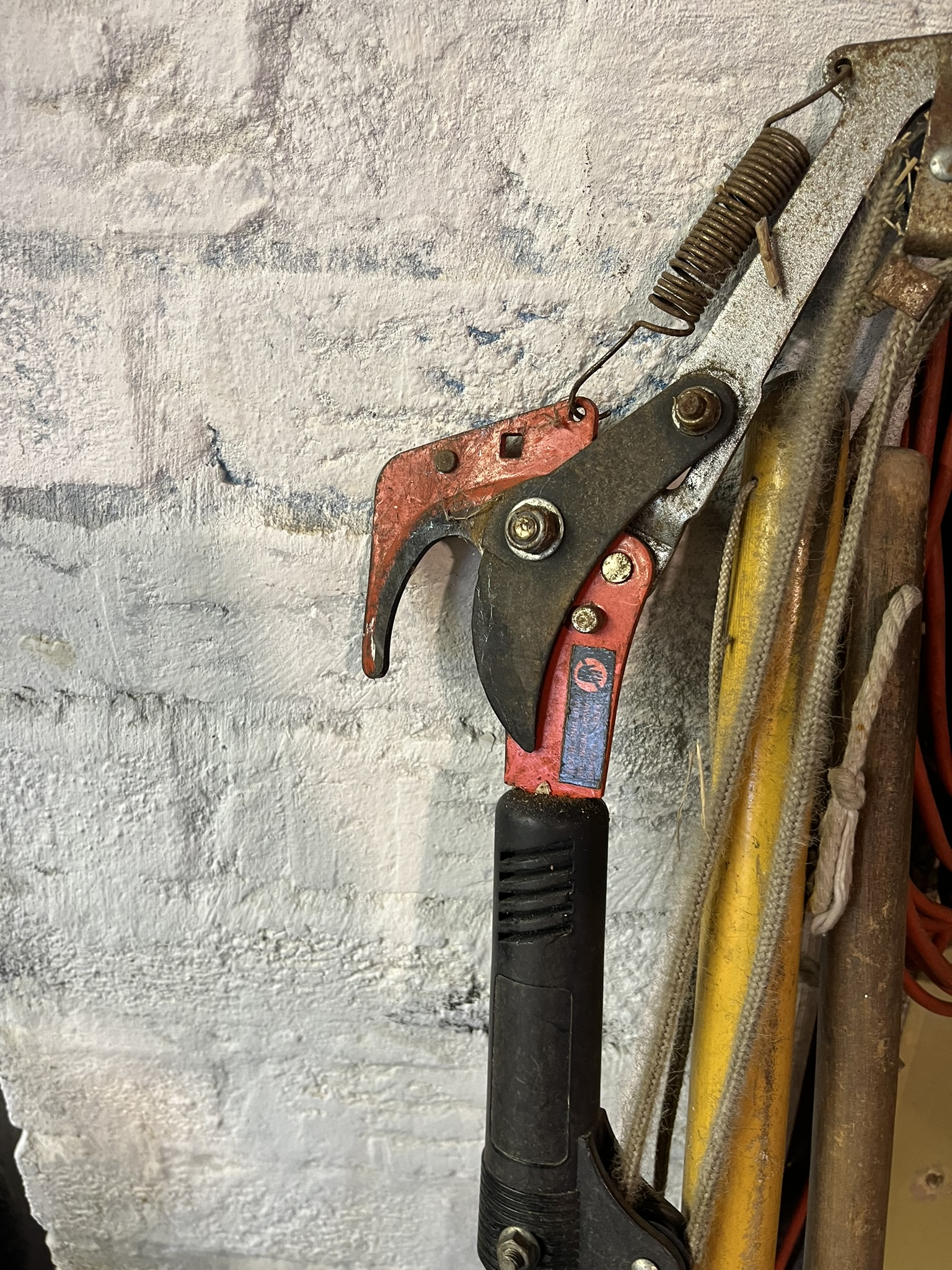

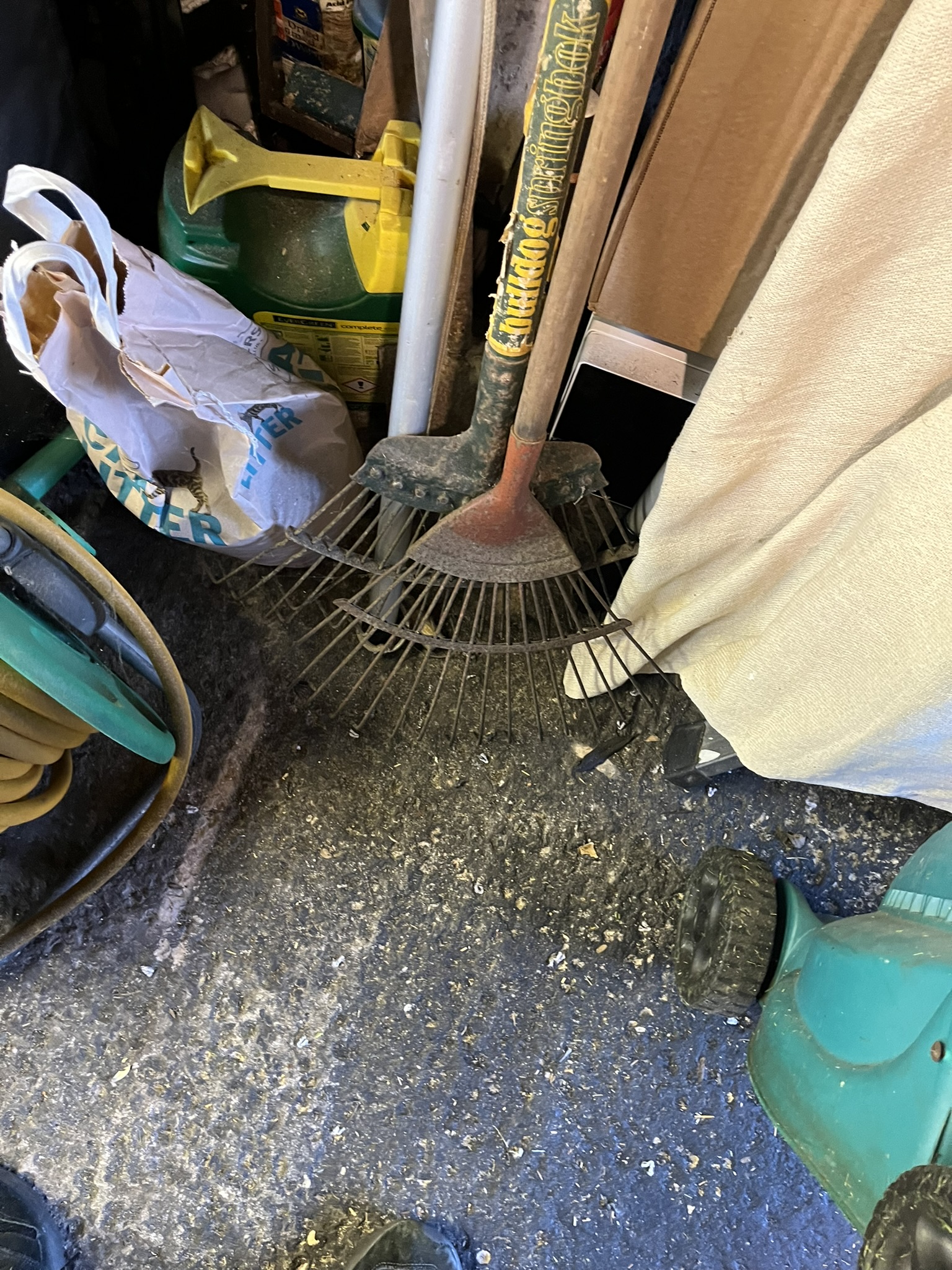

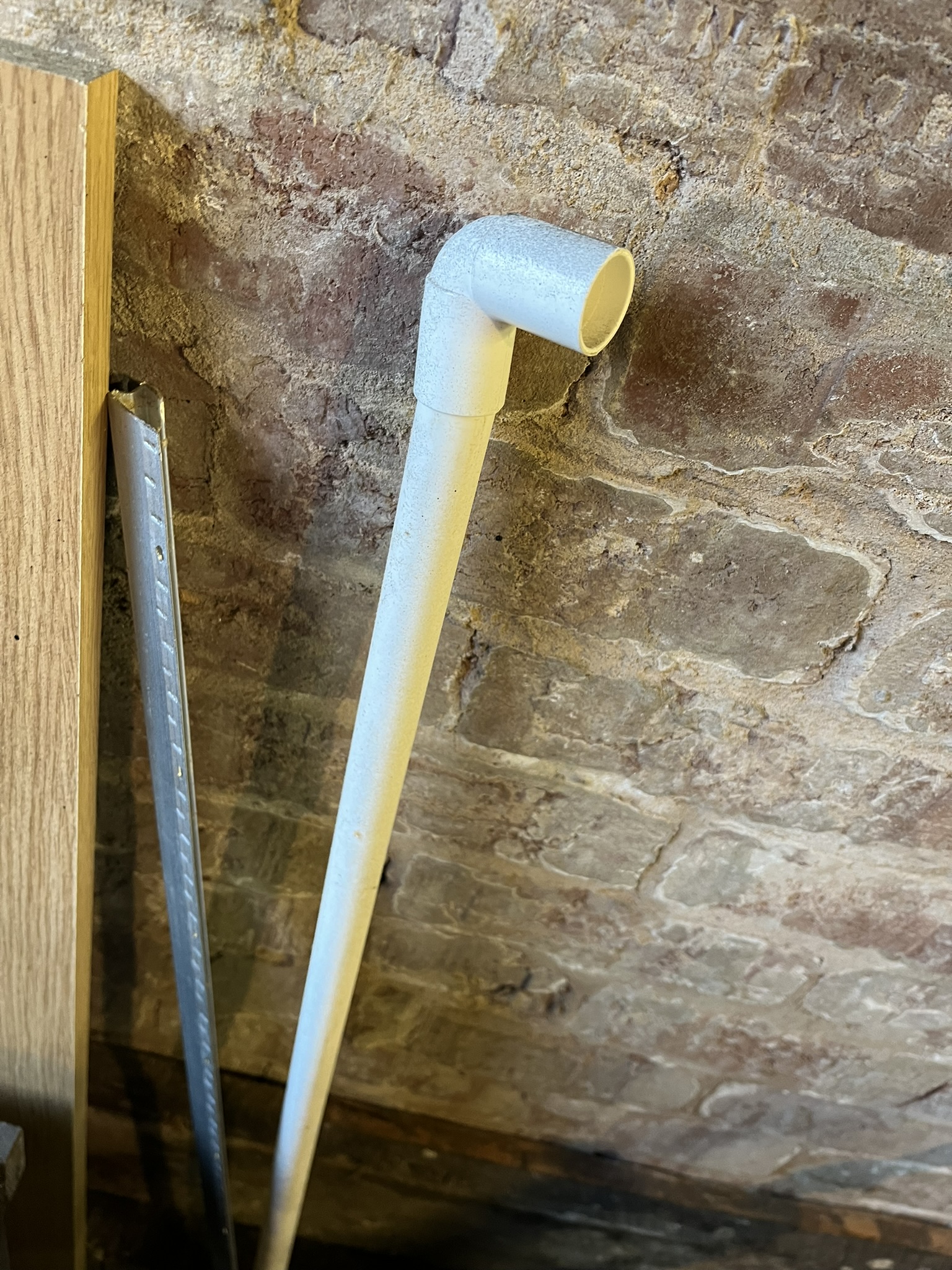

I could get the passenger side unlocked, and the door open, but couldn't get myself into the car, and couldn't reach the bonnet release catch.

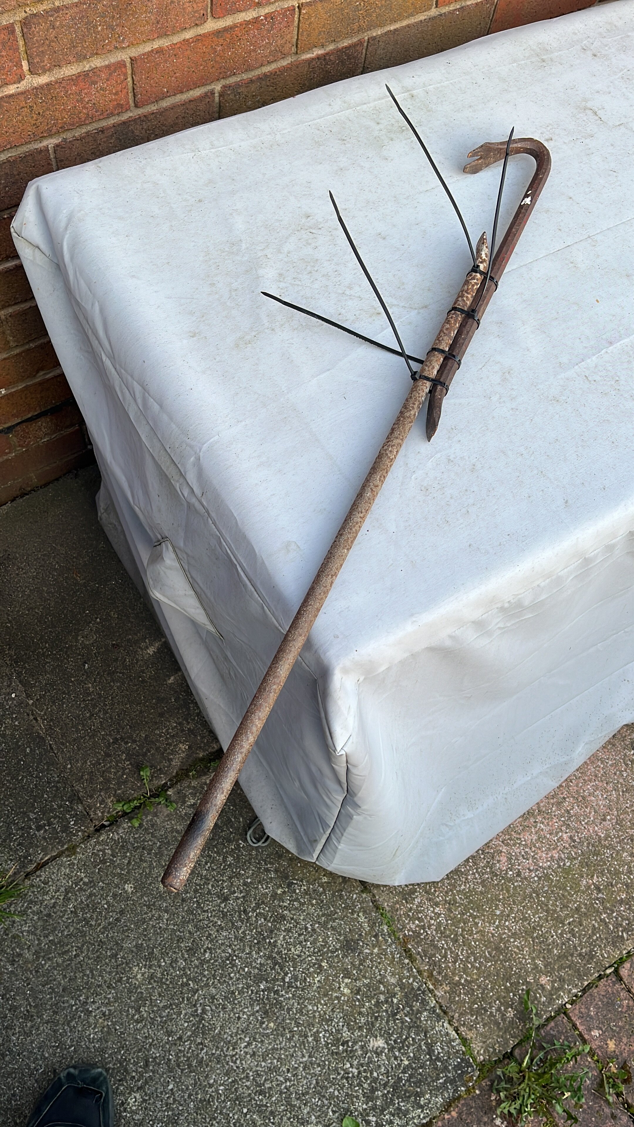

I then started angrily searching my garage for things the previous house owner had left behind that could be used to extend my reach.
Too flexible.
Mad telescopic loppers seemed like they'd work, but I couldn't get purchase with the hook.
Couldn't reach with this.
Was clutching at straws a bit with the rake.

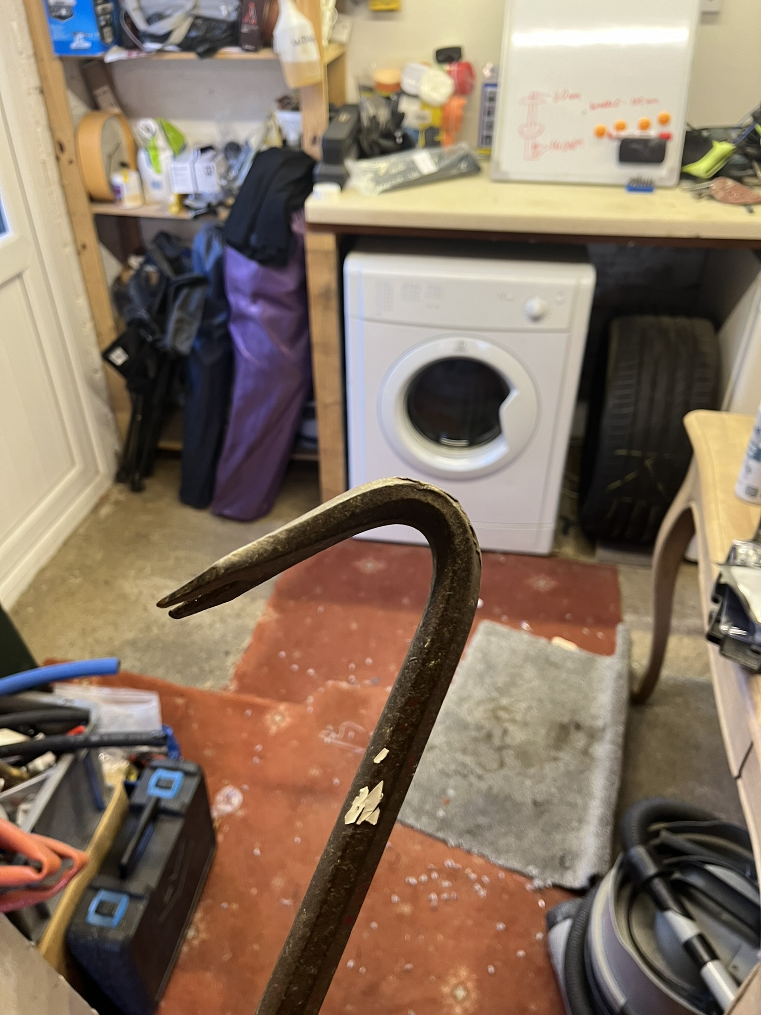

And then, in a moment of anger fuelled A-Team inspired inventiveness, I present to you...
Super crowbar!
It worked!
I could the continue with refitting the struts.
Before:
After:

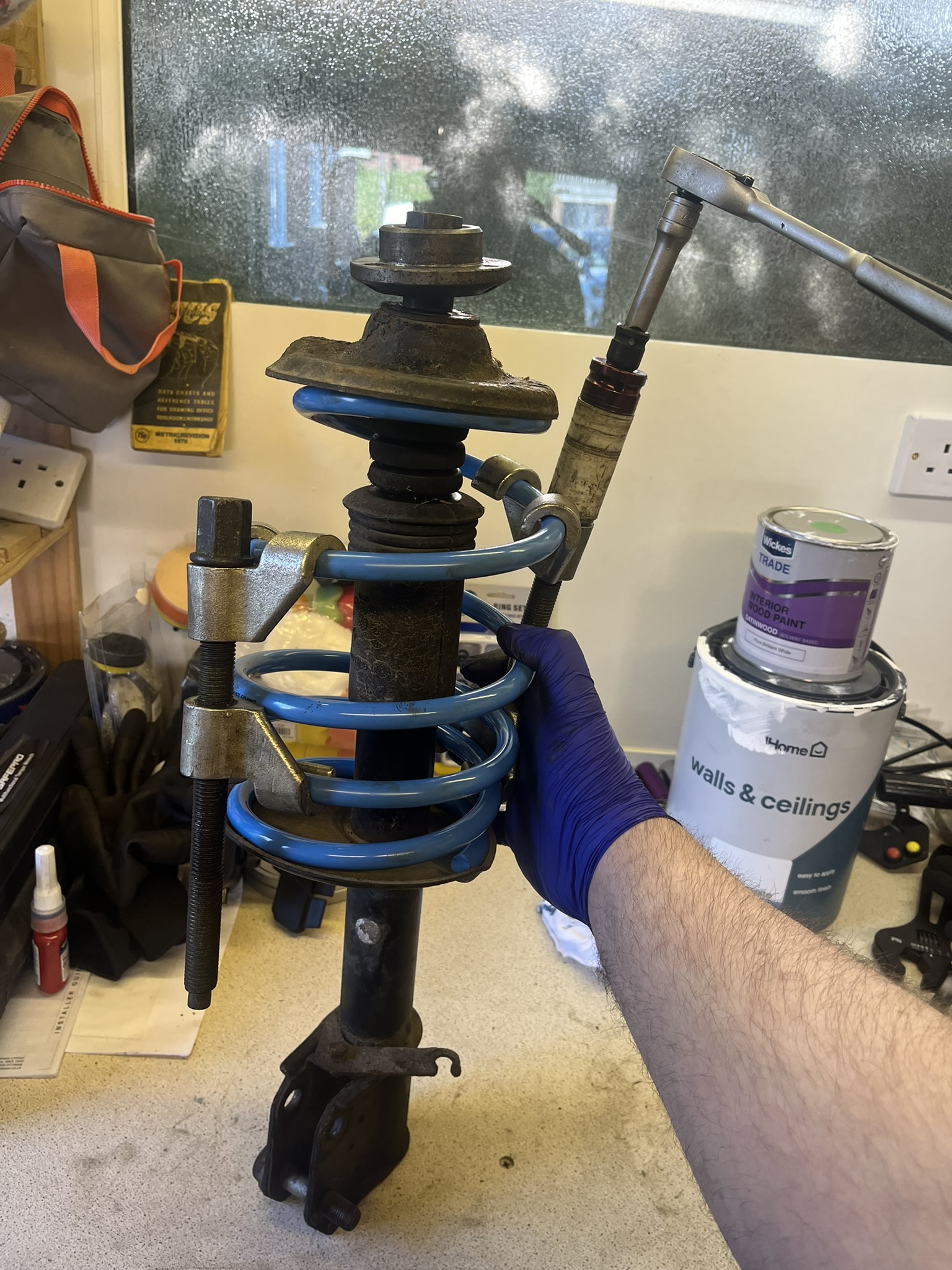

I'm planning on swapping to Koni adjustable shocks at the end of the year so not too concerned about the scruffiness of the shocks.
There's nothing like working with loads of room and easy access. And this is nothing like that.
JimF
  Clio 172
In. On. Reassembled.
Set the camber using the Eibach bolts. Sounds crude but I know that max camber is approx -2.5deg (Think its -2.4 one side and -2.5 the other), so set it to max. I've had it like this before and love how it drives.
Good to see it with some negative camer again! Needs some spacers but thats just me being a tart.

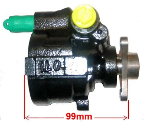

I've not driven it since the above, but I've had it idling on the drive hoping it would put some juice in the battery. Not sure if it actually does (It didn't on my Impreza due to the "smart charging" system it had. But tried it anyway.
Bad news is the PAS pump is noisy again. Now I've not ran it without fluid, but the fluid did get VERY hot at Blyton last time, and I'm just hoping I've not killed another pump. I believe the system is self bleeding, so my plan is to use the Clio for a few days to commute in, get it some fuel, some injector cleaner and a good wash, and then see what its like.

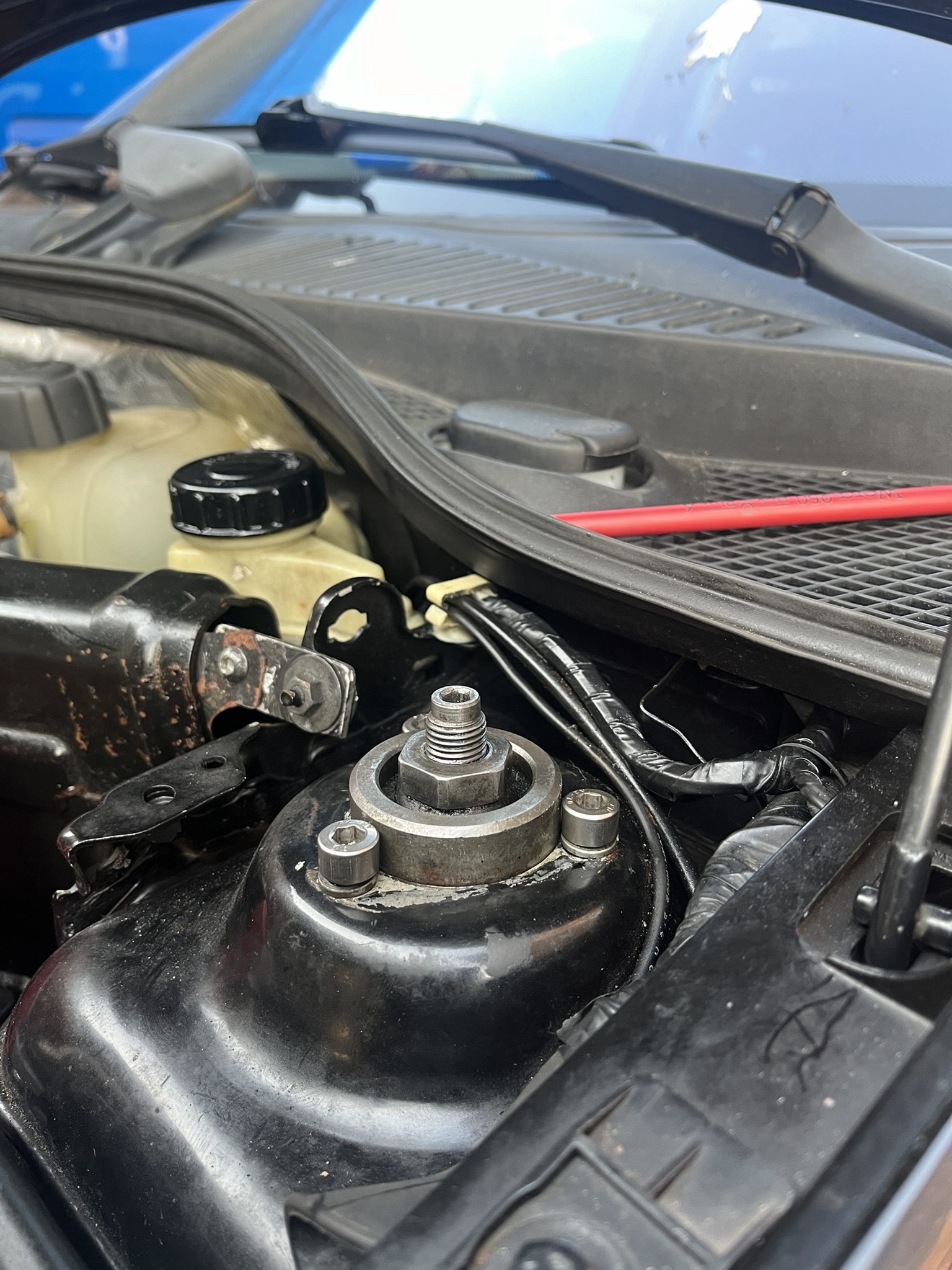

YorkshireKyle
Not all gingers stink of piss. But I do.
Good progress, I've fell foul of the car being locked and the passenger side against a wall🤣🤣
Also, you're missing the plate for the PMS top mounts. Please don't run them like that or the bolts will pull through the top of the turret and you'll die
JimF
  Clio 172
Thanks!
That picture was just when I had them in to secure the strut, I've since refitted the strut brace (y)
But thanks for noticing, good tip for the uninitiated, and keeps cars the right way up!

Power steering pump is definitely too noisy to risk a trackday with, so I've ordered another. It's my own fault really, the course of events was:
  • Overheated the pump and boiled the fluid, running the reservoir dry and shagging the pump.
  • Had the pump replaced, fresh fluid, and presumed I'd be sorted.
  • Did Blyton Park and had the telltale whine, but it would go away when the fluid cooled, so took it easy and kept at it.
  • Pump is now noisier than ever. So its getting binned and I'm getting my wrists slapped.

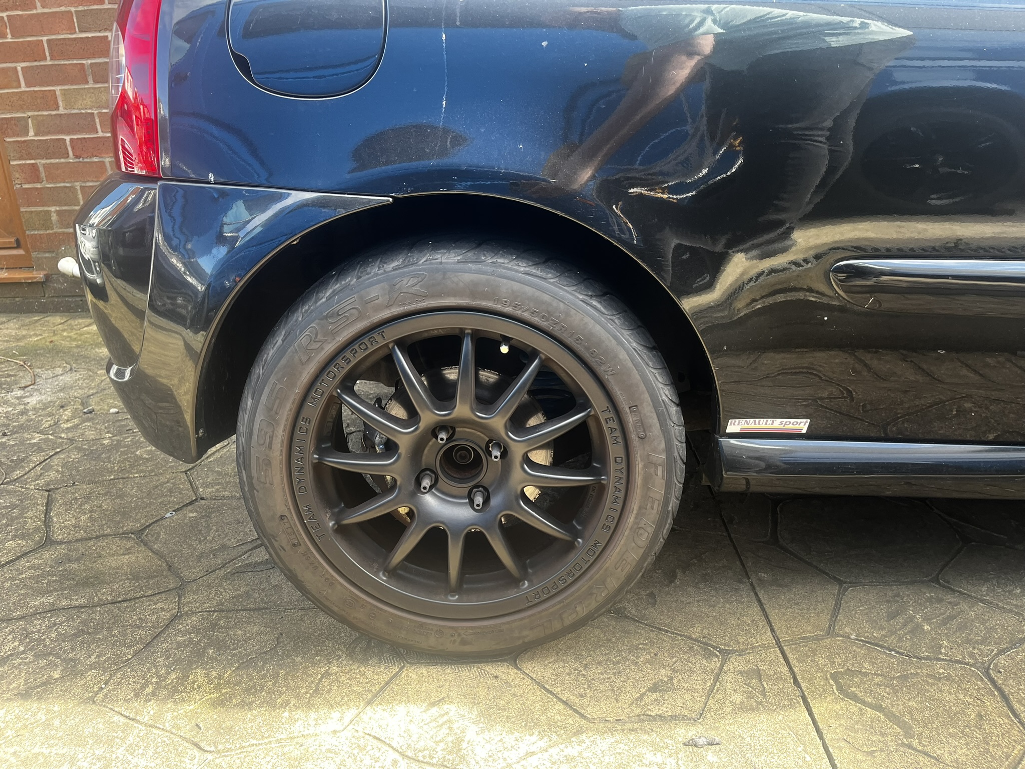

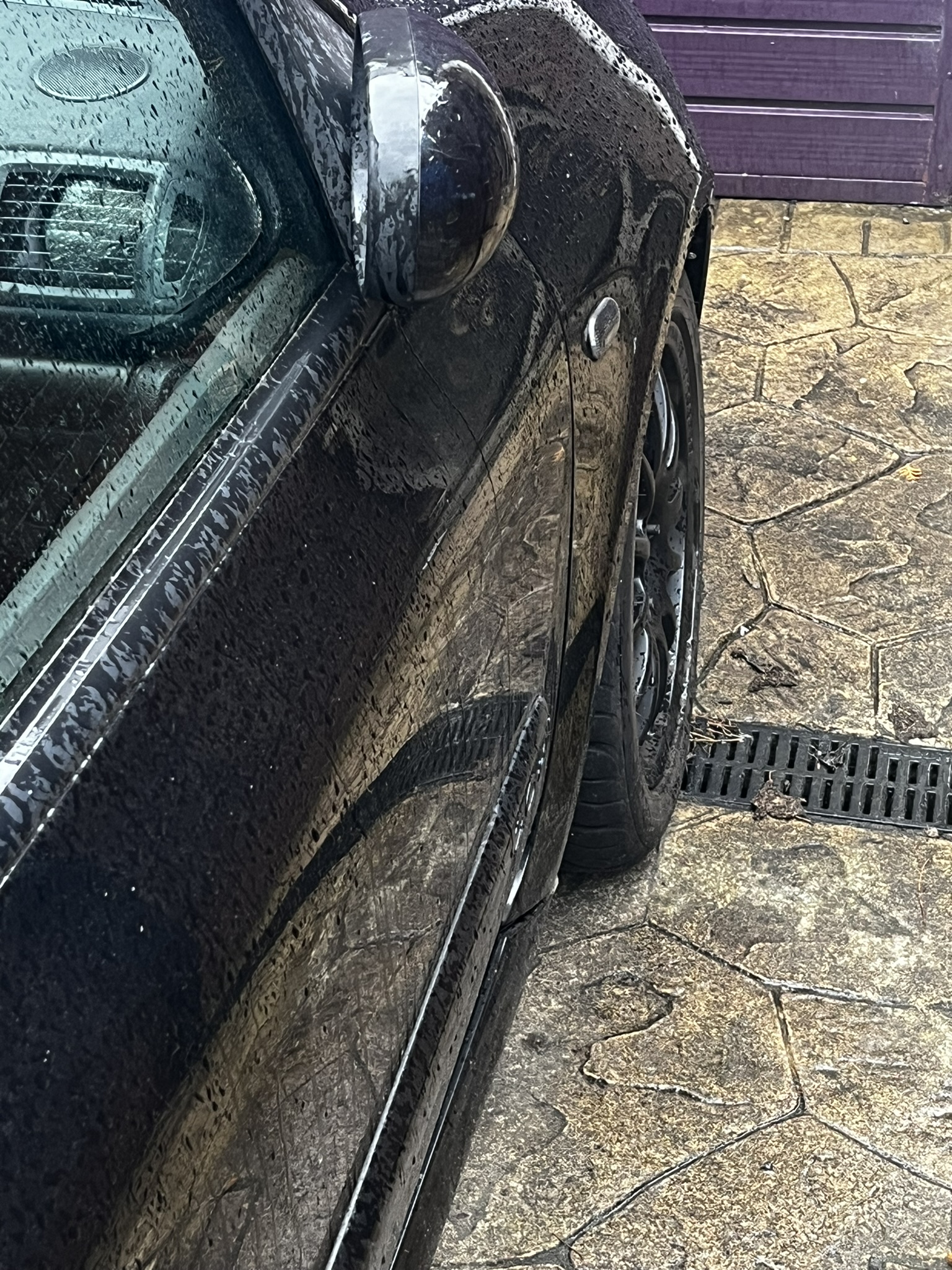

How many miles does it take for new springs to settle? I was thinking it was taking a while, but I've literally used it twice. So whilst it has been a good few weeks, its probably done less than 35 miles.
Still looks a bit monster truck spec:
JimF
  Clio 172
To be honest its done very few miles since then. Literally single figures. Life has massively got in the way. However I put it on charge today and didn't remember it being massively high at the rear. Will take a pic when the specialist has finished her under bonnet checks:
Just seen it's on 15" wheels.
The only reason I ask is mine is on Gram's all round, but it's to low. I bought some Eibach Pro-line's to hopefully make it a more comfortable drive.
