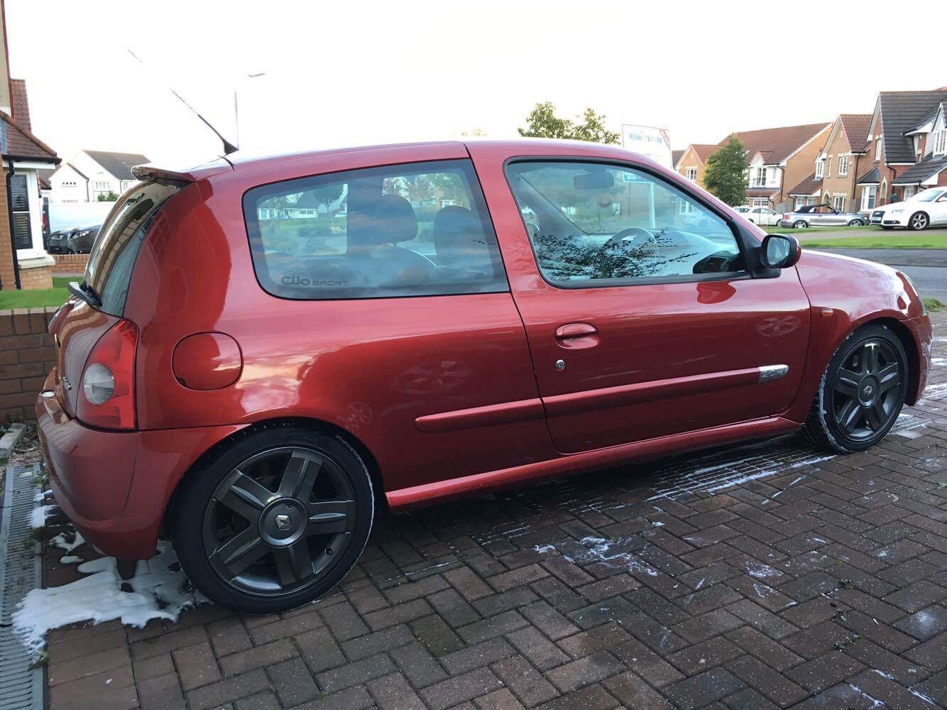

It all starts back in March 2016, when I purchased a ‘cheap clio’ to escape the never ending money pit that was my Audi A3 Track Car.

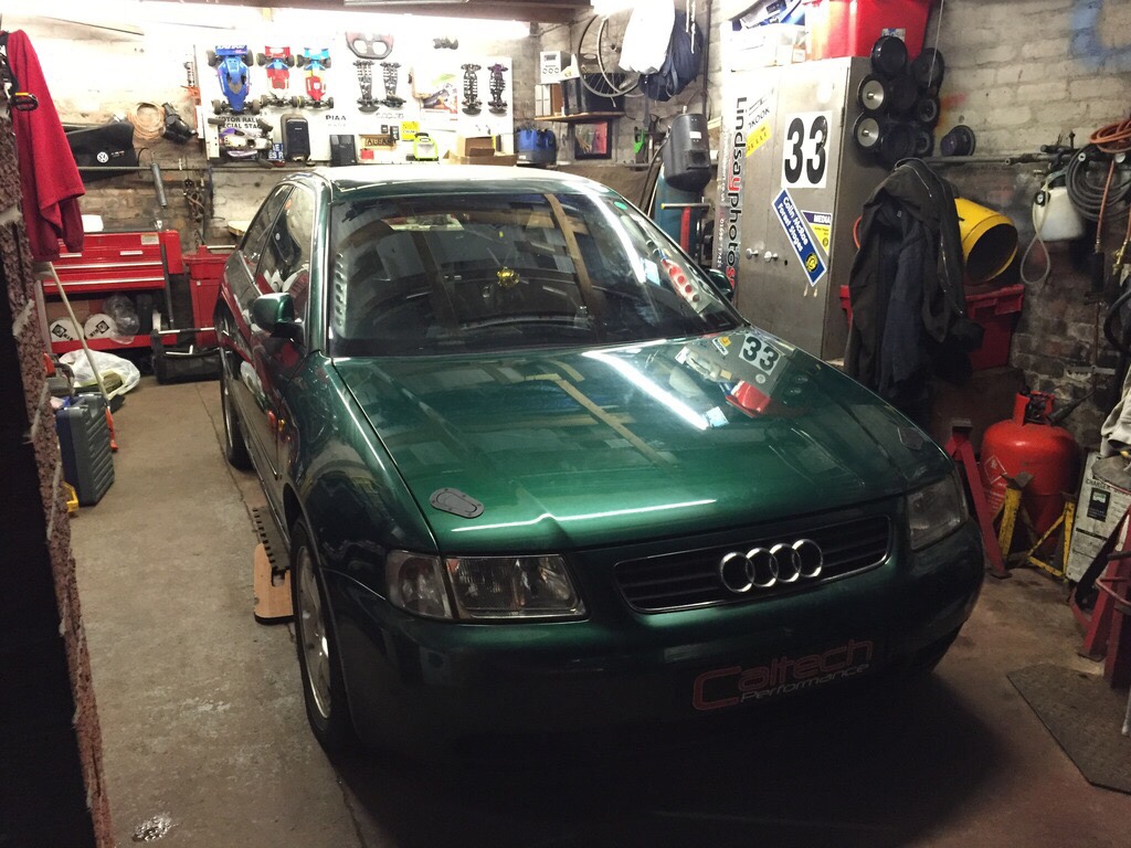

Some pics of the aforementioned Audi. The end just wasn’t in sight and I decided that I’d get a clio as ‘Cheap track car’ and just do the basics:

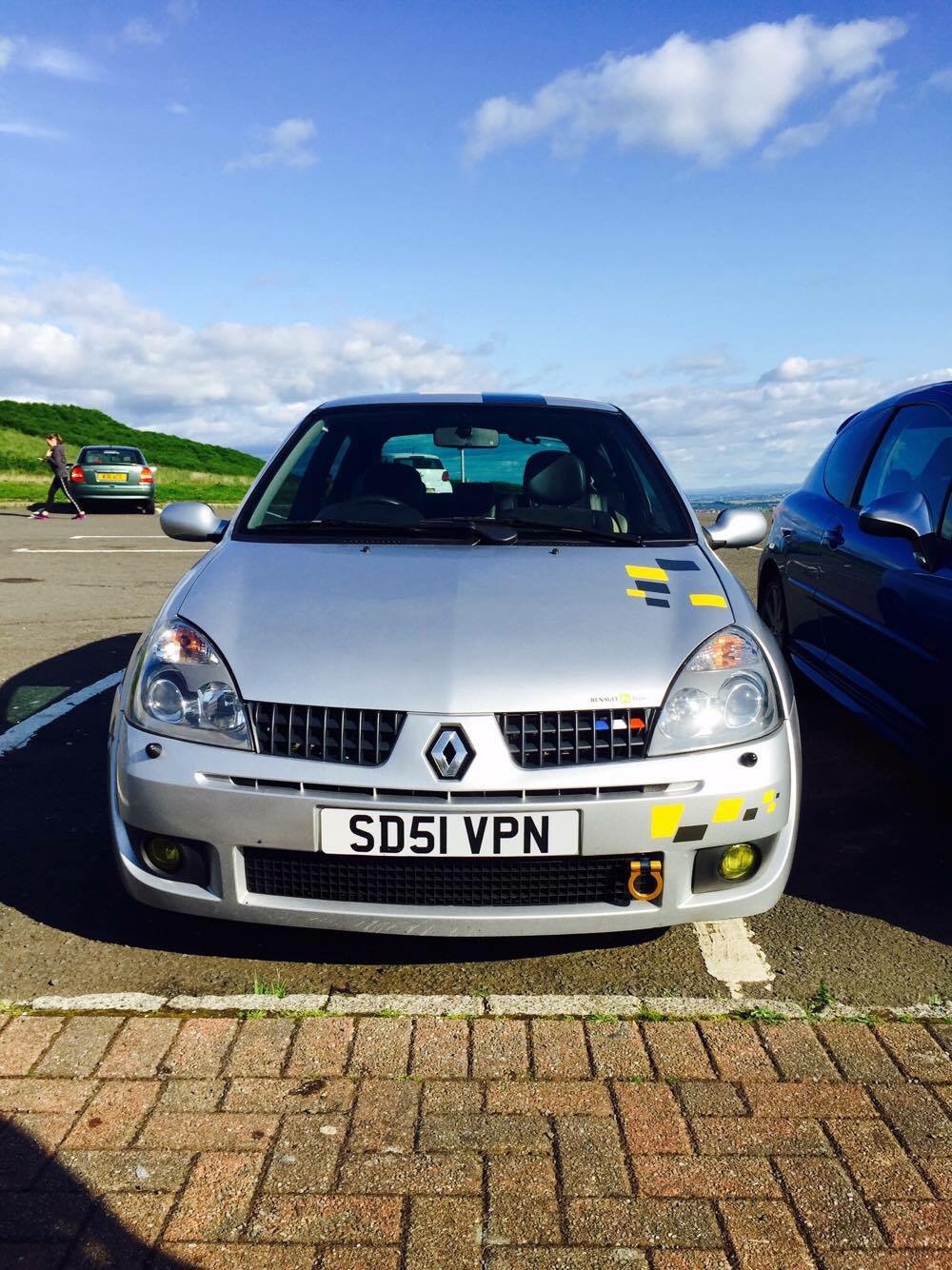

Nice car, it’s silver so it’s going to be fast :smile:

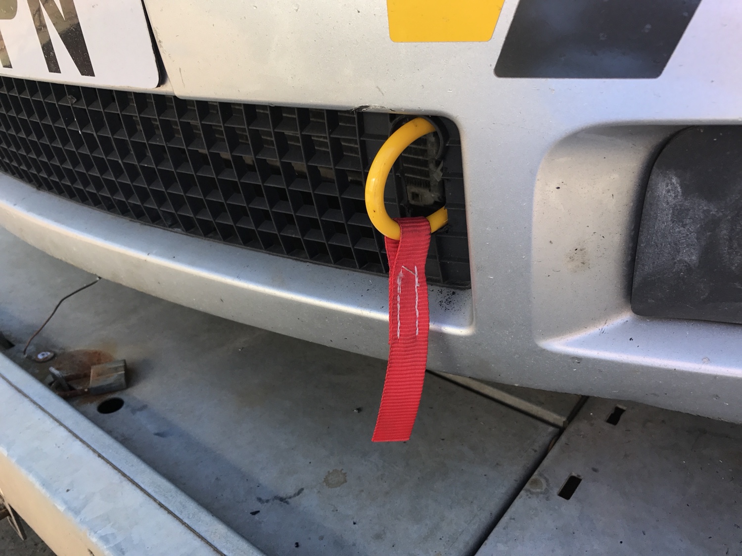

Silly question time! I’ve just brought the same tow hook but it’s to short to fit as the hoop would sit behind the grill/bumper. How did you make yours fit?
Cheers

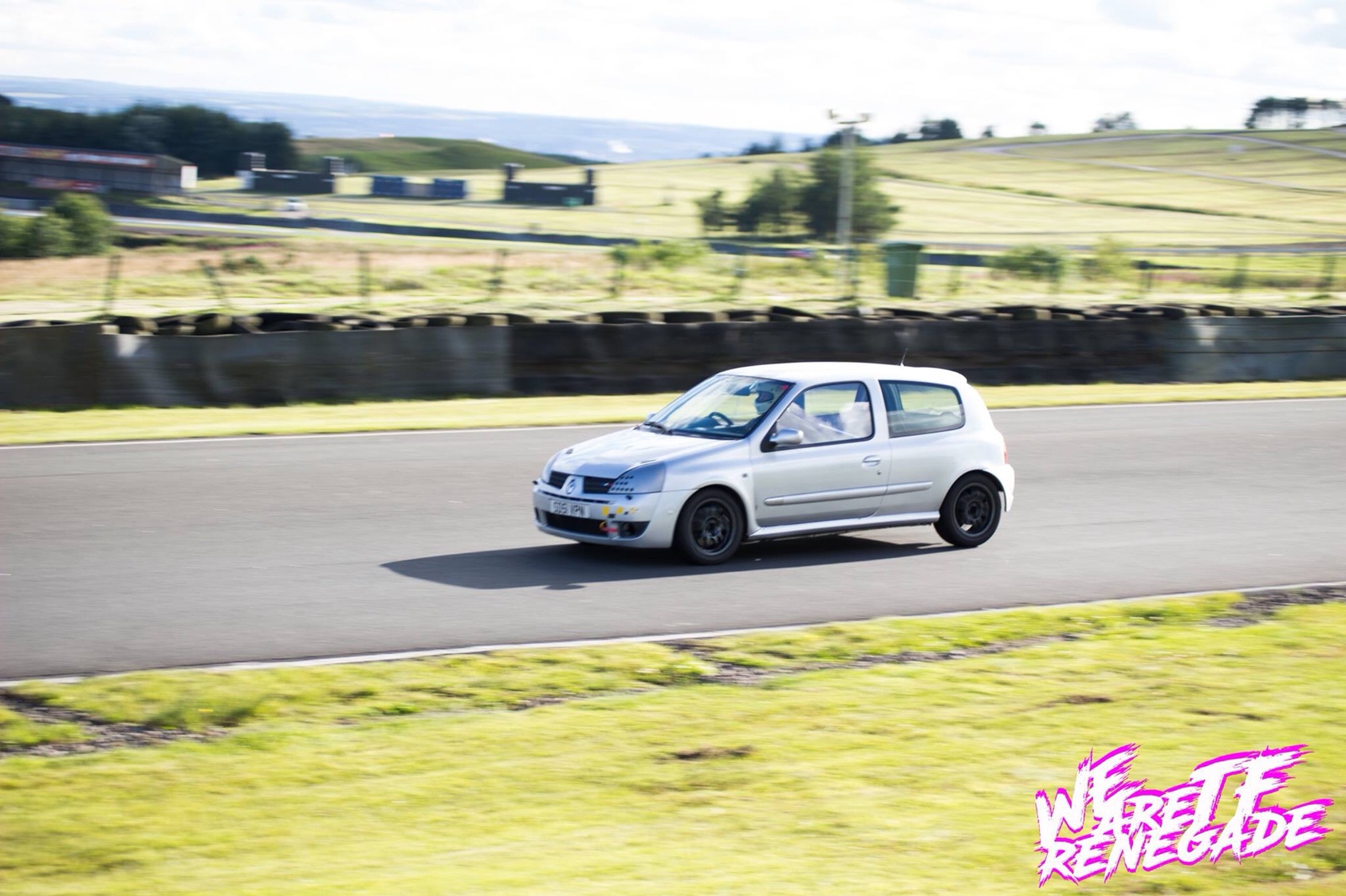

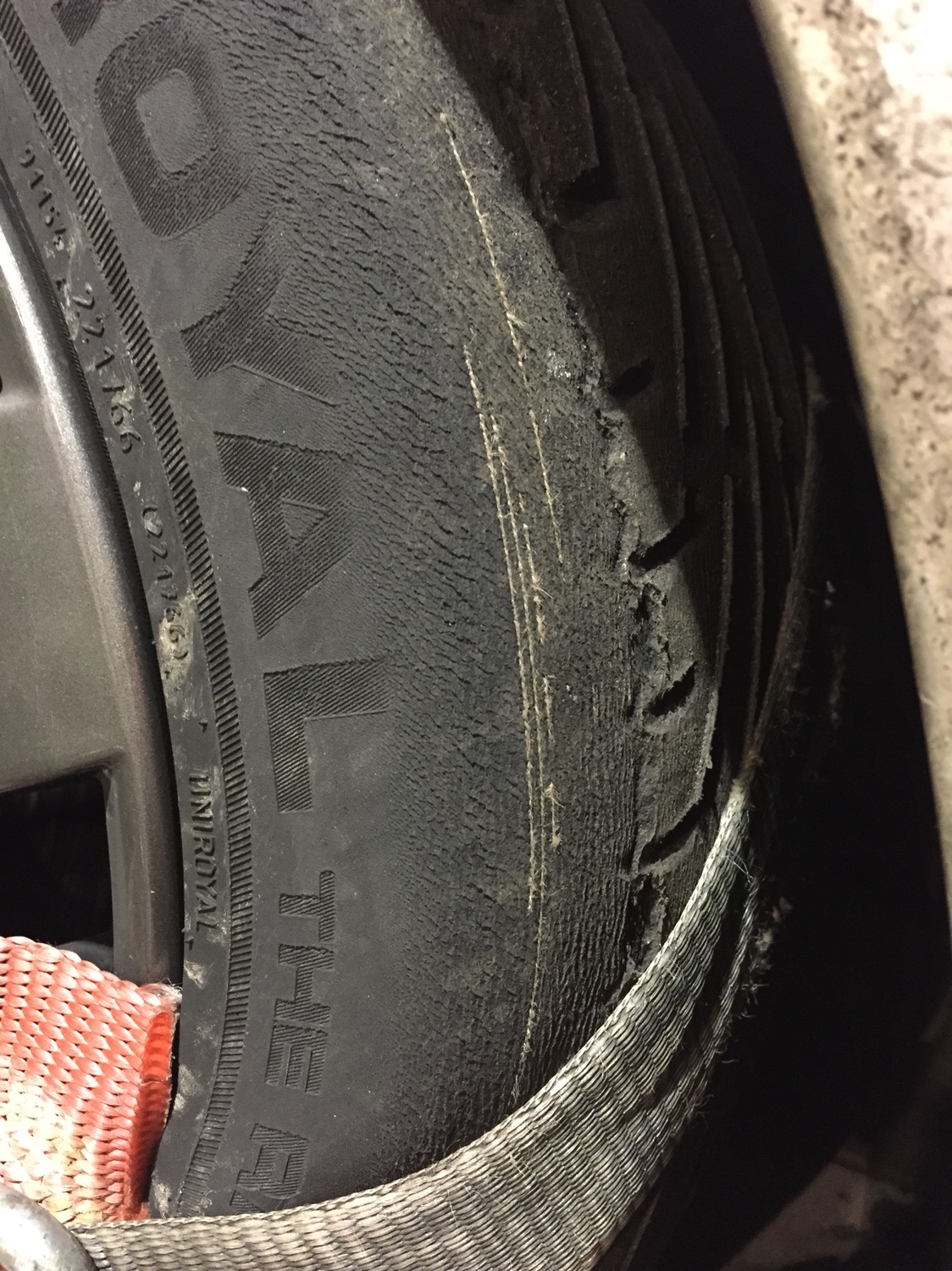

So after the Audi went it was time for the Clio’s first track day at Knockhill. It performed well for a totally standard car on shagged cup shocks and but the Uniroyals took a bit of abuse!
Cheers
It didn’t fit lol...
Was on the car when I bought it and swiftly thrown away - seemed to only be there for looks!

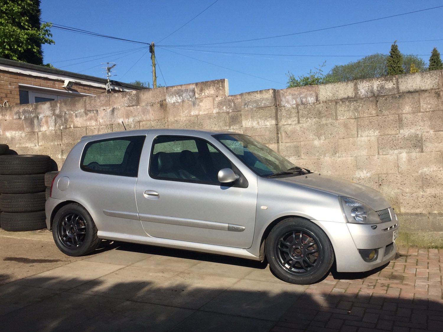

So after the first track day didn’t kill the car I decided some upgrades were in order. Starting with a nice set of 888R’s

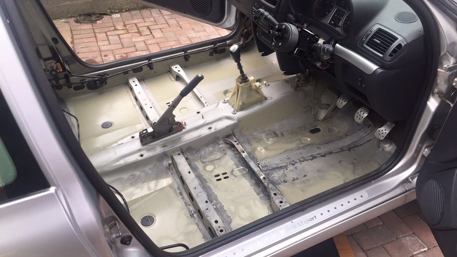

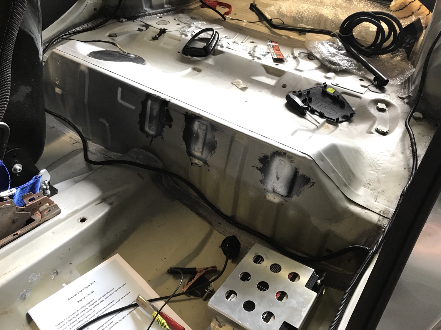

Then some weight removal:

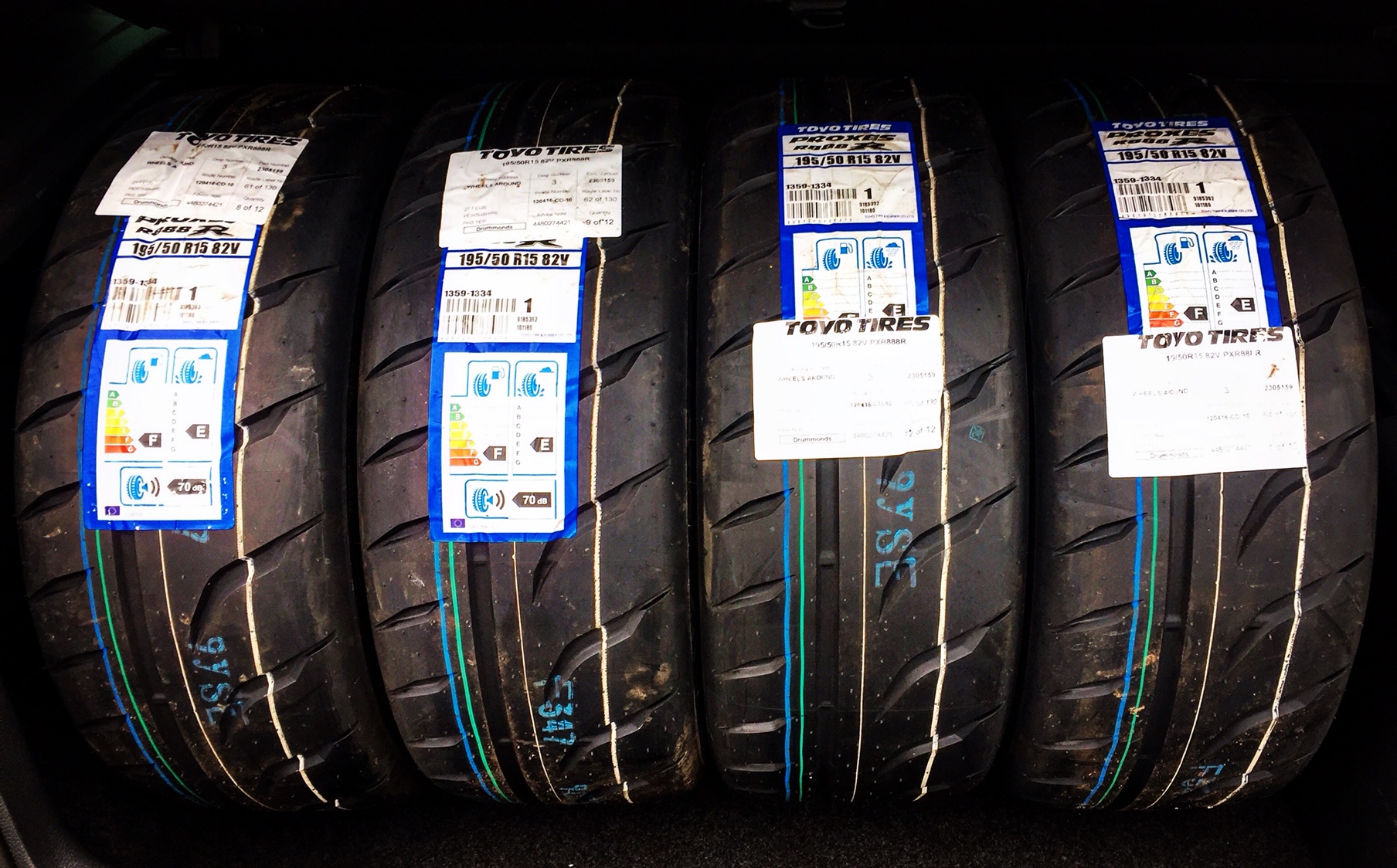

The Tyres fitted to my new wheels:

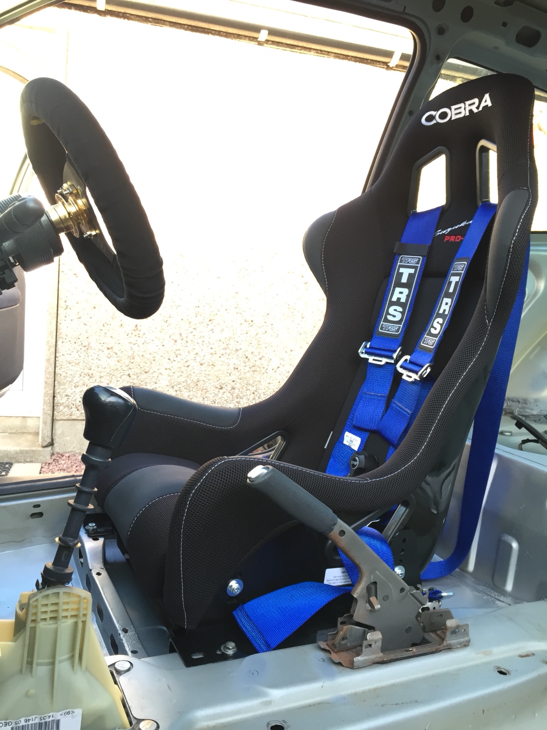

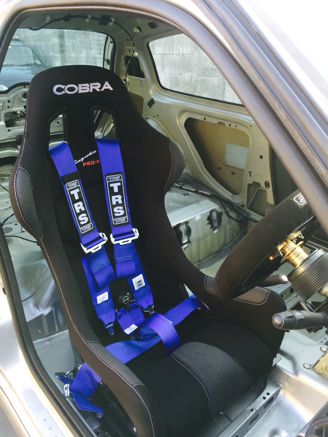

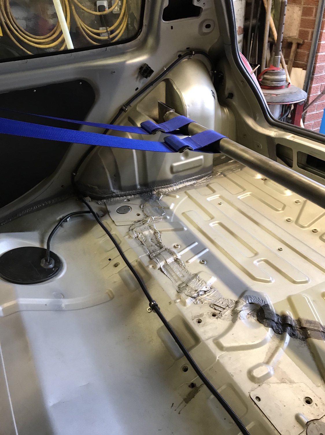

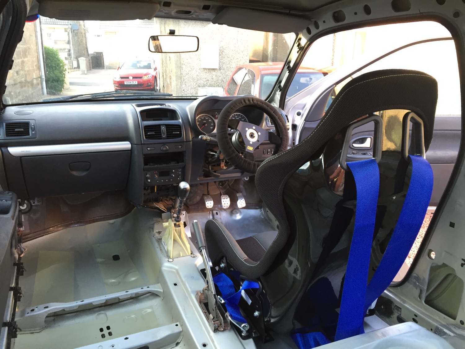

New seat, harness and mounting bar:
So that was it all back together and ready for it’s next track day. I also fitted brand new Cup Shocks and Cooksports springs at this time, but I don’t seem to have any pictures - you all know what they look like.

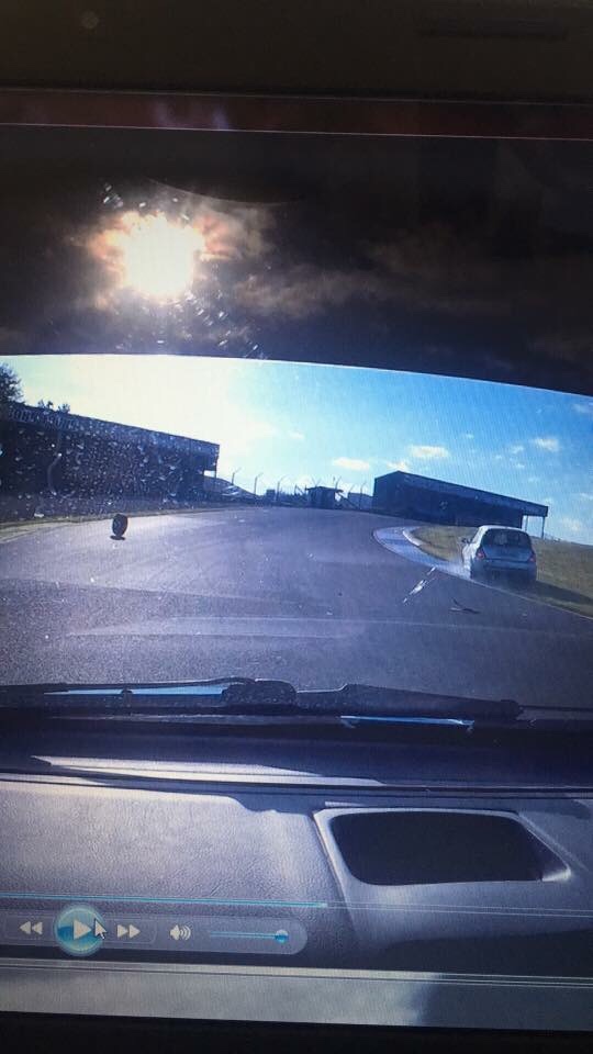

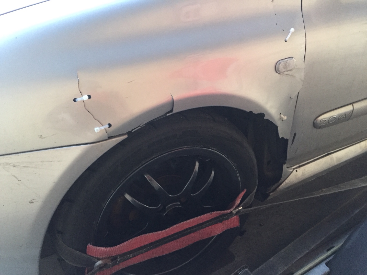

This happened though...
One of my freshly powered-coated wheels decided that it wanted to part company. No real damage though, just the wing. So continued with the rest of the night.
Replaced the wing and done another track day:

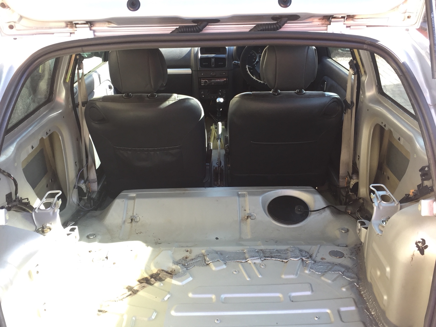

Then I started work on my car, weight saving to begin with:

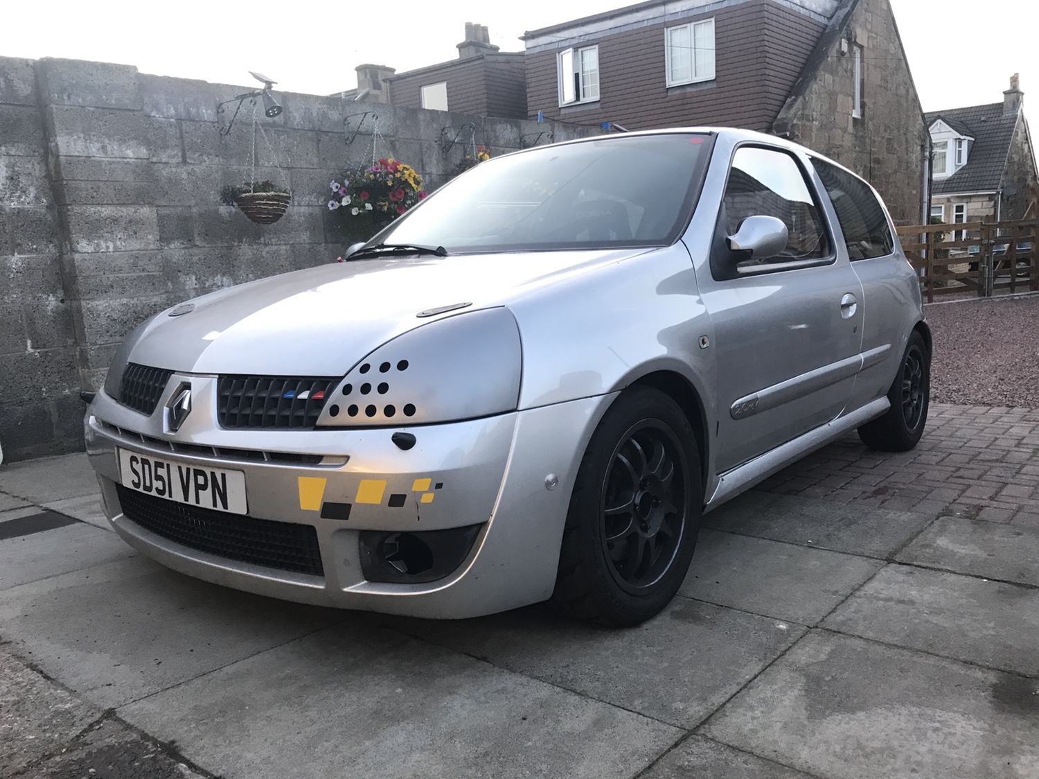

Fitted my PMS A/C Delete:

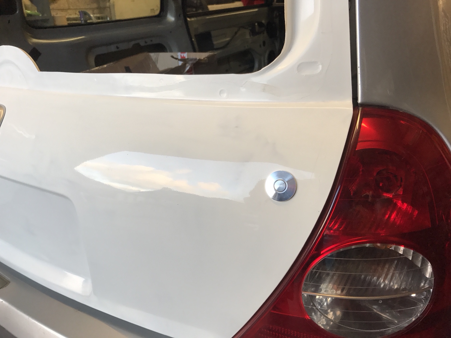

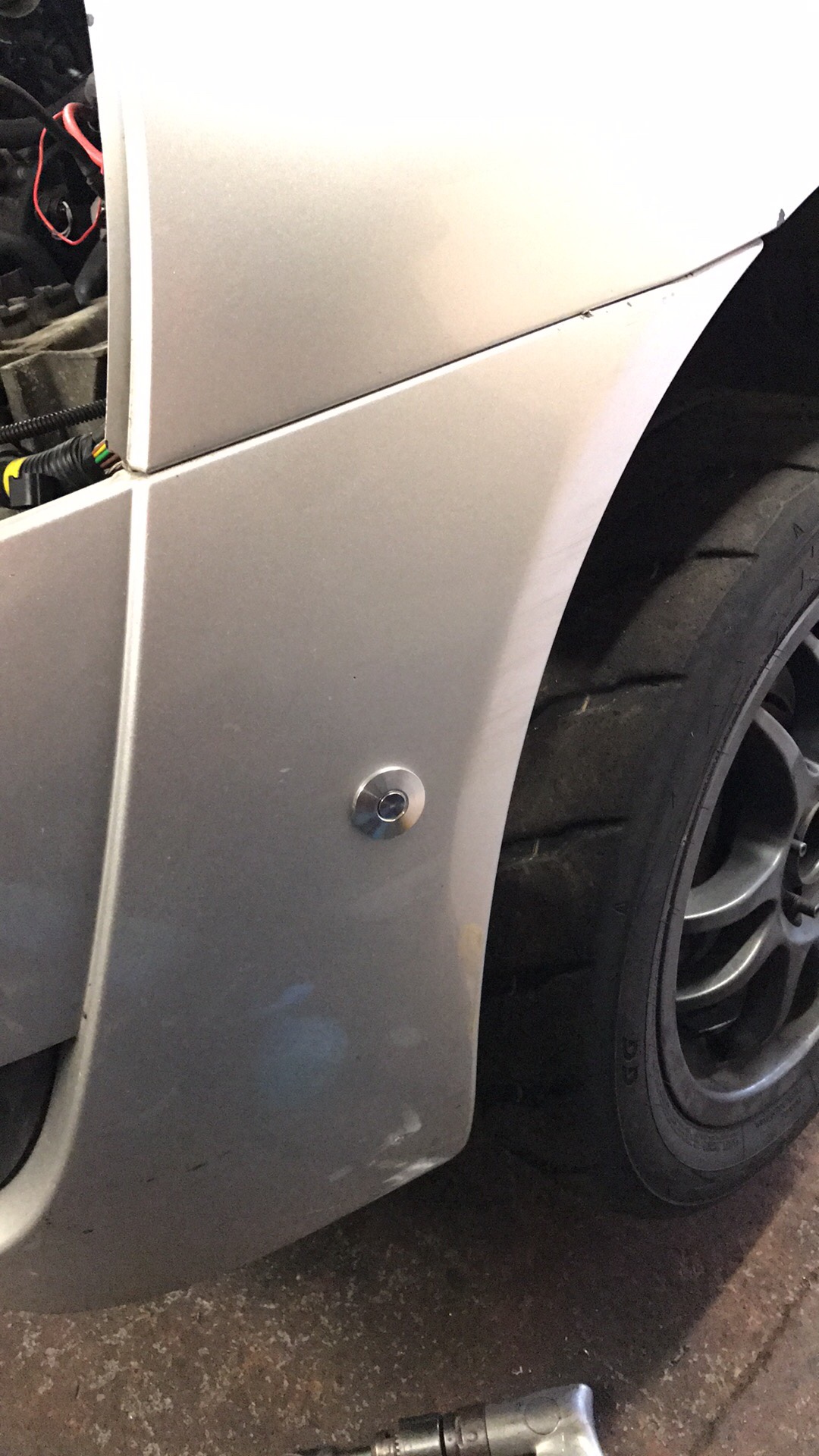

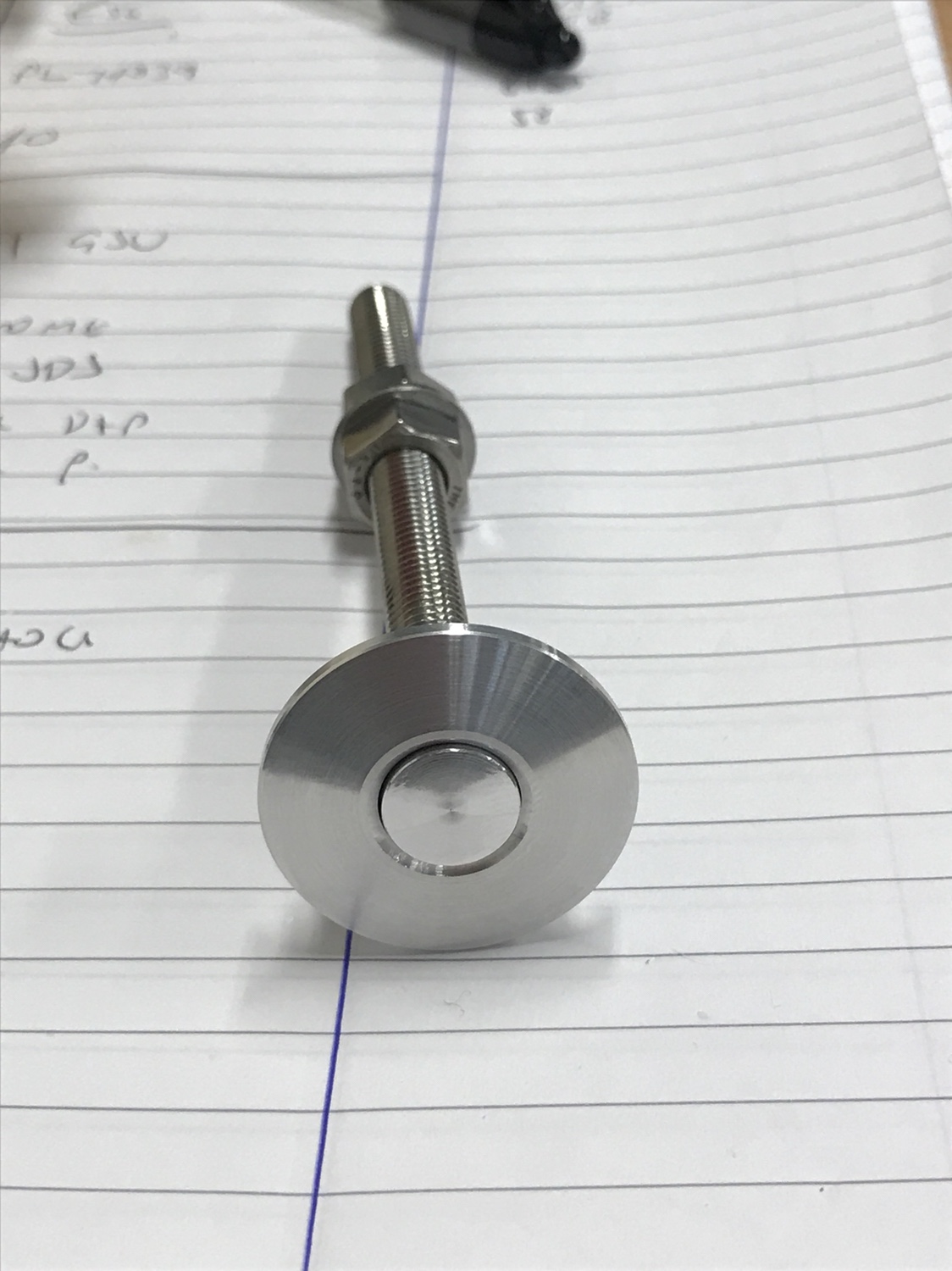

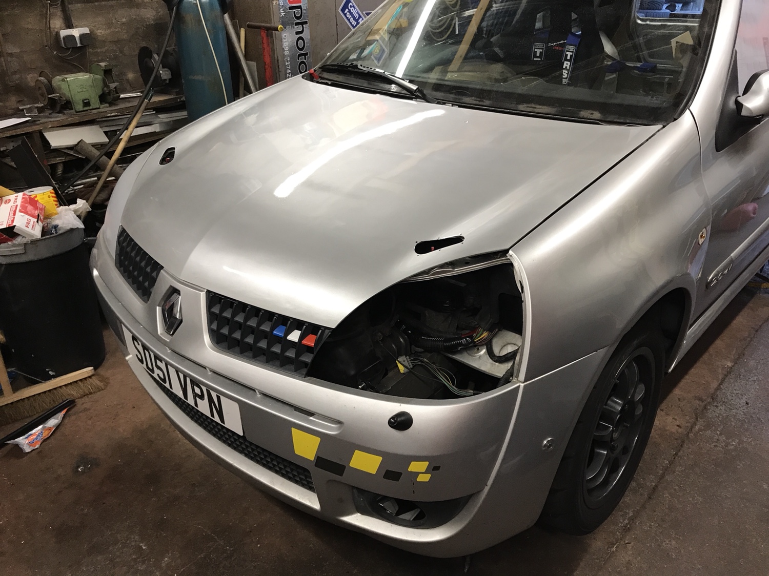

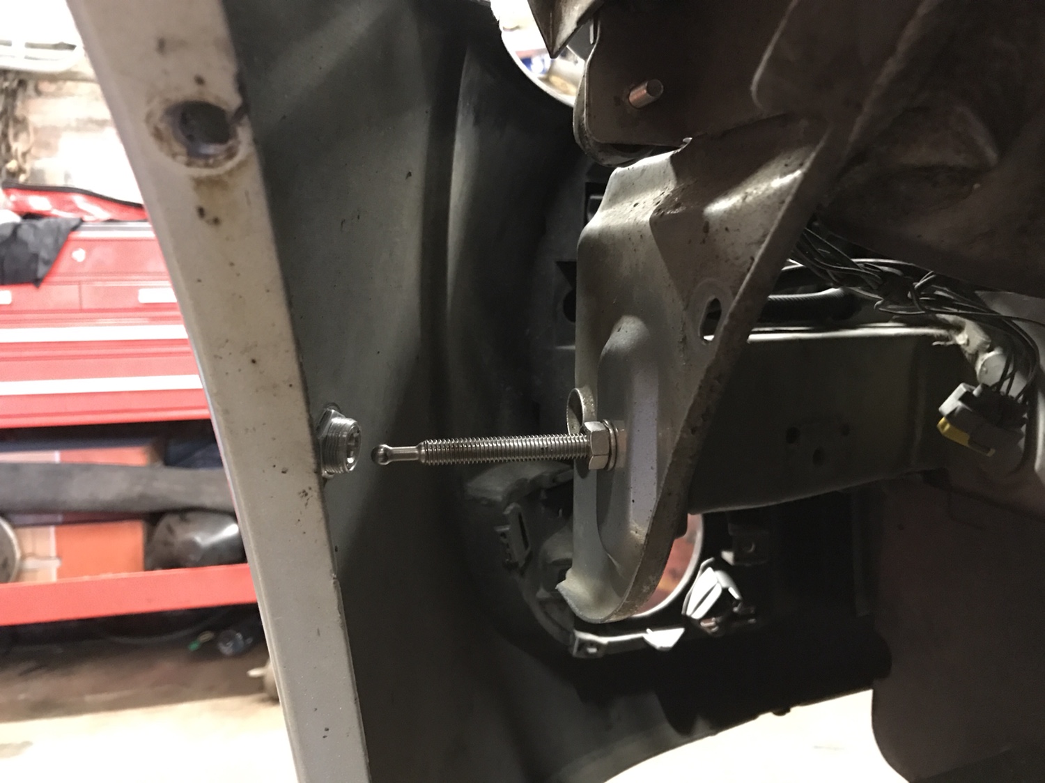

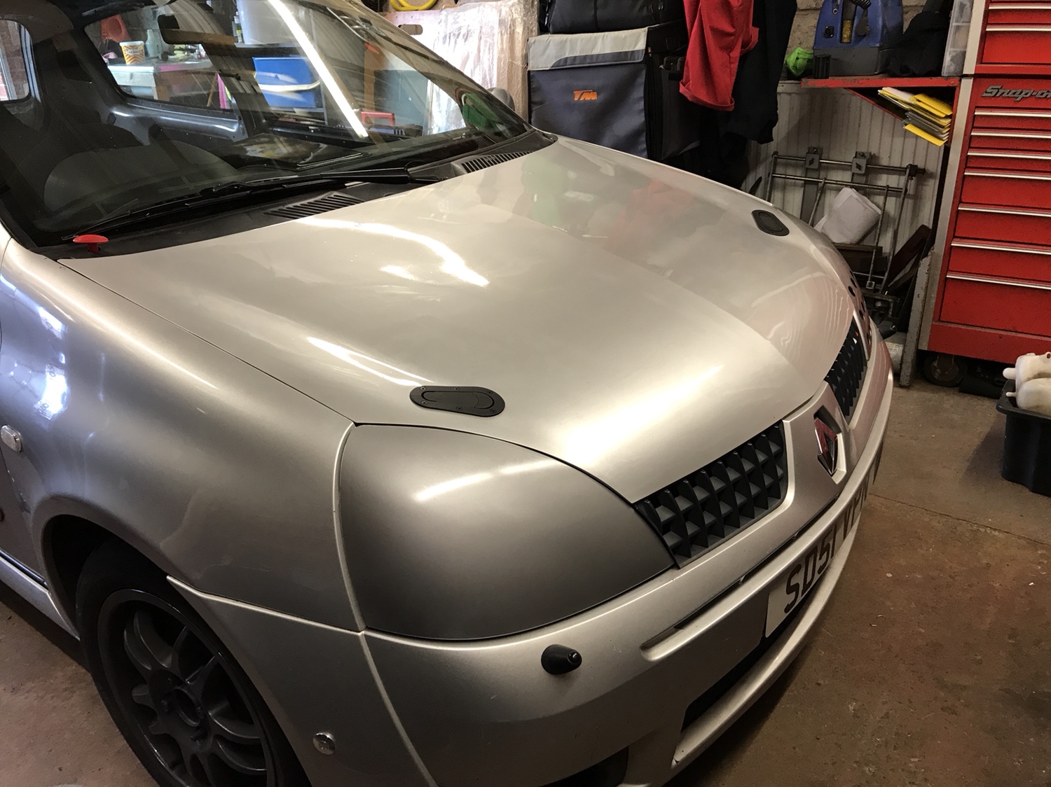

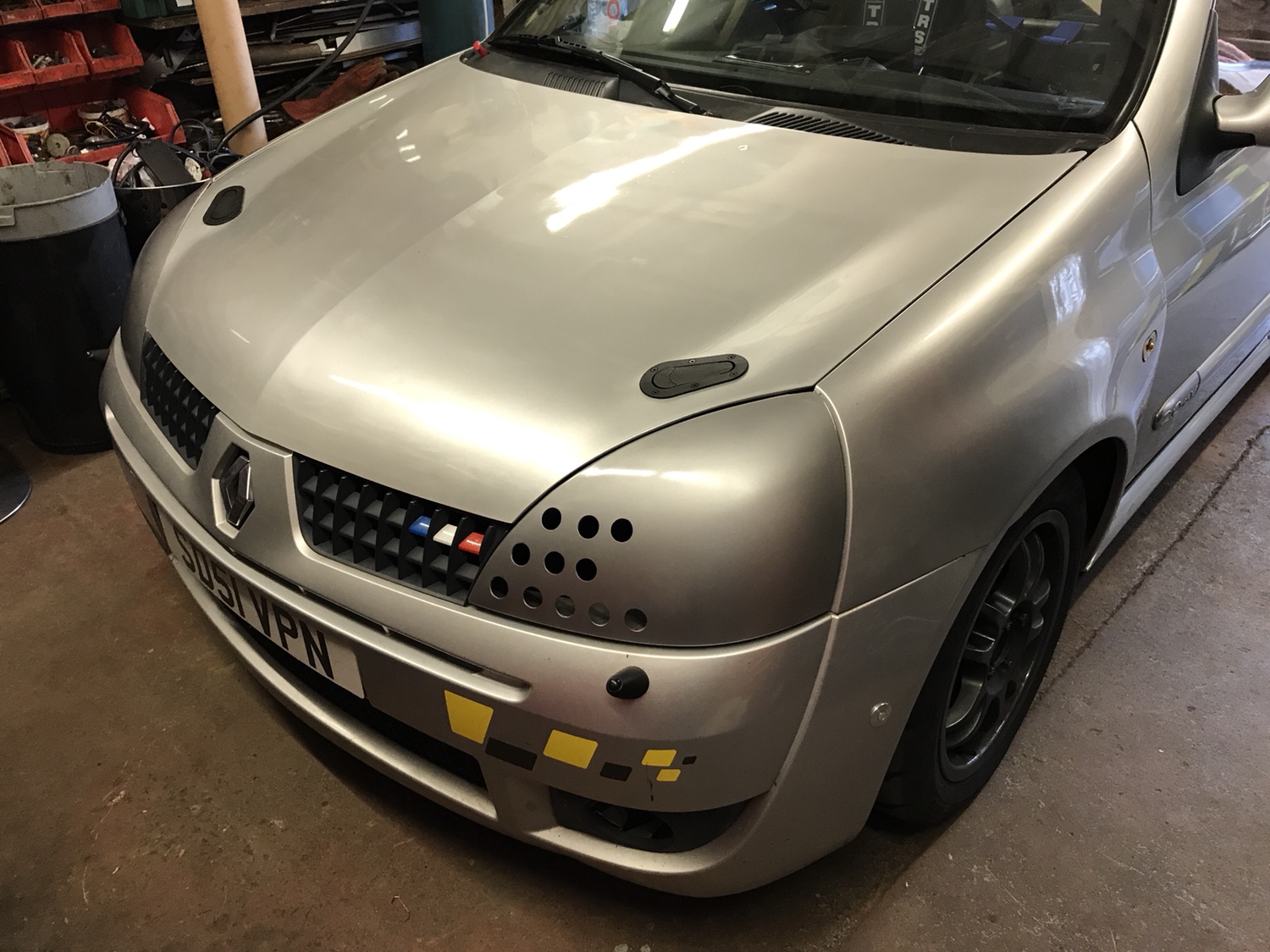

Fitted headlight blanks, made the front bumper quick release and fitted up the tailgate and bonnet:
And so by March 2017 it resembled a car again...

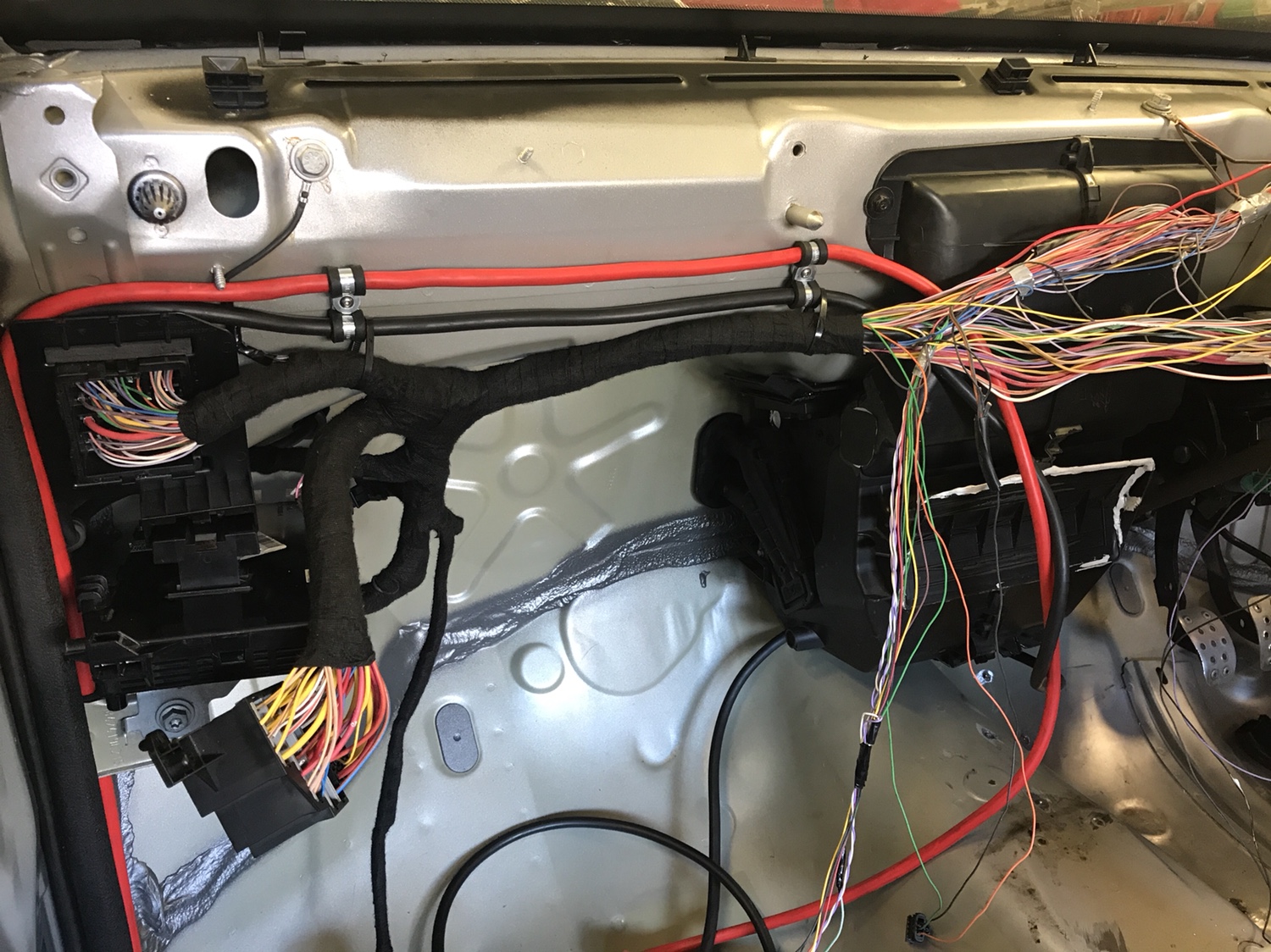

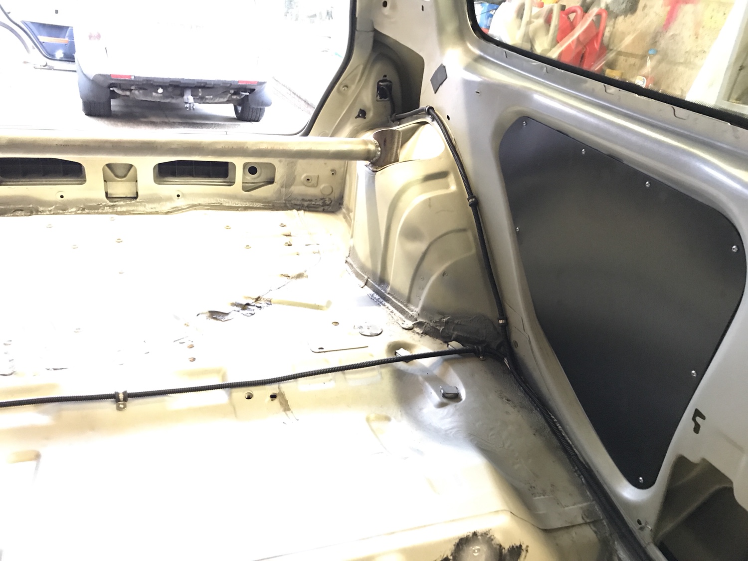

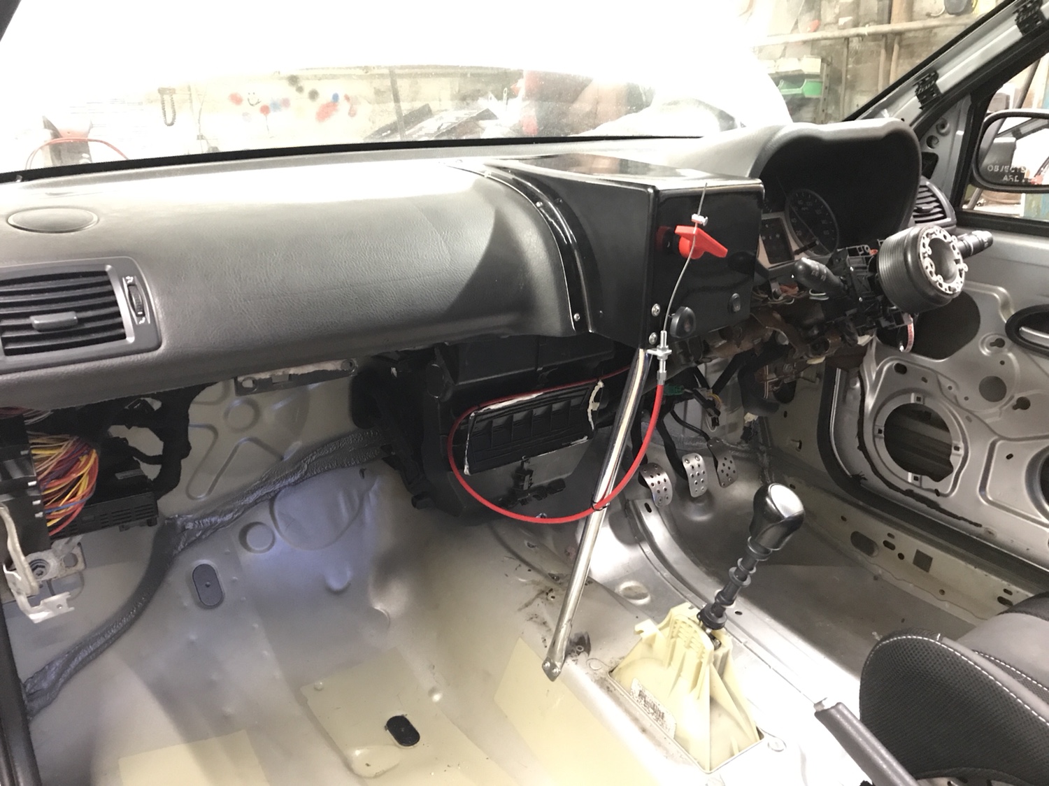

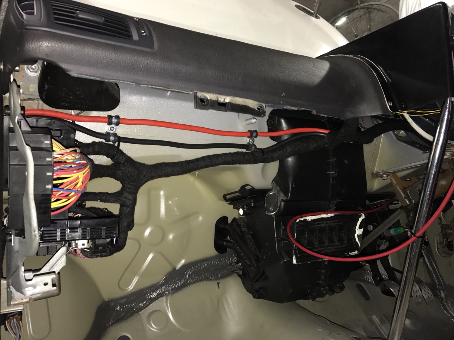

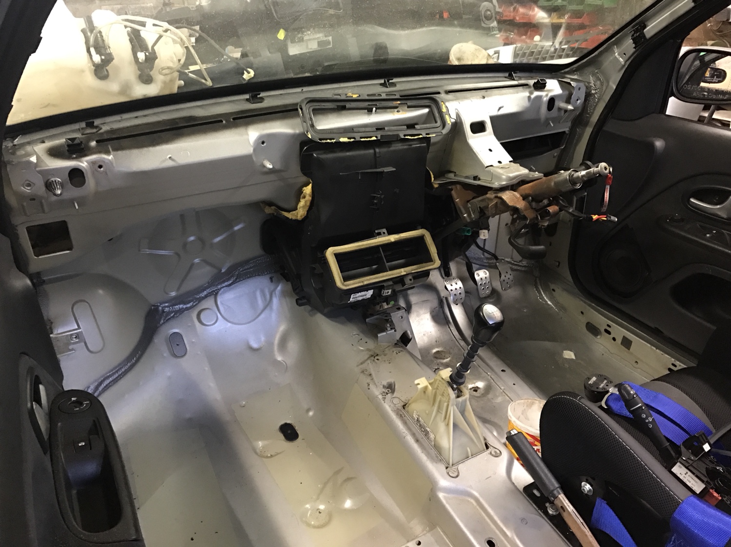

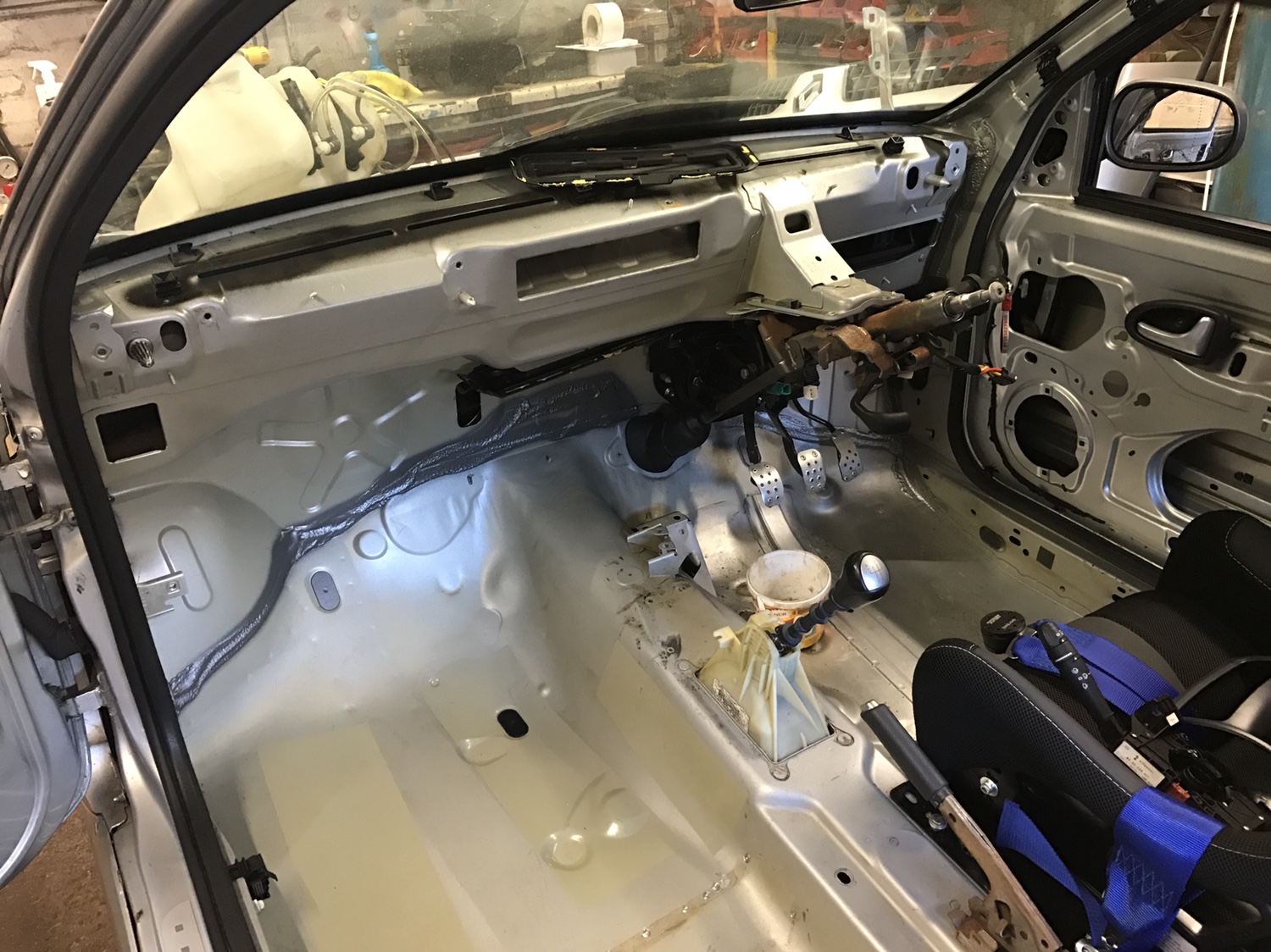

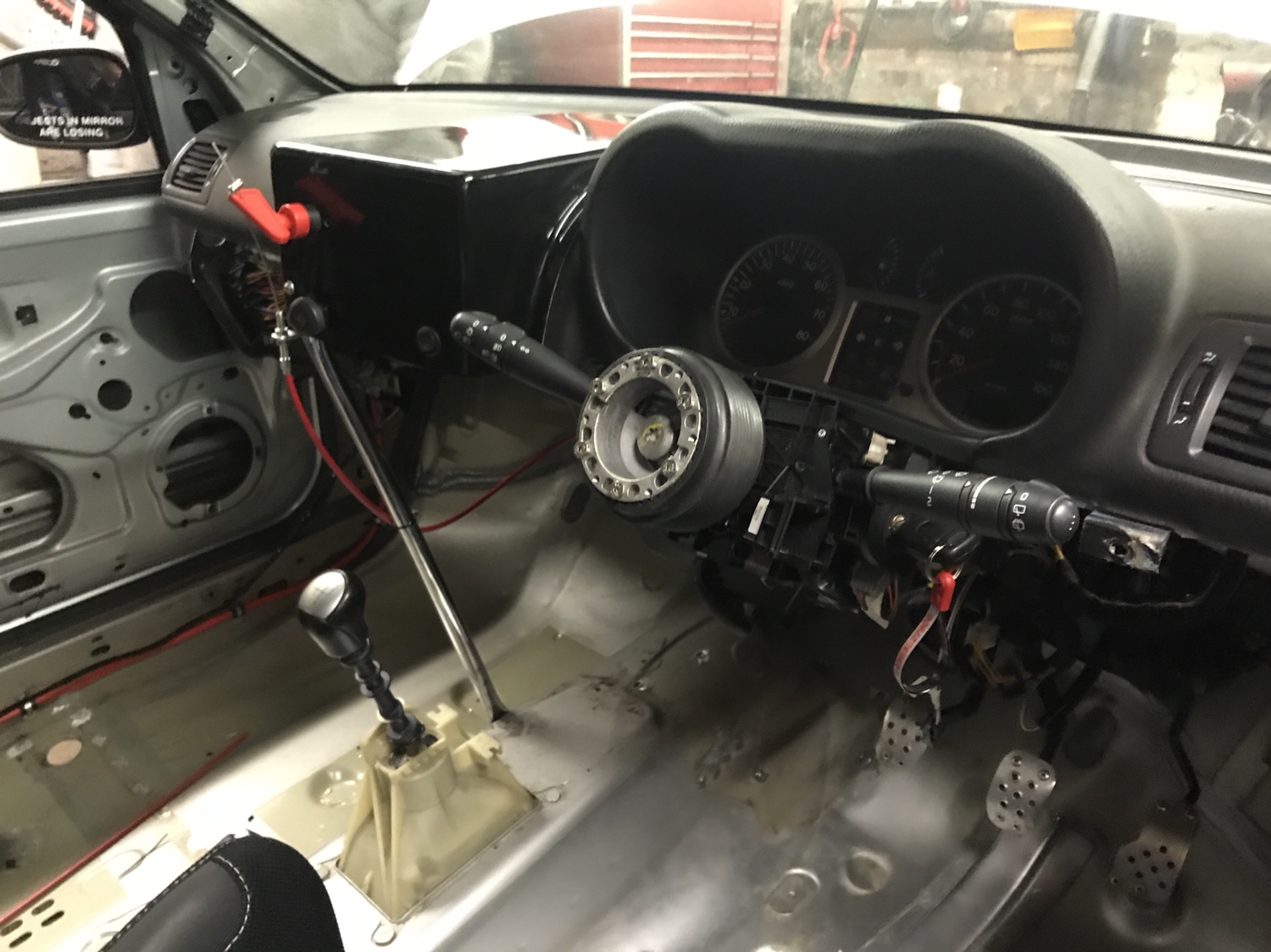

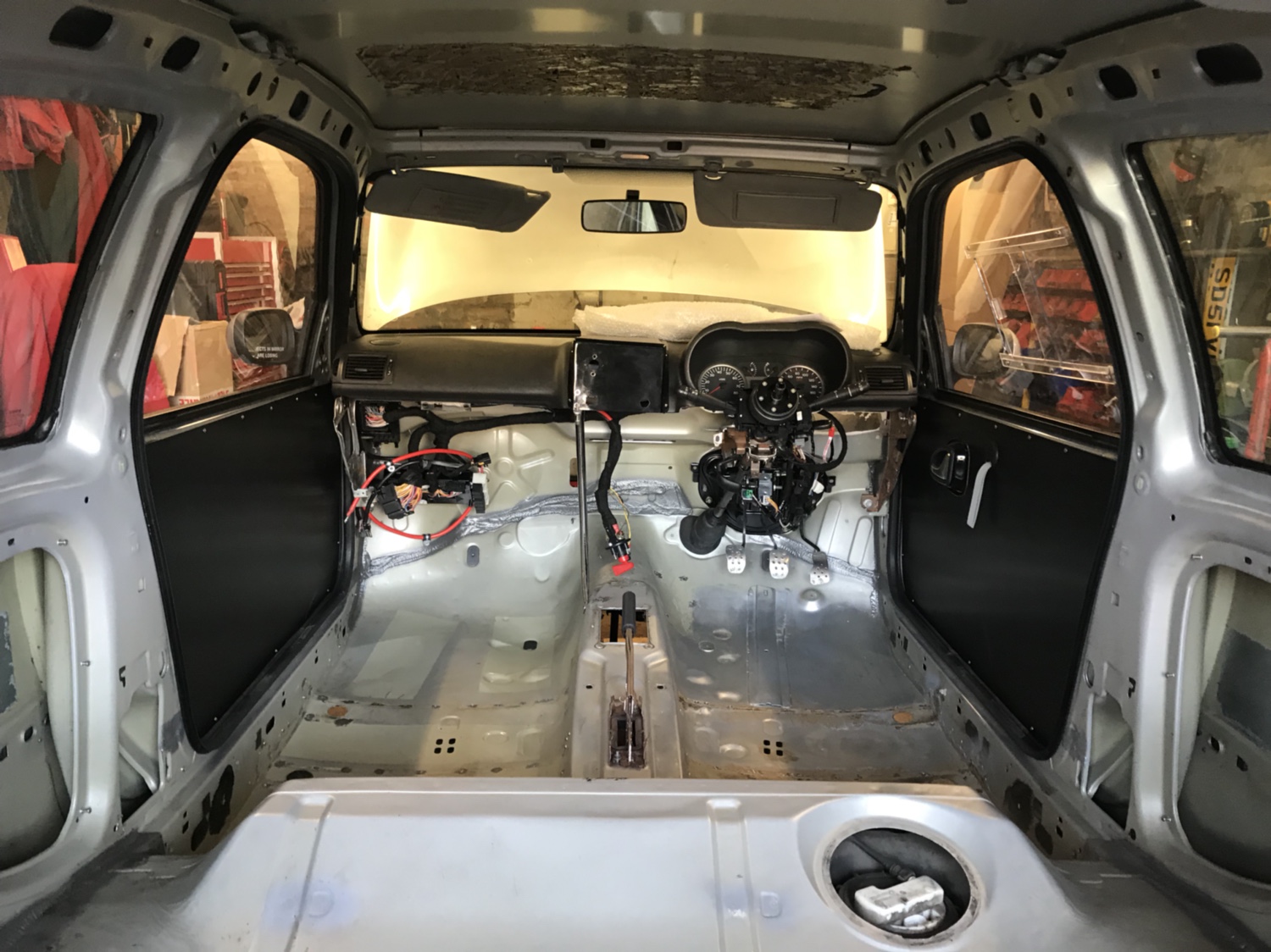

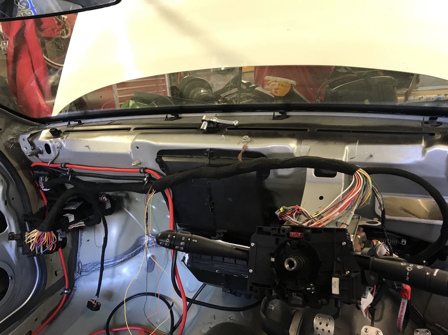

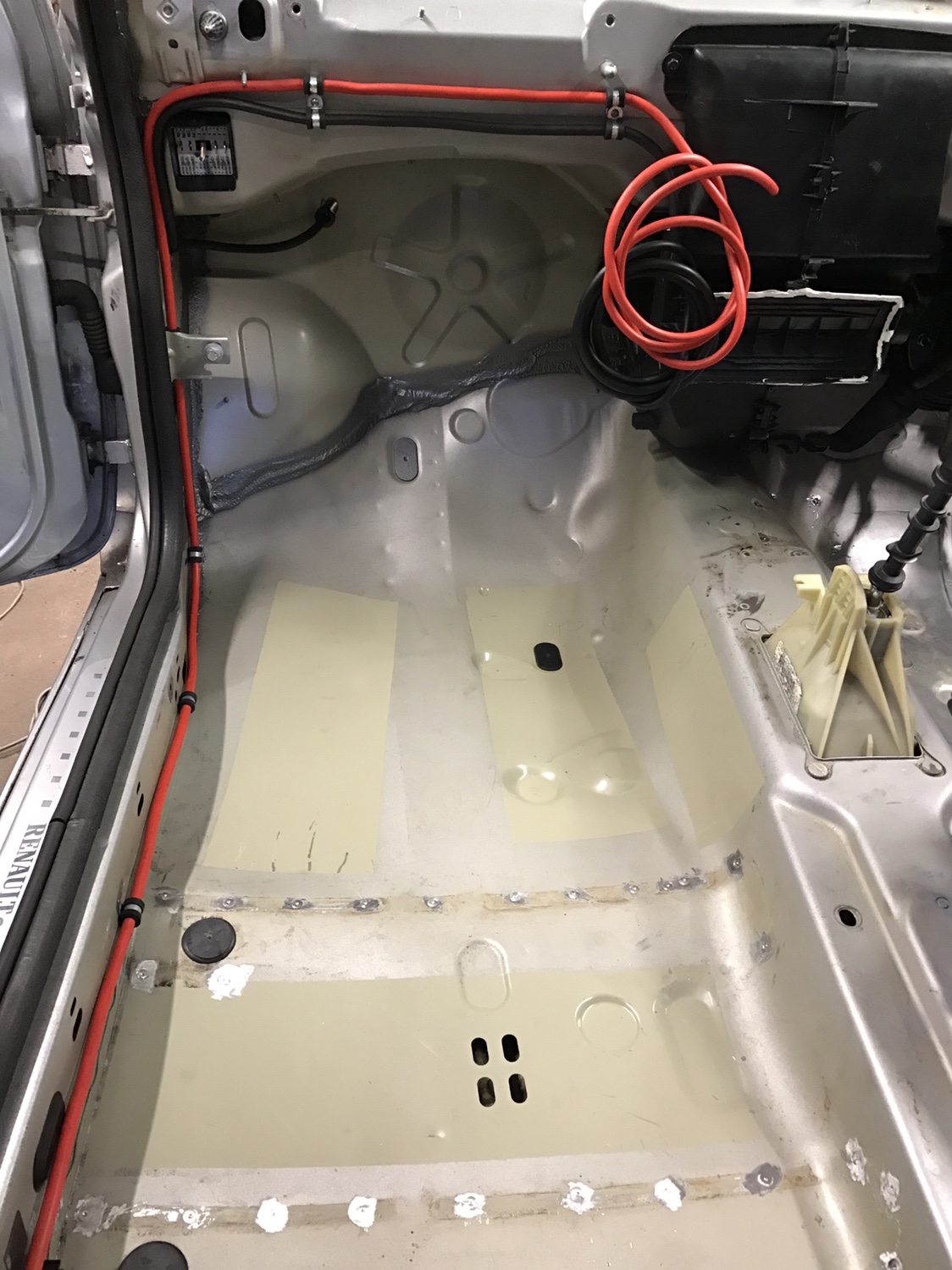

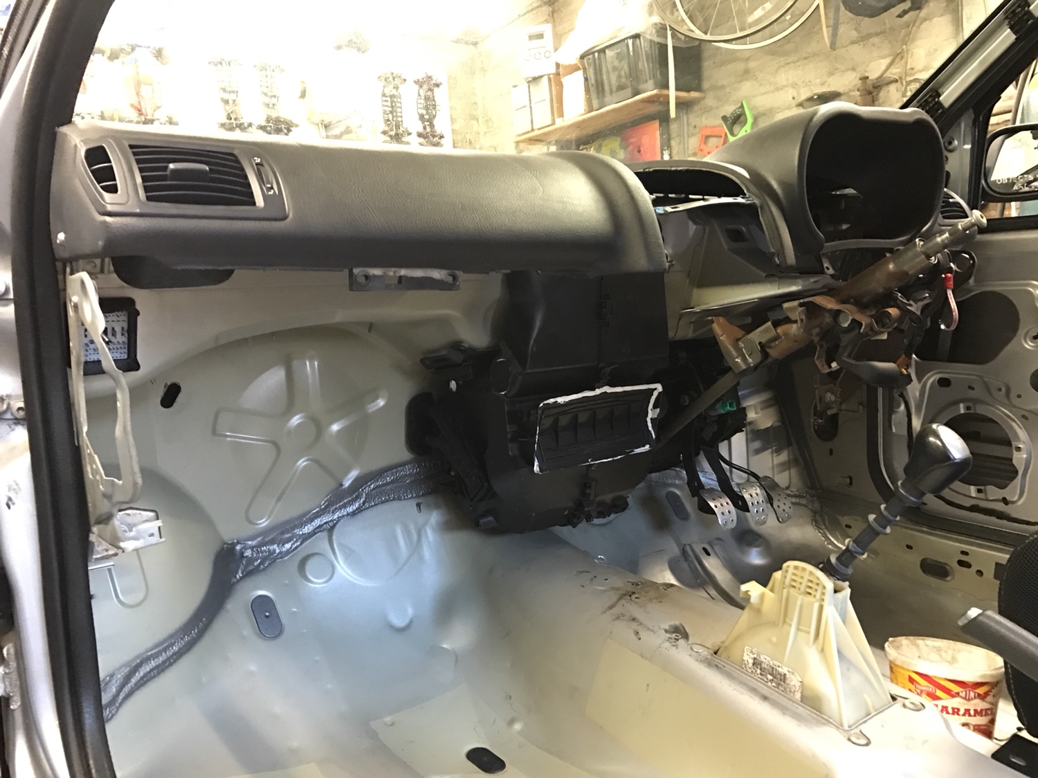

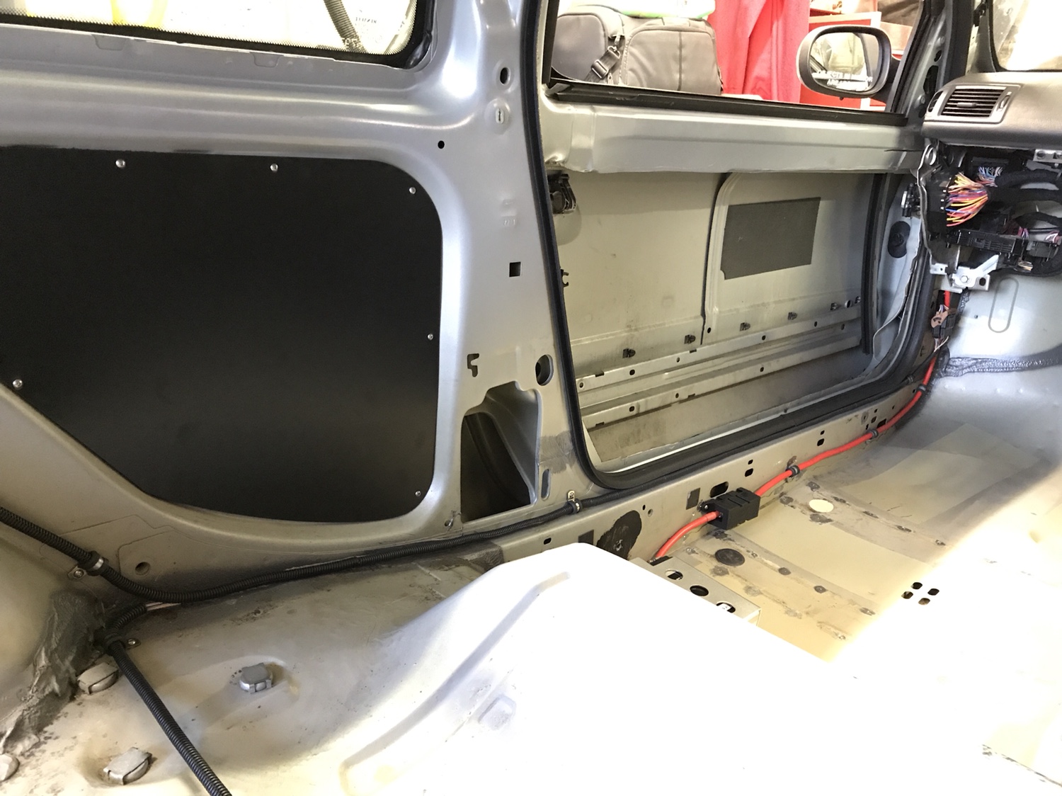

Next step was to get the dashboard back in and start to sort out the interior wiring:
Dash pod:

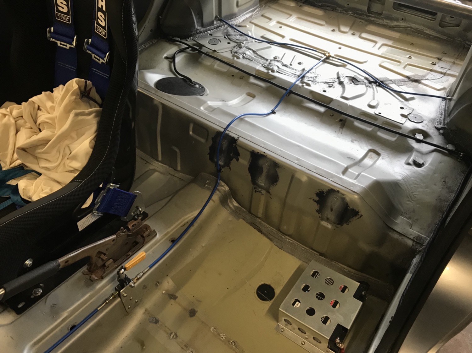

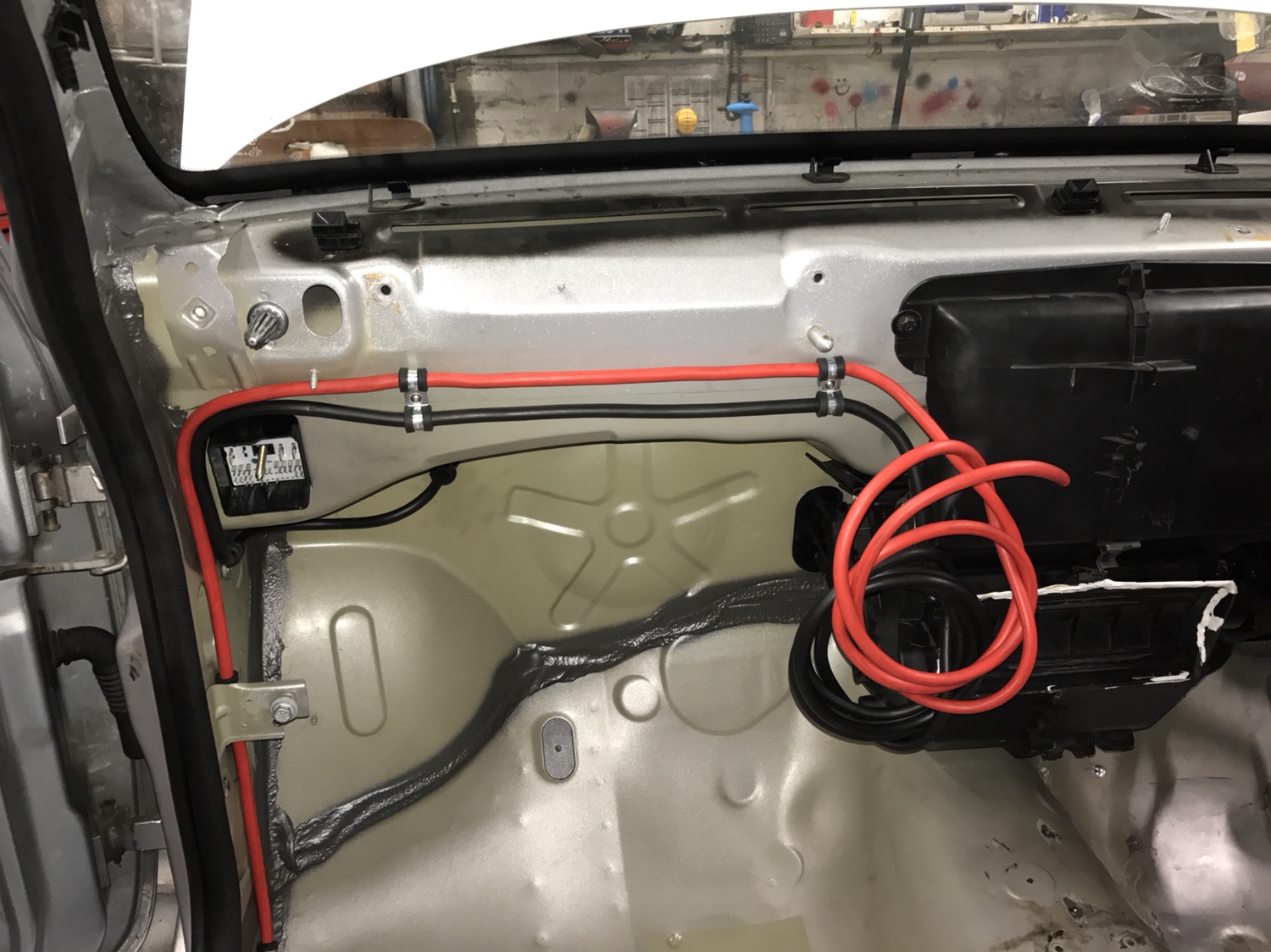

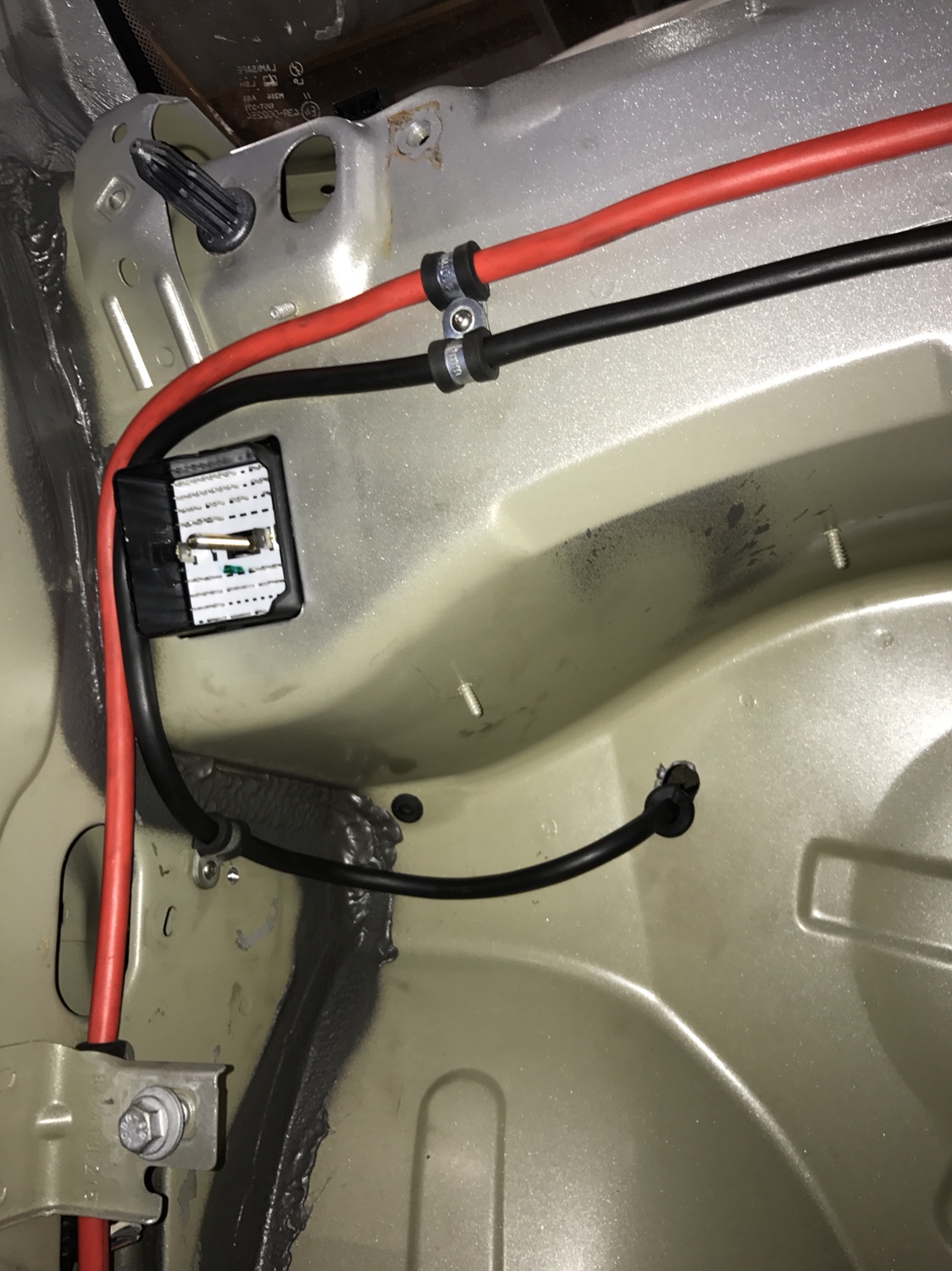

Battery positioned, and wiring run:

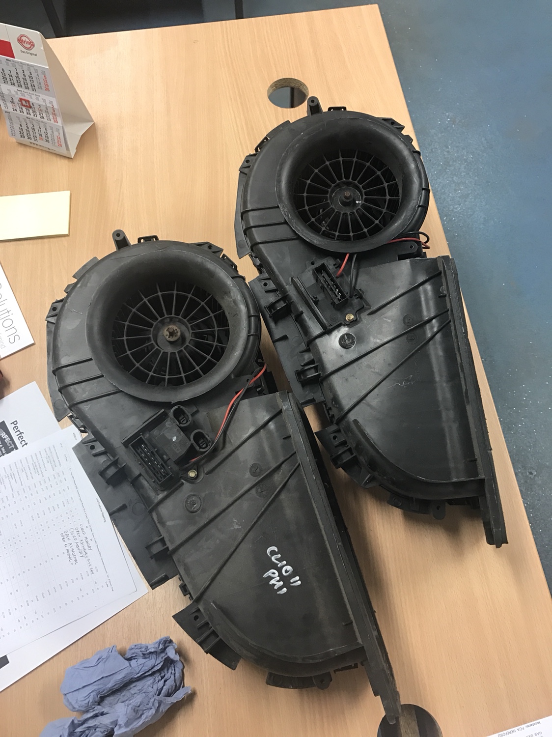

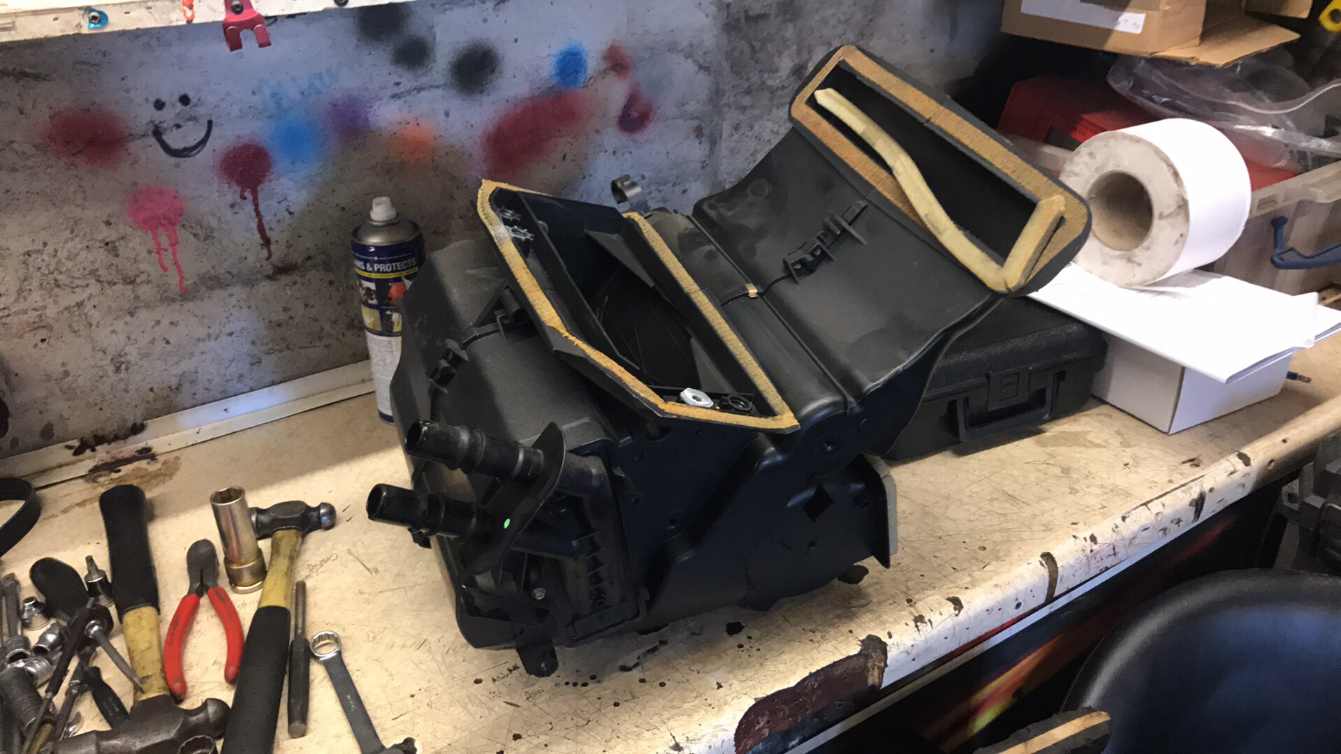

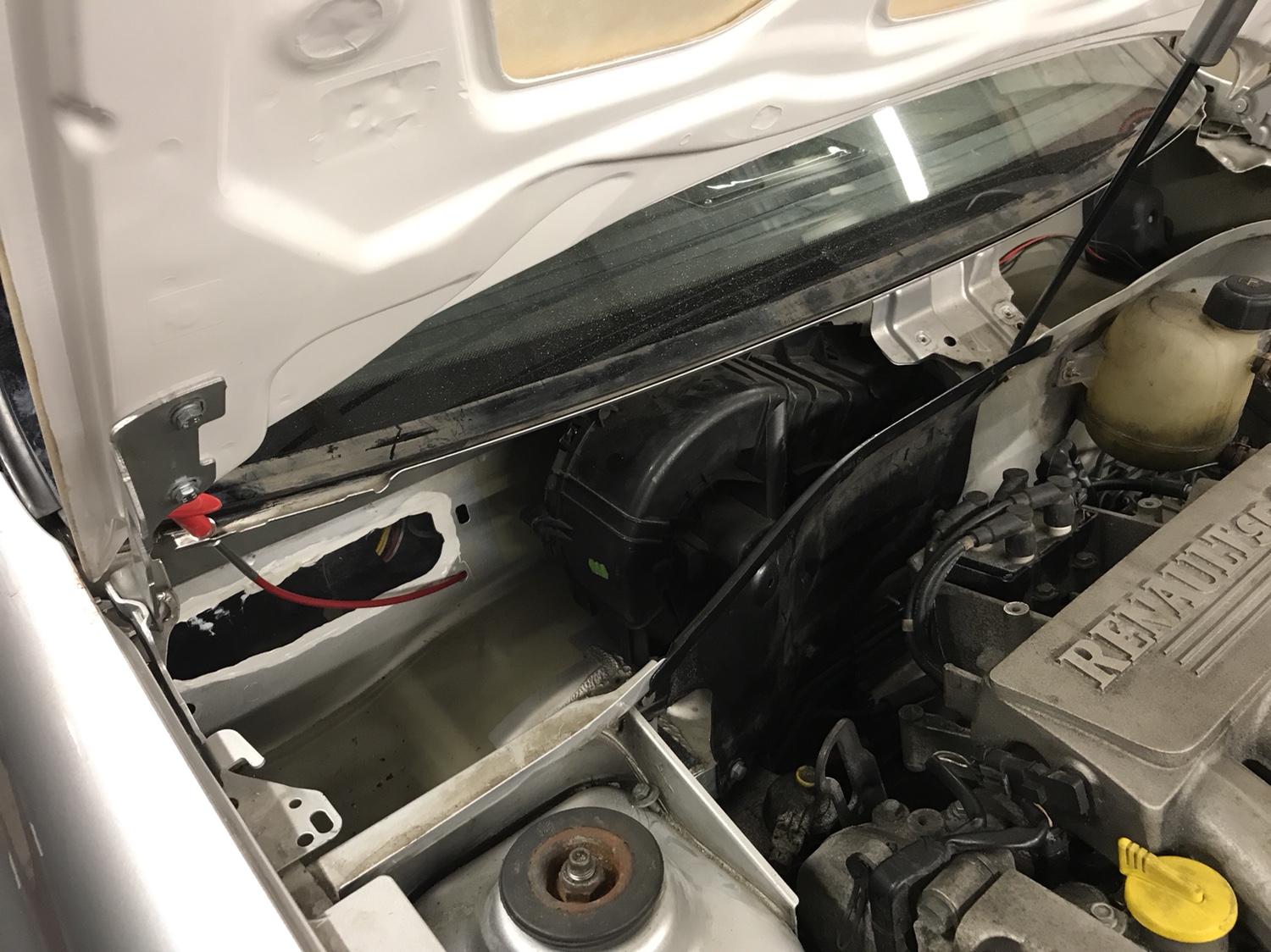

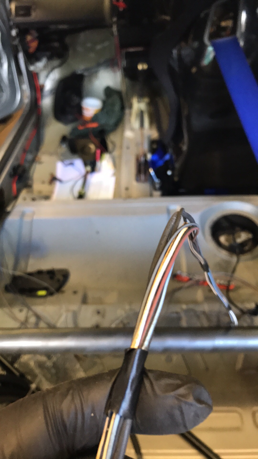

I removed a lot of unnecessary wiring from the dash loom, but there’s still a bit more to come out, this may need revisited in the future but for now I wrapped it all to to make it neat and tidy. I also trimmed down the heater box so as Just to point to the windscreen and fitted the dash pod with the isolator switch, hazard switch and on/off switch for the new non A/C heater:

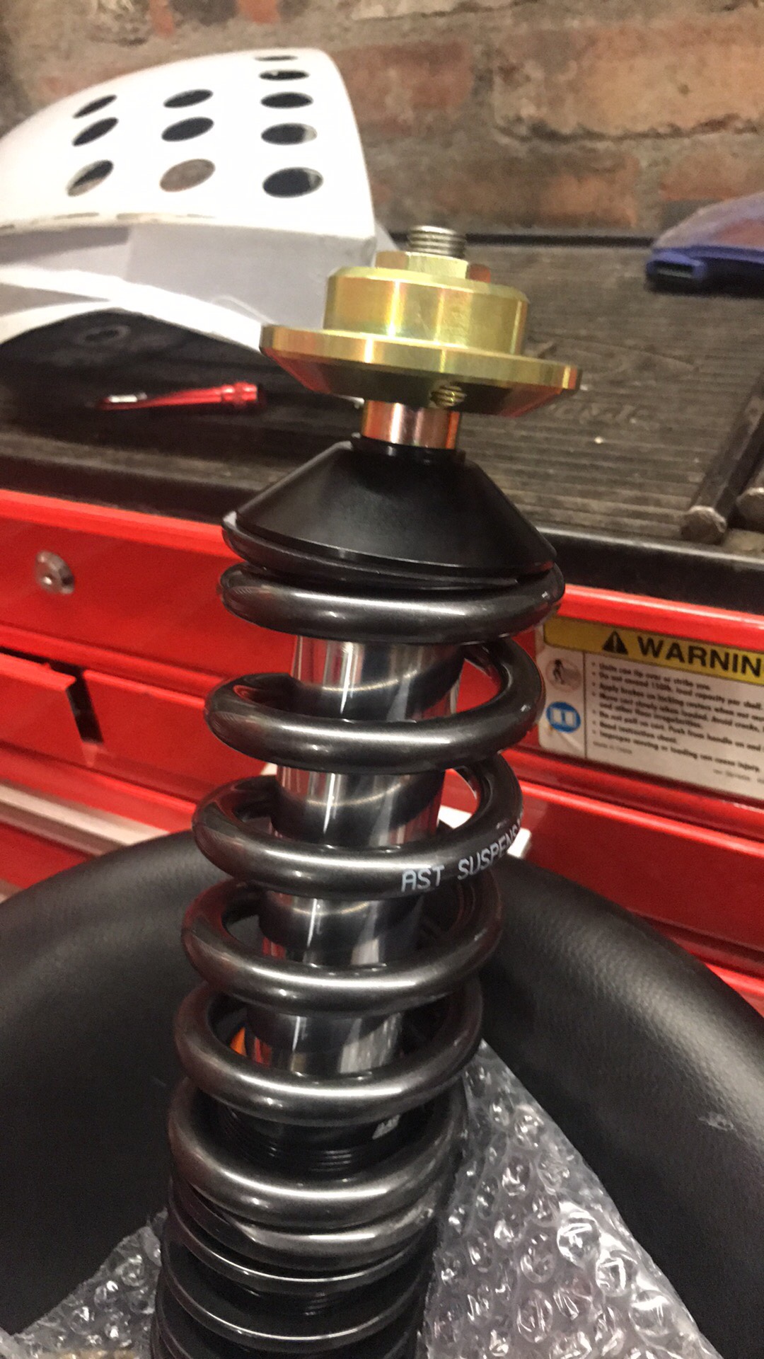

Then, a nice box (finally) arrived:

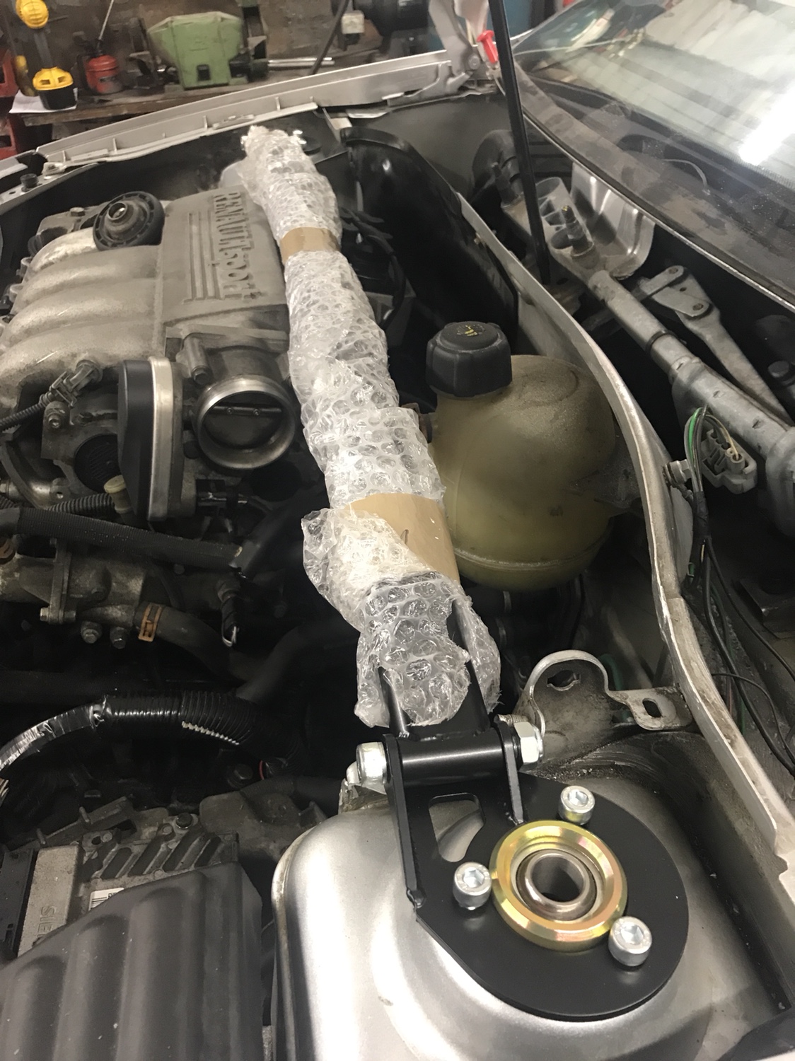

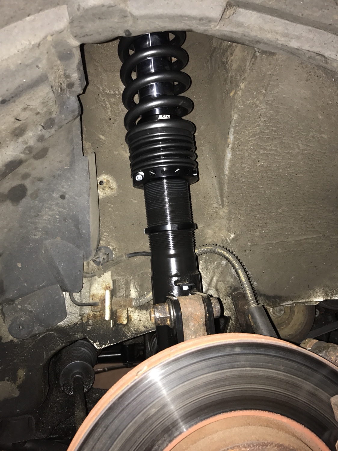

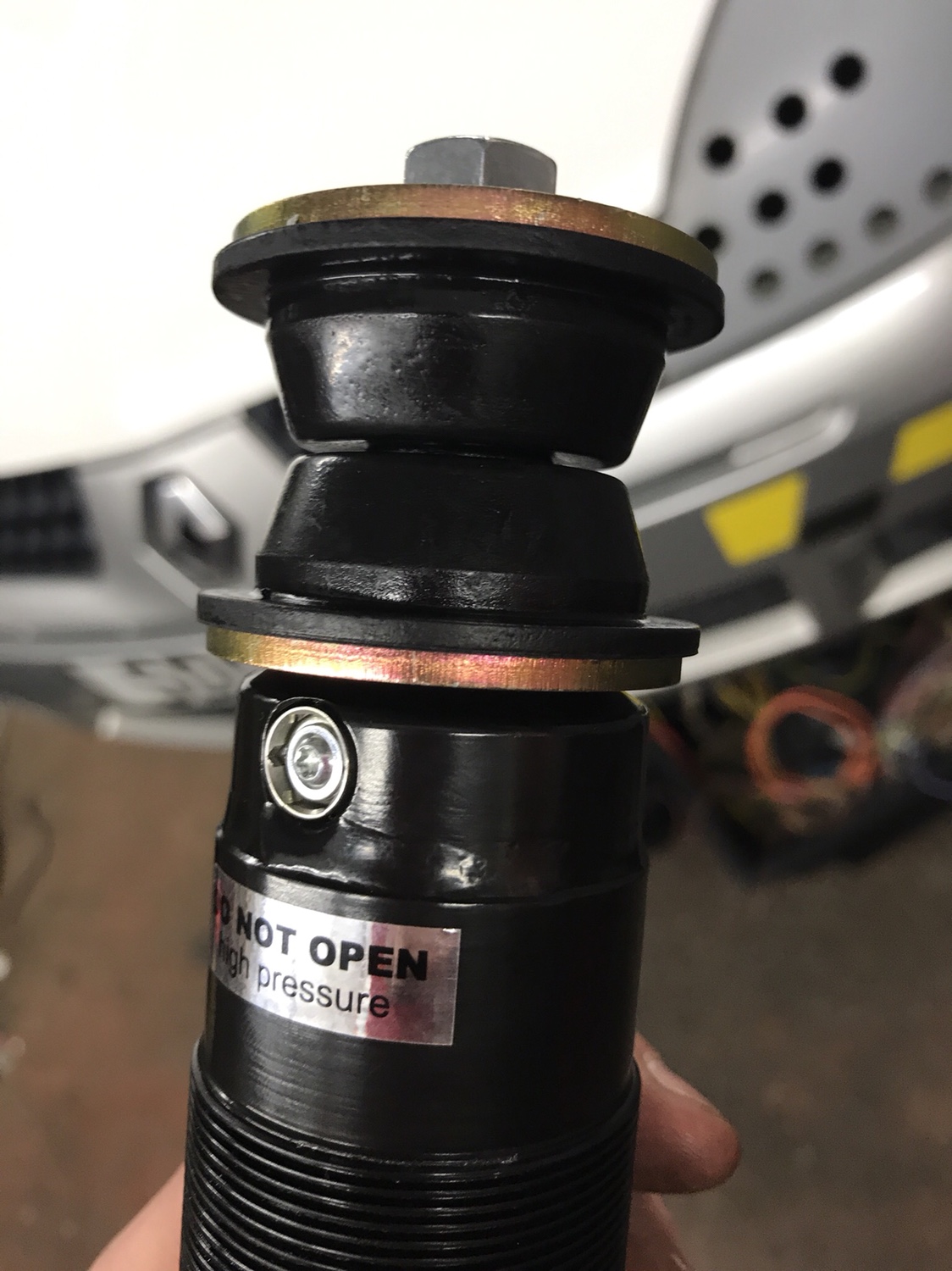

So I fitted the PMS top mounts and strut brace then the AST Coilovers with powerflex mounts on the rear.

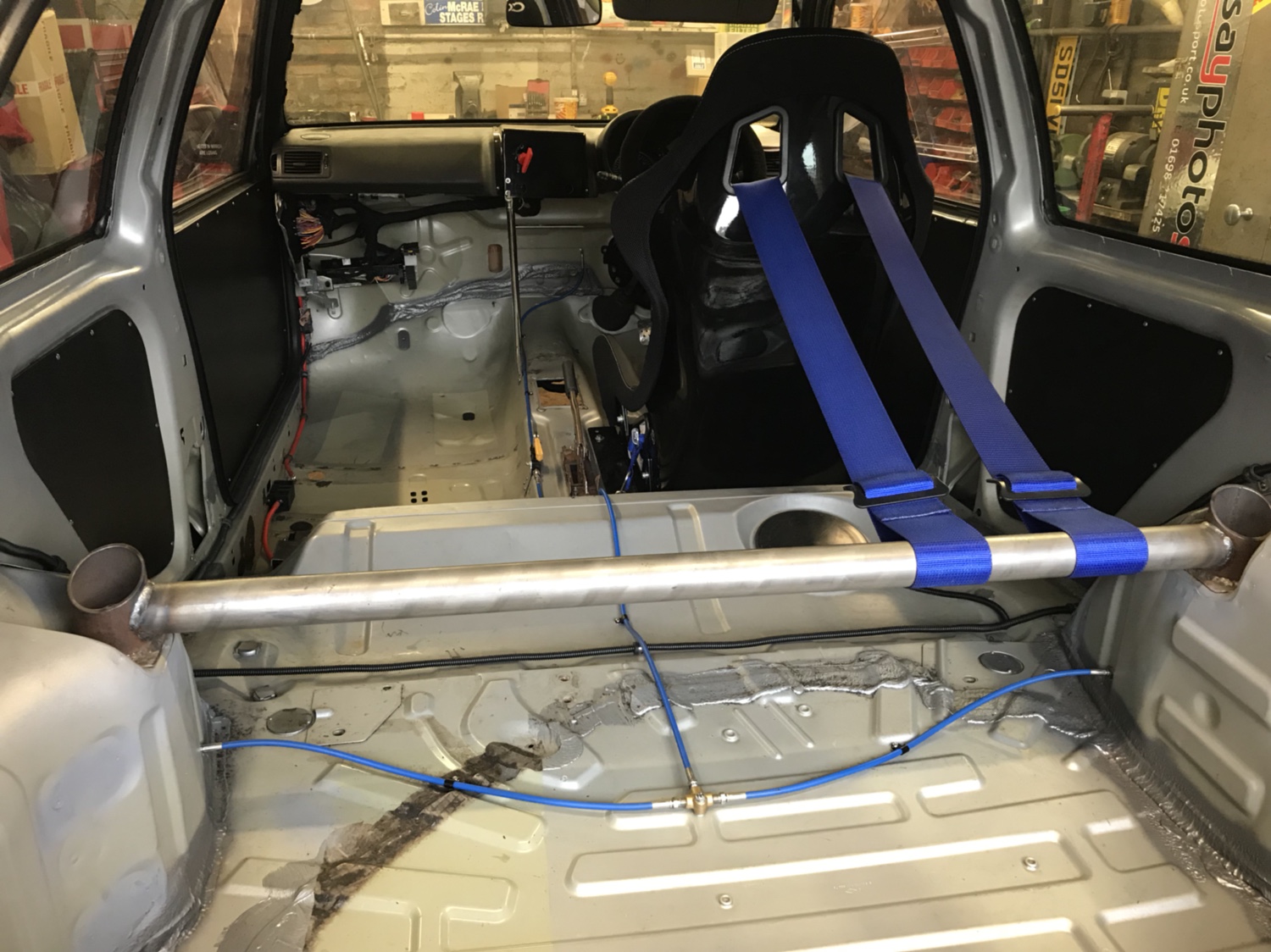

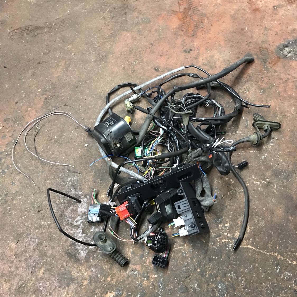

Then I fitted the rear door cards and it was time to remove and tidy up more wiring... gotta love wiring, especially French stuff!

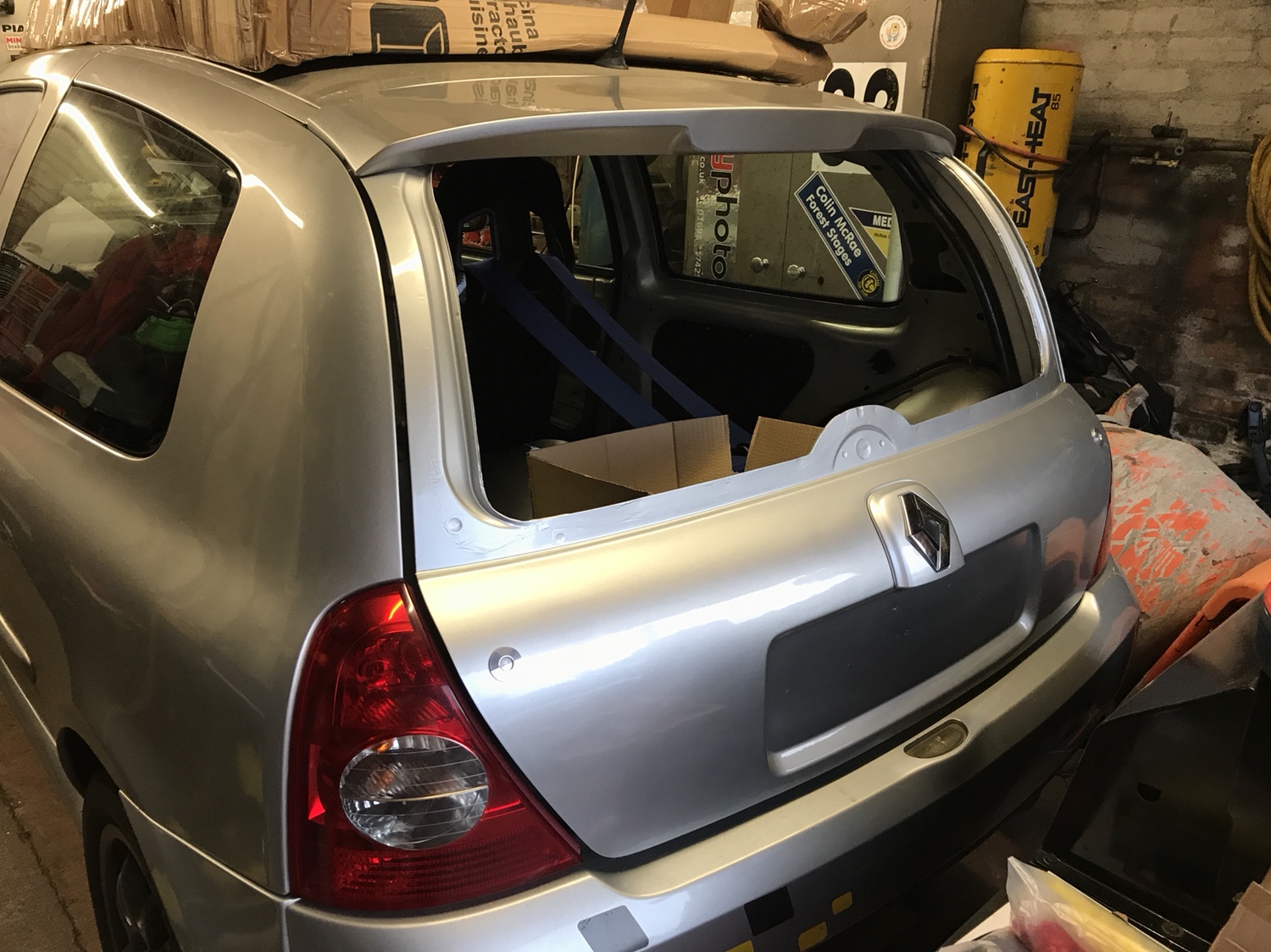

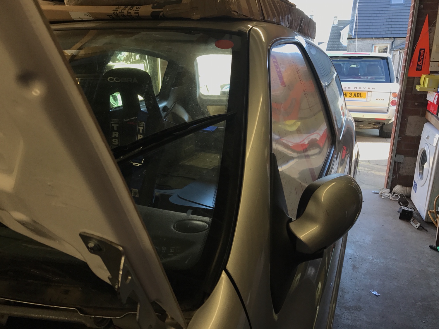

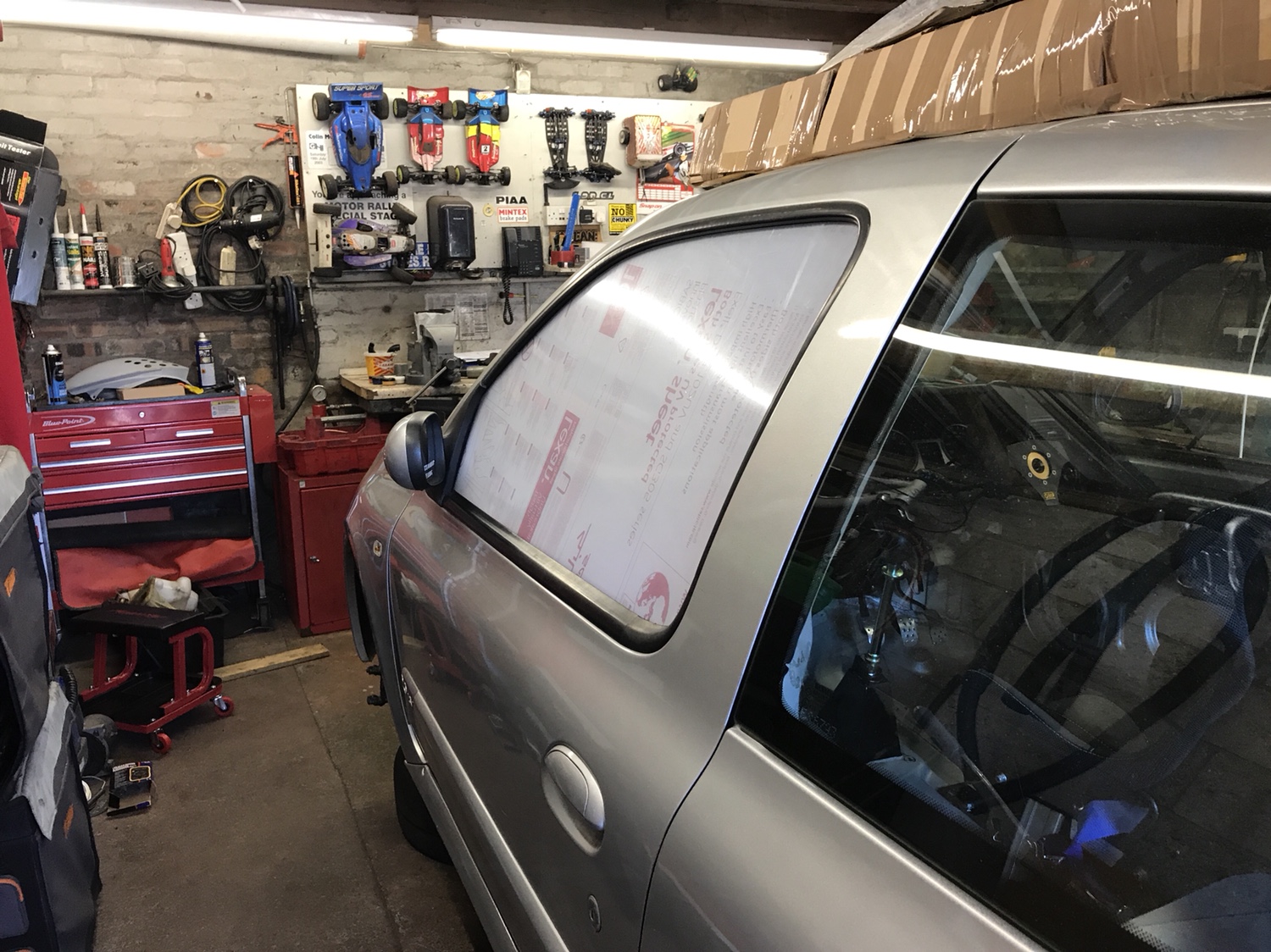

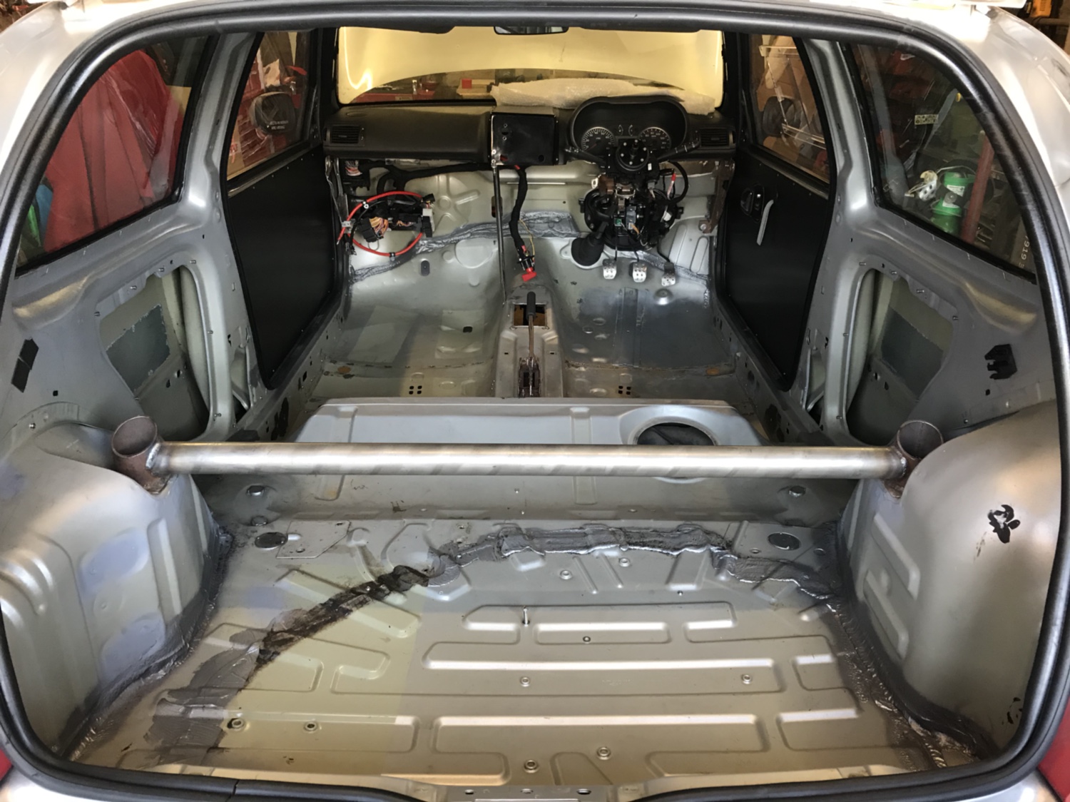

Next job was to trial fit the Perspex windows:

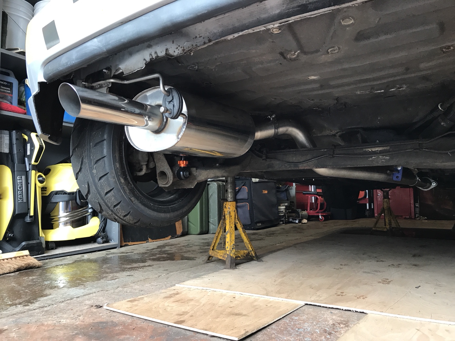

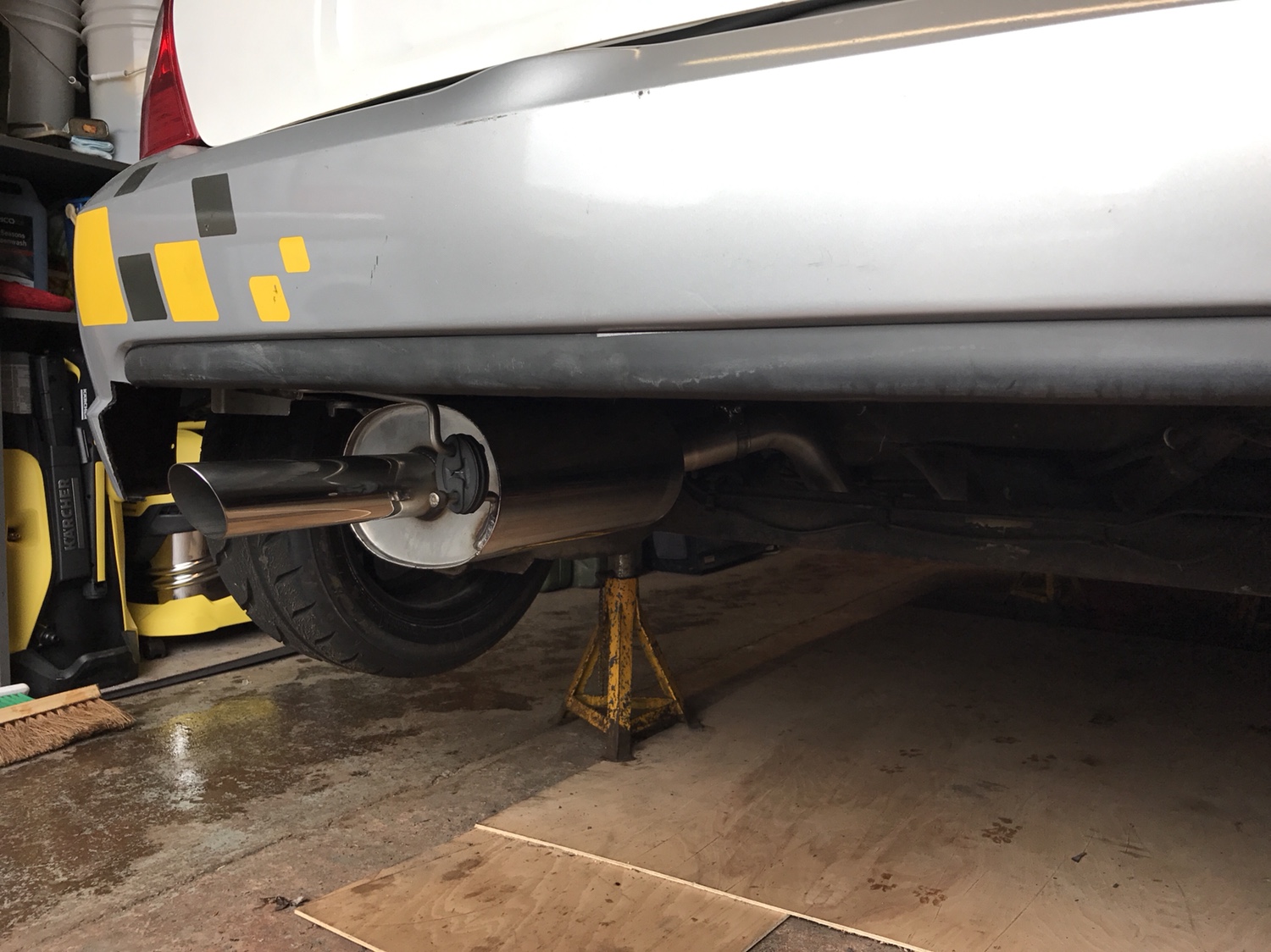

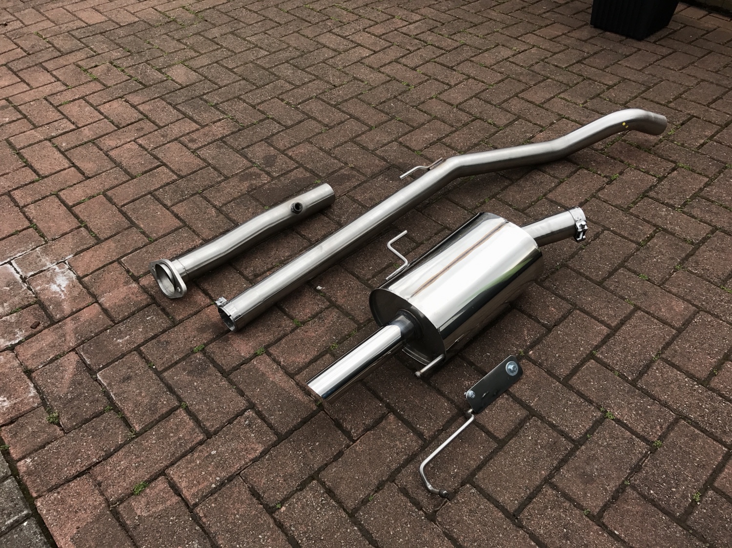

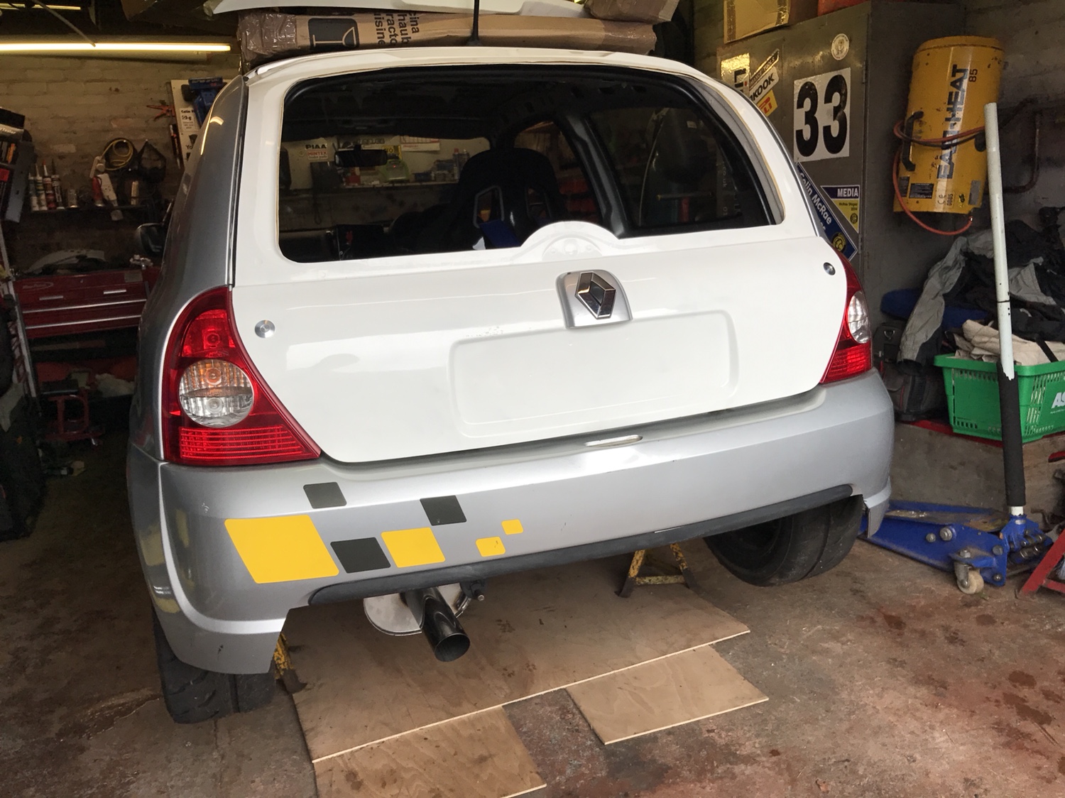

Given the effort I’d gone to saving weight I decided that the twin exit Scorpion 182 Exhaust was unnecessary weight too. Cue more shiny bits in the form of a PMS Race Exhaust.

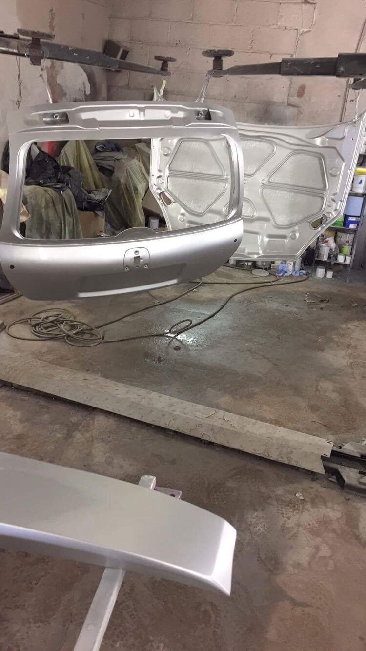

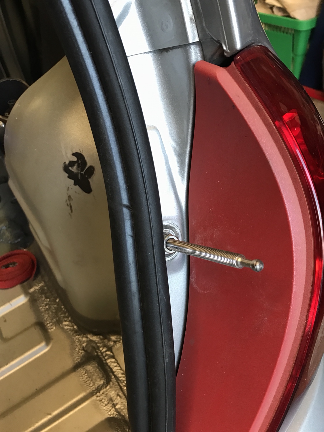

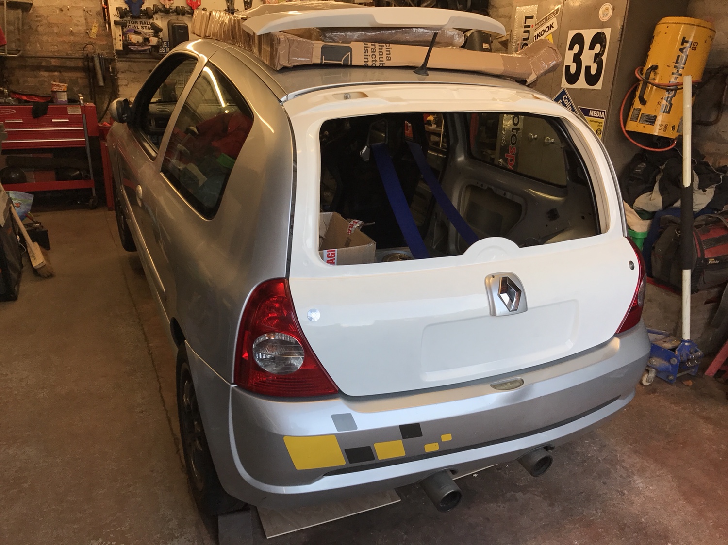

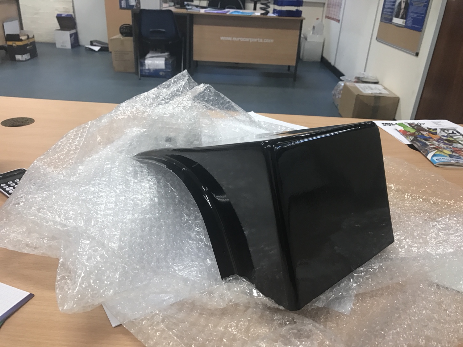

Before I could bond the Perspex rear window and spoiler into place I got the panels painted:
Fitted up:

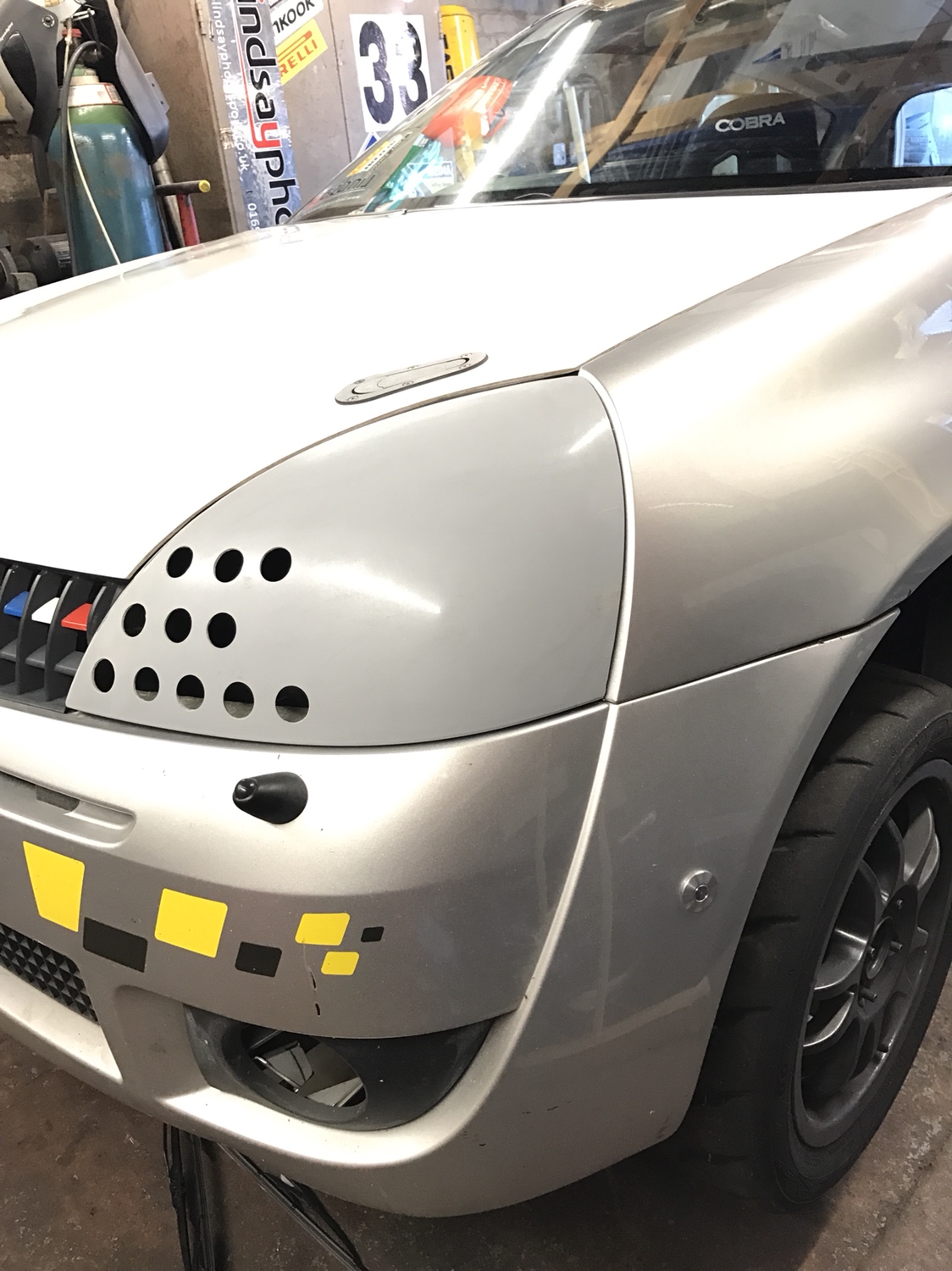

Then I painted the headlight blanks:
And fitted the rear screen with spoiler:

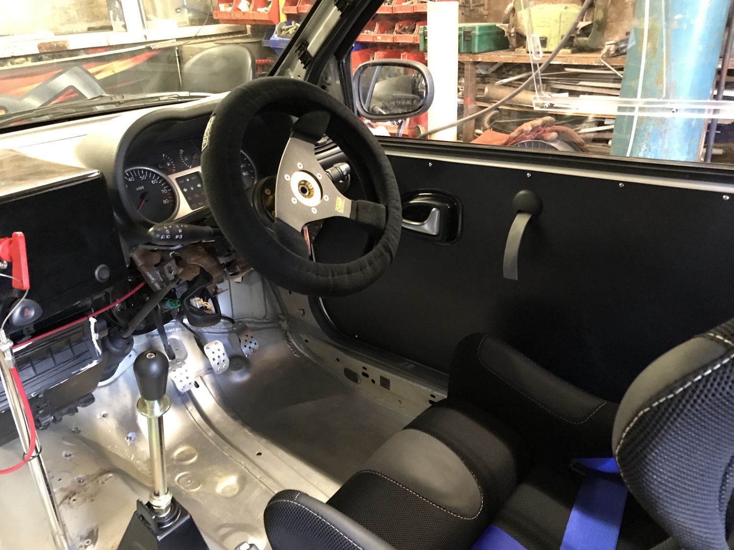

Front windows fully fitted and door cards with pull handle fitted too. PMS Shifter now pictured but was fitted at the same time as the exhaust:

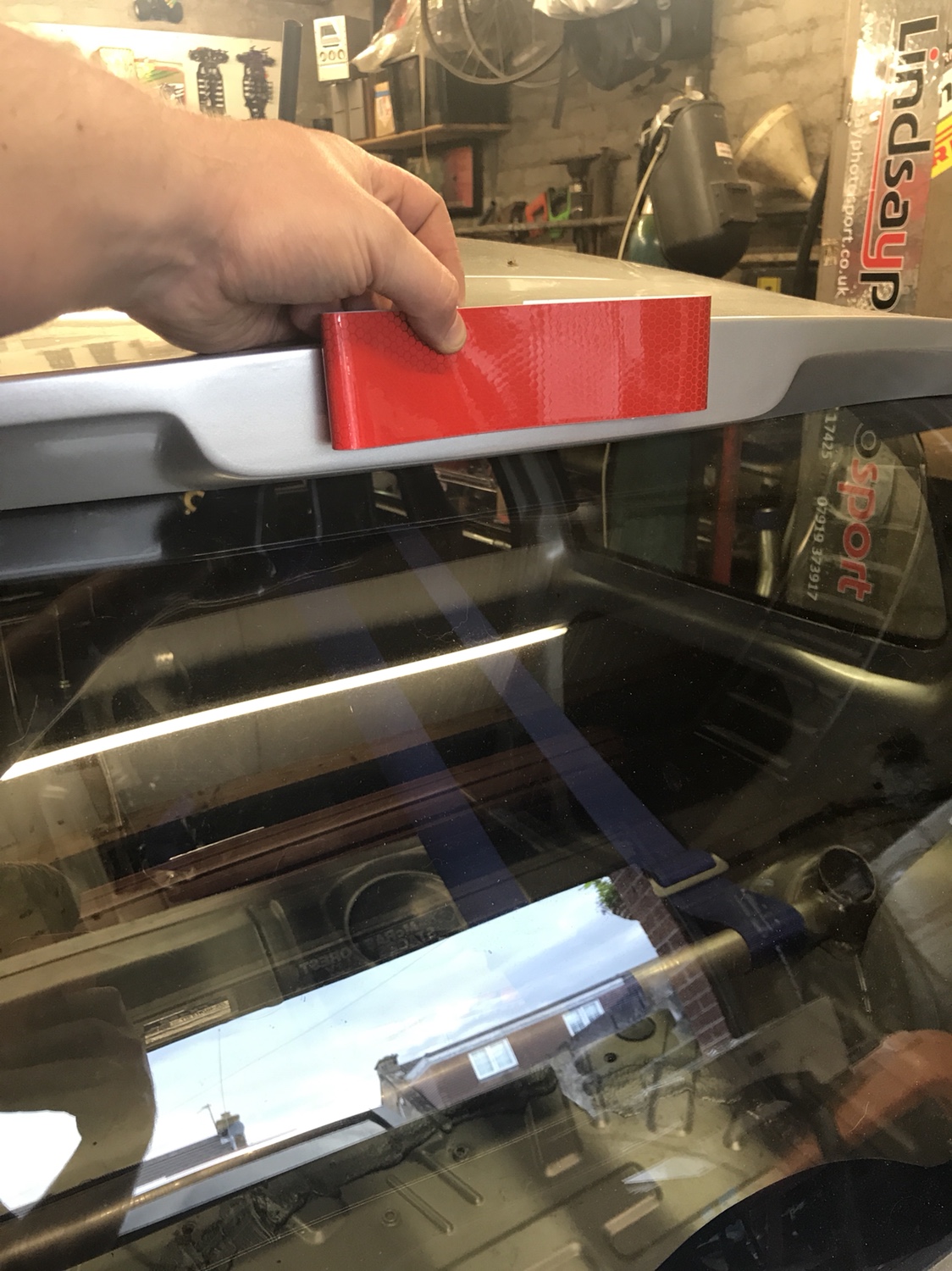

I decided that the spoiler didn’t look right without a brake light so got a bit of reflective tape:

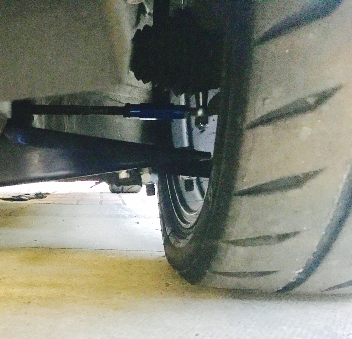

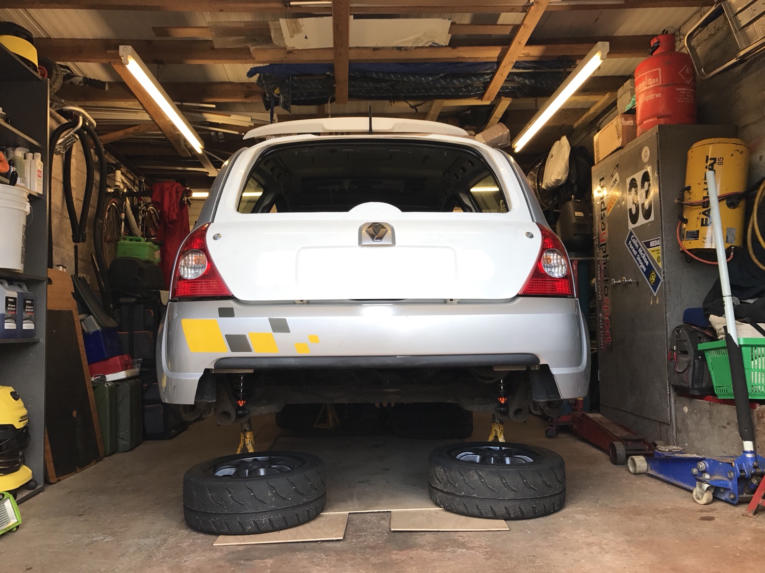

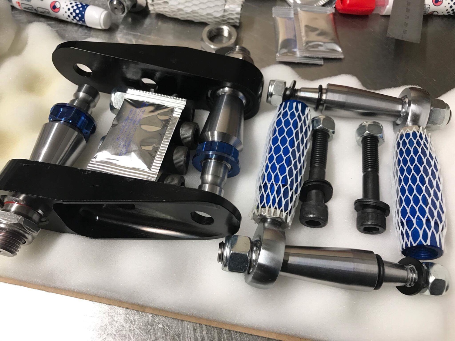

I picked up a roll centre/bump steer correction kit from Anthony Smith at ACS Motorsport and got that fitted too:
I also picked up an ABS Delete kit from Mitch at Pro-Line Motorsport, but decided I’d tackle that at a later stage.

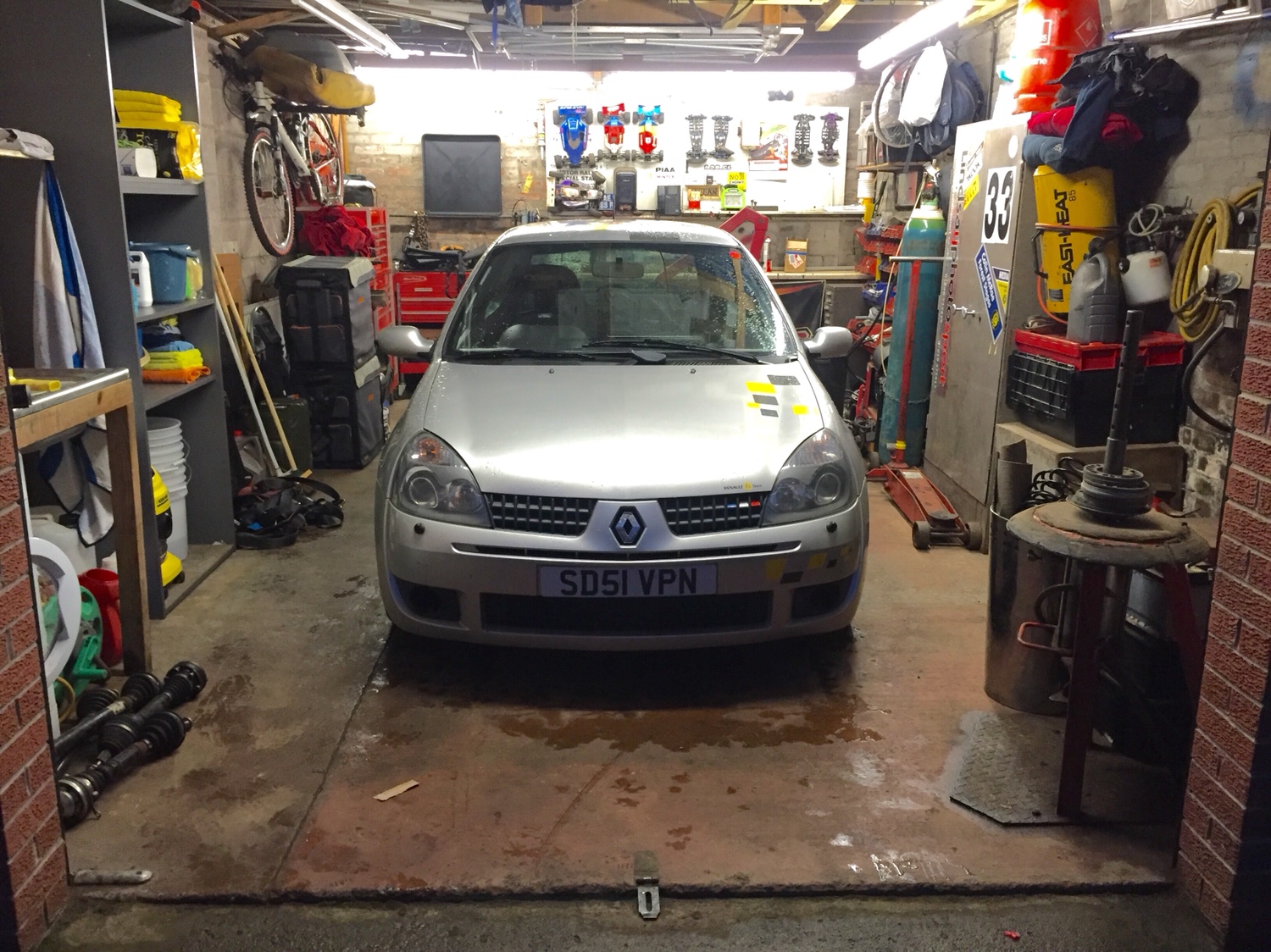

And at that point, shock horror, but it drove out of the garage under its own steam for the first time in around a year, bringing us to July 2017:
John Lindsay
  PH2 RS182

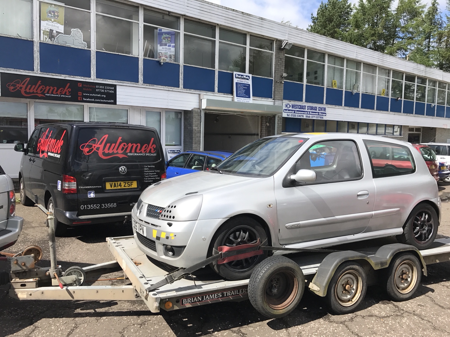

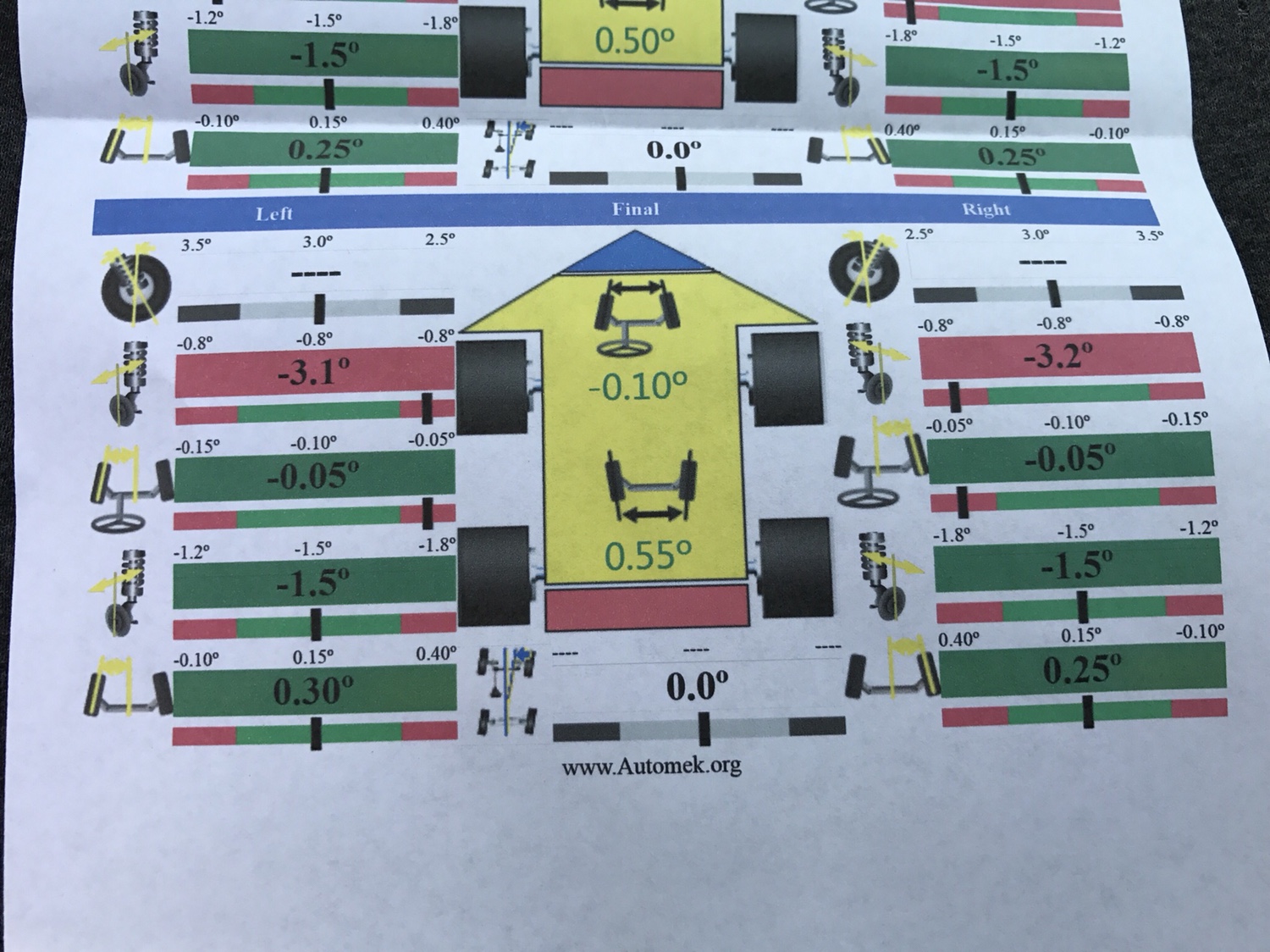

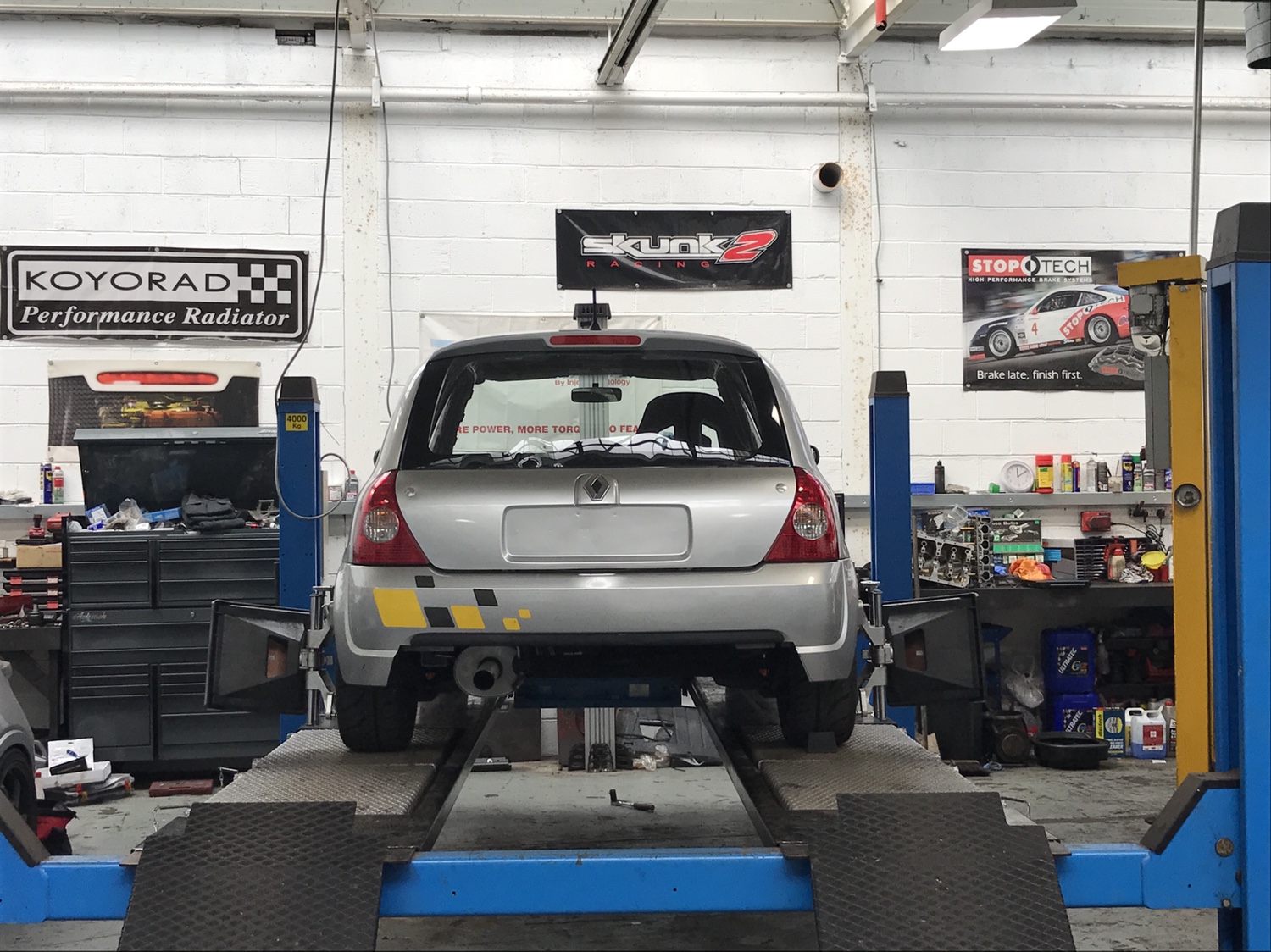

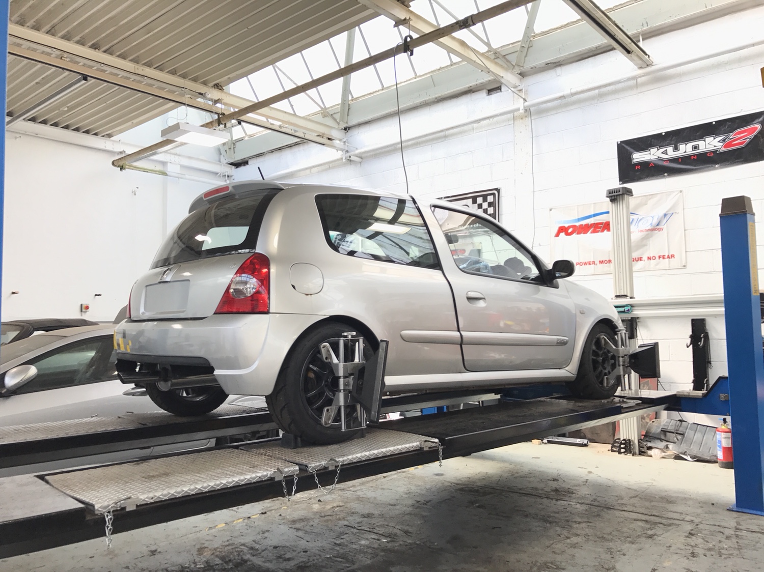

Then I booked a 2 hour open pit lane session at Knockhill on the 5th August, and took the car to have its alignment setup beforehand. Big thanks to Andrew Baird at Automek for this:

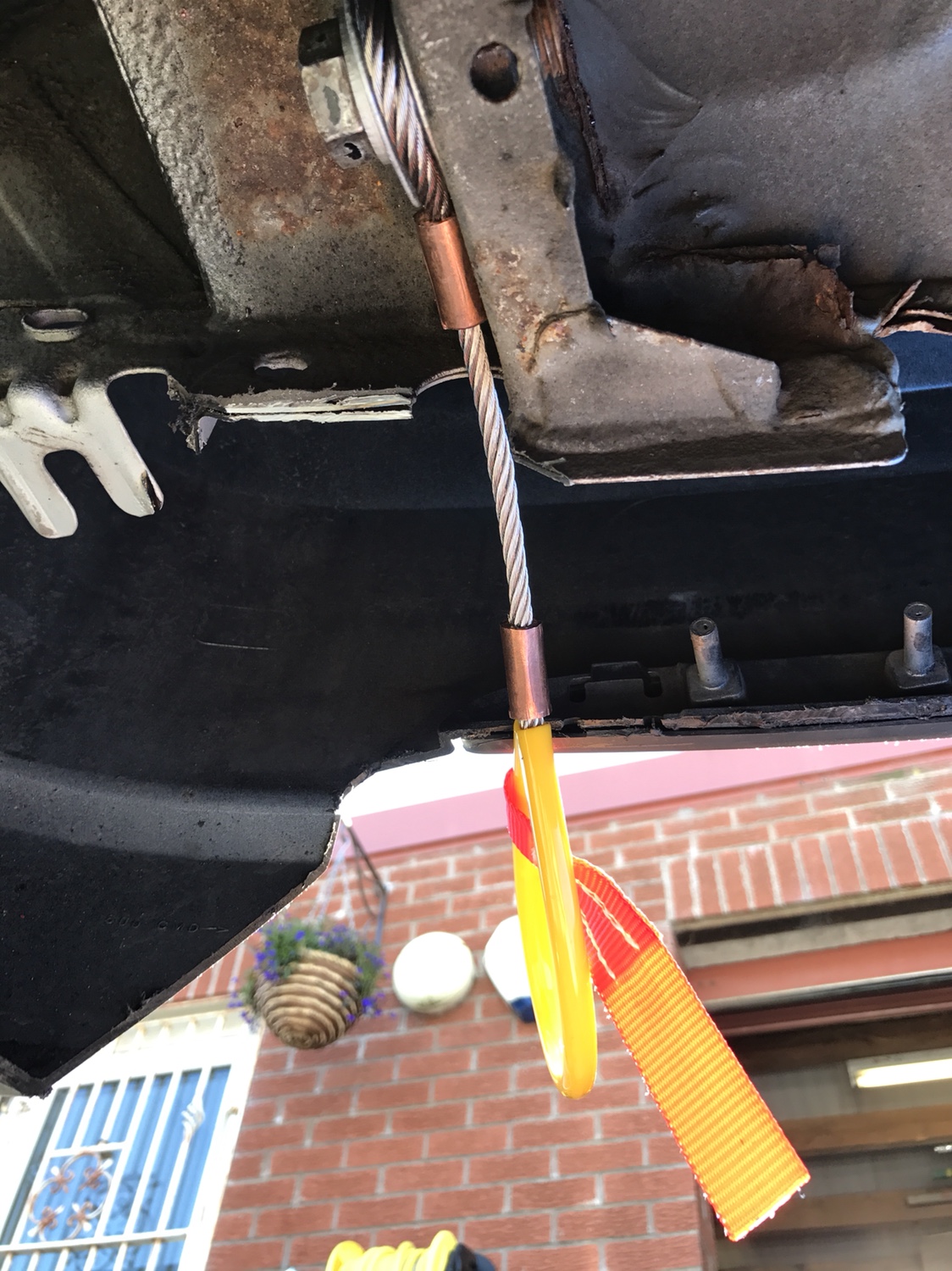

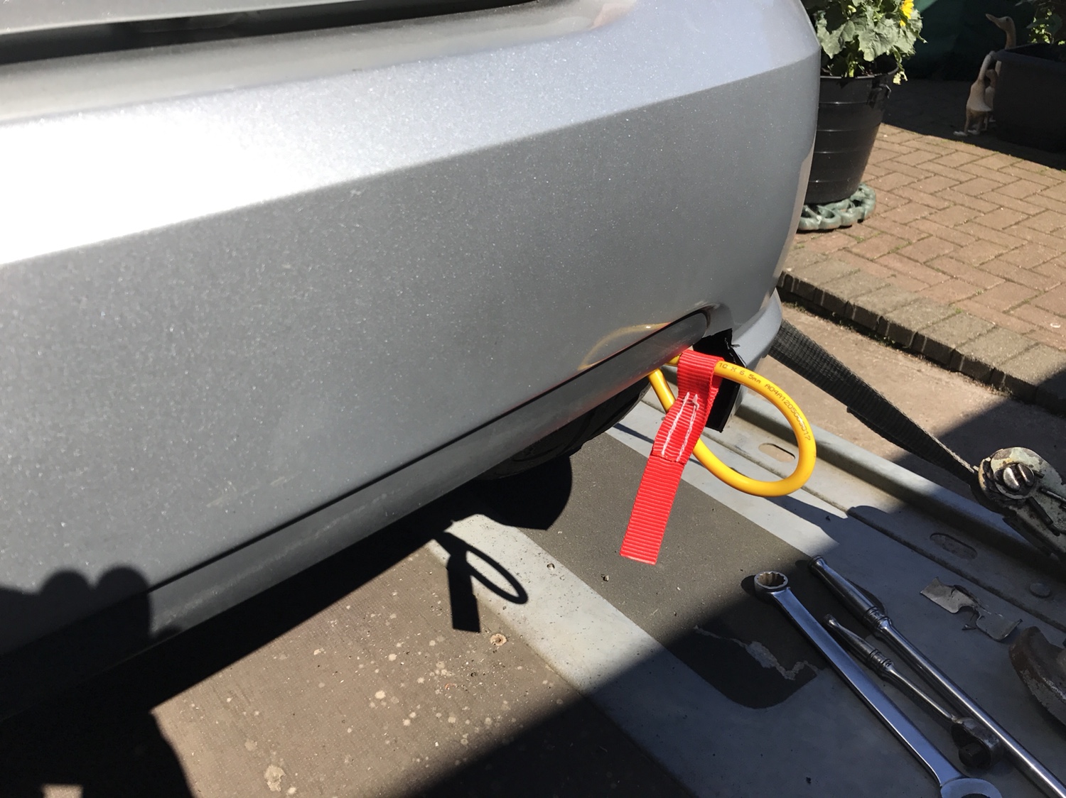

Fitted up my tow straps then headed to the track :

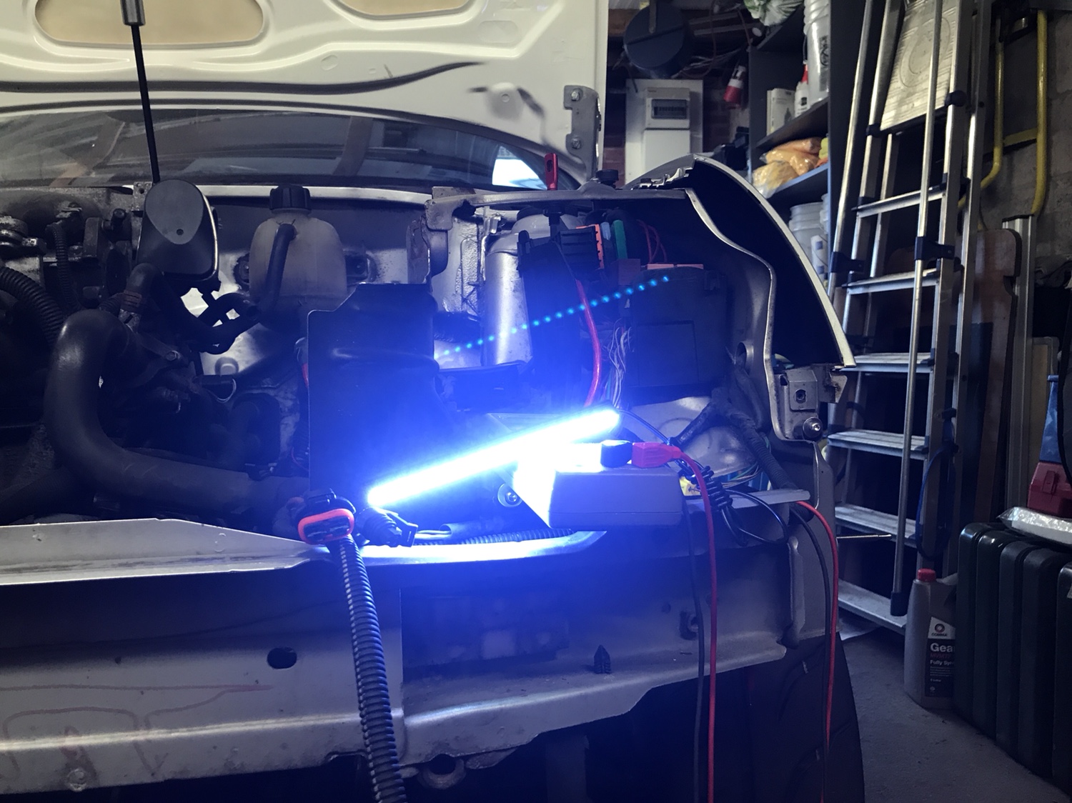

I haven’t been weighing stuff individually unfortunately. The car still has standard rear lamps, with the exception of the high level brake lamp.
At the front I have a pair of LED Strips to fit. Test picture below:

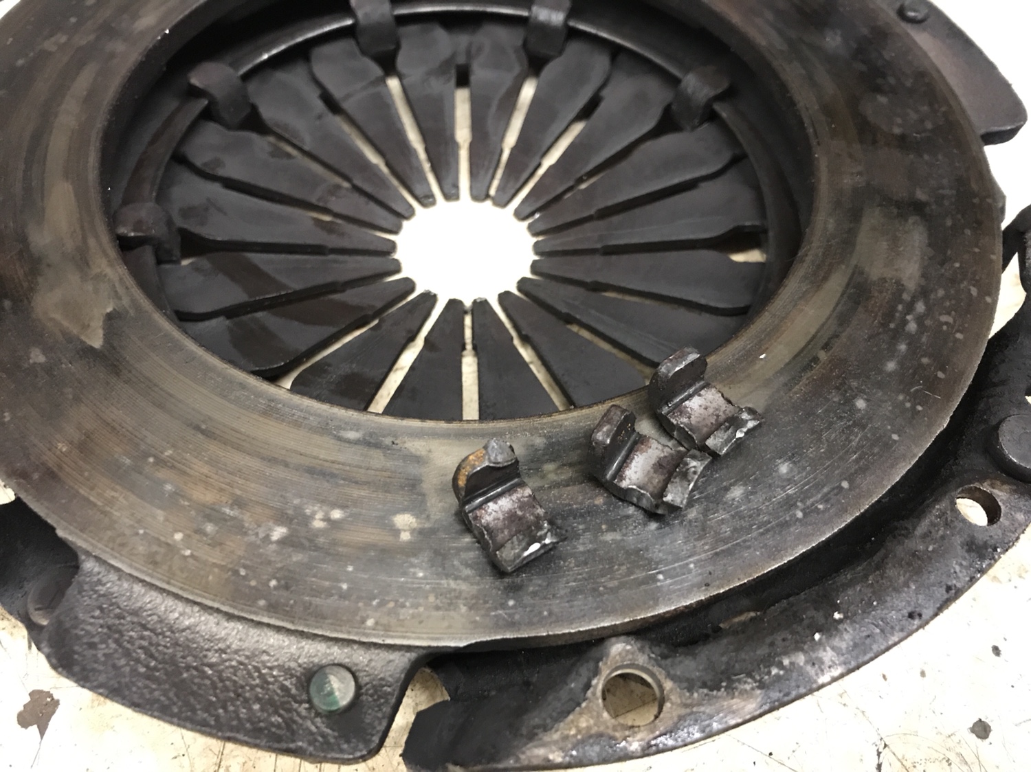

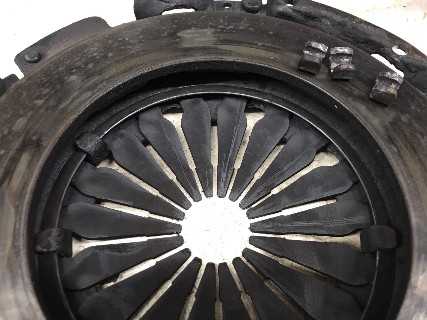

The following day I set about finding out why the gearbox wasn’t happy. I discovered that with the engine running I couldn’t select gears, however with the engine off I could get all gears no problem. Also when starting in gear with the clutch depressed it felt like the clutch was dragging.
So out came the box, after just having the alignment done I lifted it out the top so as not to disturb the subframe:

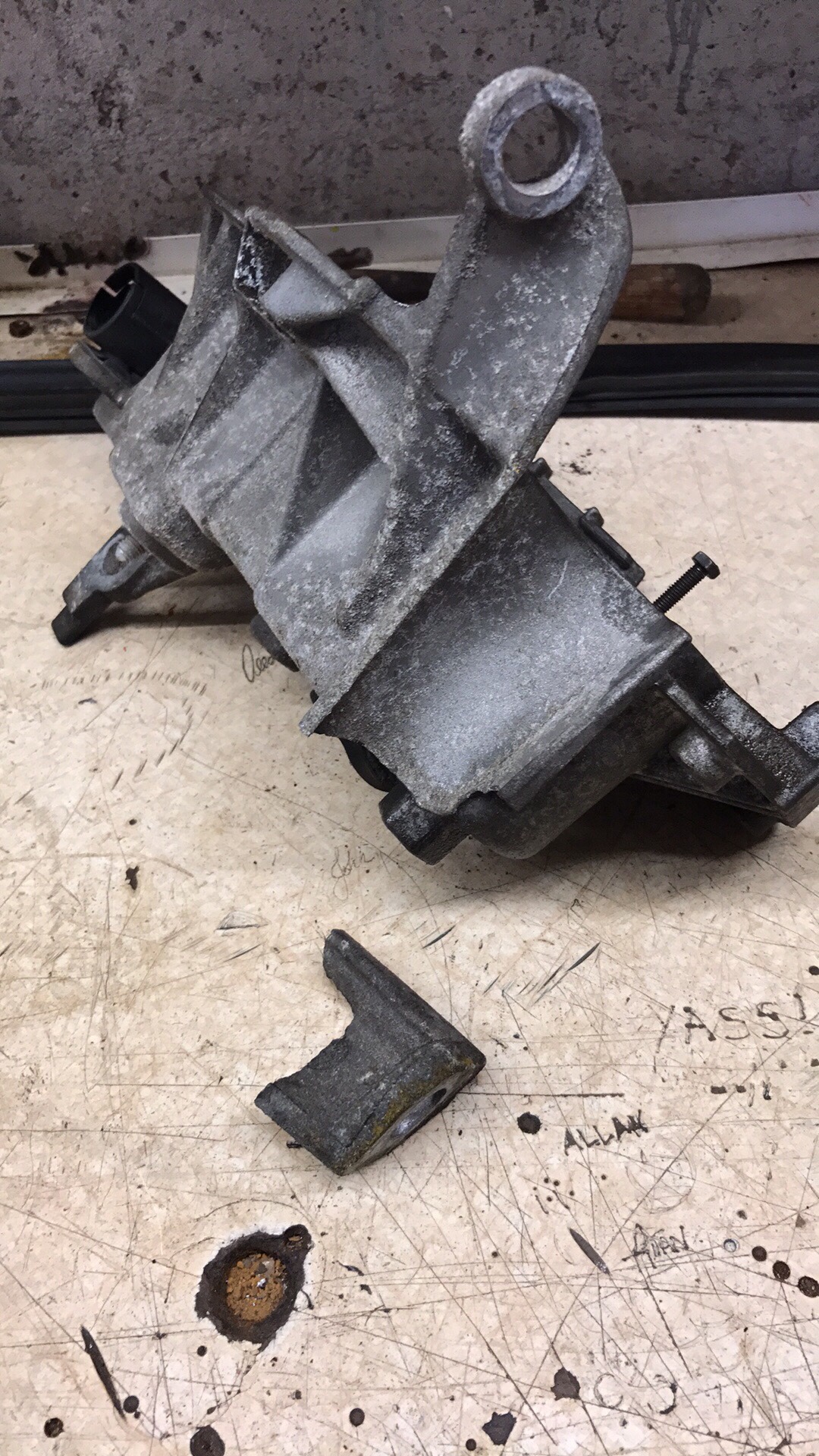

With the clutch off I discovered that this was the cause of the problems. Relieved I decided that the box would be okay and just a new clutch would be required:

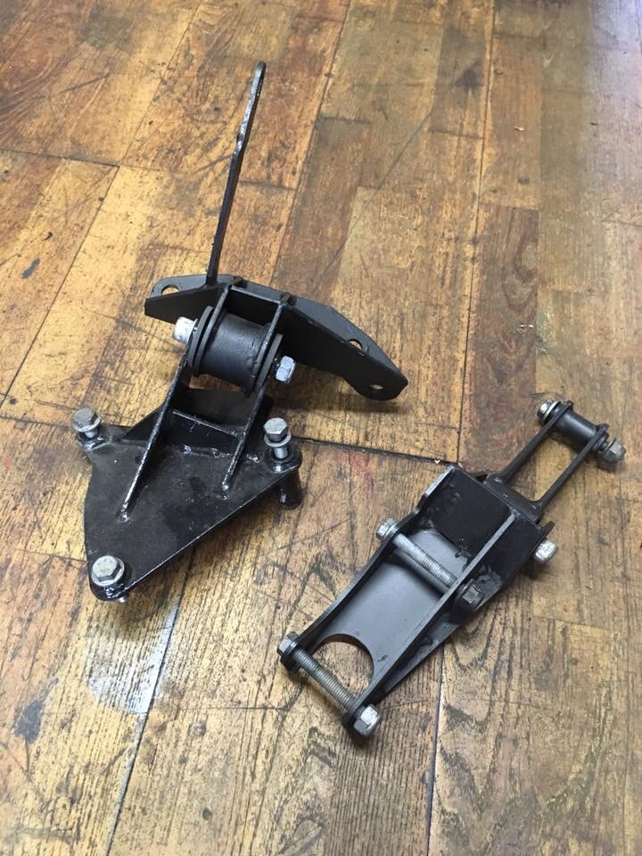

Upon removal I discovered this mount was broken:
I didn’t like it anyway, so managed to pick up a second hand PMS one:

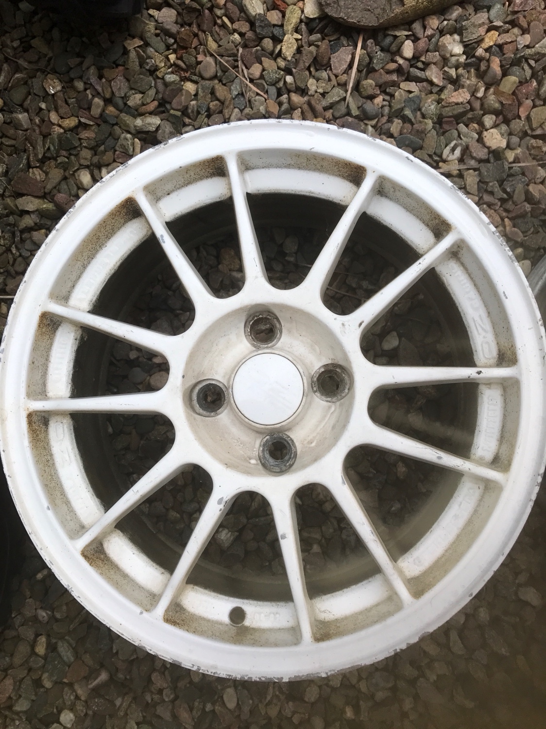

OZ Superleggera’s because they were cheap and why not?

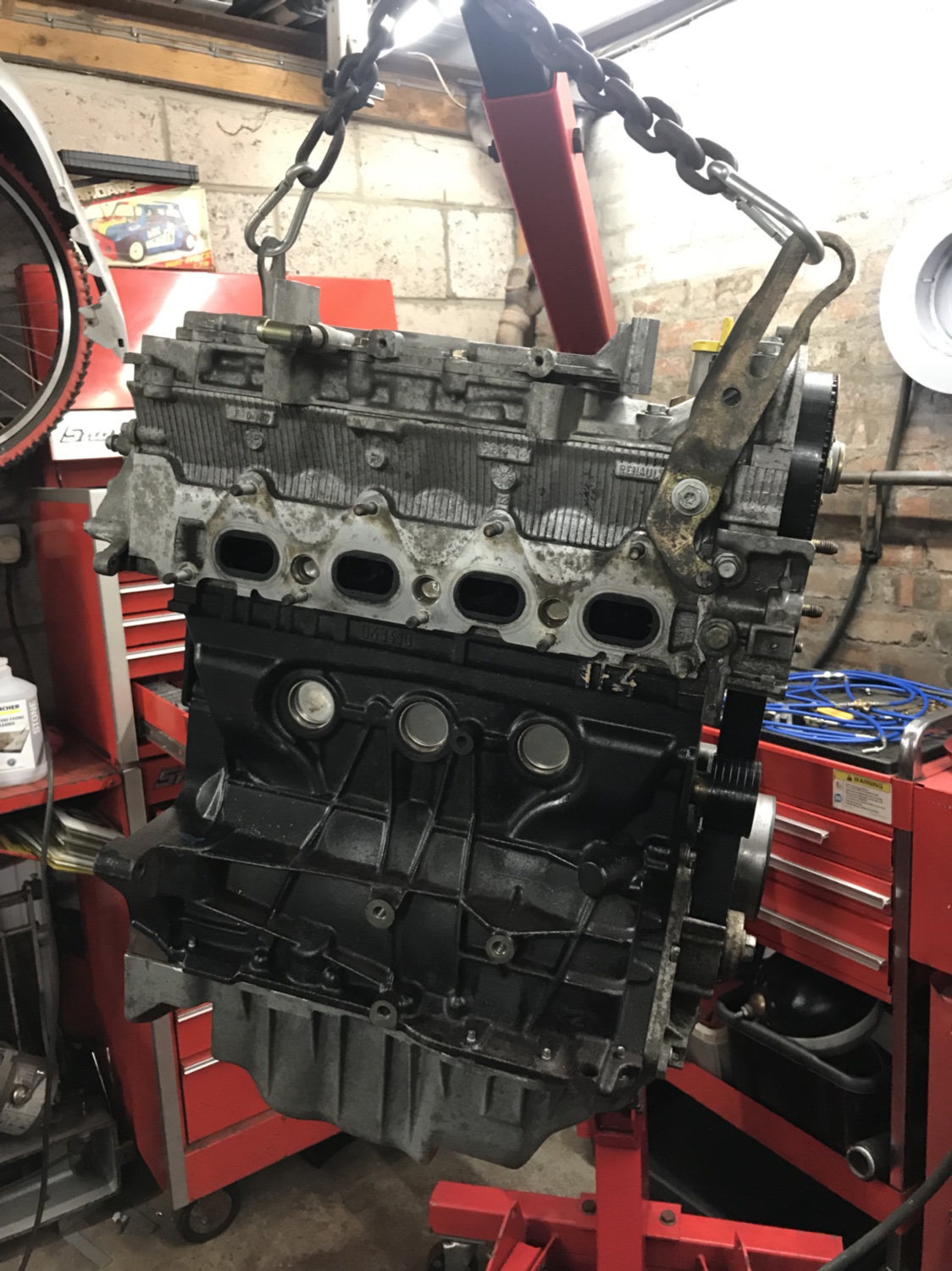

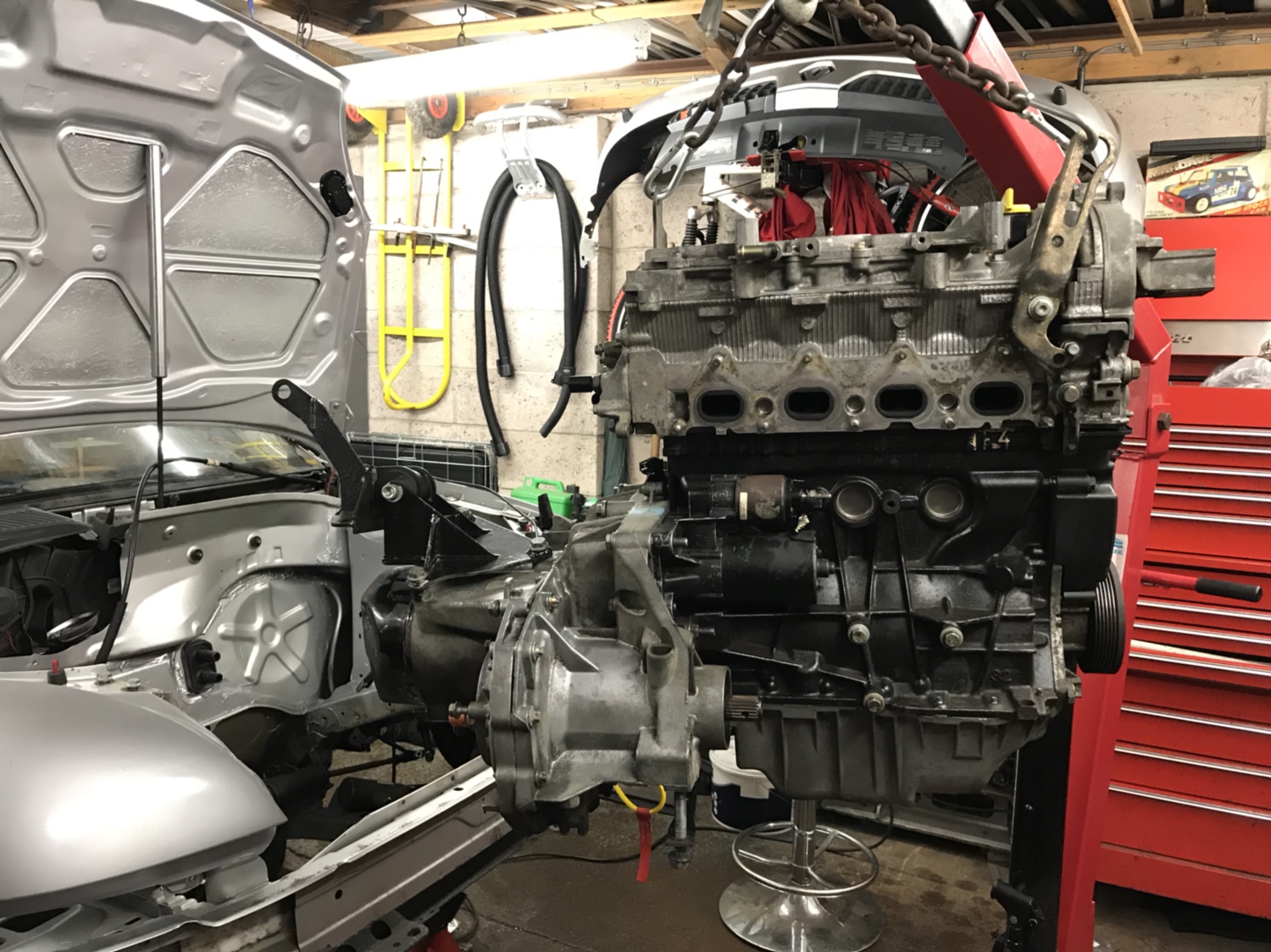

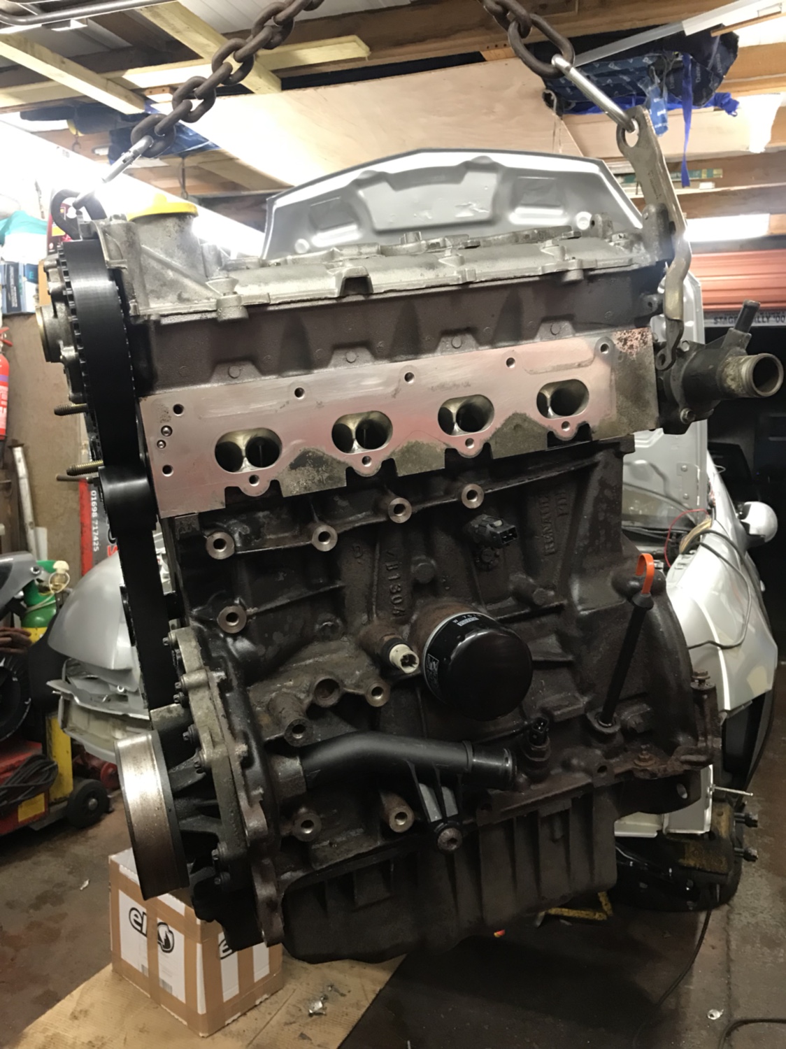

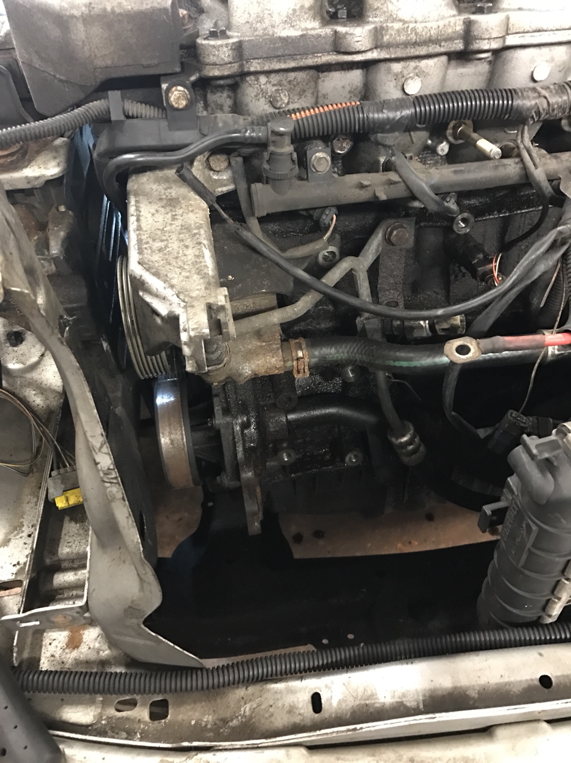

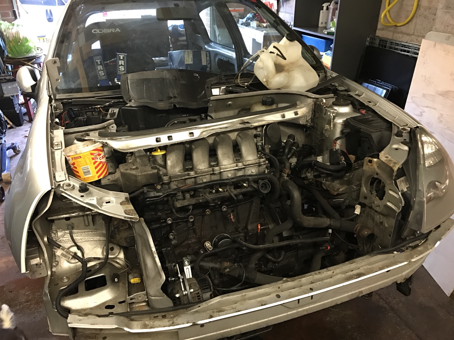

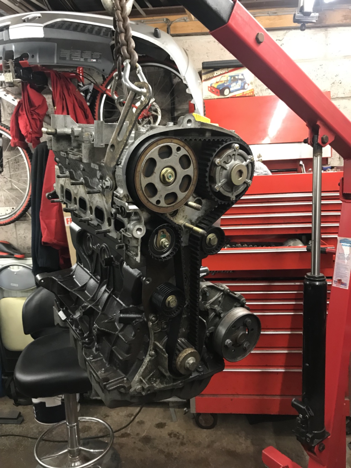

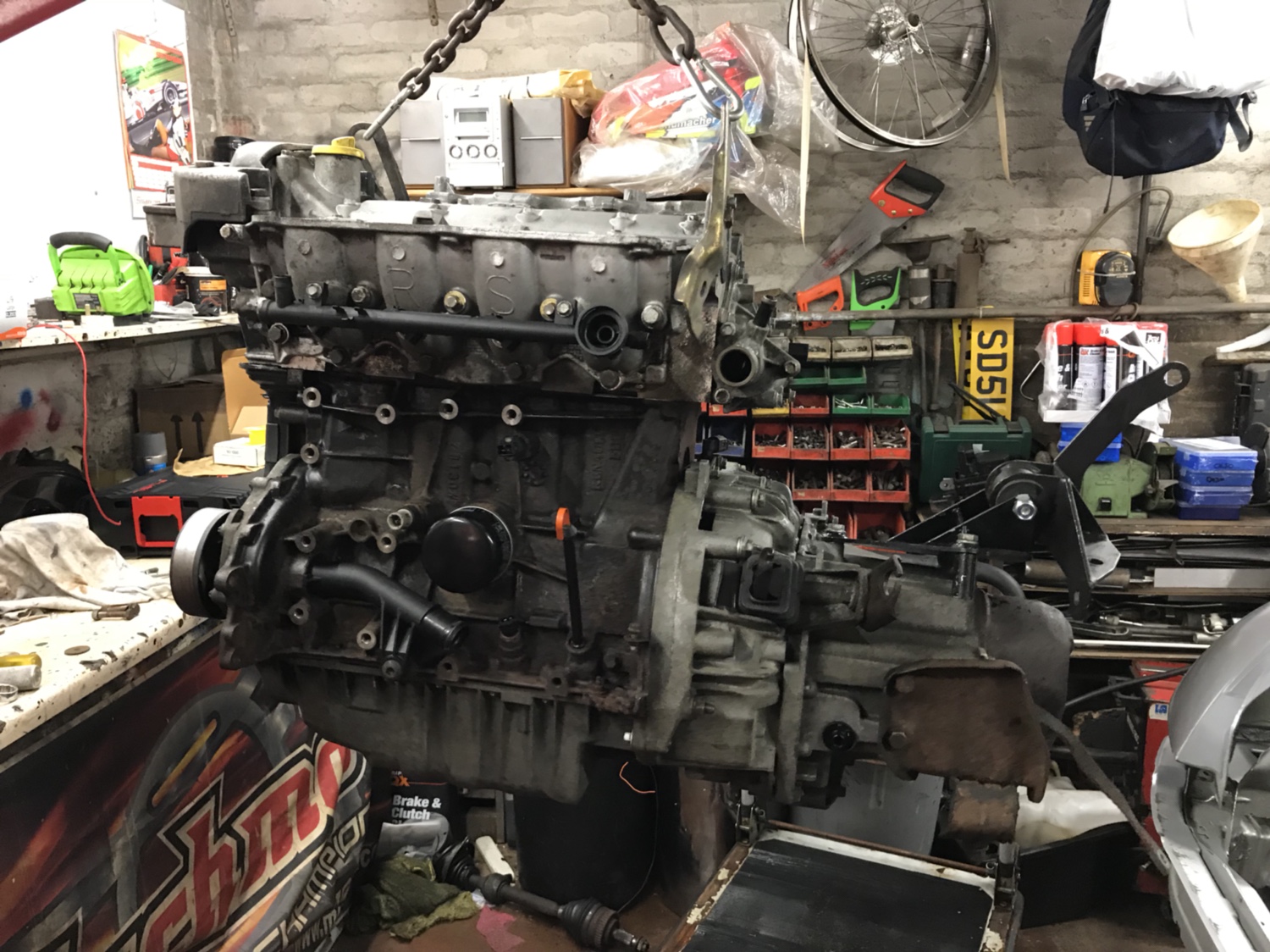

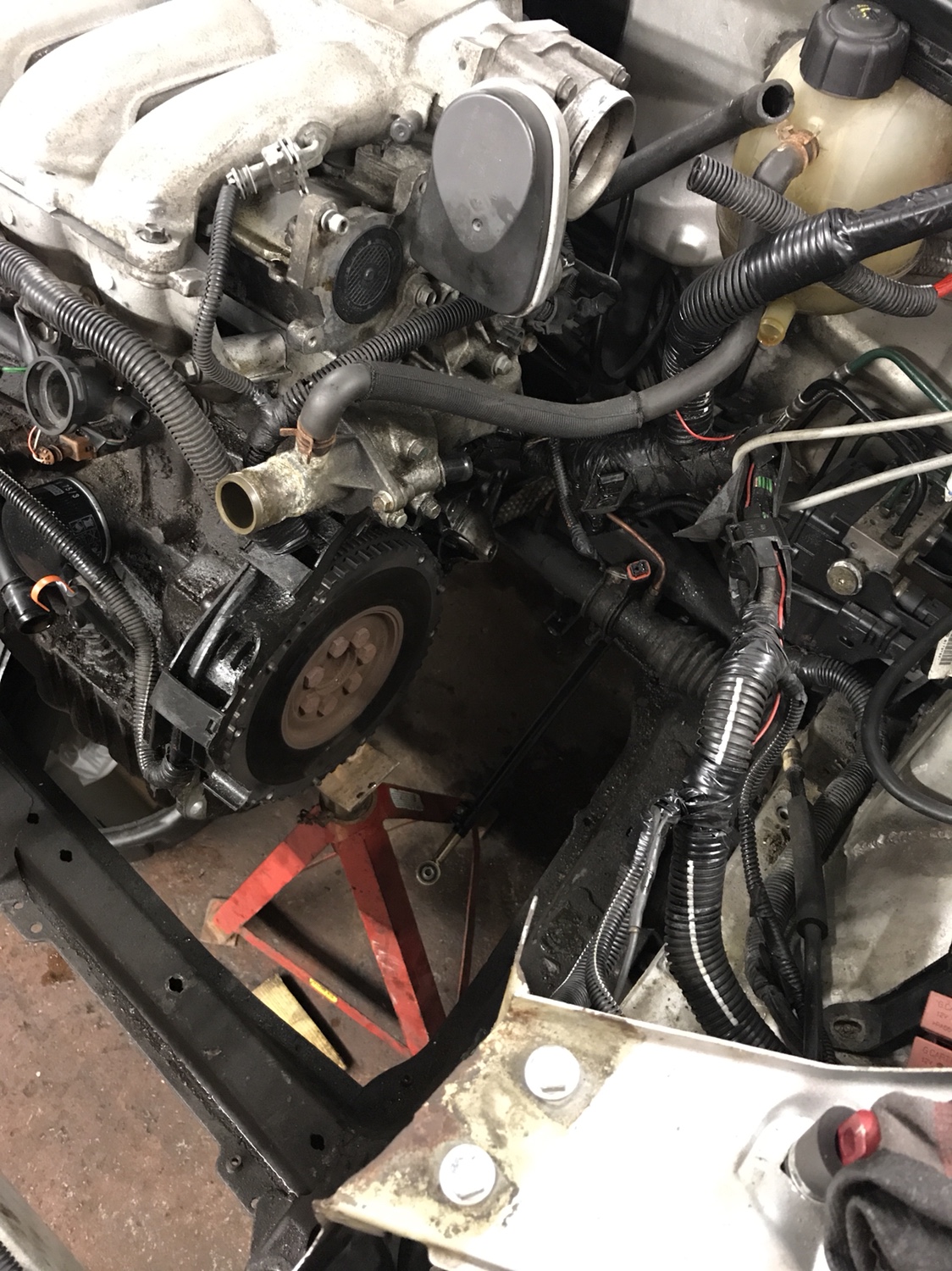

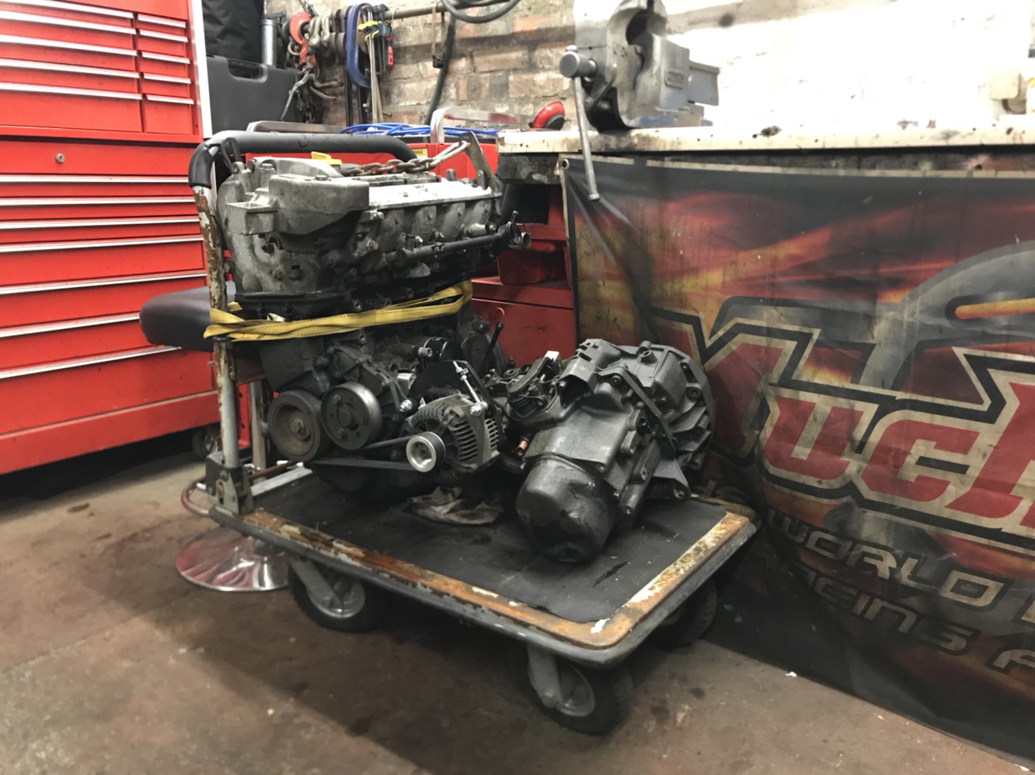

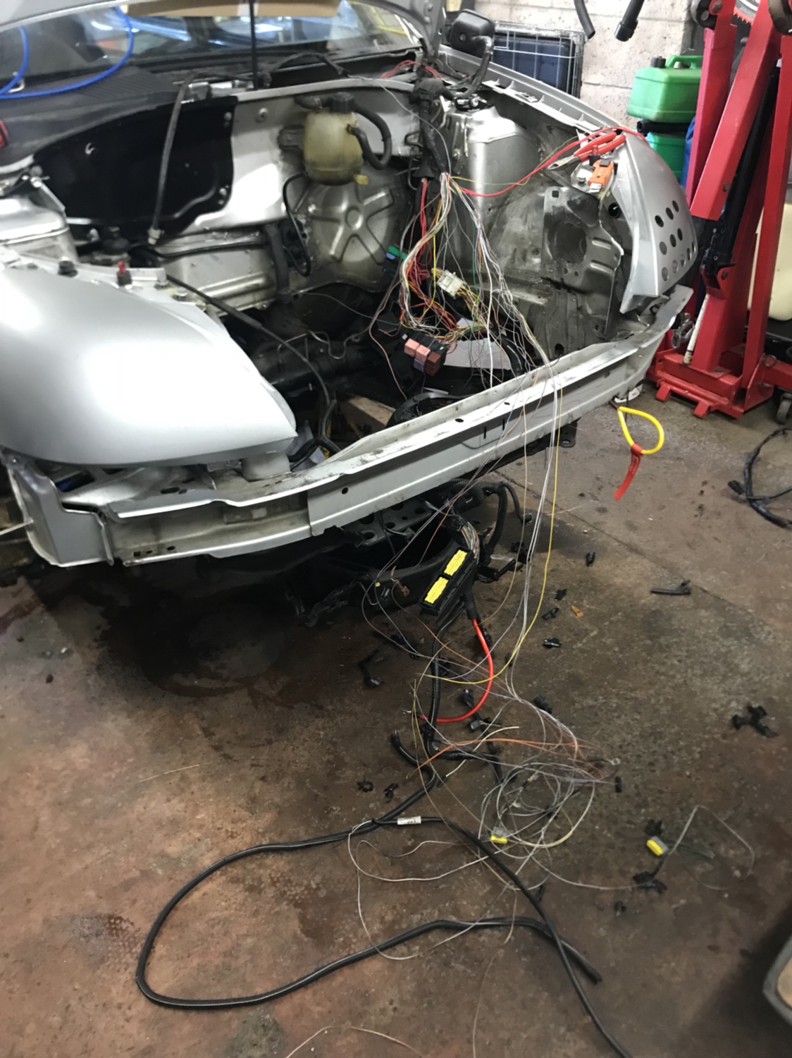

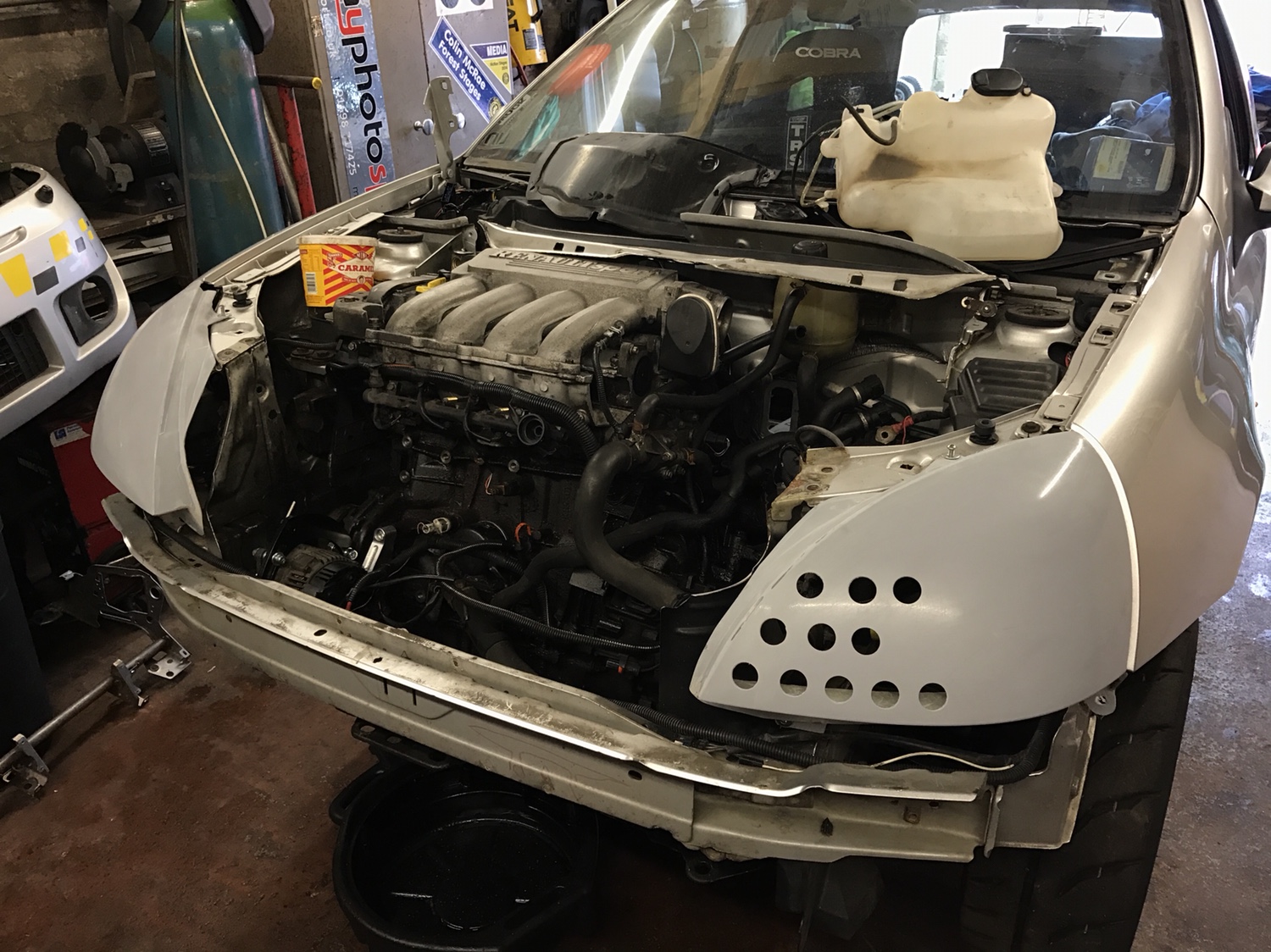

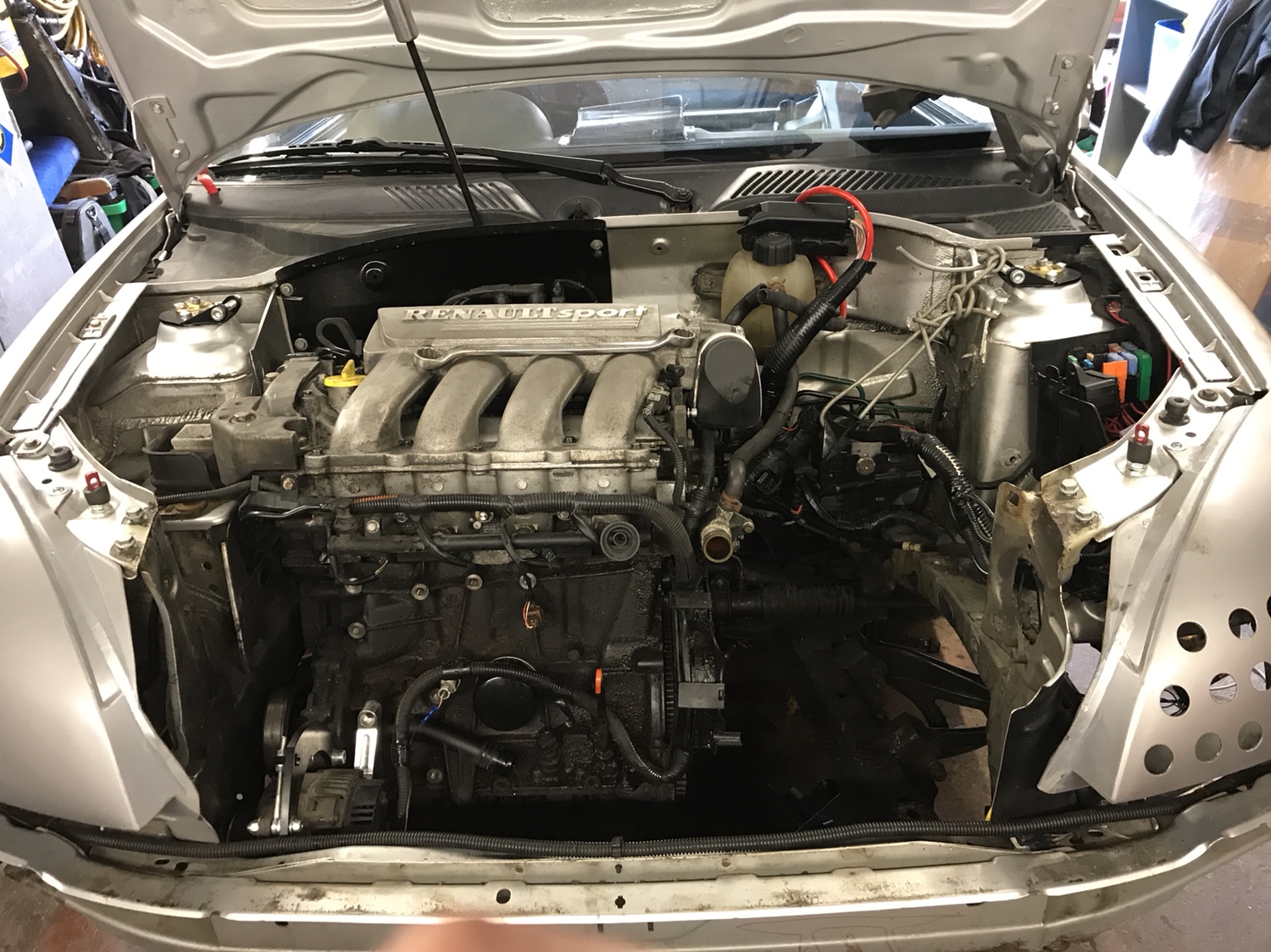

Then I decided that the next sensible step was to remove the engine, this would give me the chance to clean and tidy the bay. Also fitting the engine and box together would be easier than trying to wrestle the gearbox back into the bay.
More wiring to be removed and tidied:
Engine and box - this trolley has had a few different engines over the years!

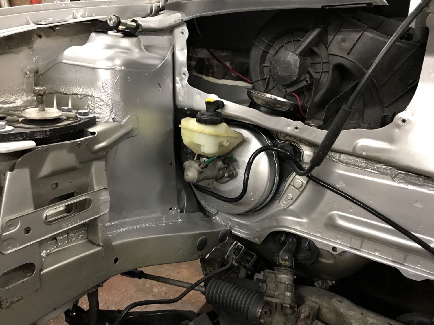

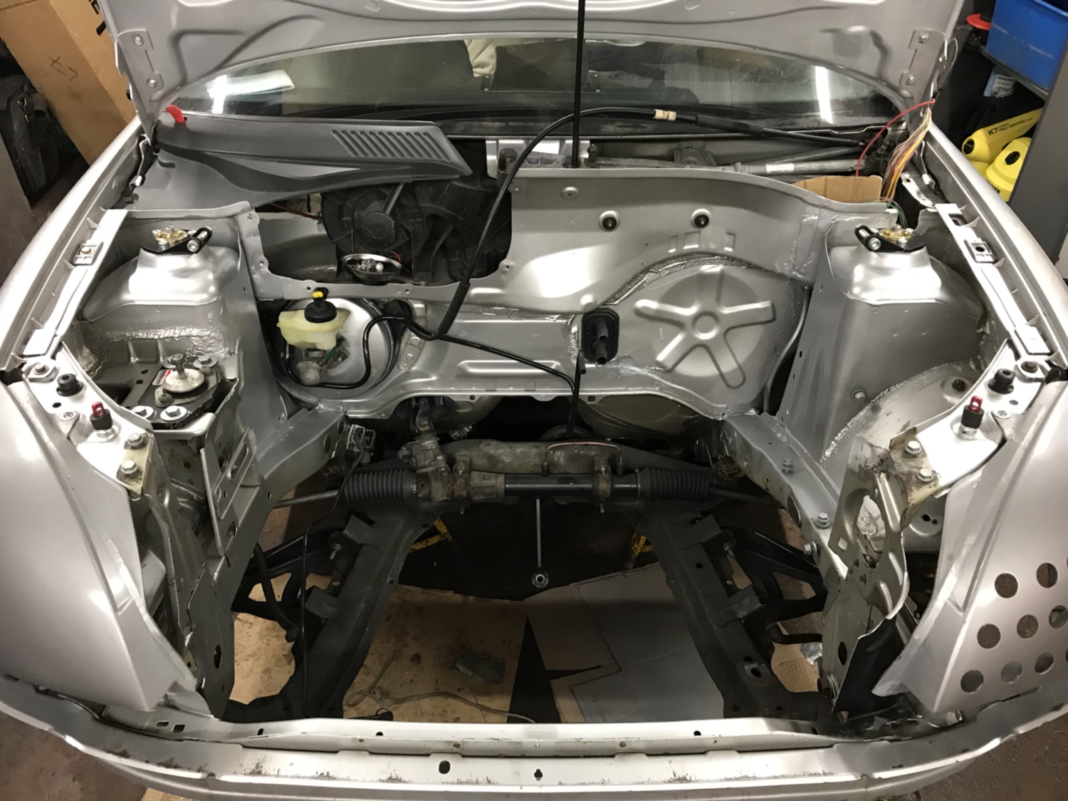

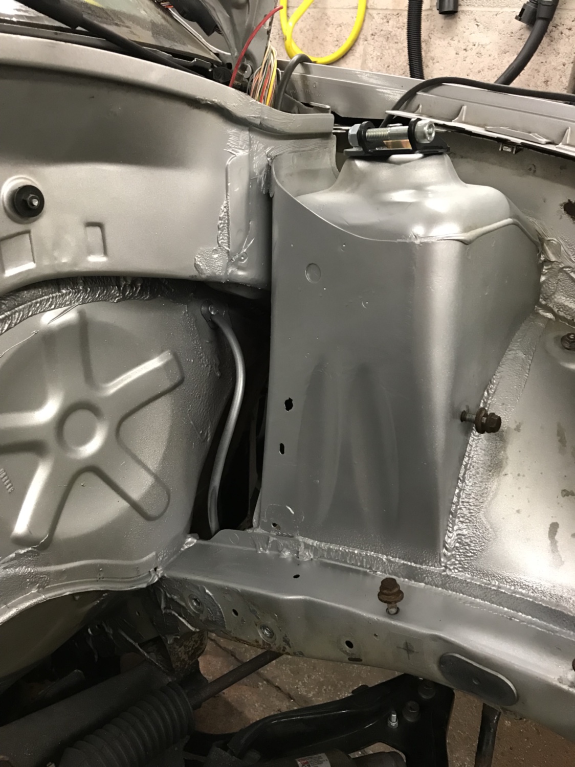

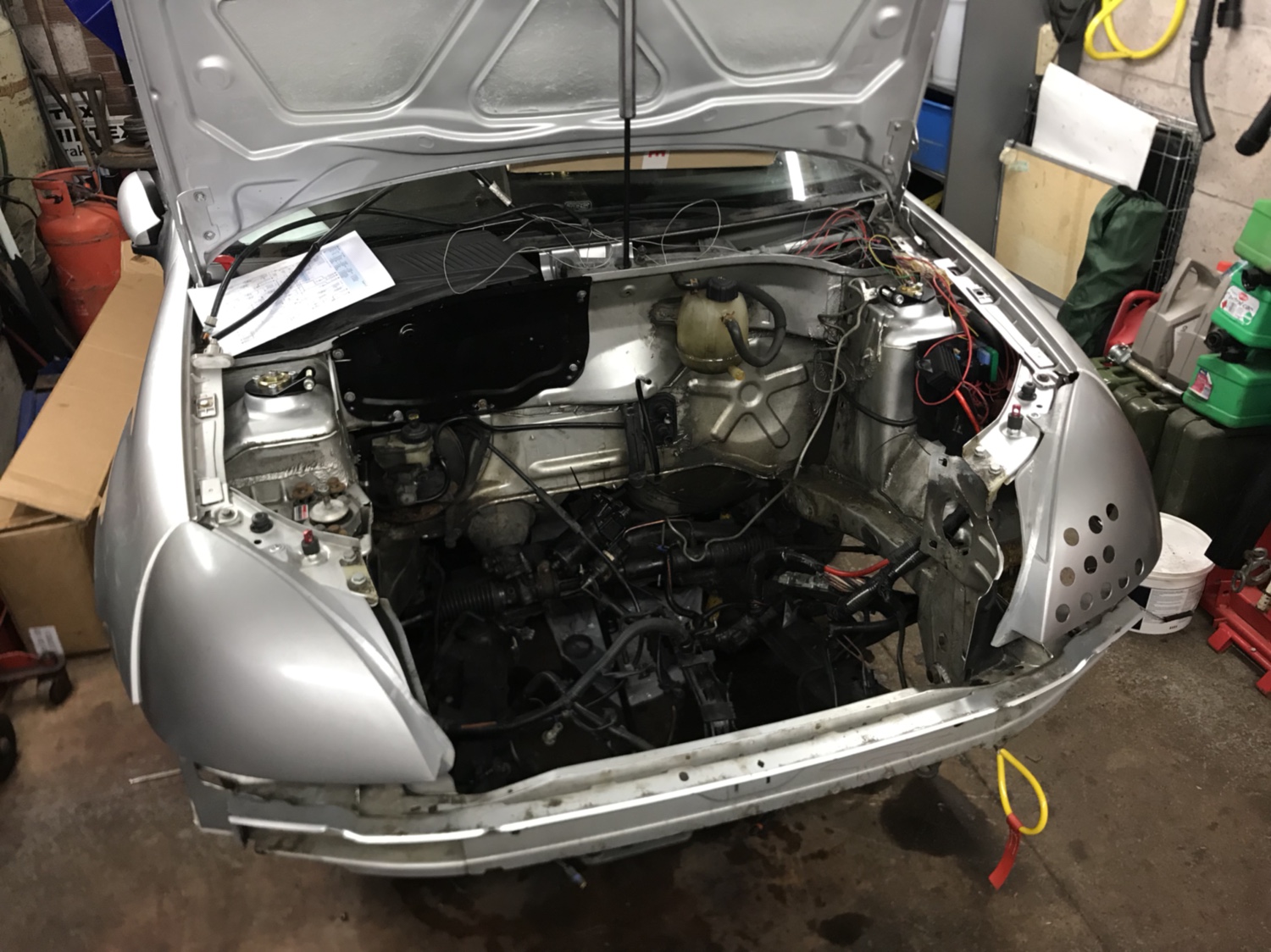

The engine bay was filthy. But it was December and it was genuinely -6° outside. I couldn’t wheel the car outside and hit it with the pressure washer could I? Yes - Yes I could. I wouldn’t recommend it, but it was kinda holding up progress so needed done. No pictures of this stage because it was pretty horrible. The water was freezing instantly and the driveway became an ice rink and the pressure washer broke. However. Mission accomplished. Here’s a before picture:
I pulled the car back inside, shut the door and fired up the space heater so that me and the car could defrost a bit. I then dried the bay off, removed the ABS pump and all lines plus a few unnecessary brackets and painted a few bits to tidy things up.
After:

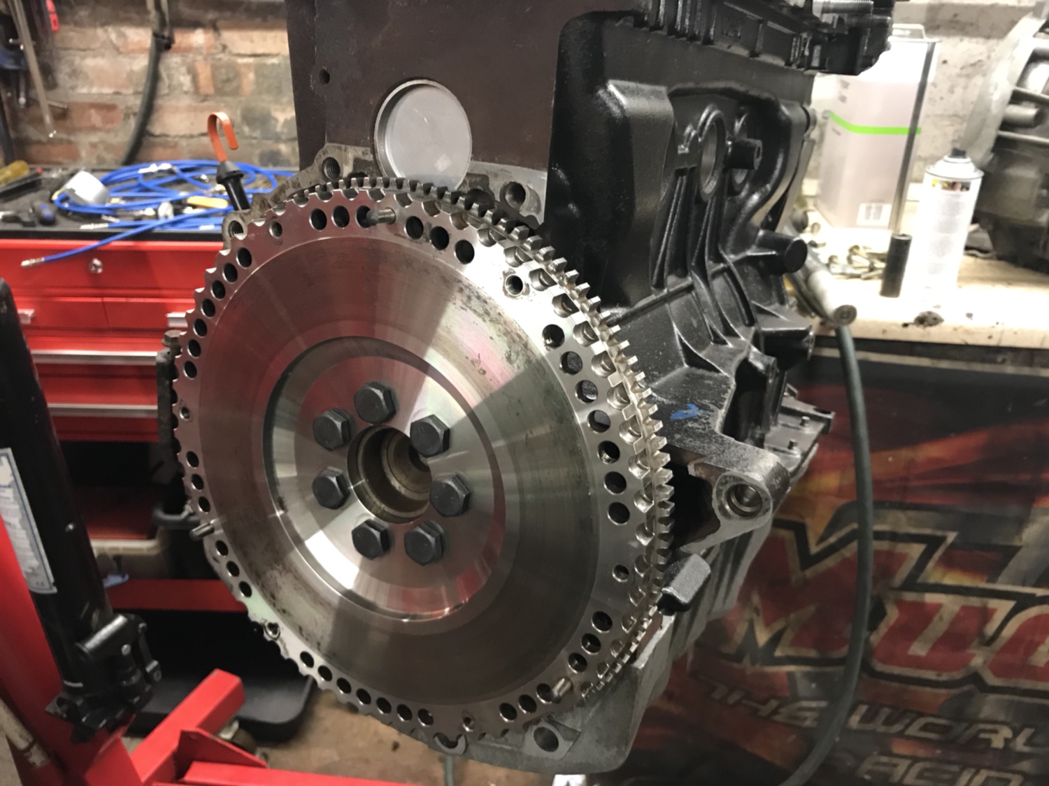

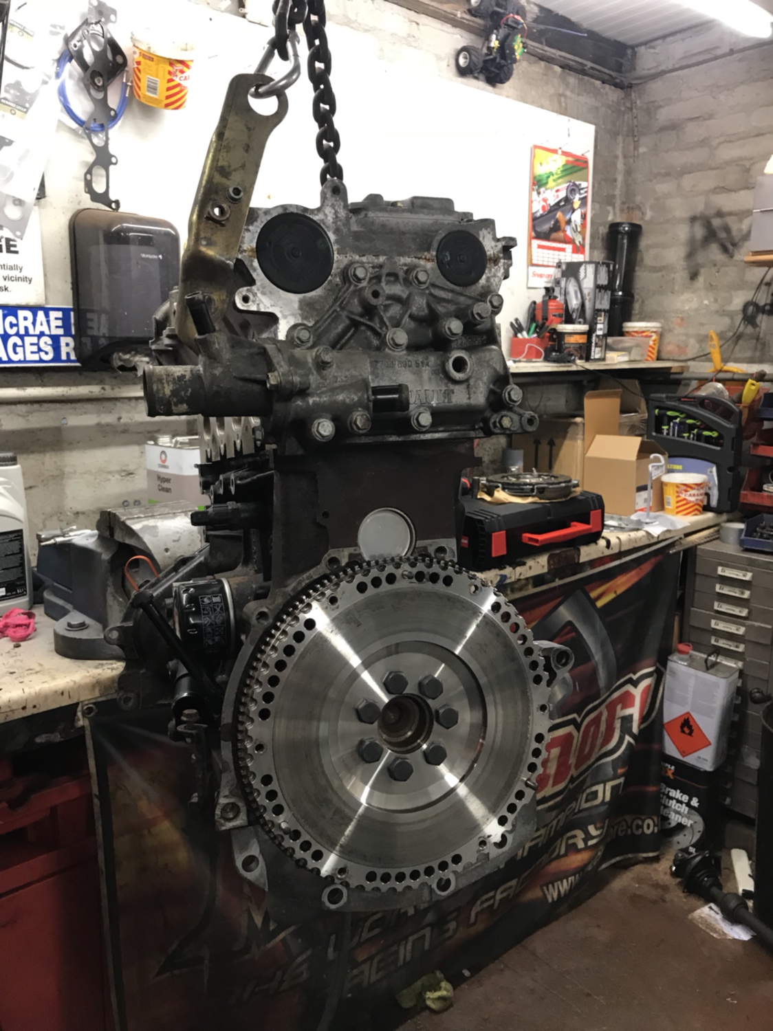

Next job was to clean up the engine. I didn’t bother painting at this stage. I picked up a used lightweight flywheel and fitted this at the same time before putting the gearbox back on.
So that’s the engine and box all sitting ready to just drop in.

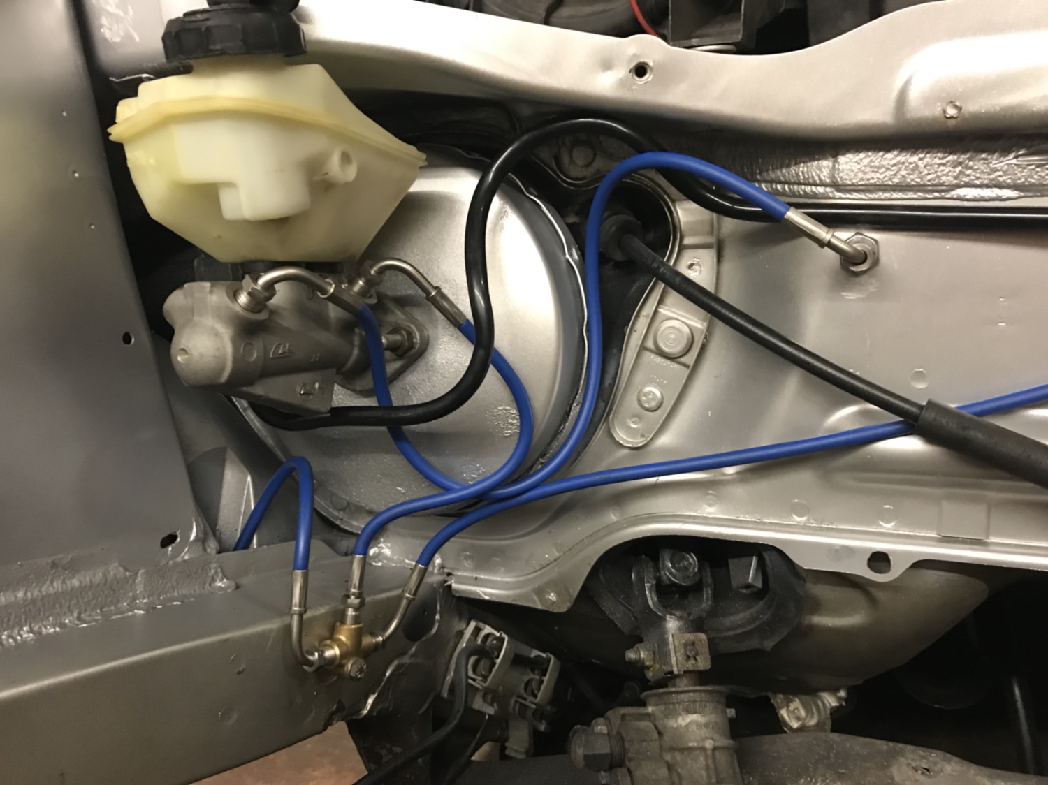

Then I fitted the Pro-Line Motorsport ABS Delete Kit:
Next I removed it all again... There’s method in the madness though. That’ll be the next post!

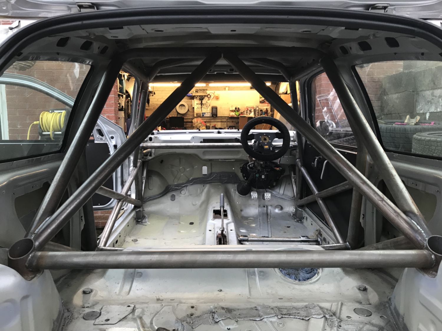

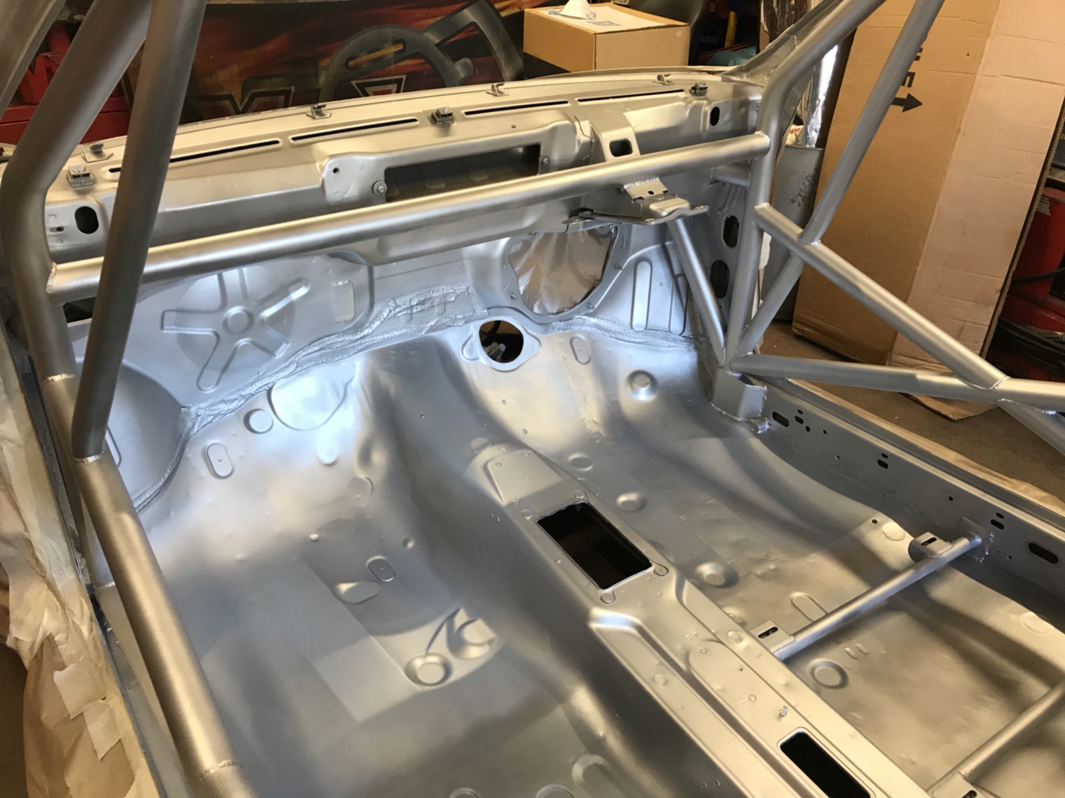

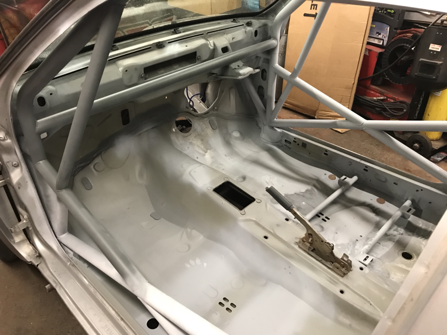

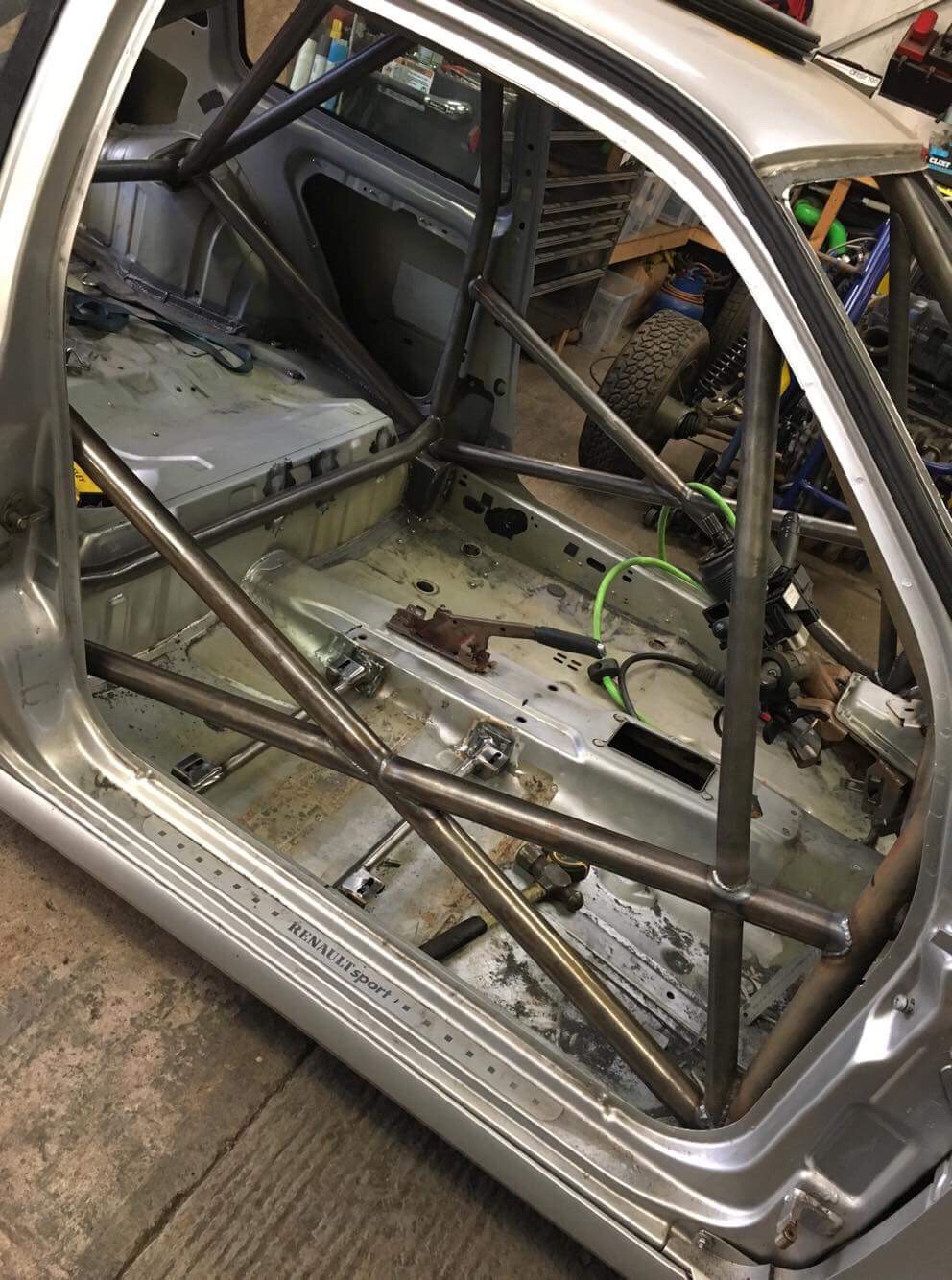

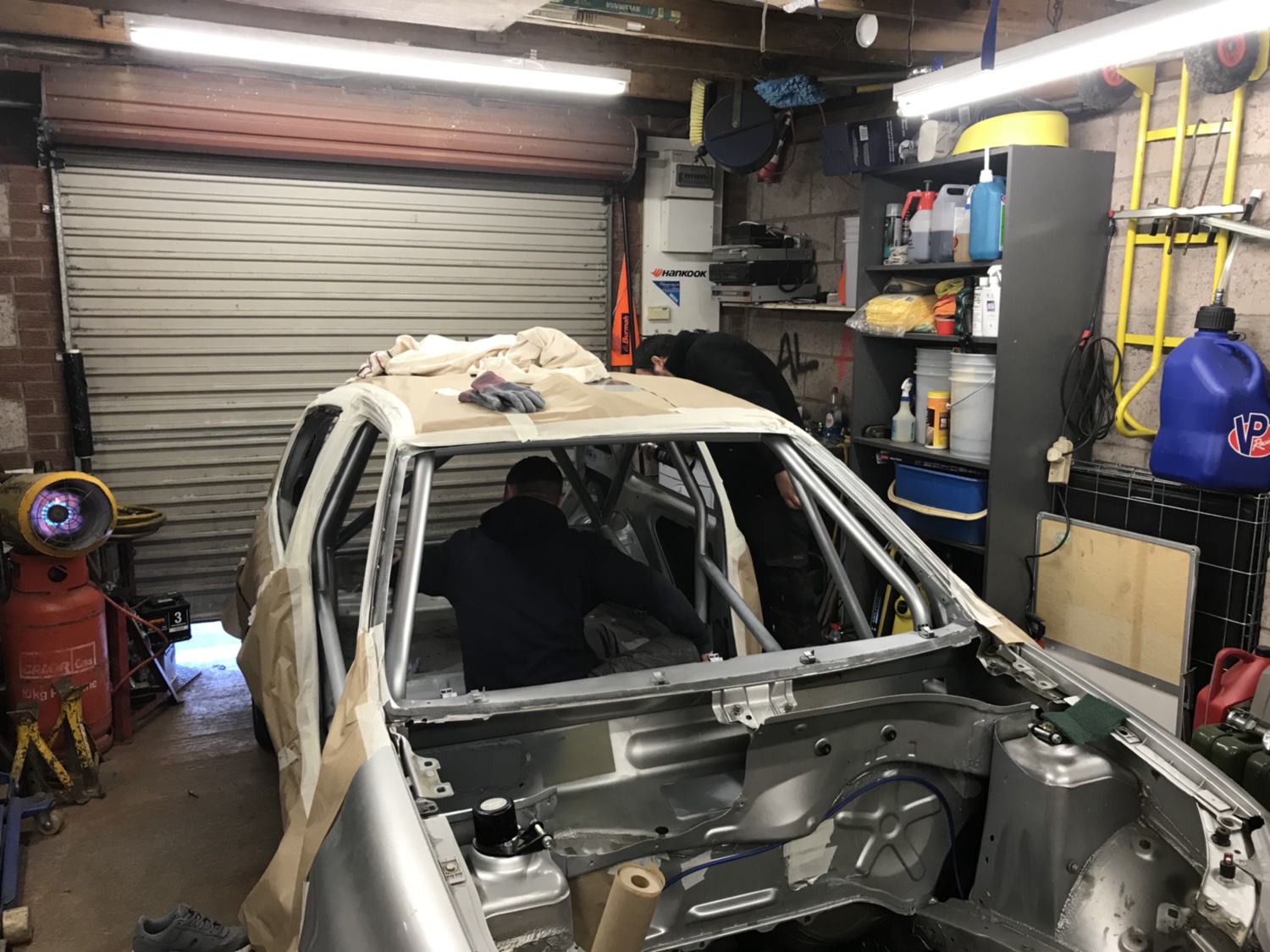

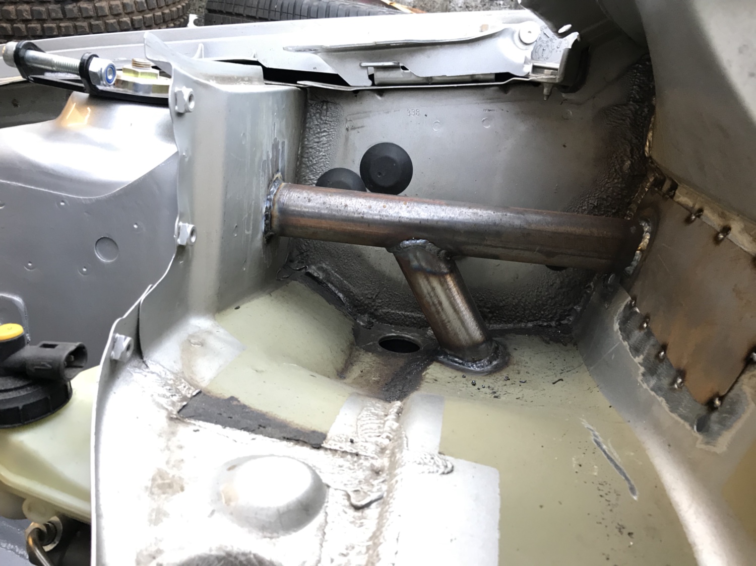

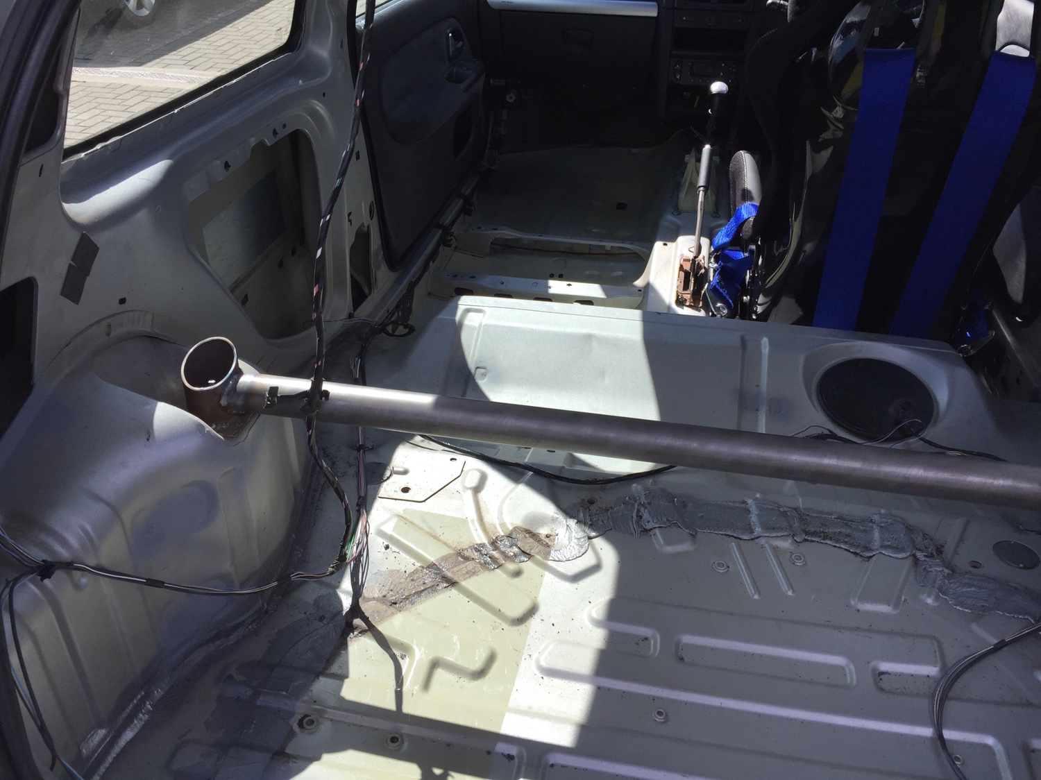

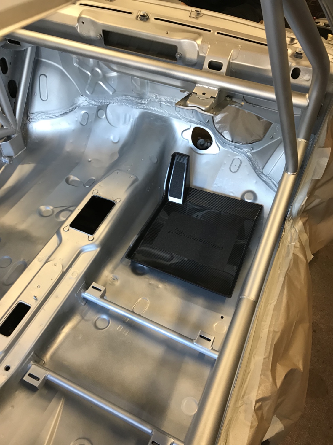

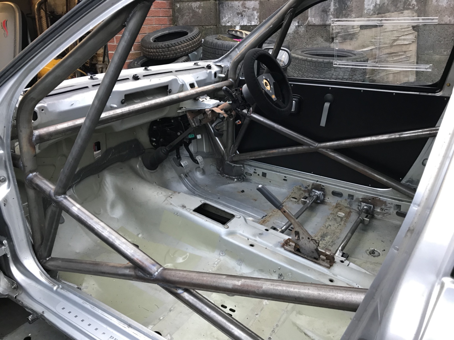

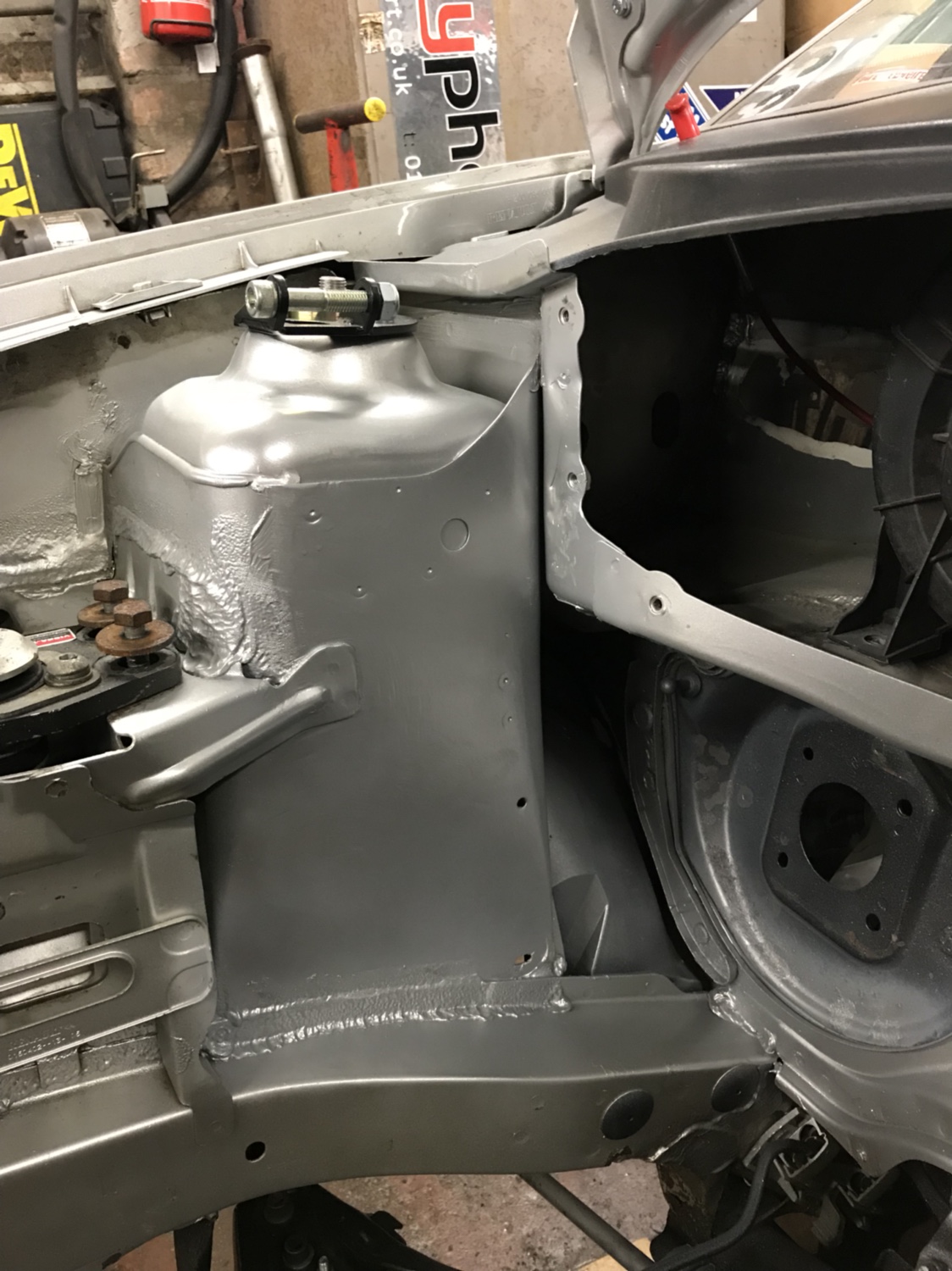

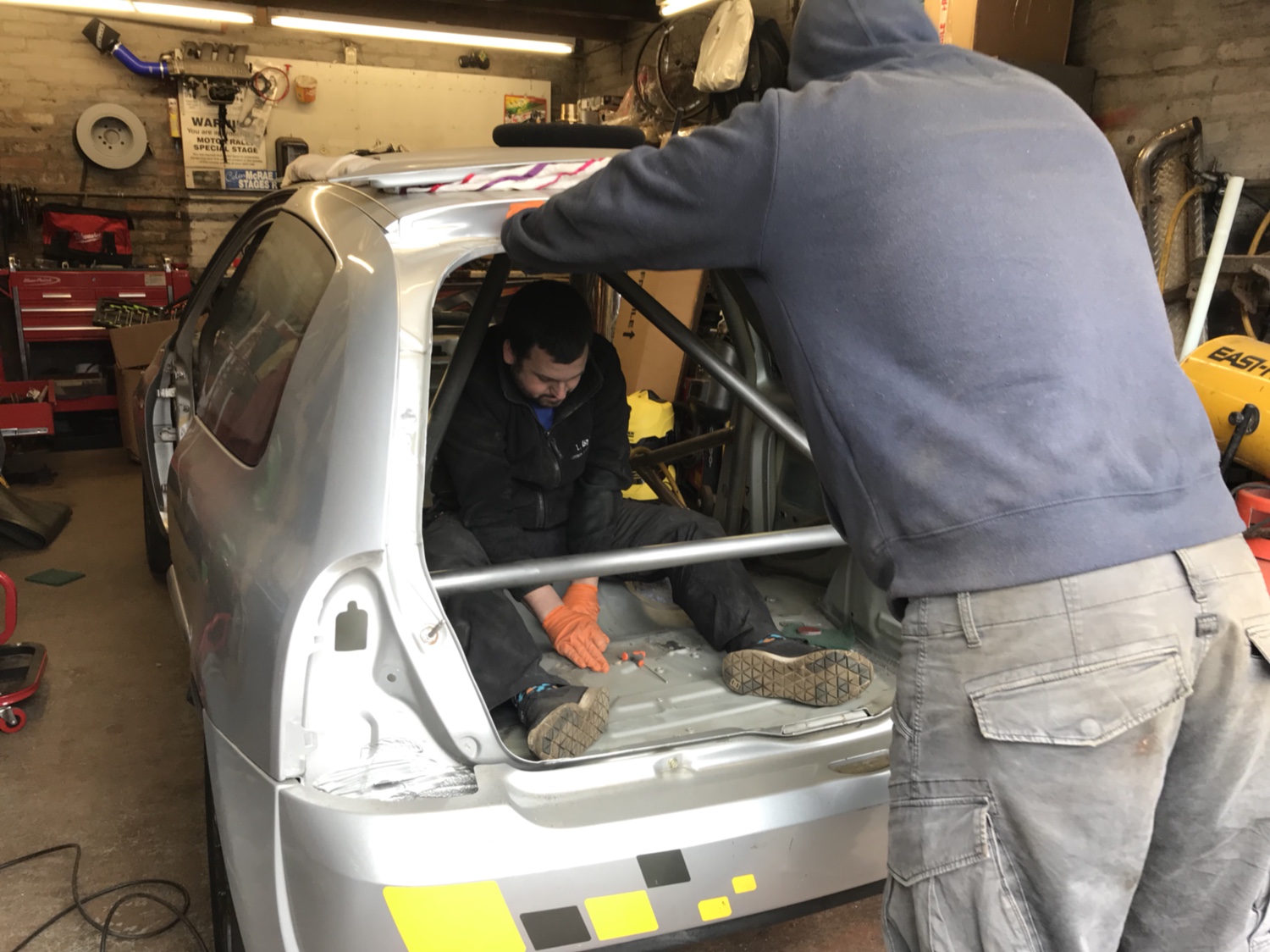

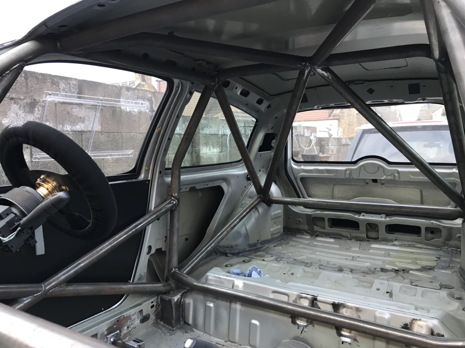

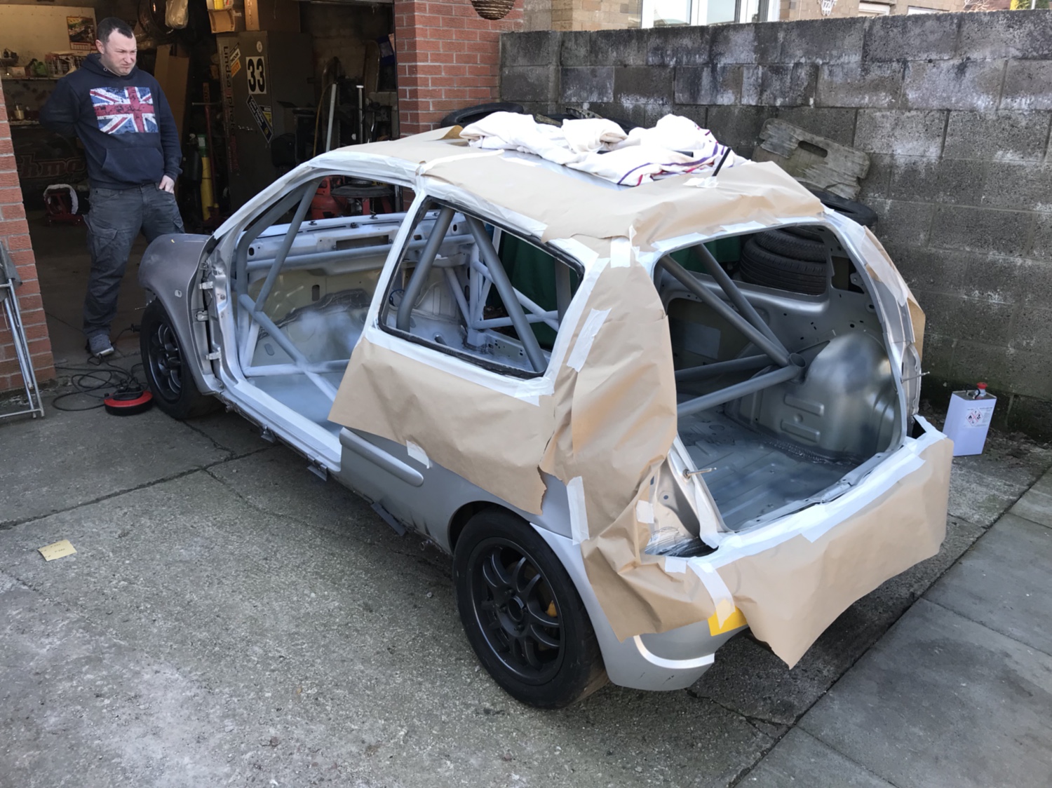

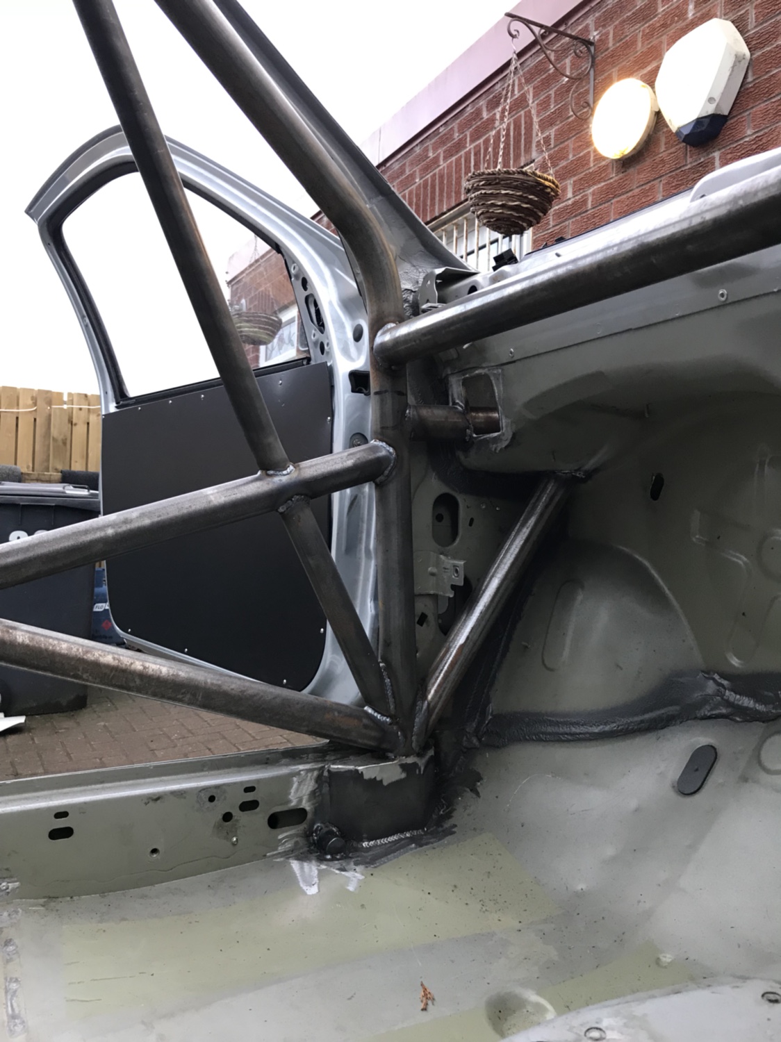

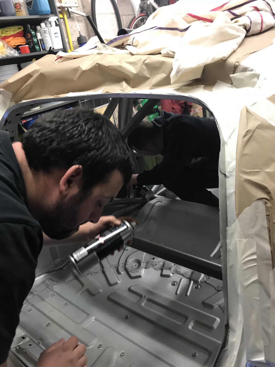

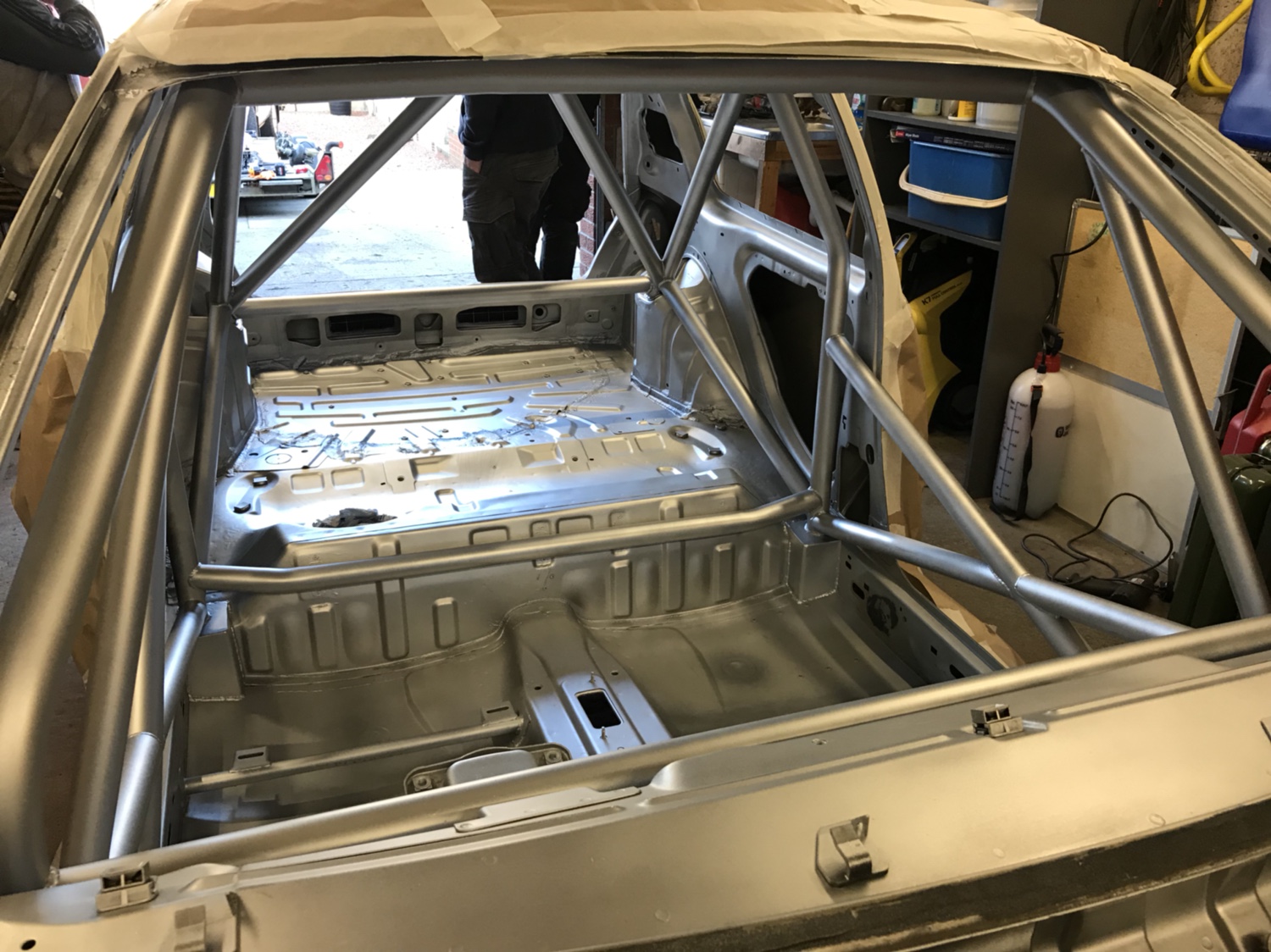

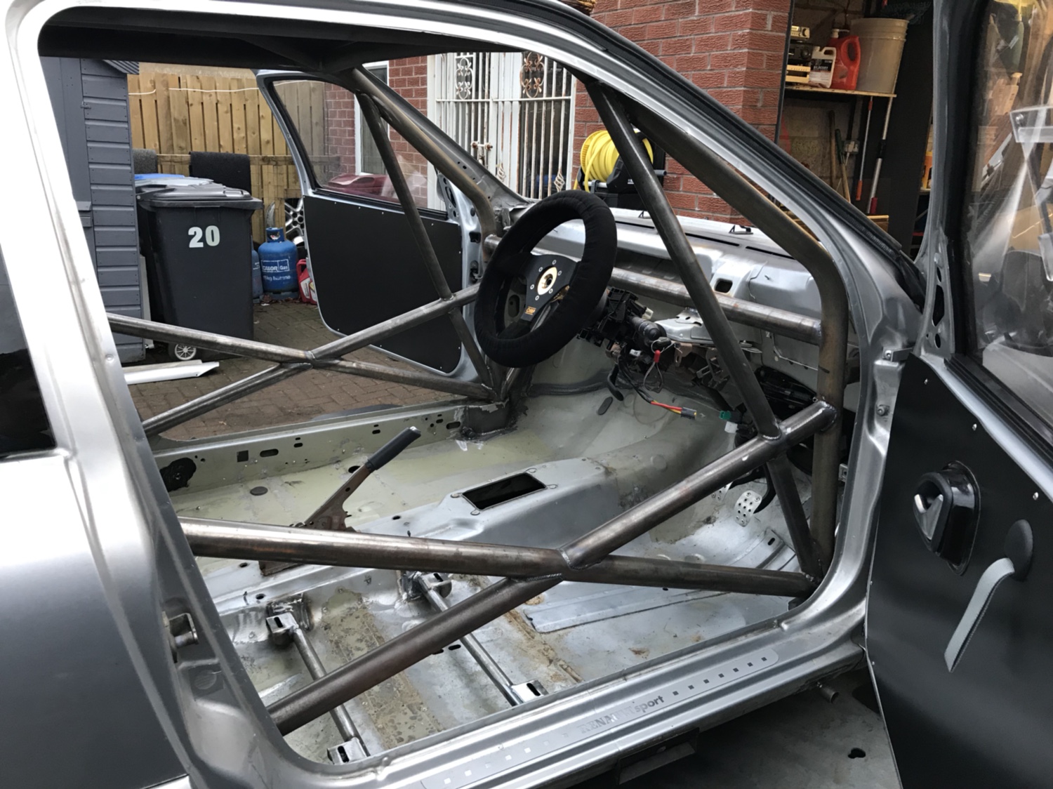

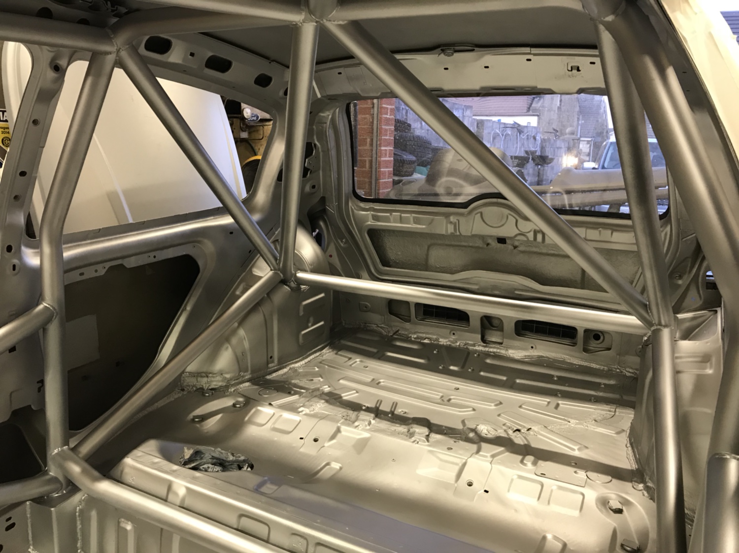

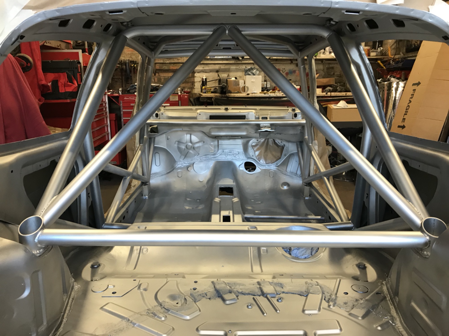

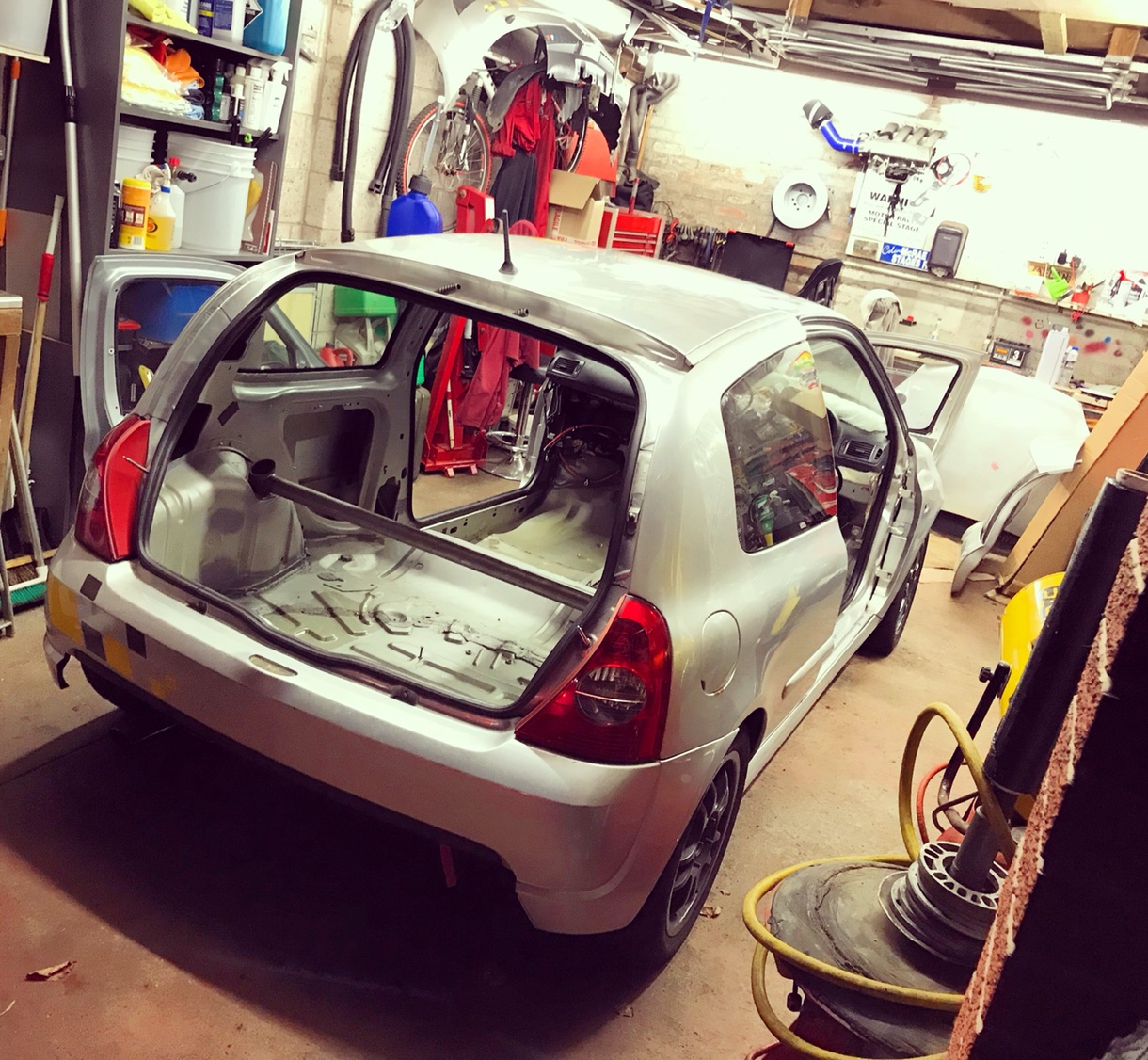

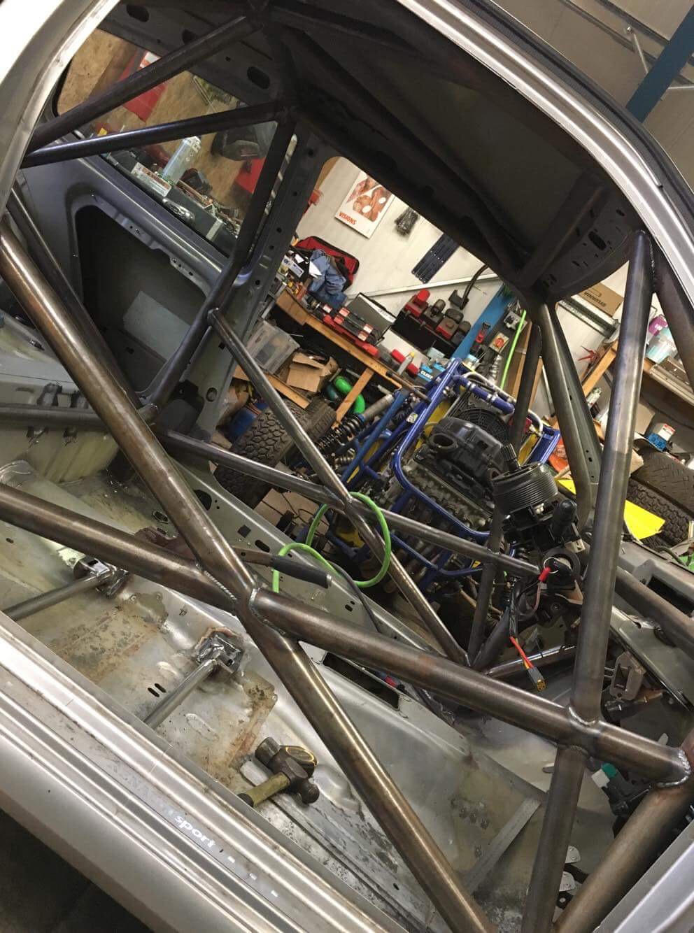

So this post brings us right up to date, and it’s probably my favourite one yet. I’ll just let the pictures do the talking.

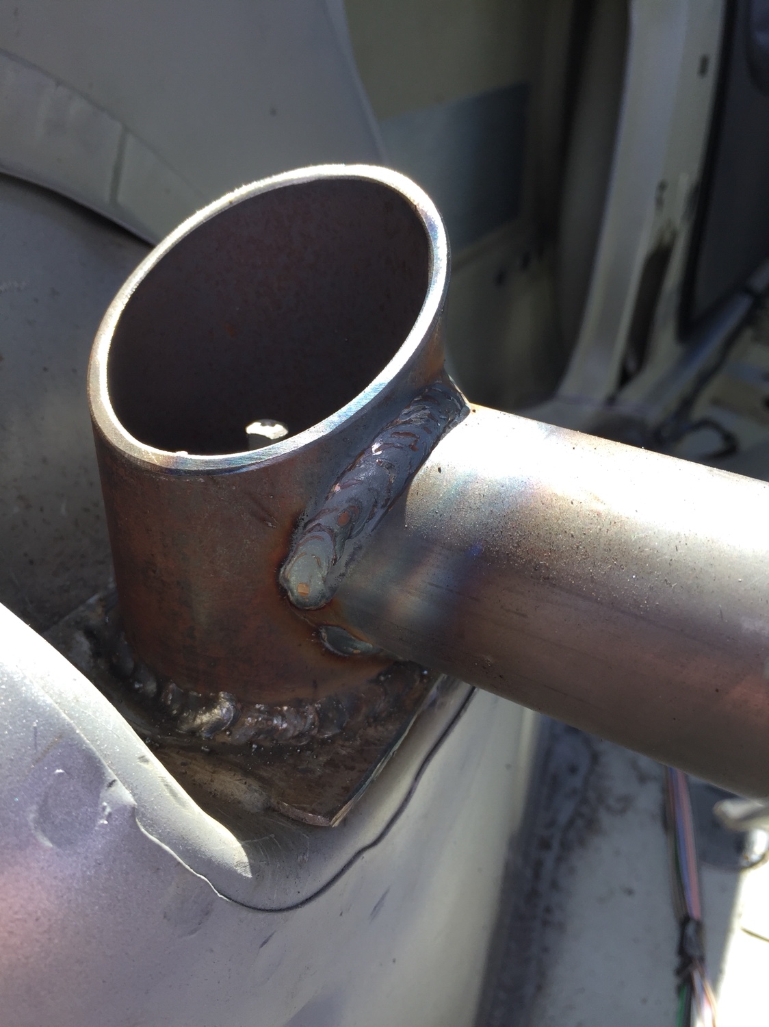

Big thanks and massive recommendation to Scott McMinn of Scott McMinn Motorsport & Fabrication for building and fitting the cage.

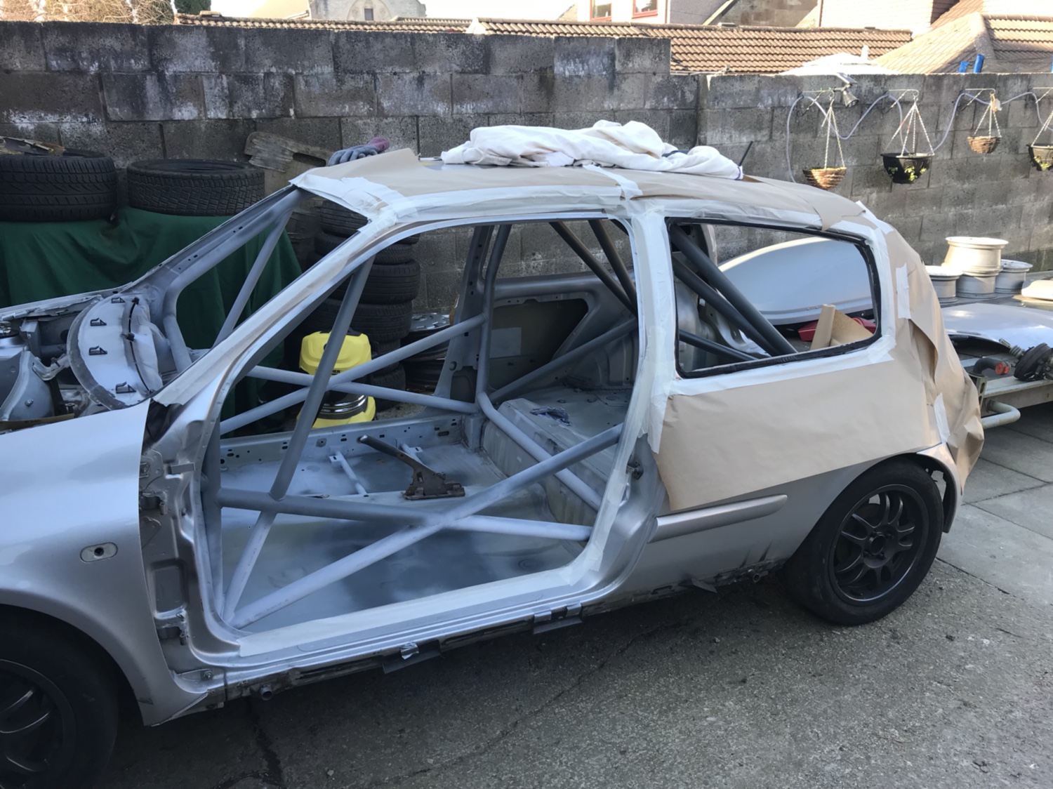

Next step is to paint the interior and then rebuild it. I’ve booked track time for March 25th. So let’s see if I can make it!
CFAB
ClioSport Trader
  Cliosport 182 ff
Well, that escalated quickly Jesus that’s going to look good. Different colour inside surly?
Lunar grey will work very well, satin finish to reduce glare .
Looks good yet again mate.
John Lindsay
  PH2 RS182
It just looks that way from the thread. It’s been a long time in the making lol

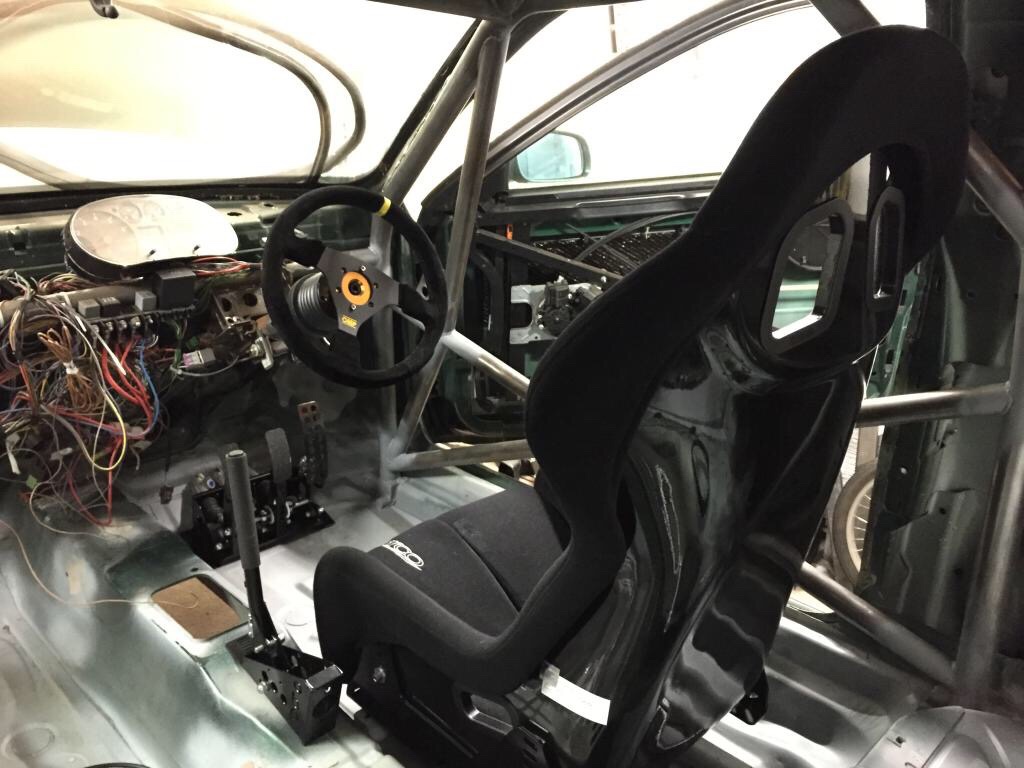

What have you used to mount the dash with. (The metal bar bolted to the tunnel and dash pod)
John Lindsay
  PH2 RS182
Subbed to this too looks really good.
It’s a bit of an old shower pole I think - hollow and light, attached with M4 bolts and rivnuts.
What is involved when fitting polycarb windows? Its something id like to do to mine in the future but not sure if its something to attempt myself..
They literally directly replace the standard windows. If you want you can make them operate as the standard windows do too. I’ve removed all the motors and regulators though and just slotted them into the existing runners then secured in place with a bolt and nut.
