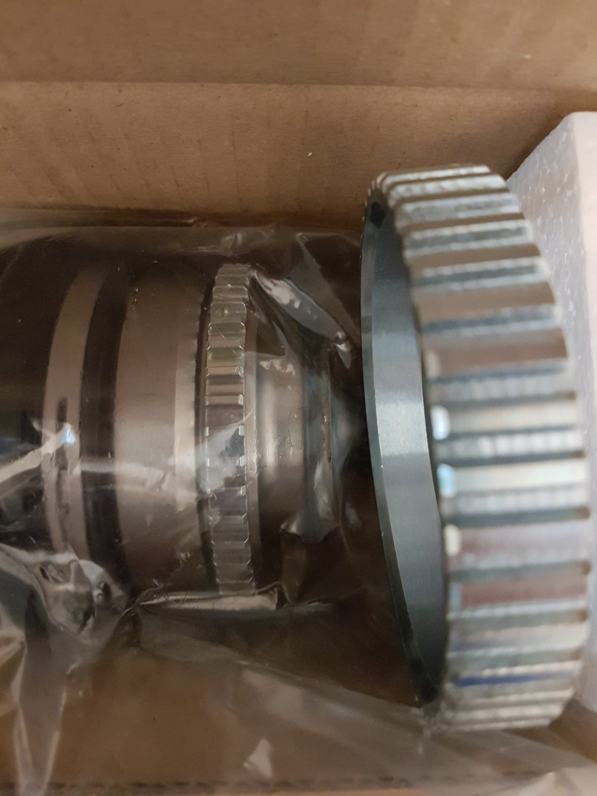

Boot split on drivers side and vibration when u accelerate. Ktec said genuines £147 or use cheaper brand like j&r any thoughts anyone?

Was just checking opinions on them as at work ford ones are expensive and they seem cheap haha but saying that old one knackered so can try. Bearing sizes vary? I got 182 non cup if makes any diff?

15mm. Oh hang on, not sure on yours.
There's two sizes, I'm going to assume yours is the smaller one.
  182
  PH2 172
The larger one is for a cup packed car, 15mm iirc and 44 teeth.
@STEVE.M
Correct, 15mm is for 182 with Cup pack.
Not sure why it would be included with a standard 182 shaft, as the wheel bearings have different Internal Diameters, unless they are not sure which ABS rings are fitted on what, so it`s cheaper to throw them in than post them out if incorrect.
