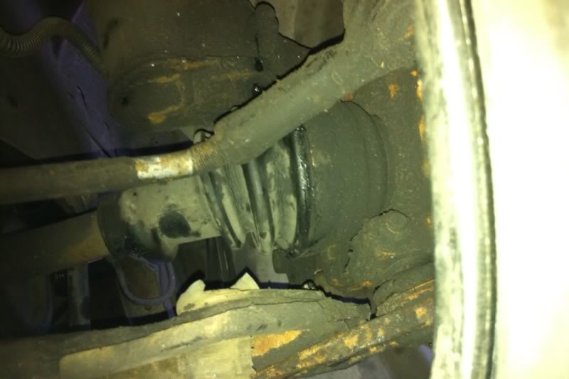

Here's a pic I took before of it
get your mechanic to give it a PROPER look over, if he starts saying a long list of items then think of scrapping/selling the car ( if its only a cheap non sport or something).
theres no point in you finding and fixing one thing at a time, you might spend a fortune then find it its fucked and you might as well of sold it. get a full list of parts you need so you can work out the cost, then weigh up wether its worth keeping or not

Get the tie rod changed and get it looked at, it may not be as damaged as it looks and if not get it fixed up!

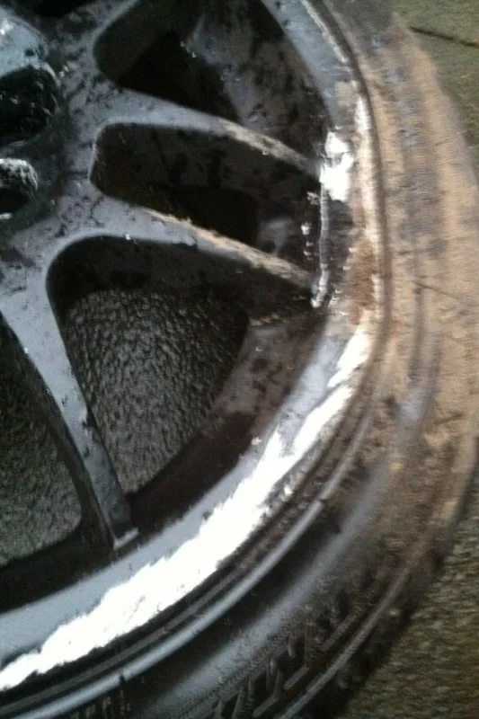

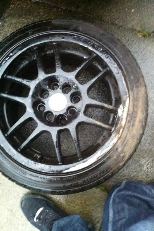

Struggler can you price me on both airbags please via pm? That would be a massive help! Rear seats aren't an issue now thank god. I hit the curb about 30mph if not a bit slower so the alloy being soft I think has taken the brunt I the force (see below)

Wheel...
