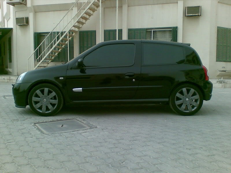

Just ordered the OZs from www.performancealloys.com, I hope the offset they send me is correct. I stated my car as a Clio Sport 182. But again, im not sure if the wheels will fit w/o adjustments? What do u guys think. all feedback appreciated. Thankss

Wel.. thats good to know. Just gonna wait till i get them and check them out on the car. I hope they fit w/o any adjustments. My car is lowered with Eibach springs. So hopefully it'll look ok?

well mine isnt, whats do u think?
