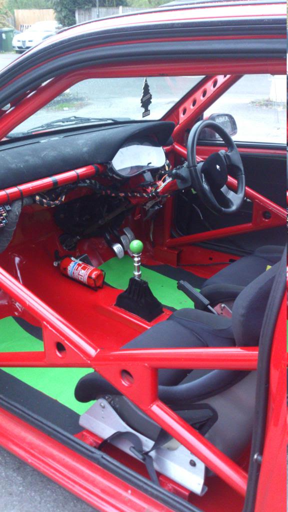

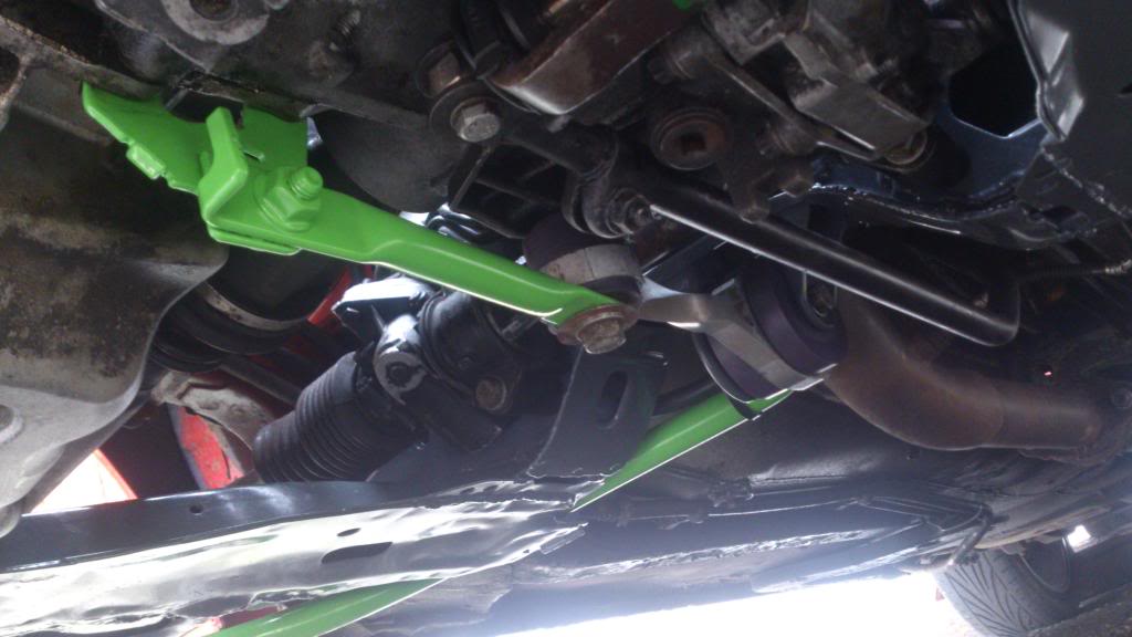

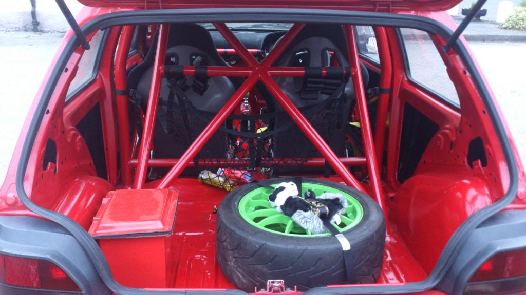

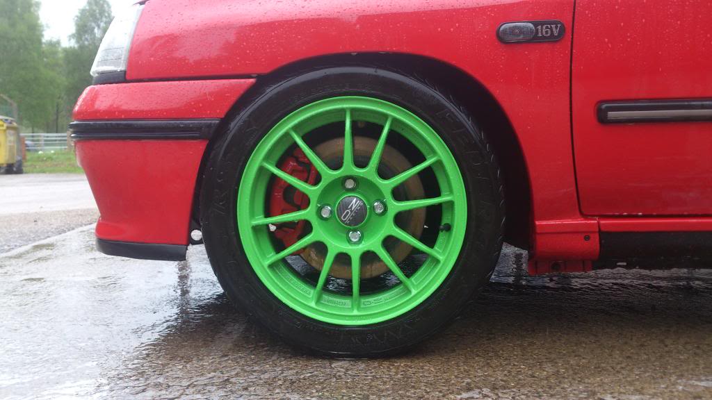

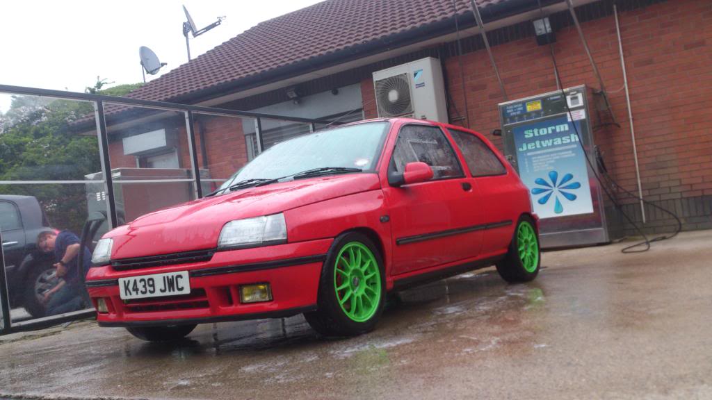

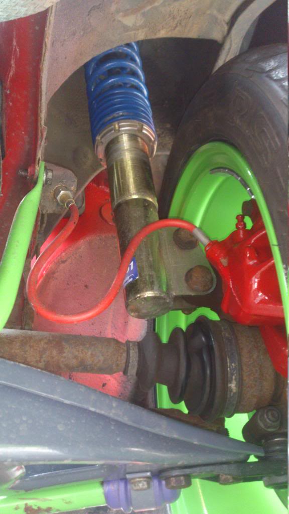

finished the bulk of the work I wanted to get done this weekend, so I'm going to stick my neck out and say its done (no project ever is and even typing now there is 'tinkering' I have planned)
however, its ready for track is the point! and in full marmite spec @TheEvilGiraffe
and @Chip-mk1 castor pic included :)
So list of jobs done:
- fitted Quickshift (with green knob :) )
- fitted passenger seat and harness
- fitted spare wheel and strap
- converted to phase 2 172 dogbone (polybushed)
- painted callipers all round (red)
- fitted DS2500 pads up front
- fitted marmite wheels with RSR's
- removed wiring for second lambda from loom
- reset faults to get the miles remaining on the trip computer to work as well
- wired up the horn (beep beep)
and as said I have thought of more tinker time, but none essential:
- paint and fit pinned fibreglass bonnet (with shiny new phase 1 badge)
- paint up few other bits and bats due to me being picky even though its sposed to be a track car
- ring Adi and get some info on whiteline RARB fitment as needs more custom bits to work and he's probably made loads knowing him!
pics, enjoy or hate, I care not ;)
