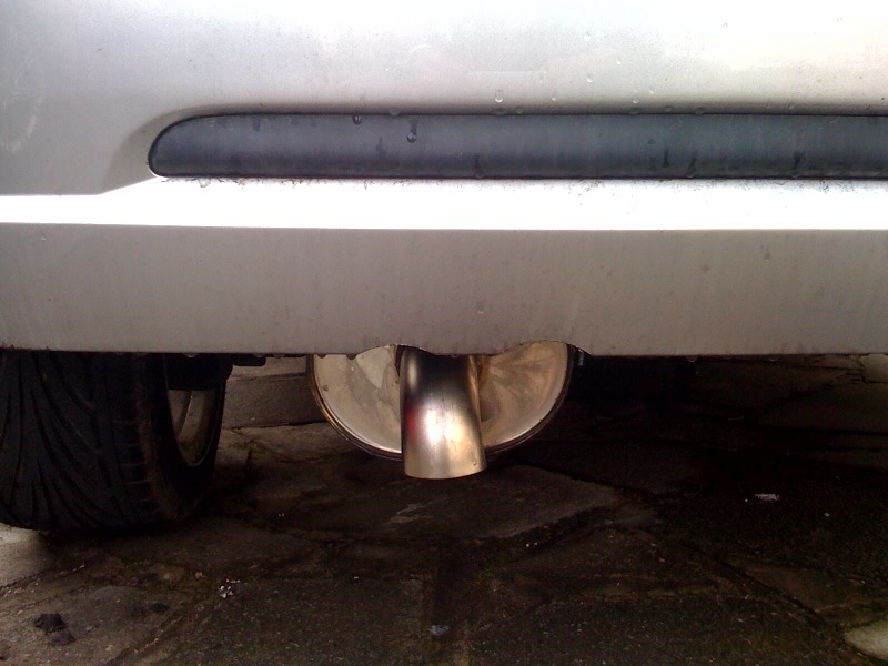

Got my system fitted yesterday. Sitting lower than I wanted, although this is being remedied today (if anybody could post pics of how stealth their system is so I have an idea as to how high the system can go that would be great :-)).
Certainly makes a sportier sound although it doesn't seem as lod as Vish's which I went out in mid week. I am hoping this will change as the exhaust wears in? There is also a lot of smoke coming out at the moment? The mechanic who fitted it said he hasn't fitted such a good quality aftermartket exhaust for a long time (well done K-Tec).

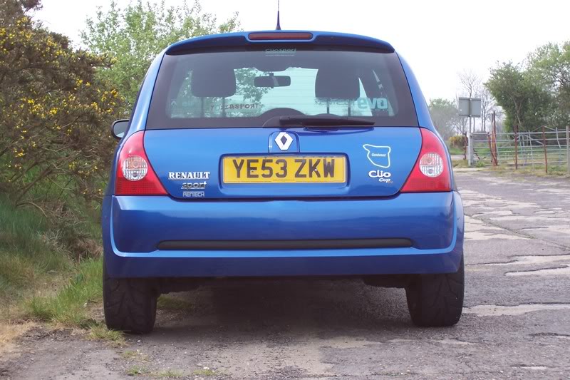

Nice,
Was it as stealh as mine?
hahaha not quite that stealth!!!! did you notice a good performance gain? Mine seems to pull better lower down

If you loosen the rear bracket lie down on a mat almost underneath parellel with the back bumper, use your knee to push up/position back box as high as you can without touching metal shield on boot the floor then just tighten rear bracket with box in desired high position hope this helps its what I did worked fine.
