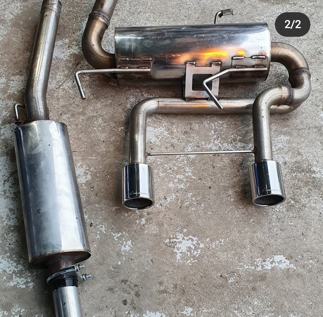

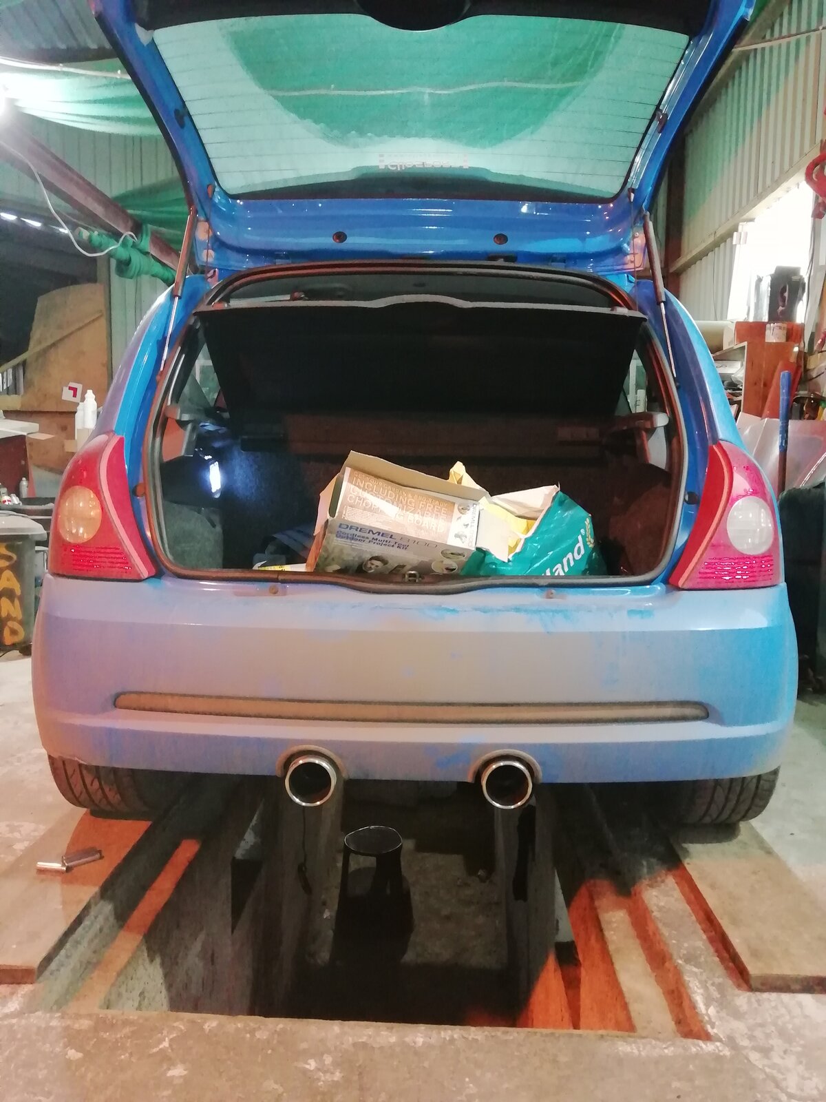

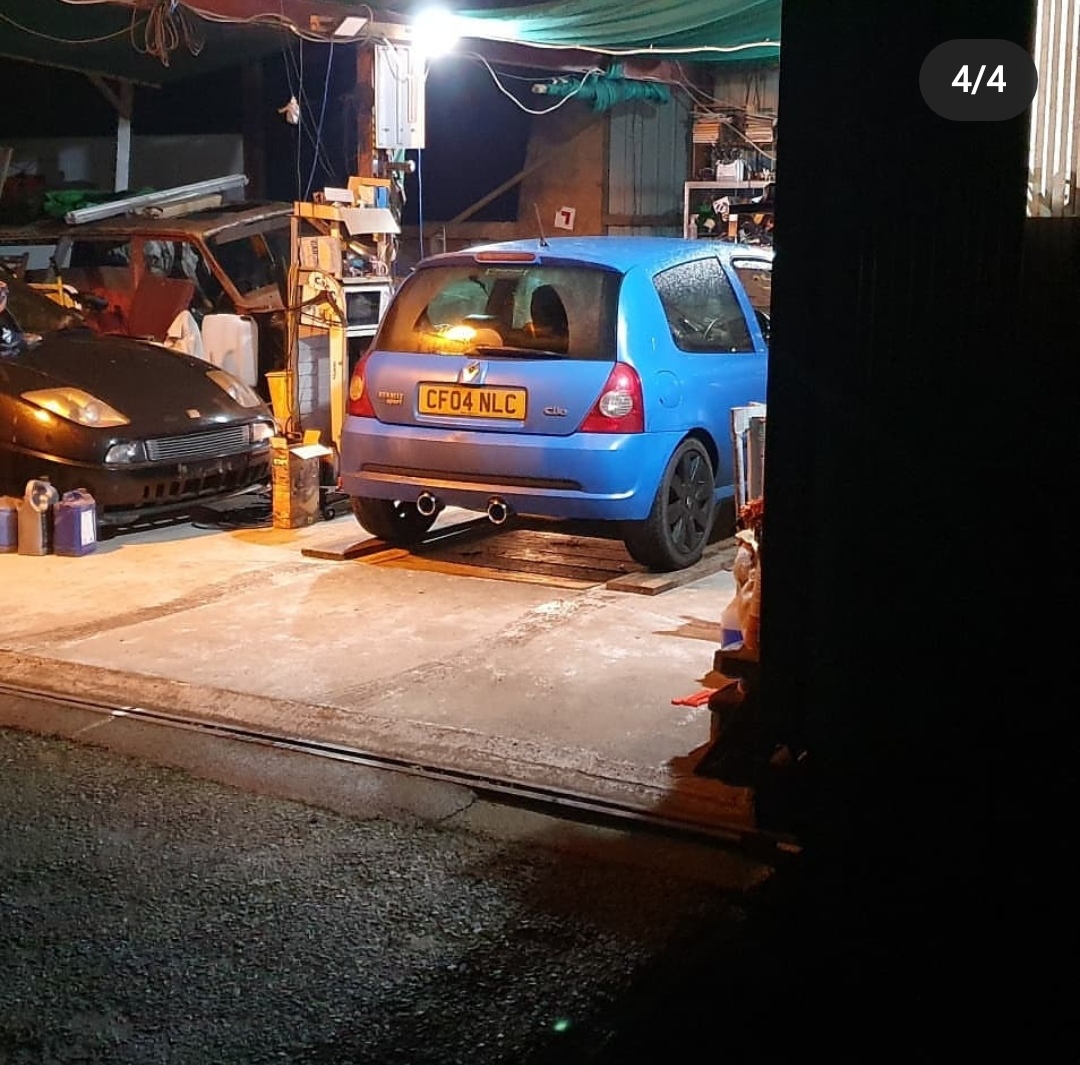

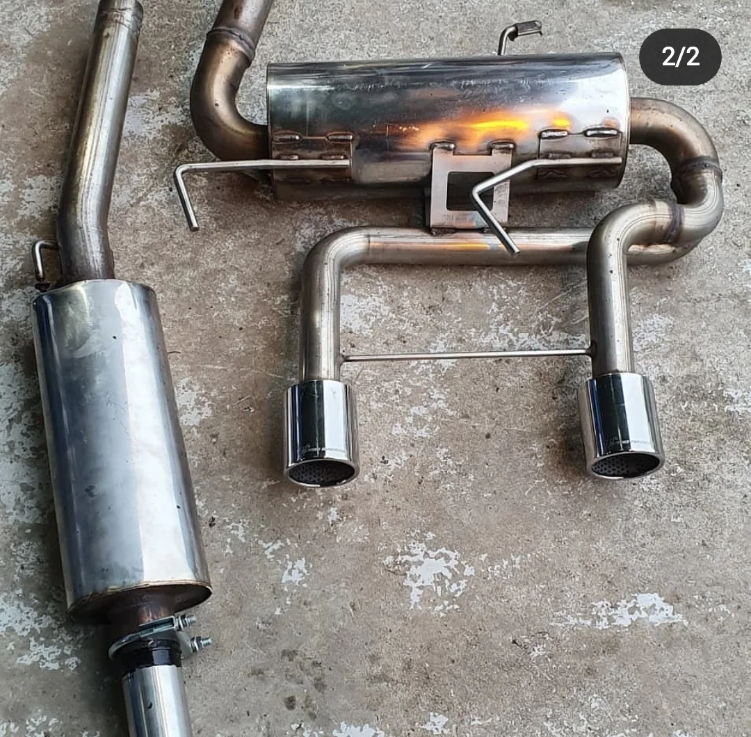

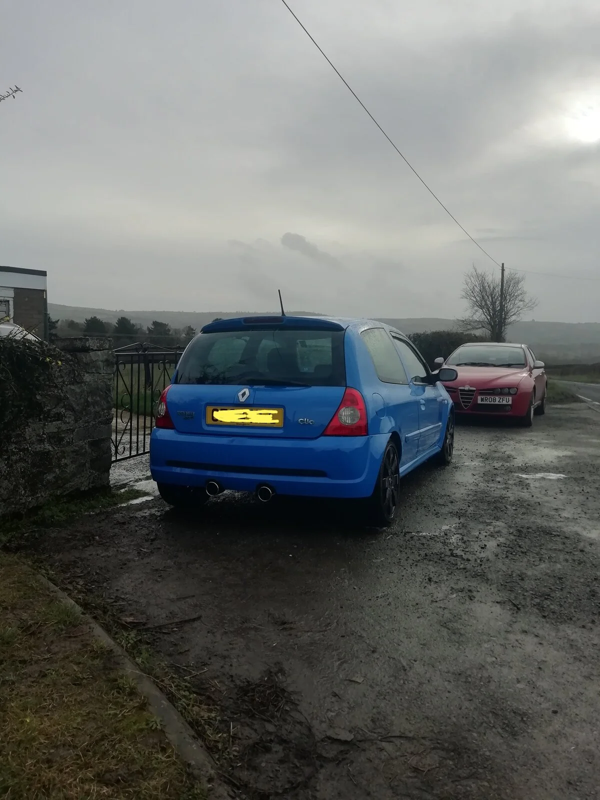

So after a 12 hour day and a bit of chit chat and a burger in between, the K-tec system I bought off @bashracing is finally fitted! Also the Gear Oil refreshed and a full service on my mates FN2 Type R including a drilled airbox.... !😜

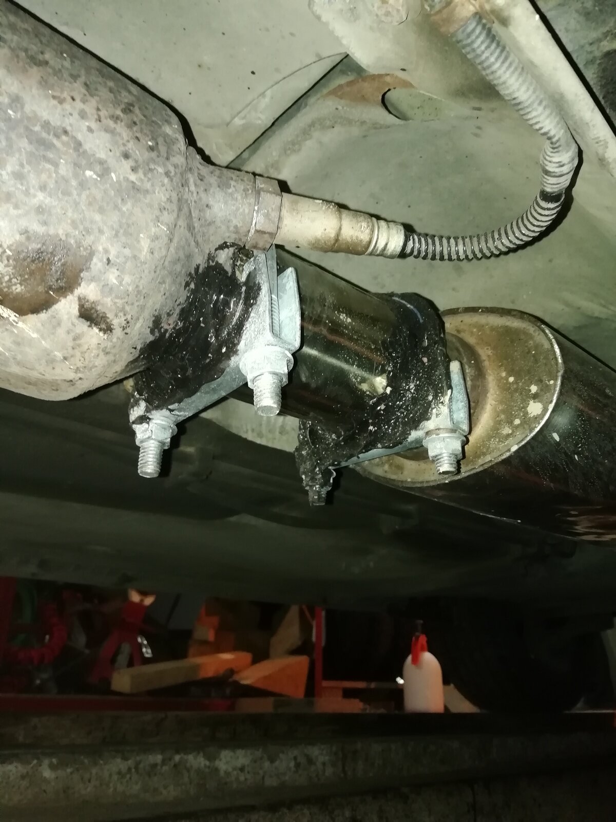

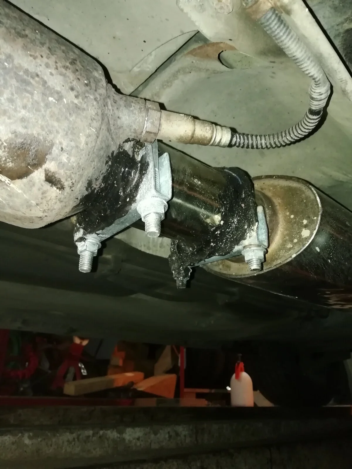

Turns out my 182 had a Sports Cat fitted so I had to totally fabricate a solution with a massive grinder, stainless sleeves/clamps and also crossed fingers and a lot of patience...!

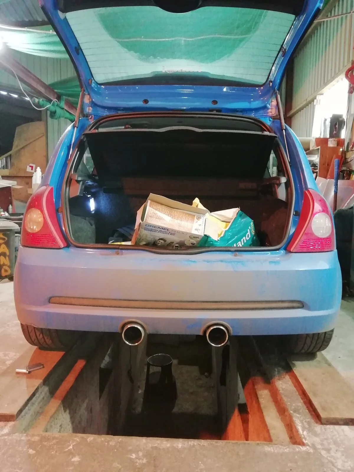

Working in a shallow pit is back breaking and I'm suffering now, but well worth it!! It's so rewarding doing your own work and solving problems... I'm very pleased with the K-tec system, the noise is just right and it looks great, big thanks to @bashracing and @gez 172 for hooking me up with the exhaust...

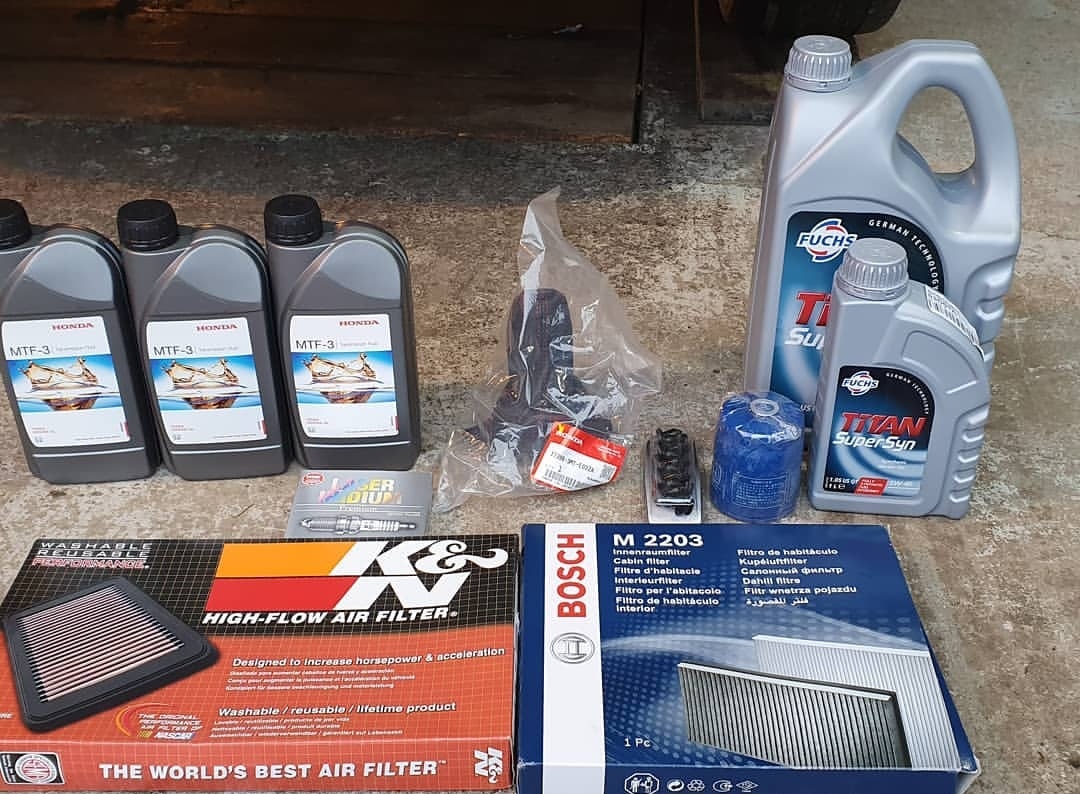

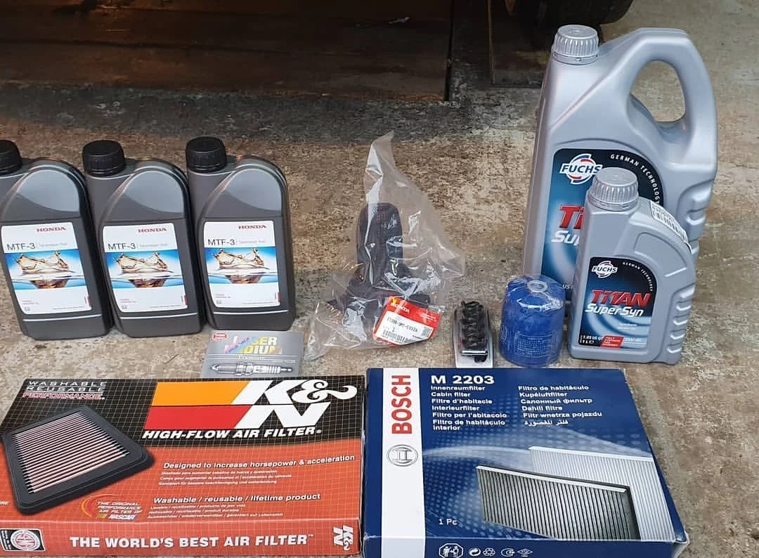

Also for anyone wanting a good cheap gearbox oil for a 172/182 the Honda MTF-3 is perfect as it matches the Renault specs and 3 litres to do the job is about £28 delivered on Ebay, the gearbox felt great on the drive home! 👍🏻
Also if anyone wants a superb sealant/gasket maker that withstands super high temps the 'Wynns Black Gasket Maker' is an absolute dream product, it is superb for exhaust joints and many uses....

The best thing was the tail pipes sit lovely and snug dead centre of the holes due to the previous exhaust fitter (ProspeedCardiff) using a clever system with what looks like polybush sleeves that you can wedge in the Renault mounts and cable tie to get the heights and direction of the tips absolutely spot on... I was well chuffed, when I can I'll get better pics and the damn thing needs a serious wash!!😬

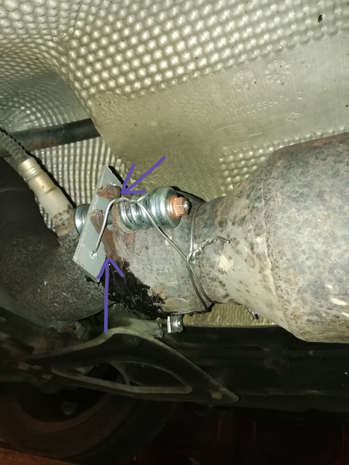

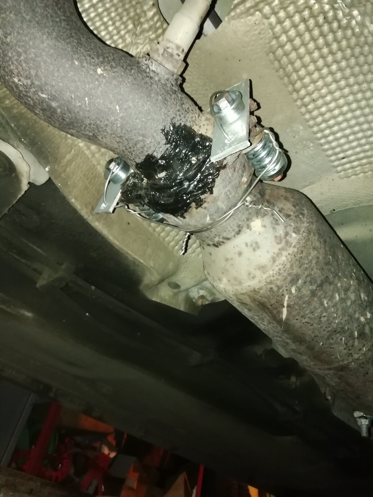

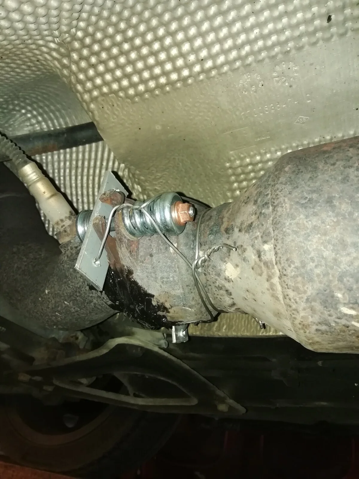

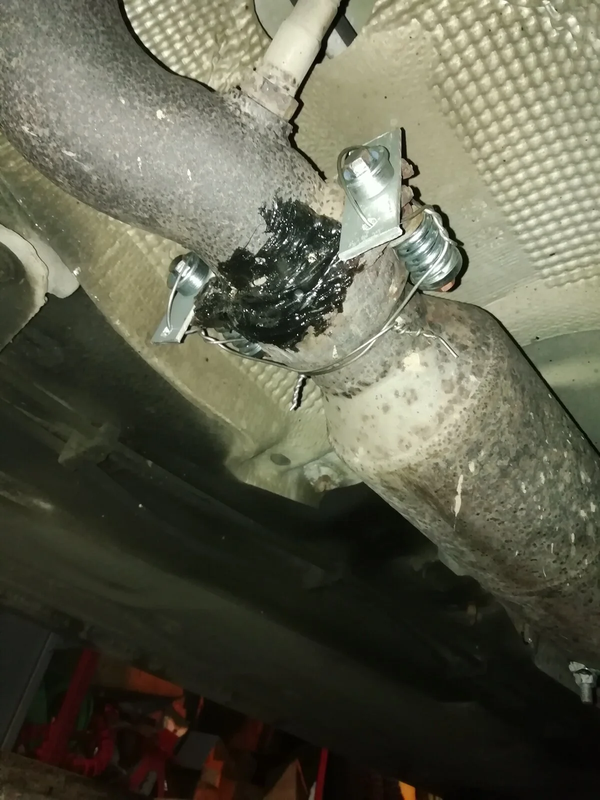

So after fitting the K-tec system last week I noticed my Manifold to Cat spring bolts were absolutely nackered and almost falling off... So I ordered a new fitting kit and renewed the gasket as well, we had to do a Heath Robinson job and use some metal bar and washers to support the spring bolts, it looks a bit dodgy but is actually really solid and secured with safety wire so it won't come apart... Also tweaked the mounts again to get the tips nicely in the bumper cutouts... The black gunk is the amazing Wynns Black gasket maker just to cover corroding areas on the mani join and seal the sleeved section after the cat... I'm super happy with the K-tec system, its got a nice sound without being obtrusive... 👌🏻

The pics don't really show it but the 2 little prong jobs that seat the hats are really starting to flake badly and the metal bar is putting more pressure on the lower part of the prong arms than the hat would... I was afraid of the hats pulling through the holes after a while... This seemed to feel more secure so we'll see how it goes for now! Ideally could do with new joints welded on both sides or those clever clamp rings I've seen people make!!
The purple arrows show the force is more on the lower part of the prongs than normally would have been without the metal bar if you get my drift?! The other side was actually worse than this and very scrumbly and we did it to that side first, then thought best to do both! Just hope it's an mot pass now! 🤞🏻
Yeah I get you. The 182 ones are starting to get a bit thin there.
If you buy a 172 manifold that section seems to survive better as it's a bit more tucked up. Then you can cut it off and weld onto your manifold.
I went to rescue my bro with some jump leads this morning and gave the car a good rip on some backroads and it seems to be sorted for now... I'll look into a new section to weld on now you've mentioned it as this setup obviously isn't going to last forever.... I plan to keep the 182 for years and years to come so bodges are only masking the issues really, proper solutions definitely need addressing.... 👍🏻
