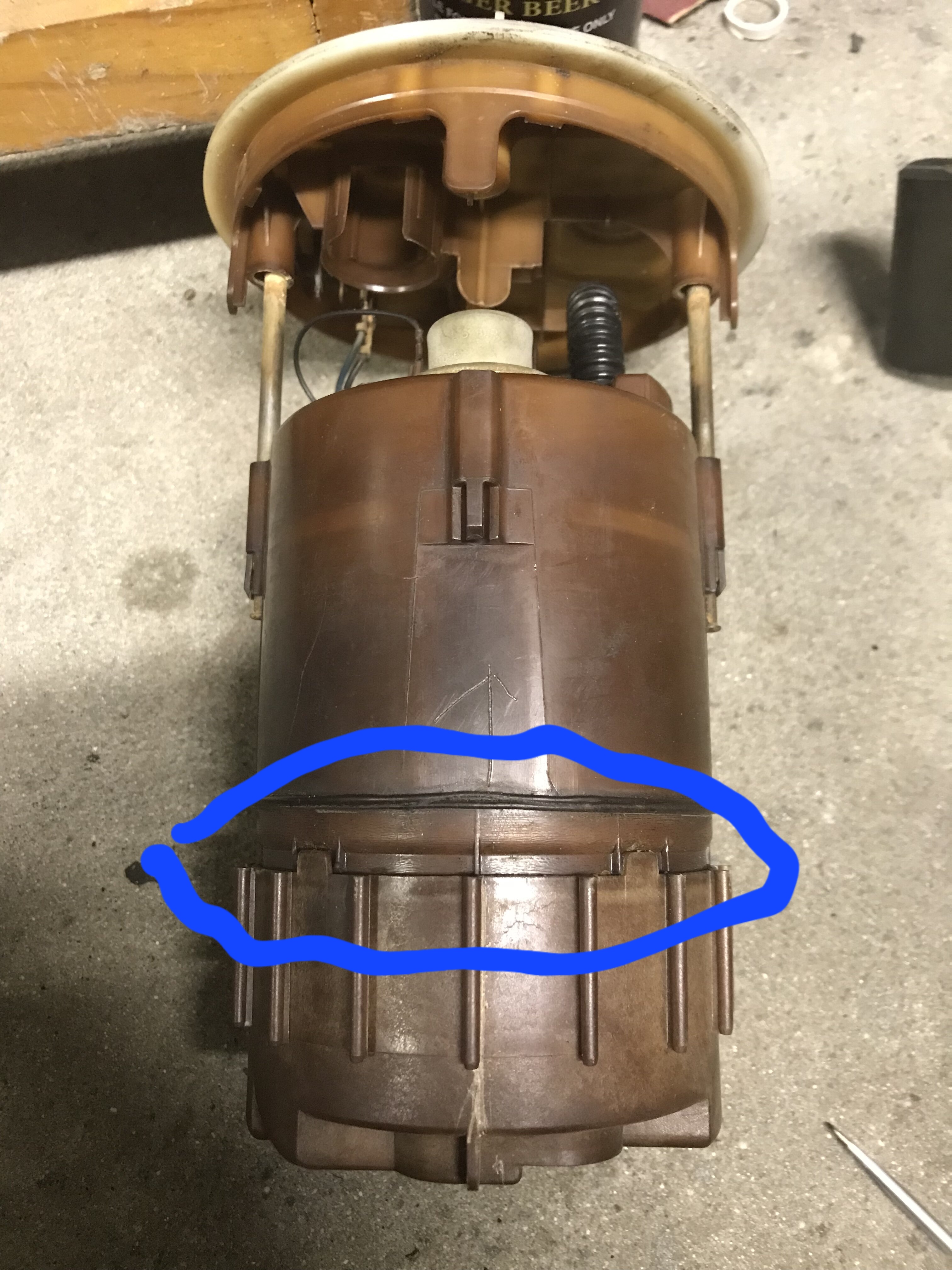

Evening all, first post. Been watching from the sidelines for a while. I want to replace my vans fuel pump. Purchased a second hand one from a van being broken up. I’d like t fit a new Bosch universal pump to the housing. How do I remove the base to get access to the pump? Did a few searches with no luck. Pic attached is of the unit I bought. Thanks in advance.

The sender has a non replaceable filter inside id be tempted to change the full unit with it being that colour, its prob well past its best, new full aftermarket sender not expensive.

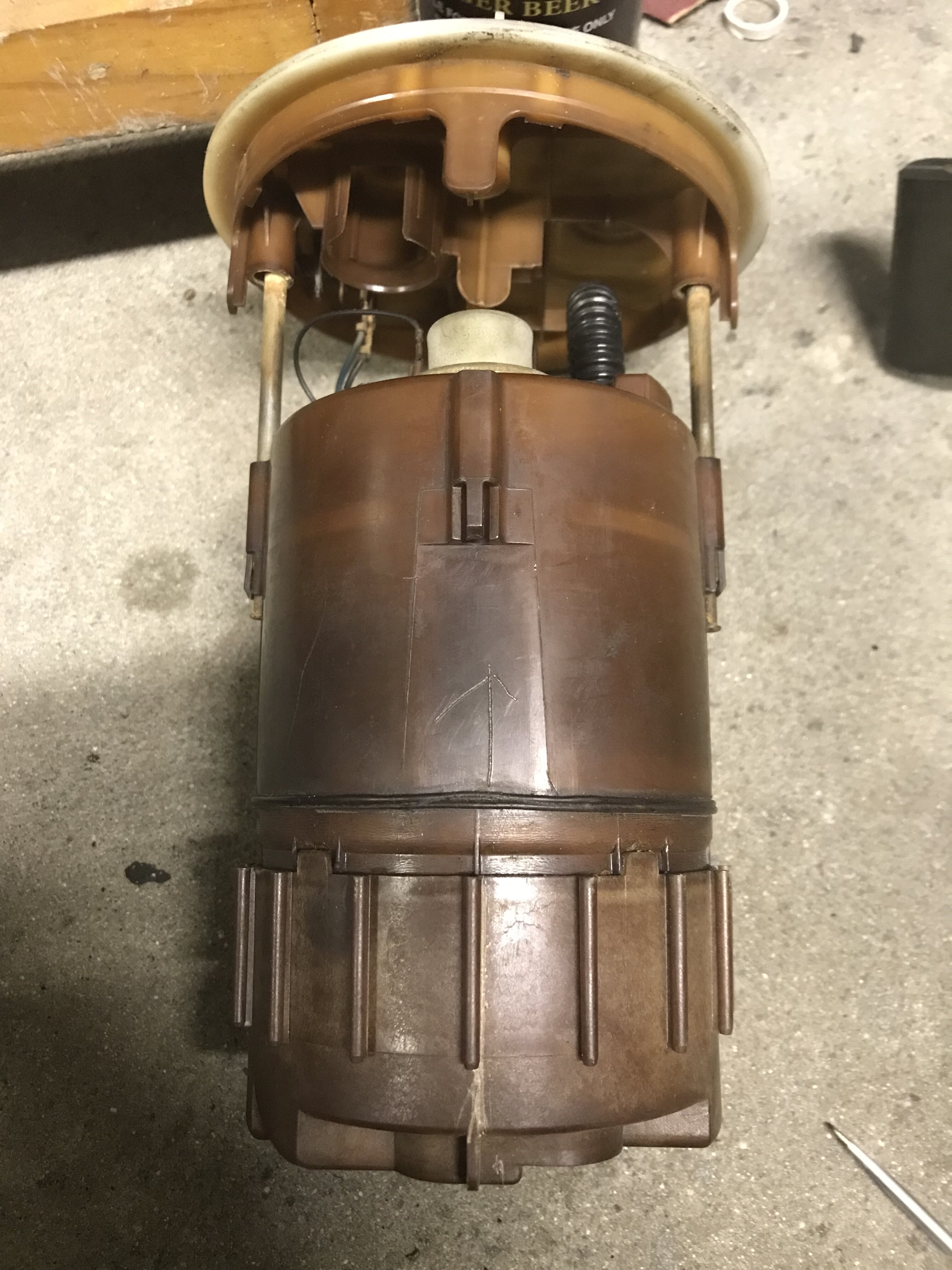

If you really want to change the pump you need to take the bottom basket off. If you lever it off with a screwdriver they always break, best way ive found is to hit this edge with a block of wood, pops it off no damage.

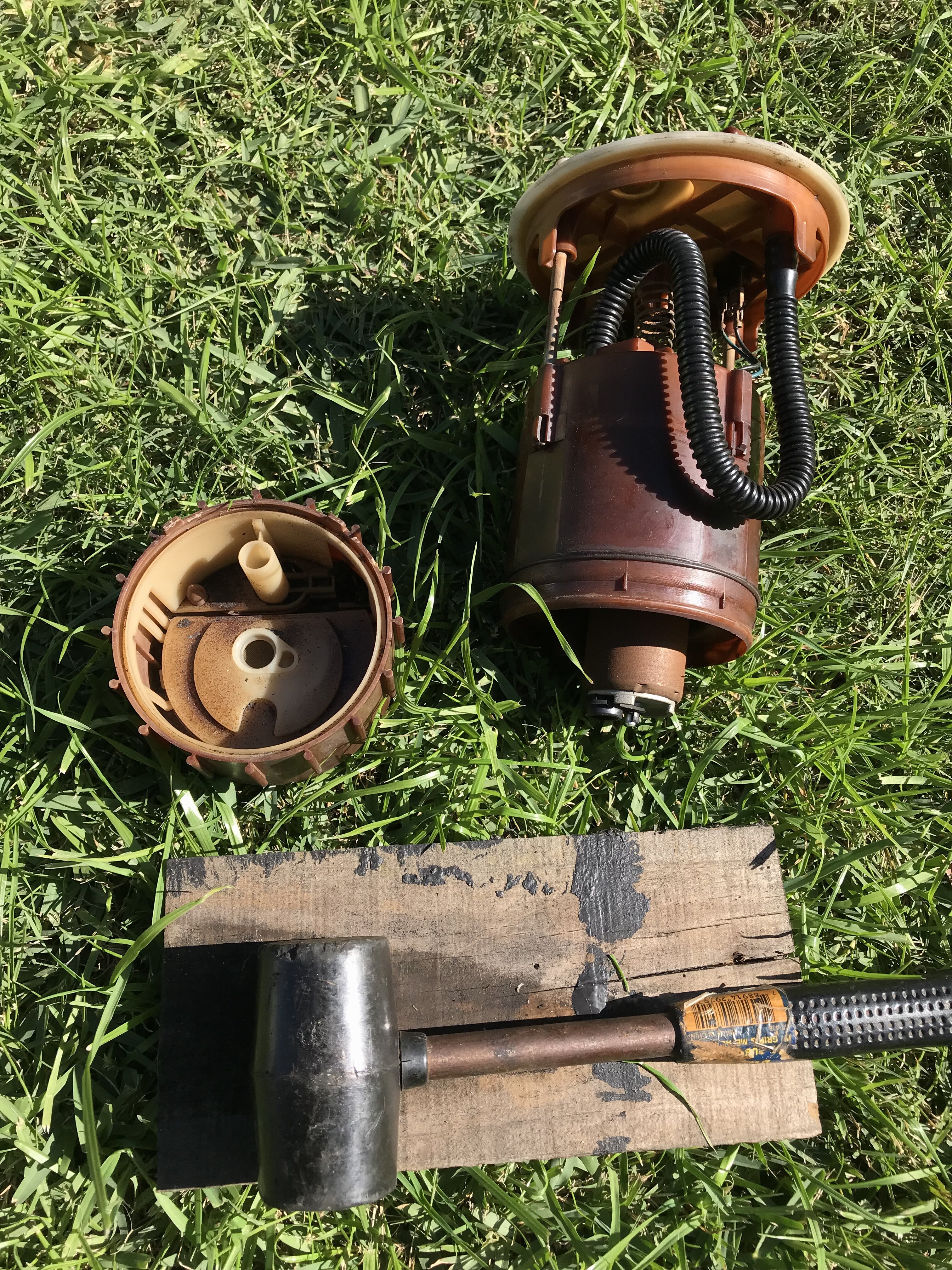

Thanks Brigsy. 2 knocks with the mallet 😁
