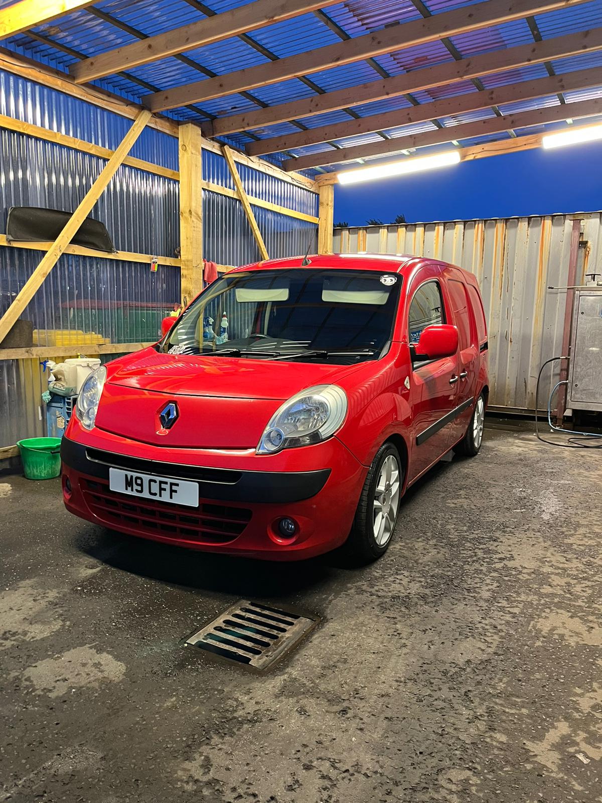

Kangoo Sport DCI 85 / Daily Day Van

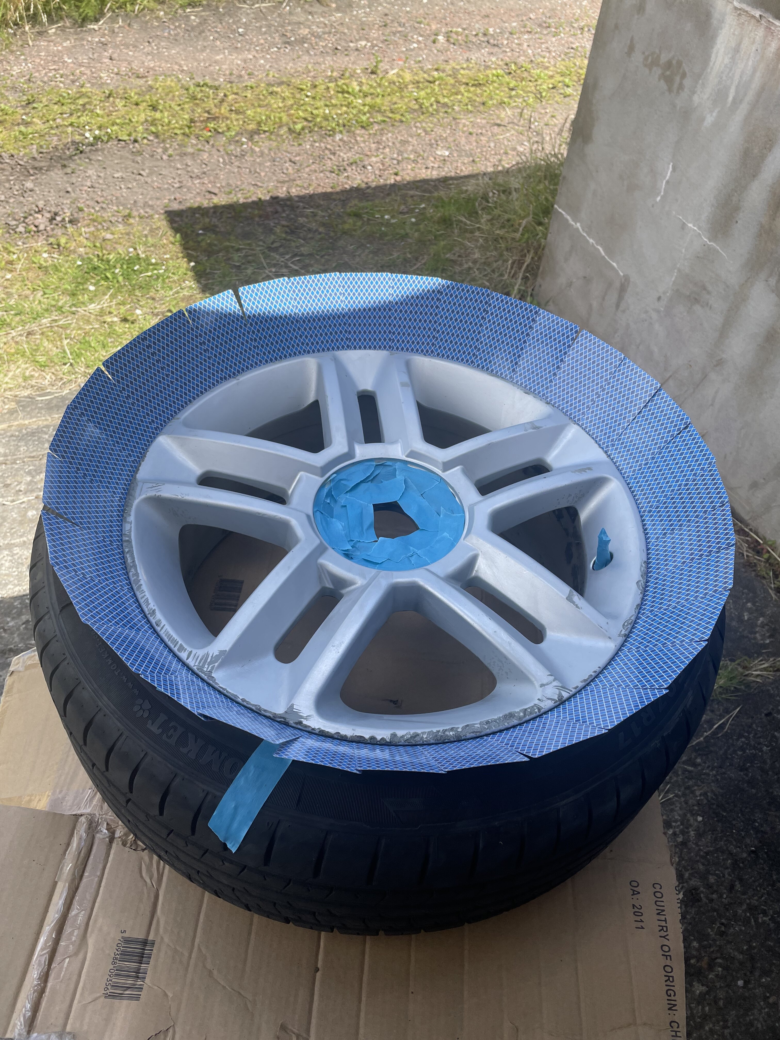

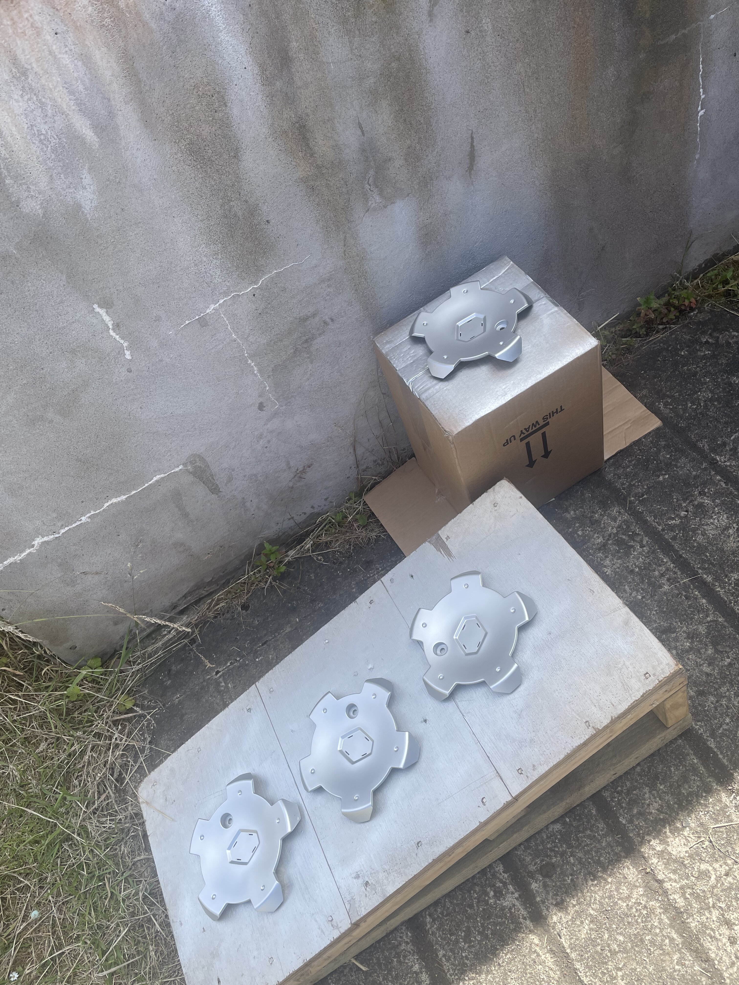

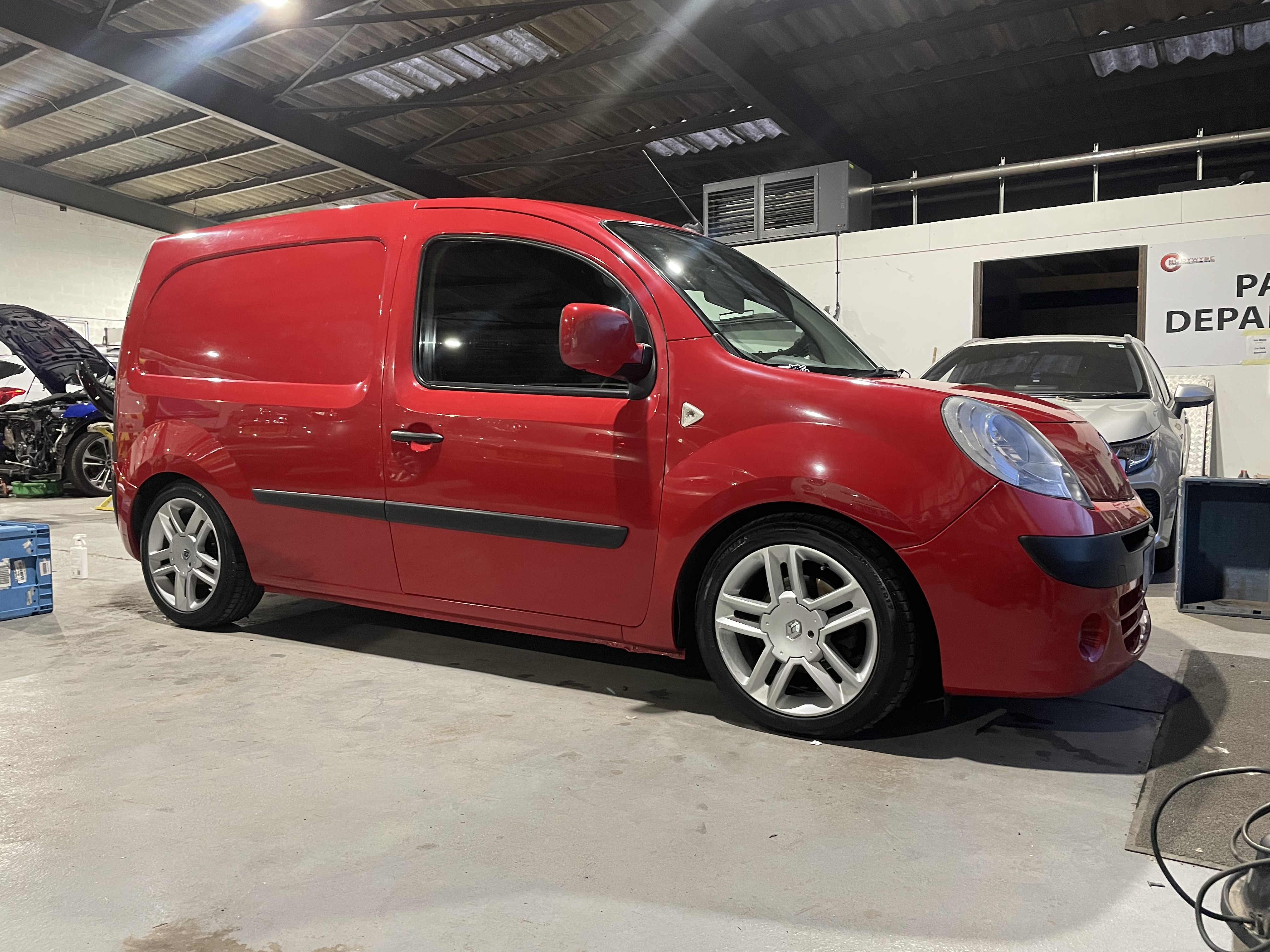

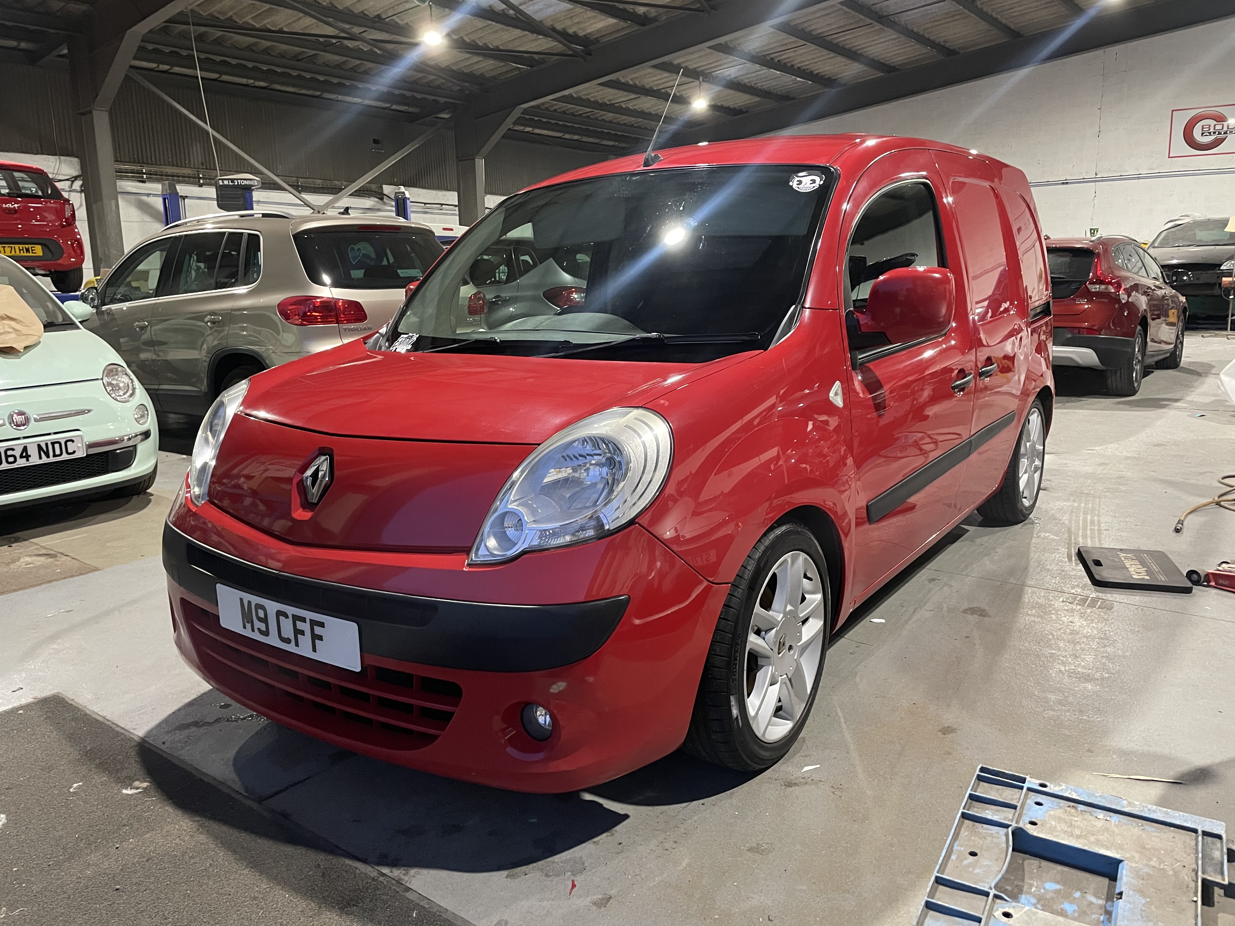

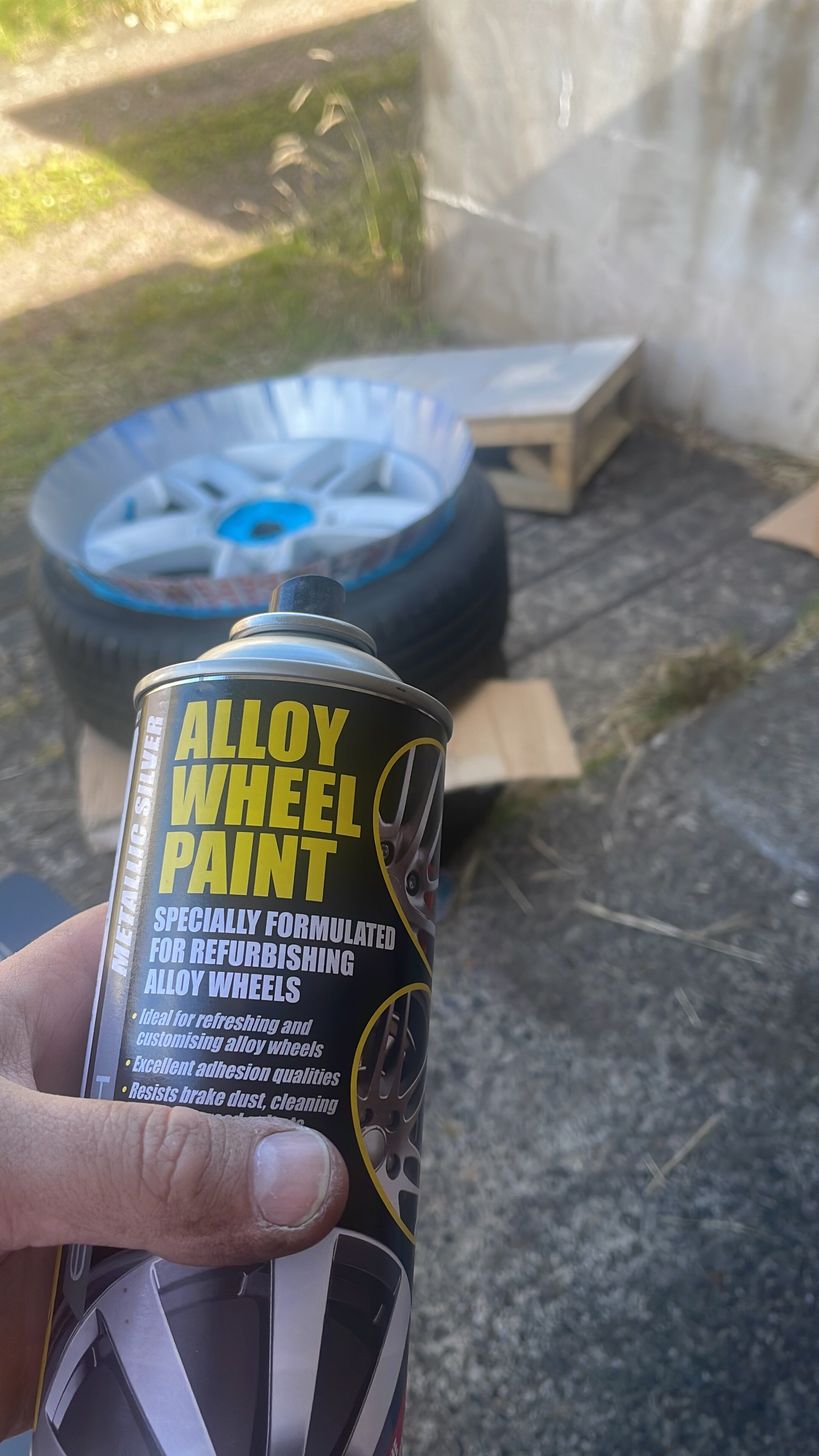

Done a refresh in silver on the Laguna wheels and changed the tyres for some 205/50/17 the Megane wheels where just too heavy and too much contact patch. I’m suspecting that the extra size and grip might have been too much for the box and it’s now whining at me. Also with a little bit of sympathetic driving I’m averaging 47 - 48 mpg where as I couldn’t break 43 with the Megane wheels. So I think that’s sealed their fate.
Last night lowered the front of it a bit more so it’s level, I’m pretty happy with how it sits now, was running a hubcentric spacer on the Megane wheels at the rear but they snapped on the hub so I might just find a 10mm spacer and that should be fine to bring the wheels out safely.
We had planned on giving the van the works detailing wise, but when coming up with a game plan and assessing the state of the paint it just wasn’t worth the time and effort. It really has been abused over the years like you would imagine a builders van would be. So just went for a hand polish and wax and didn’t bring out the polisher. Also used some trim restorer to bring the plastics back. The worst part that took most of the time was the roof. It was so dry it was just absorbing the product.
While my mate was setting about that I was painstakingly going around the van with a touch up pen to take your eye off the scratches. So she does look miles better in pictures but she’s good enough for the girls I go out with so I’m over the moon!
Both cars are pretty much ready to hit the road now. Clio needs a final clean and hoover and fuelled up. Past it’s MOT thankfully so I can have a couple of days rest before hitting the road!

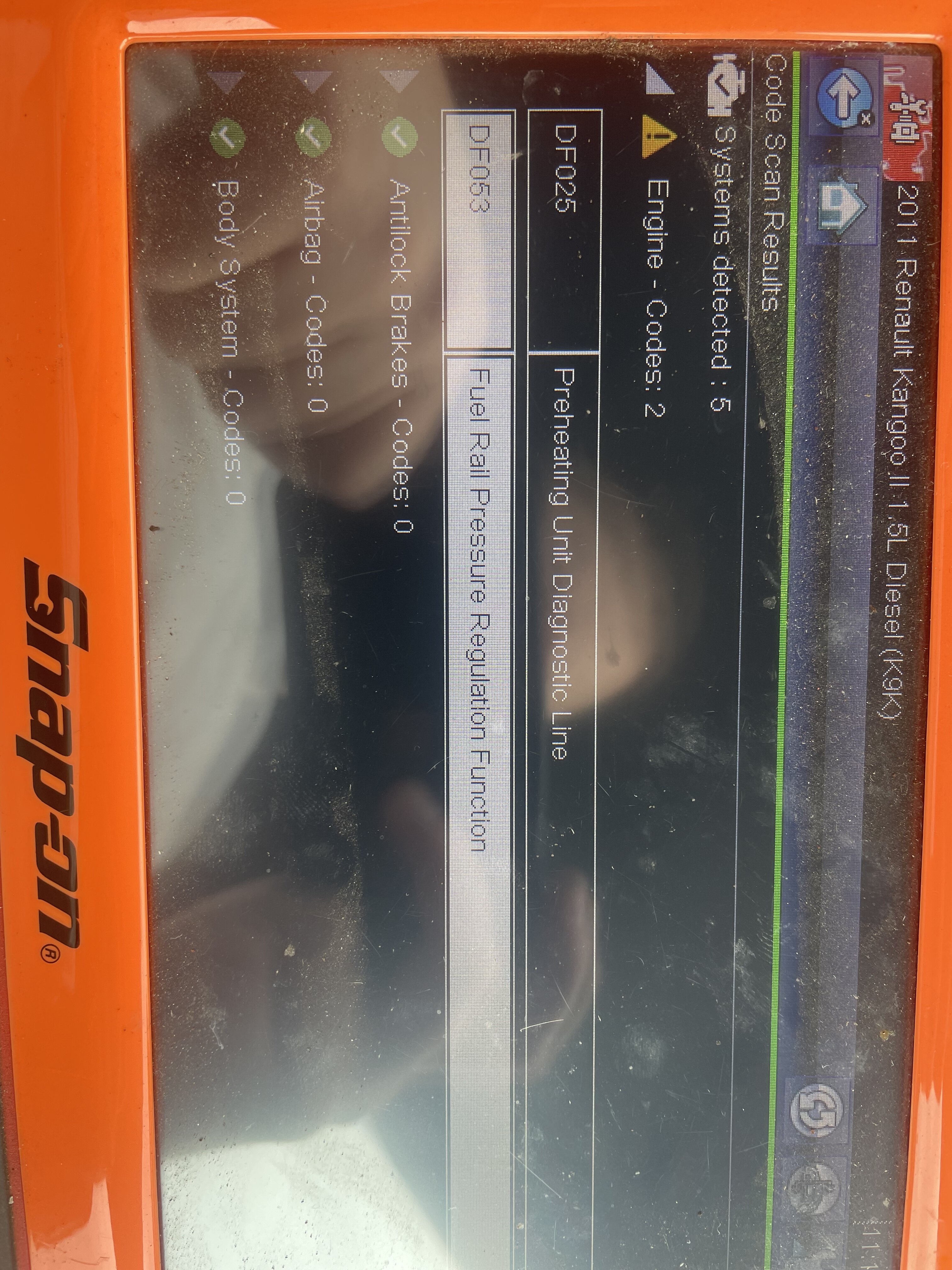

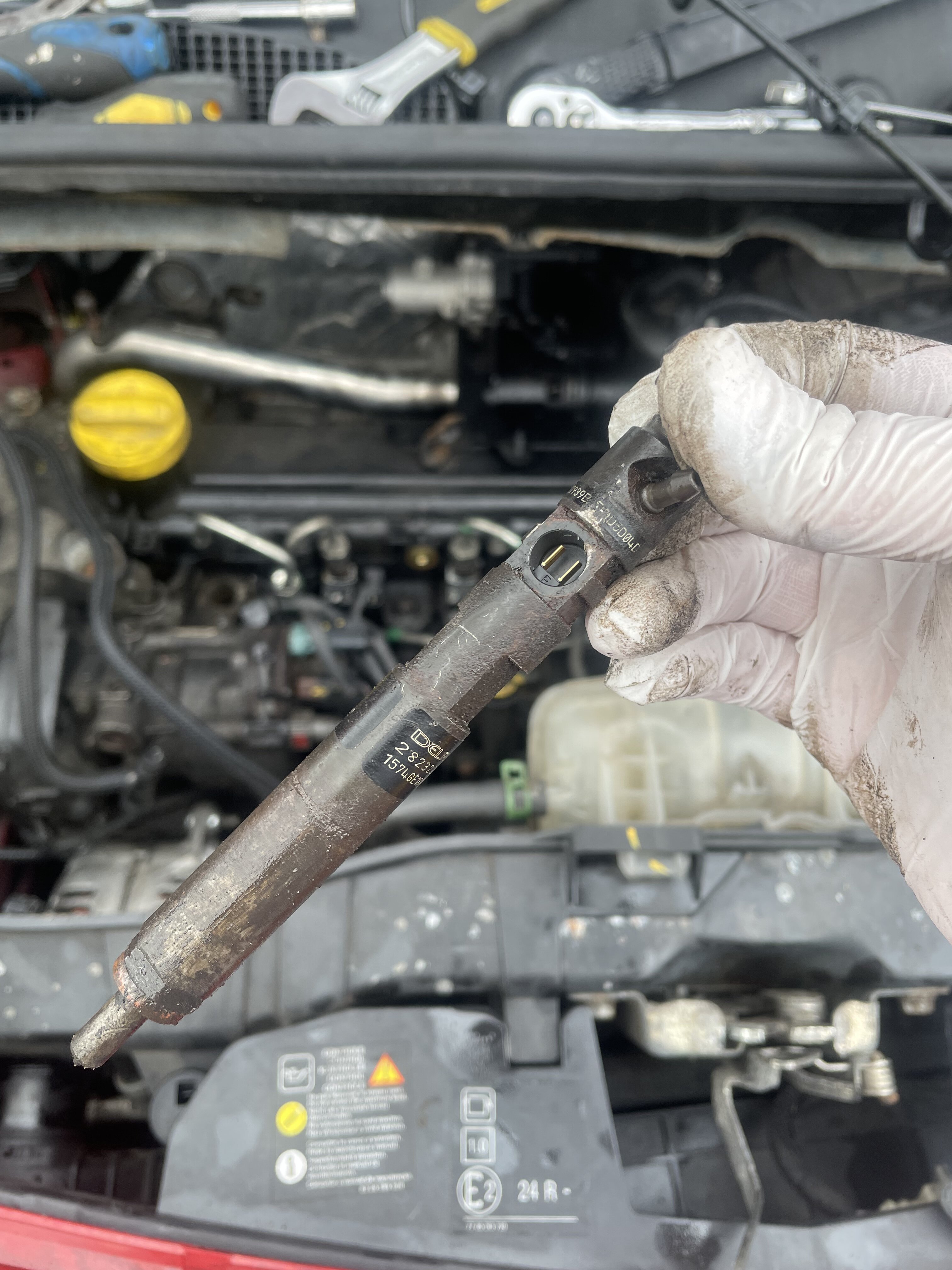

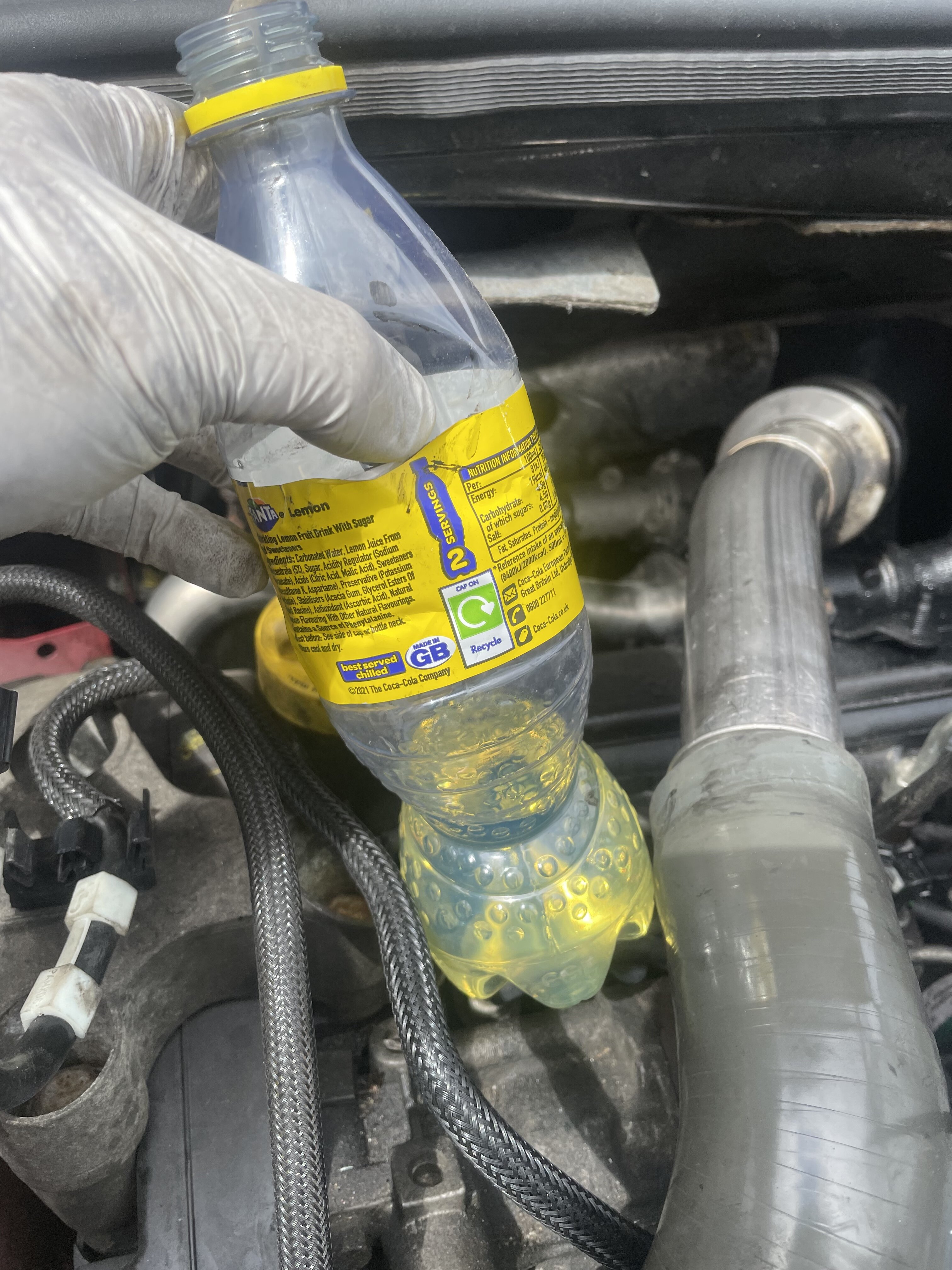

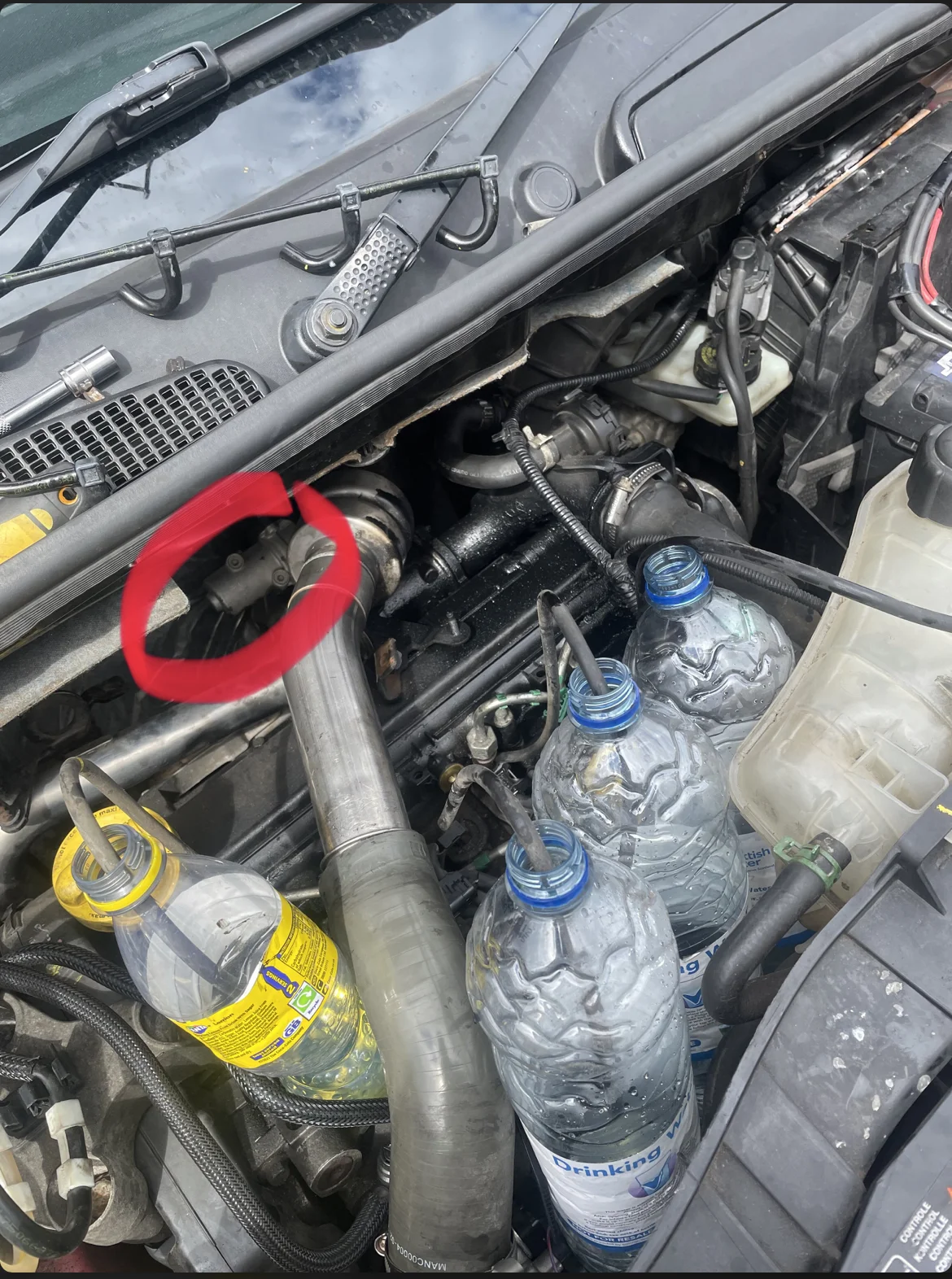

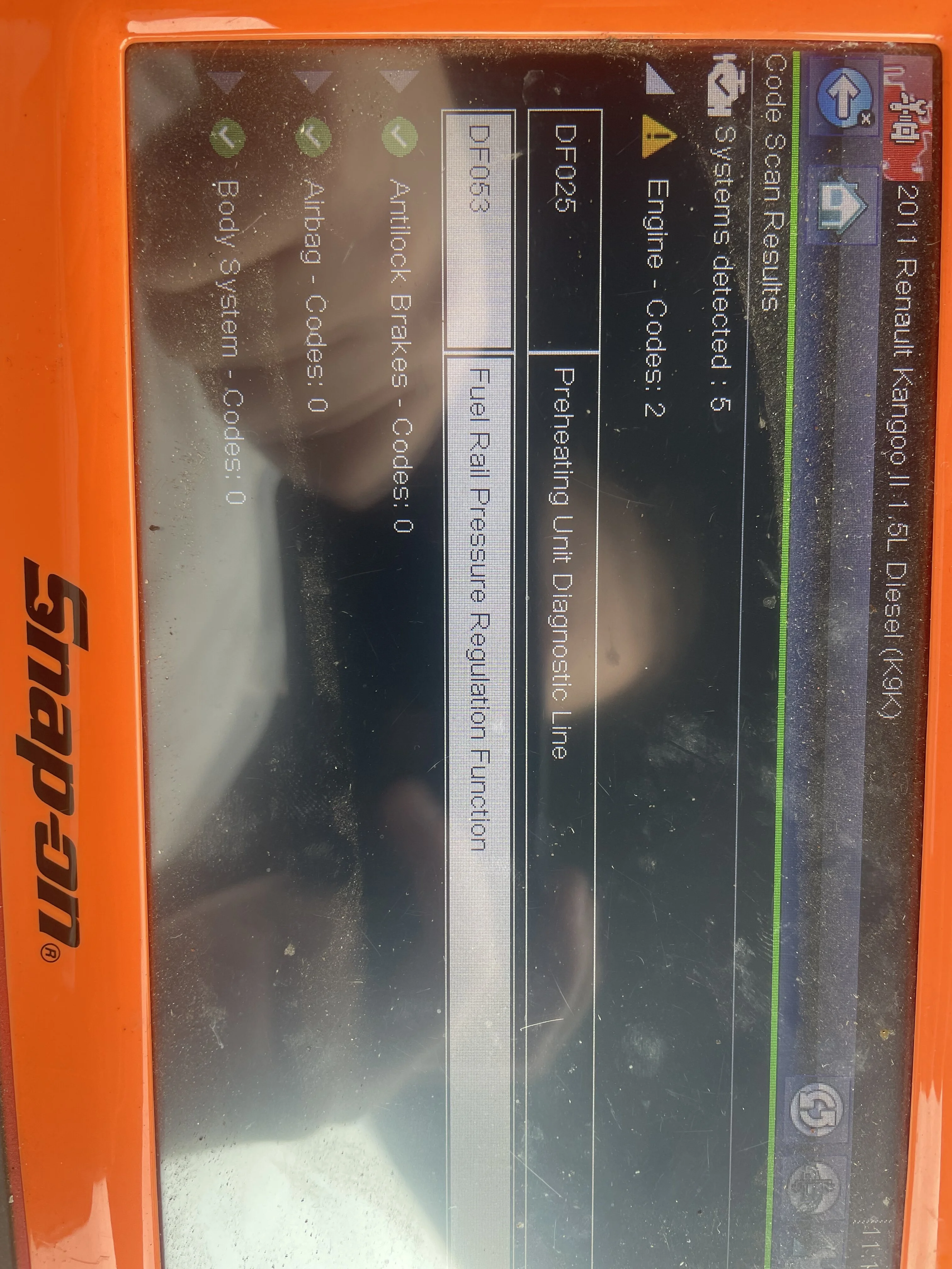

I knew pretty much from the get go that the starting issue was most likely an injector. But the fact I’ve not worked on diesels before and all the horror stories of snapped injectors and leak down tests honestly frightened me a bit so I ignored it as long as I could.
Anyway a few YouTube videos later and a leak down test…
Came to the conclusion that injector 4 was the bad one.
I couldn’t get the b*****d out but I had a bit of muscle in the form of @Stu. From “Renomotive” that ended up pulling it for me with little effort.
I looked at various options online at new and refurbished injectors. But did I mention I’m tight… ended up with one for £40 delivered from a breaker and just the hope it would work.
fired the new injector in, coded it in and it fired right up off the key. It’s never done that before as quick, had a bit of Ticking past the injector so replaced the washer and buttoned it up again.
For the time being jobs a goodun. Proper luxury now starting up without having to open the bonnet.

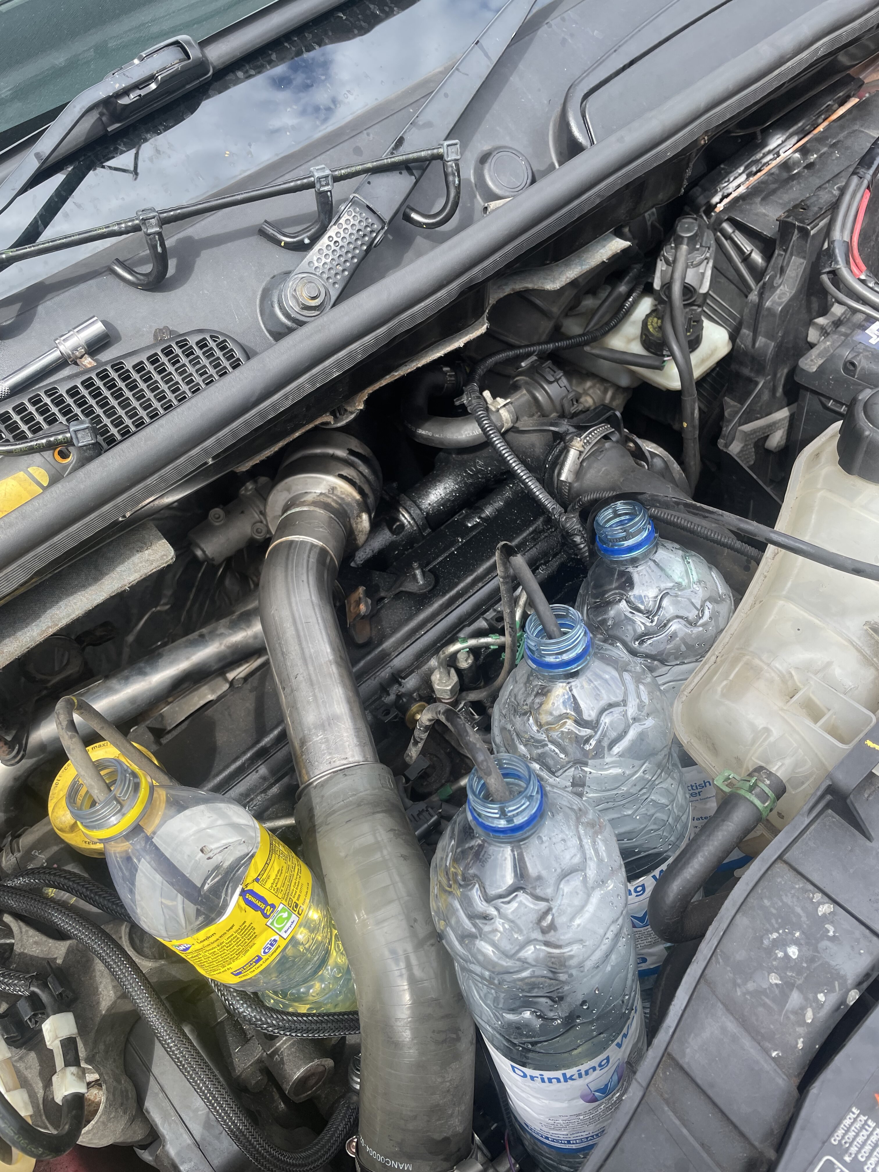

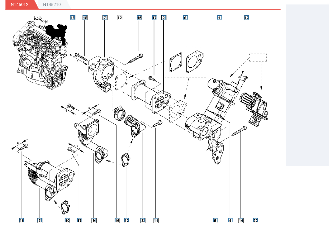

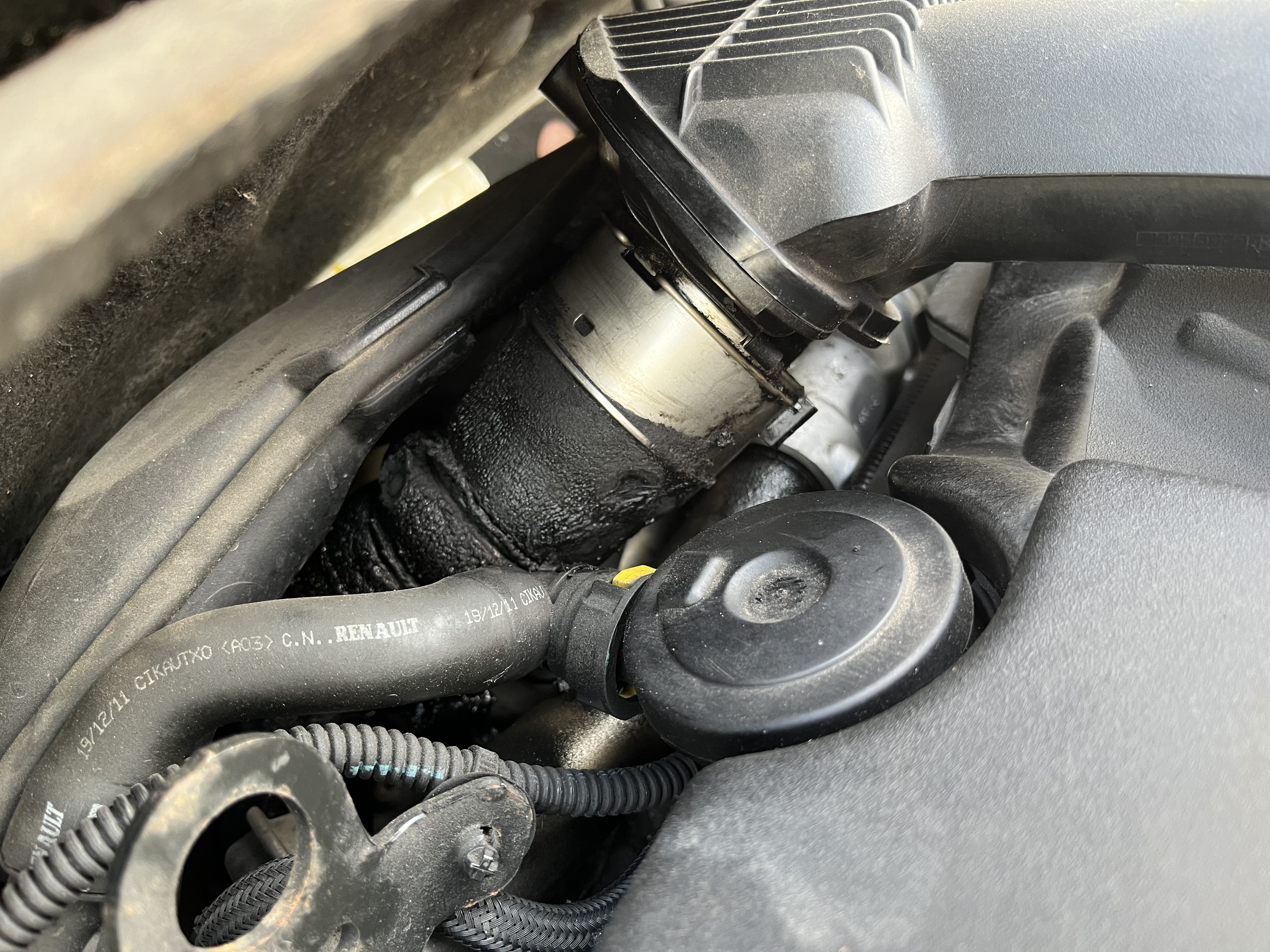

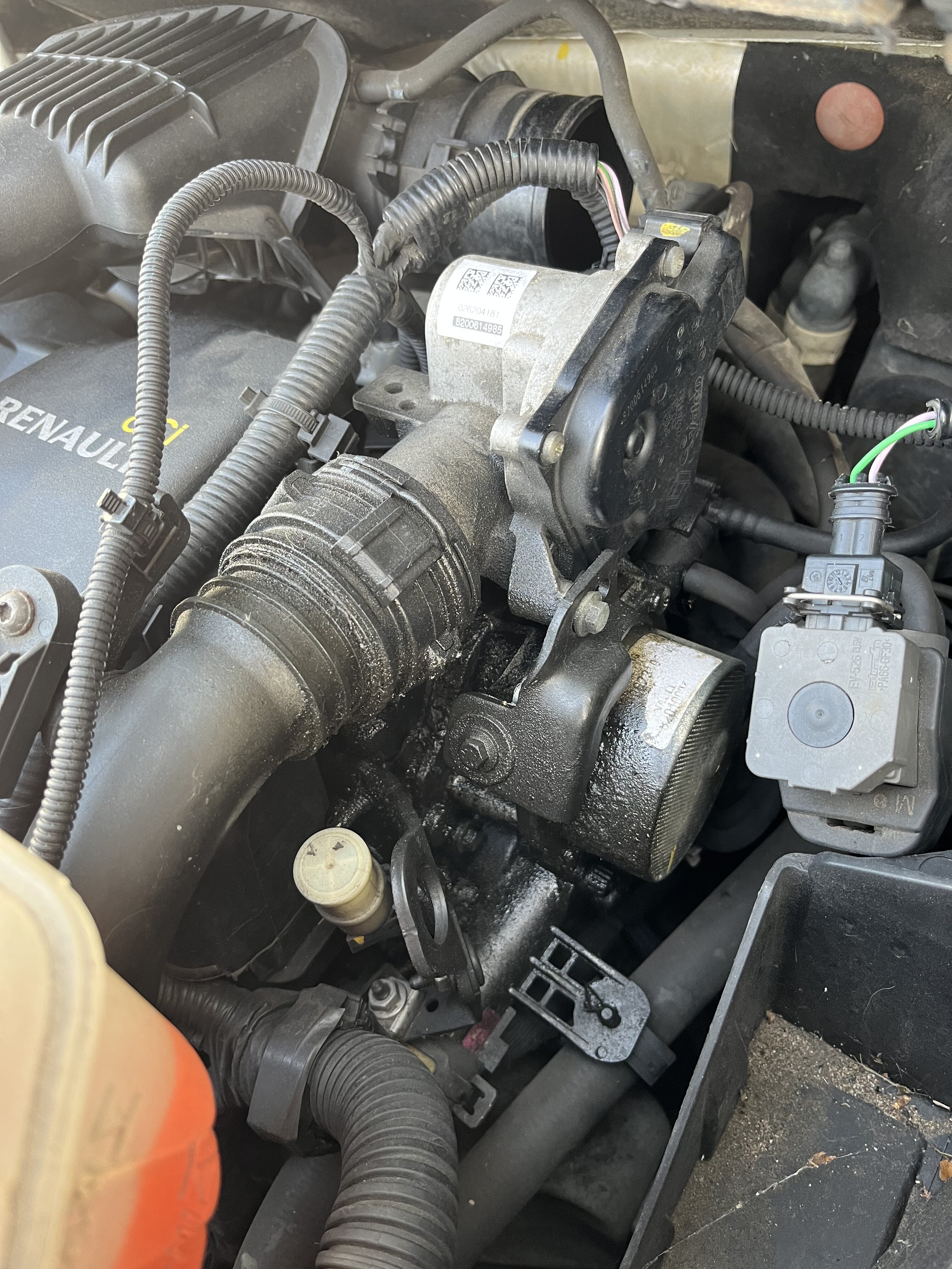

Tackling the EGR today but mine looks loads different to yours! Also struggling with removing the top hose, can’t see how the snap ring releases?
It looks quite oily too?
This clip here on this hose is doing my head in and can’t figure out how to remove and feel I may need to Jack the van up to remove the turbo inlet that runs along the back of the engine?
From memory yes yours looks slightly different from mine. Cross over pipe on mine is metal. But I’m imagining things aren’t too dissimilar. Snap ring should just pop out with a screw driver. There’s like a little hump on it you should be able to flick under and it will release.
Mine is absolutely caked in oil and has been since I’ve got it. Way worse than yours is. But doesn’t seem to use any oil.
Can’t really tell from the picture but mine looks like it attaches further down. What year and model is yours?
I’ve not had the bonnet of mine open in some time so memory is vague. Although I’ve just had delivered a clutch and fly wheel for it and will be getting the belts done at the same time.

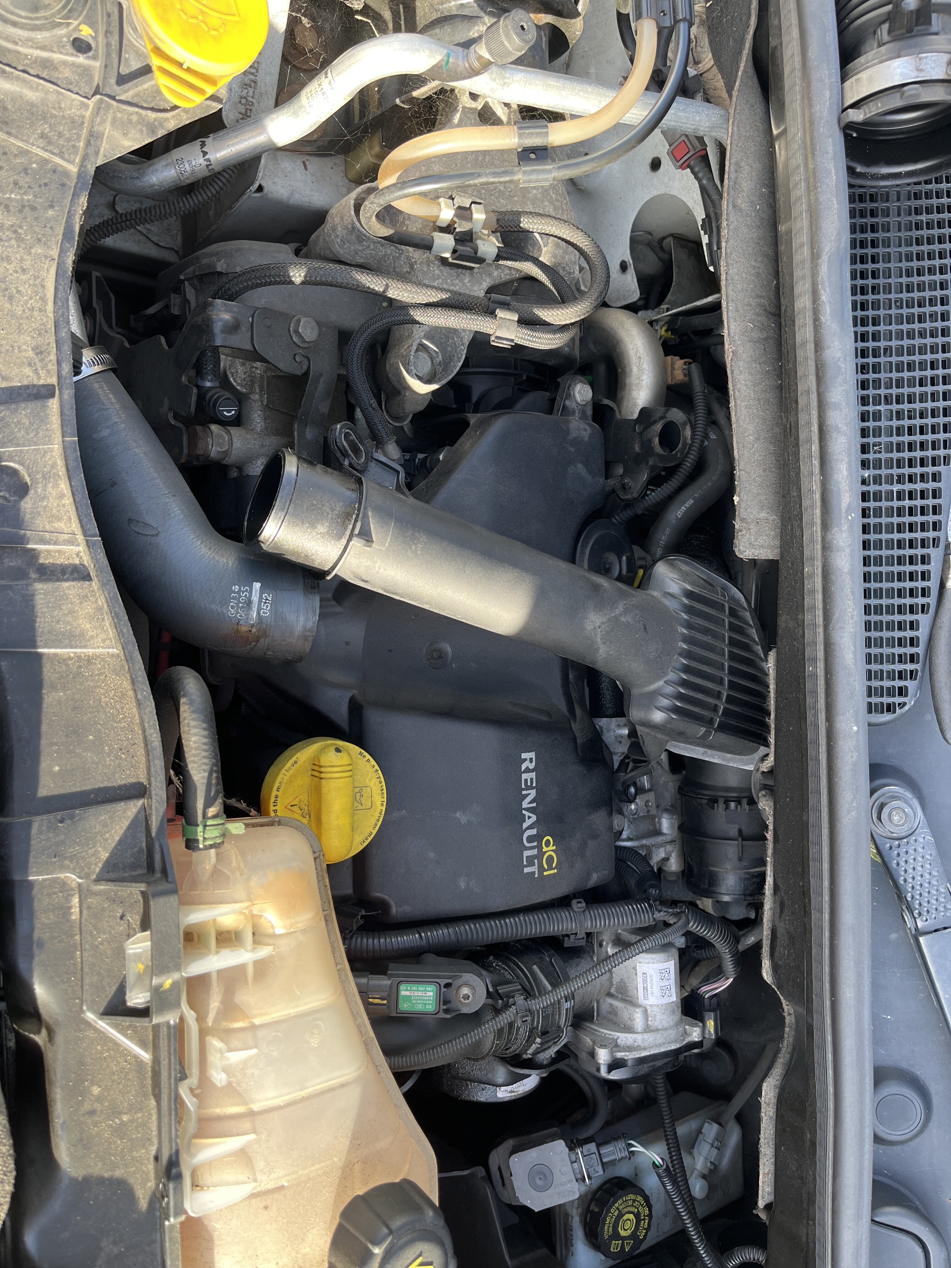

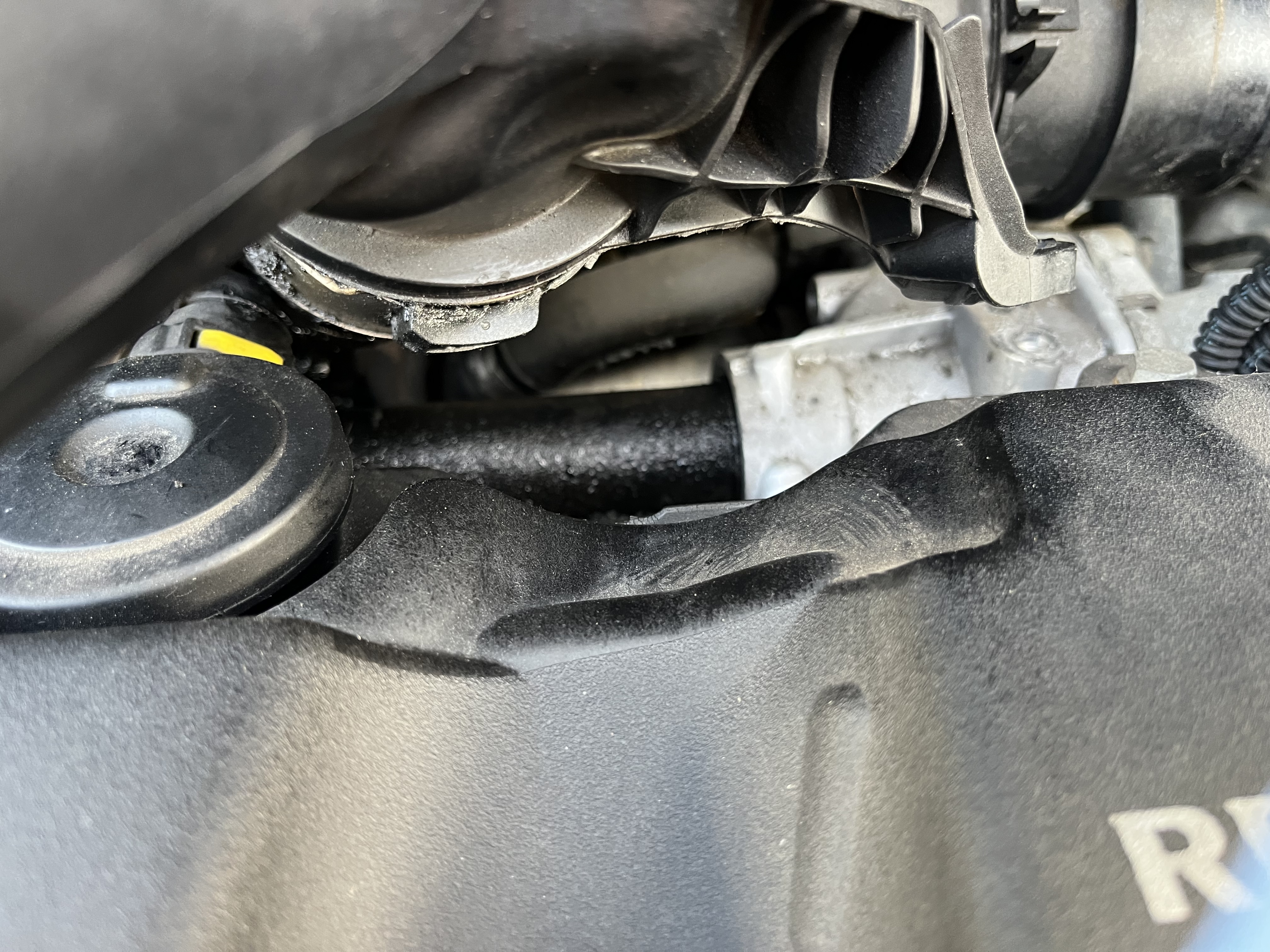

I was having a go at the snap ring for ages, will revisit it tomorrow and have been told the valve is at the back of where I’m looking under the intake pipe. Mines a 2012 van, I could see alot if oil deposits and I’ve never cleaned it so thought it’s best to get it done
Not the best photo but I’ve got nothing else to hand. That’s the EGR valve there. The full egr system and cooler is down the back next the the turbo. There are 3 different types for this engine I’m sure but all very similarly placed and shaped.
Figure 1 is the egr valve.
Whip wipers and scuttle panel off, takes 5 mins and loads of access to the rear engine area once removed.

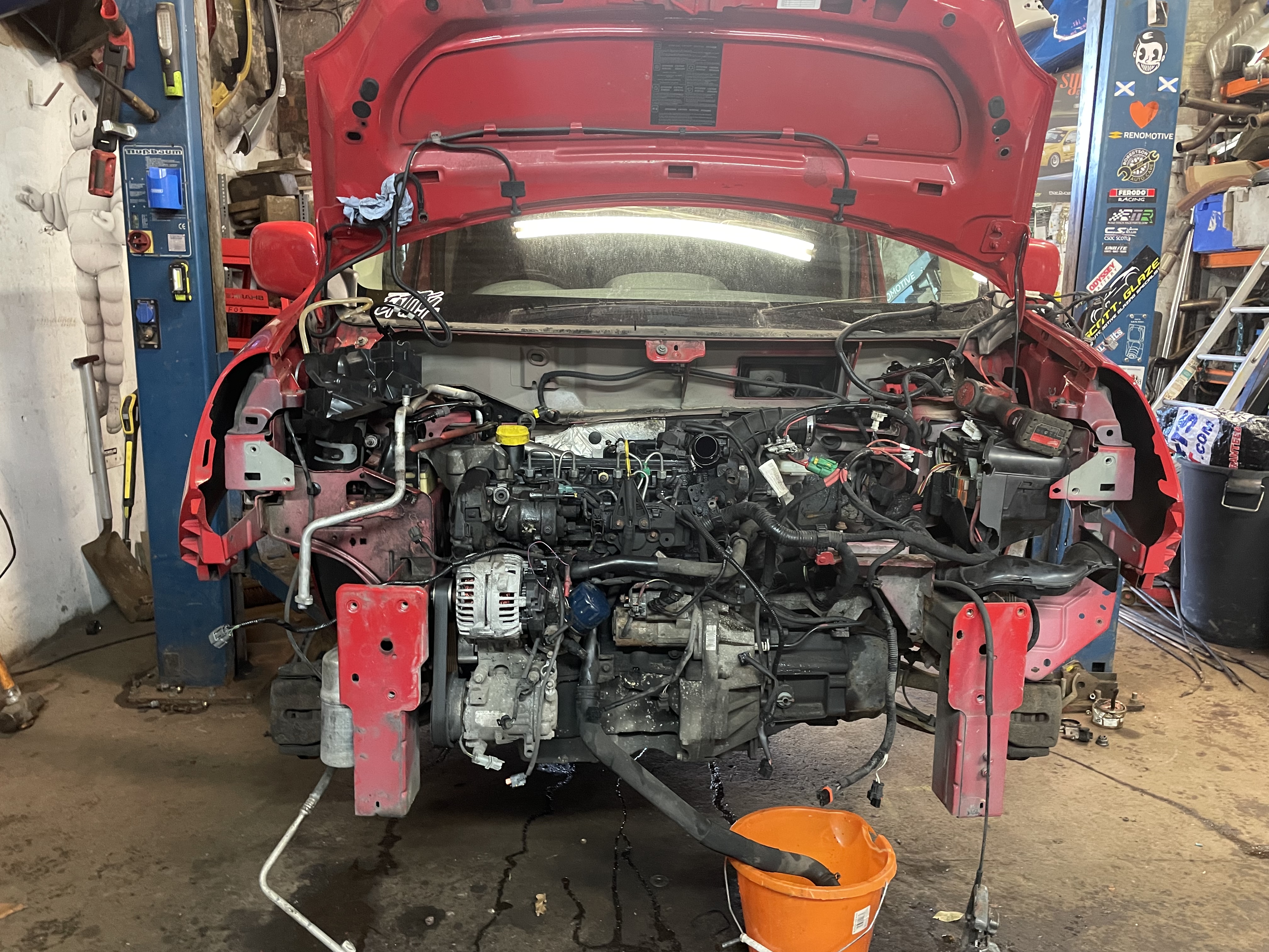

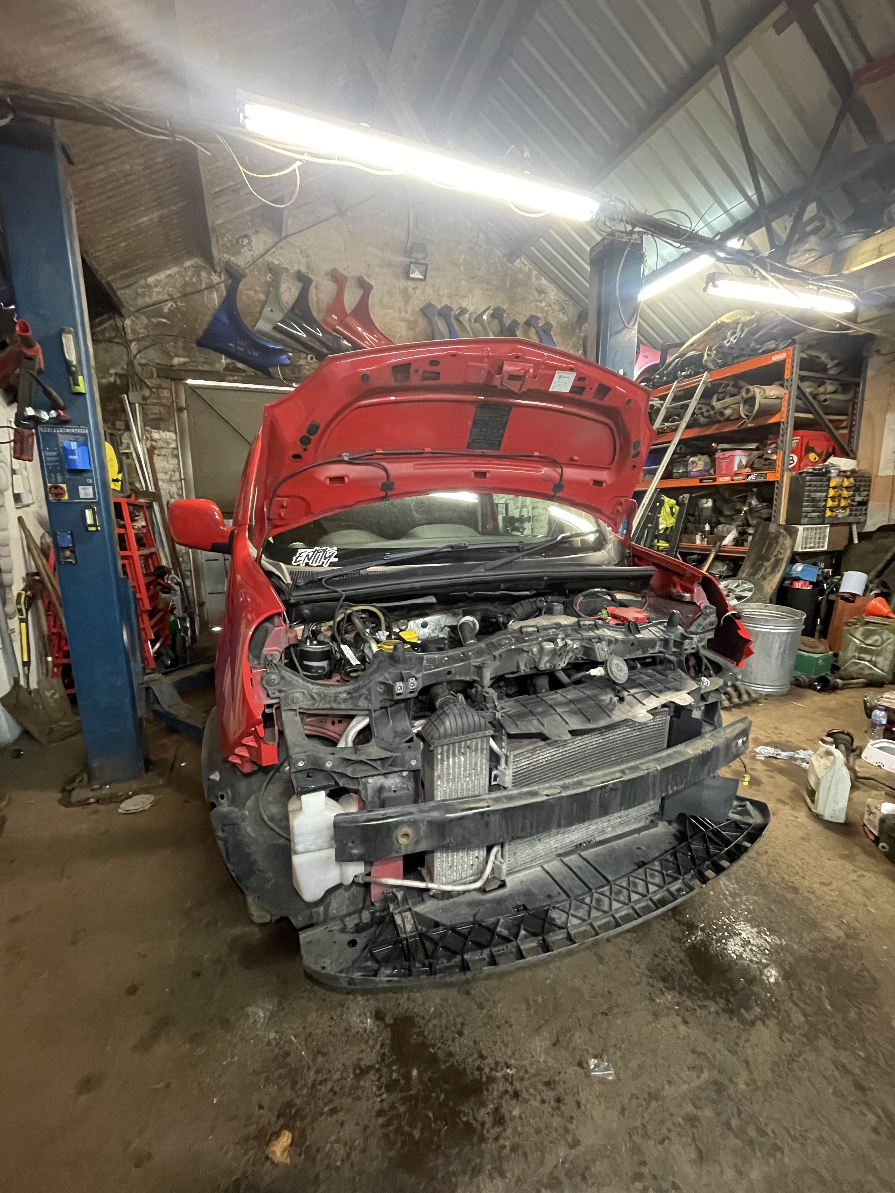

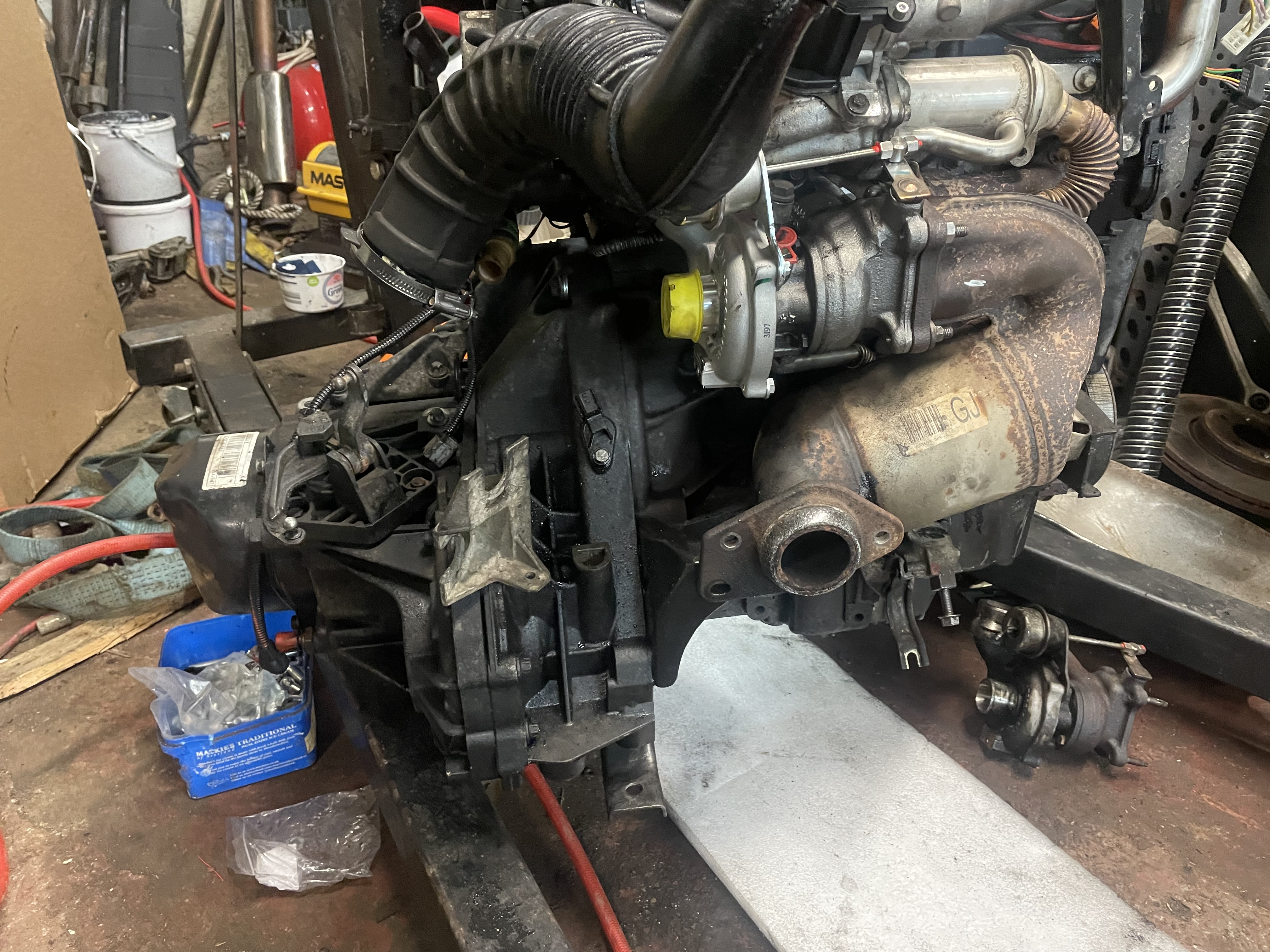

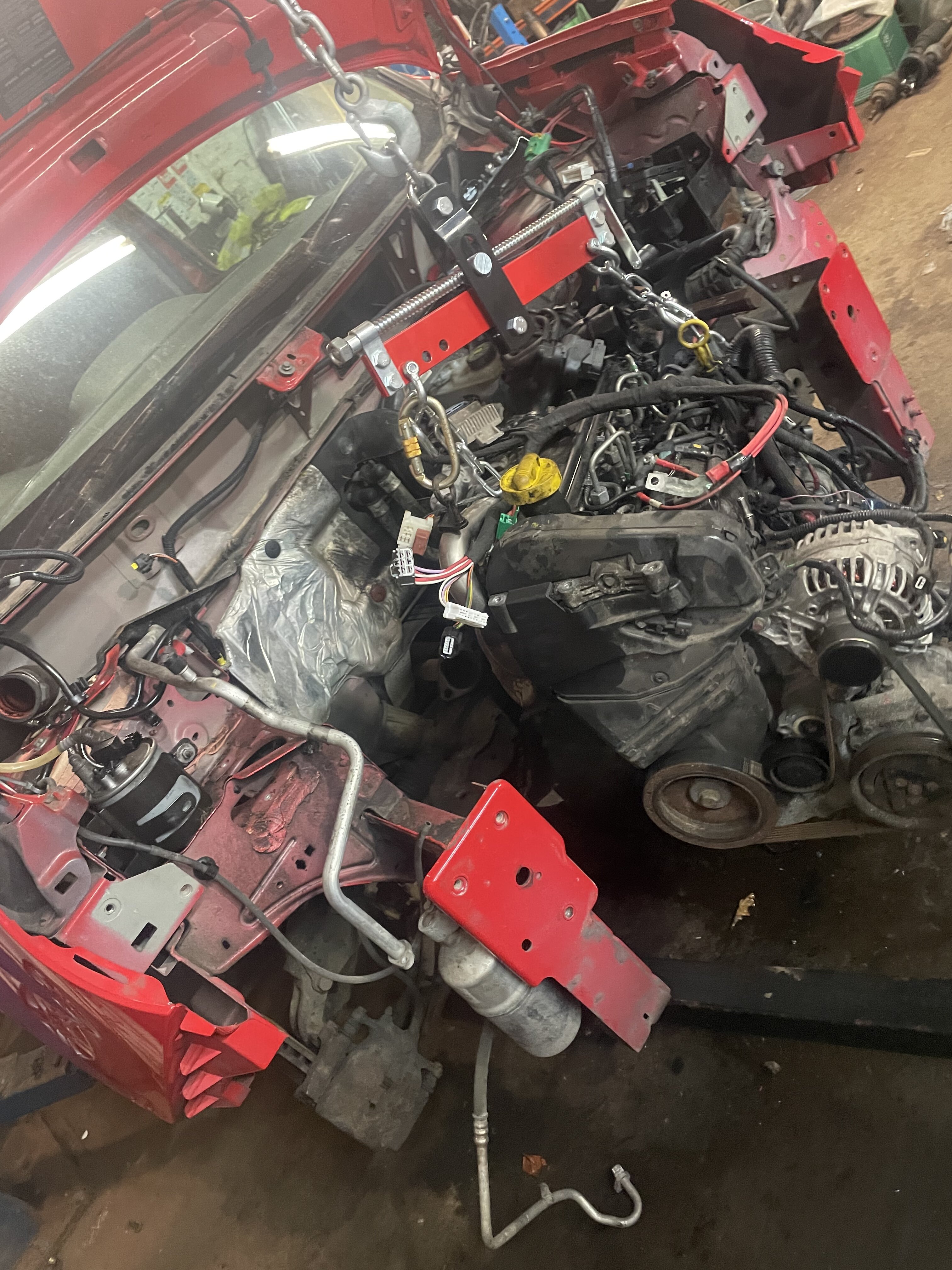

So in recent times the past couple of weeks on my down time I’ve managed to get the engine and box out.

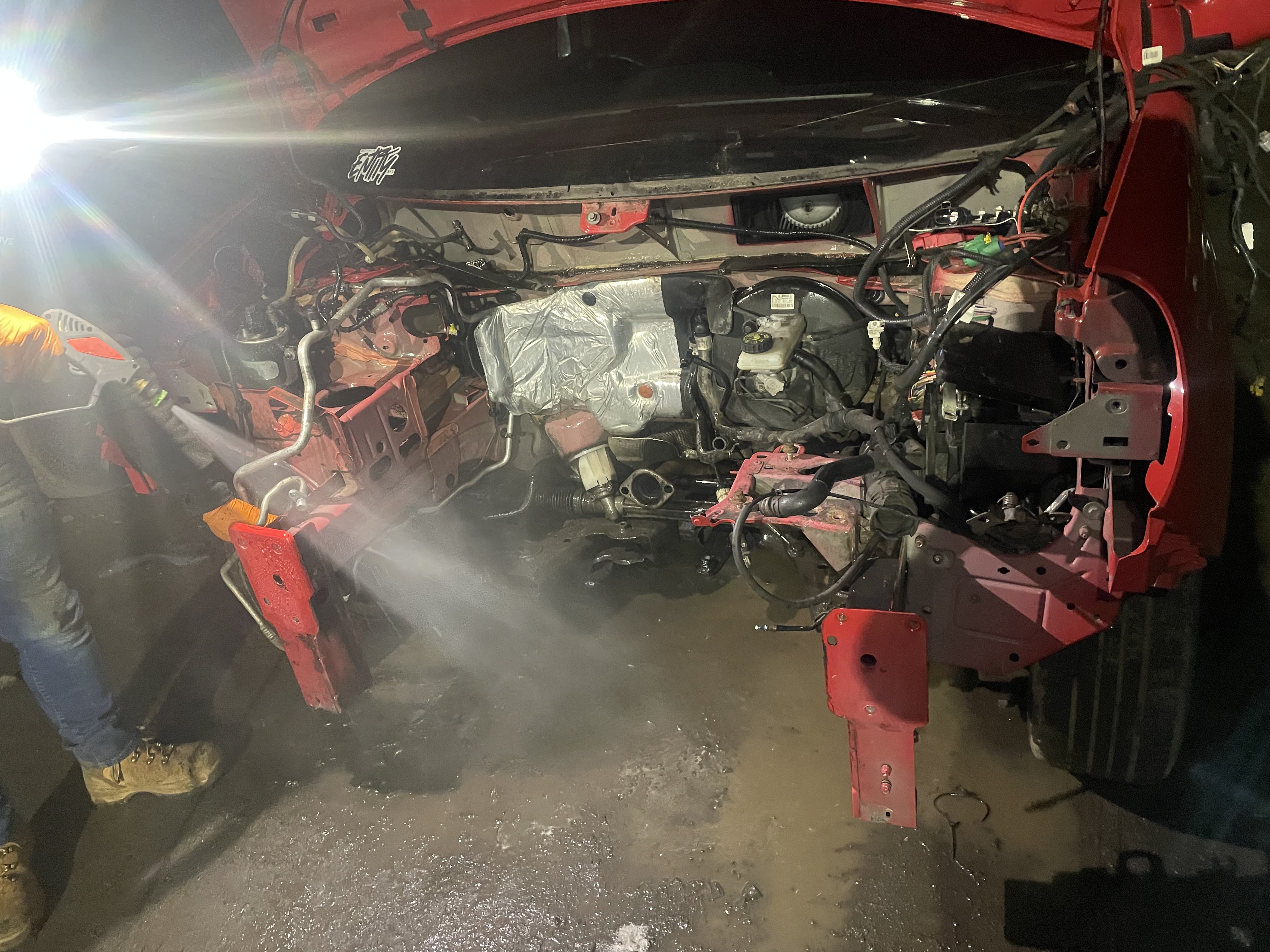

Pressure washed the bay:
So as per renault ownership, things have grown arms and legs and it’s become the parts cannon. “May as well just do that while the engine is out”
other parts on the way now:
- New Radiator
- Aircon condenser
- wishbones / ball joints
- adjustable drop links
- tie rods and ends
- brand new borg Warner turbo
- new coolant hoses
- sump plugs and washers
- dogbone mount
- split charging kit for leisure battery and inverter.

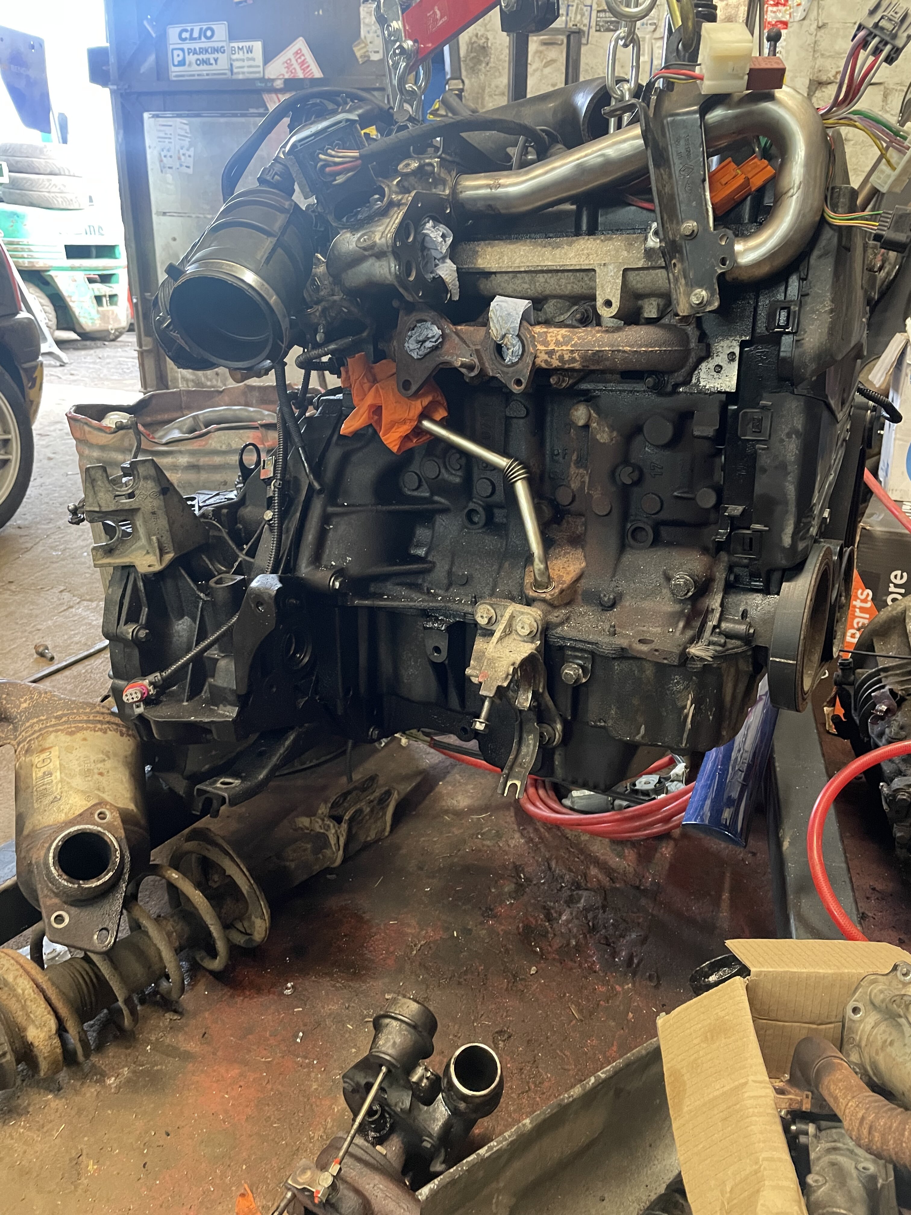

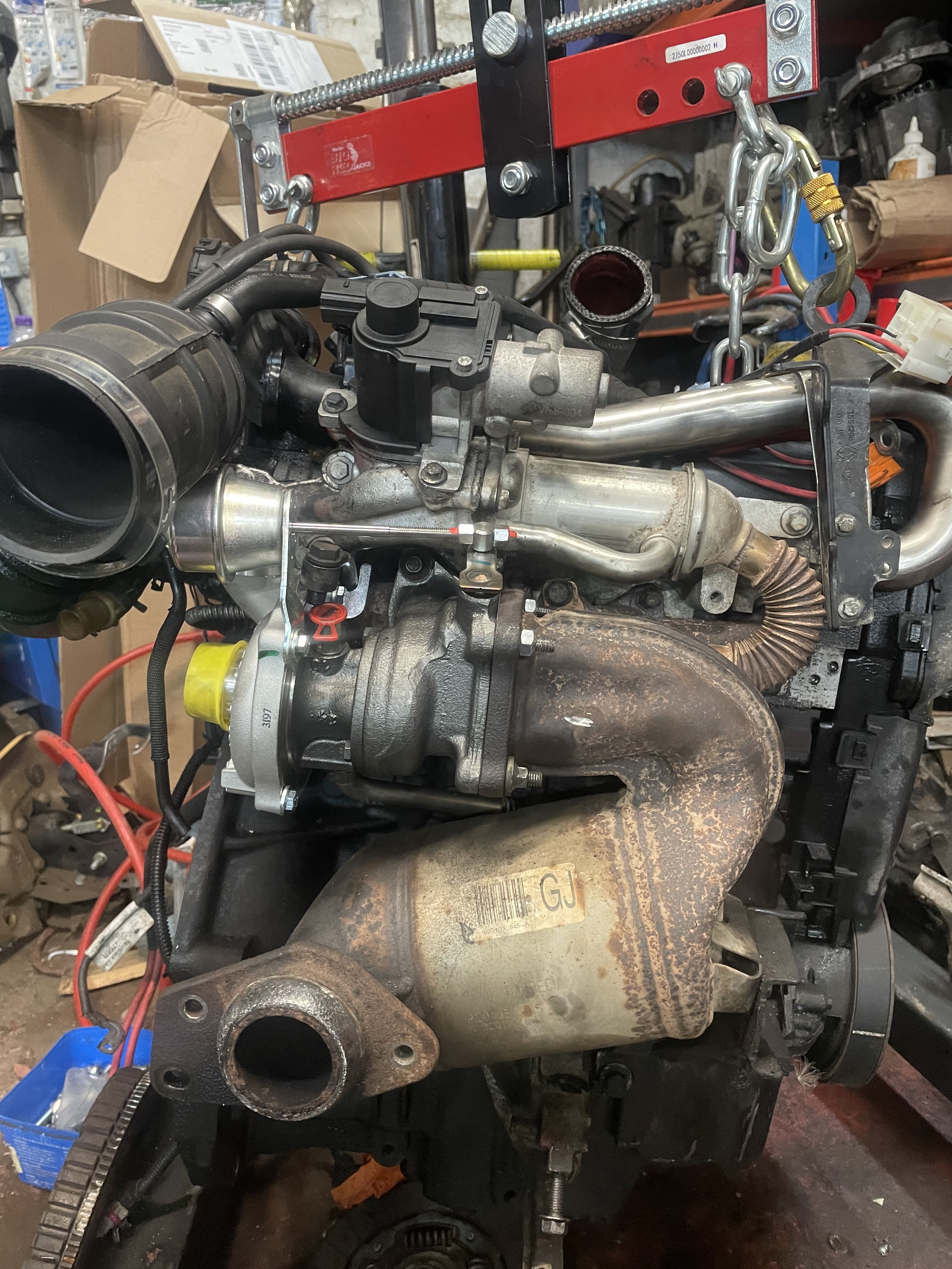

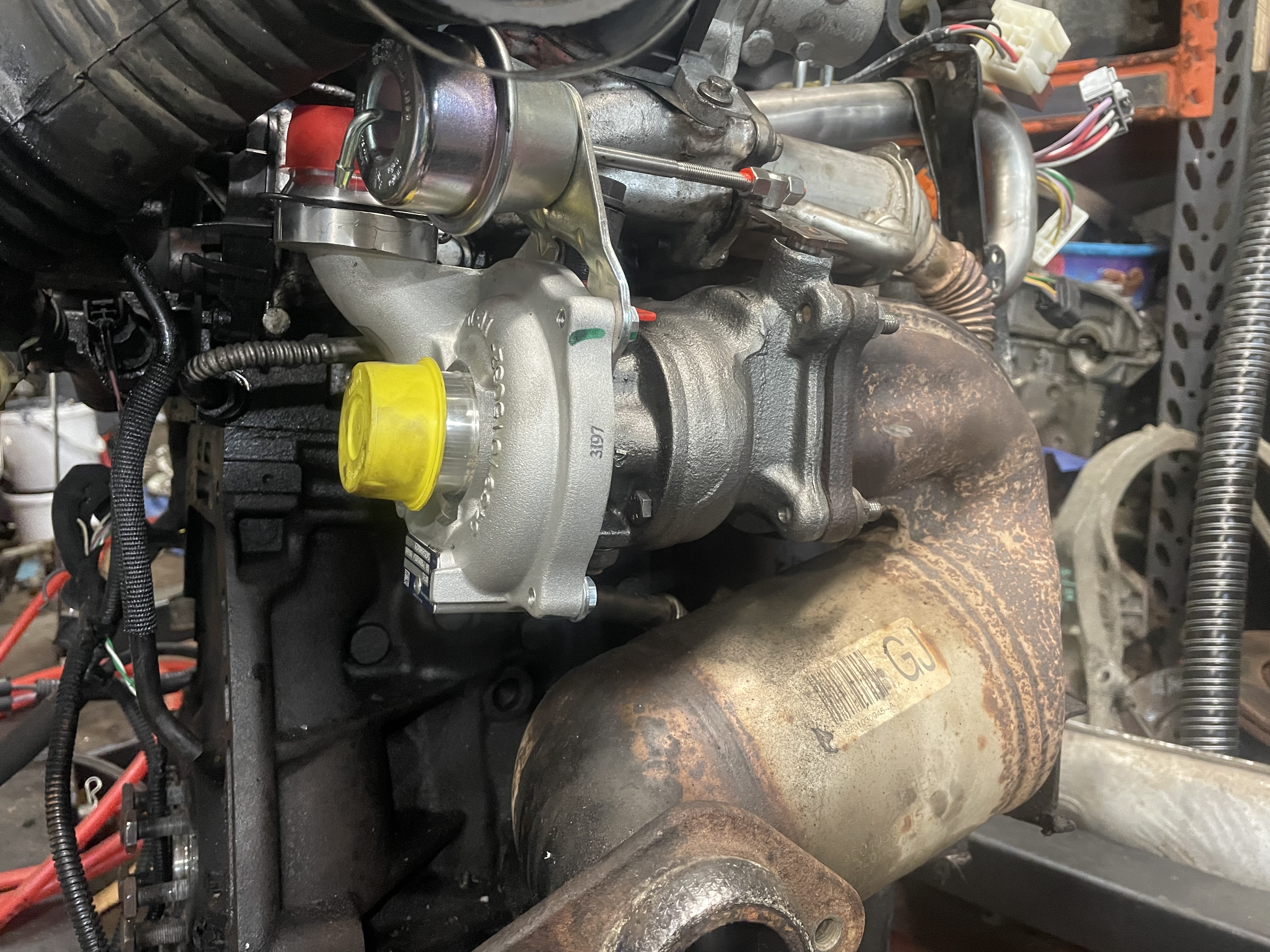

Set about taking the turbo off today, seals are gone on it was far cheaper to get a brand new unit than getting this re built.
As you’d imagine all the bolts were typically seized on so was a fun time smashing all the nuts off the cat.
That’s where I’m at just now, plan is to get the clutch and belts done and the engine back in, hopefully in the next couple weeks.

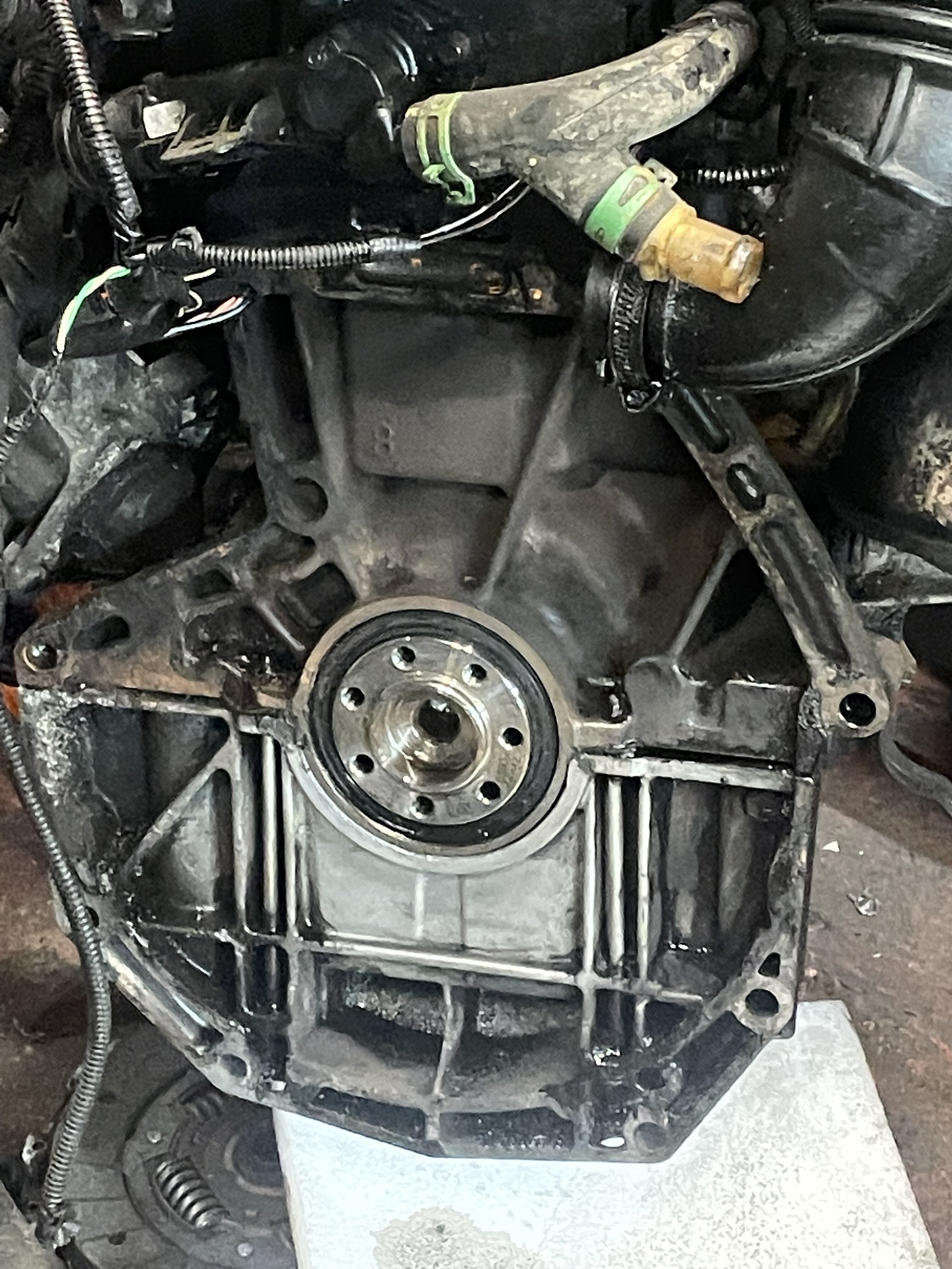

Few bits done tonight to get this thing moving.
New turbo on, realised the oil feed line was a bit leaky so I’ve ordered a new one.

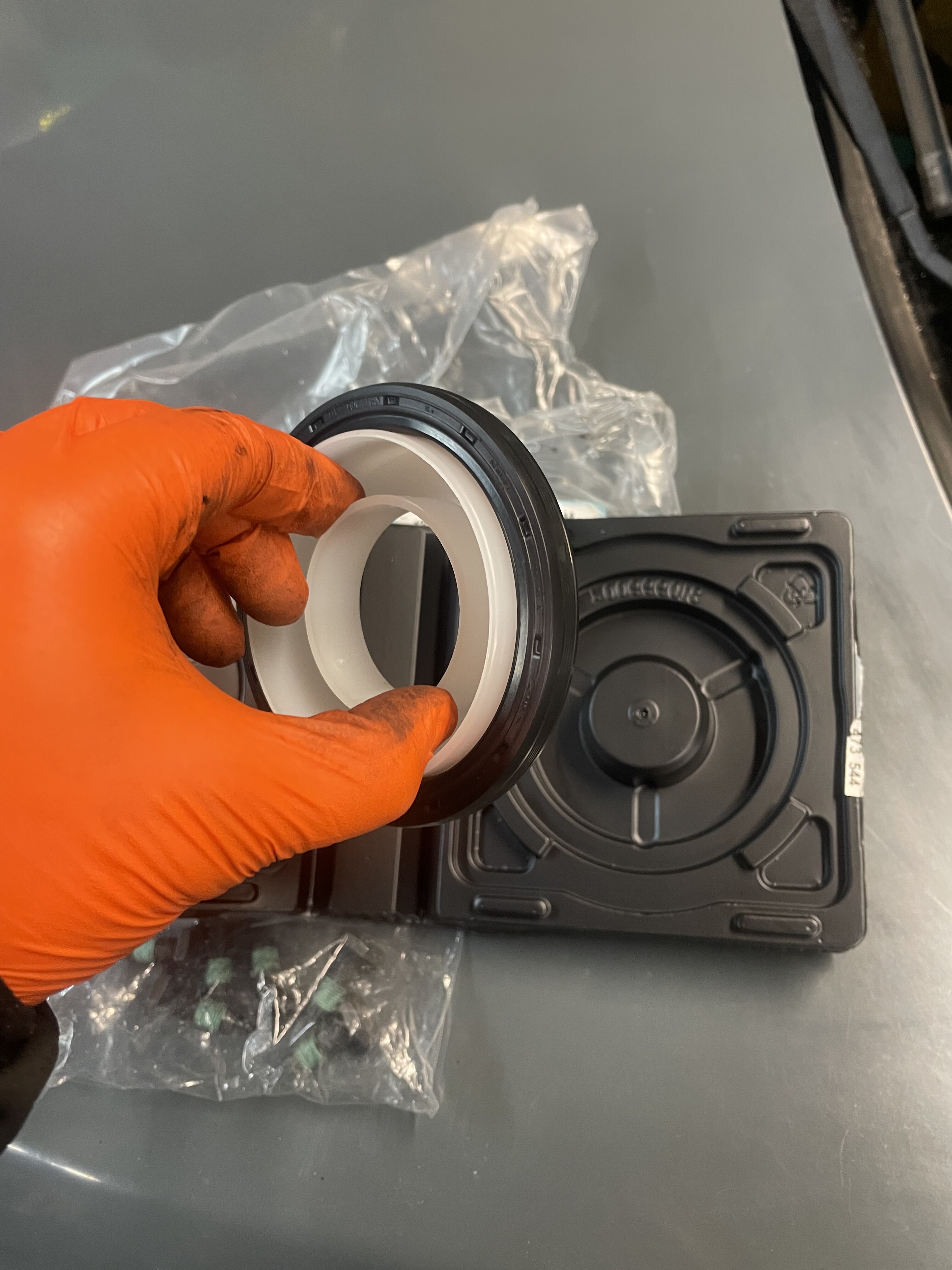

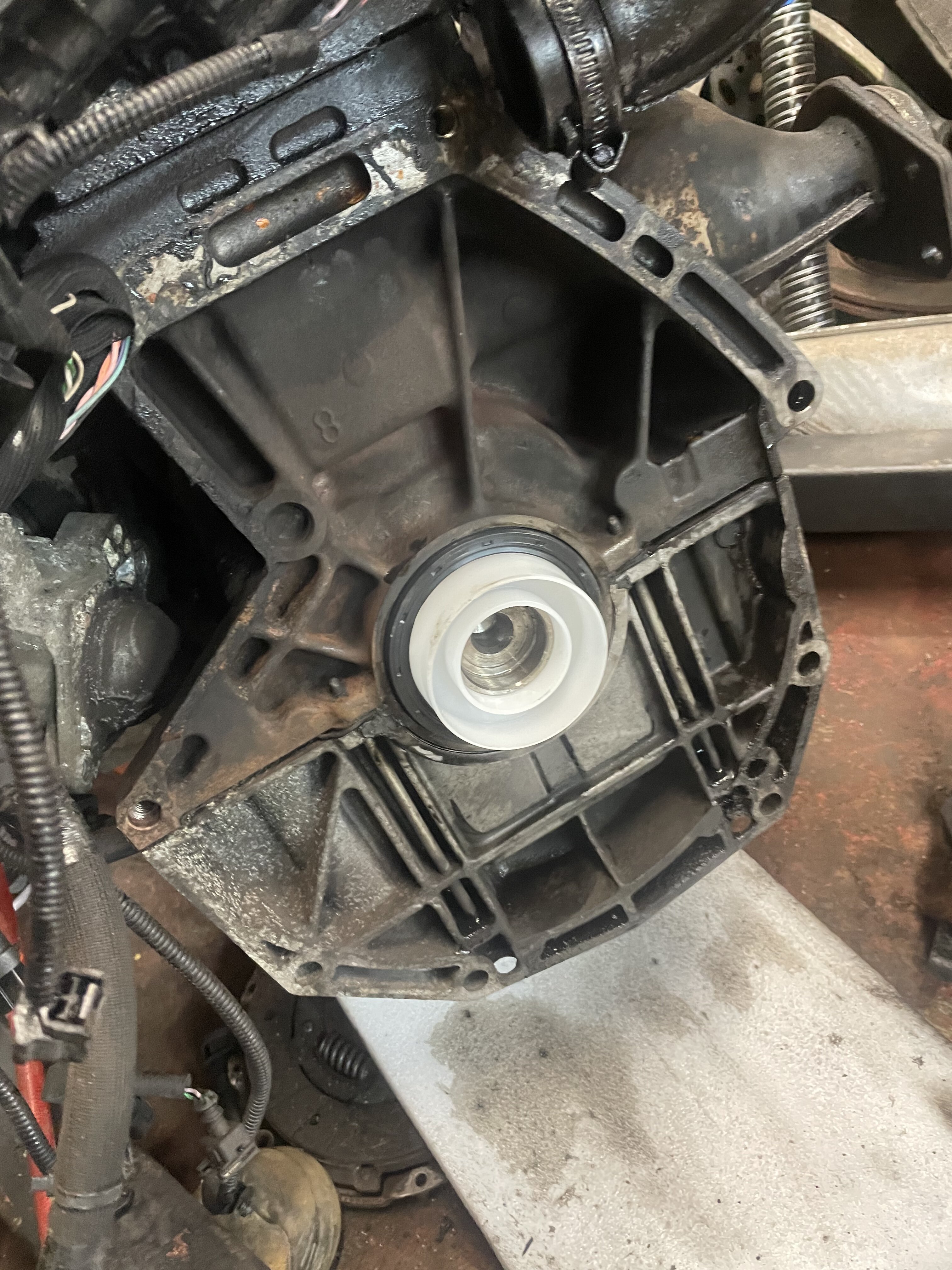

New rear main seal installed along with a valeo clutch and release bearing. Fired the box back on.
Will hopefully get a bit of time to do the belts and can sling the engine back into the van.
Need to run some wiring through the bulkhead while the engine is out for a leisure battery and inverter. Will also fire the new wishbones on too while the engine is out amongst other bits and bobs.
Good to get a bit of progress again. Not had much time to work on it lately.
