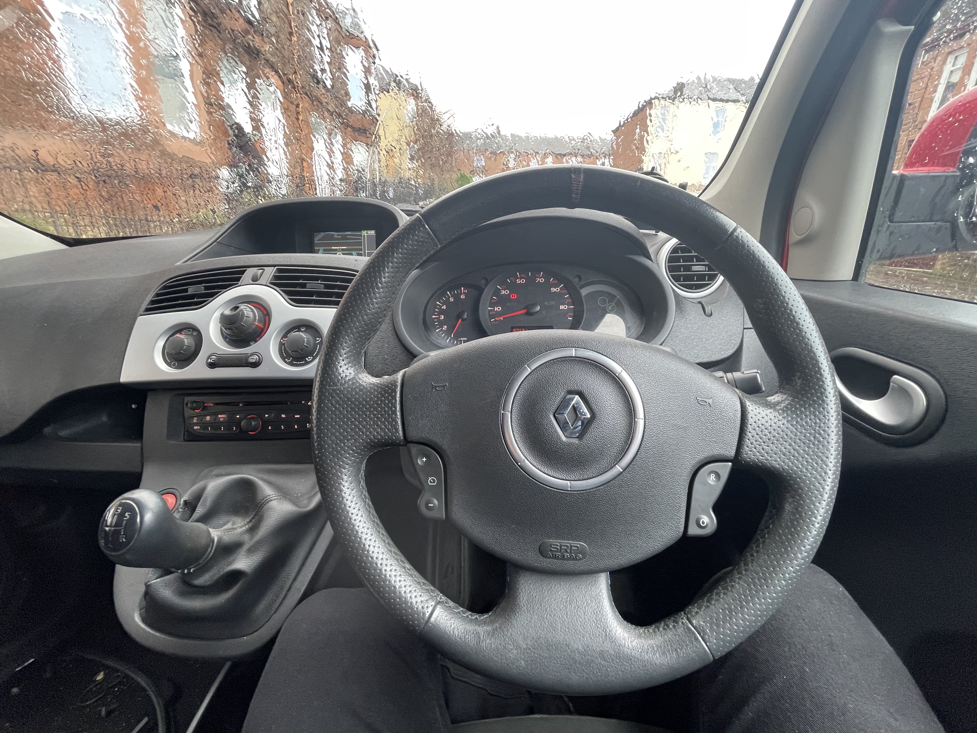

So do the 197/200 door handle straight fit I guess ?

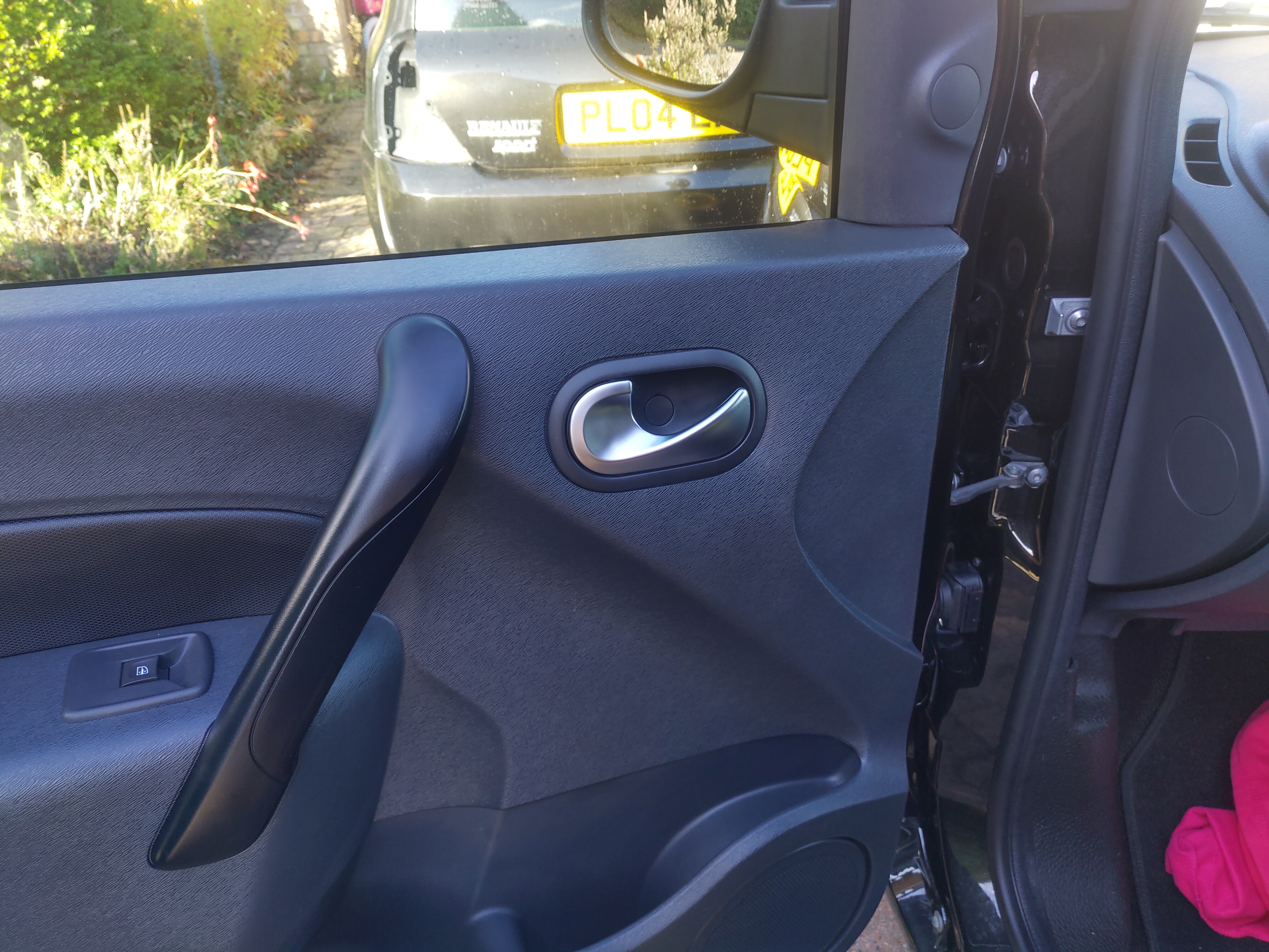

Nice little change that. I couldn’t help my self Went and ordered some should be here today. They literally a straight swap?
Cap flicks off, 1 torx screw out. Cover on the back unclips and clips into new handle, torx back in cap on and done! Easy peasyNice little change that. I couldn’t help my self Went and ordered some should be here today. They literally a straight swap?

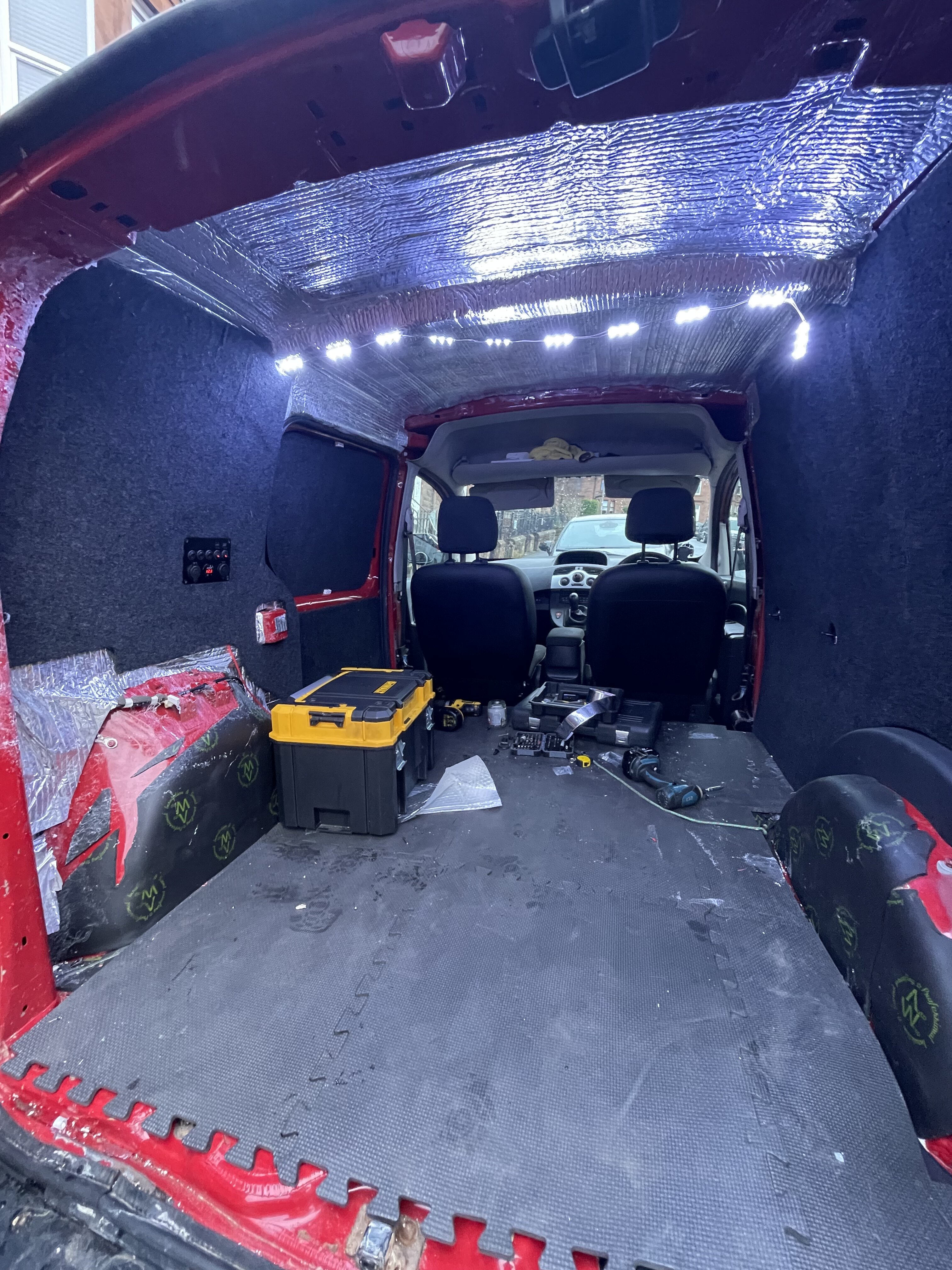

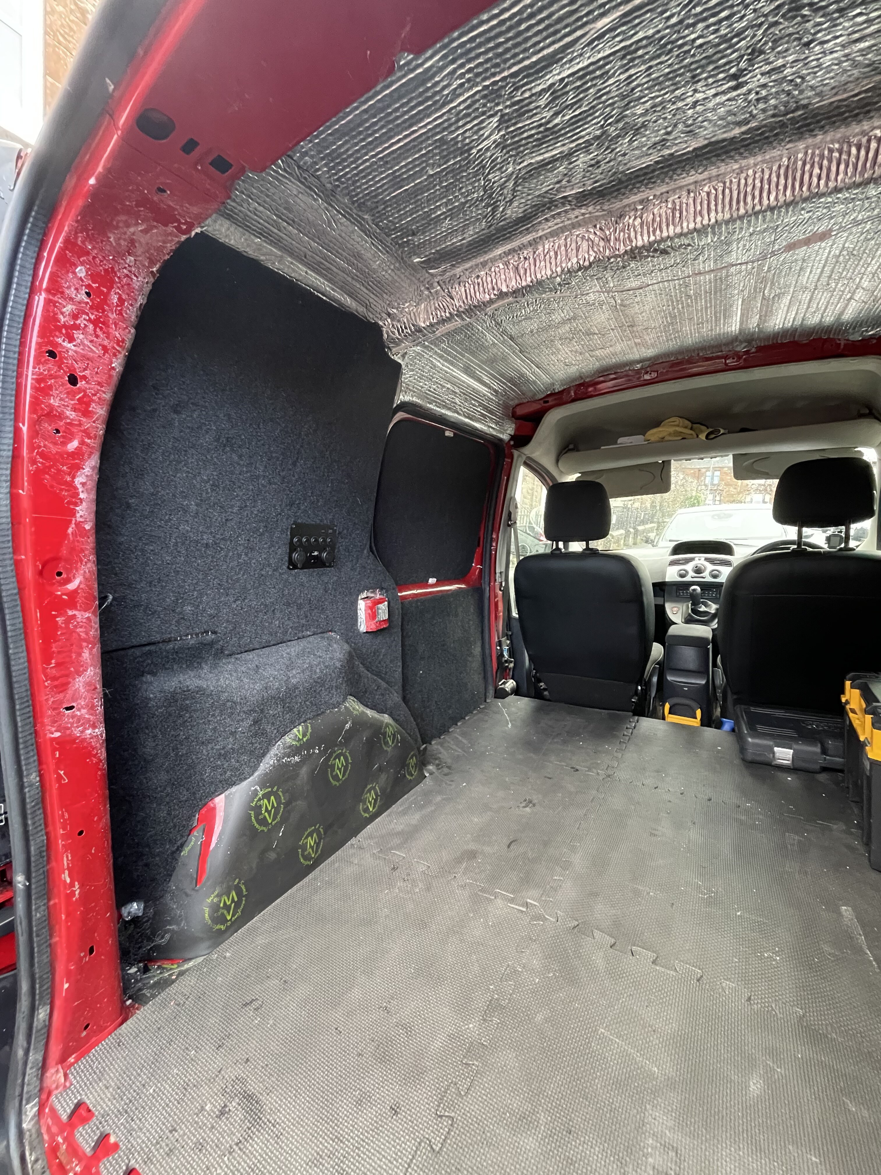

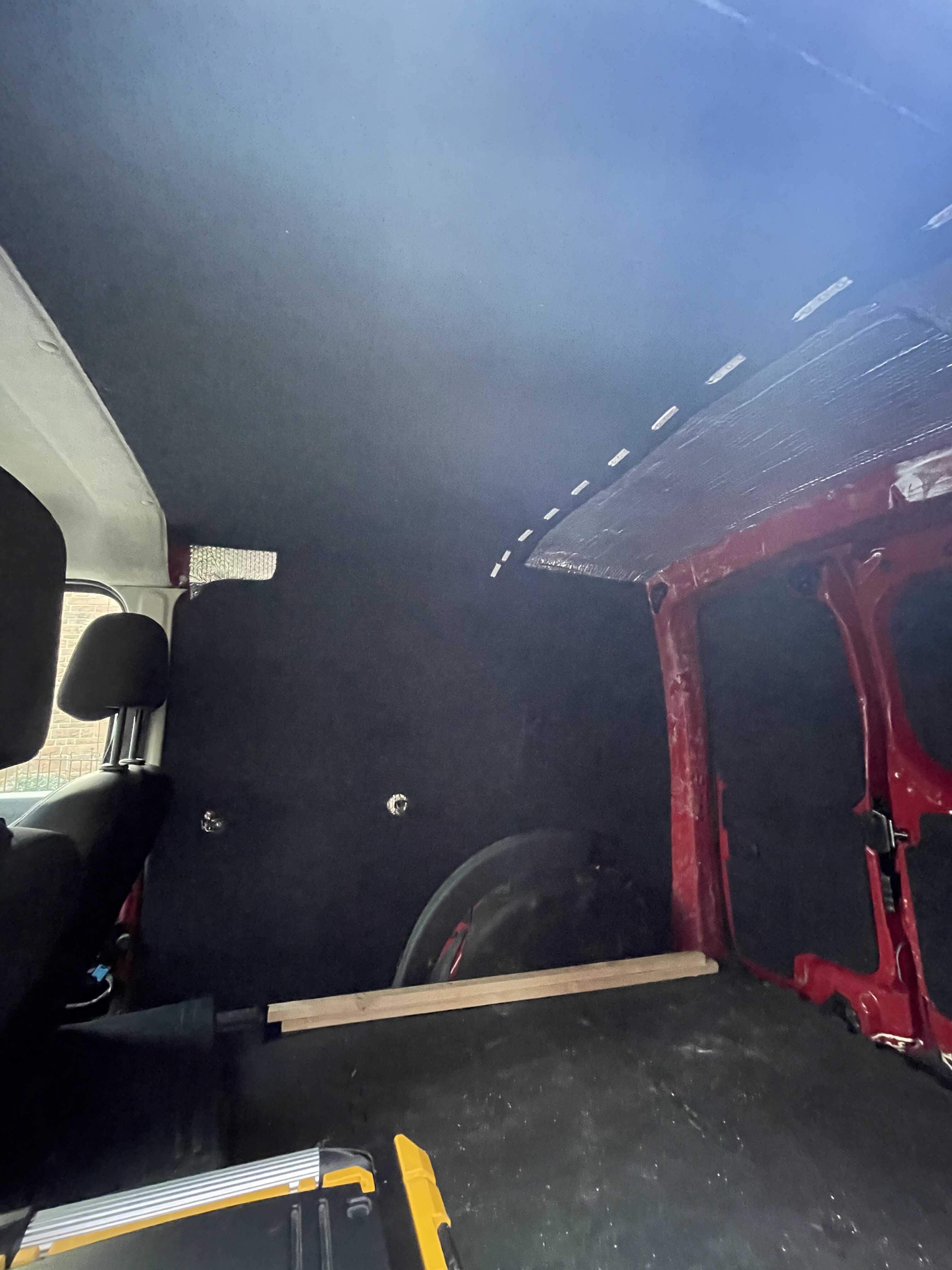

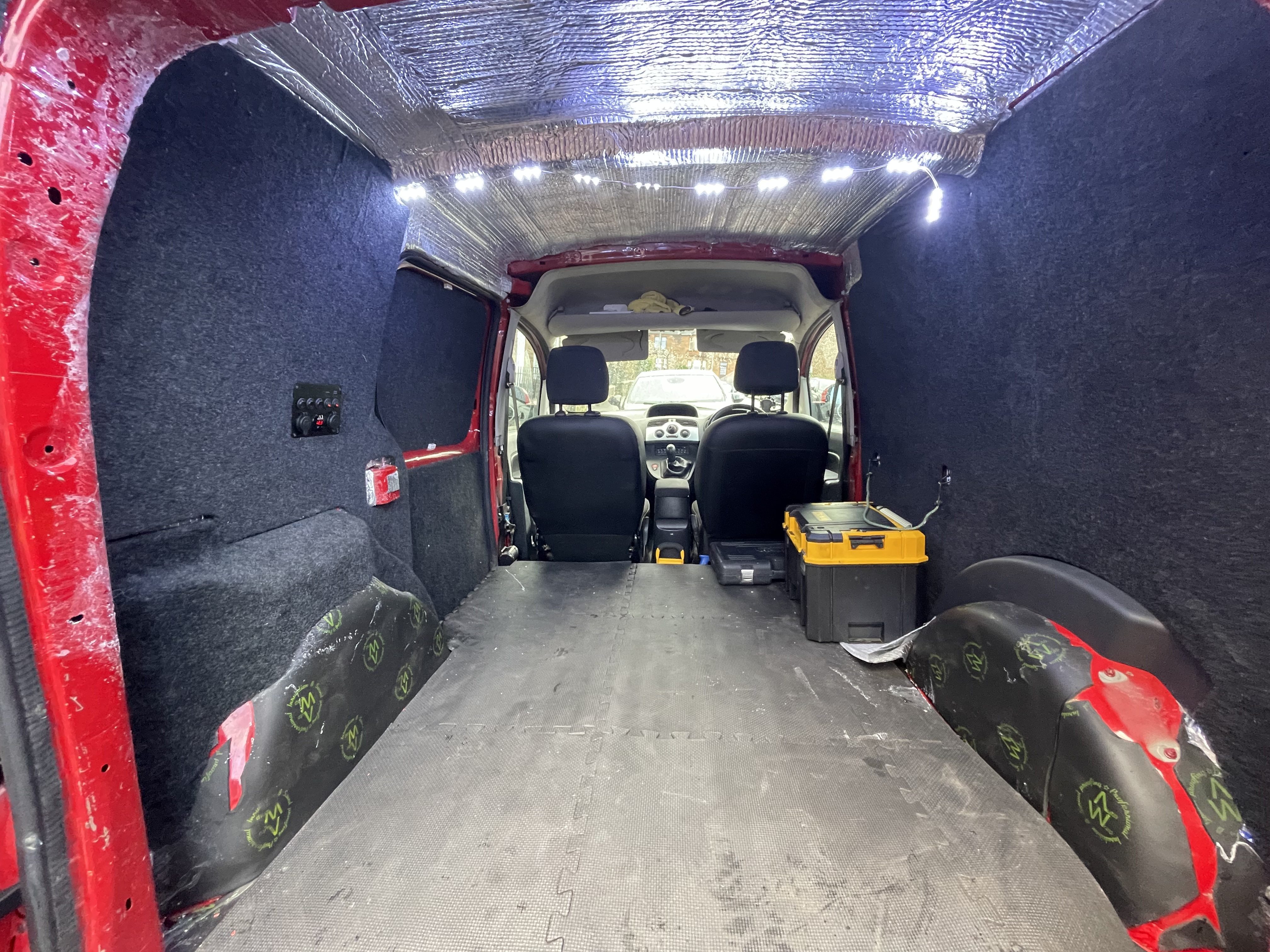

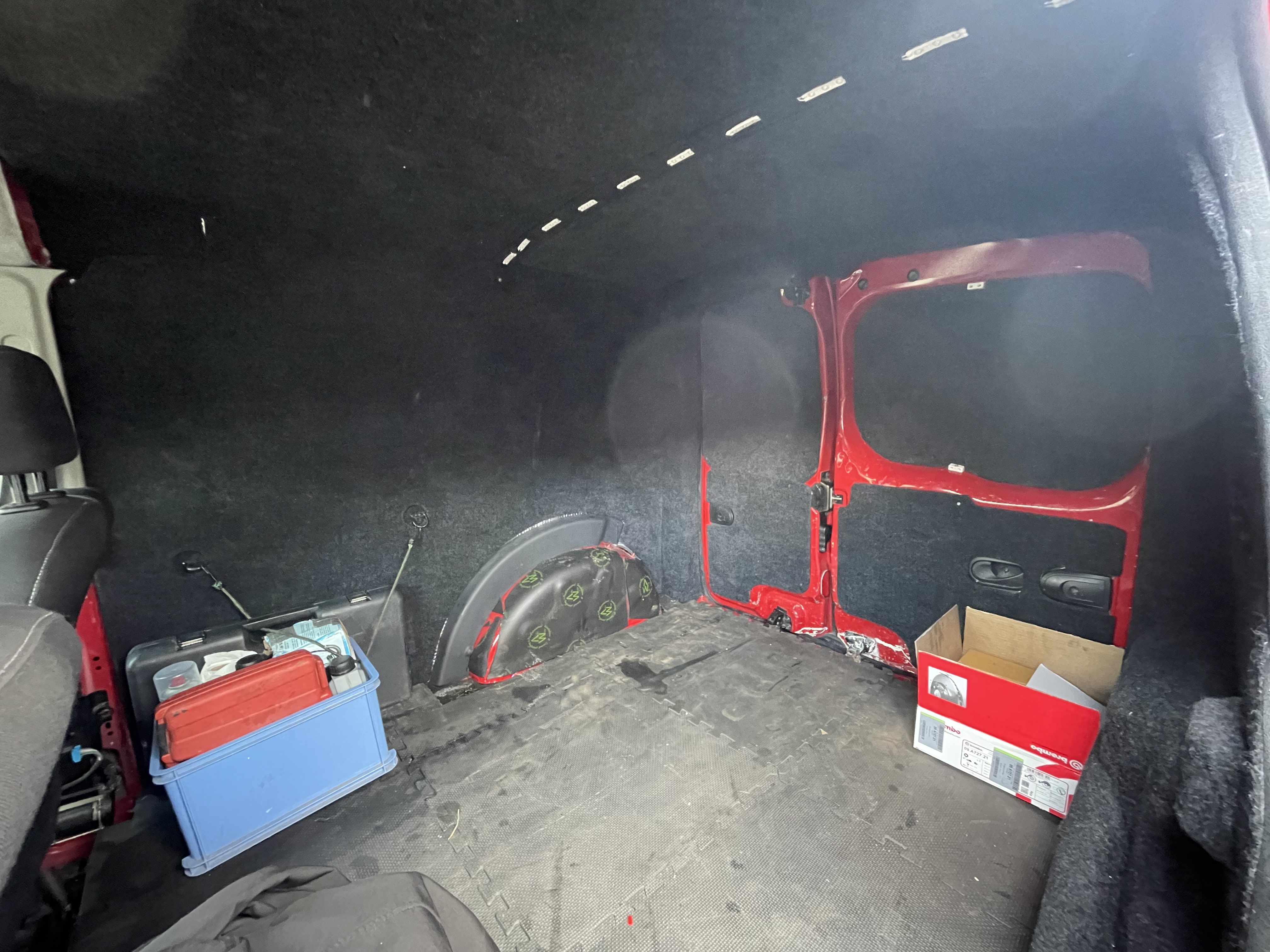

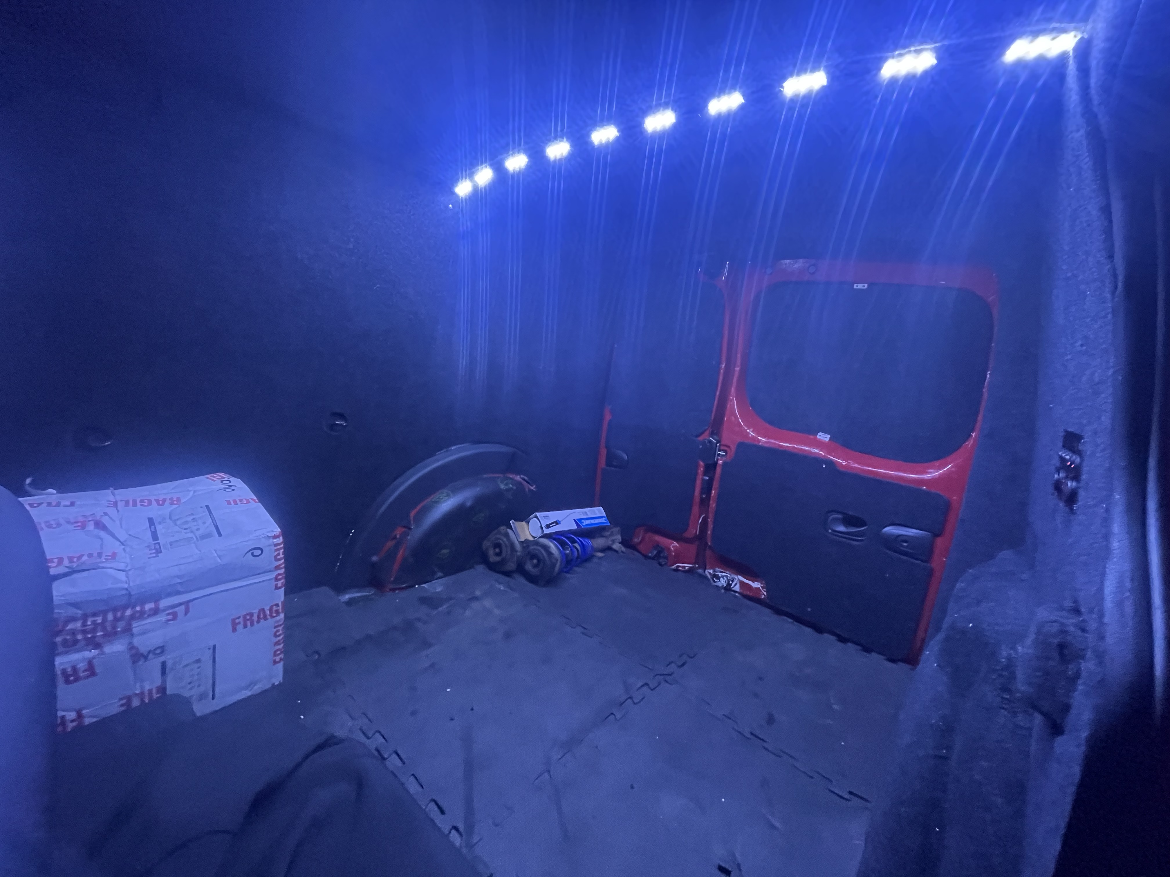

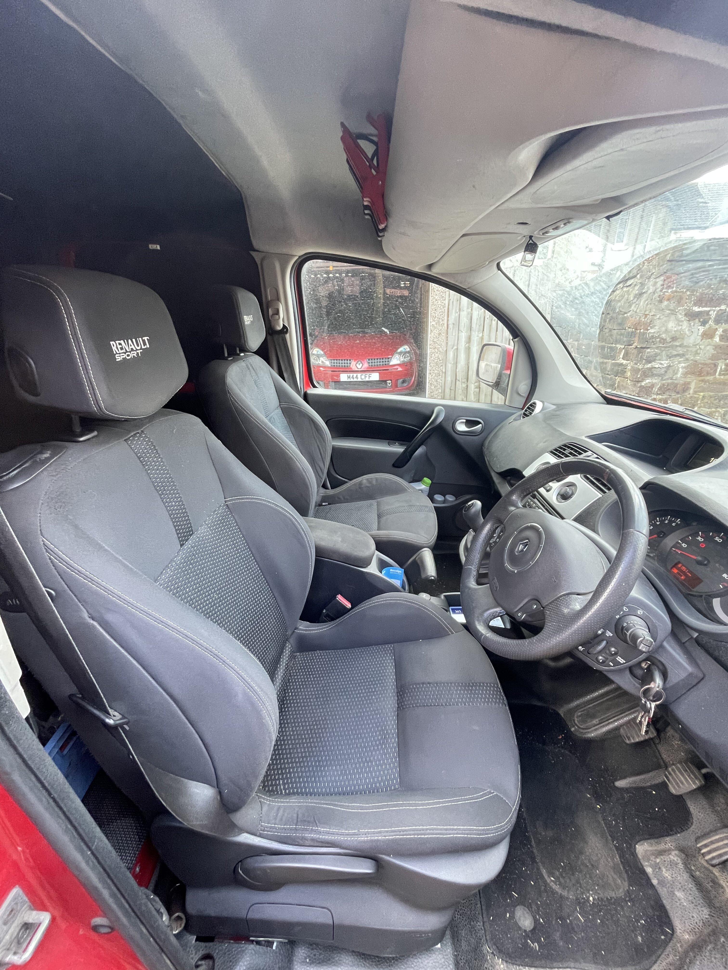

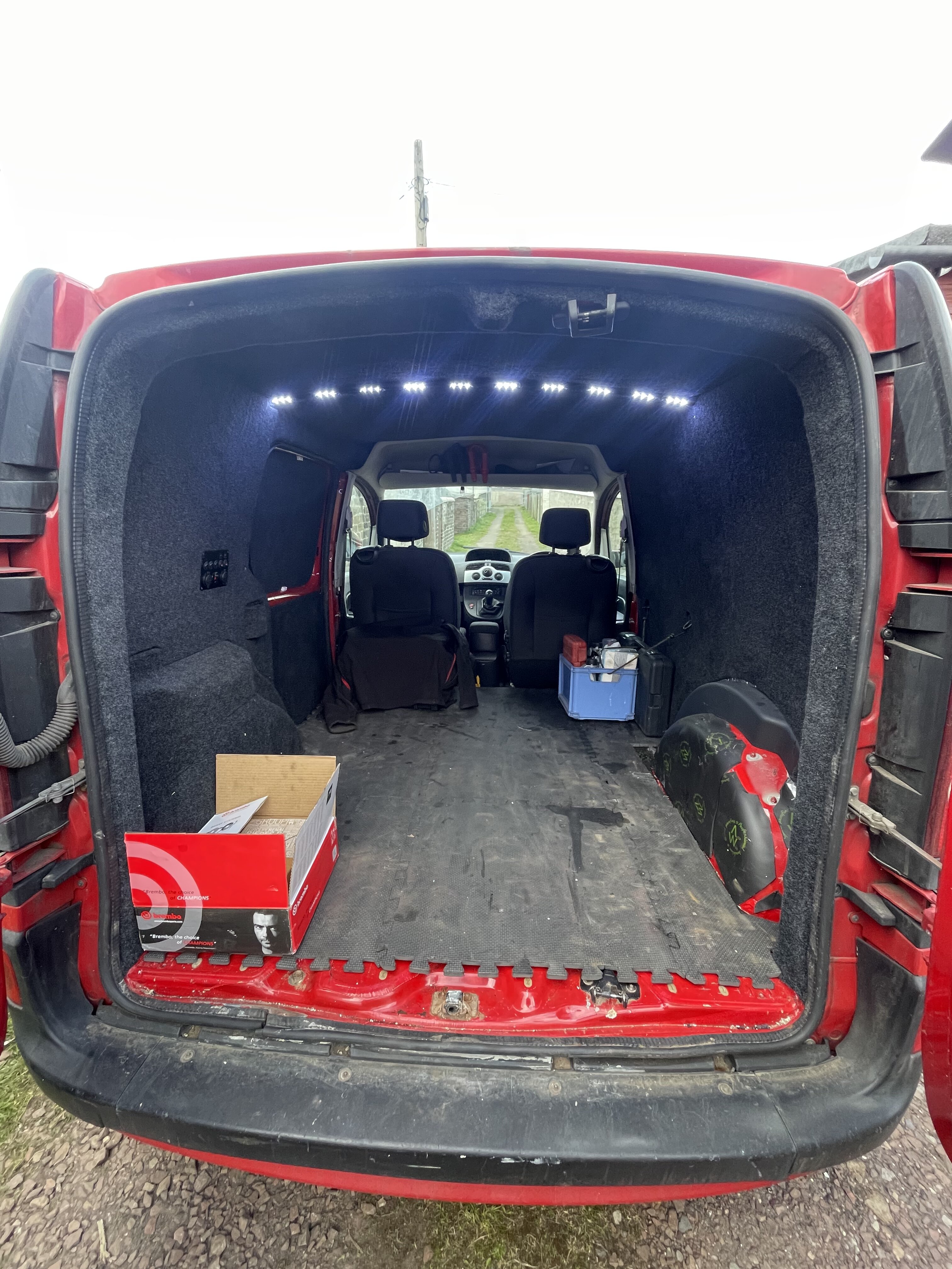

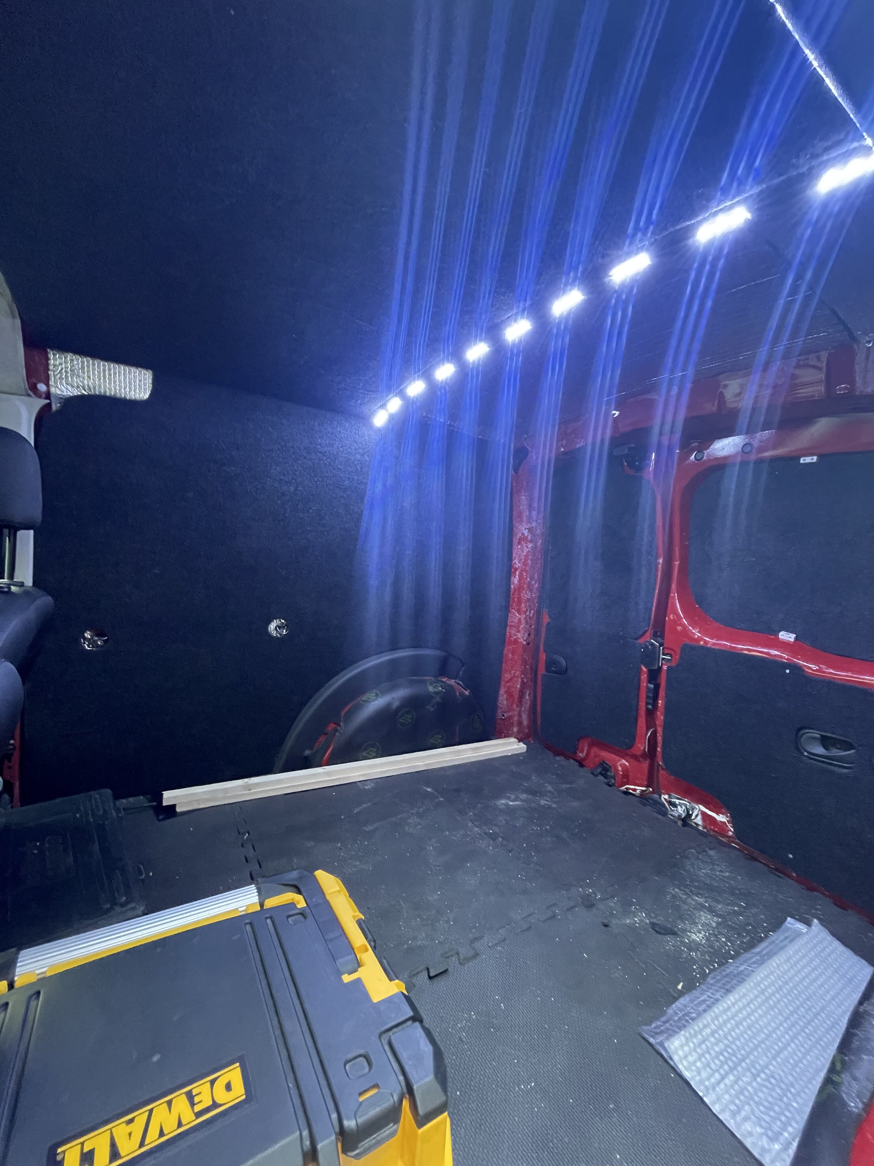

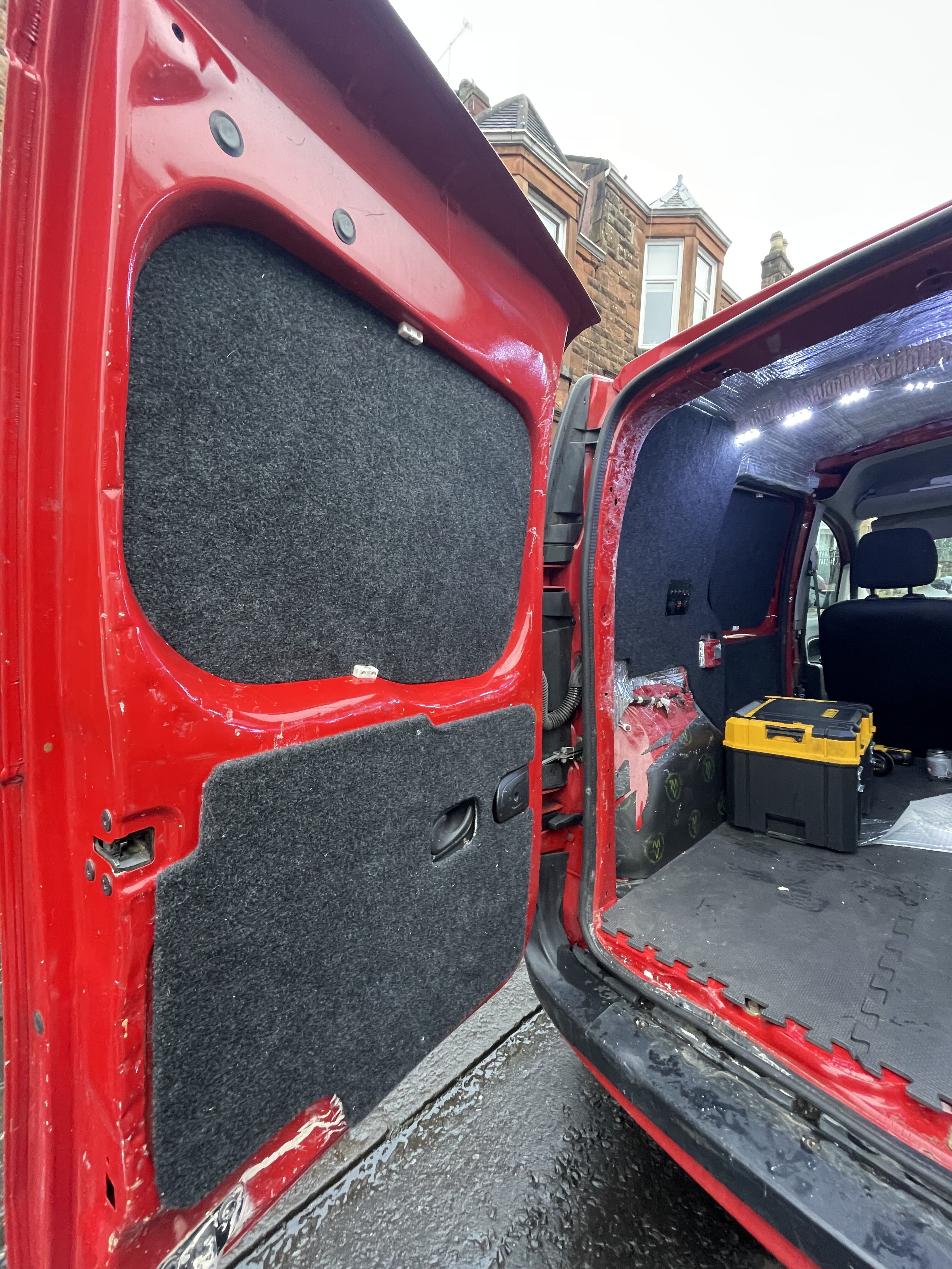

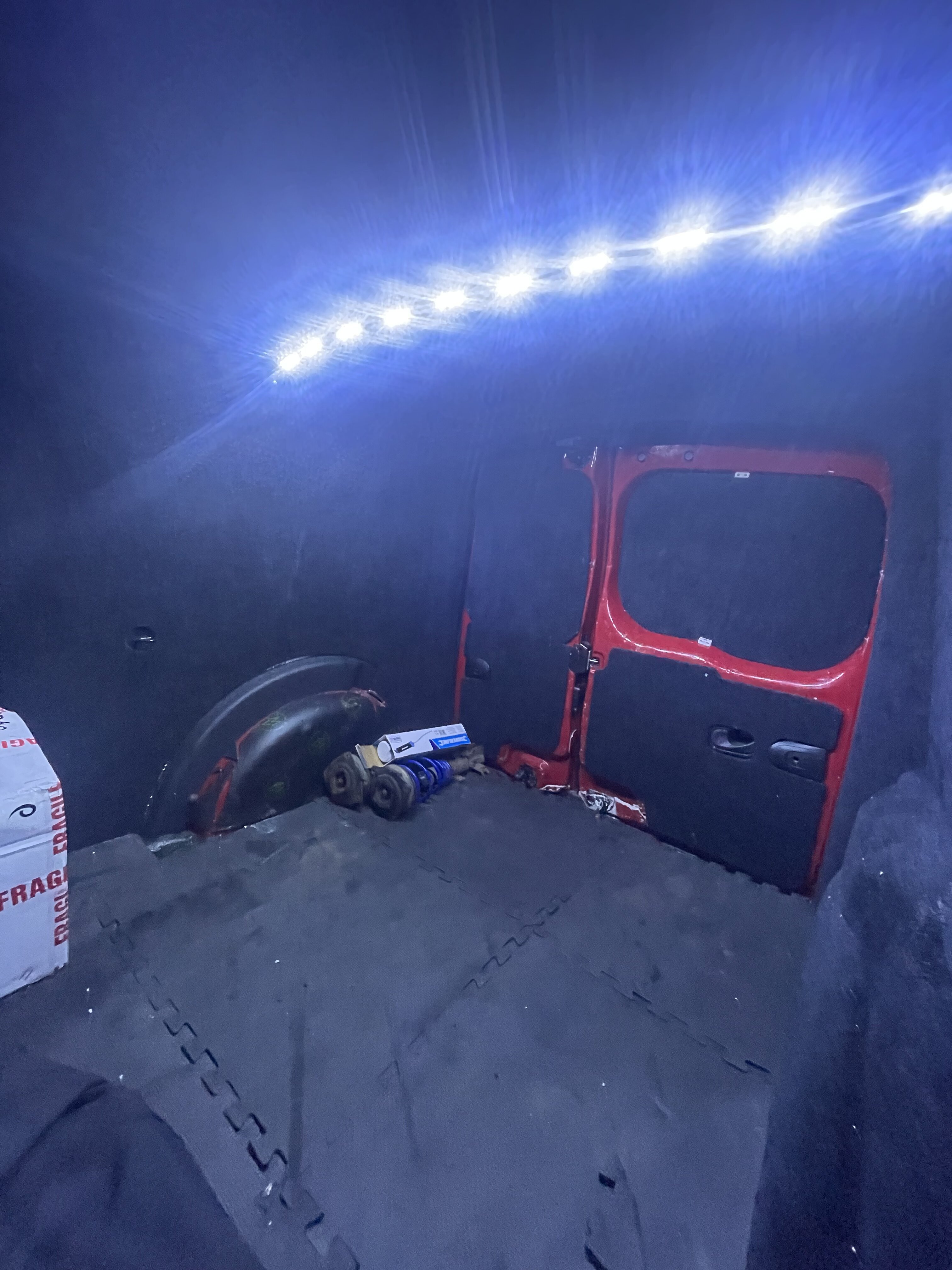

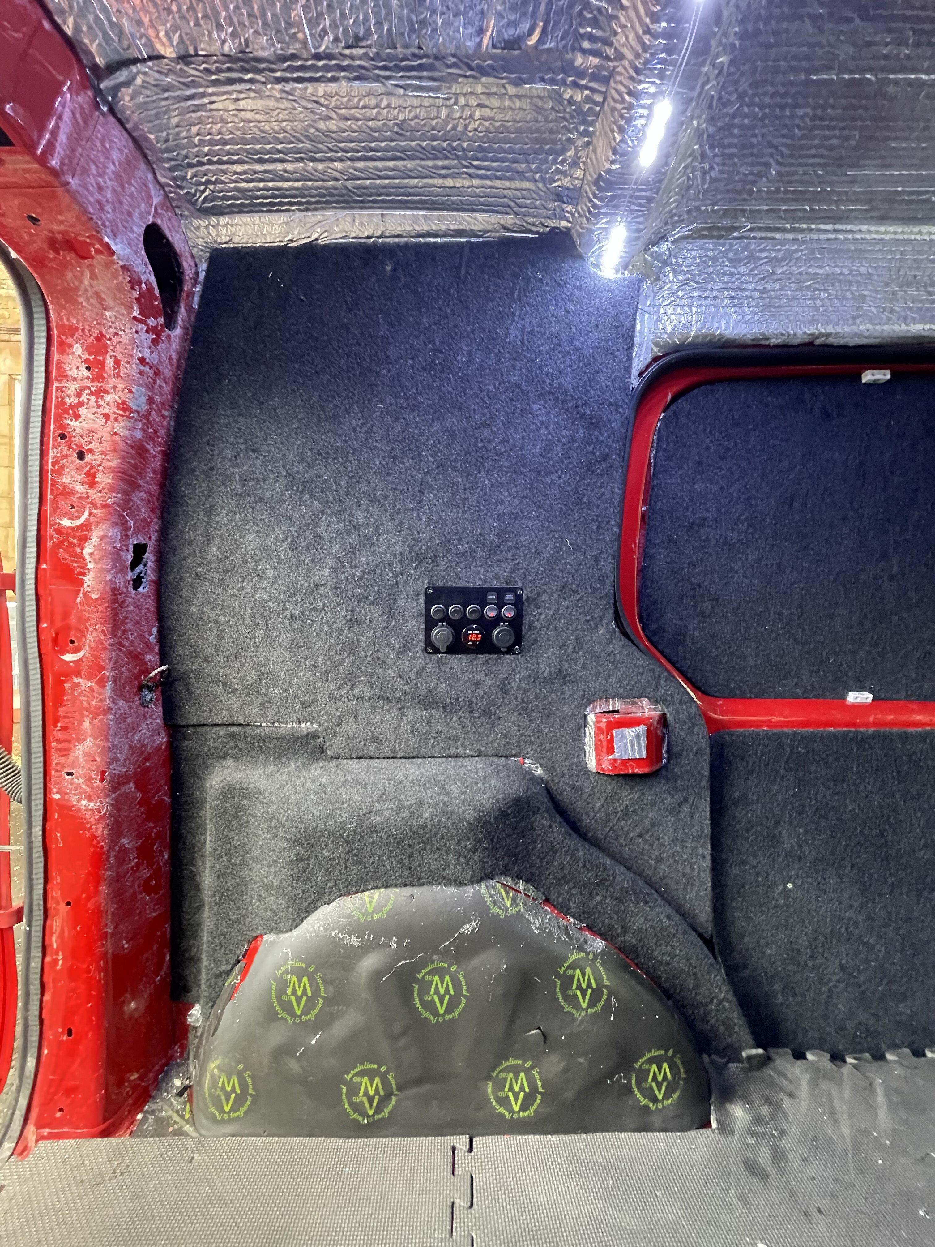

Not exactly sure what part you are wanting pictures of? I might be being a bit dense 😂 just the sides where the bulkhead attaches?@Mcaff Could you take some photos of the bulkhead screw locations please and some of your overhead storage in the front when you get the chance please? I've wanted to add the overhead for some time now and I've added a bulkhead but I never fixed it at the sides whereas you have and can't see if it's just screwed into the metal or actual fixings?
Sorry read it again it makes more sense to me now. Yeah no problem if I get the chance I will have a look tomorrow. Mine has a mixture of bolts and nuts also a couple of fixings in the top. Will get a few pictures tomorrow@Mcaff Could you take some photos of the bulkhead screw locations please and some of your overhead storage in the front when you get the chance please? I've wanted to add the overhead for some time now and I've added a bulkhead but I never fixed it at the sides whereas you have and can't see if it's just screwed into the metal or actual fixings?

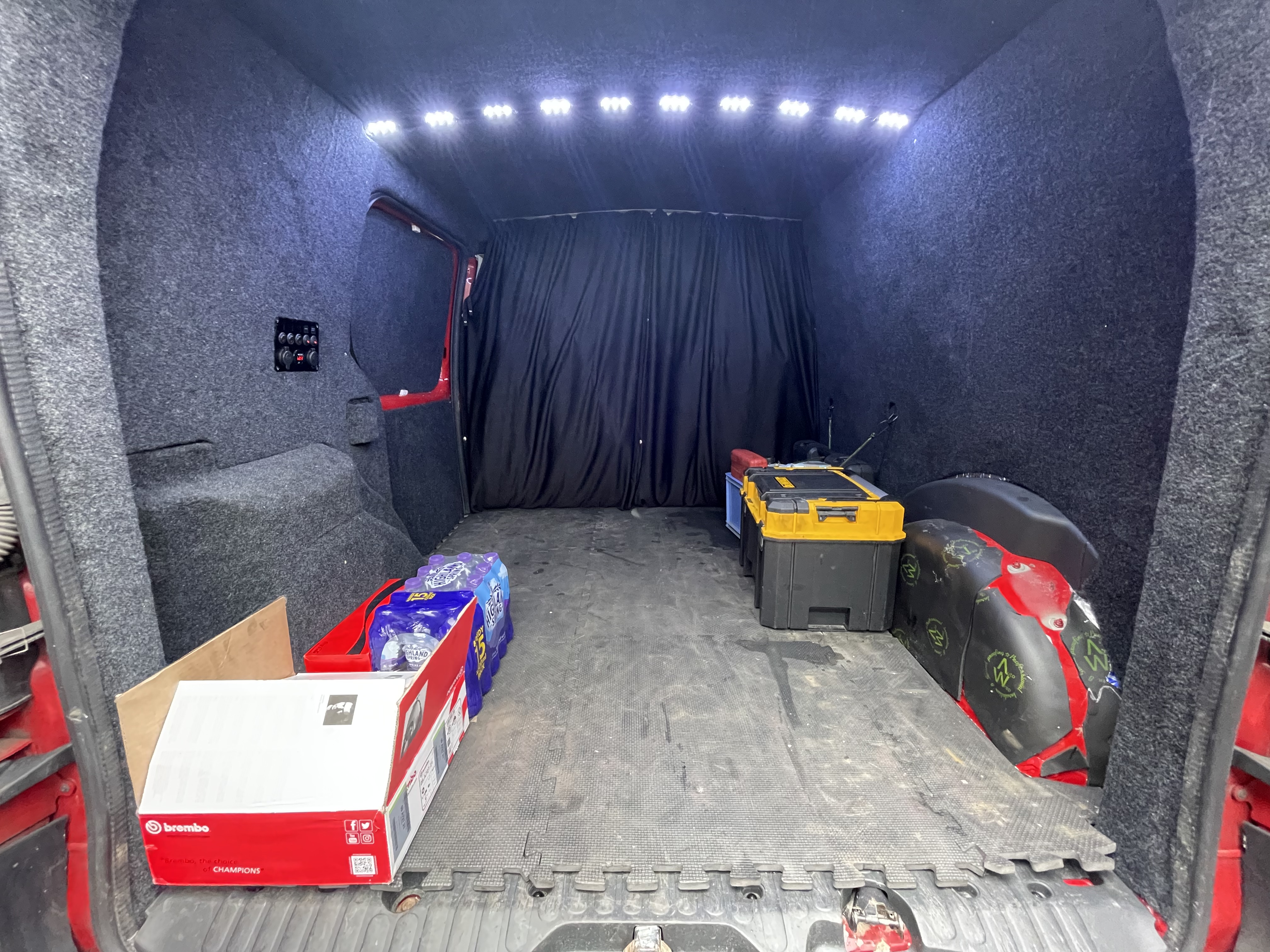

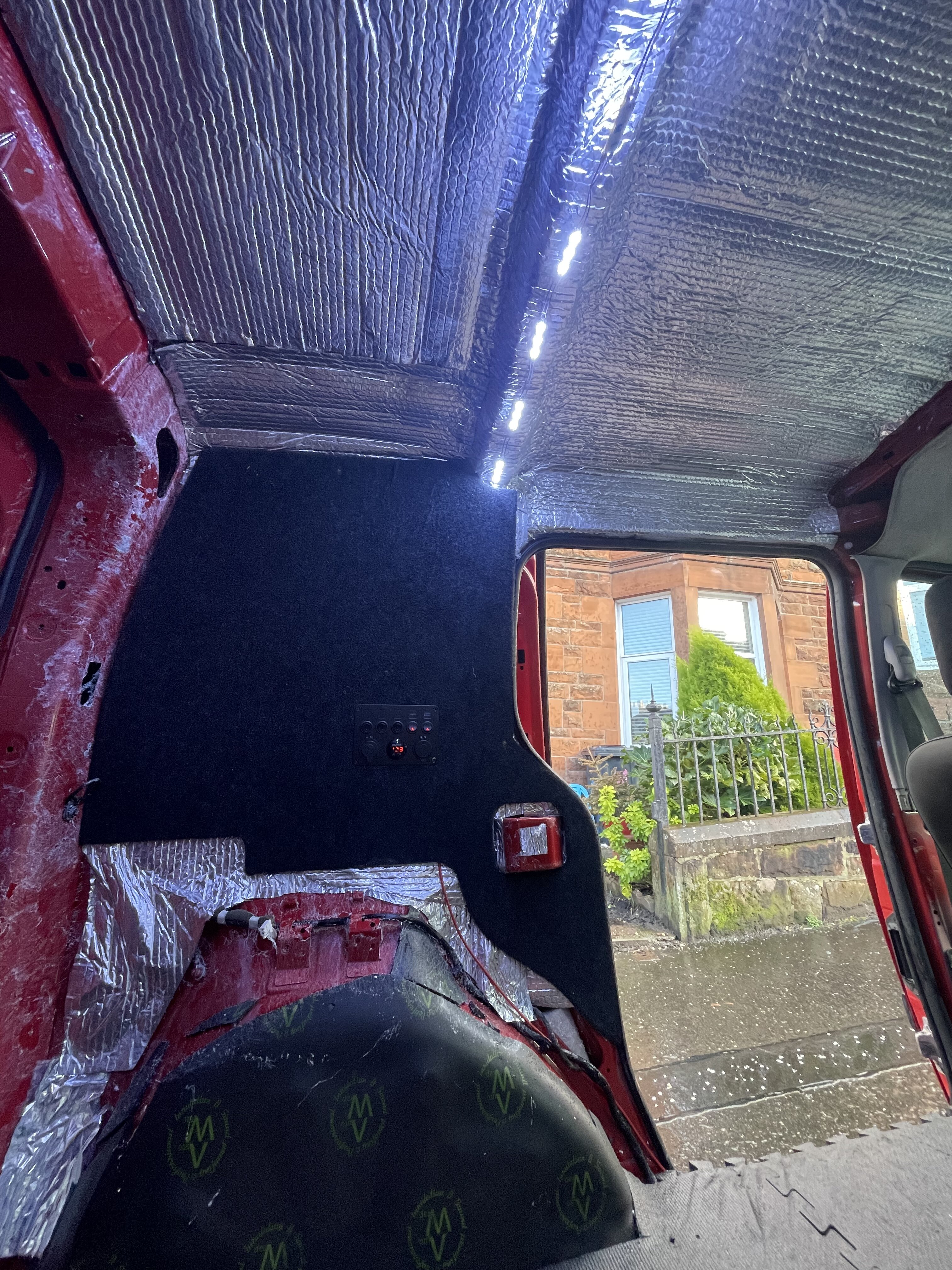

Some Batons screwed in to make a frame, some carpeted 6mm ply on top. Simple stuff reallyWhat are your plans for the roof in the back?

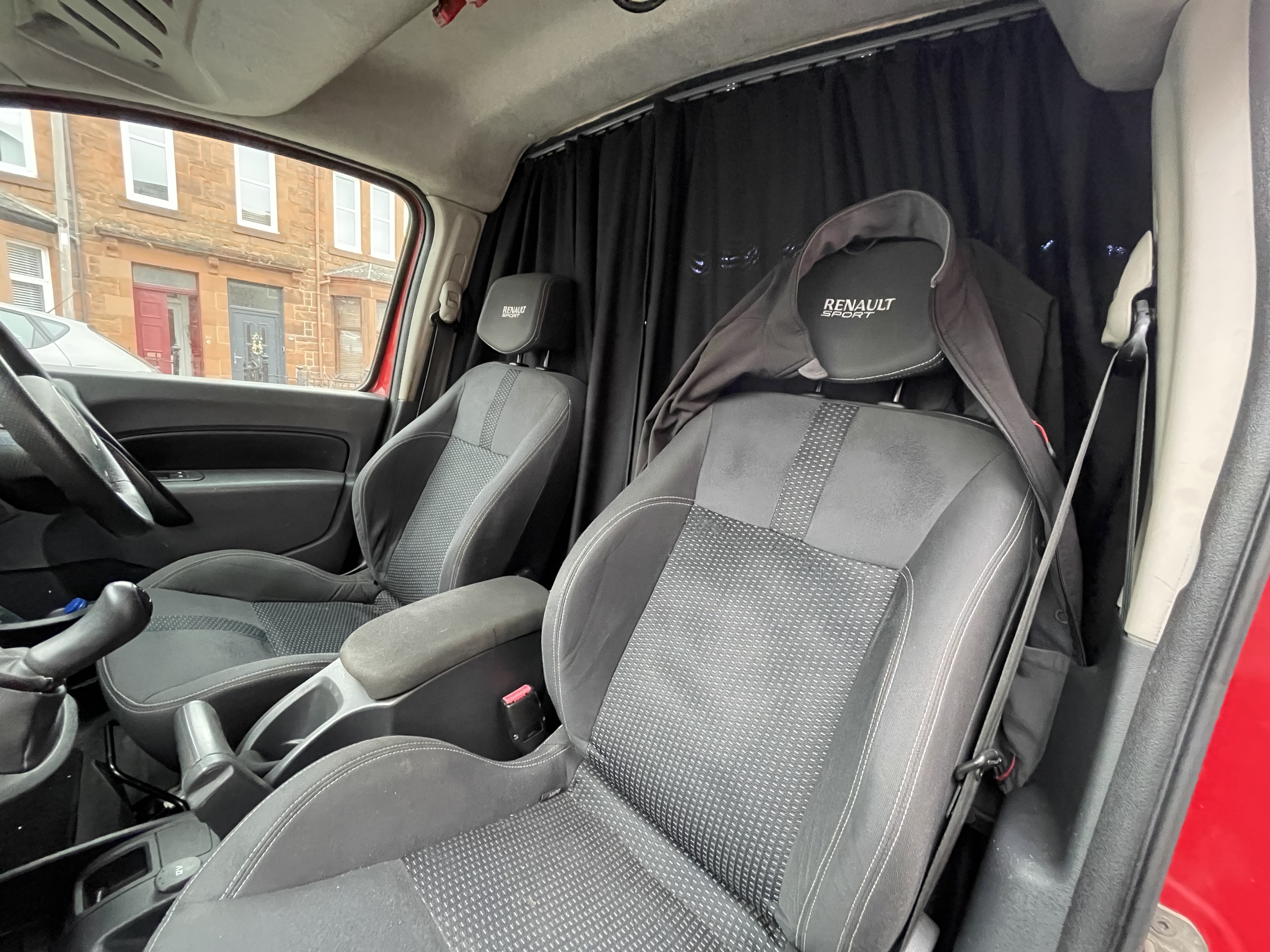

You got a link to the curtain ya gonnna use on the bulkhead ? Been looking for one for mine

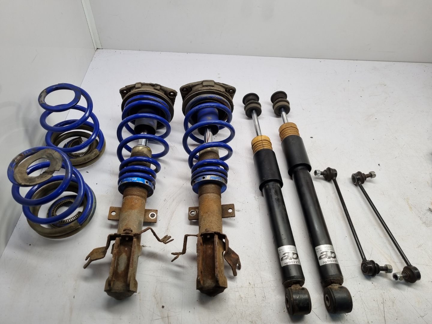

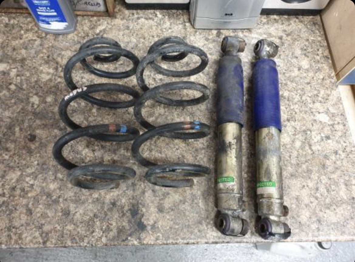

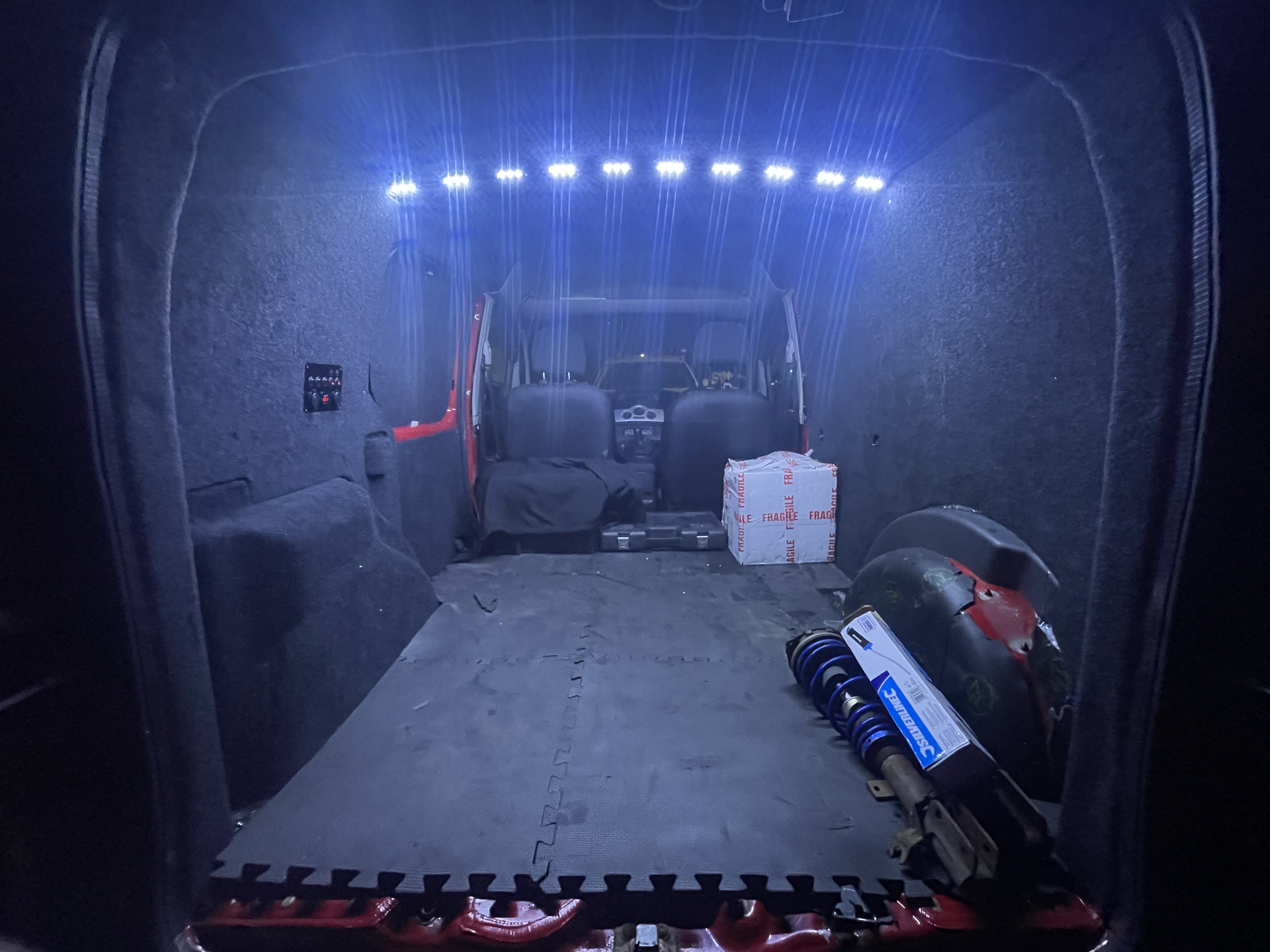

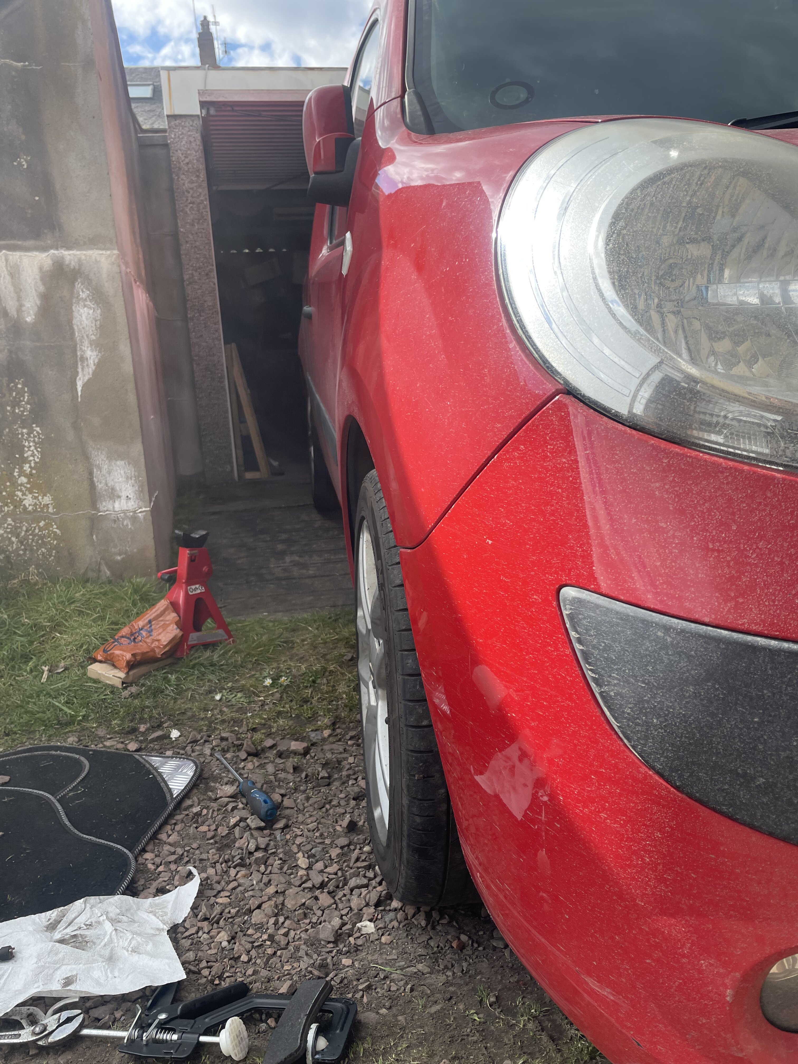

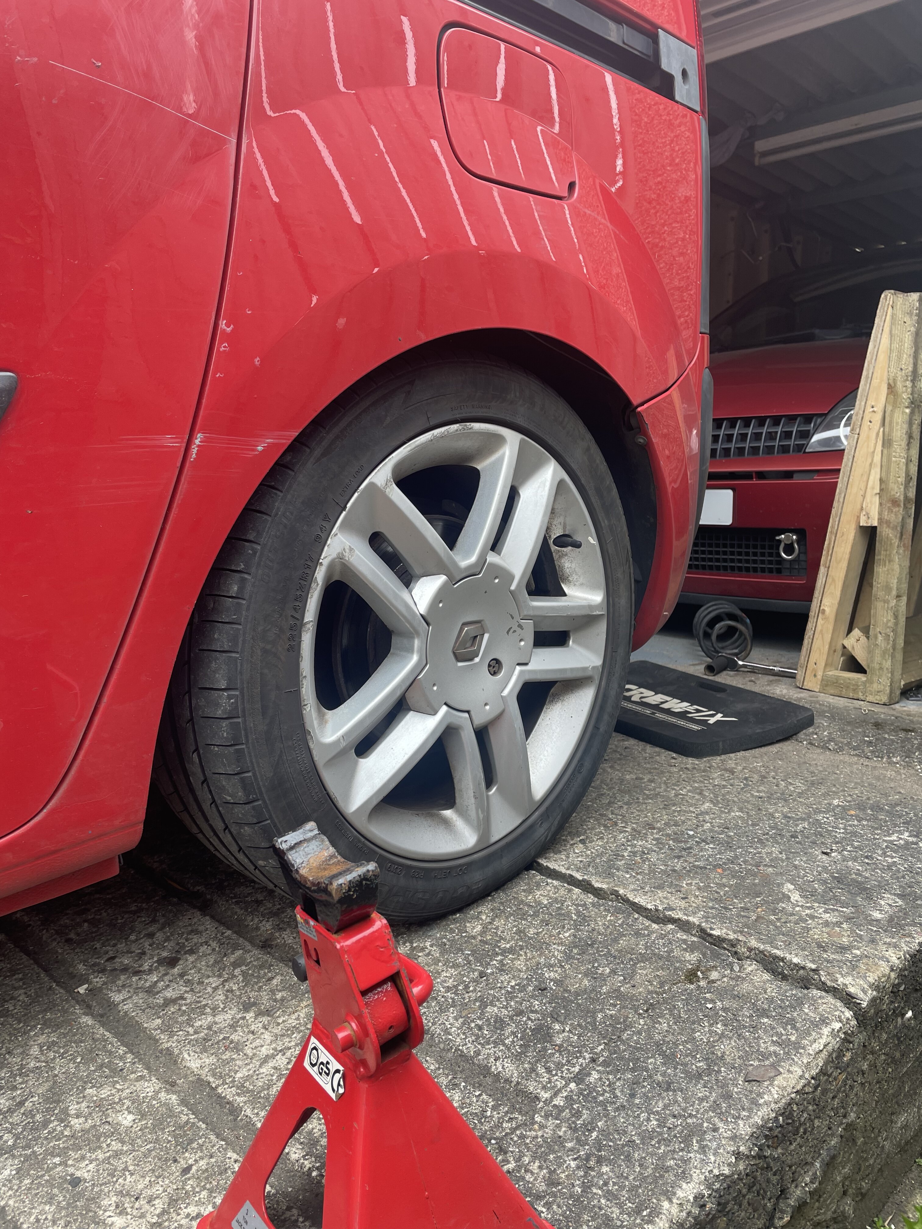

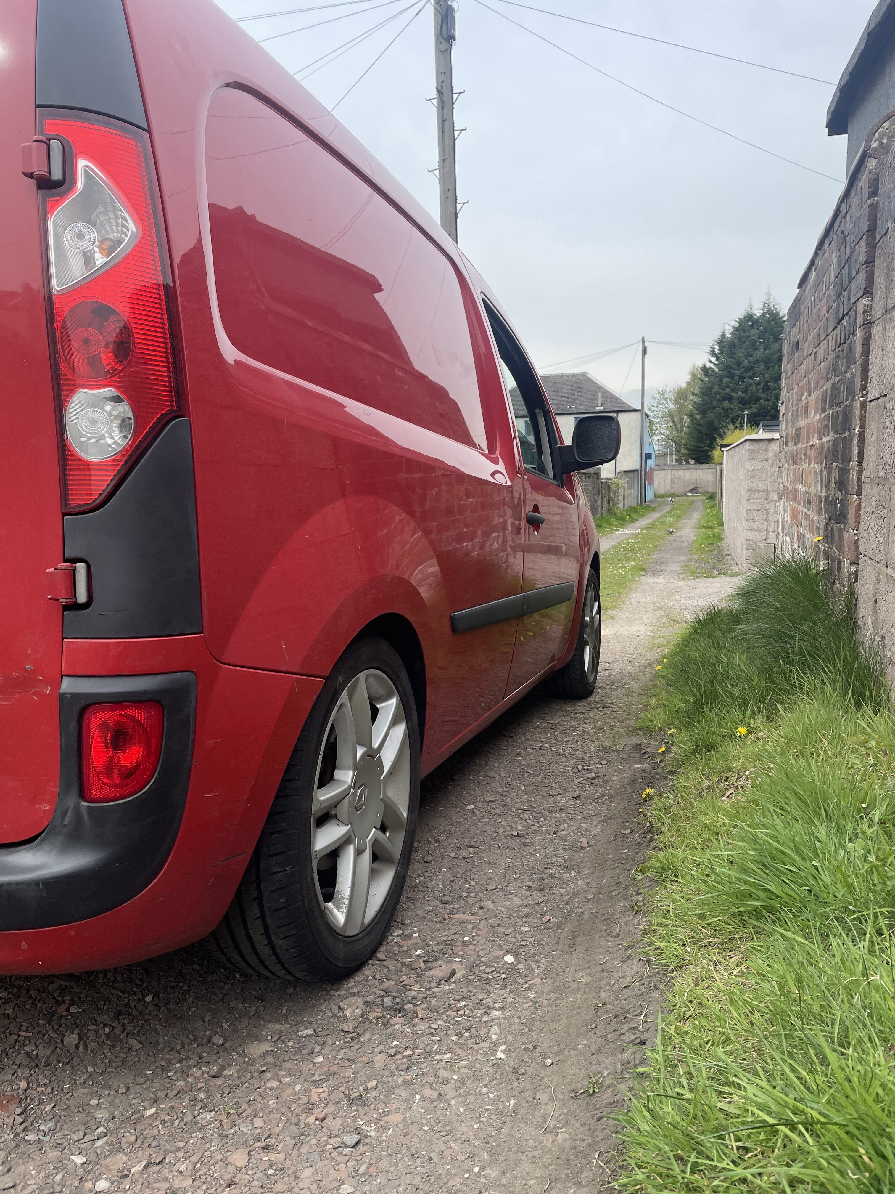

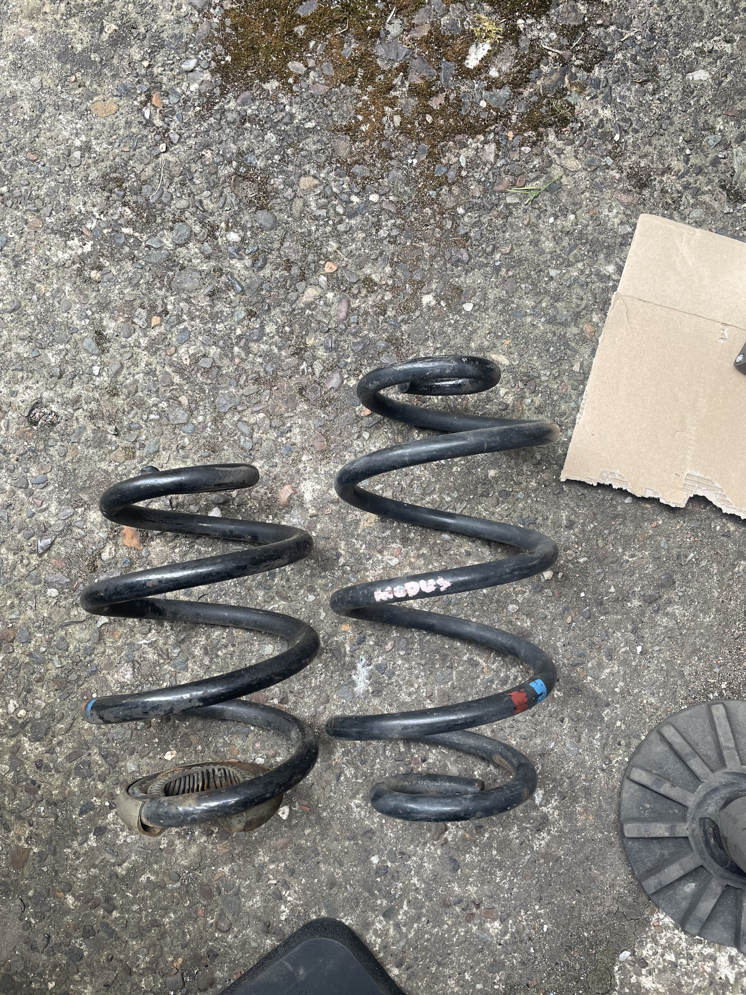

Mk3 non sport clio, top mounts line up and the shock is marginally shorter than stock.@Mcaff What are the non sport coilovers off of, Megane?
Honestly just about melted the nut off the drivers side taking the heat to it!Looks spot on. I should have advised you that the top rear shock bolts corrode into the tube. Mine were a b*****d initially, i just worked them forward and backwards with the impact gun to break the corrosion.
Ive used pms megane 225 10mm spacers on mine before i got the lower et wheels. Megane 250 bolts or generic bolts off ebay will work, or of your feeling posh 12mm stud and nut kit to suit.

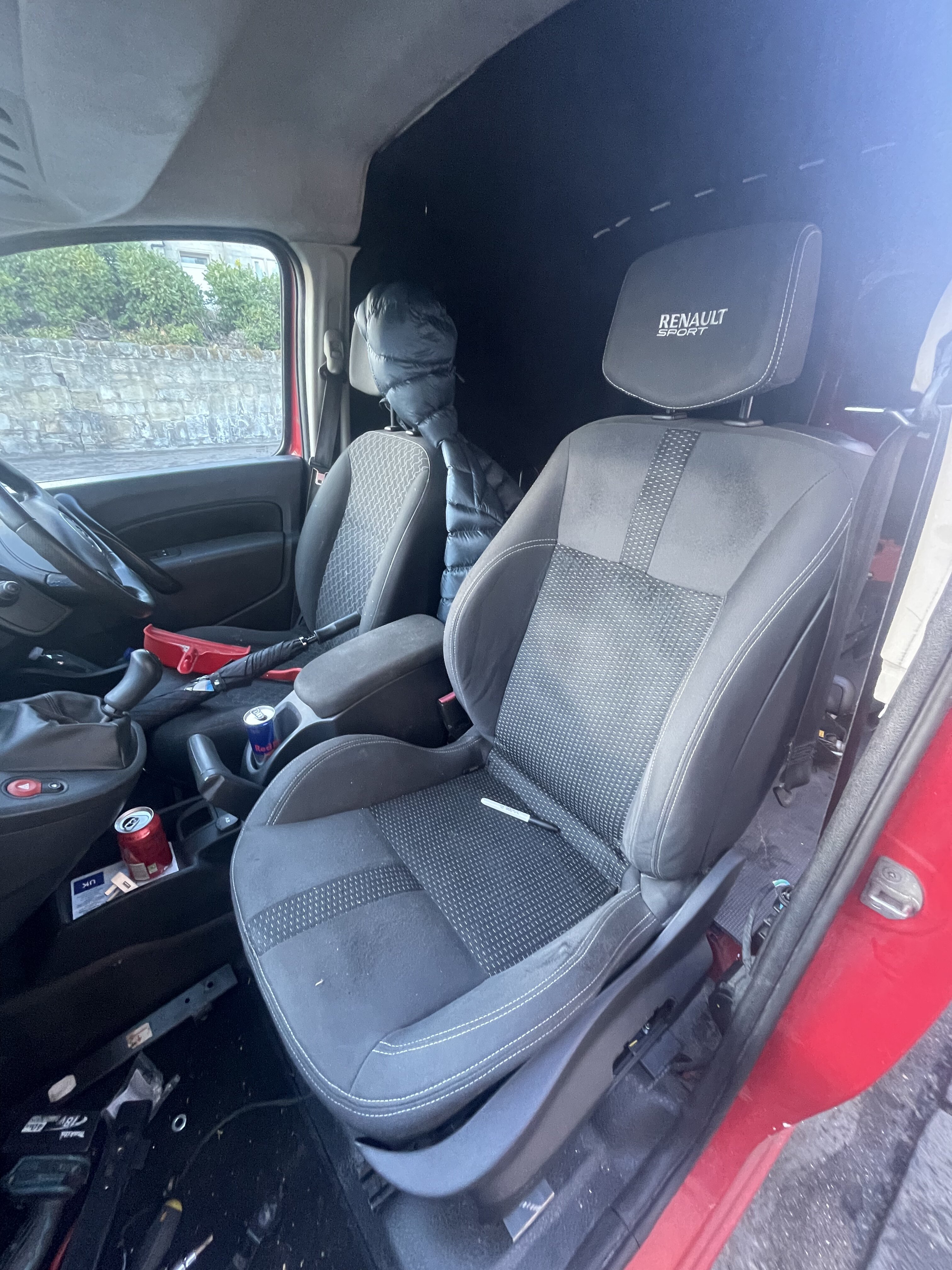

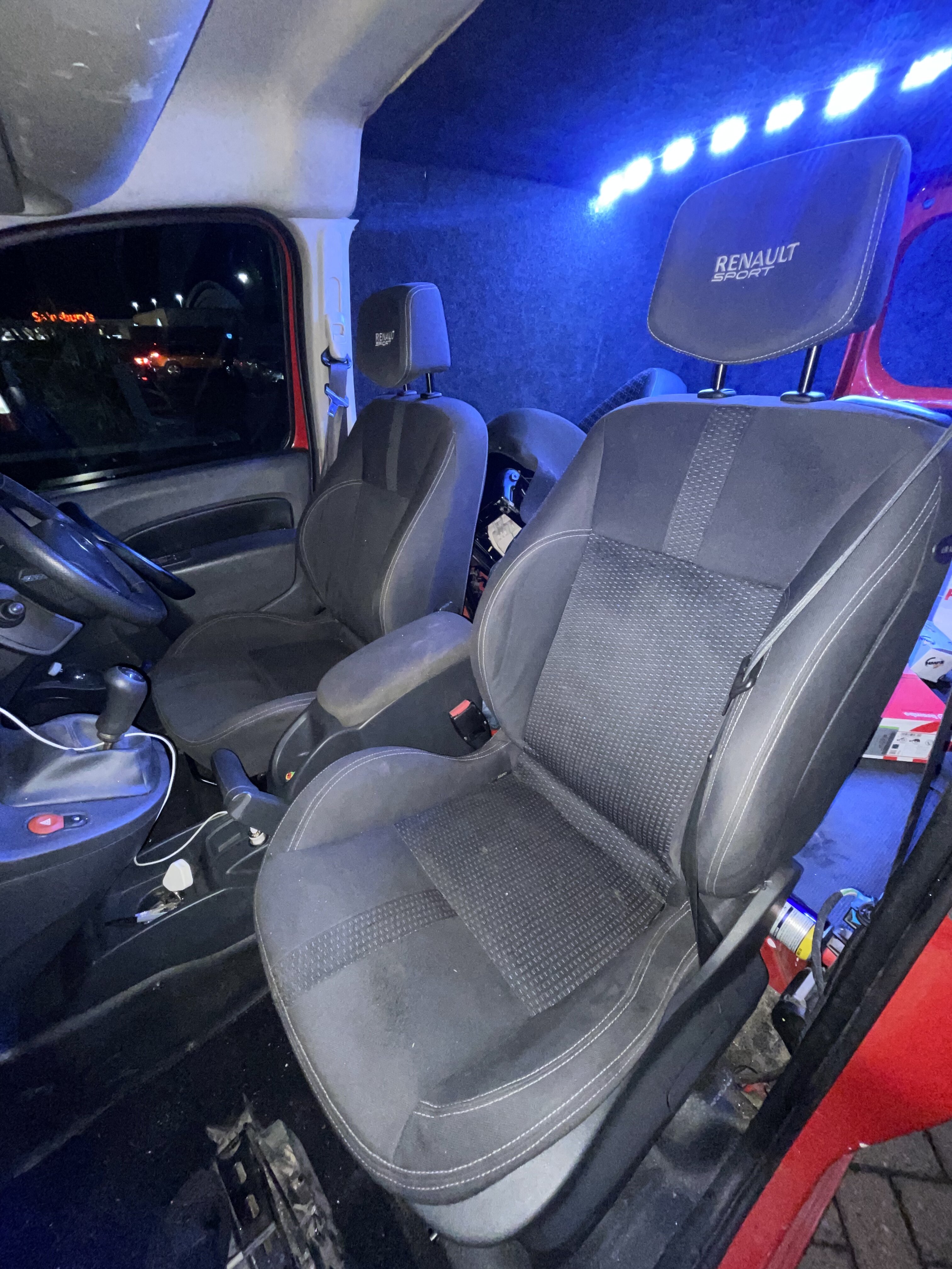

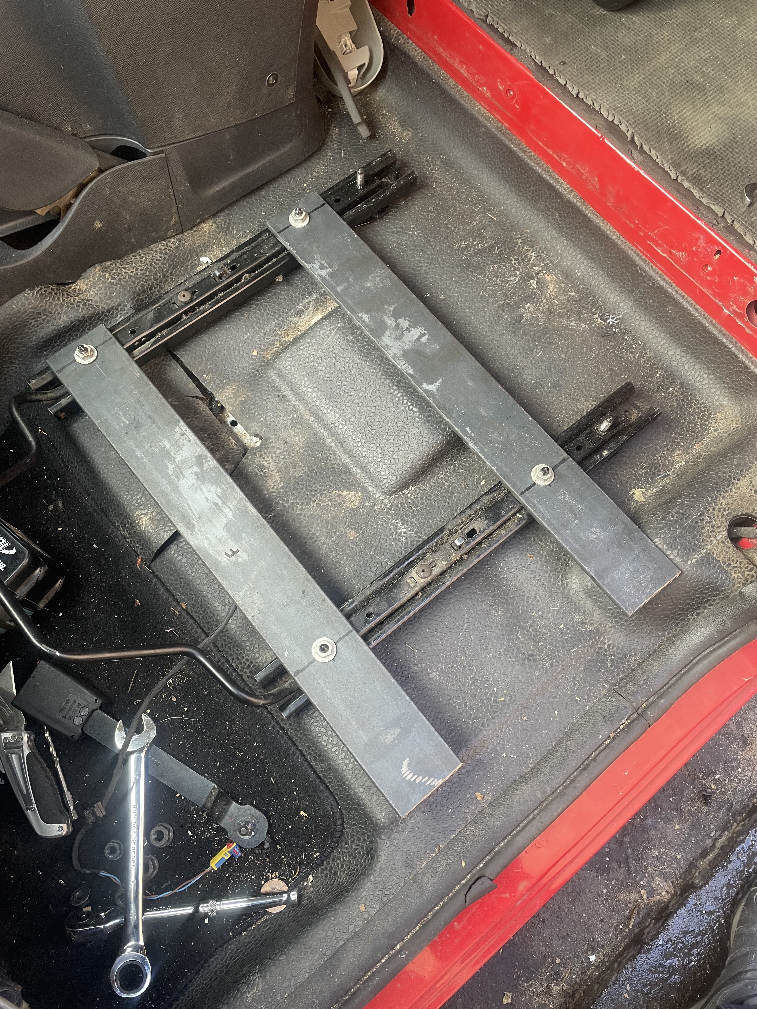

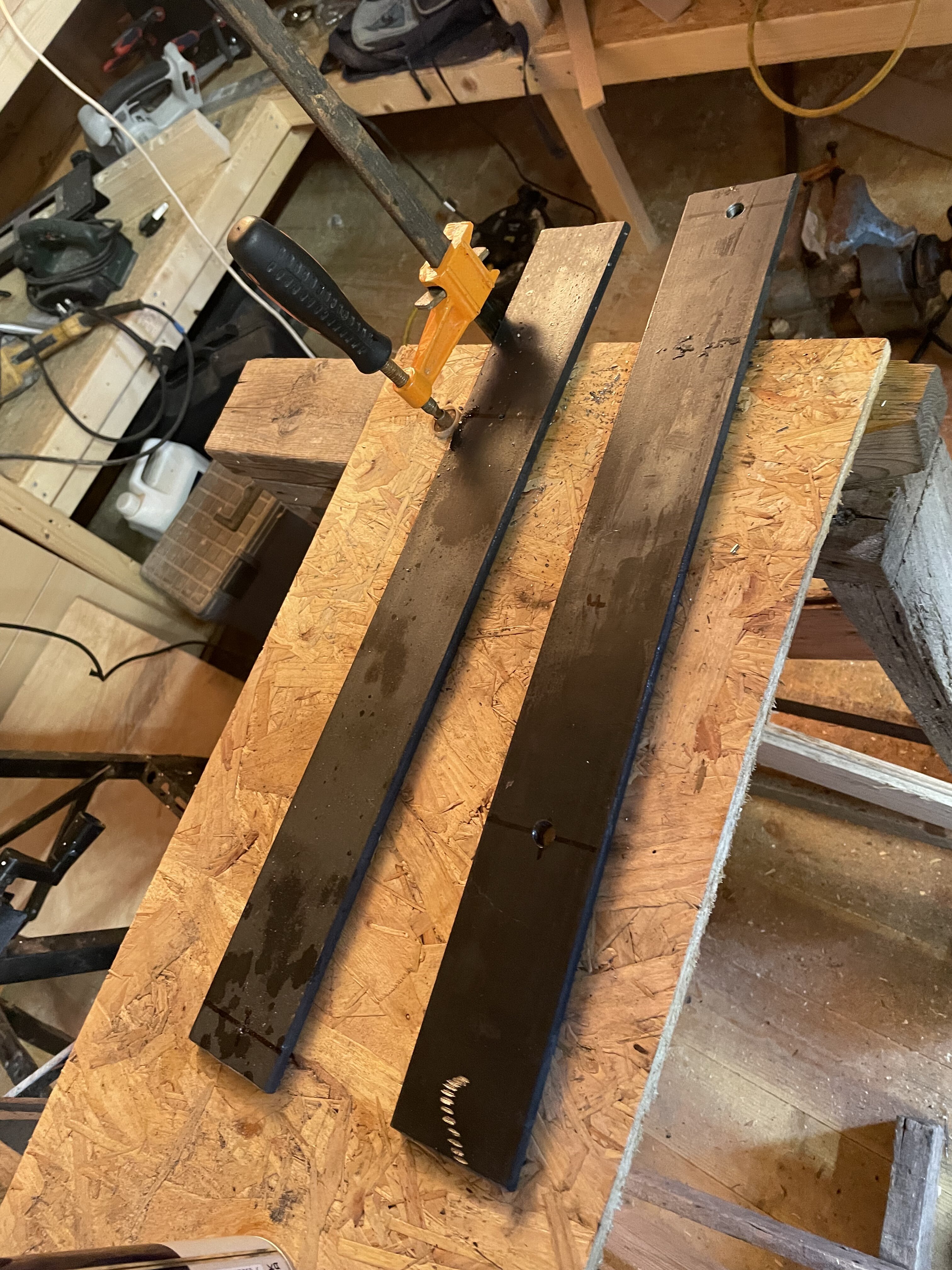

Yeah steel flat bar.Steel flat bar I'm assuming? Glad you posted this as my seats have been sitting in the shed for a year now as I couldn't figure out how to attach the seatbelt to the seatI need to get and do mine now I've seen these and how it's done...
Both are dead easy to separate from the bases, mix of 13mm and 17mm nuts im sure 6 of them.Perhaps I was being daft the last time I looked but couldn't figure out how to get the rail off the base but that was last summer I last looked at it. I don't mind the driving height but a little lower would be nice except I think I will struggle as I have the bulk head in and the current seats are right up against them, sitting lower should in theory mean your feet are closer to the pedals if you get what I mean? I will just get the seats out over the weekend and have a good look at them.
Why did you opt for 5mm steel? The only reason for asking is with some bases and harness attachments they use 3mm steel, each mm saved means sitting lower in the car![]()
Always helps, just scouting around the shopfloor for something suitable myselfThe short answer is the steel was free 😂 but 2mm is a thick bawhair really!

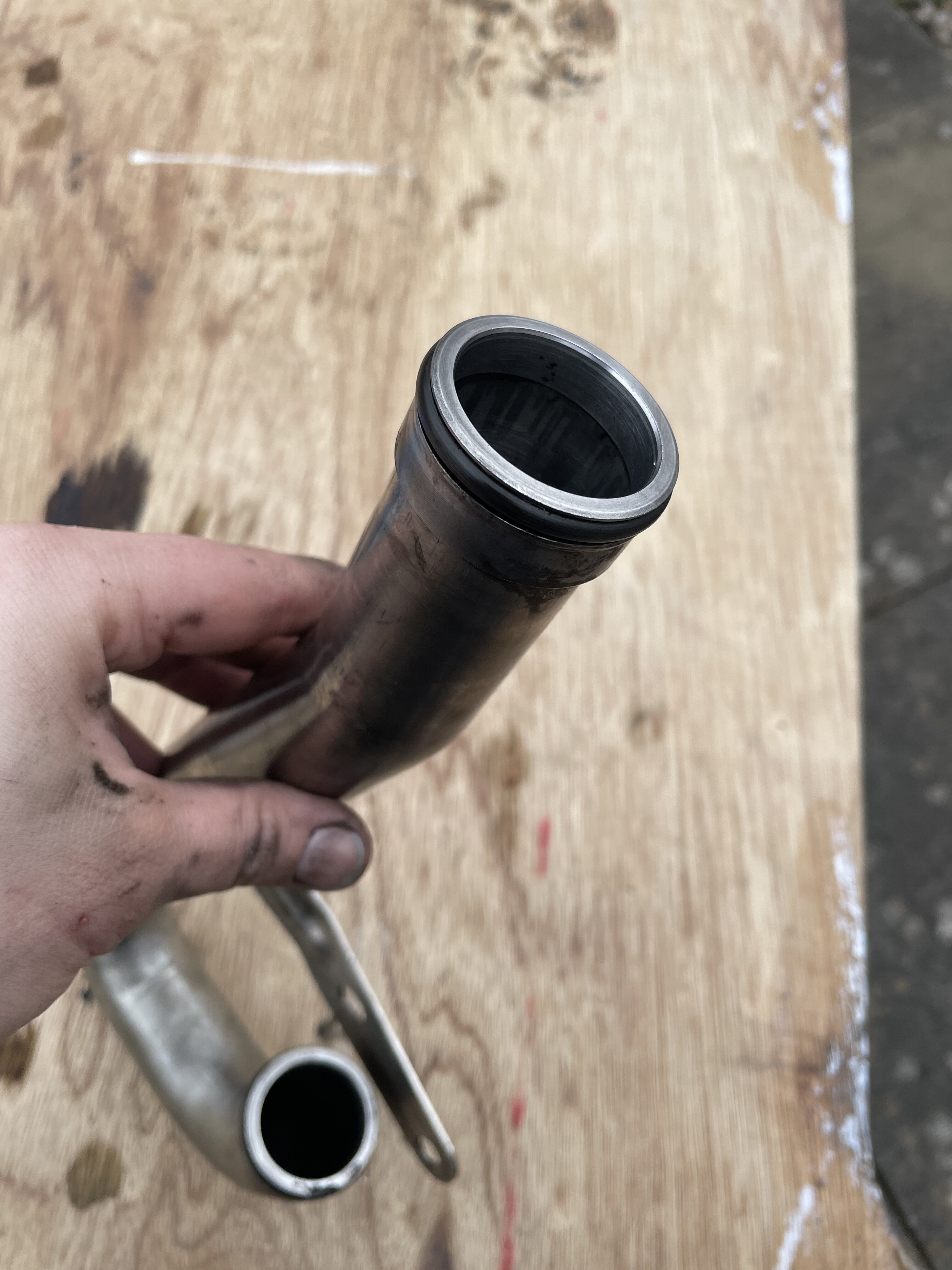

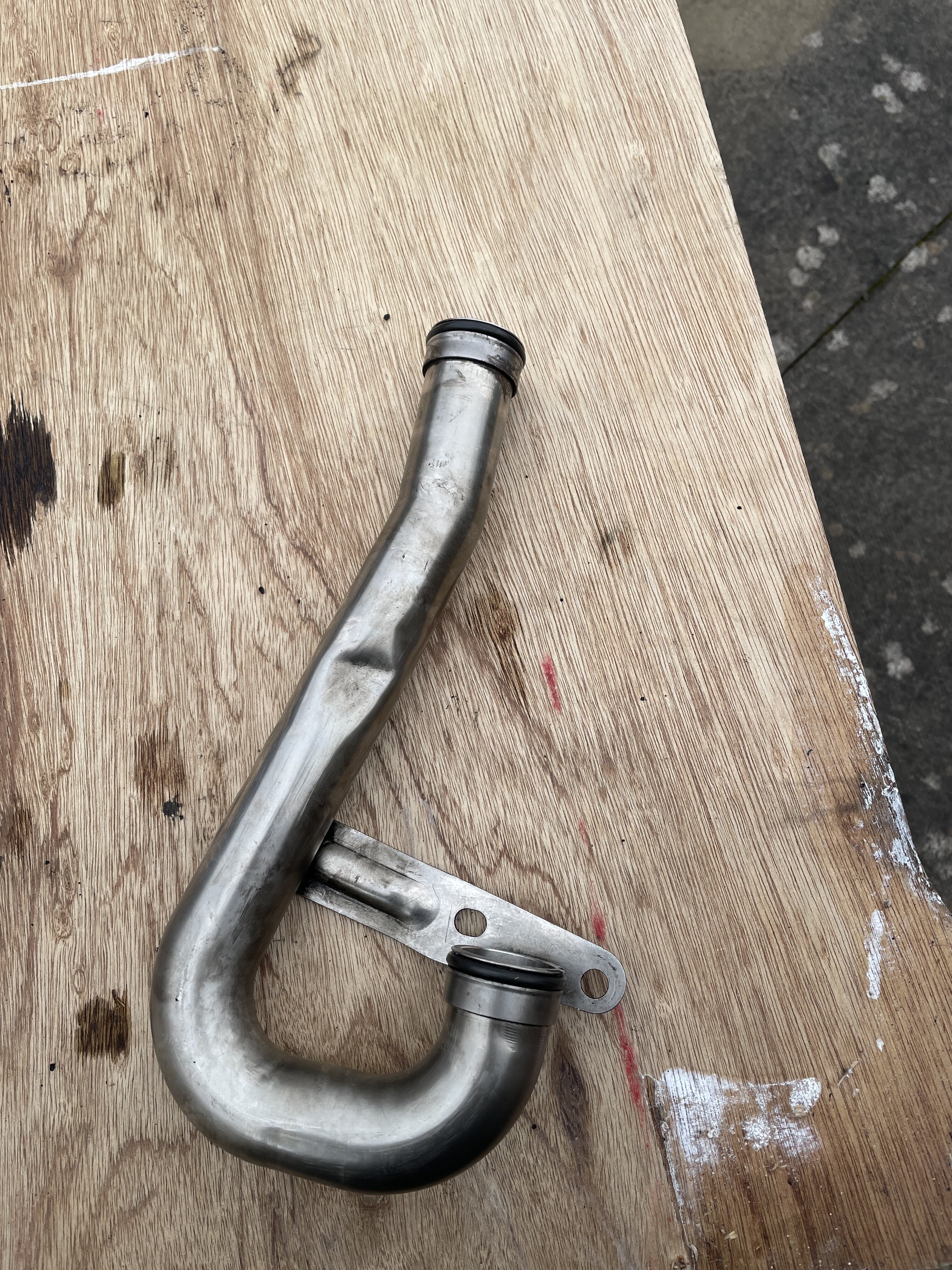

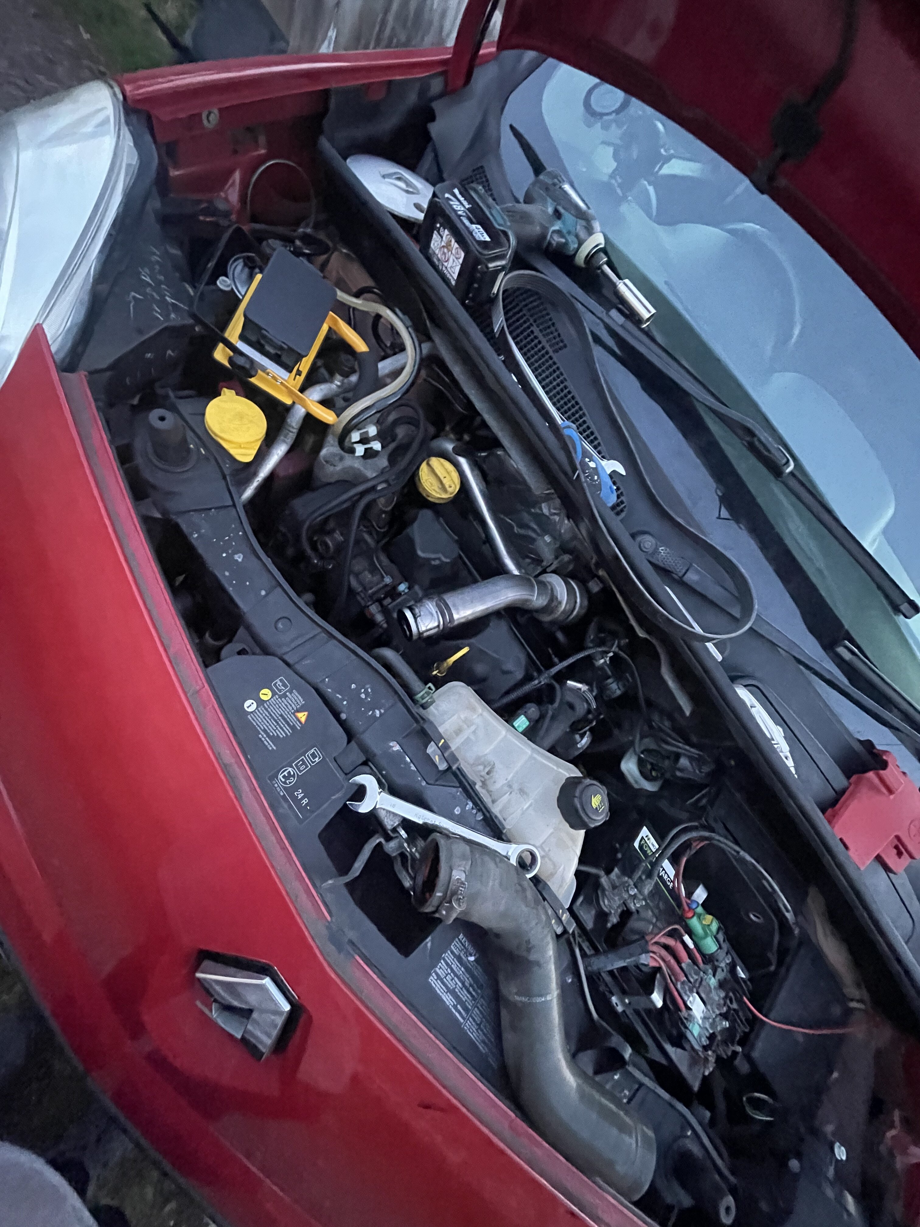

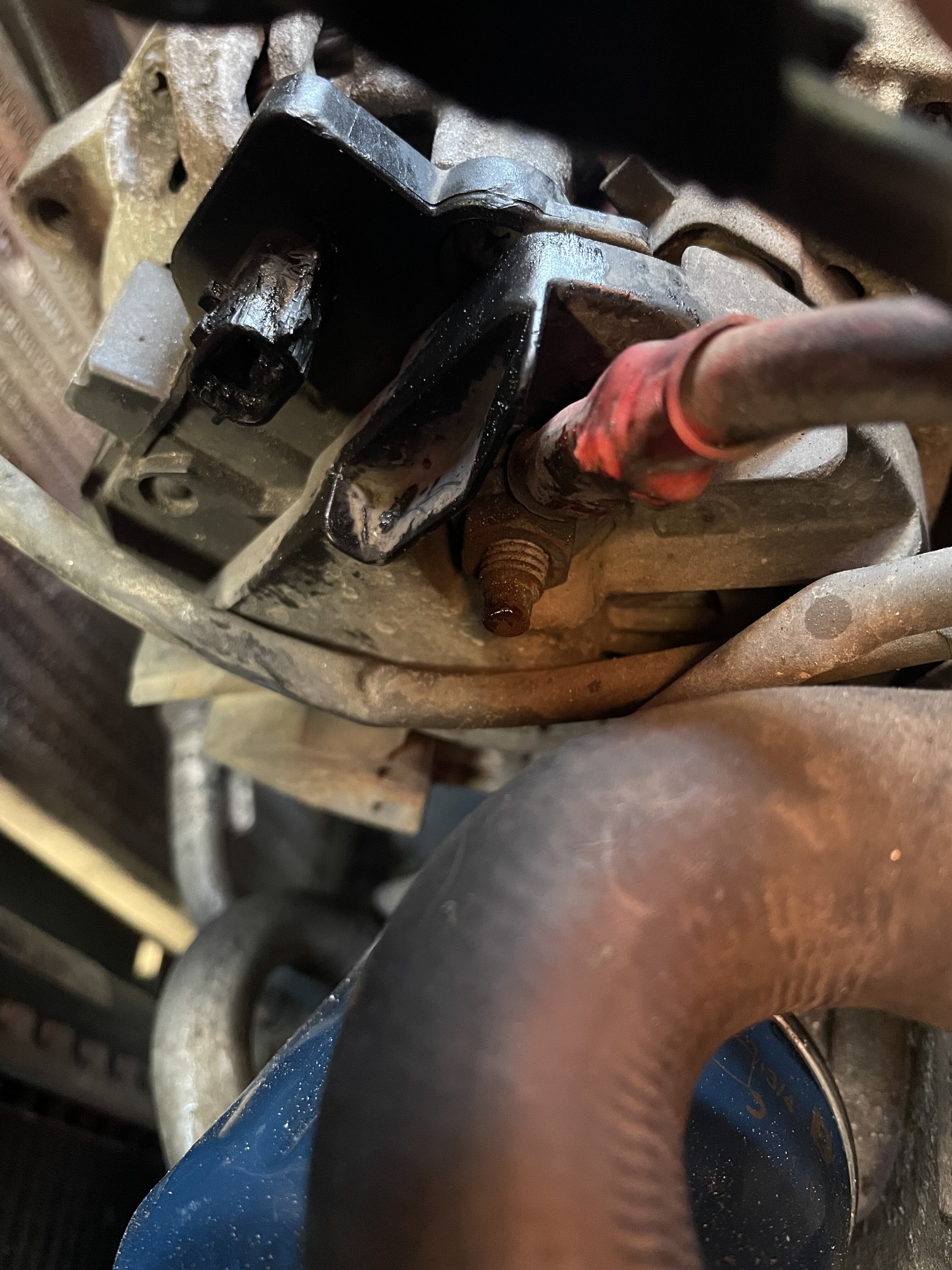

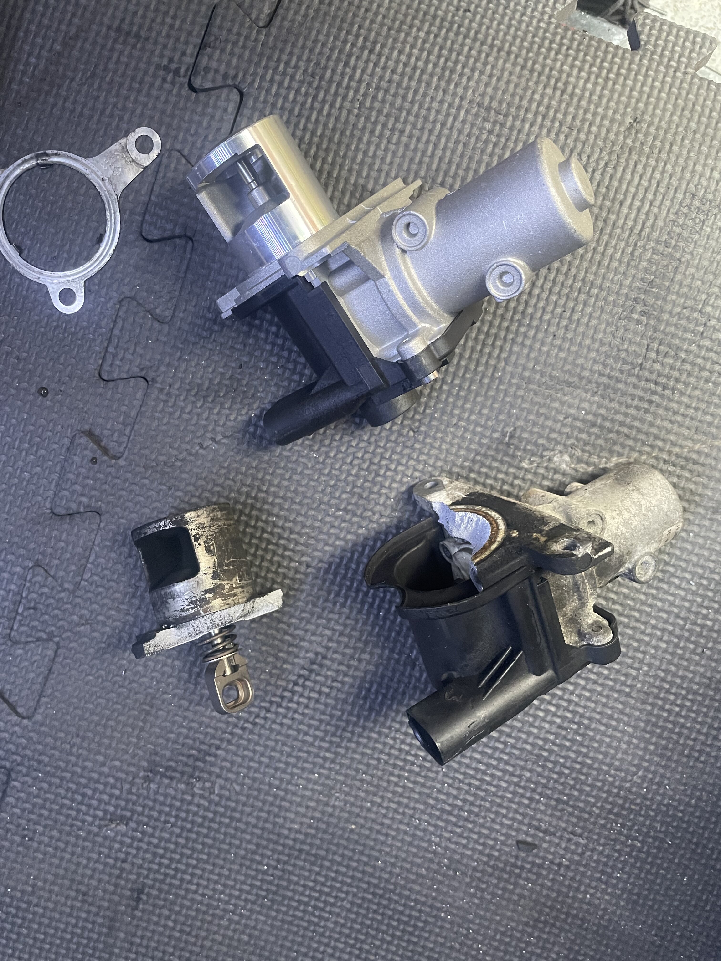

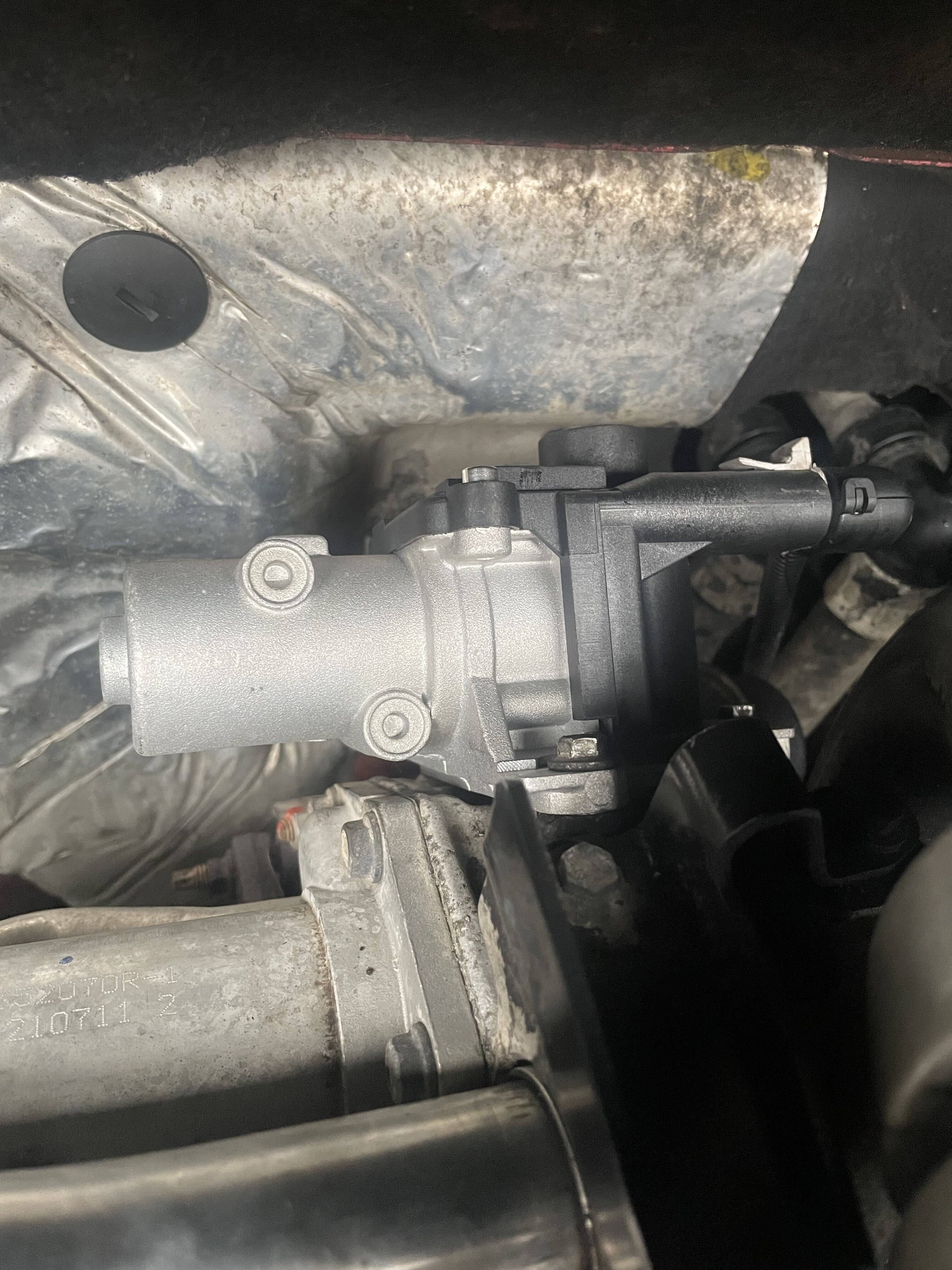

Pretty easy to access. I think it comes on Wednesday so will fit it then.Pics of the new EGR going on would be niceAnother thing on the list of things to do on mine
It’s very good access on these no need to take that off unless you’re doing suspension bits really.I've done VWs before using the mr muscle (other oven cleaners are available) letting it soak and then getting the pressure washer out and flushing it out. Usually aiming the exit at next doors garage and coating it with black s###
Did you remove the wiper and scuttle to get better access or pretty doable without removing it?
