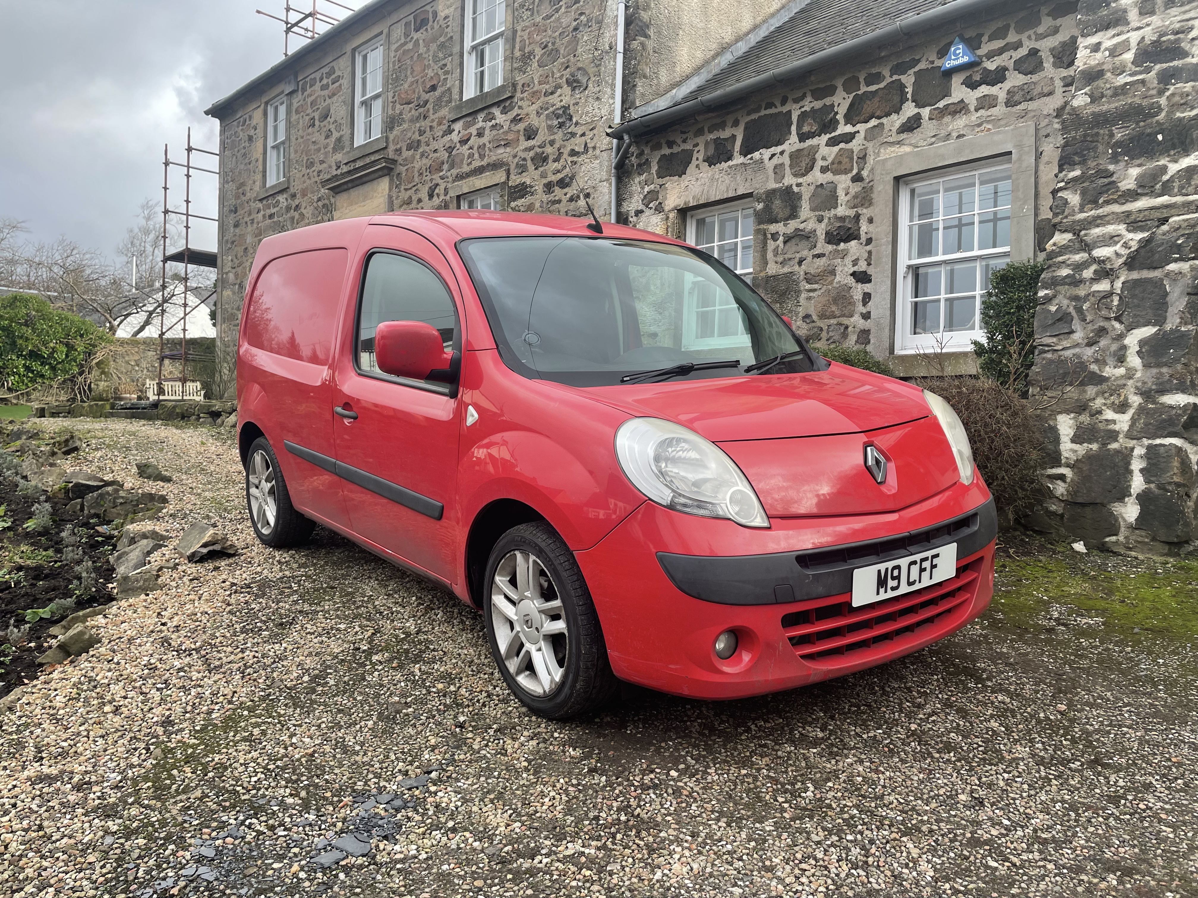

Fancied a daily diesel and sold my Laguna so the search for a wee van was on. After seeing a few dogs local that needed too much work I found this on Facebook marketplace in Leeds. Knowing it would probably need a bit of work as it was fairly cheap and higher miles I took the trip down last Sunday and picked it up.
The van made it home with a few issues, had to add oil at a service station and it seemed a bit choked up coming up the road, although that might be the fact I’m used to Renaults with a tad more power.

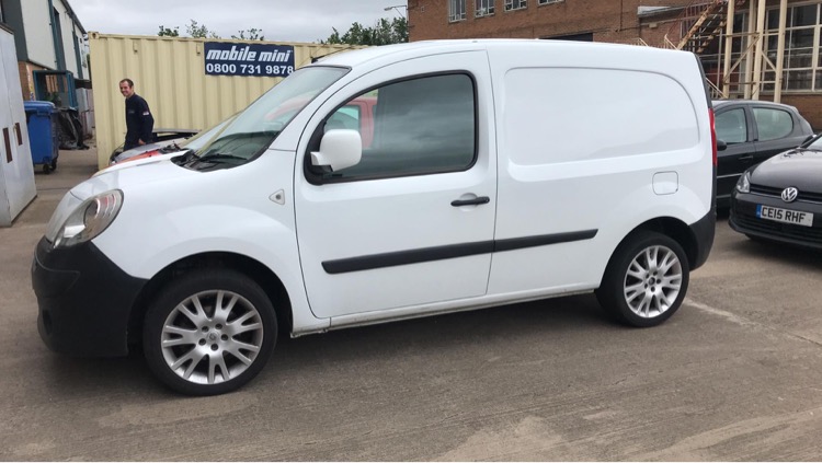

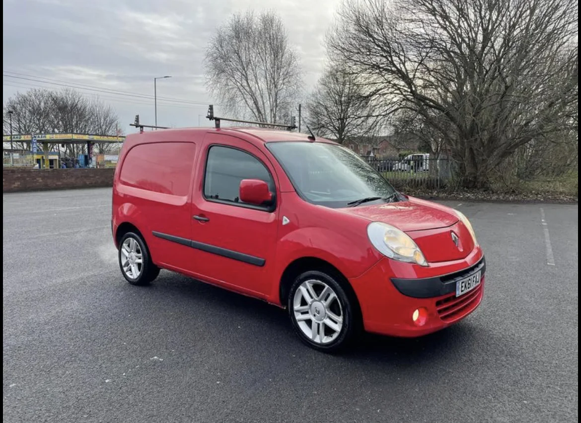

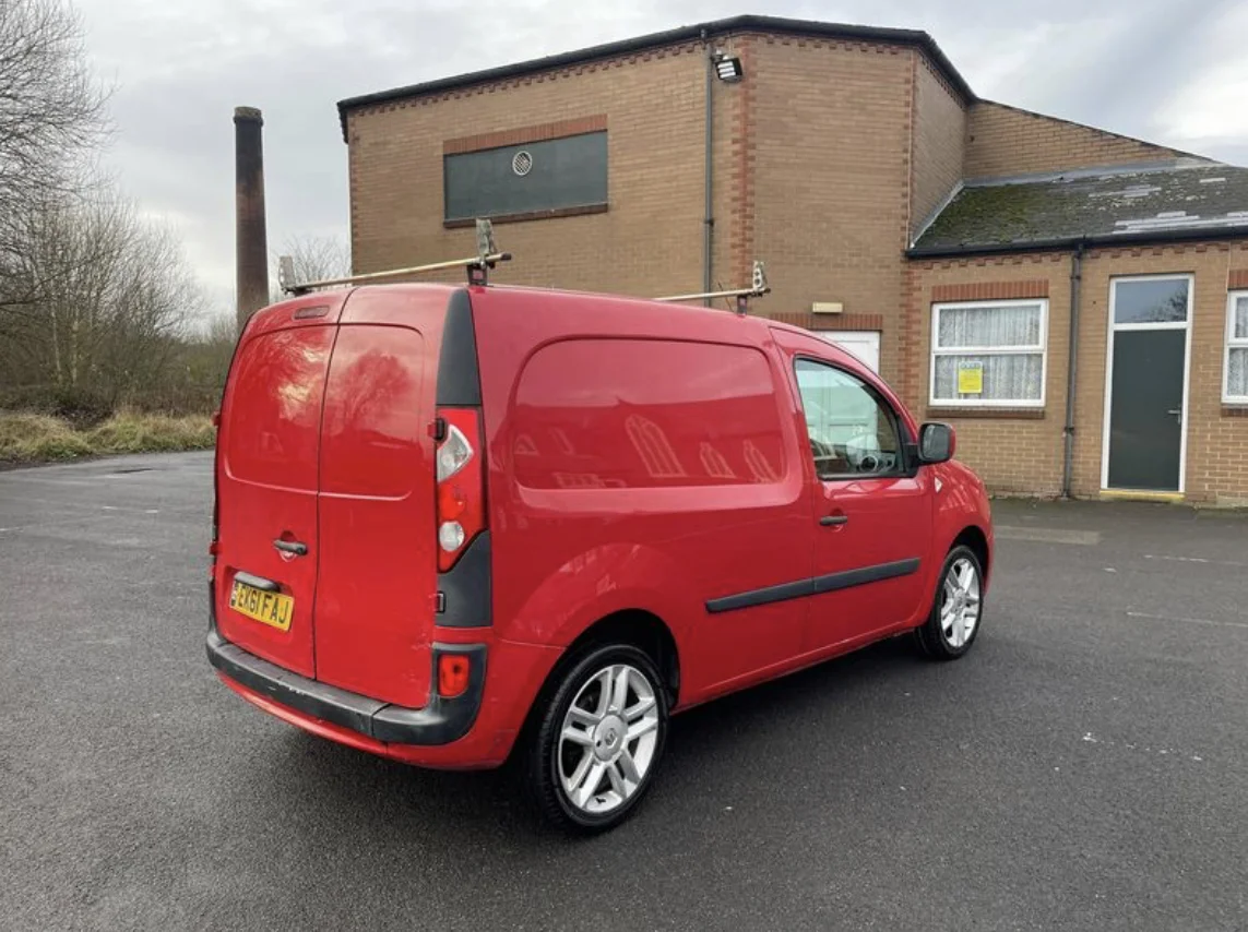

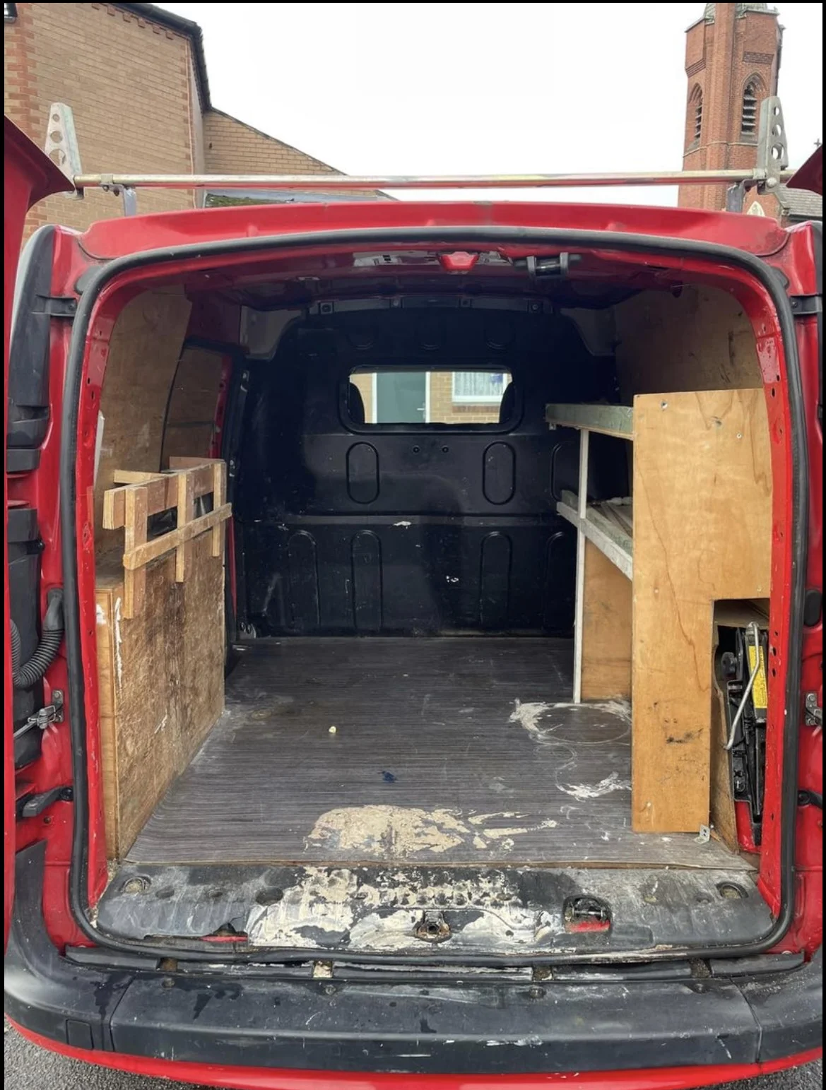

Some pictures from the advert:

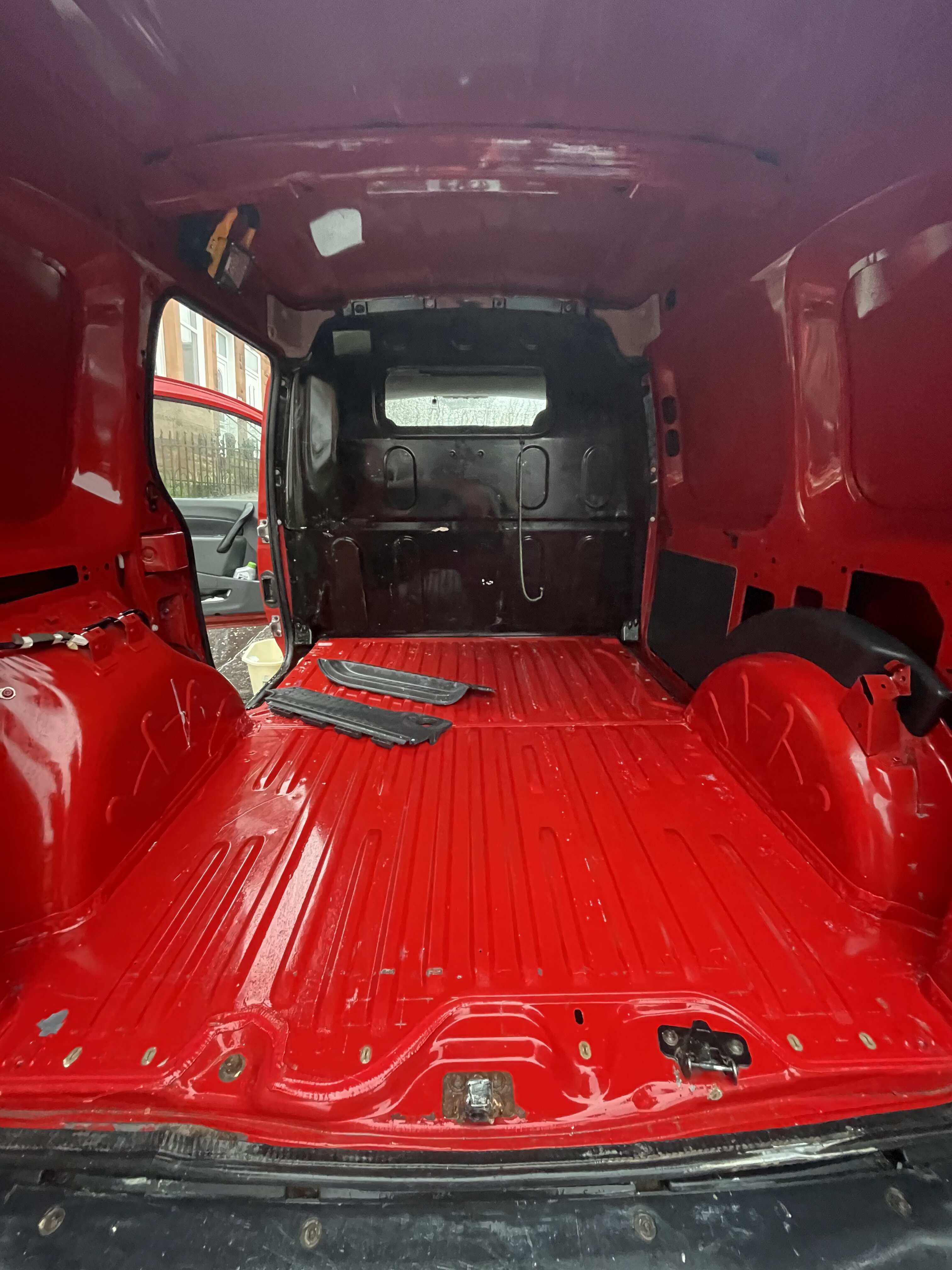

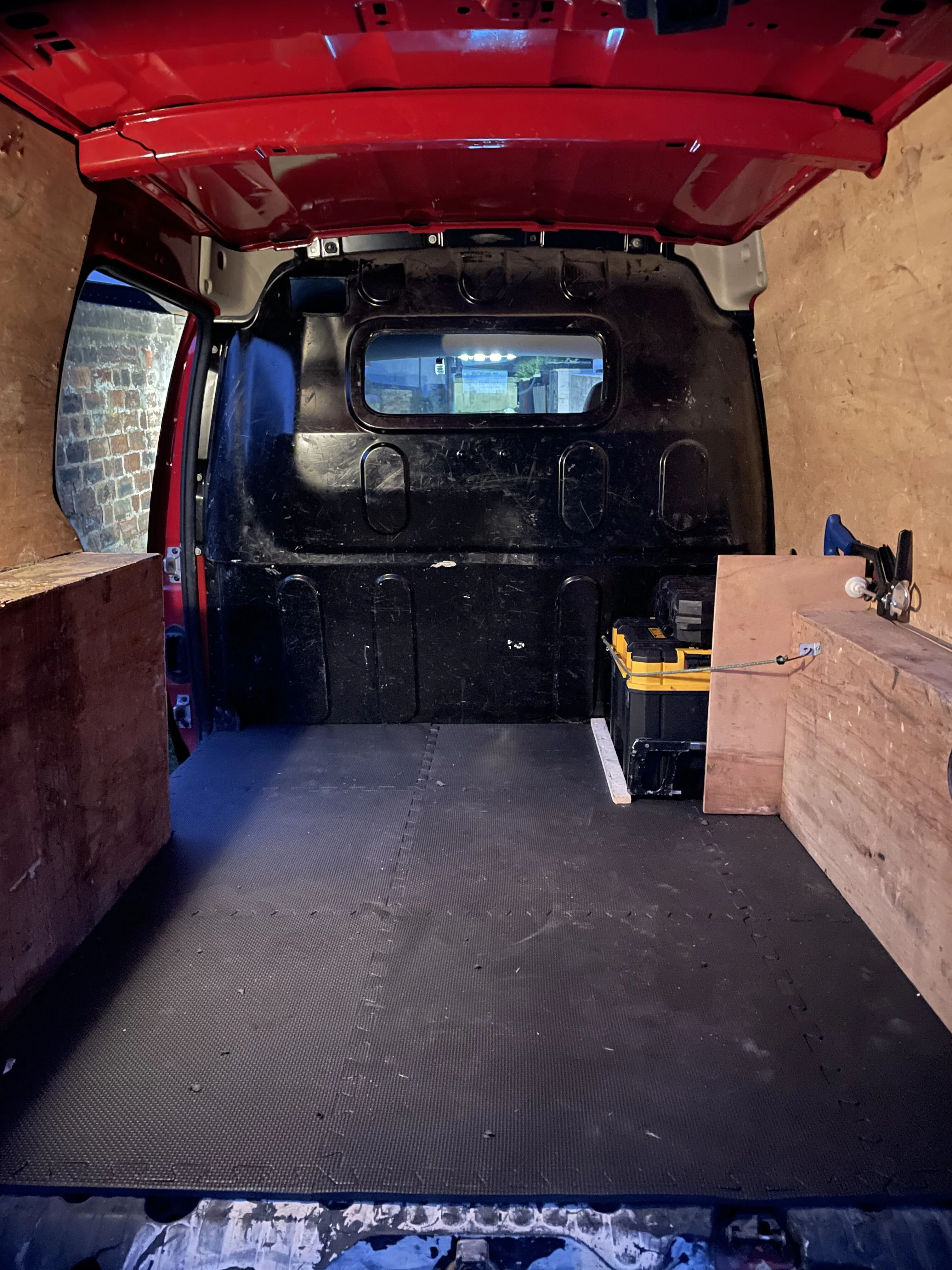

Now it’s home I’ve ripped all the shelves out the rear, pulled the flooring up and laid foam tiles.
The van was stinking of turps so I’ve since cleaned out the front and set off a McGuire’s smoke bomb so it’s now smelling fresh. Although I’ve not taken any pictures inside, I’ve added new mats and wipers to it.

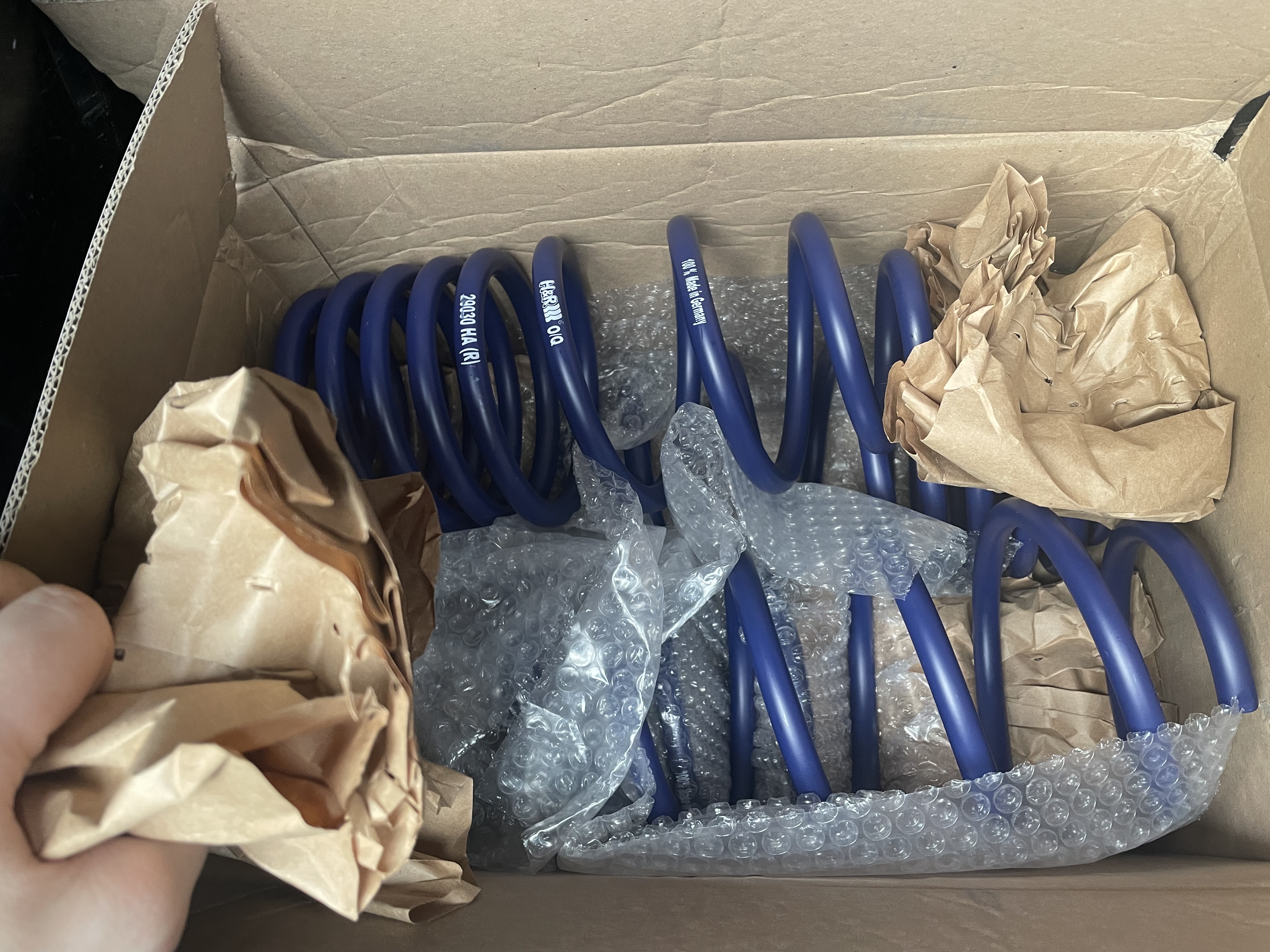

I bought a full set on eBay, that seemed the cheapest place to get them. I think they where £150 but I think they still have import tax to be billed at customs.
From reading brigsys thread modus springs off the top of my head are 25mm shorter, but you need the shorter shocks of they will fall out.

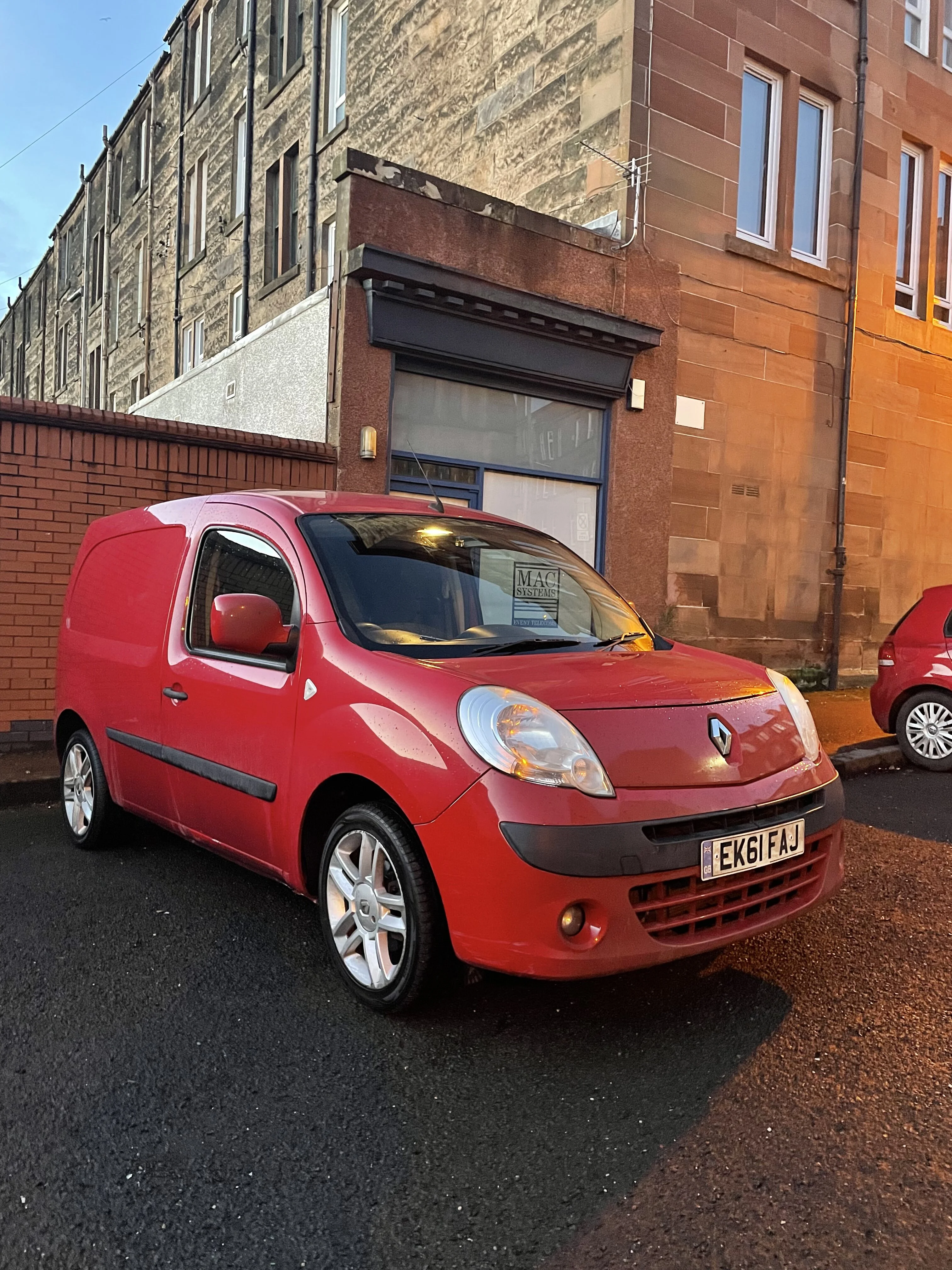

Have also put my plate on:

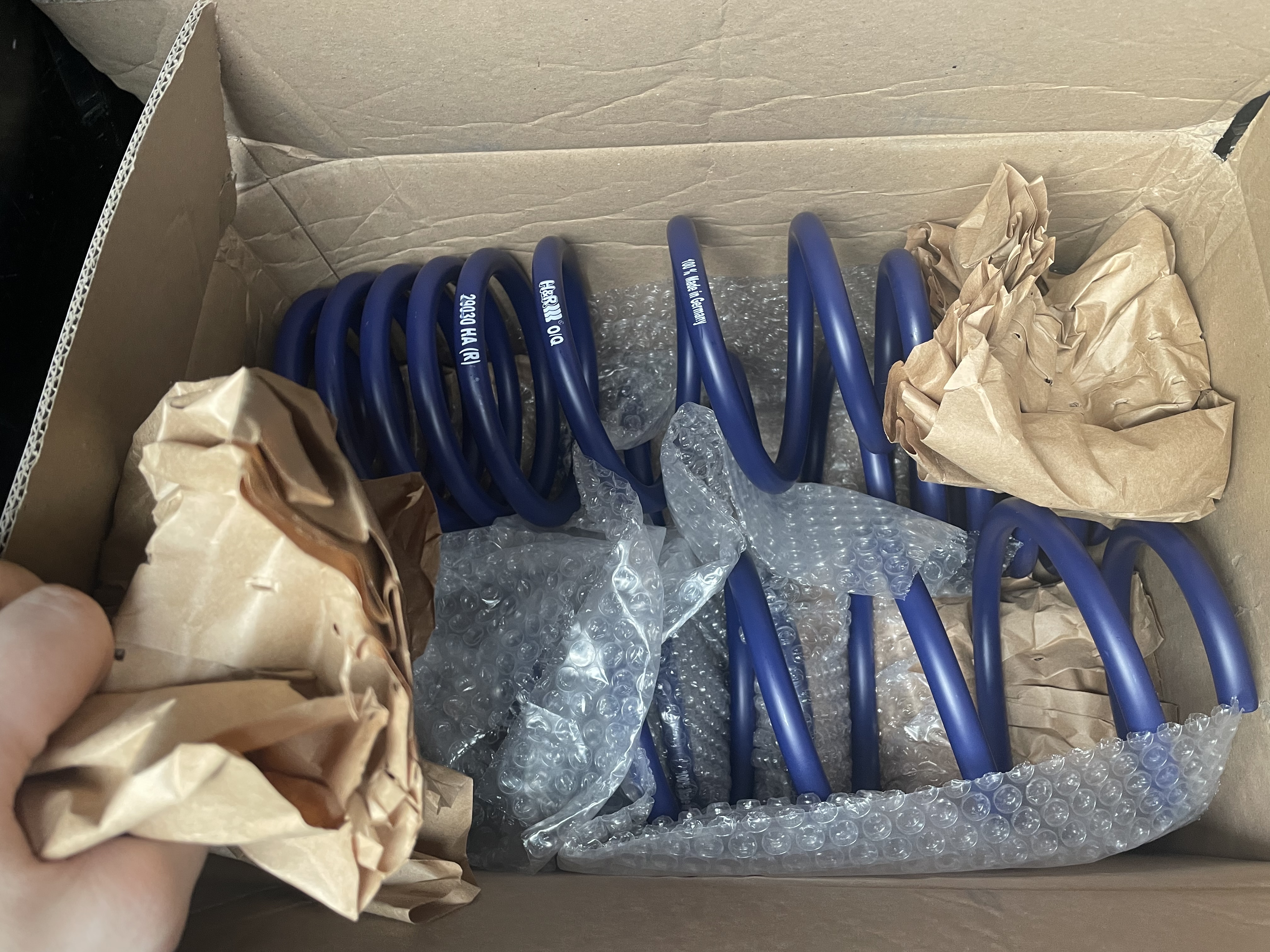

H&R springs have been delivered:

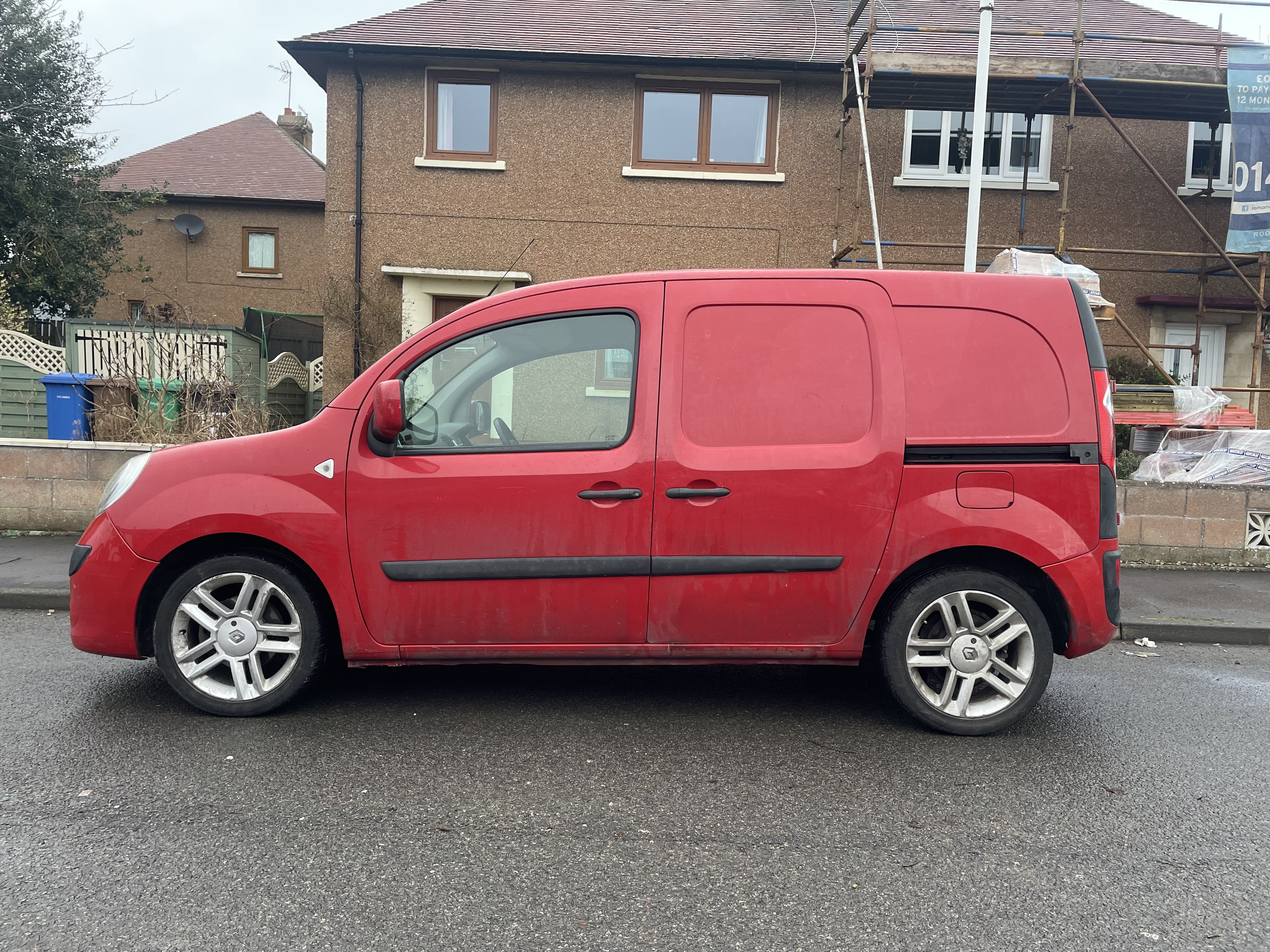

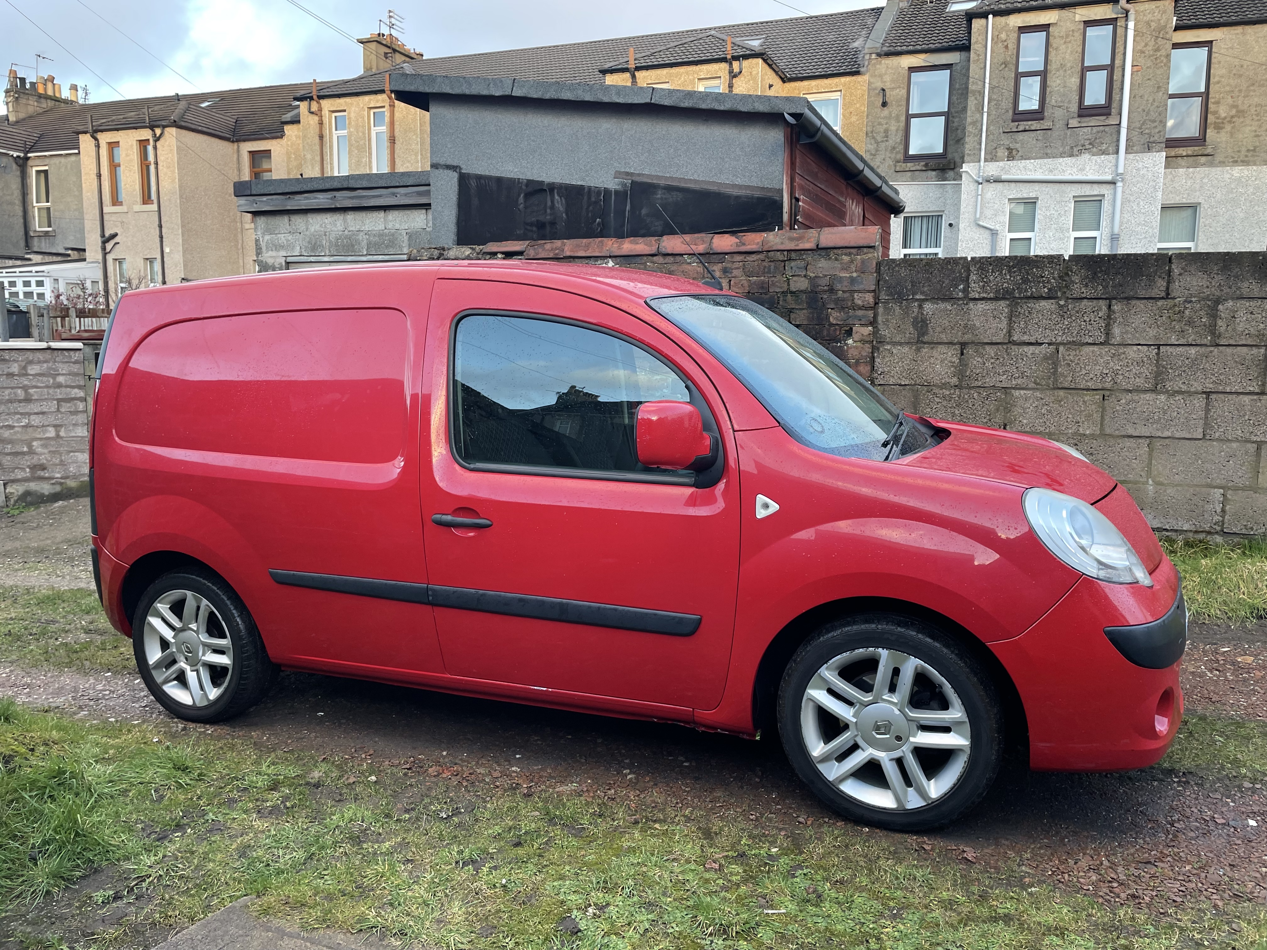

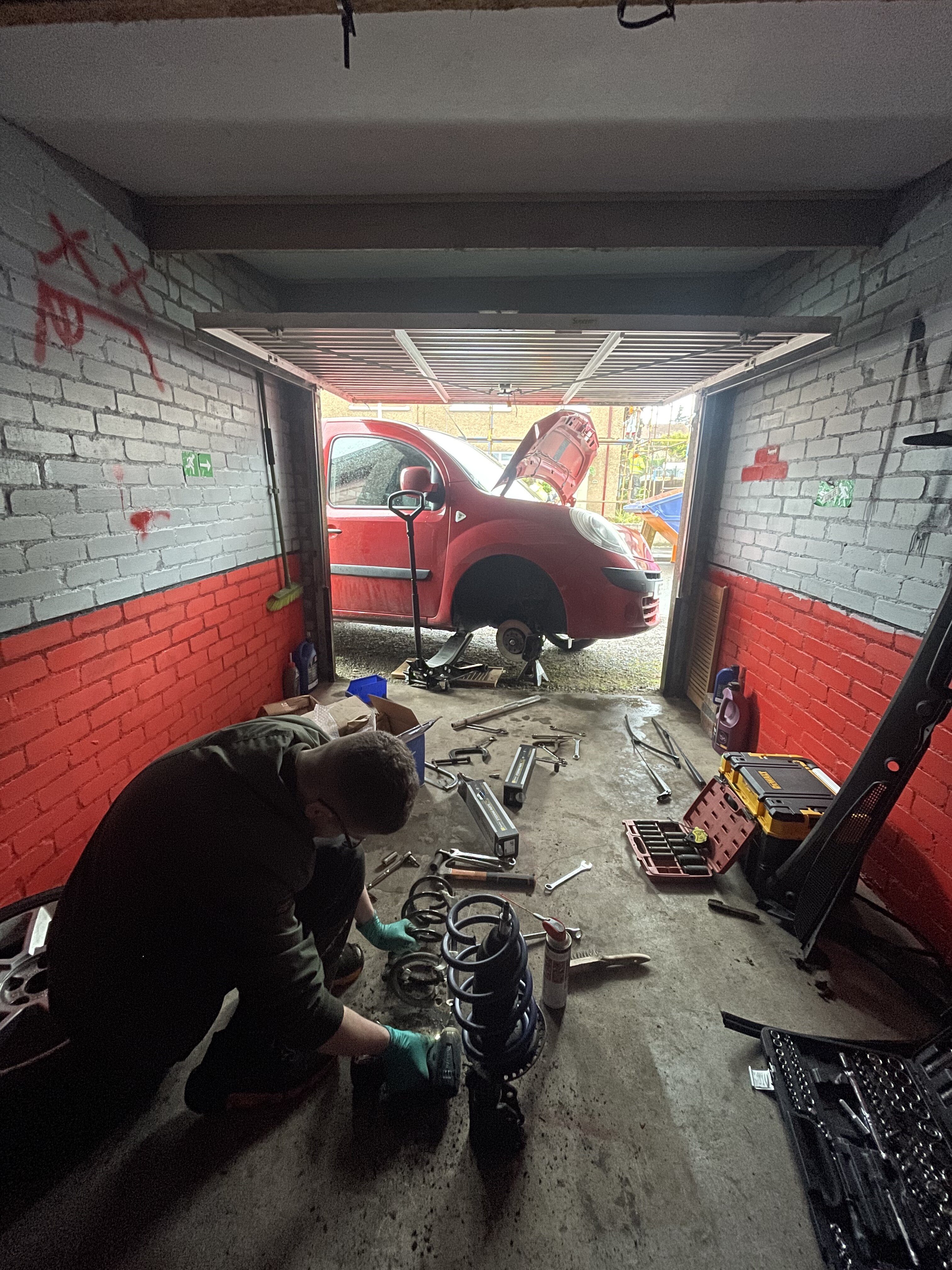

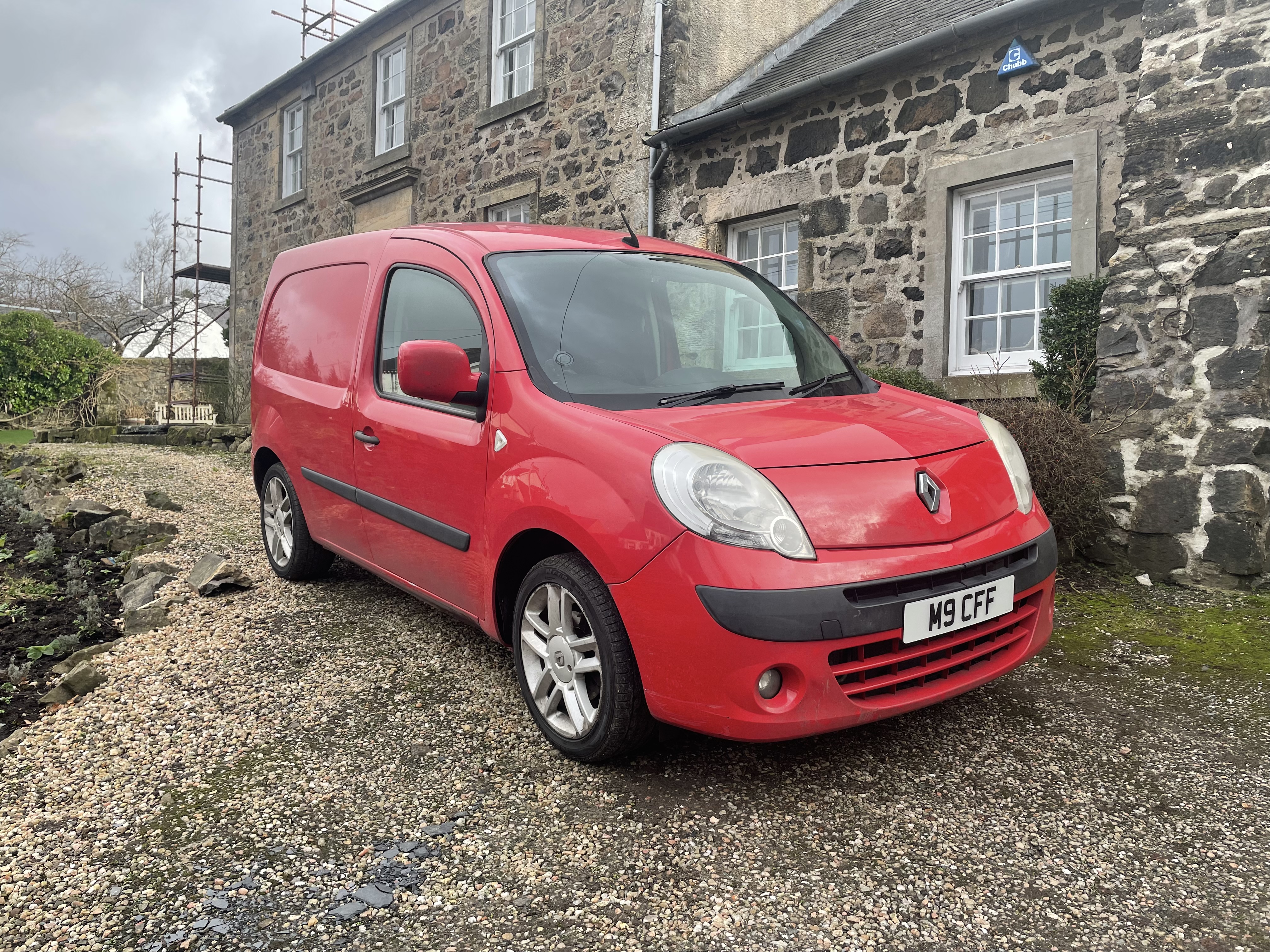

Van is now marginally lower than it was, changed the springs over yesterday.
Didn’t take any before pictures side on as the weather was pretty horrendous and we where sheltering half in a lock up while doing them.
After although it has settled somewhat this was just off the jacks:
And a couple today after I took it for it’s first wash!
Changed a couple of droplinks at the same time and it really does now drive much more like a clio on springs rather than a van on worn out suspension.
Ride height the back needs to come down a bit more hopefully sorted by the altered setup from brigsy, this is it just now on the -40mm H&Rs all round. I would really love to get a coilover on the front but it just wouldn’t be cost effective to get that set up.

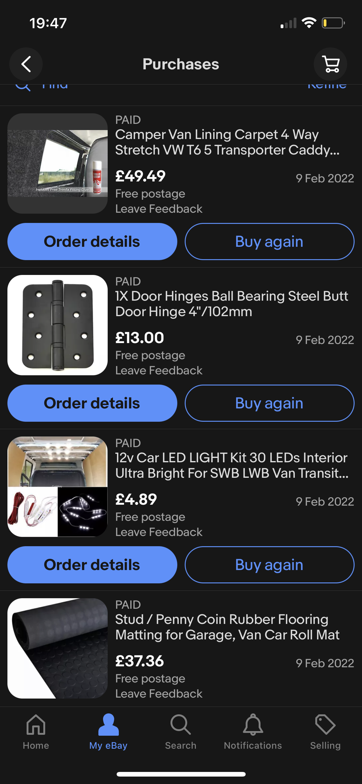

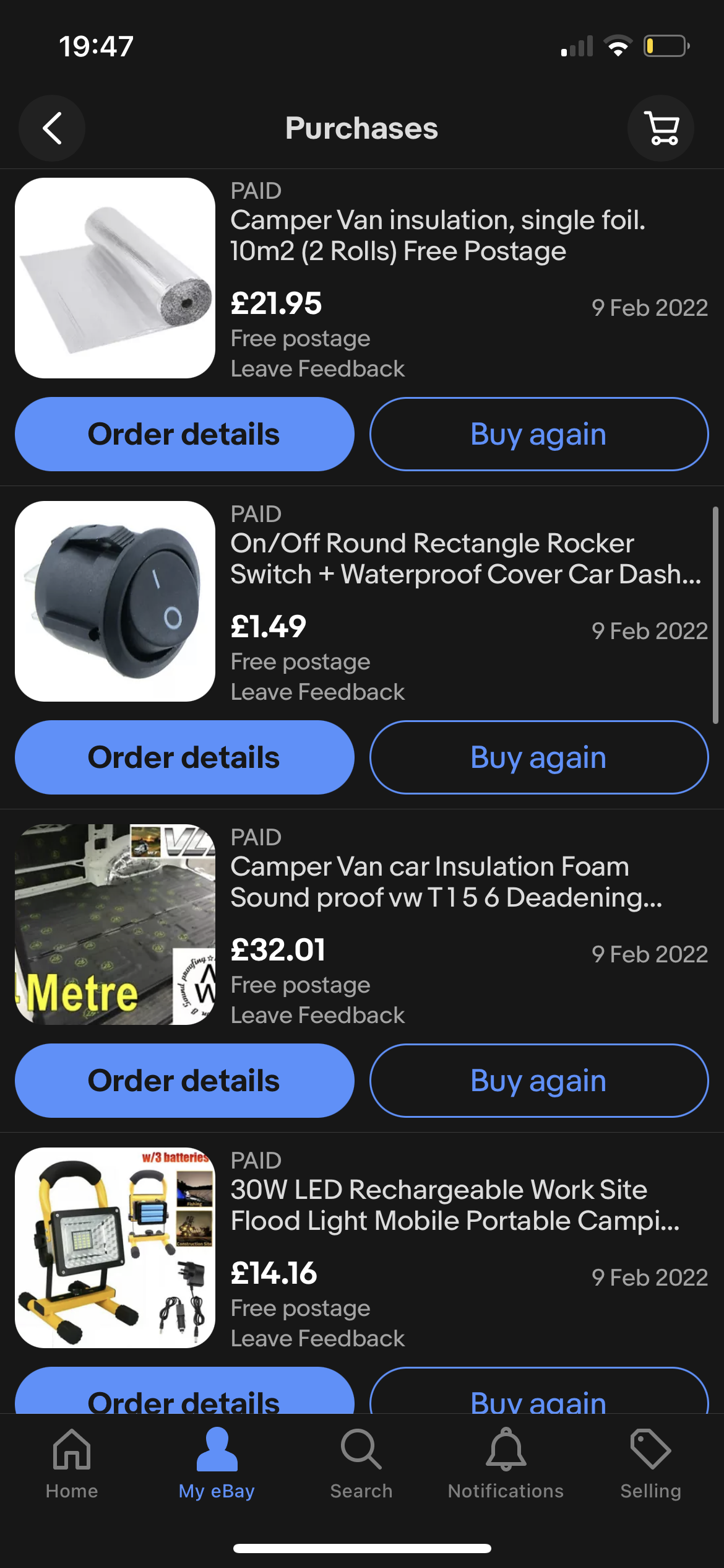

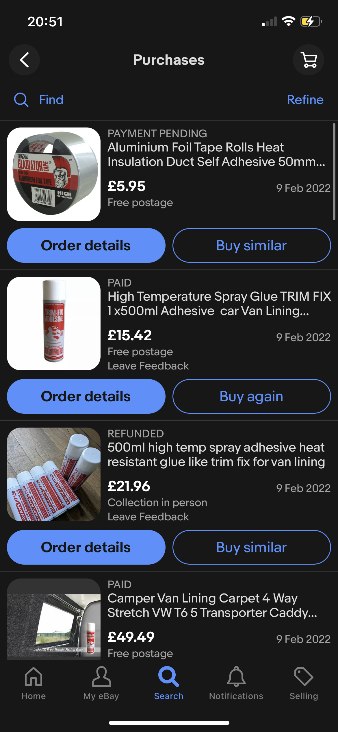

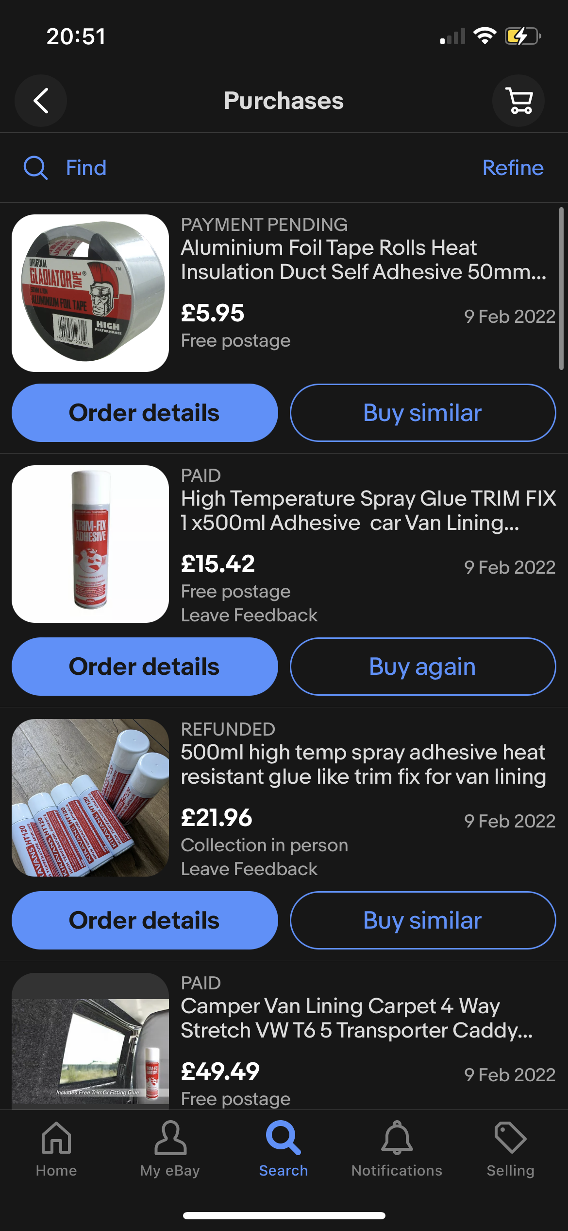

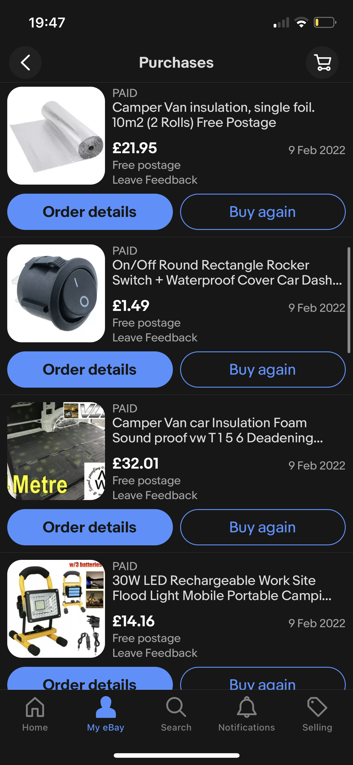

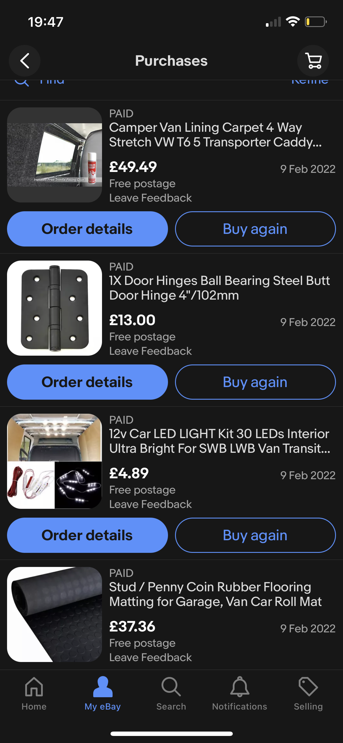

Been doing some eBaying to carpet and somewhat insulate the back. Just going to fire a list of stuff I’ve bought in here more for my own records!

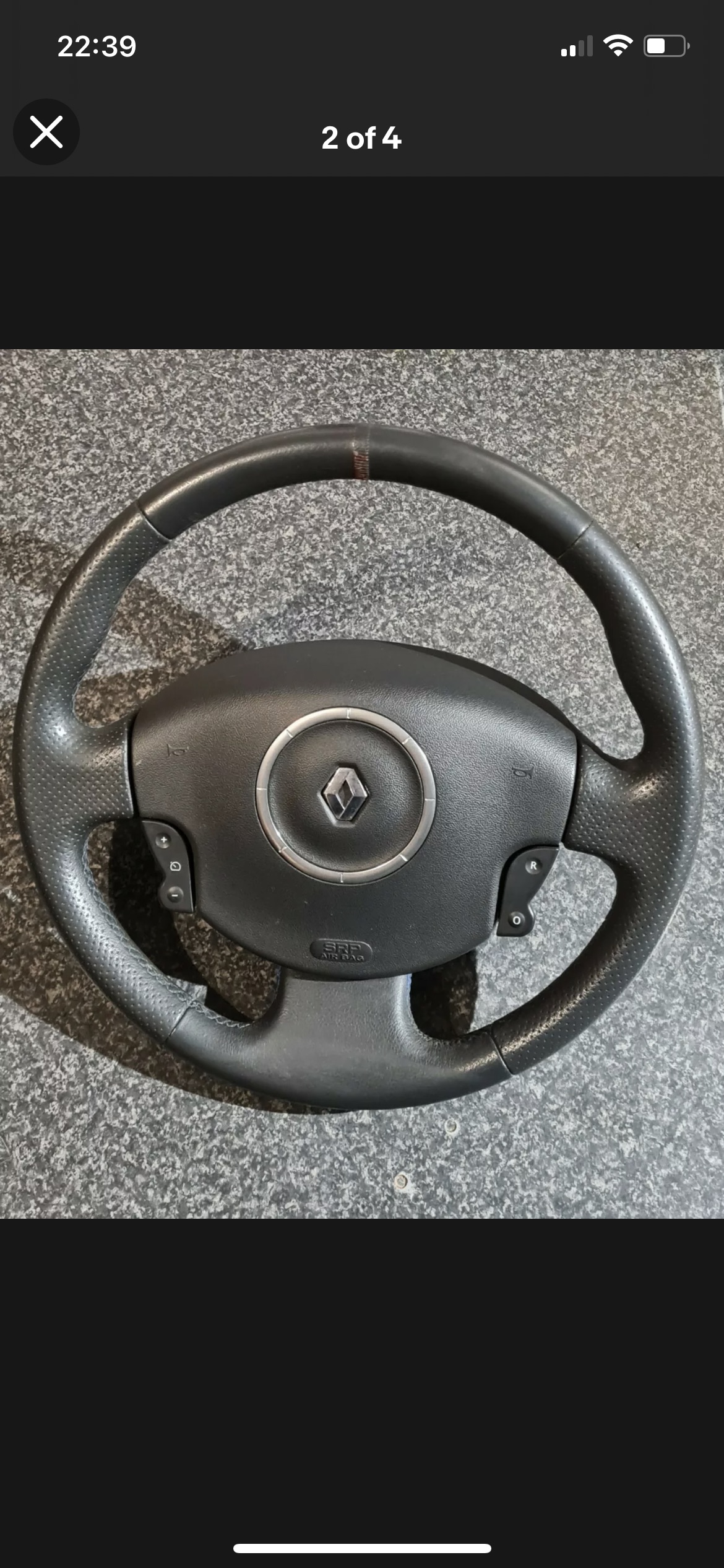

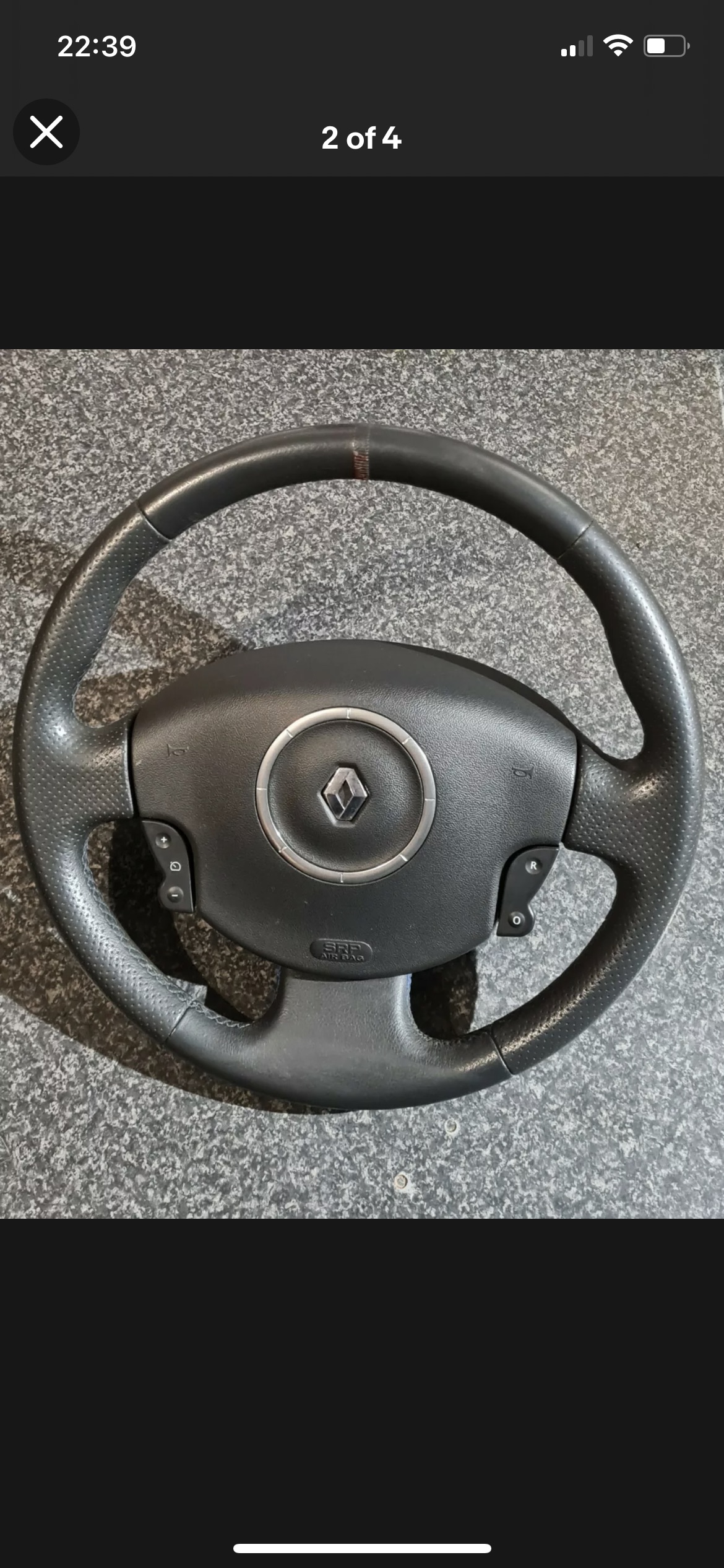

Also bought myself some 197/200 handles for the front doors and a Megane 225 wheel.
Not really been doing this on a budget or anything just kind of firing money at it, but I don’t think I need too much more. I’ve got some rigid board insulation as well from doing my kitchen ceiling that I will use in the gaps.
So far I’m at about £1100 on top of the van. That includes the springs, belt kit and every serviceable item, glow plugs, discs and pads etc. plus a load of other bits I’ve bought for tidying it up not listed below.
I’m close to finished spending I recon at most another £3/400 and al be mostly happy!

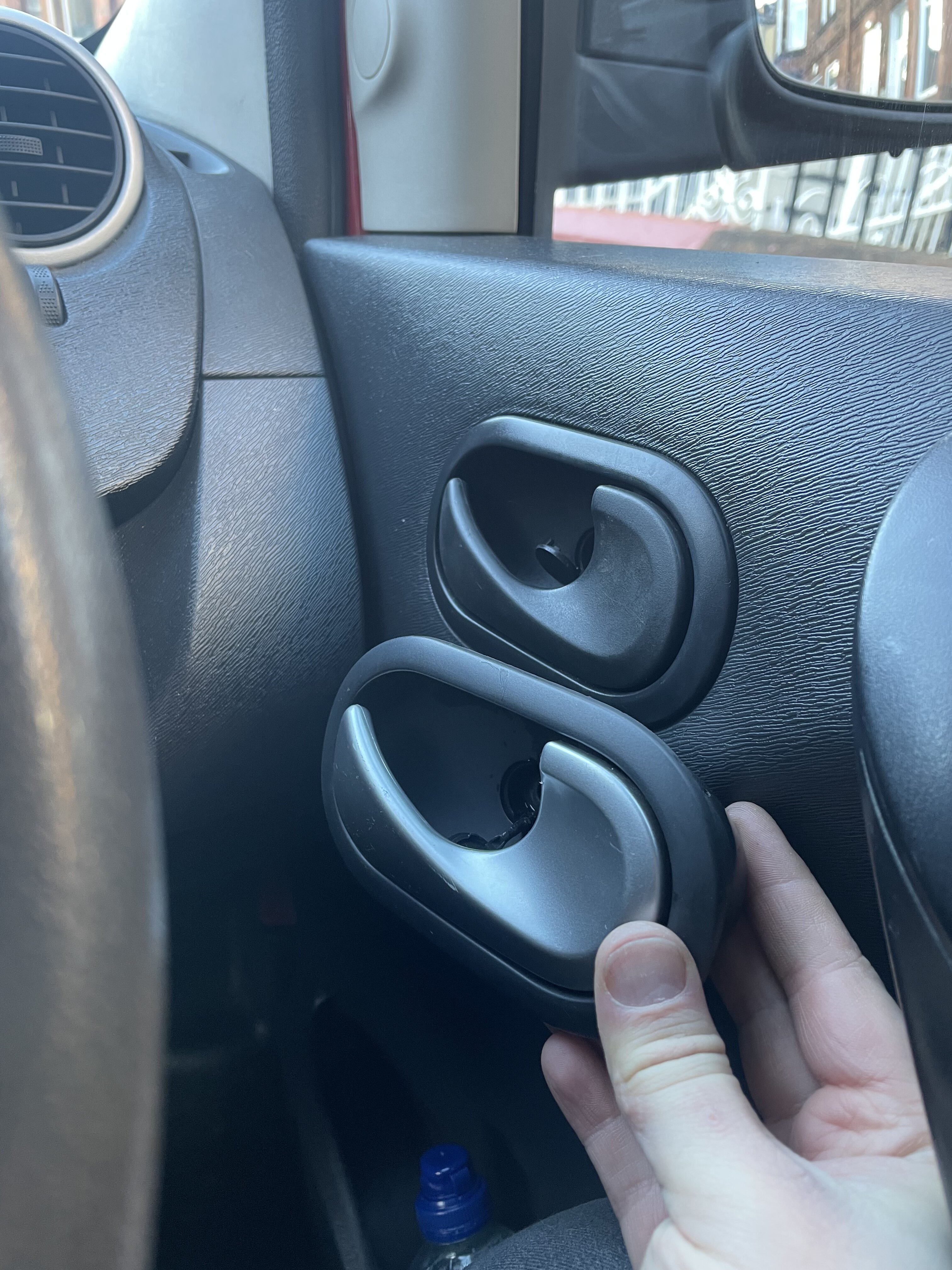

So do the 197/200 door handle straight fit I guess ?
Yes they are identical fitment dead easy to swap over.
Should have said, I've got a 197 wheel I'd have sold. They're far better than a Mégane 225 wheel😂
I’d have had it off you! To be fair I’m trying not to load this with renault sport badges and look full nonce with it 😂
although:
@Mcaff I was thinking the external handles. I’ve wanted to change the external for a while now to get rid of the textured. But from what I can see on eBay the external handles may differ but it is something I plan on looking into further
Ah yes I’d been looking at that. I wasn’t entirely sure myself. Was chatting with my mate last night about getting this blown over with some fresh red paint. Would be ideal to fire on some smooth handles too!
@Mcaff I've still got quite a few 197 parts, if you need anything drop me a message. It'll save you paying stupid prices from some other plank😂
Good man! Al have a think I’m not sure what I need now it’s mostly just the crap to turn it into a day van.

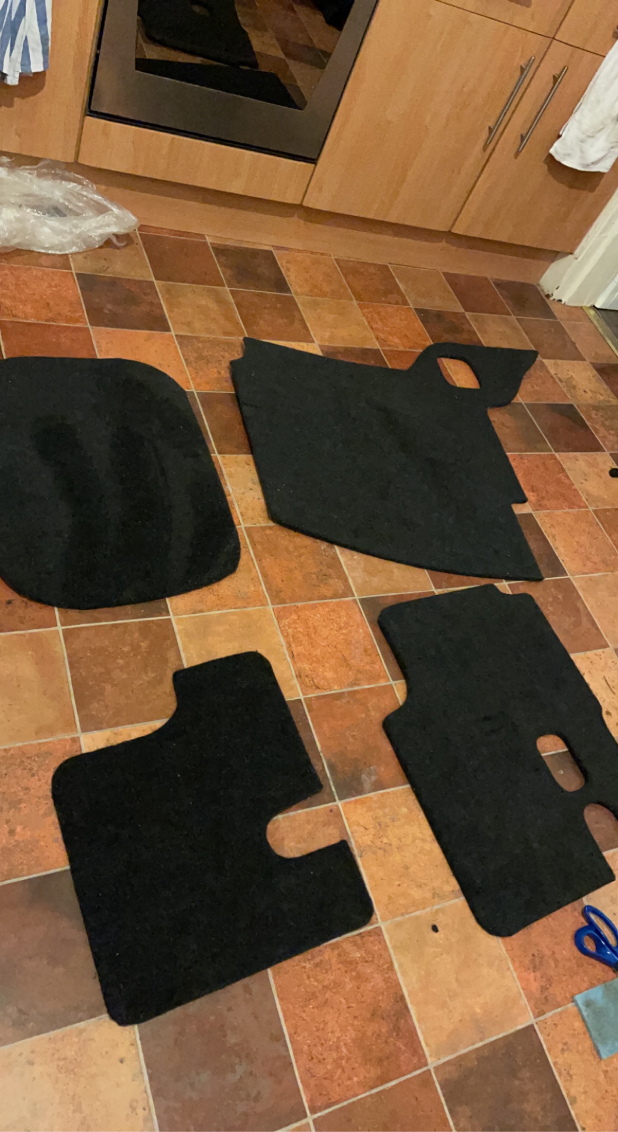

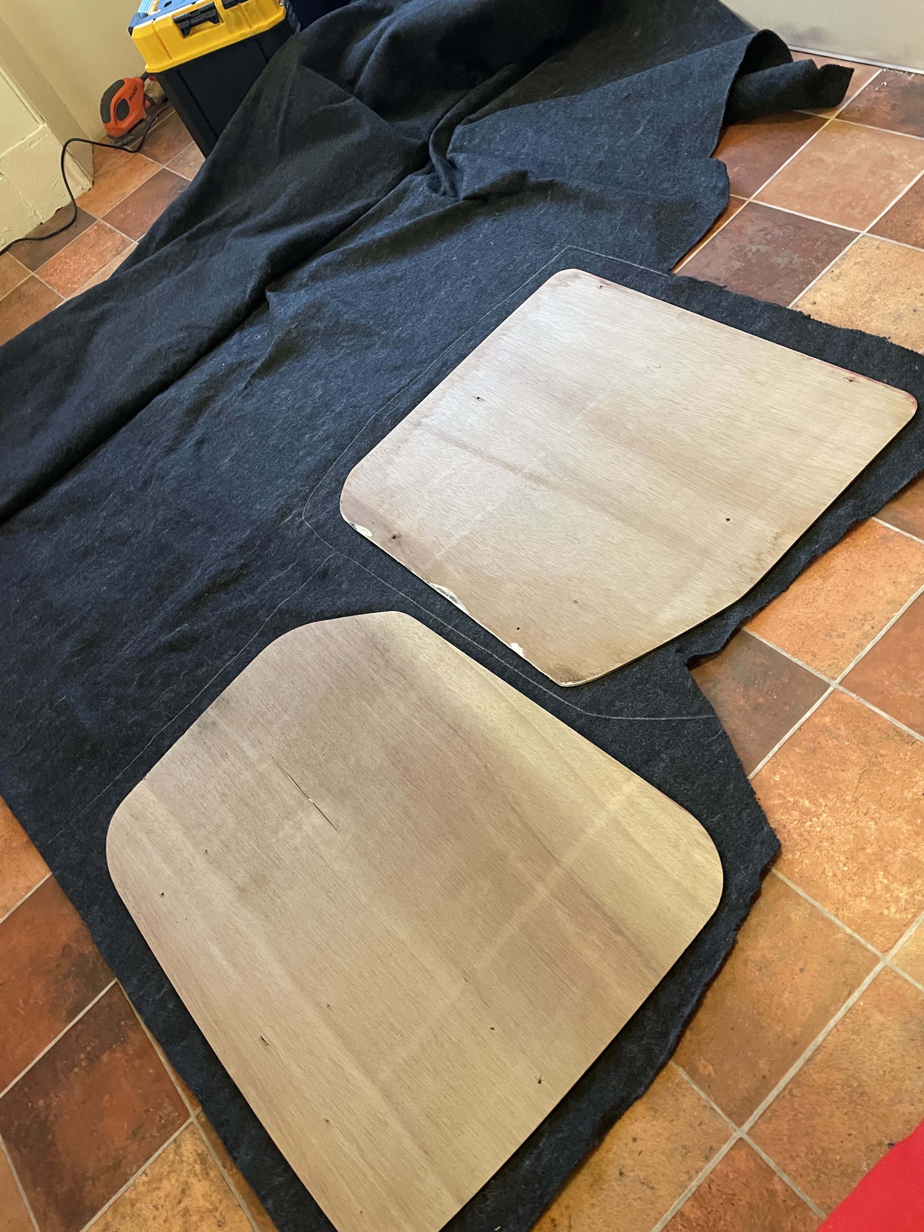

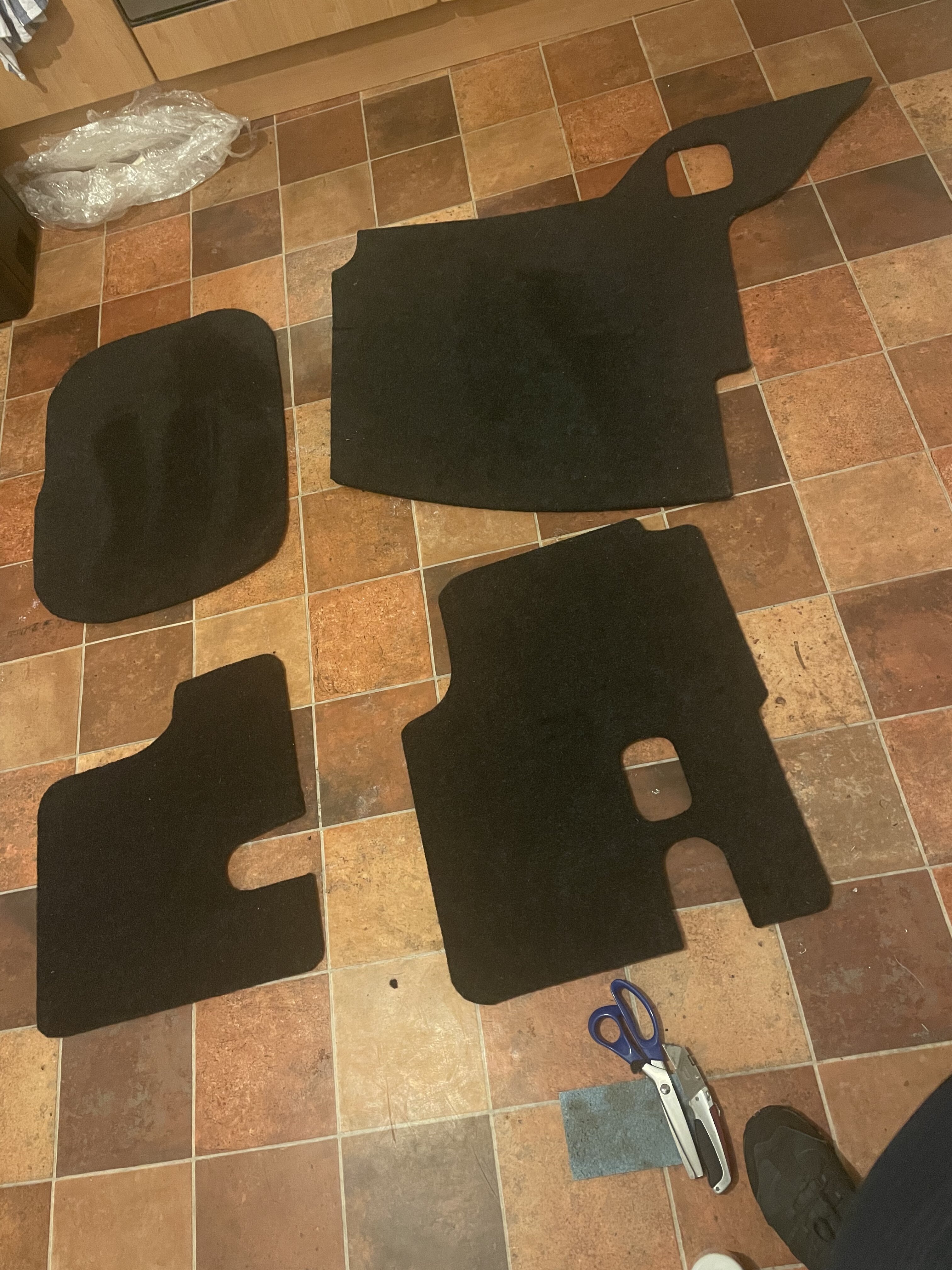

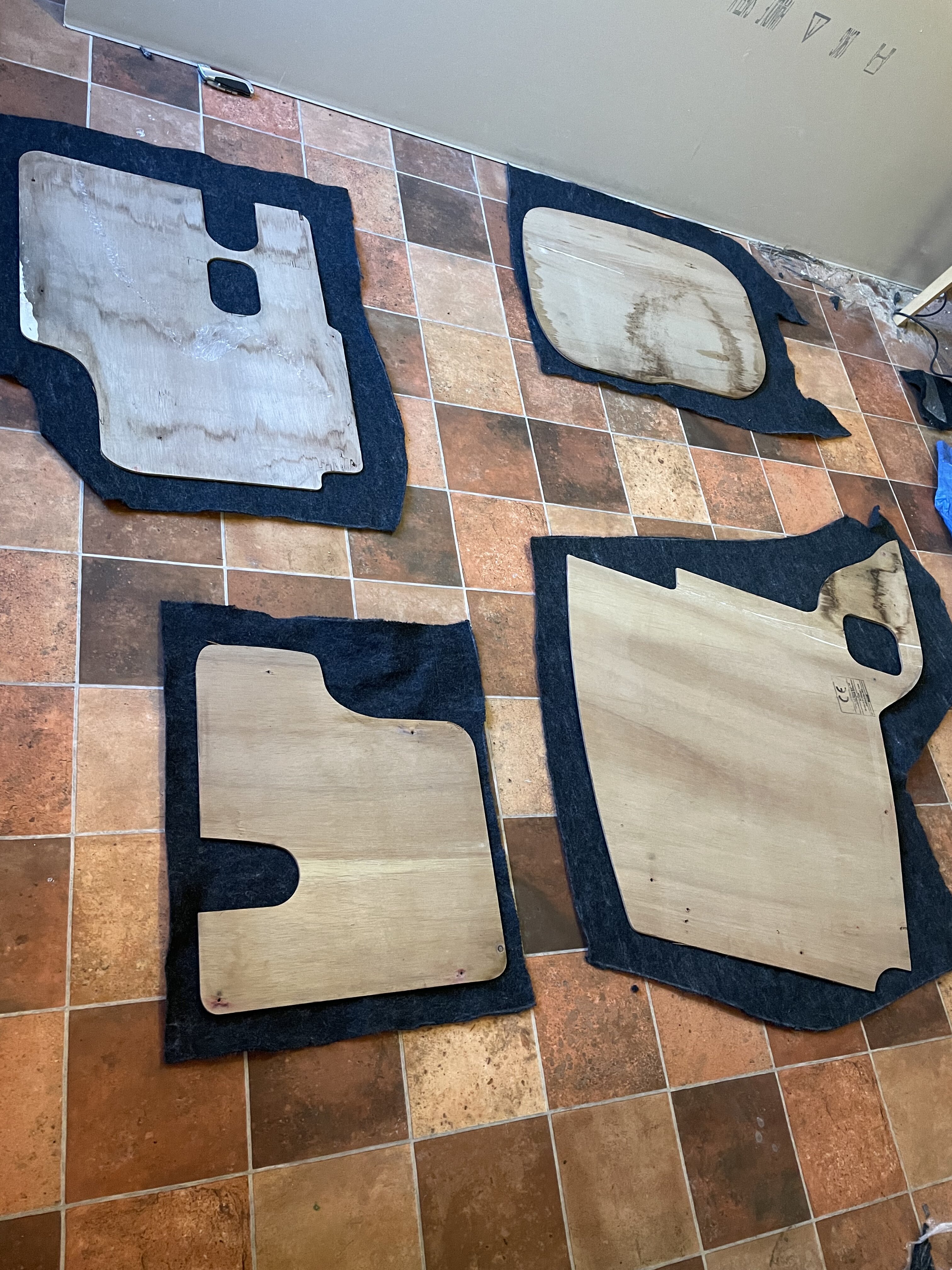

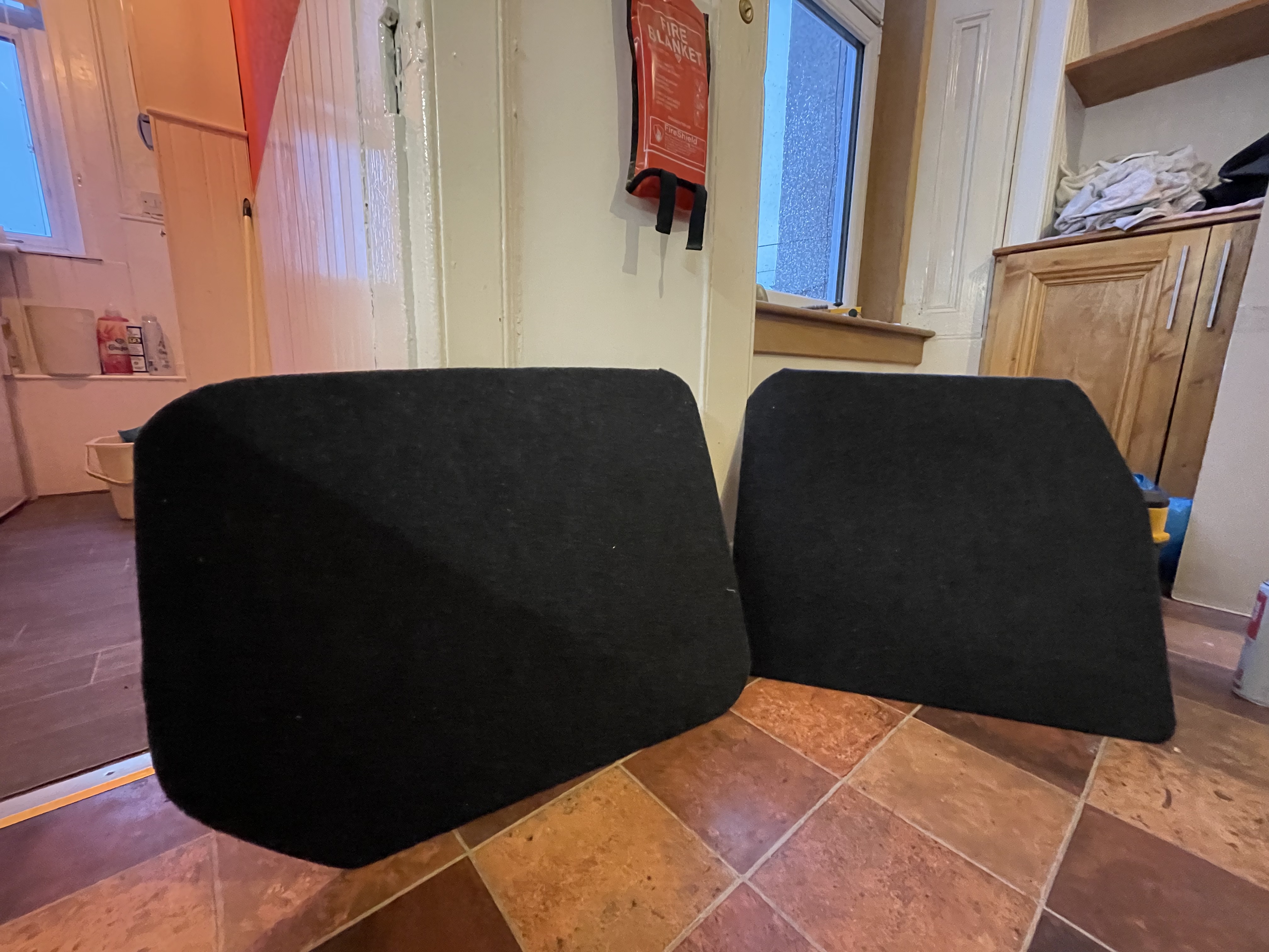

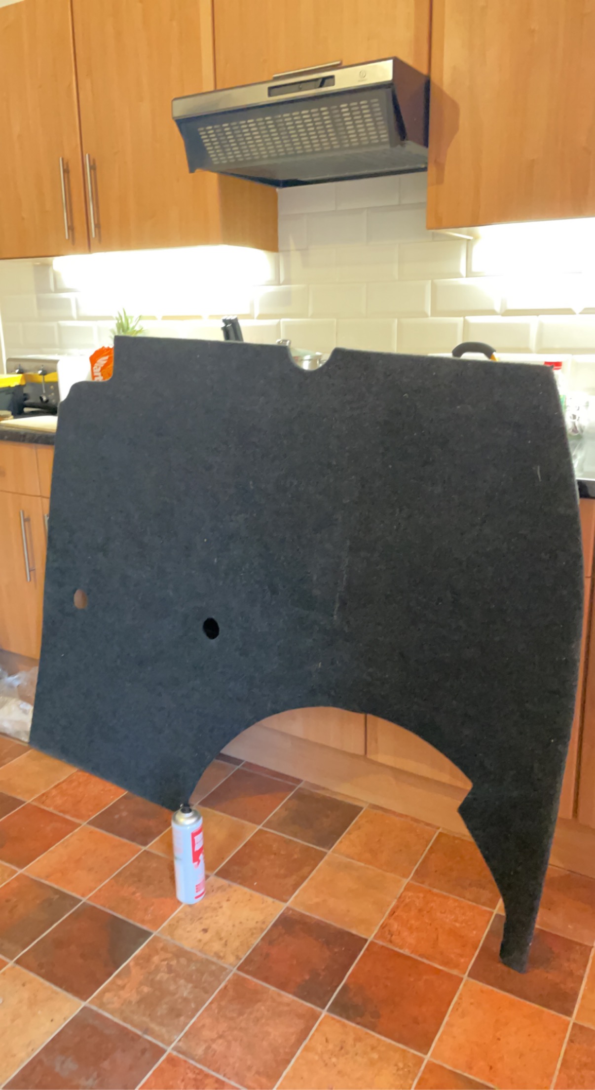

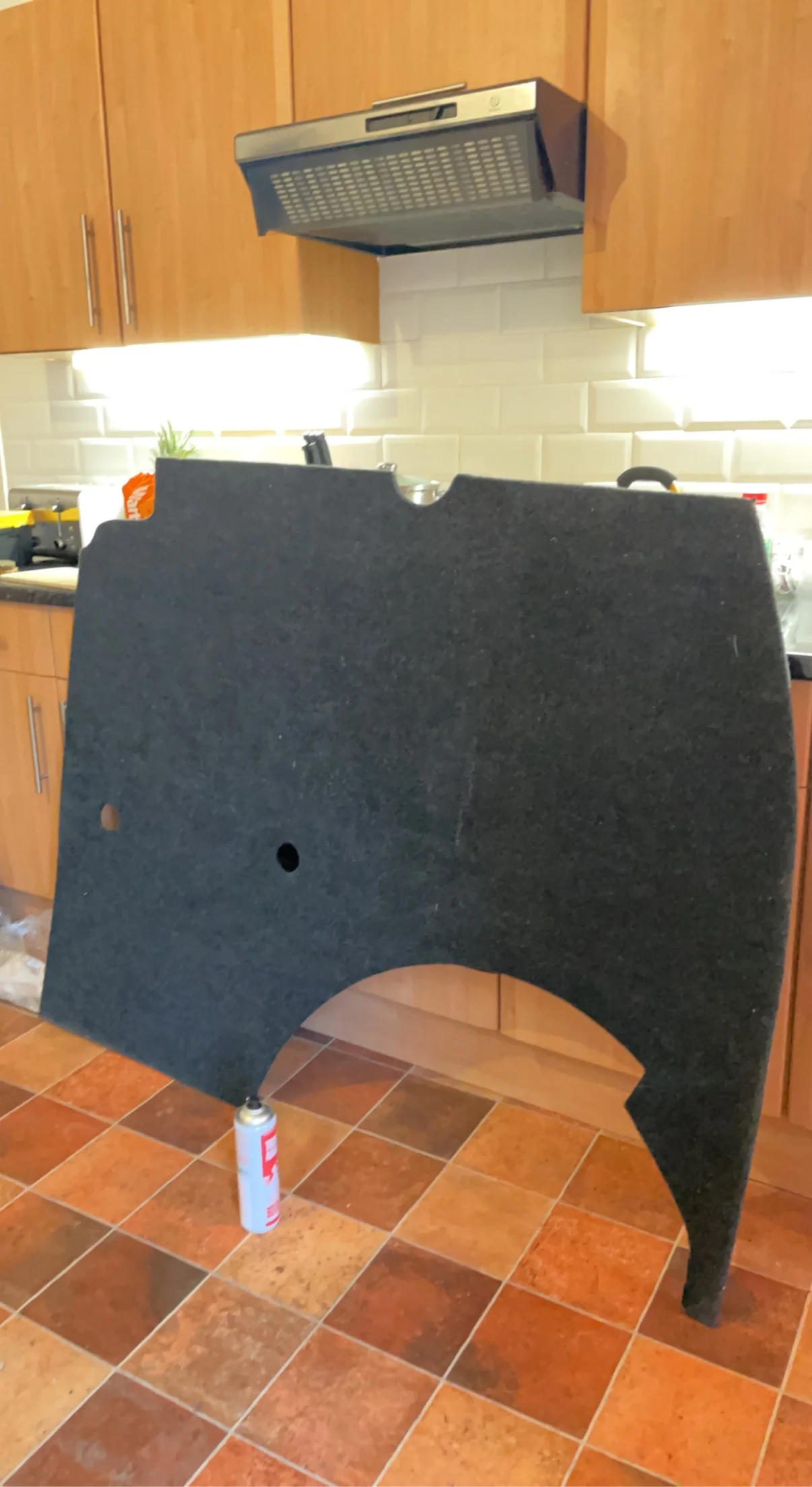

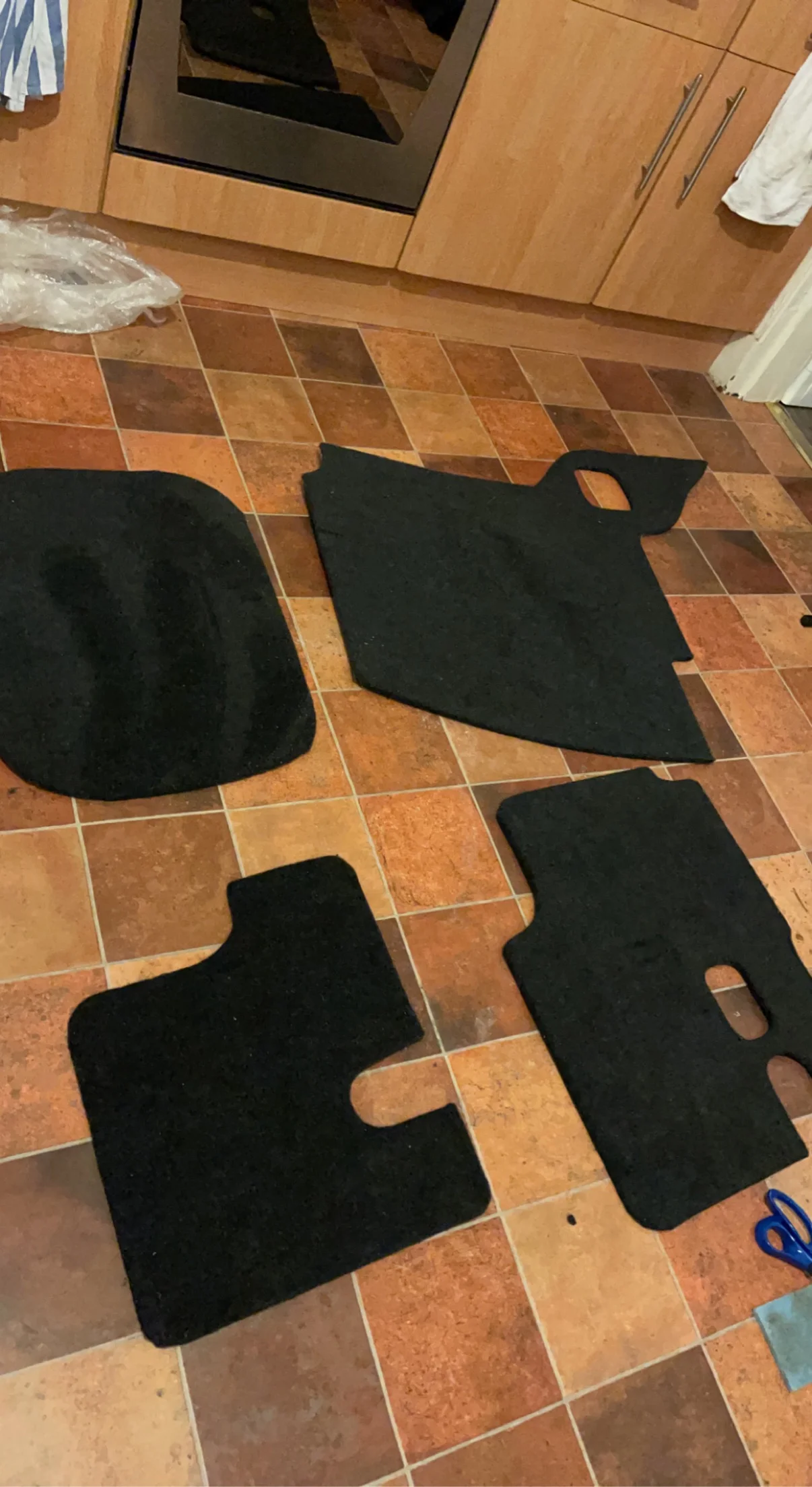

While I’m still waiting for insulation to come I set about carpeting the panels.
Fairly easy to do, quite messy.. thankfully I’m in the middle of having the kitchen renovated so wasn’t too much bother to have glue on the floor. But I would advise if you are doing it to cover the floor! Not the sticky mess I’m used too!
Came out alright al temporarily put them back in the van tomorrow.

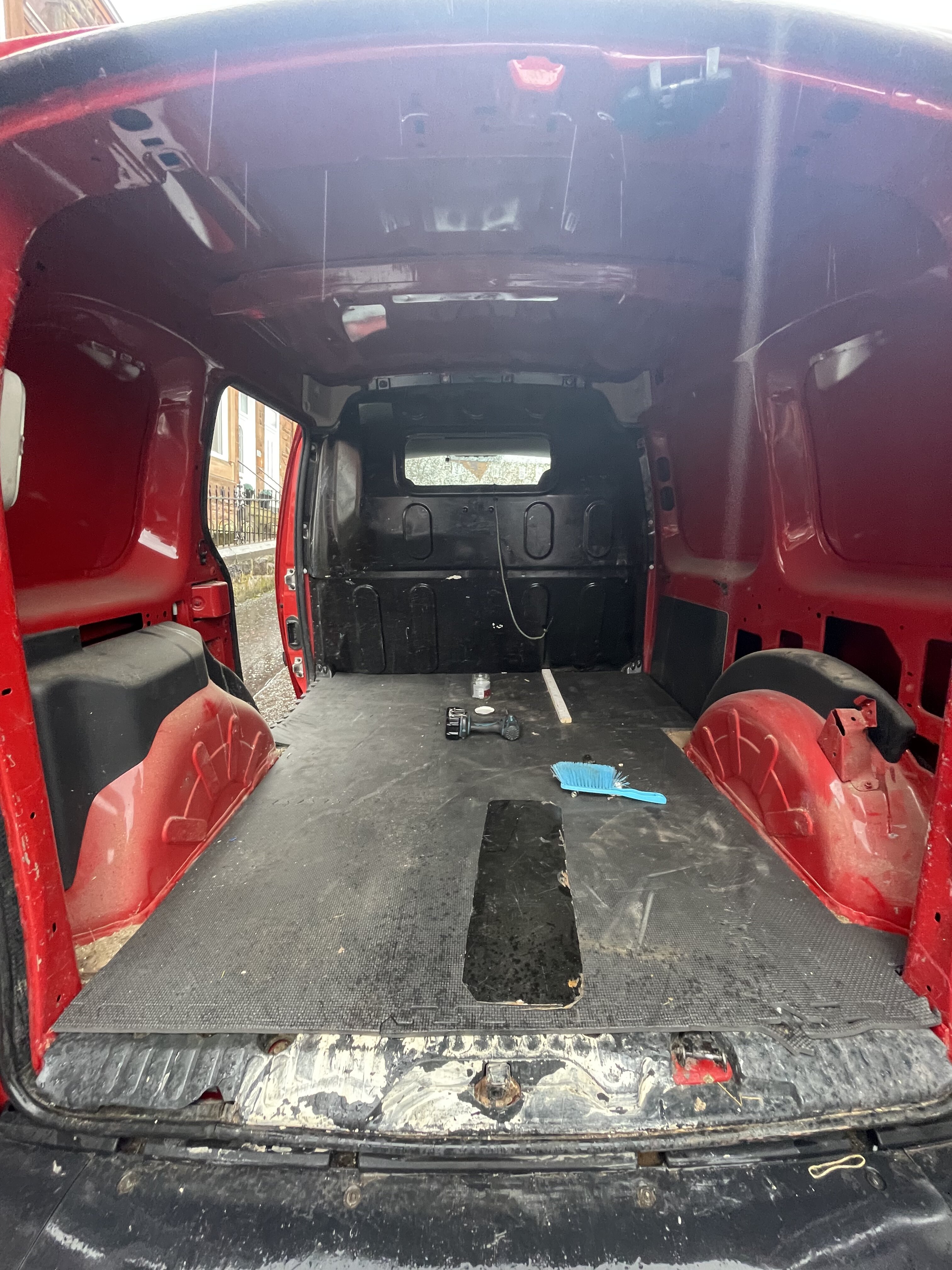

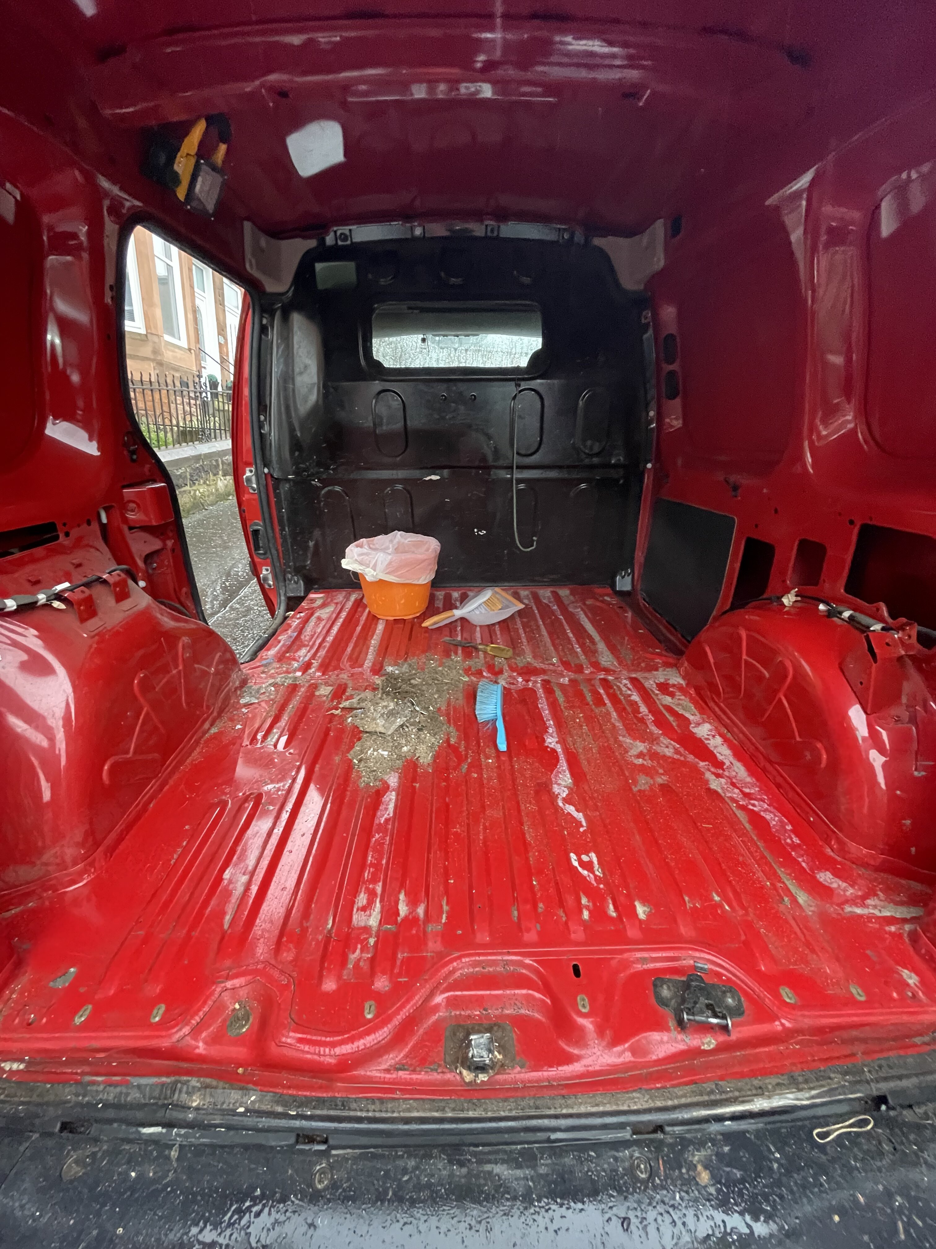

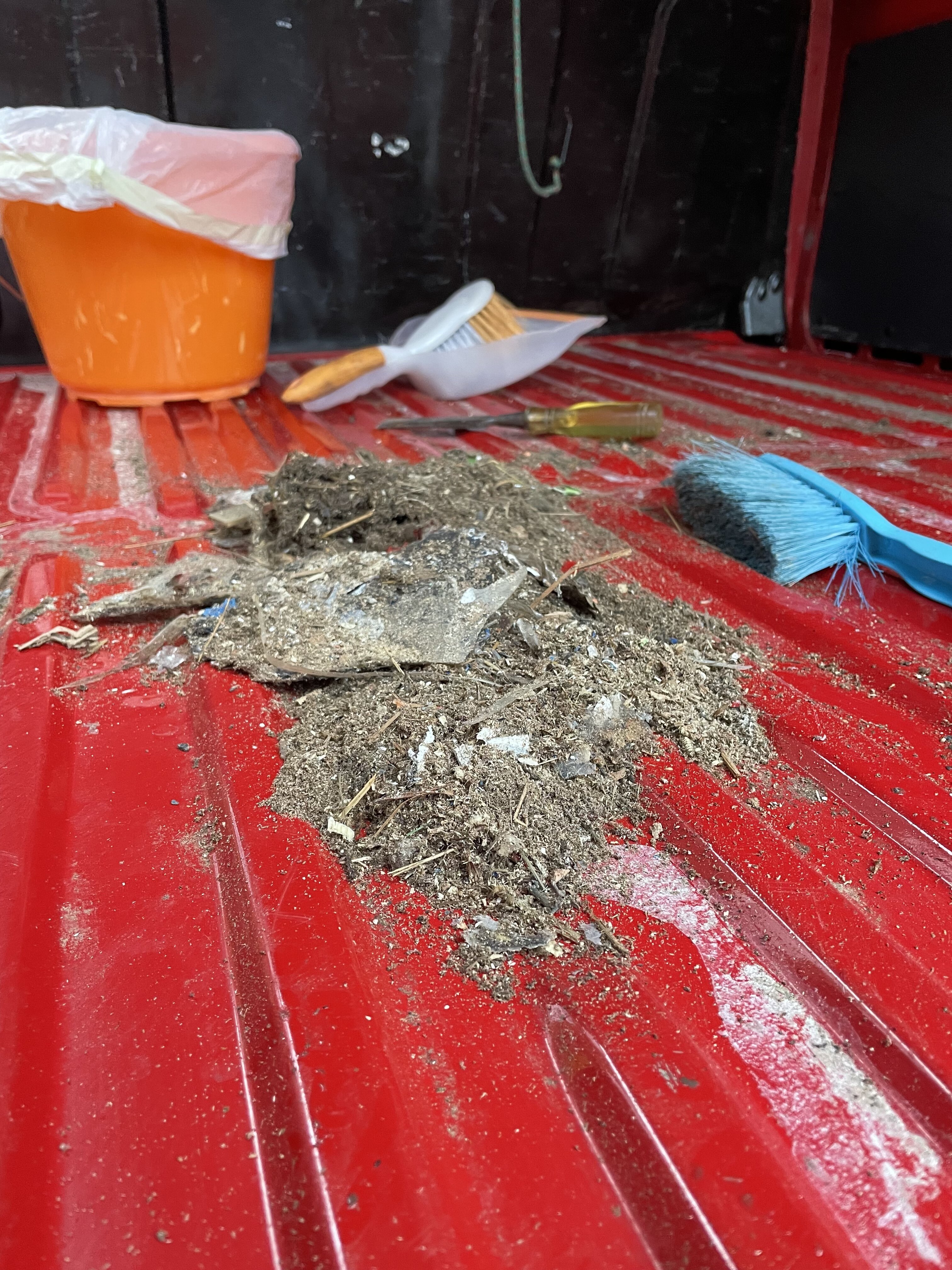

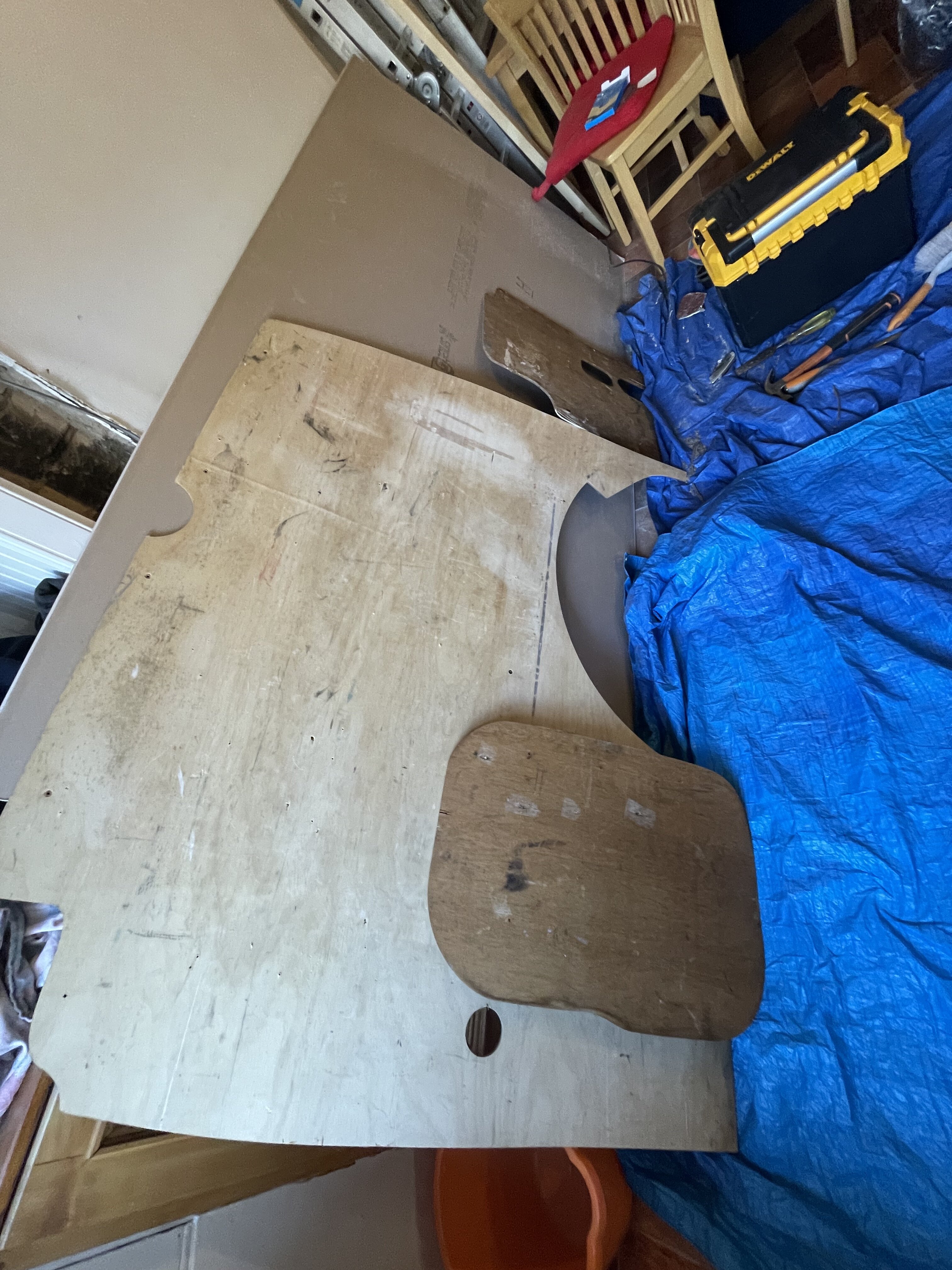

Had intended to insulate the floor today, as with all things cars it didn’t pan out that way. Under the plywood floor it was a right mess. The joys of doing this to a builders van, sawdust, spilled paint and glue all had to be removed from the floor.
Under my foam tiles was a sheet of plywood that got horsed out, was completely saturated with what I can only imagine is turps. Totally stinking.

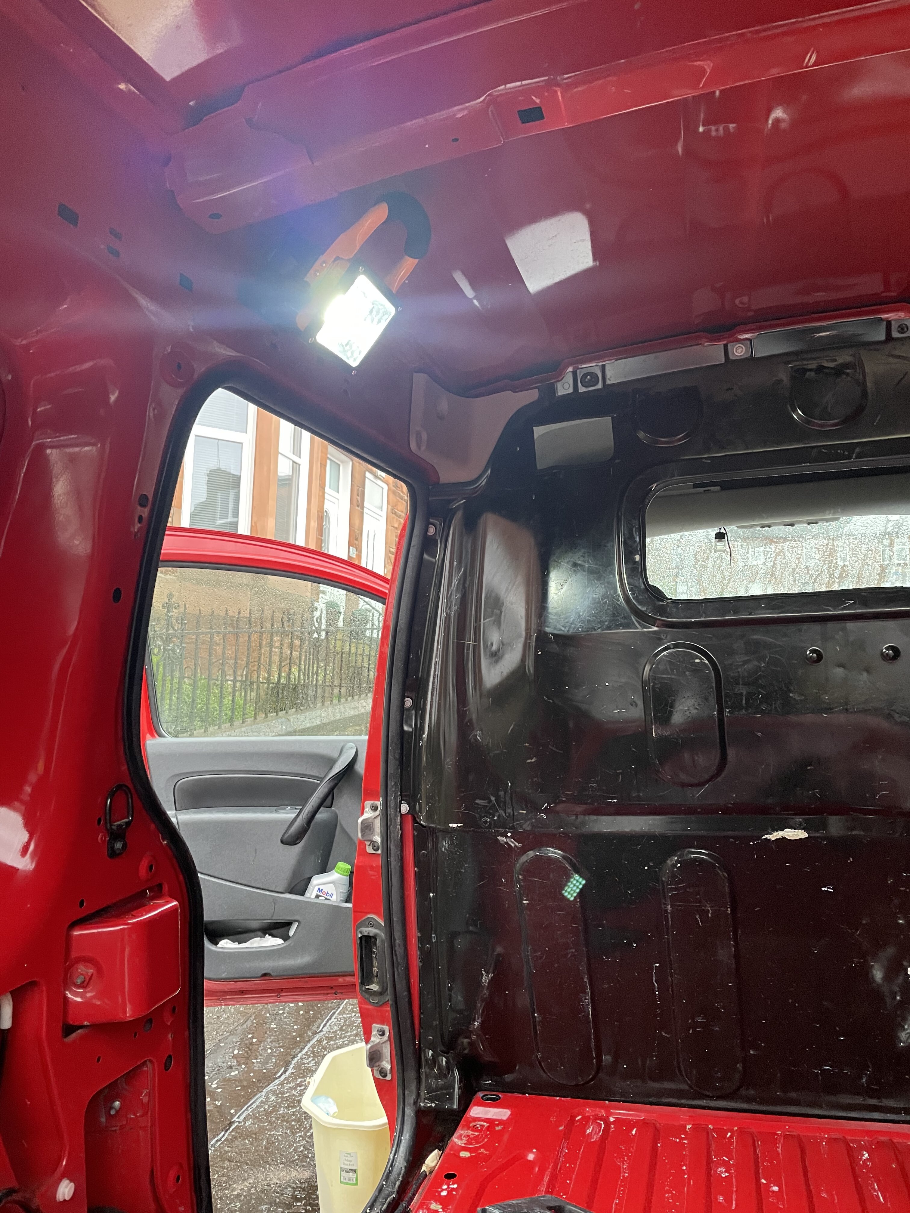

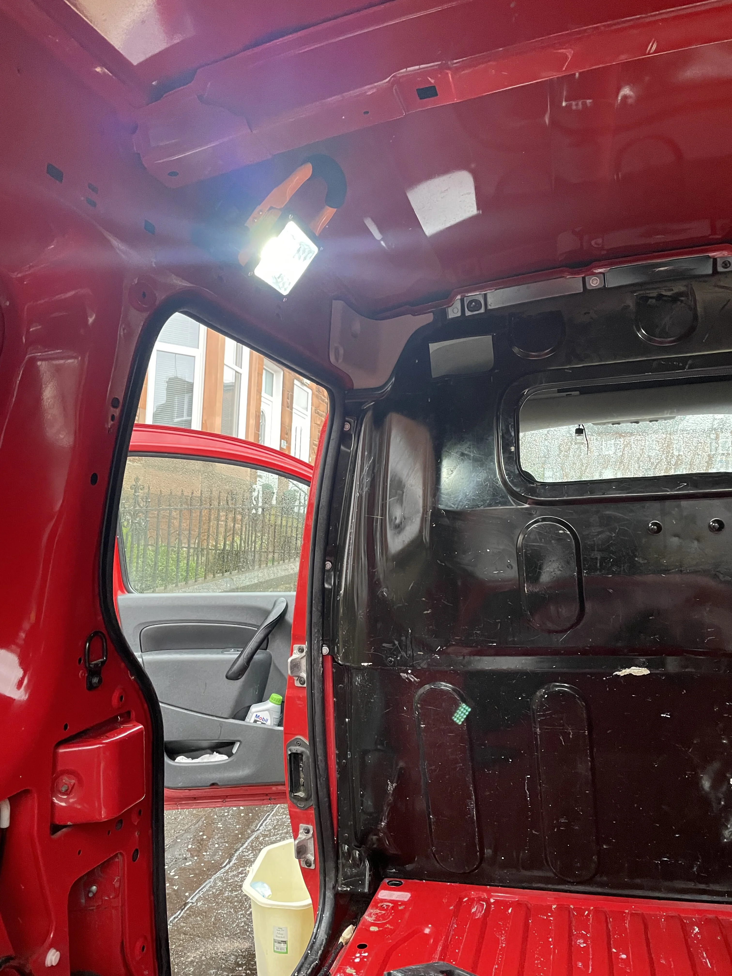

Added a rechargeable led light for those dark evenings where I might need my tools or whatever.

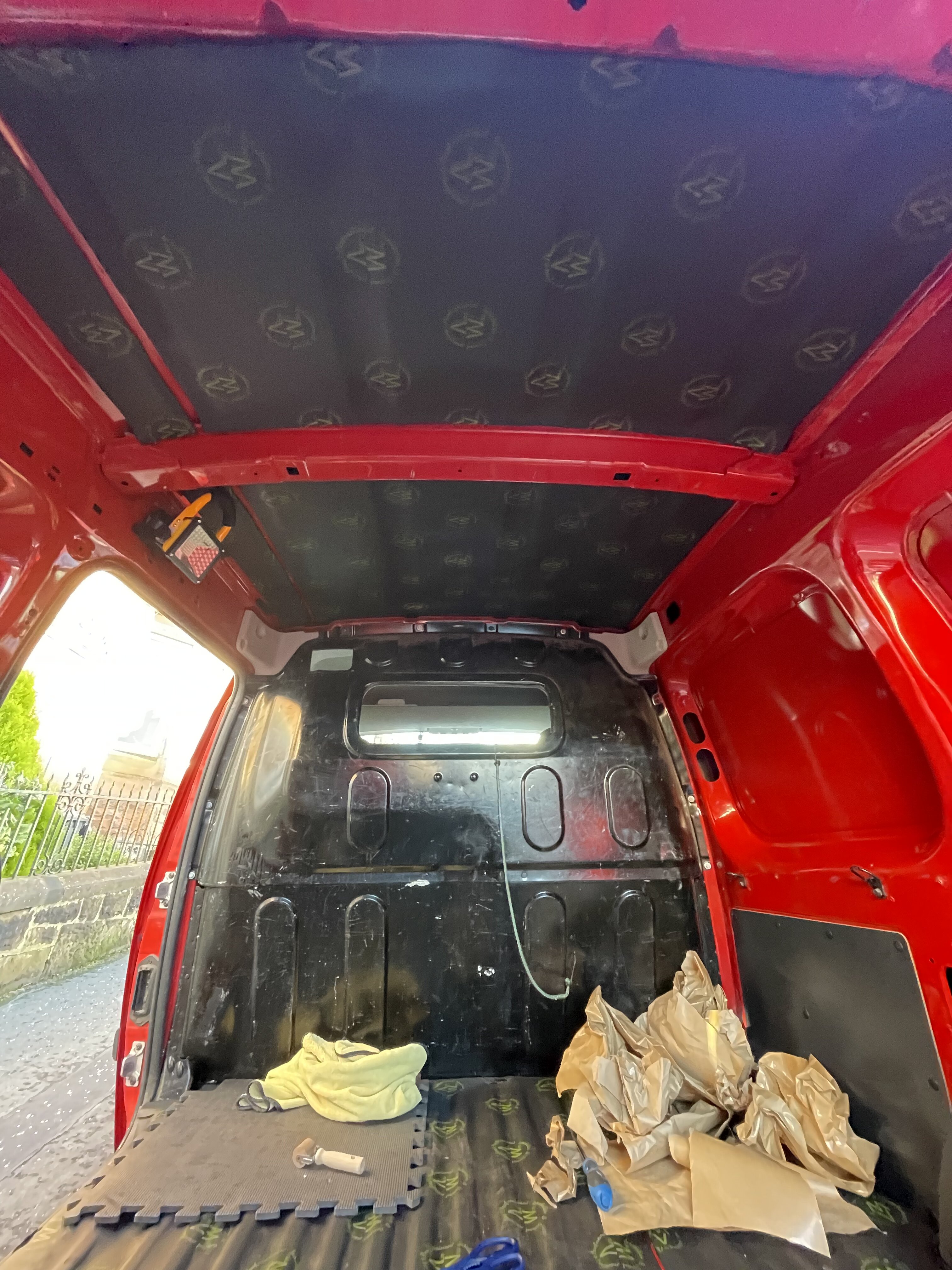

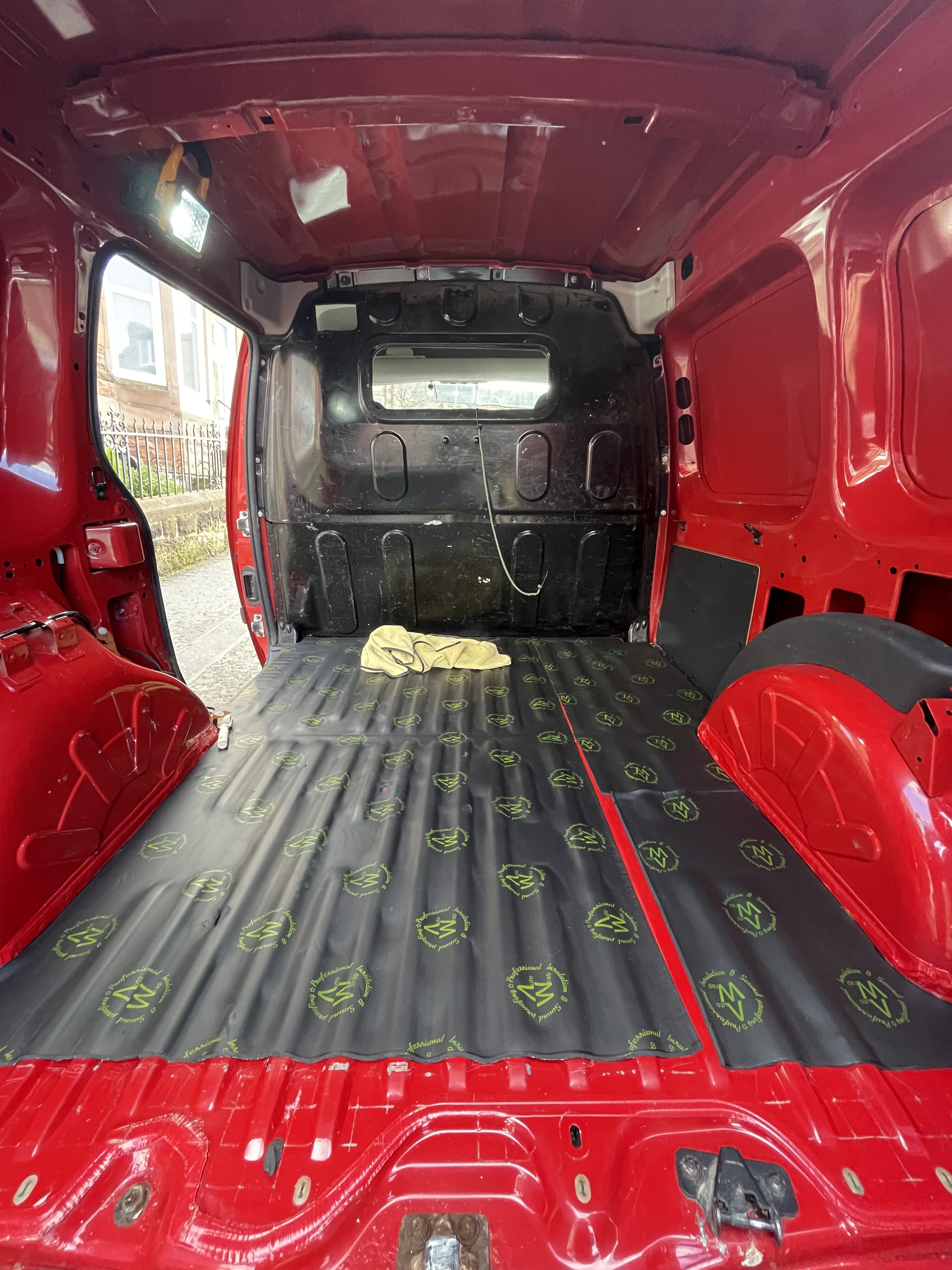

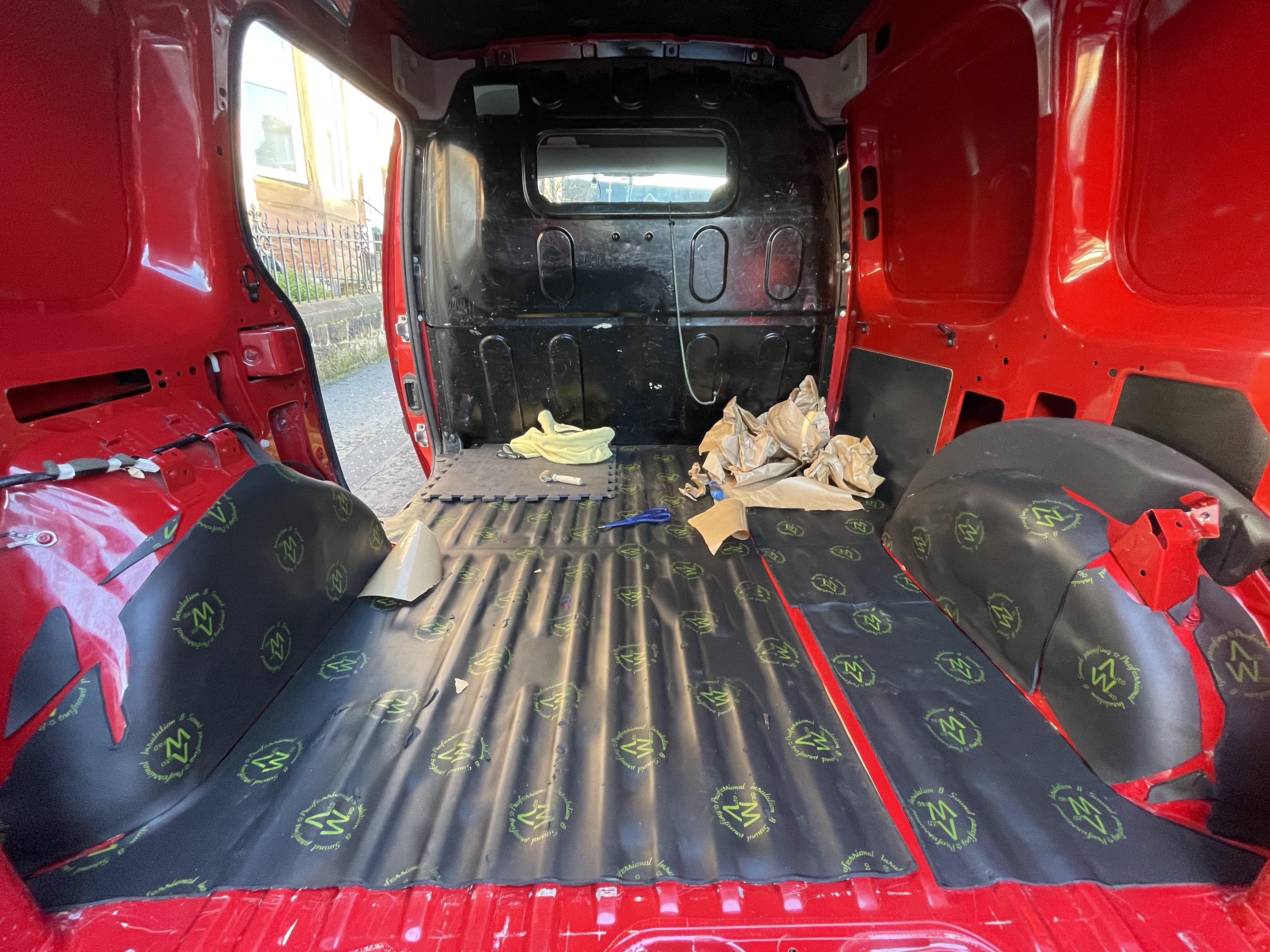

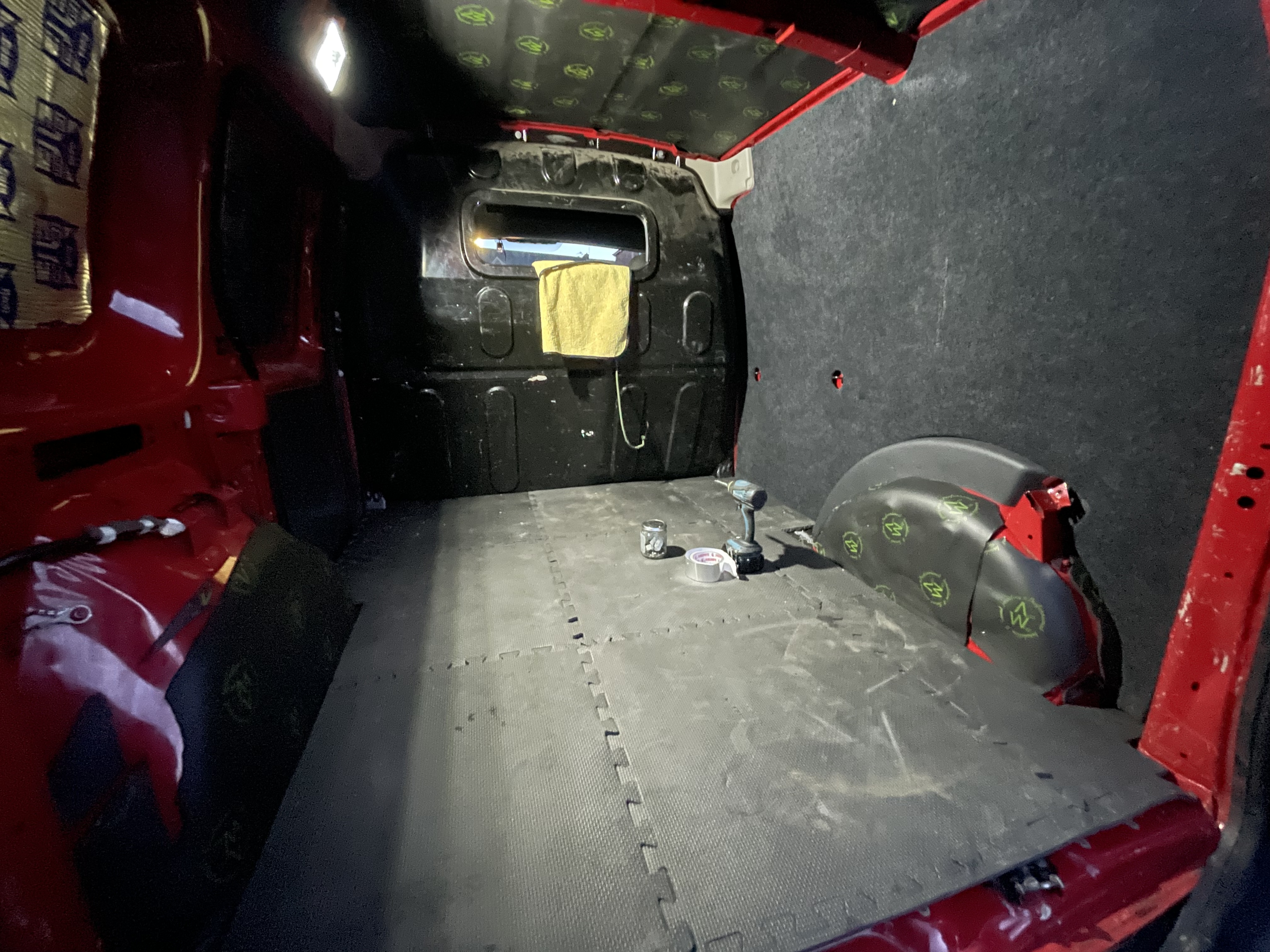

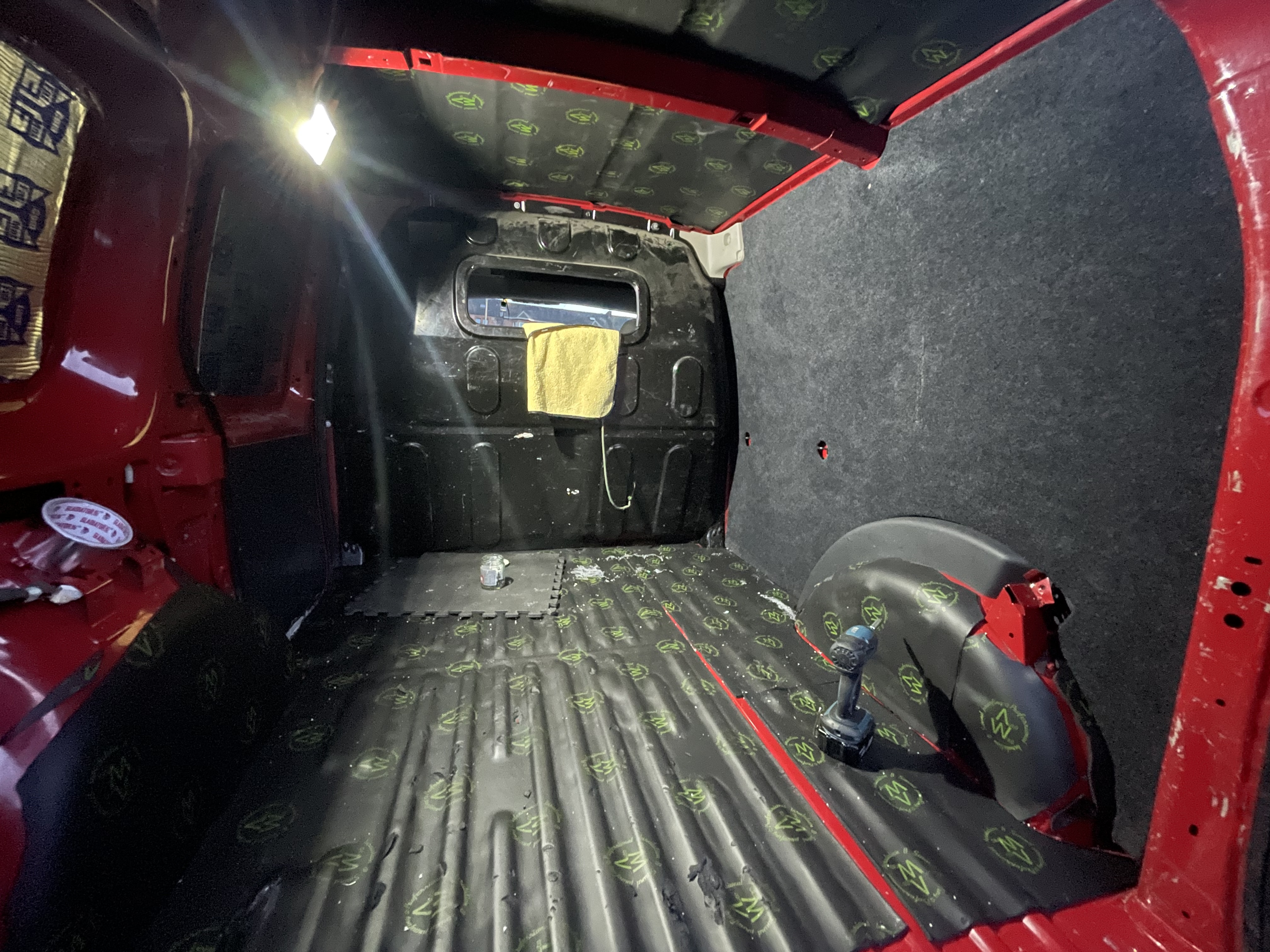

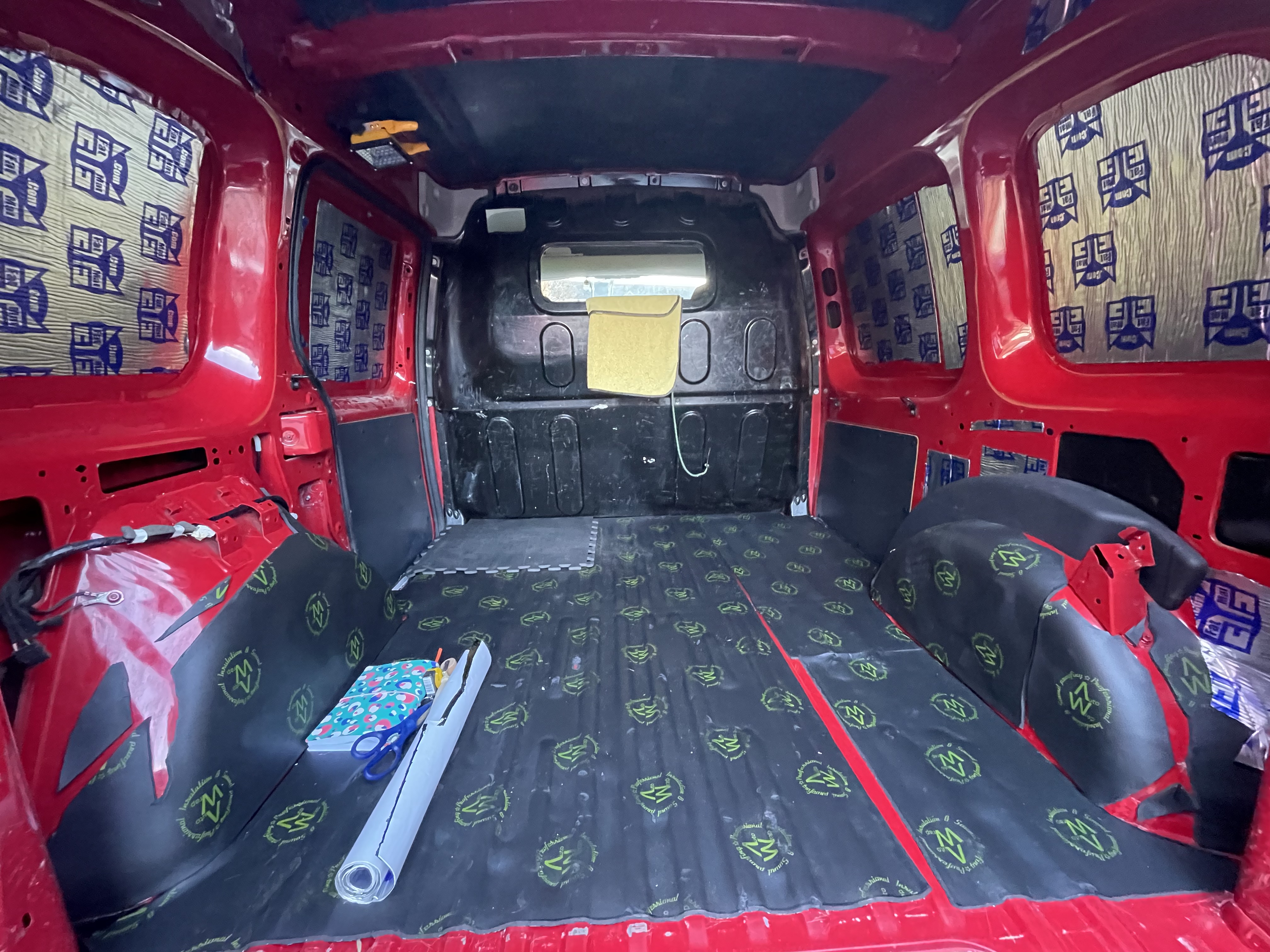

Cracked on a bit more today. Quite tedious doing the sound deadening. The foam stuff is ok to work with, ended up using what off cuts I had to wrap round the wheel wells. Not pretty but it will all be covered!
Might do a bit more after lunch but I’m still waiting on my foil insulation coming so that’s holding me up now. Usual Hermes delivery issues.
Fired some leftover 50mm kingspan insulation I had in the gaps. So I can get an idea of things and to hold the sides together I’ve put one of the carpeted sides in and my flooring back down, it will protect the floor as I need the van tomorrow.
If I get the chance tomorrow it should all start coming together. Ideally need to take the bulkhead out now to crack on with the interior carpeting. Been trying to hold off taking it out as long as possible as it makes a great difference to keeping the heat in the cab.
Taking shape though!
