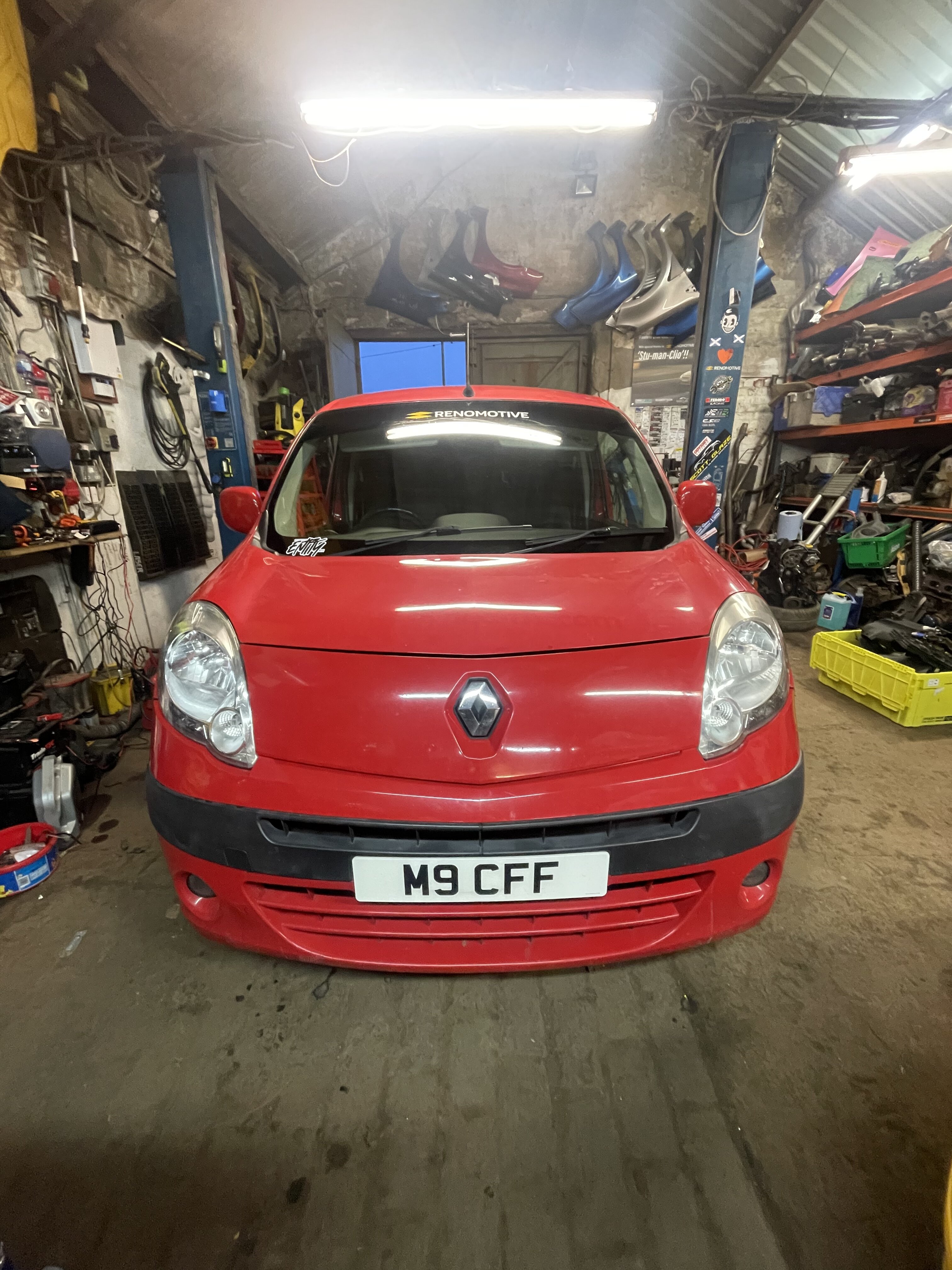

Got the van built up last weekend. Managed to snap off the return on a brand new radiator so had to wait till the Monday to get it buttoned up.
All fairly straight forward stuff was happy that it fired straight up.

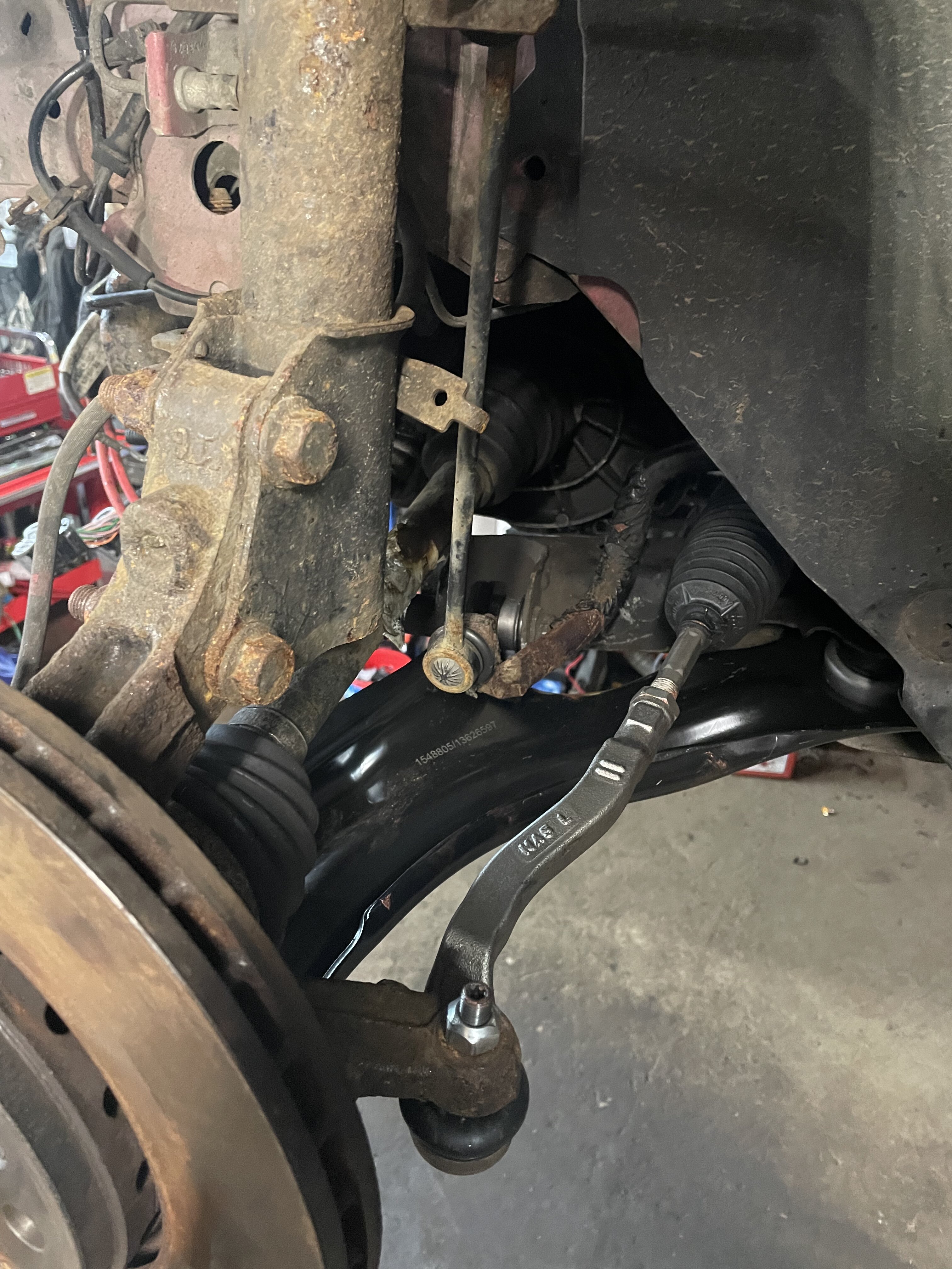

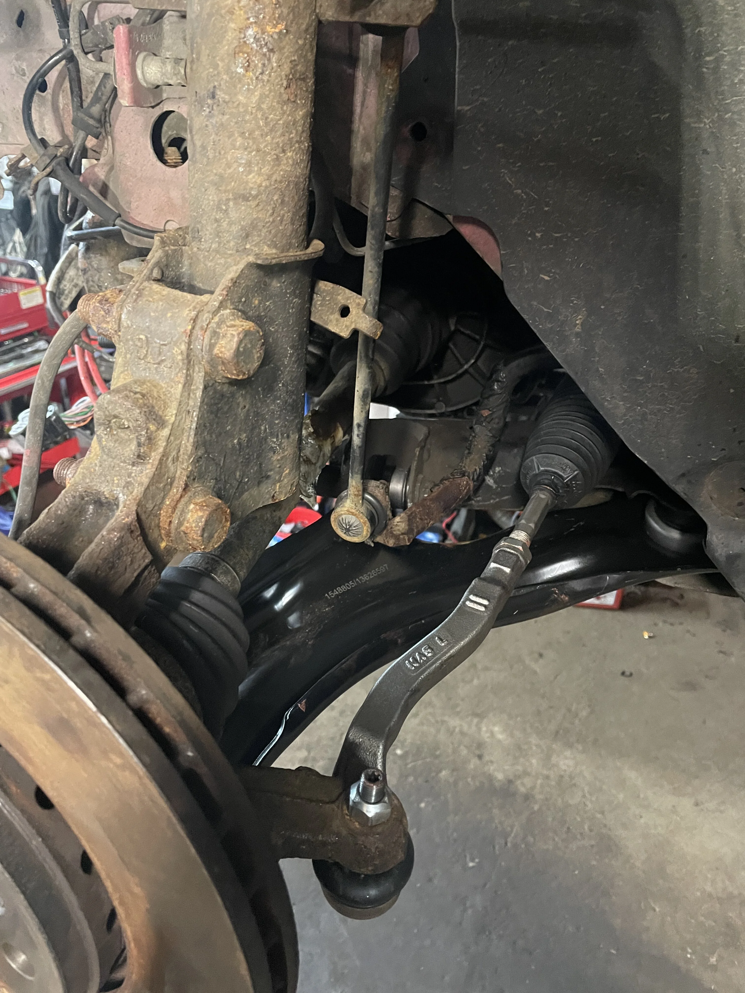

Fitted the new ties and ends and wishbones while I was at it.

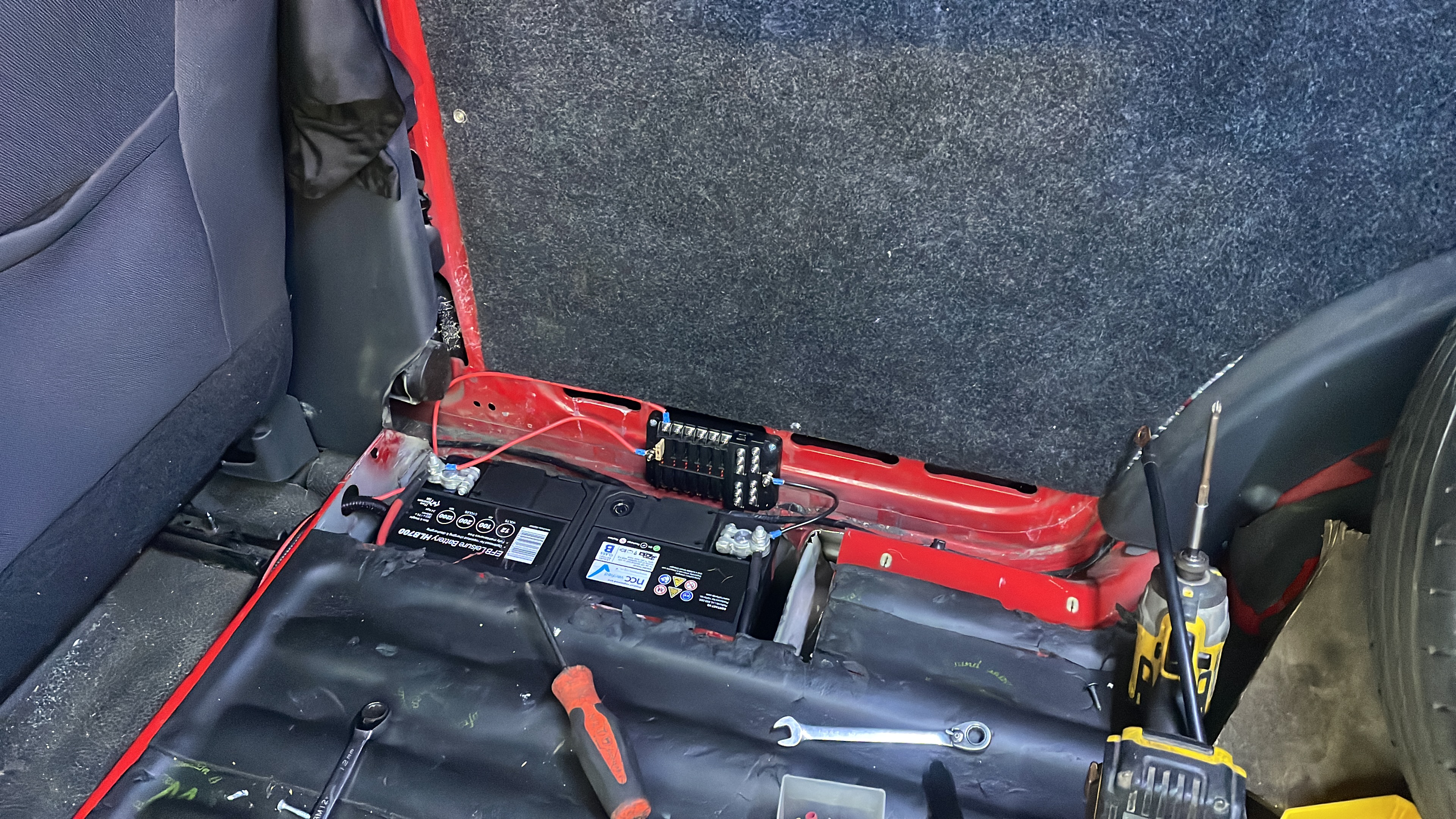

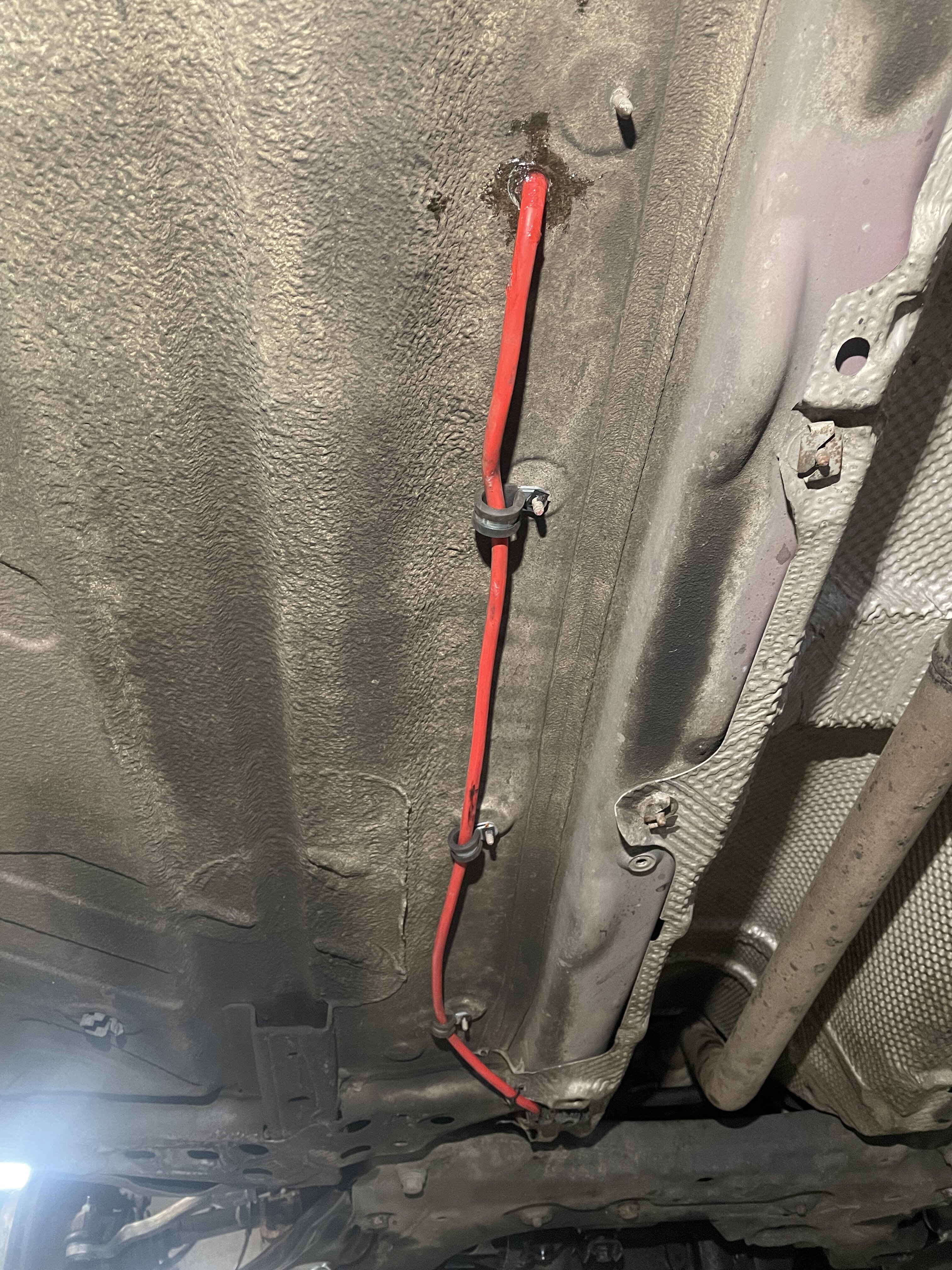

Ran the positive to the rear for my split charge / leisure battery and inverter.
Have ordered a 2000w inverter so I can run just about anything I’d need . Just doing my research on batteries at the minute as I’m not sure what I need on that front.

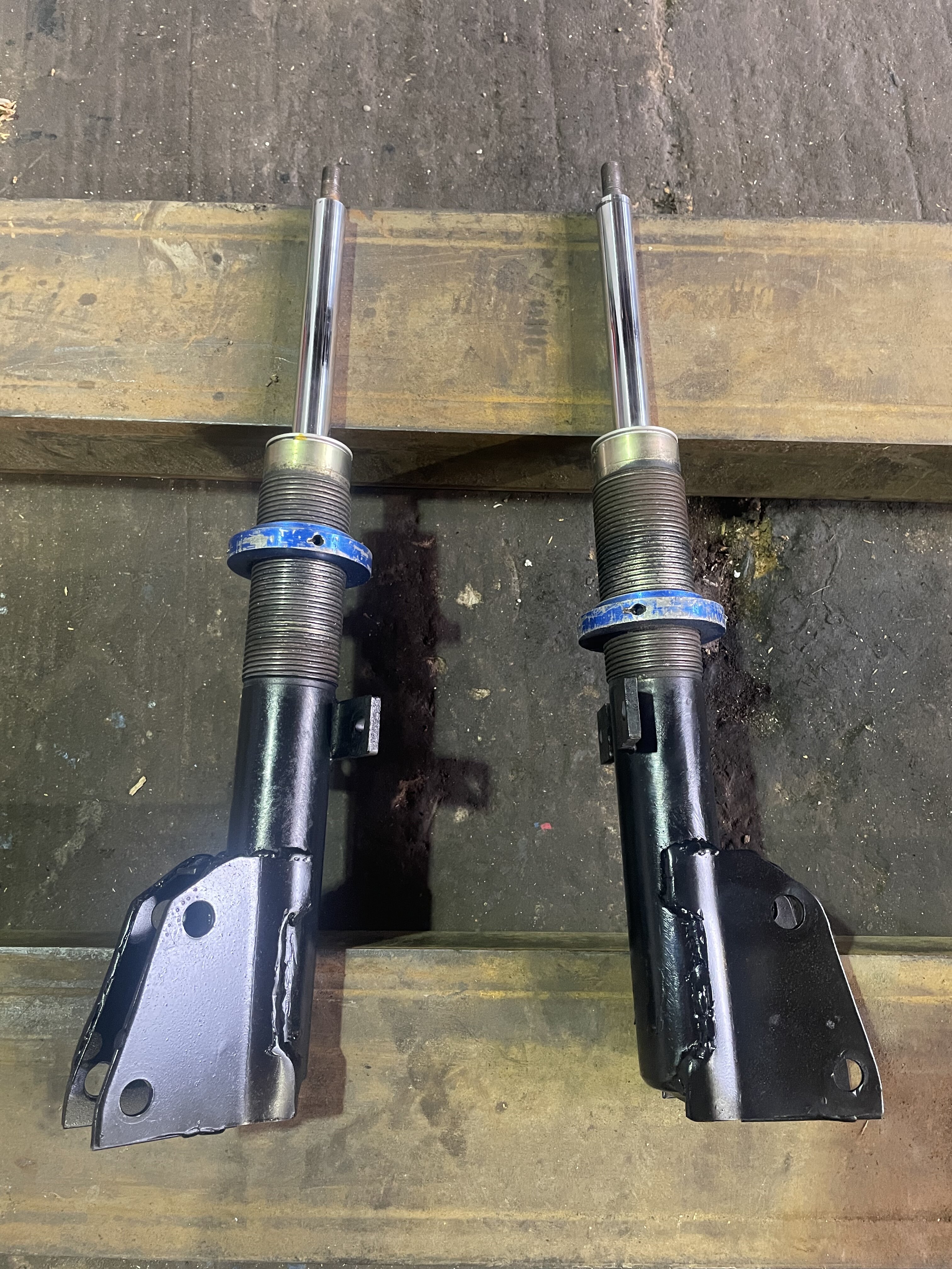

I’ve made brackets up for the coilovers just need them welded up now and I can have it aligned and motd.

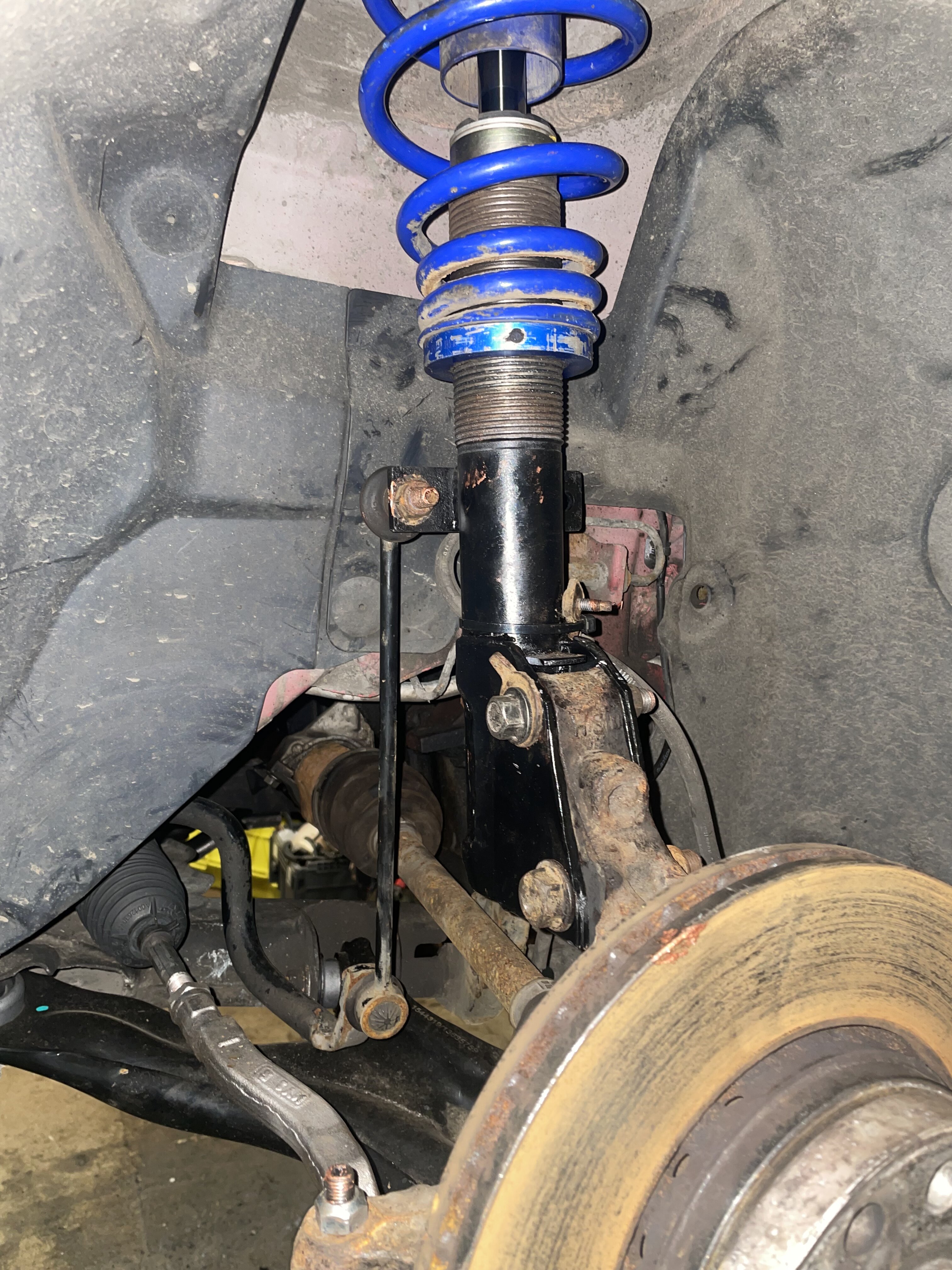

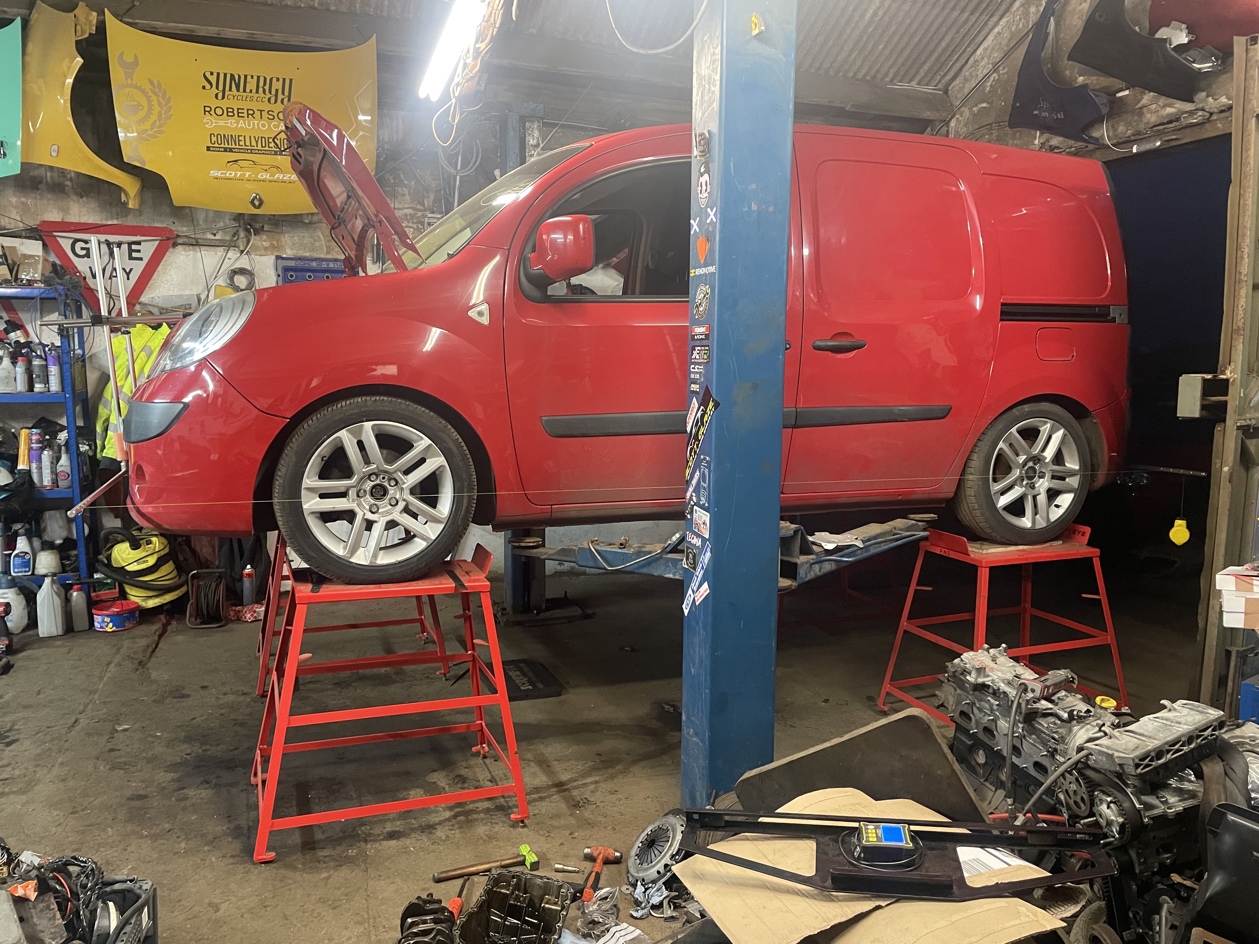

Had the coilovers welded up after making some brackets a couple weeks ago, had pencilled in a few hours after work to have a go at setting things up and having a check over it before it’s MOT next week.

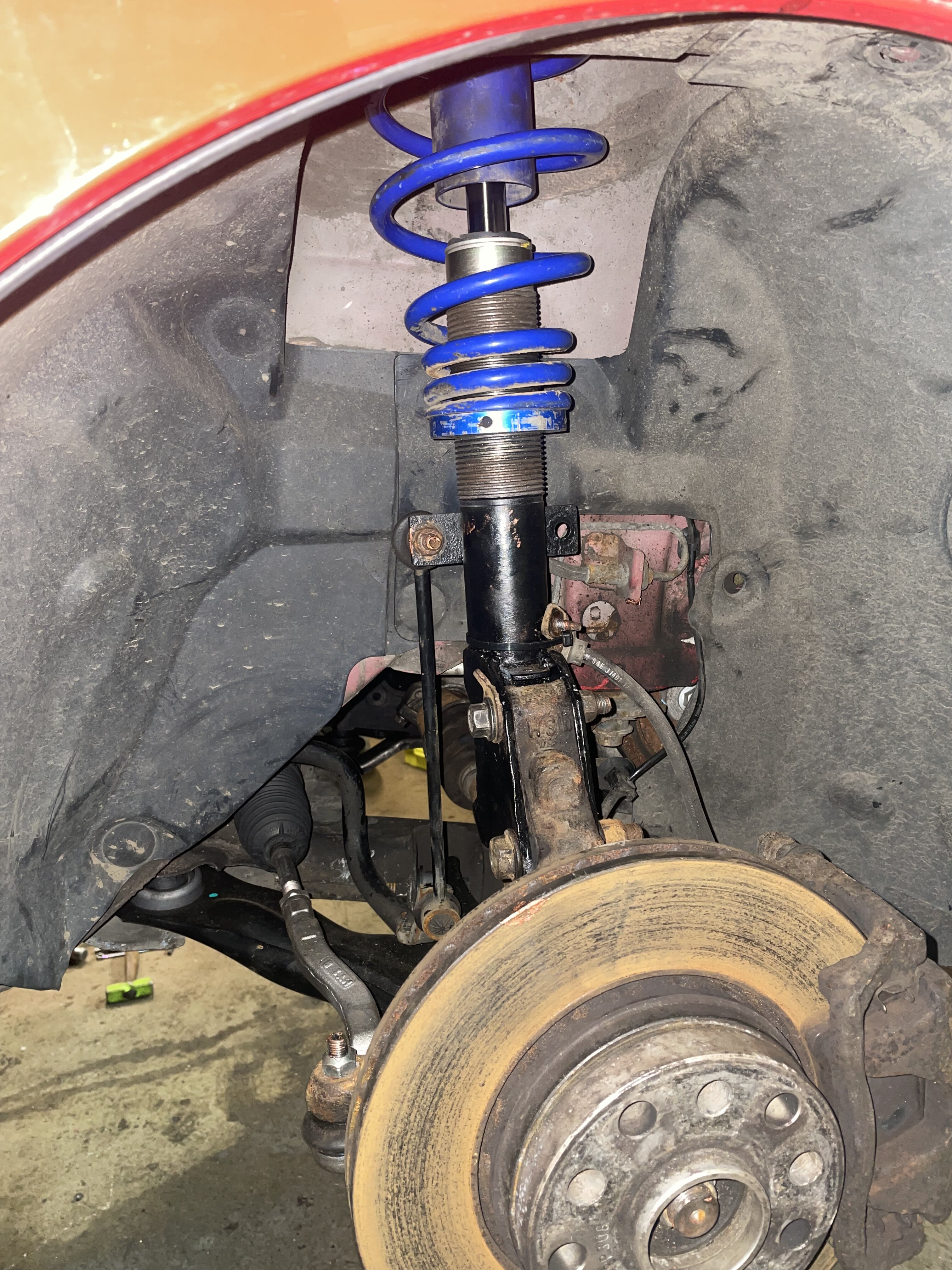

Coilovers on and camber bolts fitted. I have a set of shorter drop links here if needed but it’s seeming like the standard links are ok for now.

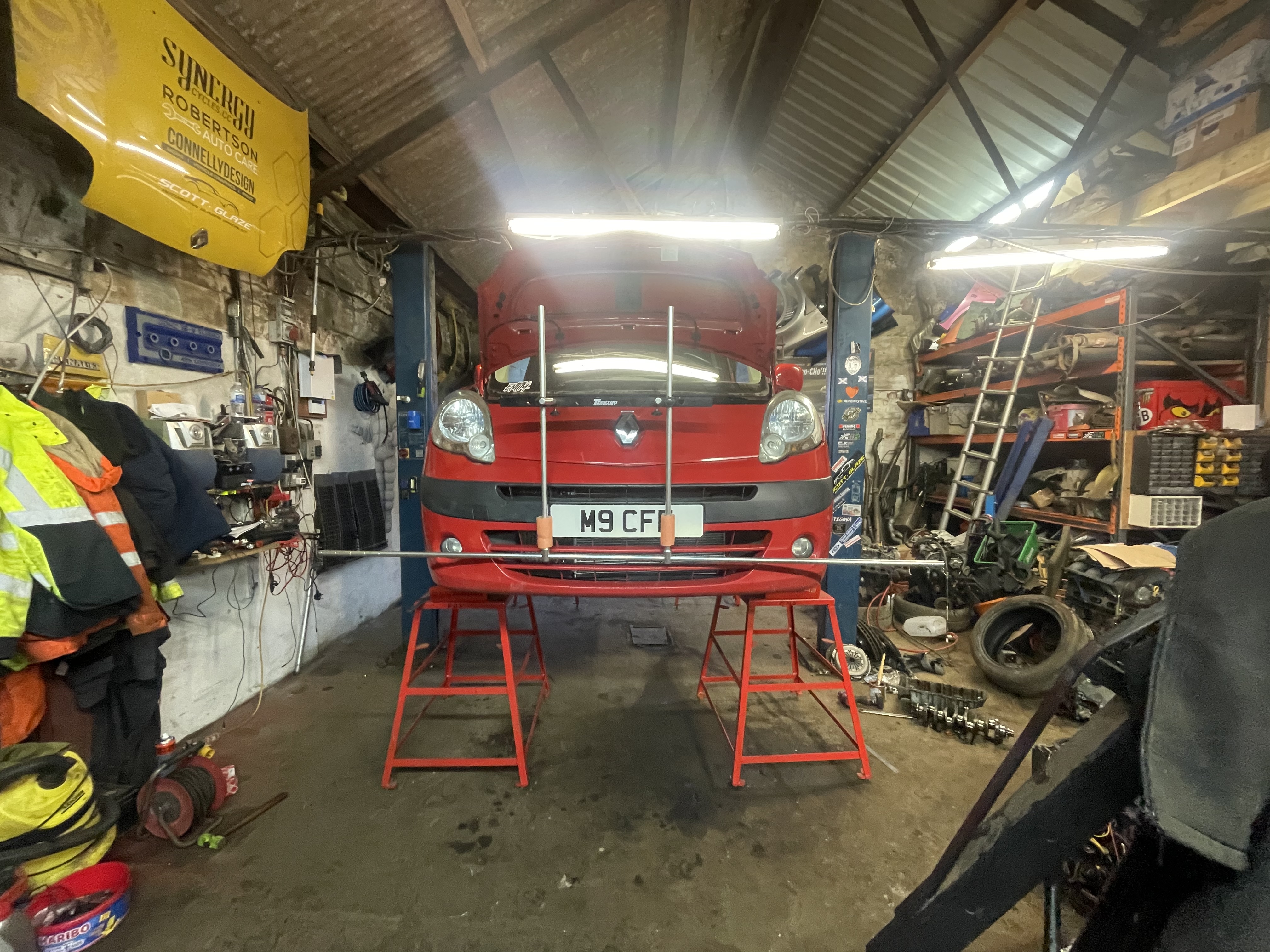

Had a good hour or 2 sorting the alignment and camber out with everything being new it was way out. But drives straight and the steering wheel is Bob on as well.
Couple little niggles to sort out before MOT just daft things I’ve forgotten to plug the wipers and 1 fog light back in. But fingers crossed it will get through as it’s now as good as it has ever been.

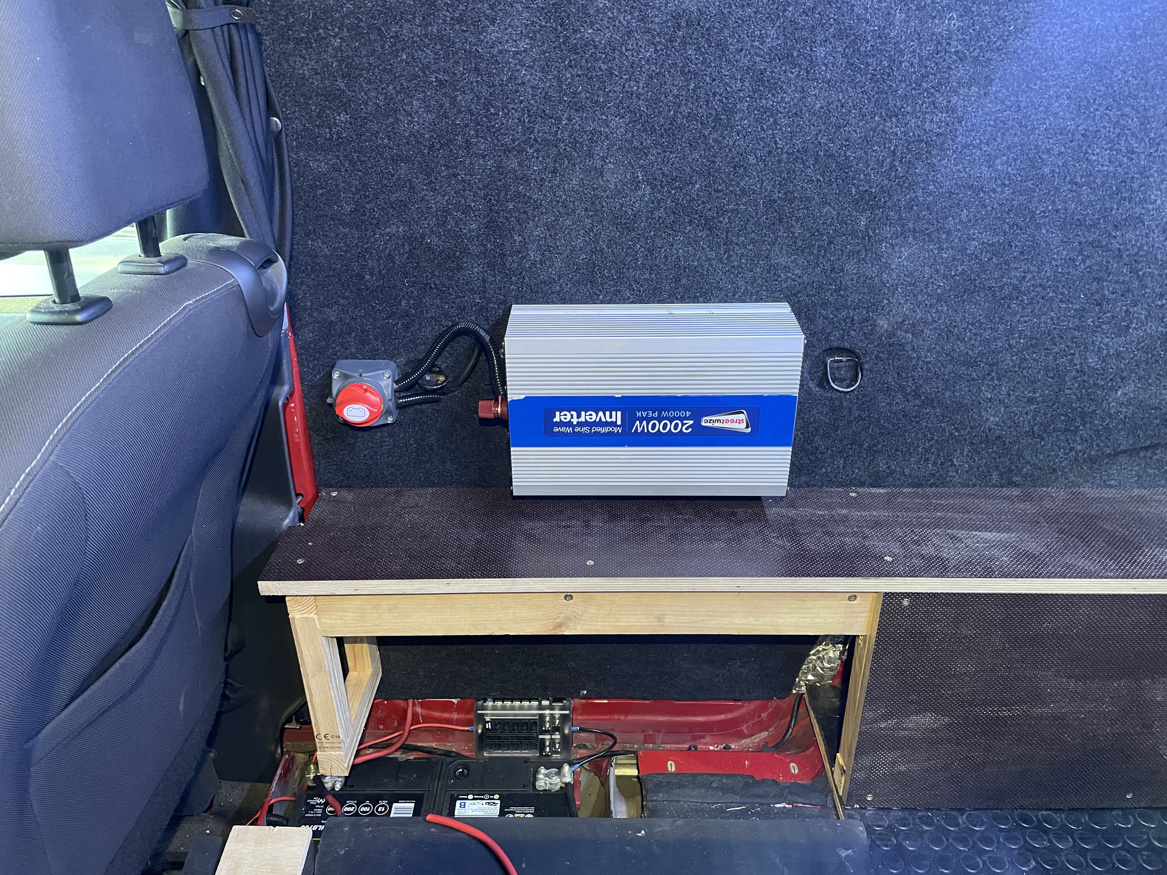

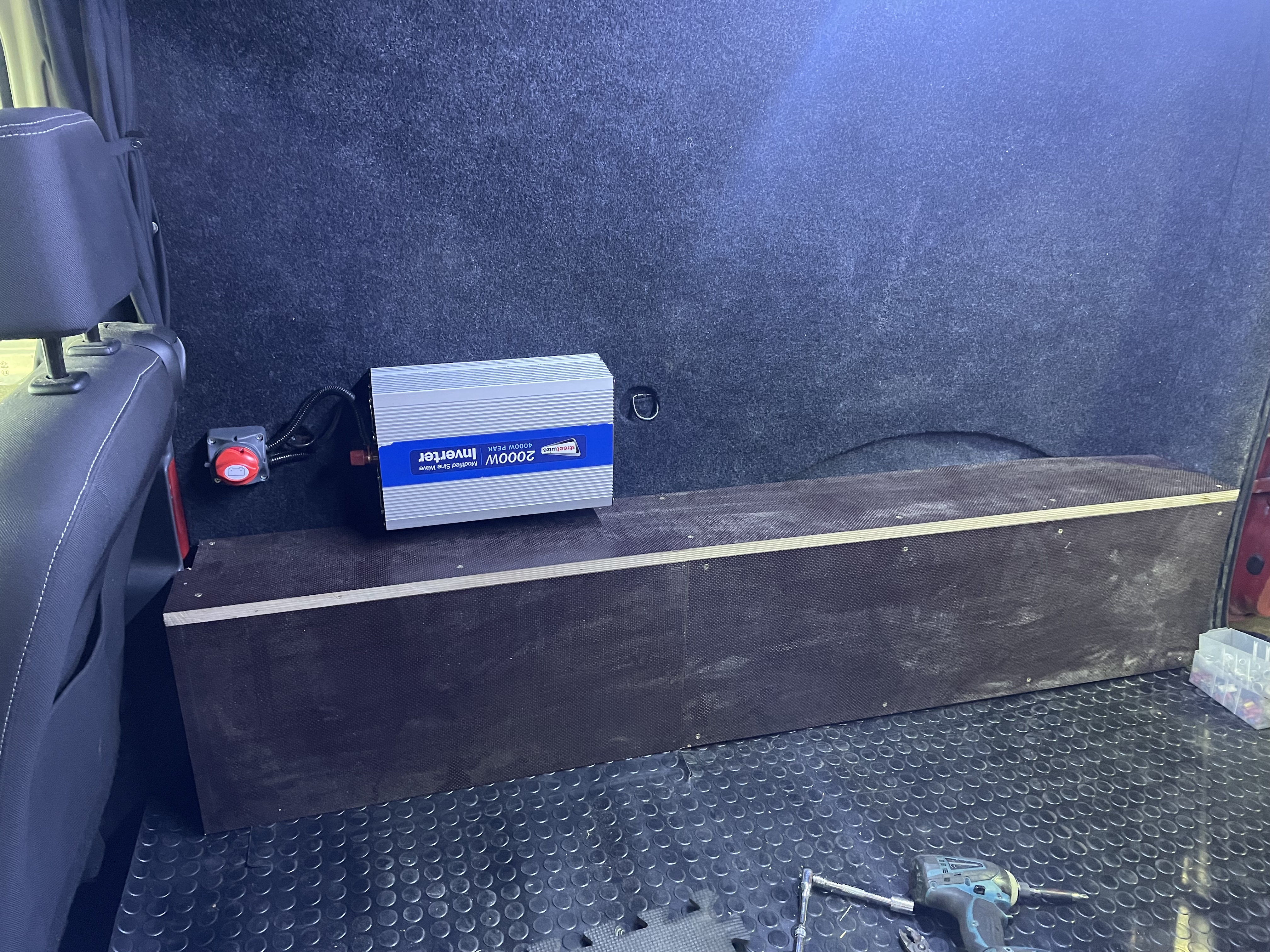

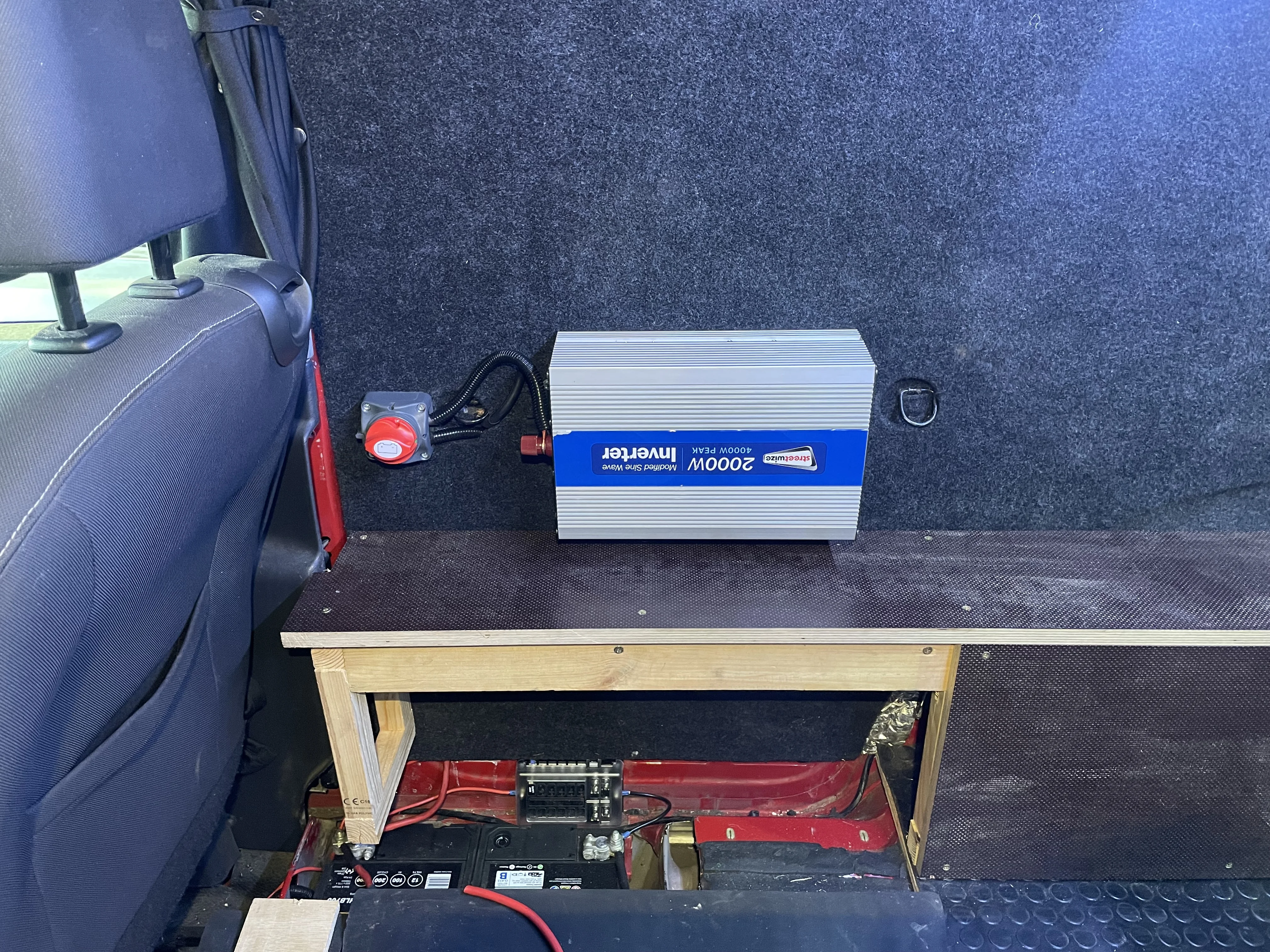

Wired in a leisure battery / split charge / grounding block and 2000w inverter.

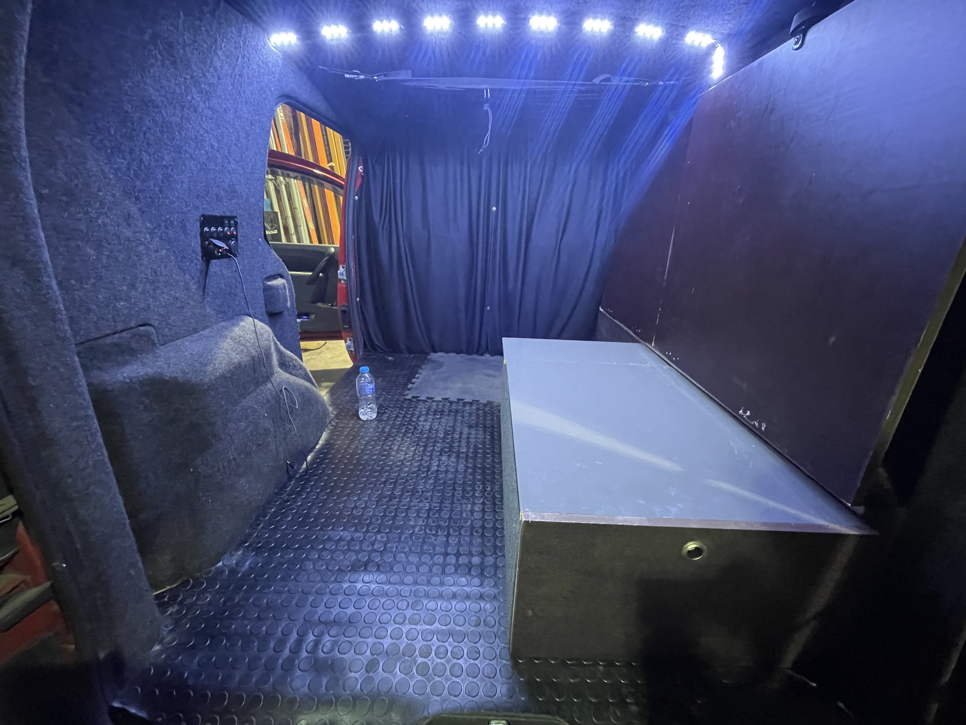

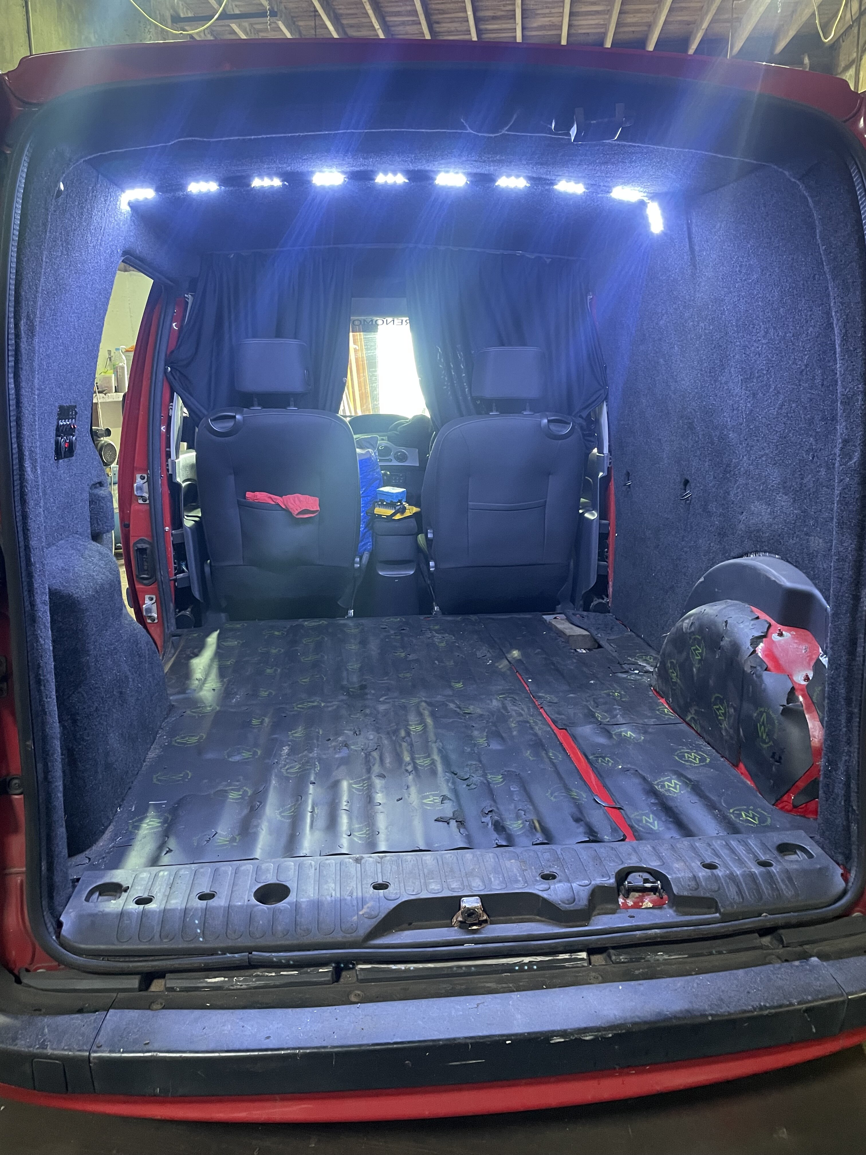

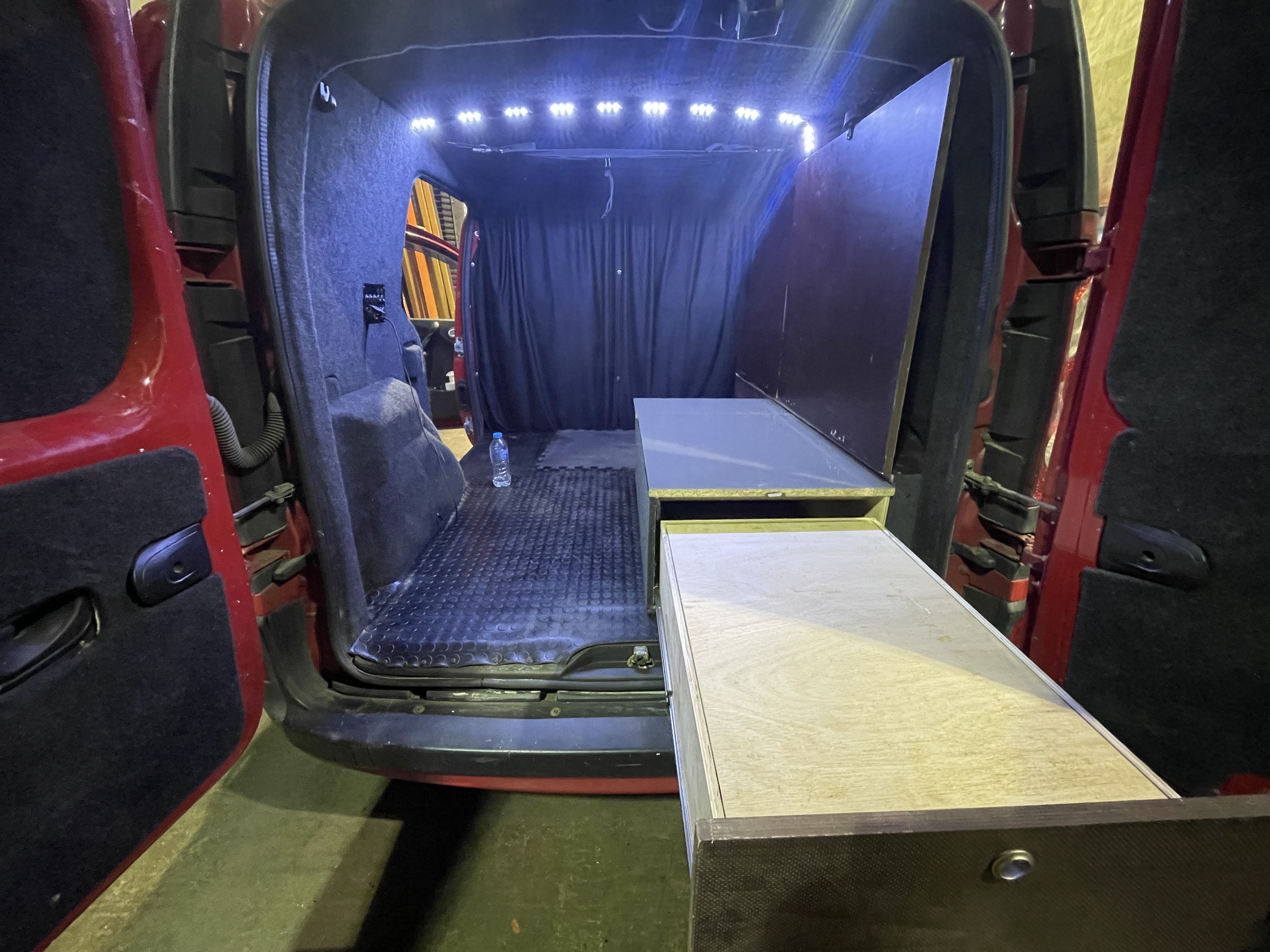

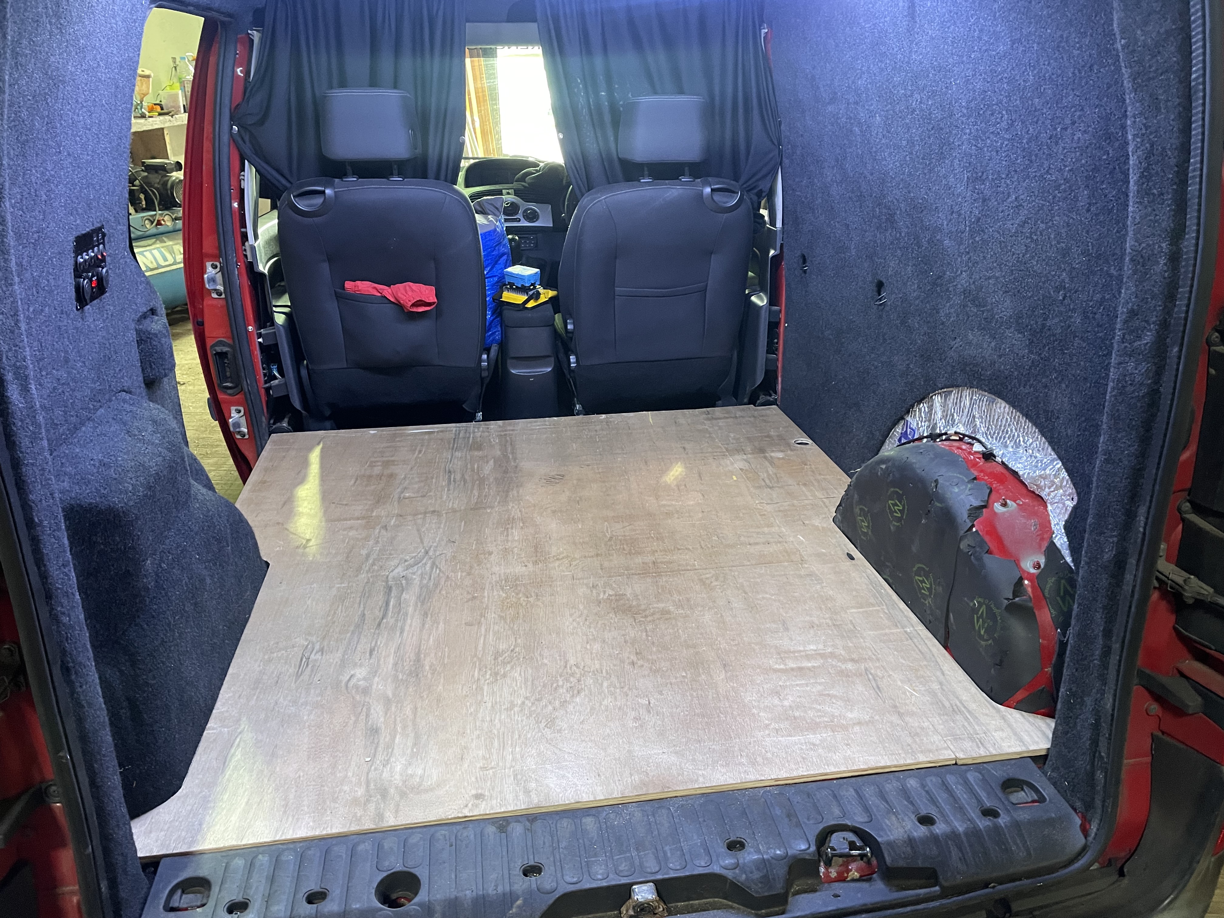

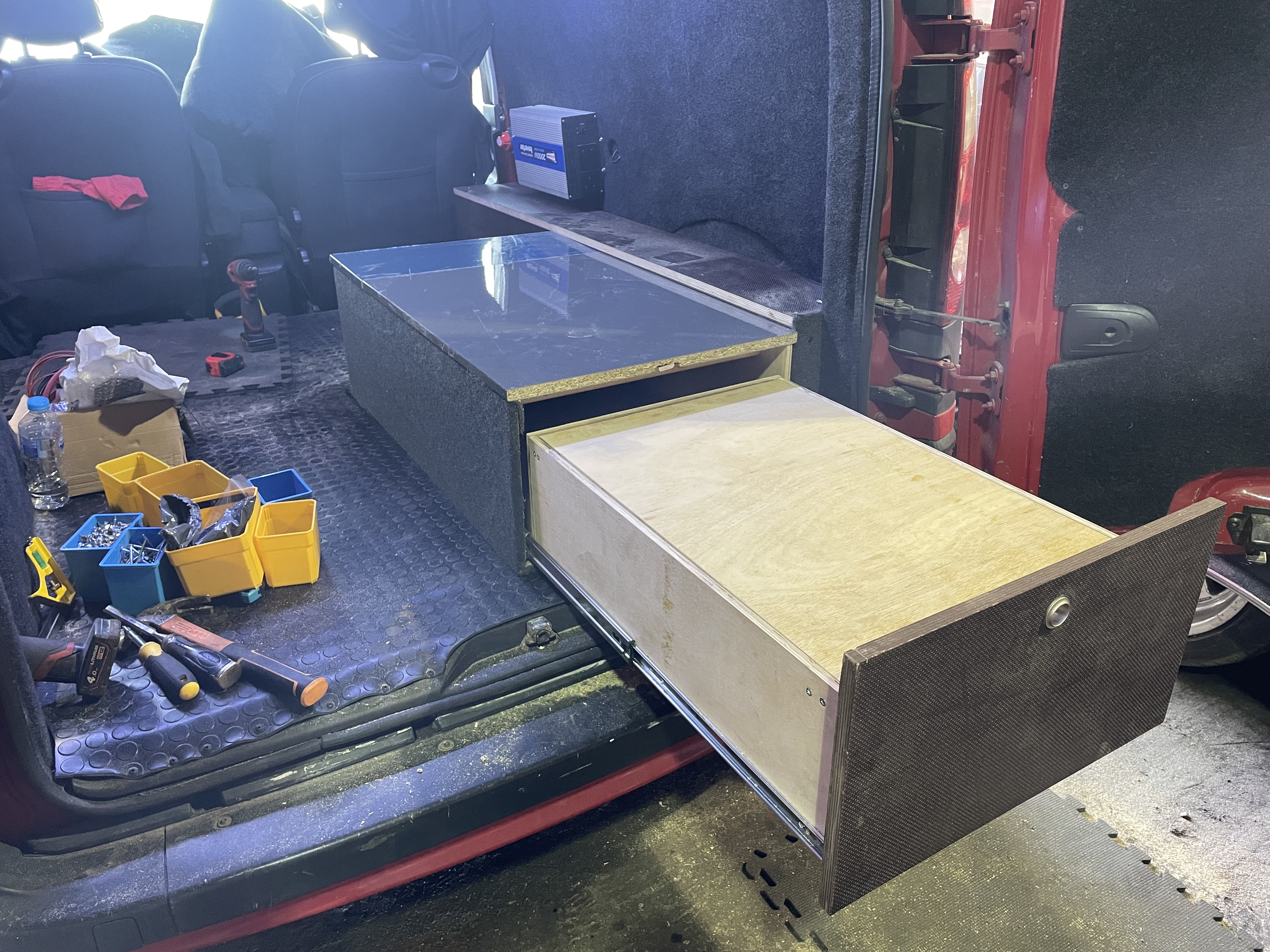

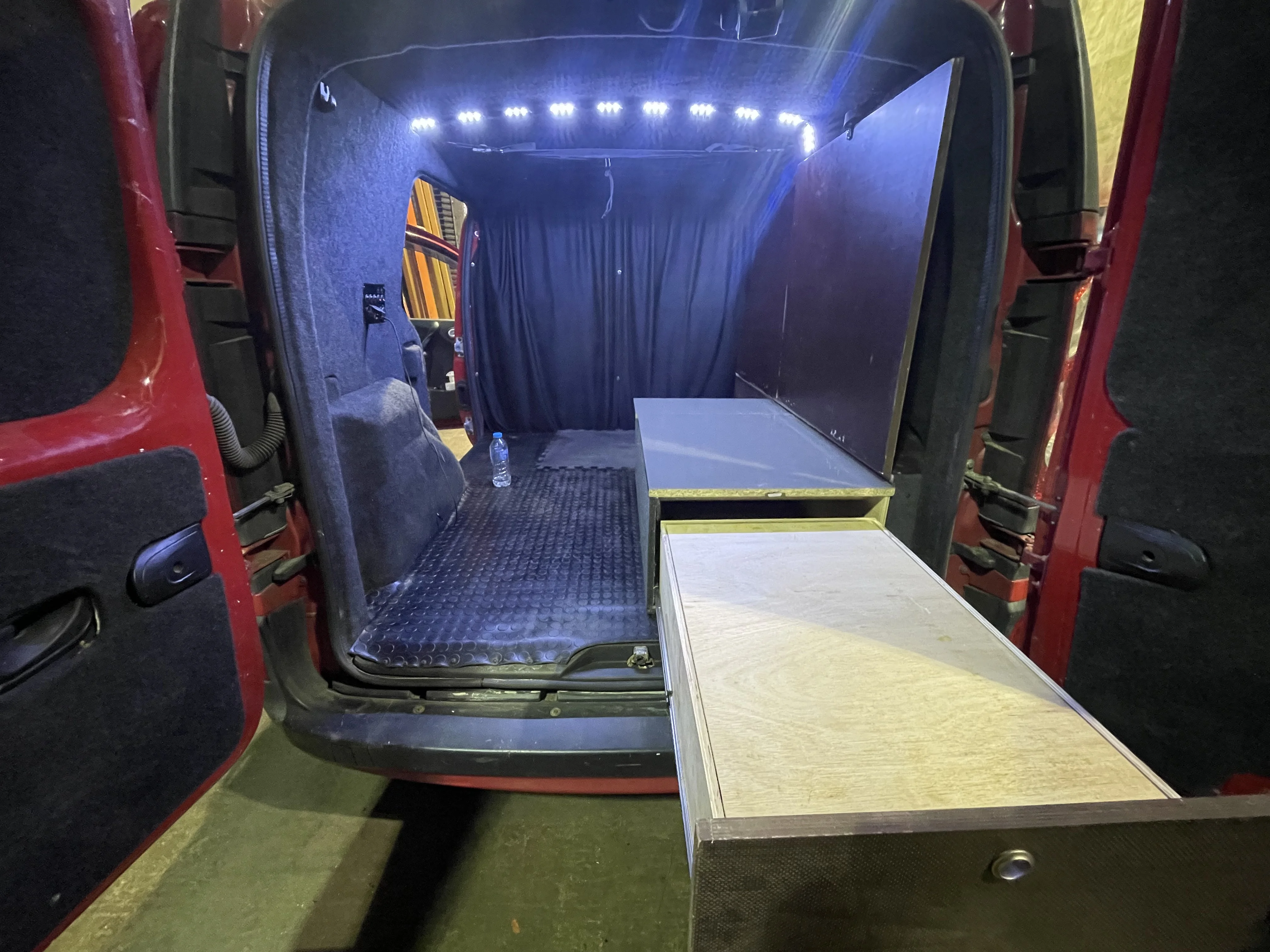

The kangoo having a flat floor welded over where the rear passenger footwell would be I decided to use some of the space for the electrical gubbins.

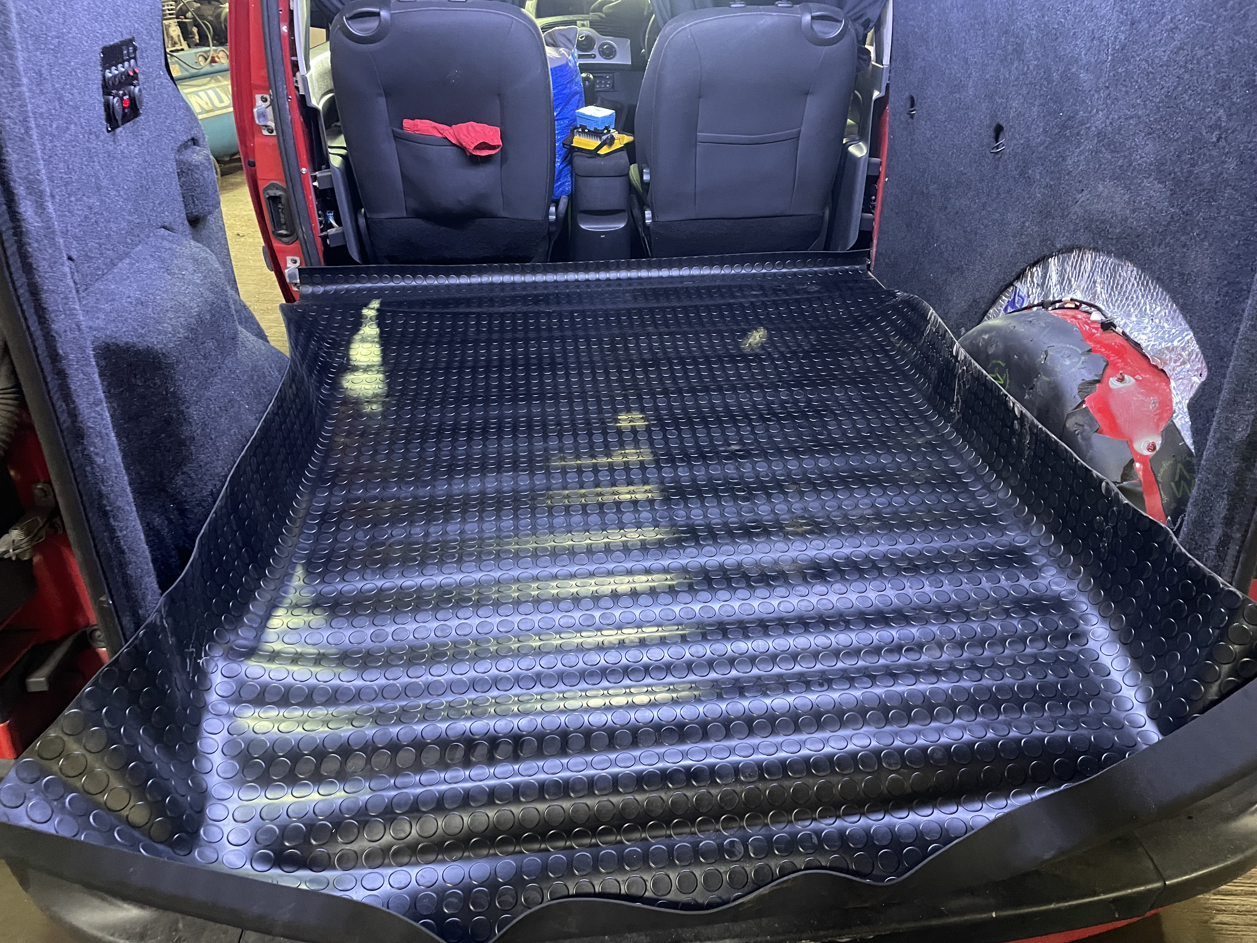

Cut in a new plywood floor, covered in rubber matting. Ideal for when it’s being used as a normal van.

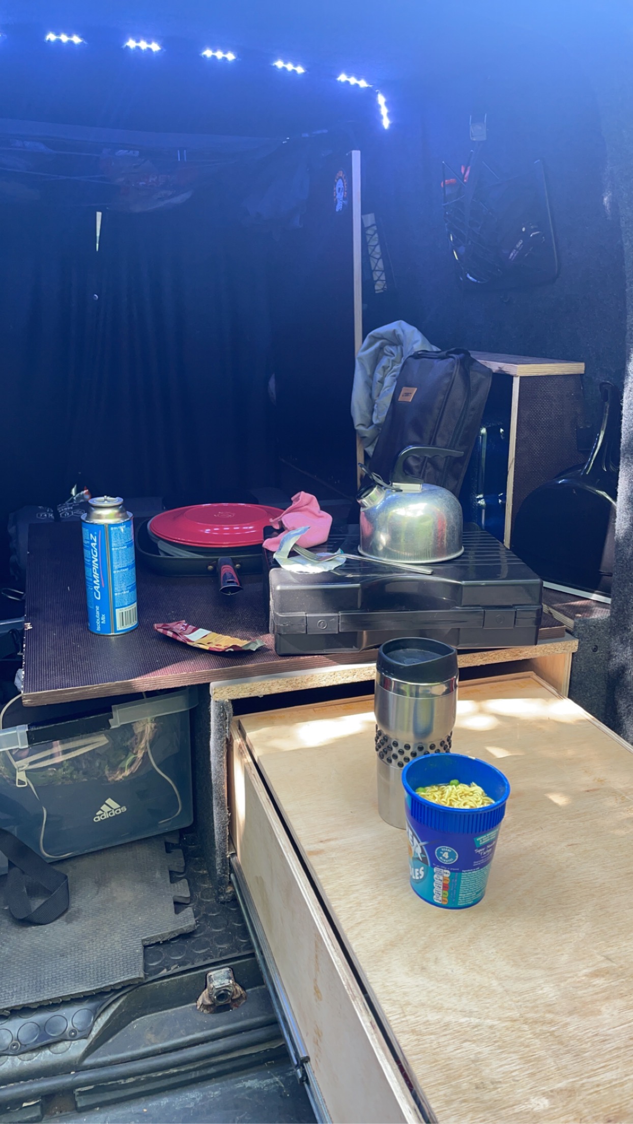

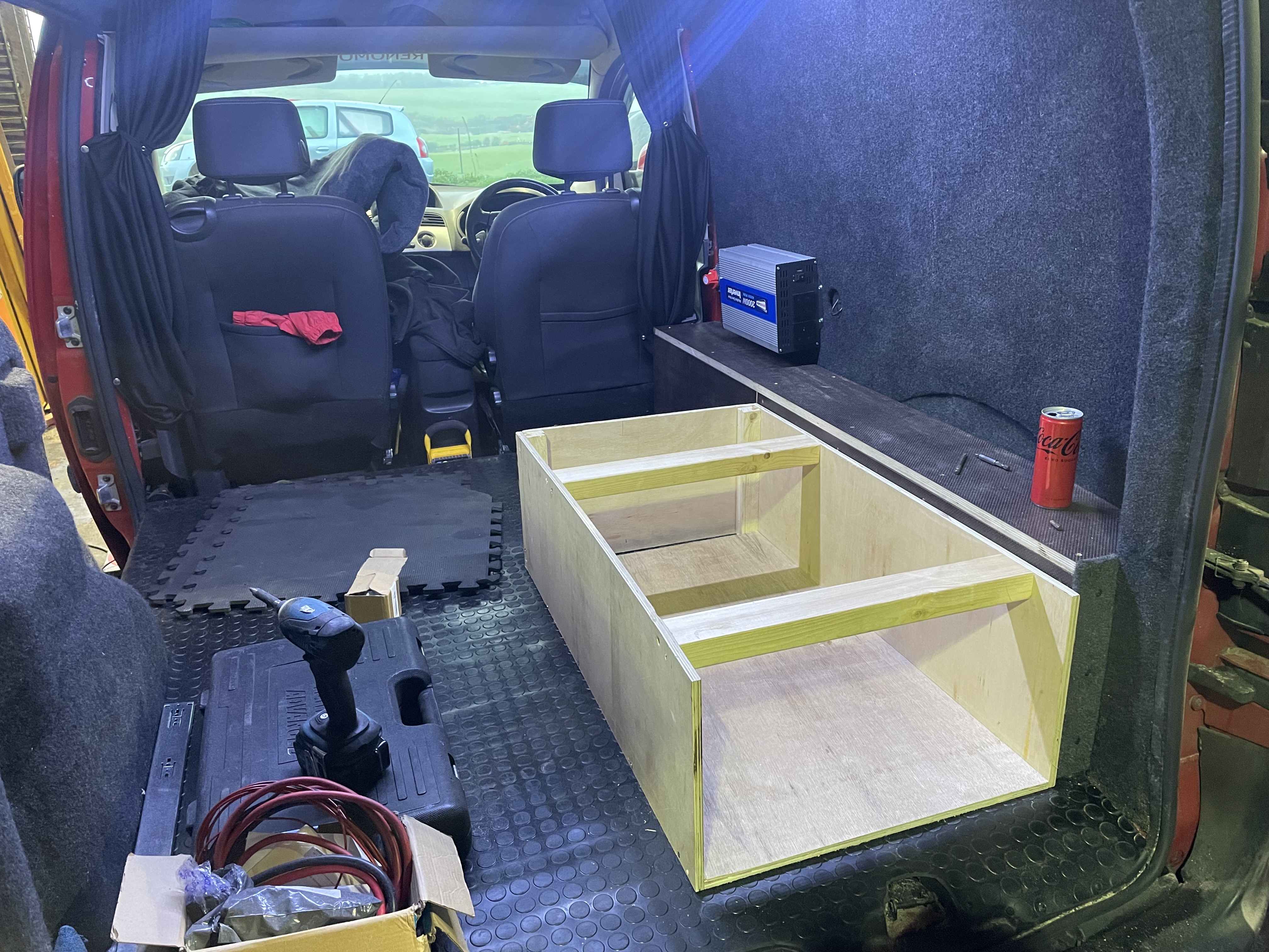

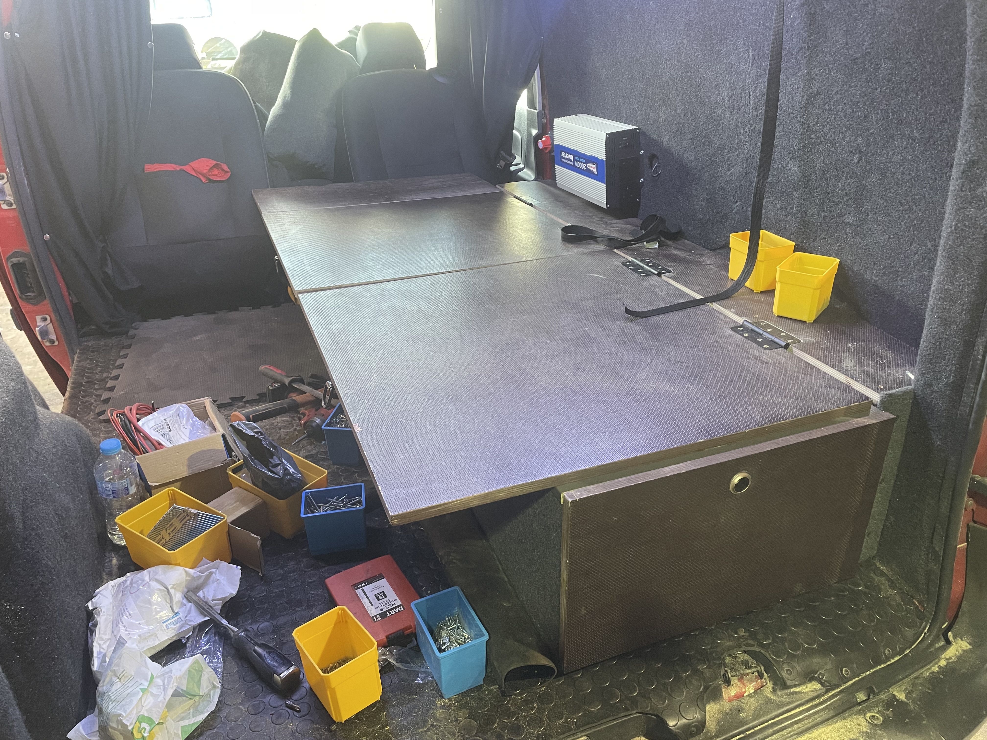

Started on the bed area and placement for inverter and cut off. Trying to use every bit of available space as it’s a tiny van.

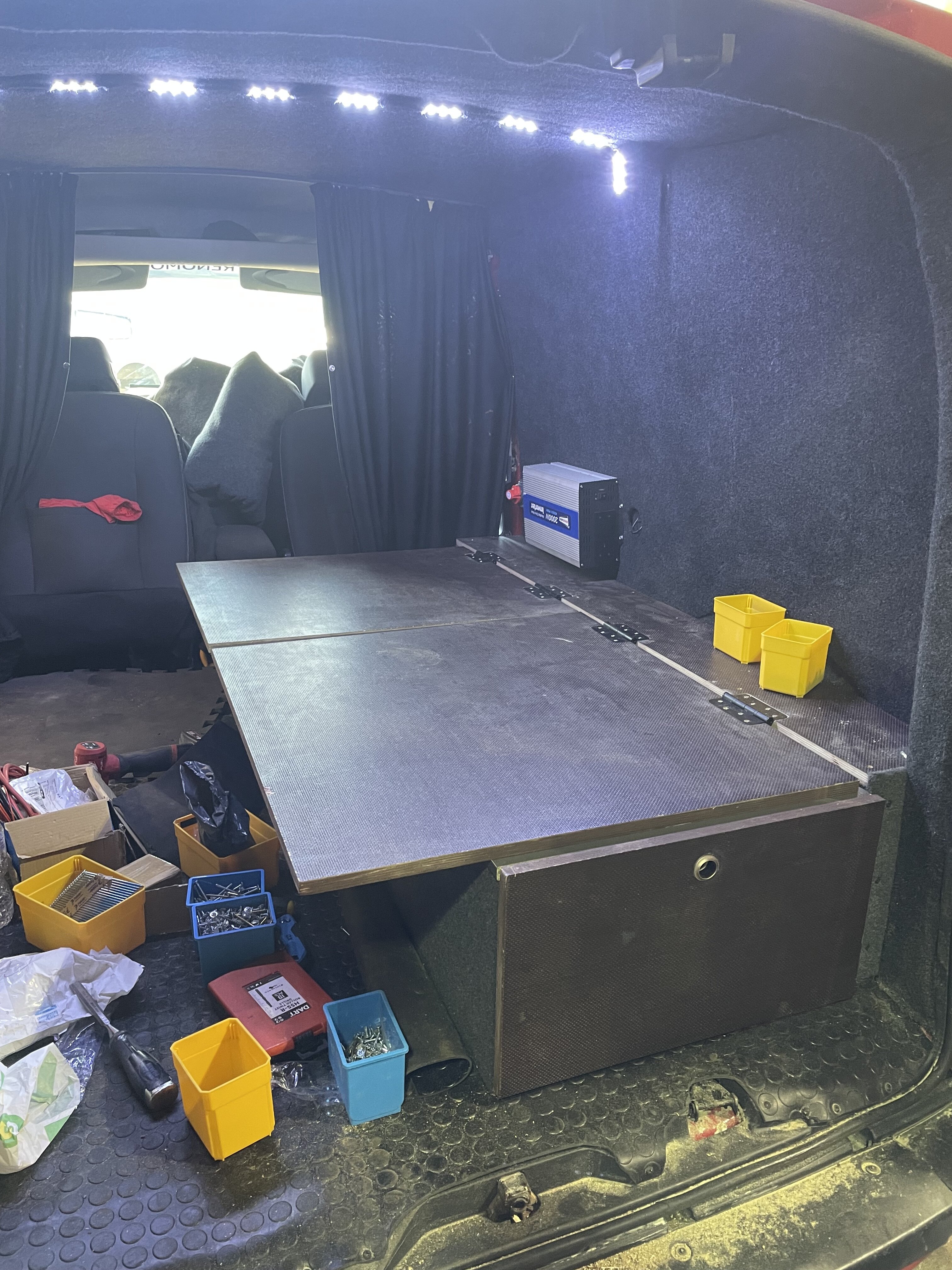

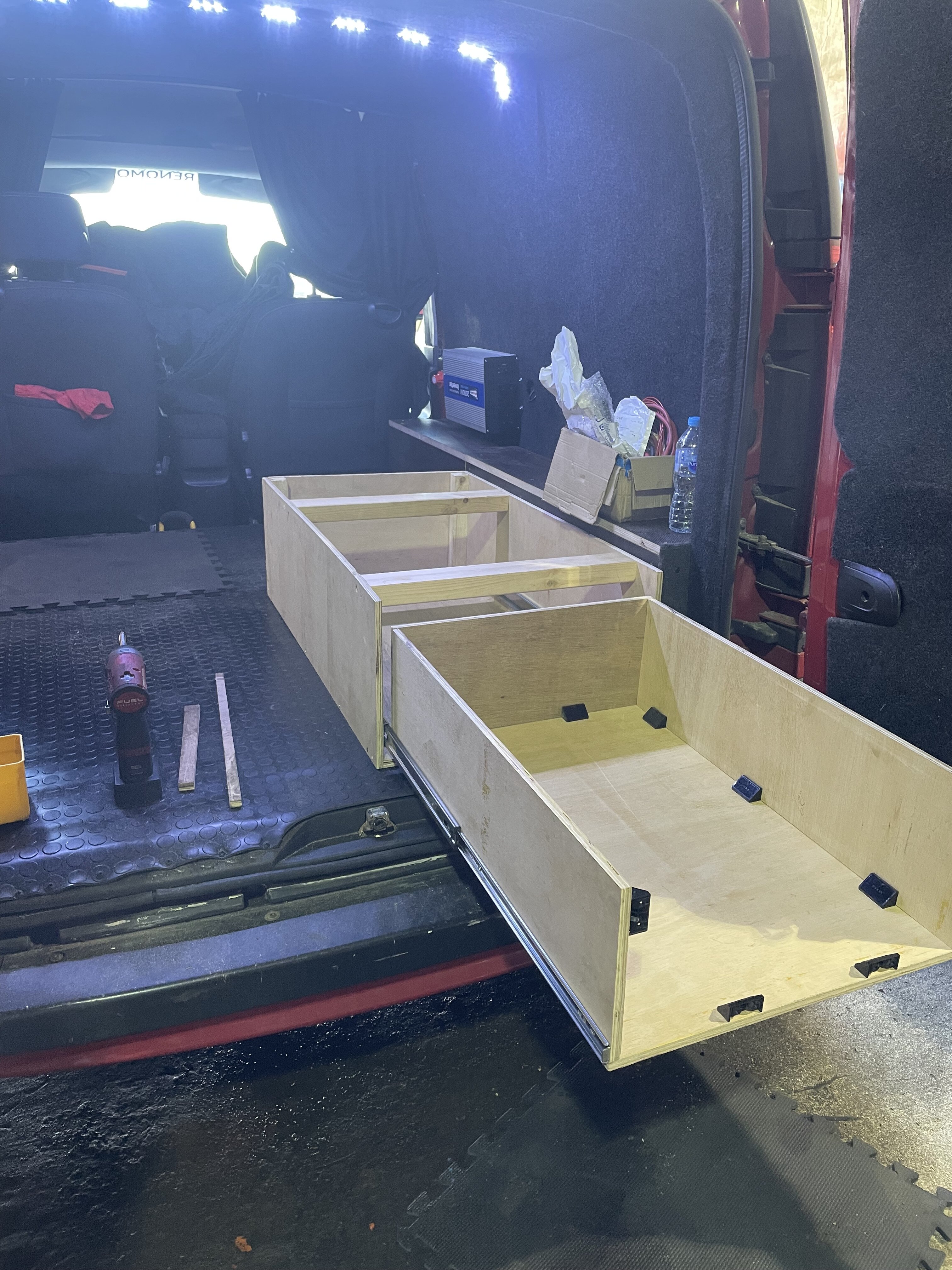

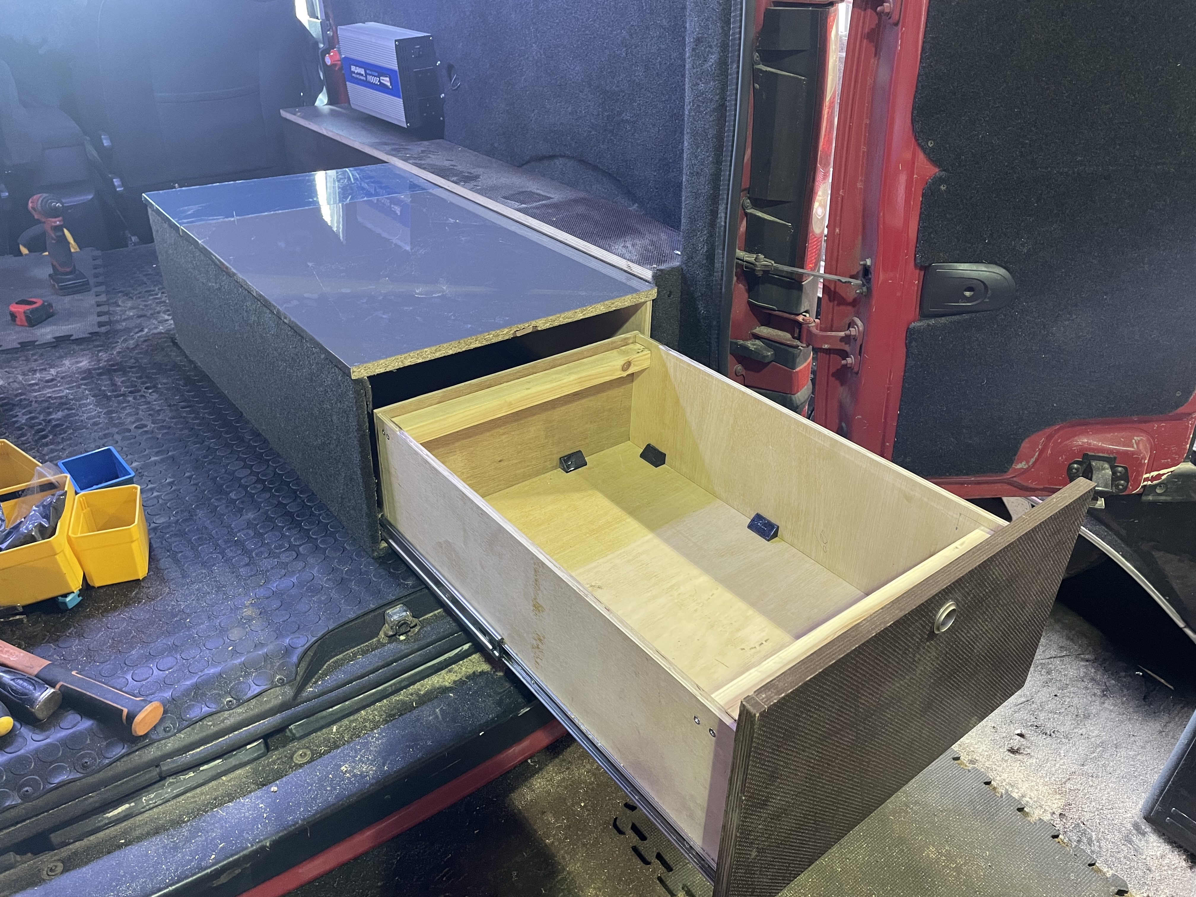

Continuing on, started building out a “removable” storage cupboard and drawer for cooking. Easily removable and fire it in the shed when I’m using this as a normal van.
Continued…

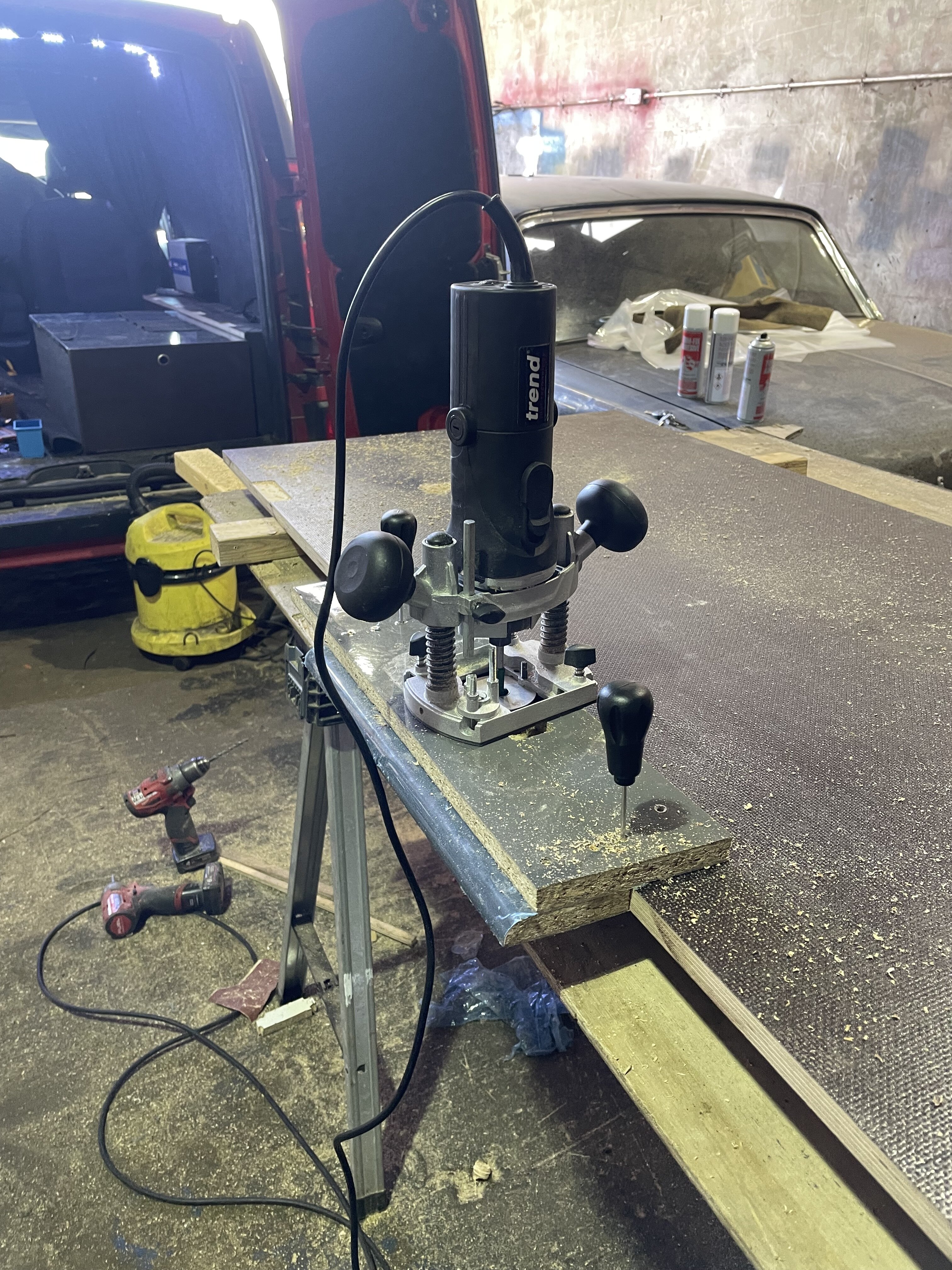

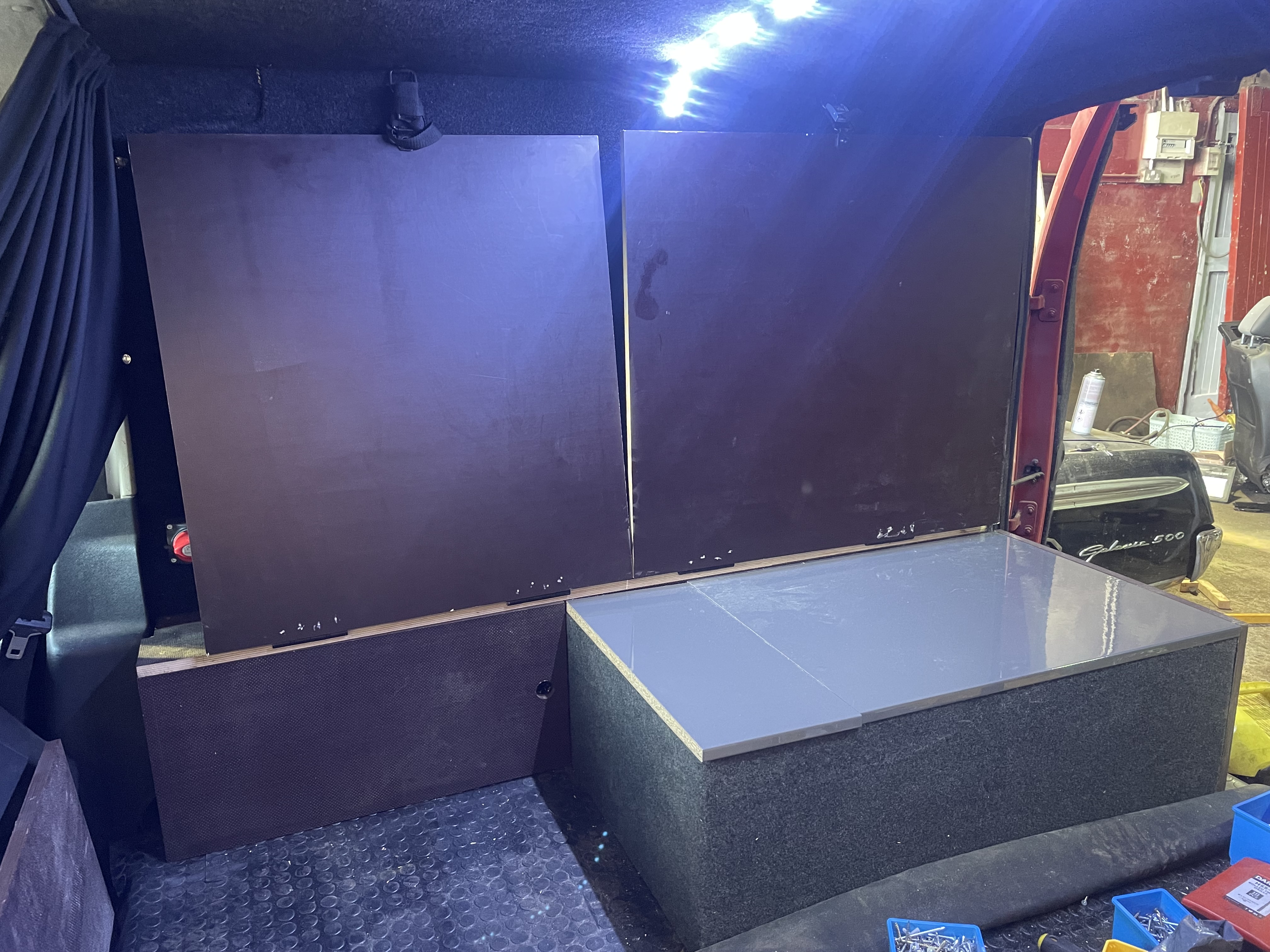

Made up my own jig for routing in hinges.

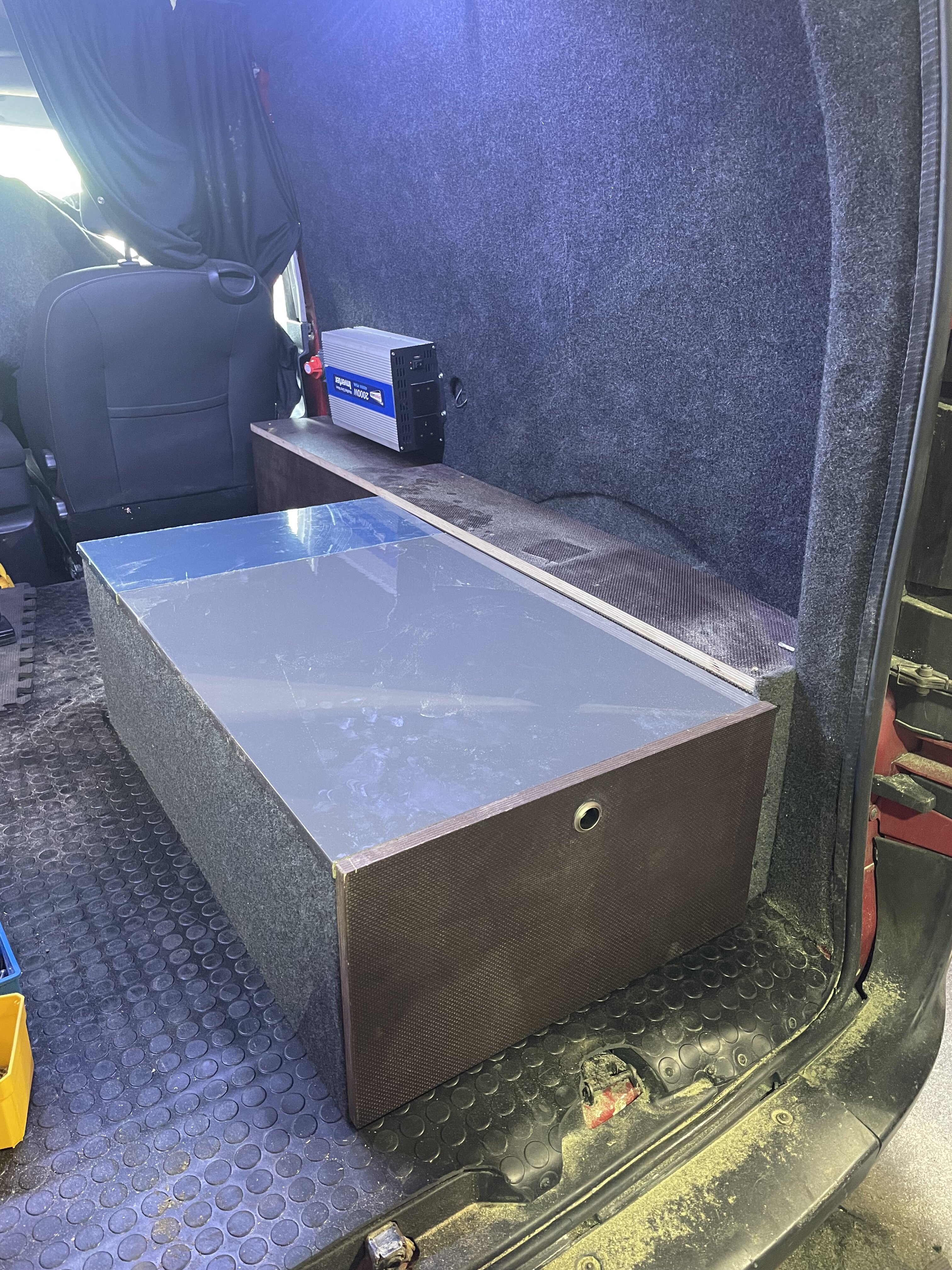

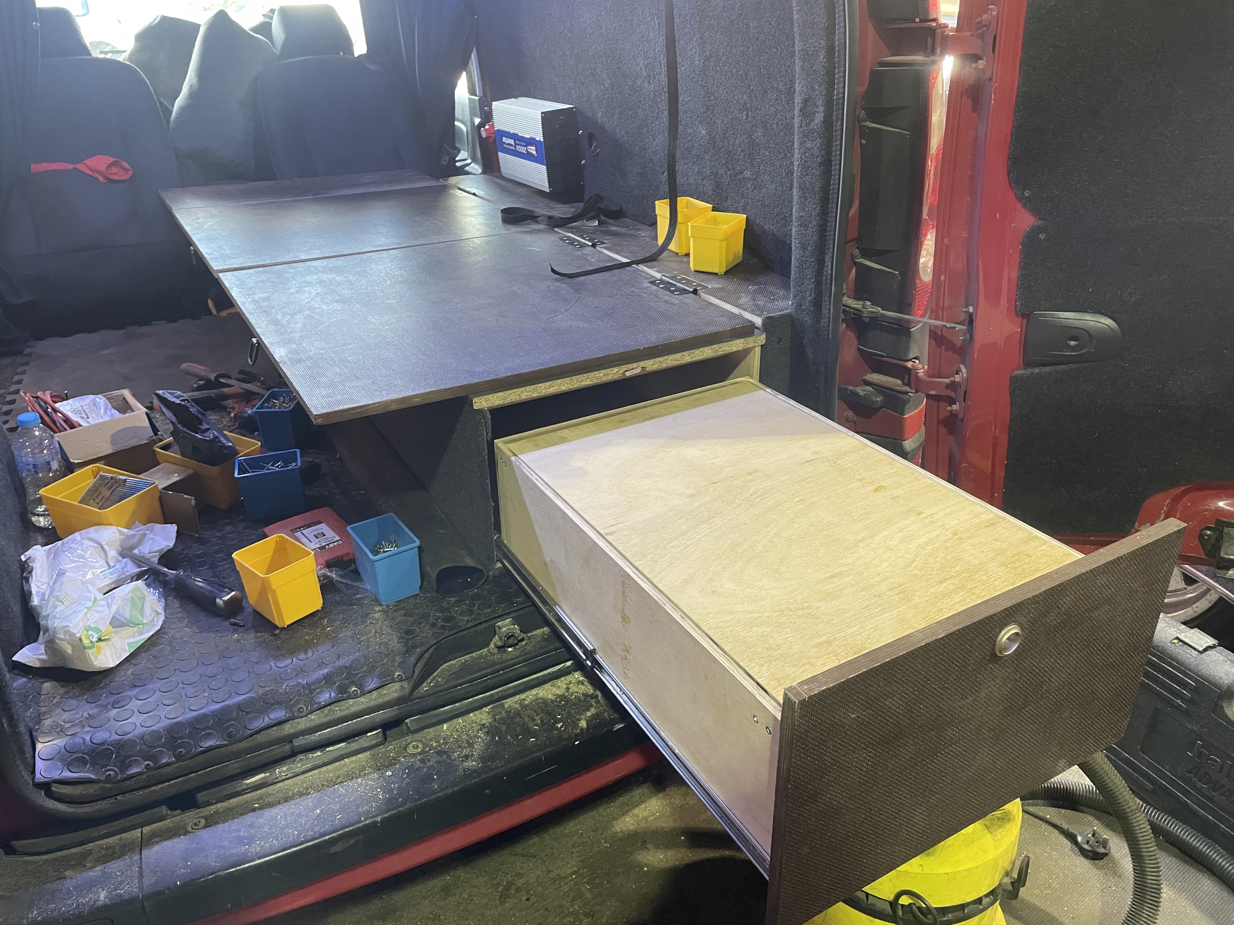

Making a fold down bed that comes down in sections so I can use part of it to sit on, ideal for saving space.
Folded away:
I still have another section that folds down into the drivers section when the seats are forward I’m just waiting on a piano hinge for this coming. When all folded out it gives me 6ft of bed.

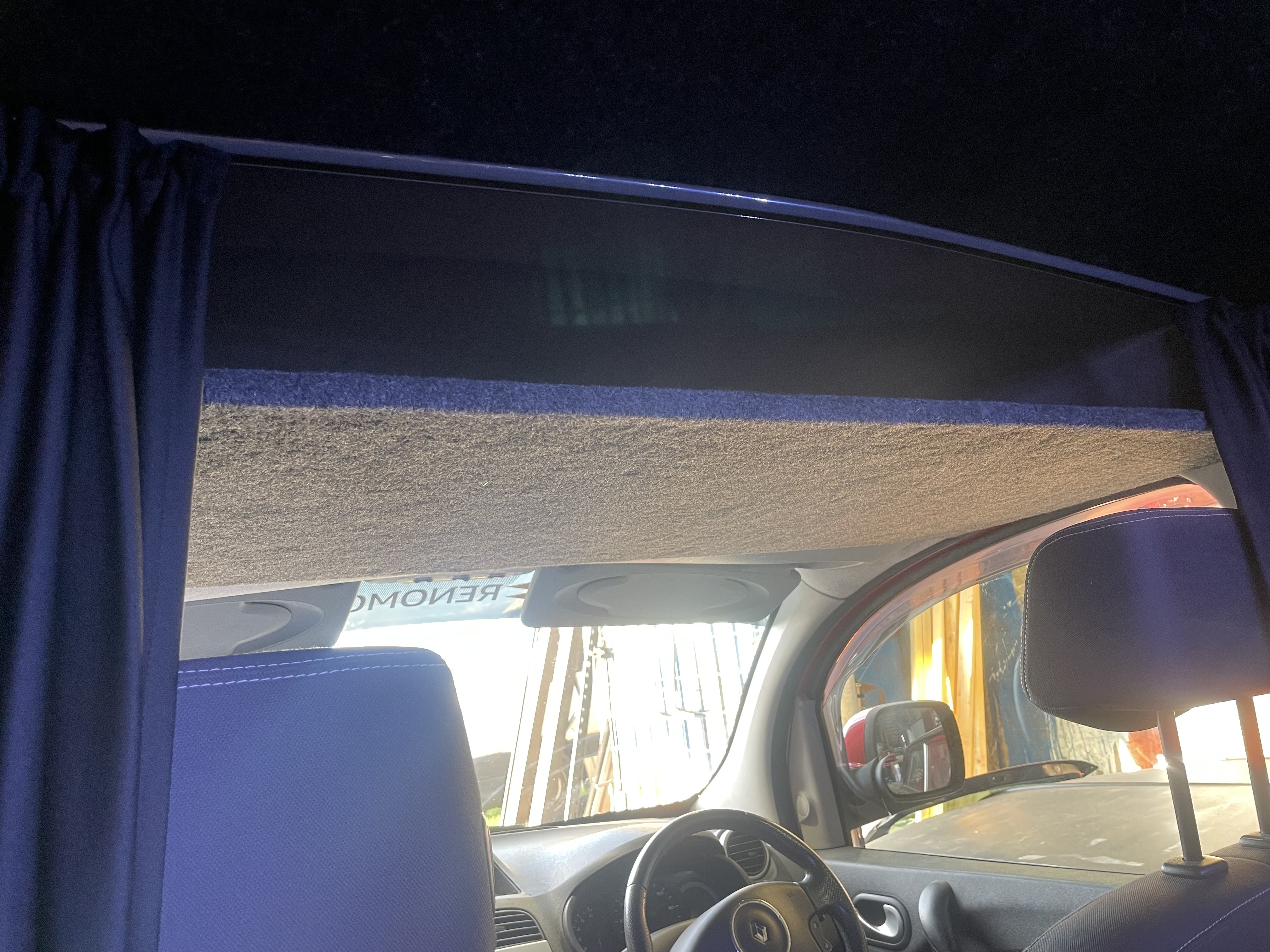

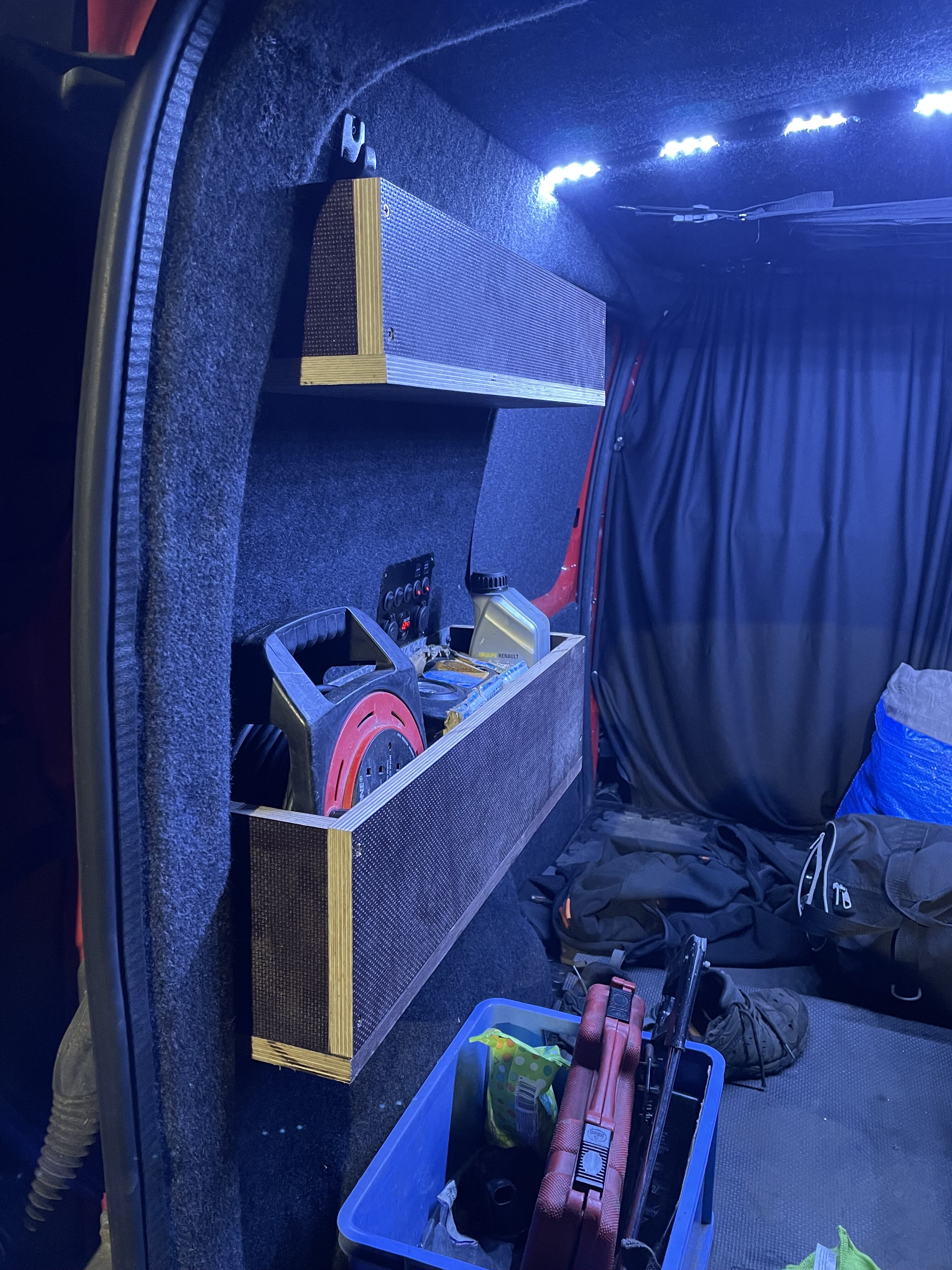

Made a storage space above the cabin just for storing clothes and odds and ends.

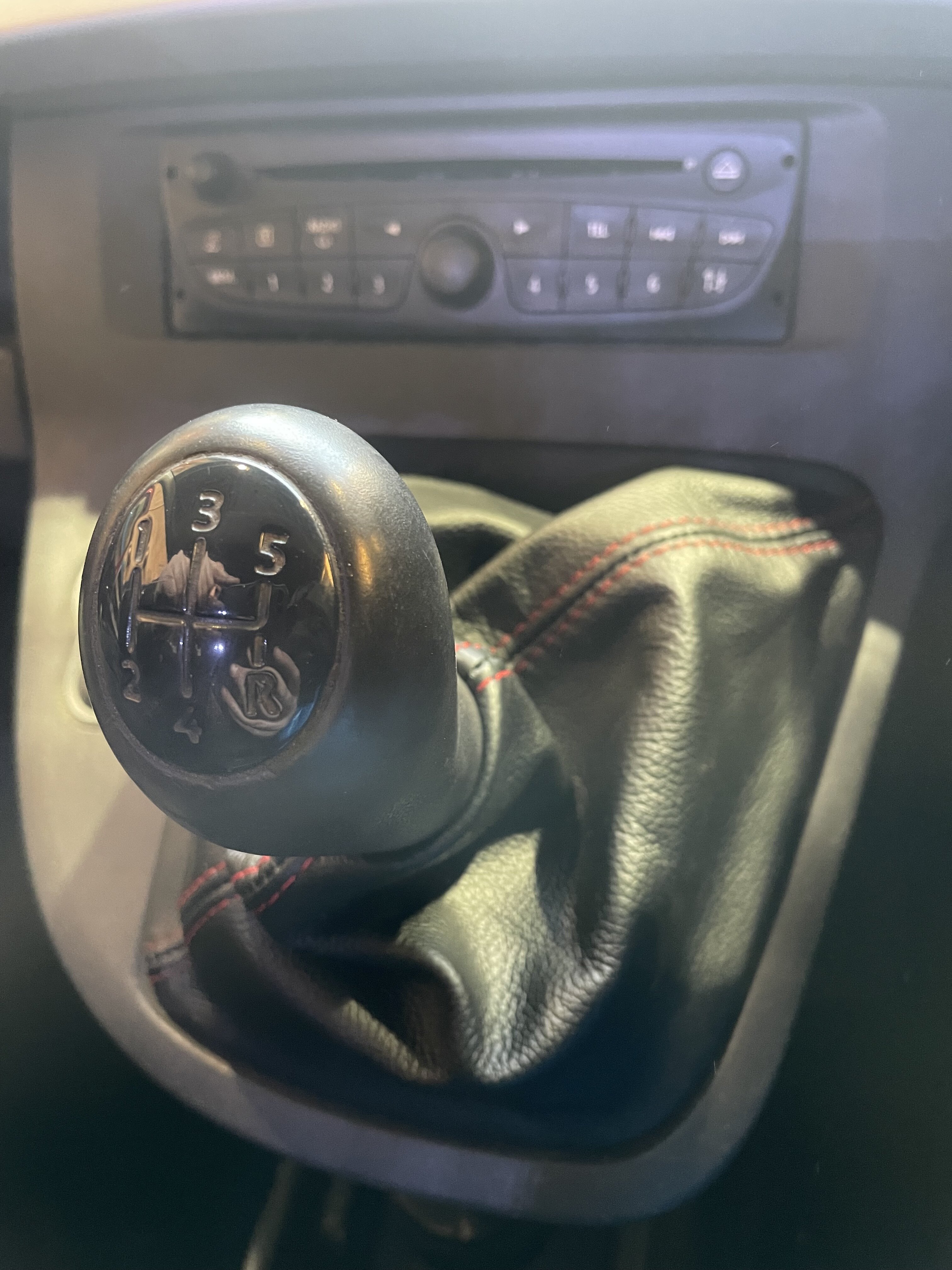

Re trimmed leather with red stitching gear gaiter, wouldn’t have really bothered with this however the standard one was totally haggard.

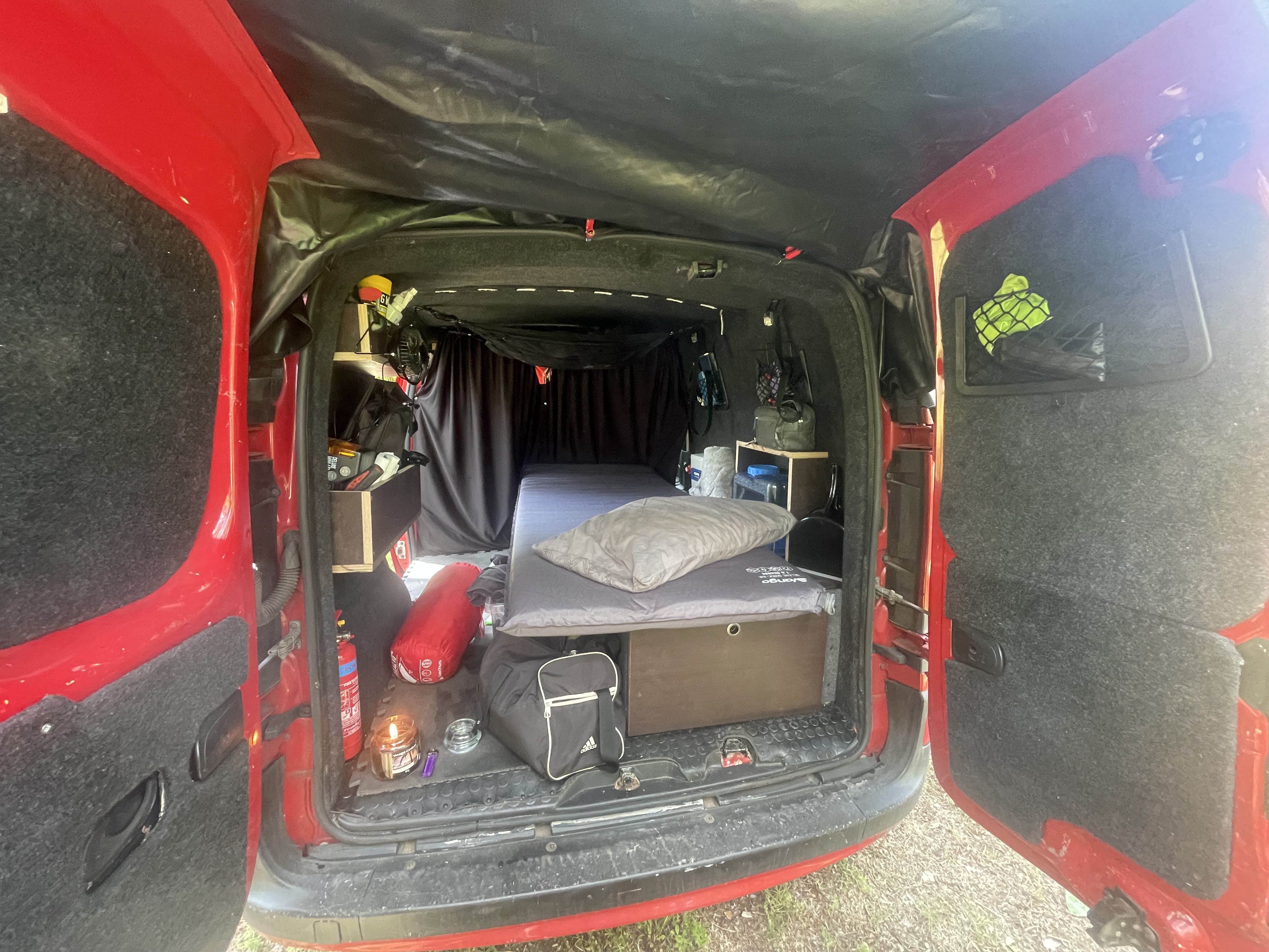

Where it sits just now. Few bits and bobs like magnetic clips and hinges to come and finish it off. was quite late on last night when I finished up so there is a few odds and ends that need tidied up, a little more storage to be added where I can like little nets and possibly some enclosed shelving.
Coming along now looking forward to get some use out of it in summer while road tripping.

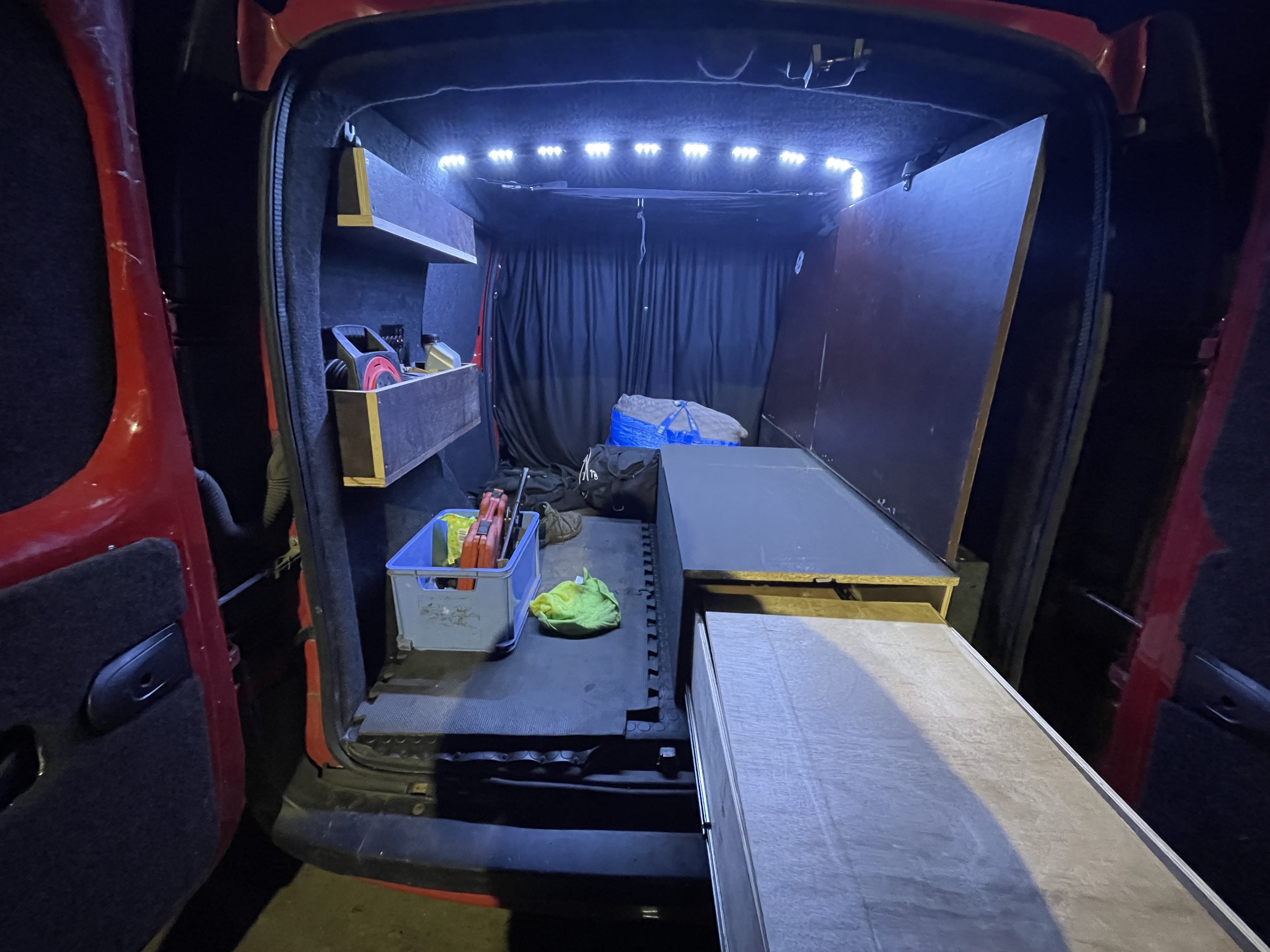

Added a couple of shelves today made from leftovers. Quite chuffed with them in all honesty the phenolic plywood is nice to work with.

Unfortunately one of the new inner ties has developed “shitey” and I’ve got a bit of a rumble coming from the front. Not much I can do about it at this point in the trip but if it gets worse I will try and do a repair at one of the campsites.

Tie rod is really annoying now but I’ve spoken to a local mechanic via google translate who’s going to rip me off for fitting a new tie rod next Thursday. So in the mean time I’m going to travel over to Nice tomorrow then on to Monaco for a couple days. Then I will come back here to get the van sorted.

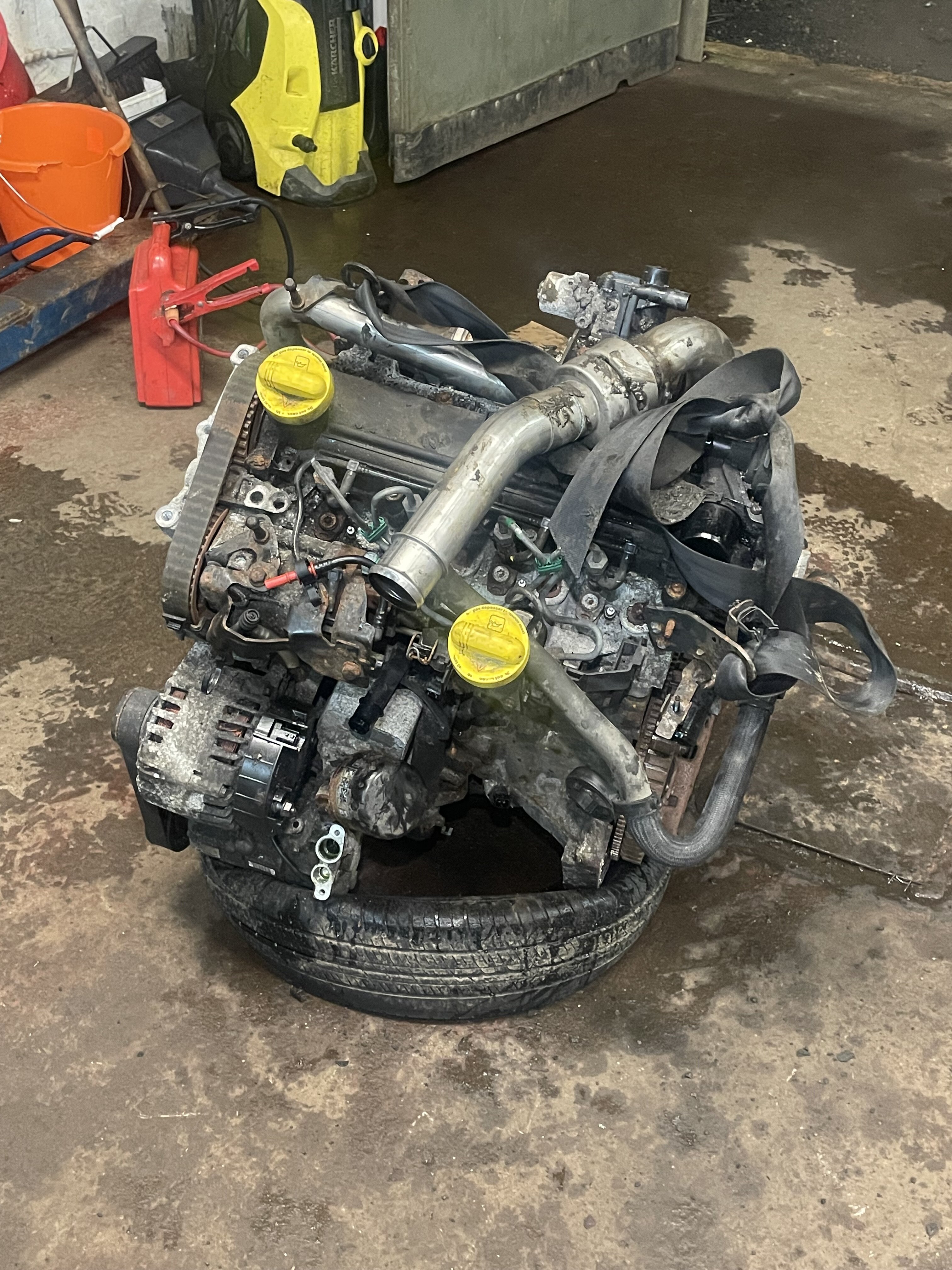

Have picked up a lower miles Megane engine with 122k miles so pretty new in comparison to the kangoo lump!

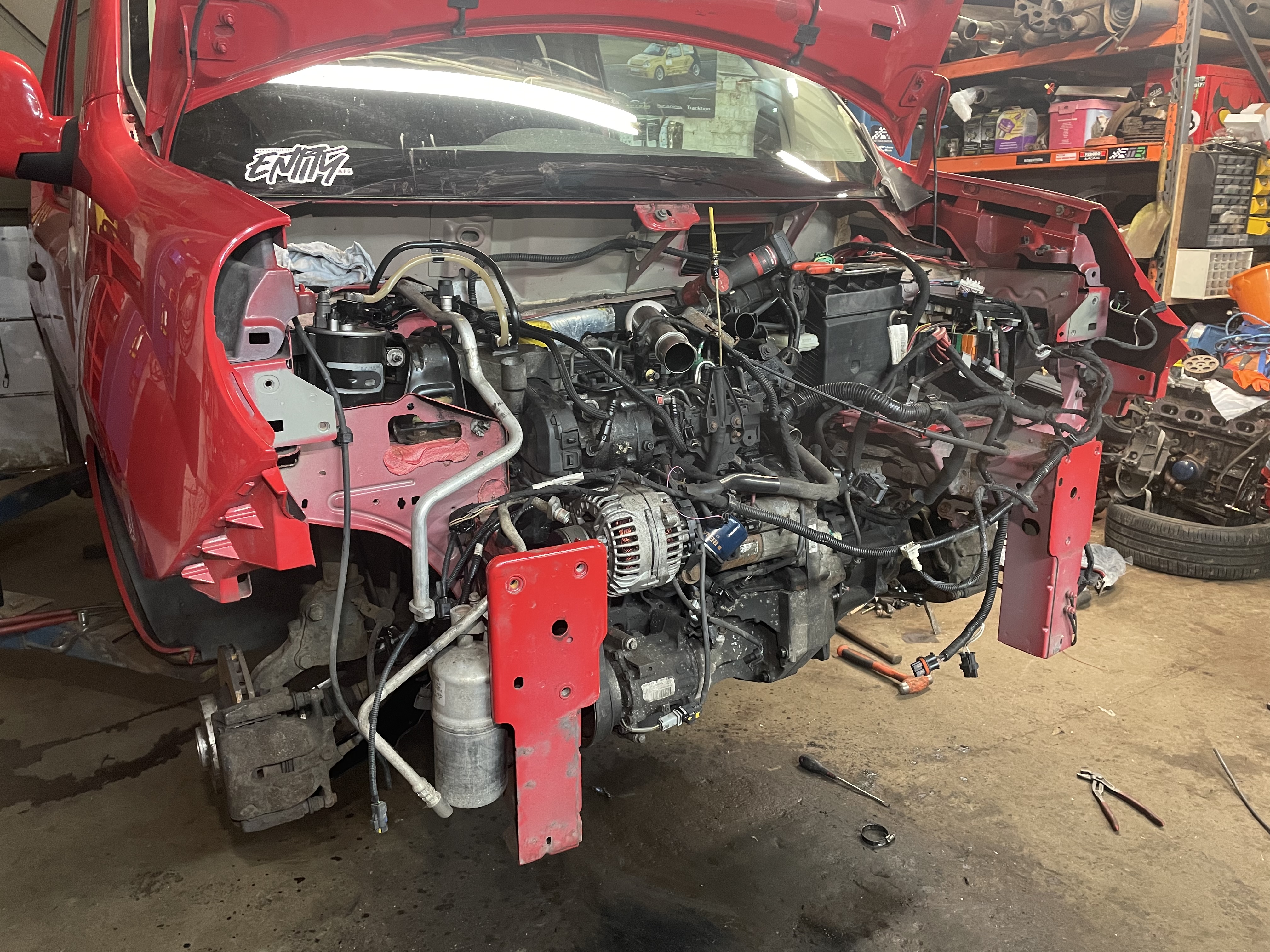

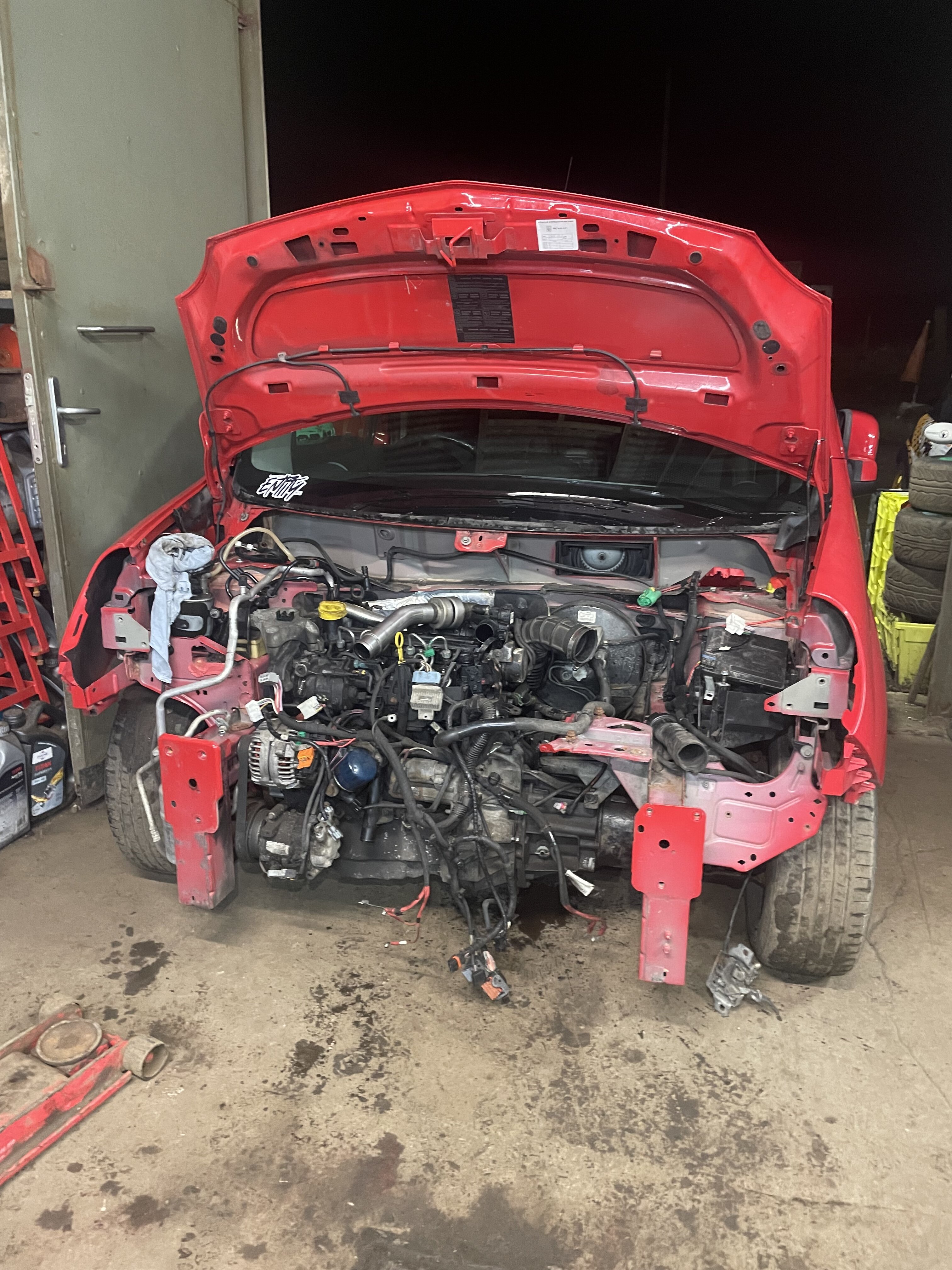

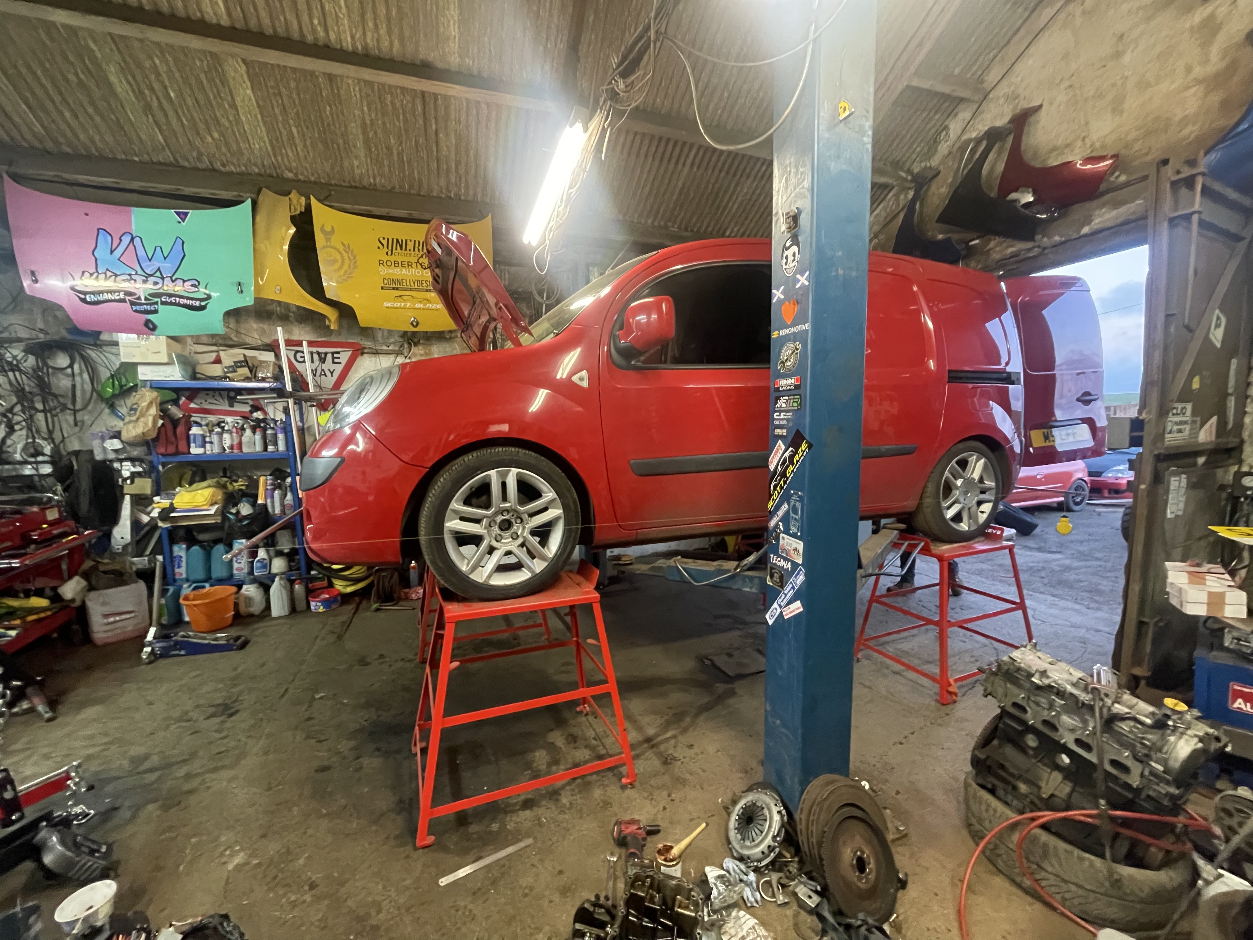

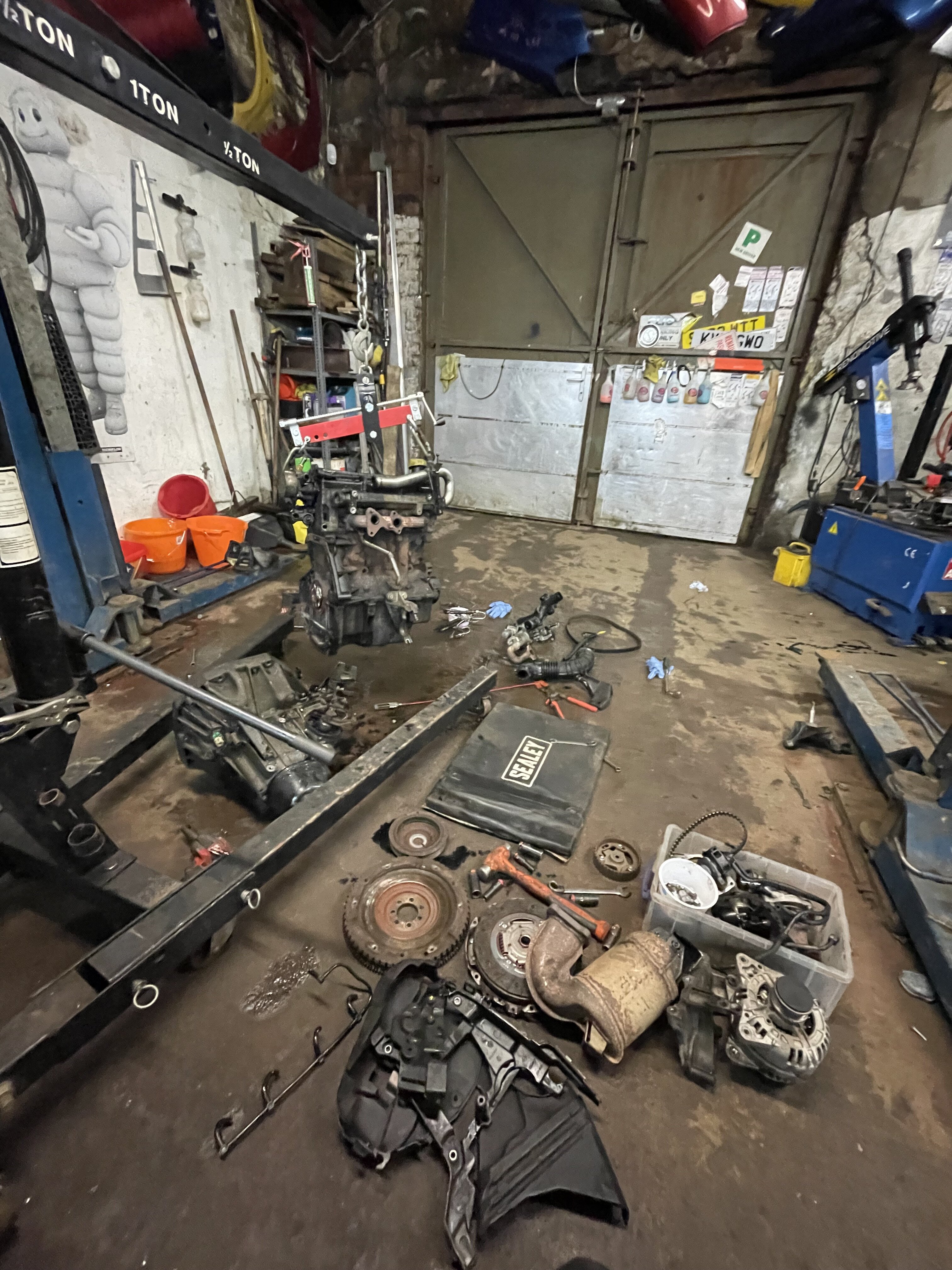

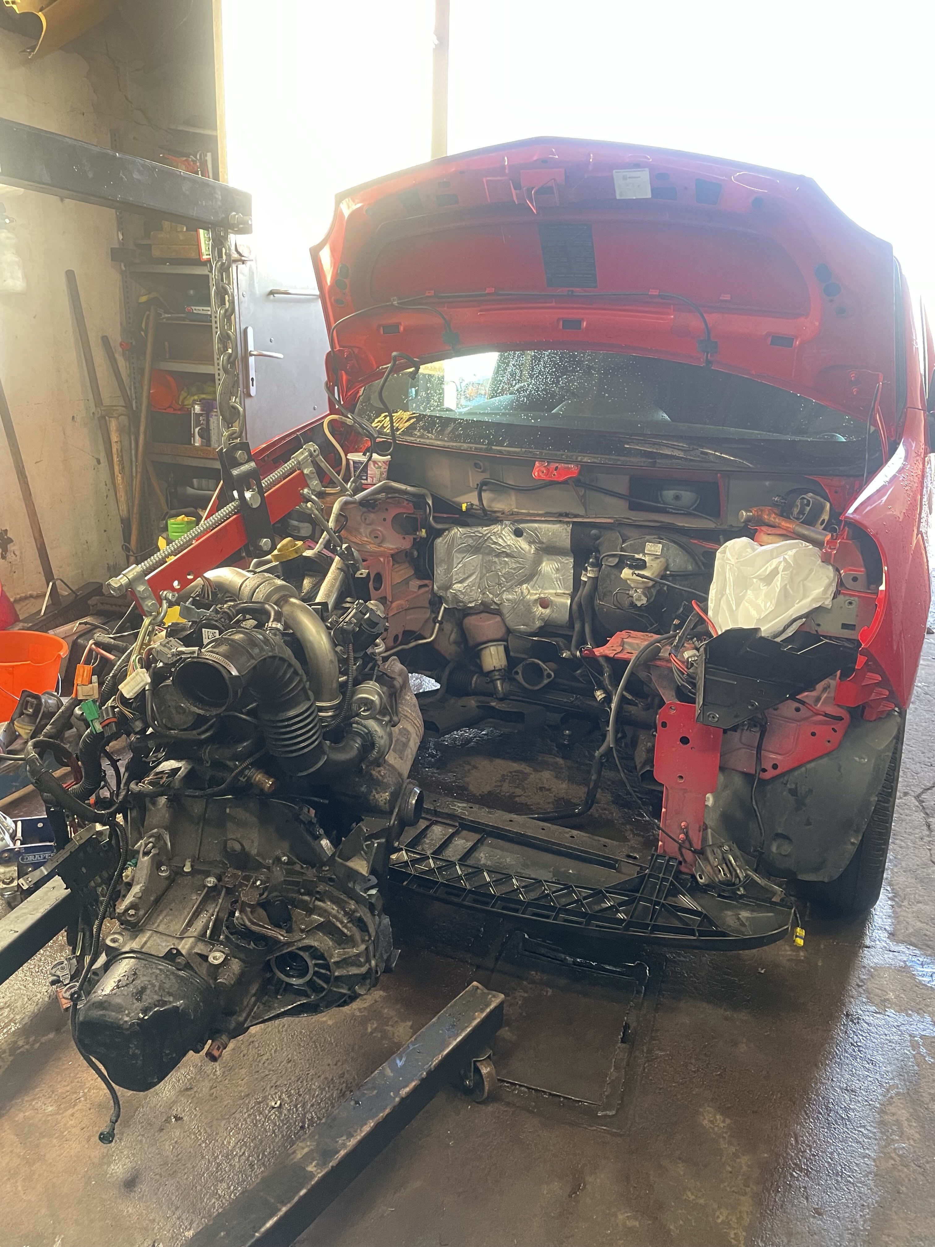

Set about getting the engine out of the van to see what went wrong and prep for the new one.

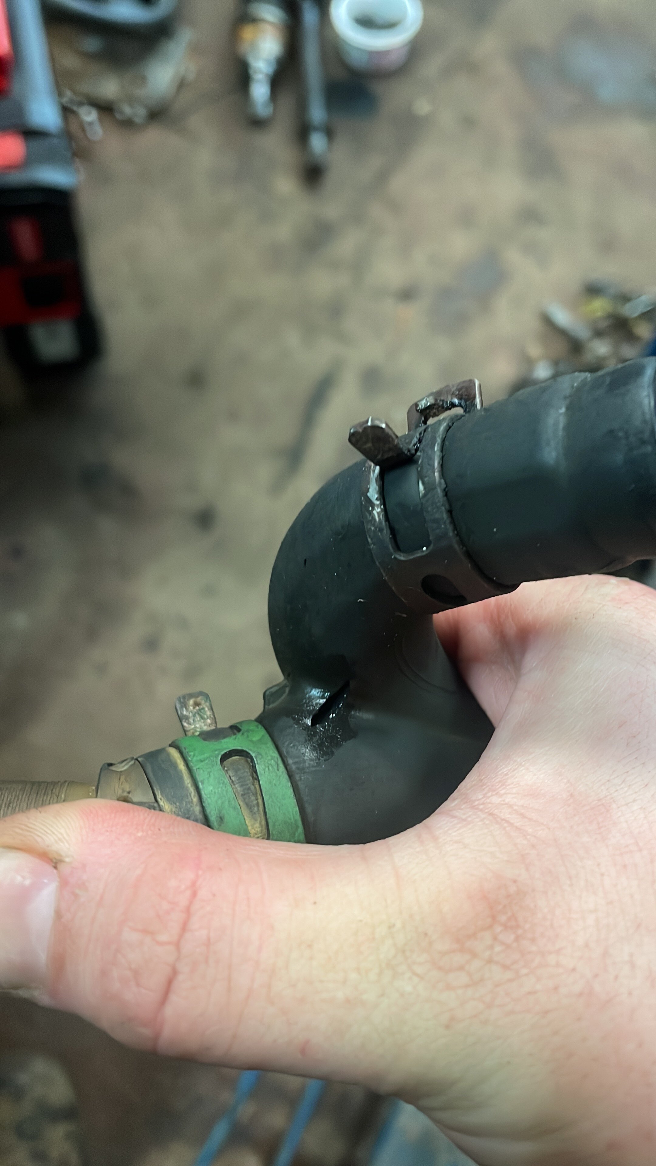

Engine out and started to take it apart, culprit for dropping the coolant was this hose, annoying as it was a brand new hose when I had the engine out previously.
I should say the mk2 kangoo doesn’t have a temp gauge so not much to go off when they get hot.

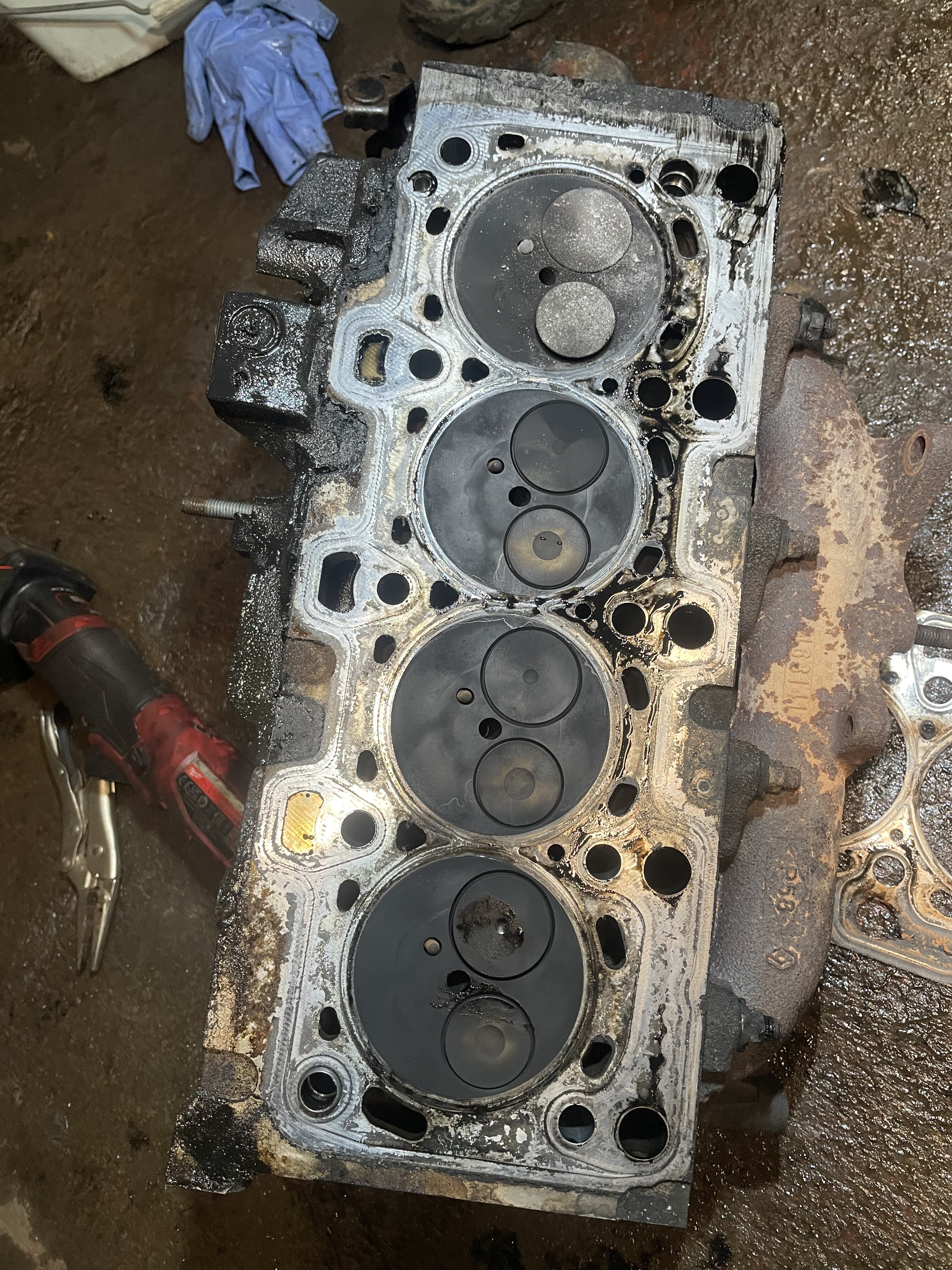

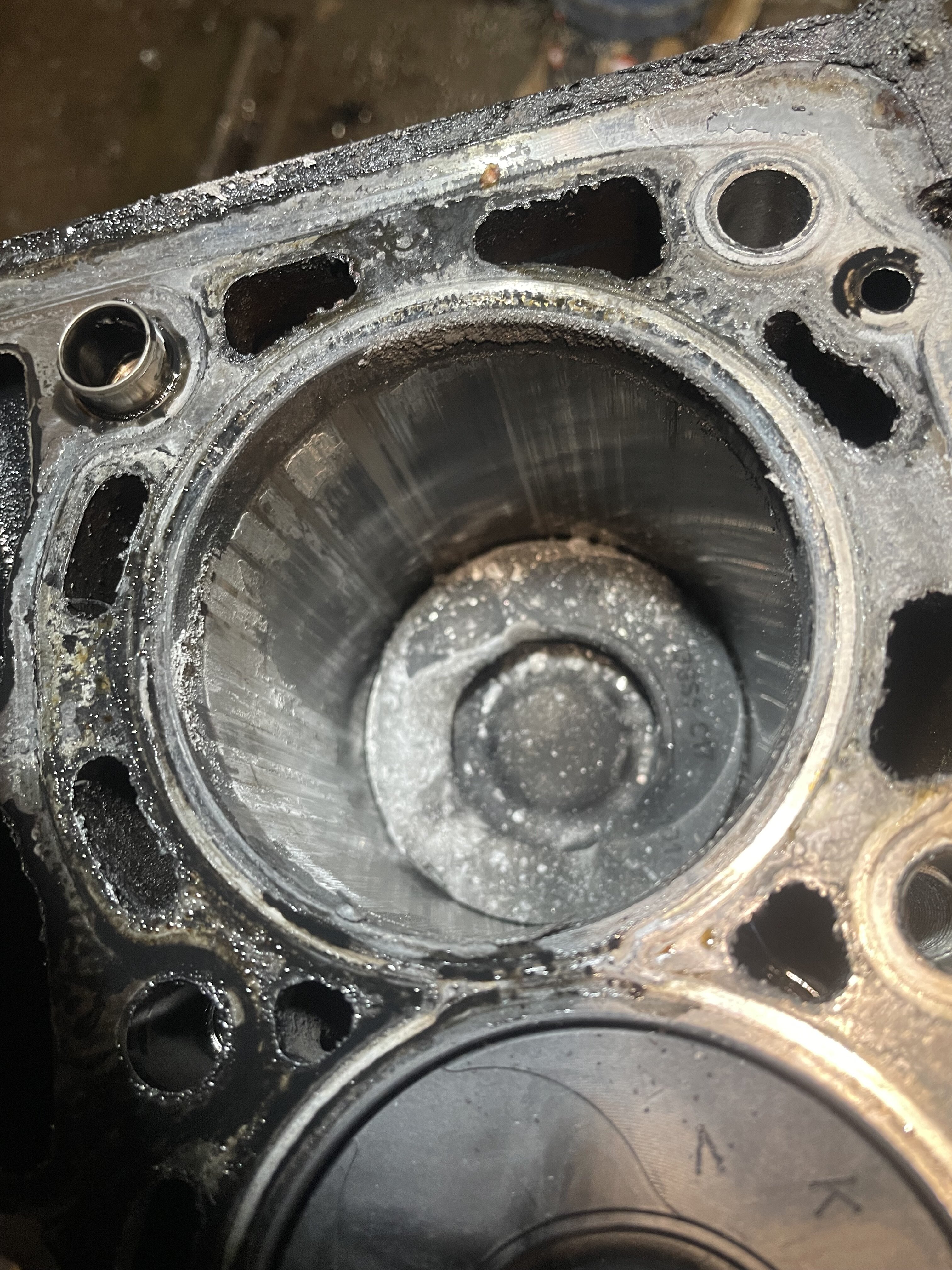

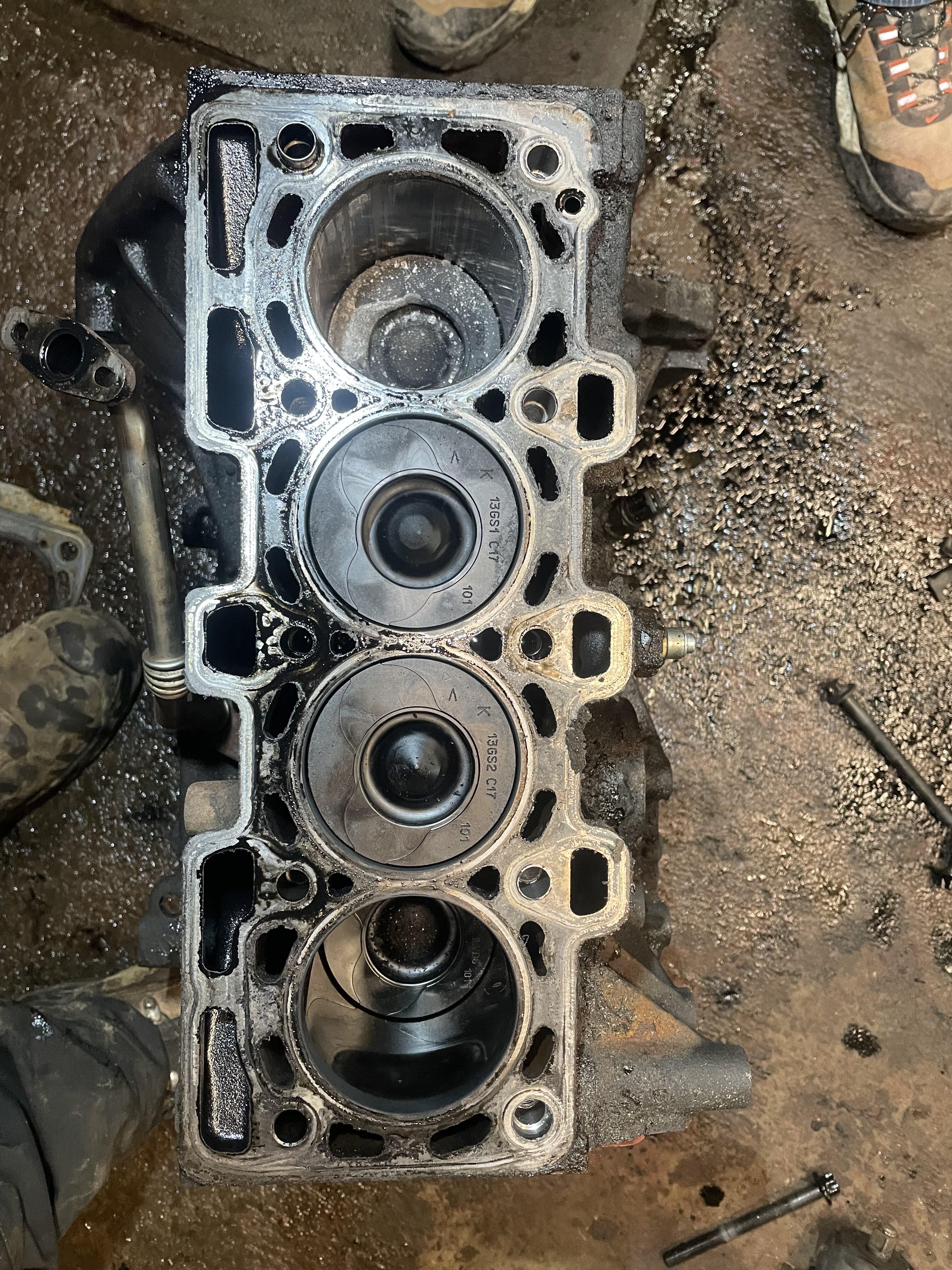

Took the head off to inspect the damage:
As we thought it had melted piston 1, bit of a shitter but will throw it back together. Most of my parts have now arrived so going to try get some time on doing the belts on the new engine. I’ve got a fair bit of new parts from my old engine to go on like turbo etc so will swap that over and hope it’s fairly straight forward from there. Feel like I’ve had this thing apart way more times than I’d like to. I had originally bought this as a cheap run around and as with all things it has escalated 🙃
