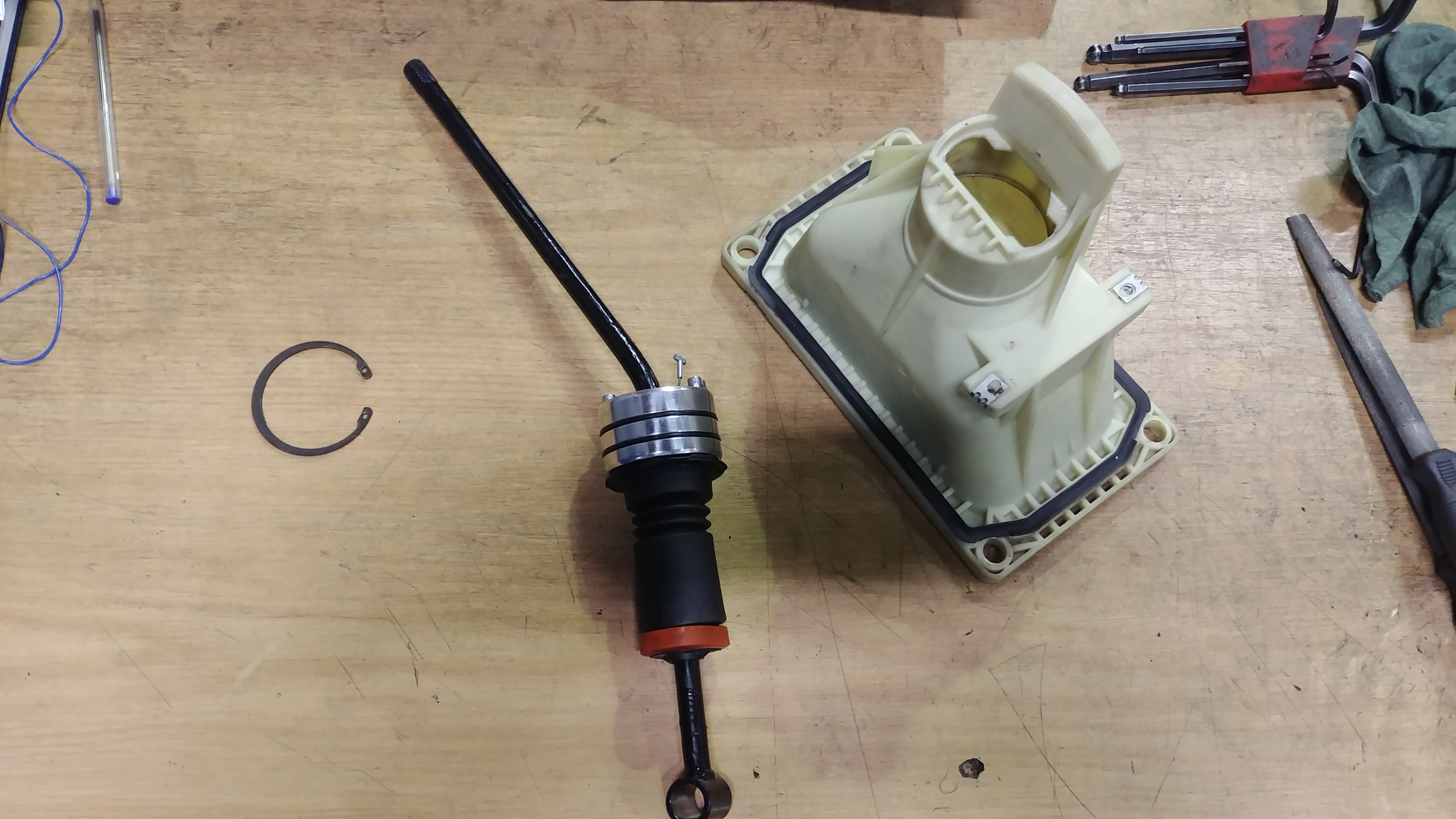

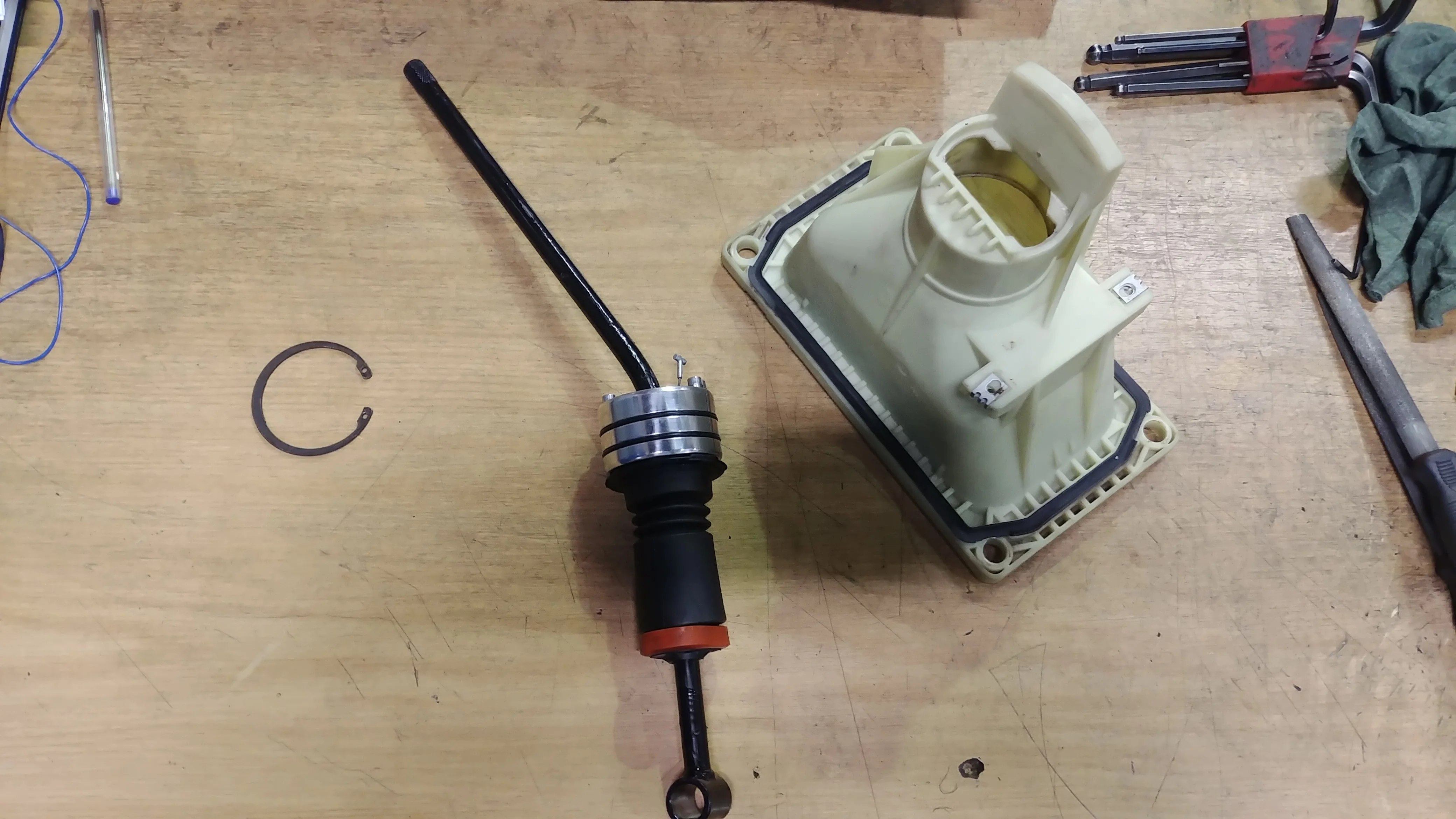

Small update, managed to find a mk1 scenic shifter & linkage to address the standard shifter height
I know the common opinion is to go for a PMS shifter however for me I could not live with any form of rattle (I work in vehicle acoustics) so no matter how positive the shift is, this was never an option for me.
Now I need to find out how to improve/refresh the scenic shifter to make it as fresh as it can be.
After doing a lot of research on this it seems that Yanoo offered many products however sadly is no longer an option..?
There seem to be a load of short shifters on eBay (has anyone used any) but am worried about rushing the synchro's as I know these gearboxes are made of glass
Also, any ball joint/bush repair kits anyone could link me to?
Appreciate this has been asked before but all links to old products suggested have since been removed
Thanks

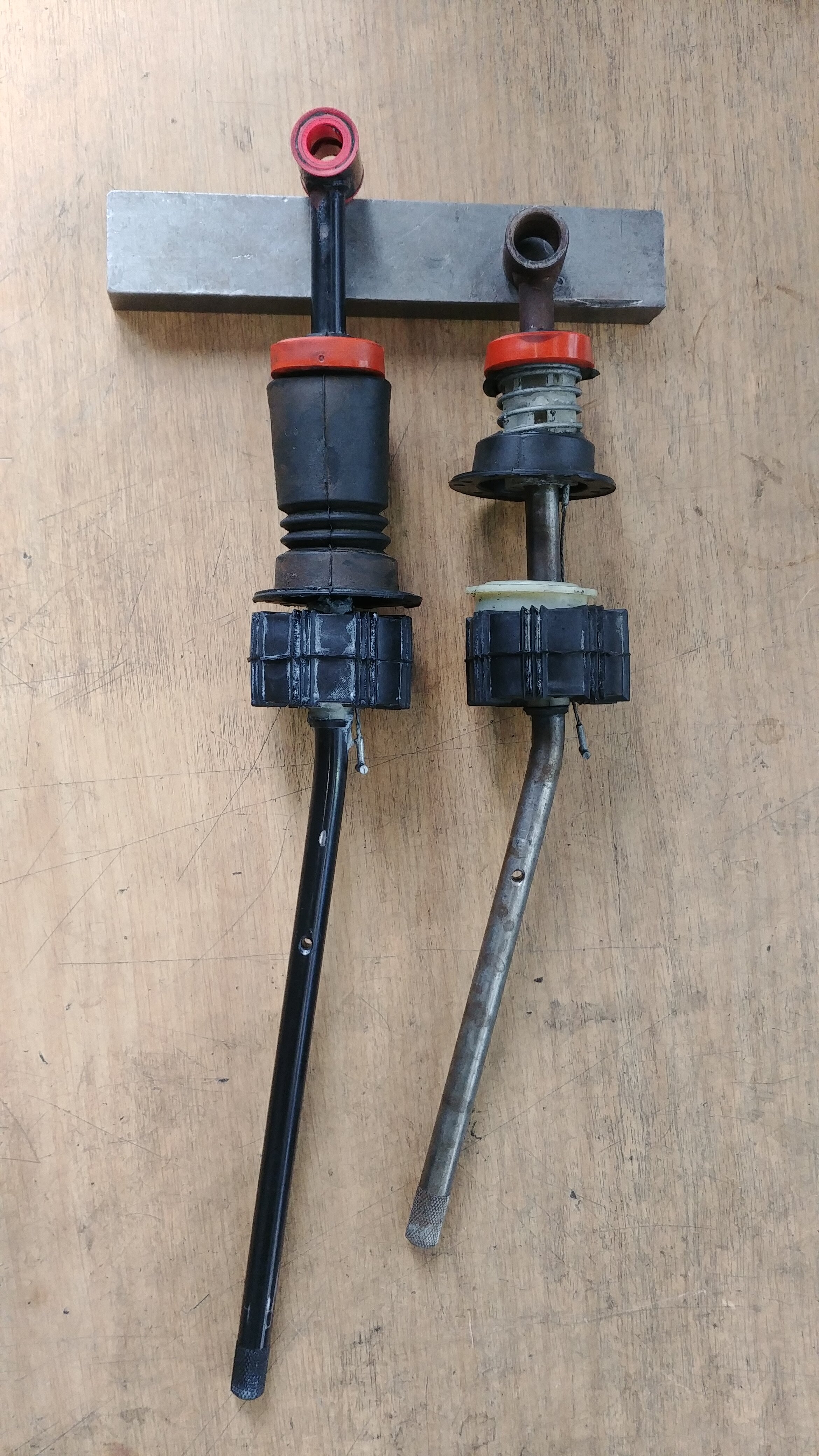

Doesn't look like Yanoo's products were passed on to anyone else unfortunately. I have a scenic shifter with yanoo stiff shift and shortshift fitted. Beside that the only mod you need is to increase the bend in the shaft a bit so its not too close to the dash. The short shifter just cancels out the increase in throw the longer scenic shifter creates, don't worry about rushing the box.
Scenic vs 182, note extra length either side of the pivot.
And the stiff shift fitted and extra bend.

With that in mind I will more than likely set about renewing the standard bushes with the addition of a short shifter.
Does anyone have a specific recommendation for short shifter? Had a look on ebay and found the one below but am always wary on ebay...
Renault Clio Short Shifter 2.0 16V 172 182 Cup Sport RS Exhaust Trophy Cup Bush | eBay
Also, have researched the brass bush for the bottom of the shifter to shifter linkage.
Brass Shifter Bushes – Clios and Coffee
Anyone have any experience with these?
Thanks

I managed to bend the scenic shifter shaft further back to the driver and fit into the car.
Quite a difference to the original shifter!
New neutral position
Also picked up a Motamec Quaife style gearknob
Shifter position is substantially improved so very happy vs the original shifter. I haven't fitted a short shifter as yet but am going to use it and see how I get on as Ive never really liked how short shifters feel.

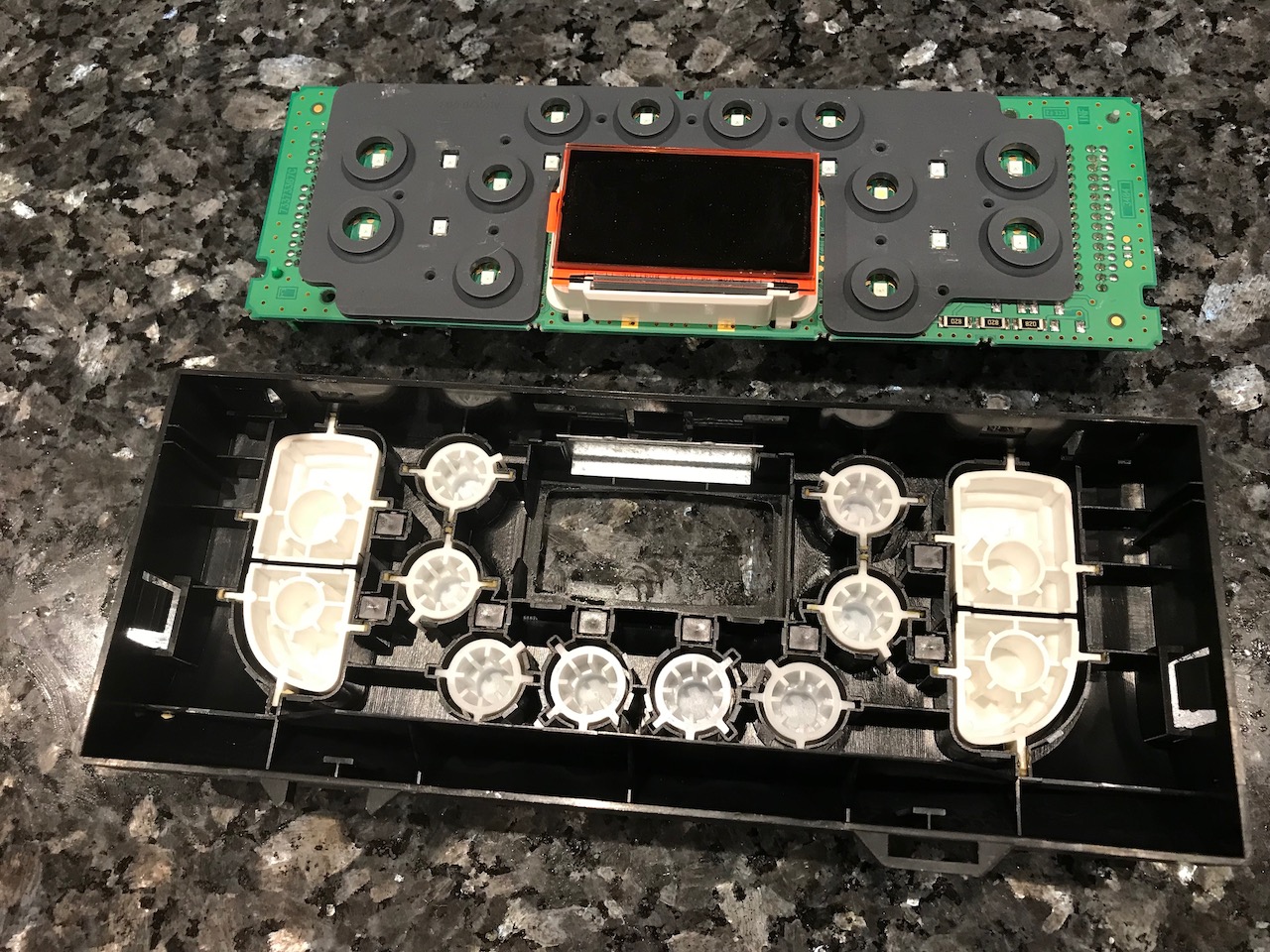

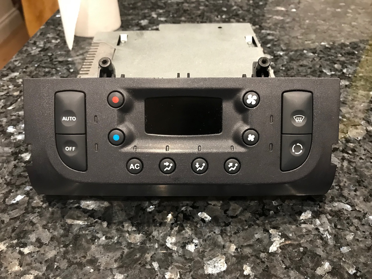

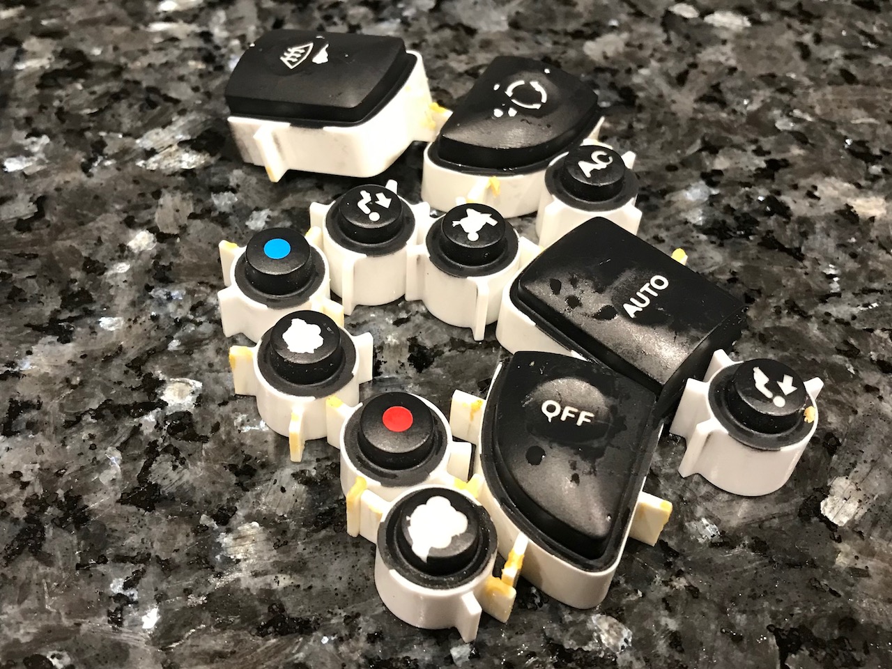

Decided to finally get round to de sticky'ing the interior trim at the weekend.
Stripped the climate control unit down
And then when I thought I was being clever using some tape to hold the buttons in place when inserting the PCB back I removed the tape and this happened
So now I have a much nicer de sticky'd interior but also need another unit altogether or find a solution to recon the buttons. (Suspect another unit is going to be the easiest route here)

Mr Underhill
I did mine at Christmas but was unaware the unit pulls apart and the buttons are easily transferred. Thank you to @SharpyClio for the tip.
So I bought a second-hand unit, not sure if it worked or not, and just switched everything over. Now I've got 1 really nice unit out of 2.
