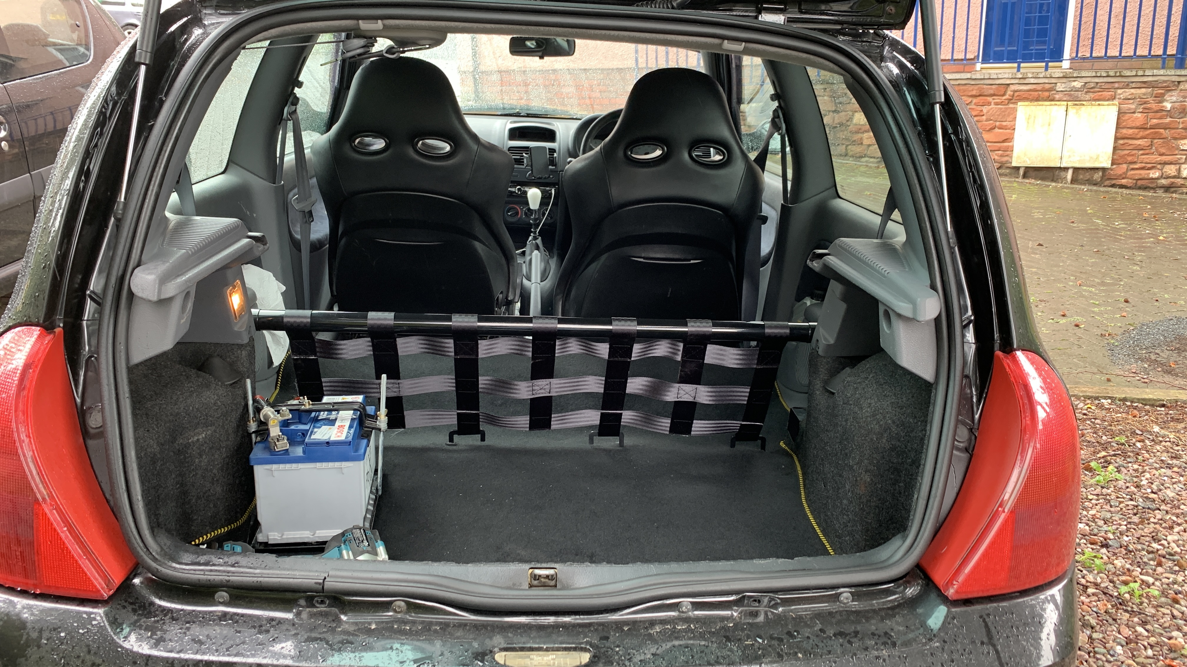

Small update,
I decided that with the addition of the Clubsports above & considering that the seats are solidly mounted it renders the rear seats useless.
Even throwing a coat onto the rear seat is hard work to retrieve so I decided to commit to the 'Clubsport' route and remove the rear seats all together
In my mind, the rear seats have never and would never be used, and the idea of a 2 seat Clio with the practicality of a boot closer to that of a 5 series is much more useful to me, not to mention any weight saving.
I think I remember reading the rear bench, ISOFIX bar, belts etc nears onto another 15-20KG?
In anycase, I didn't like the exposed metal from the rear seat so quickly sourced some carpet from work and made a boot mat to fit
Still some tweaking to be done but overall happy with how much tidier everything is back there.
I've got some longer M8 bolts and 8mm spacers on order so hopefully will be able to drop the steering wheel height enough to get it where it needs to be

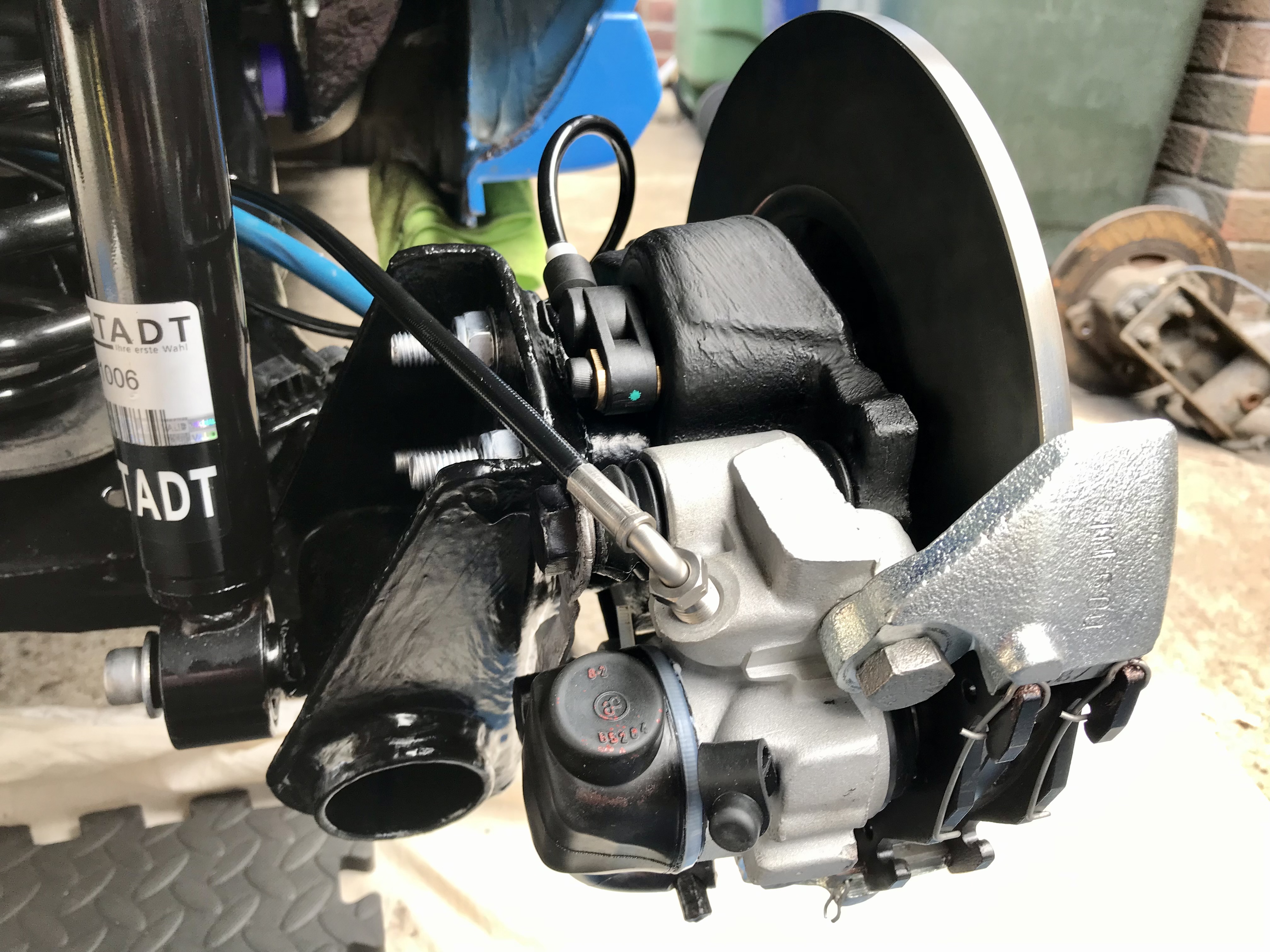

And just when I though I can go enjoy the car I noticed a noise from the NSR when moving slowly to a stop which seems to be the rear wheel bearing
These were new approx. 1500-2000 miles ago when the recommissioning work was done at KTEC... Is this normal or just unlucky?
Been looking round as the discs were also brand new and have found a Febi Bilstein bearing from Autodoc.
Anyone used this one before? Measurements I believe look all correct and at £12.70 I cant complain for the price..

Also been reluctant to drive the Clio until I can get to the root cause of a noise Ive been hearing. At very low speed (sub 10mph) under braking im getting a rotational 'knock' from the rear. A quick look says both rear wheel bearings are ok, and no noise when driving along at any speed if off the brakes so hopefully ok there.
Discs and pads have done sub 1500 miles and no obvious signs of scored discs etc.
However, when removing the rear slip on spacers, I did notice the OSR caliper was binding preventing the wheel from spinning freely when in the air so suspect it needs a rear caliper..?
Any recommendation as to where & what brand? Assuming there is nothing else to check before pulling the trigger on it?

Mr Underhill
I bought Febi units for mine and they're spot on.
Part numbers for the OSR are - 7711135714 (exchange) or 7701204847 (non-exchange) but NLA unfortunately.
There are some Febi ones on Autodoc amongst other brands, but I can only speak for what I've used.
Autodoc never supplied mine, they came from a local motor factors (DMFX) in Darlington.
