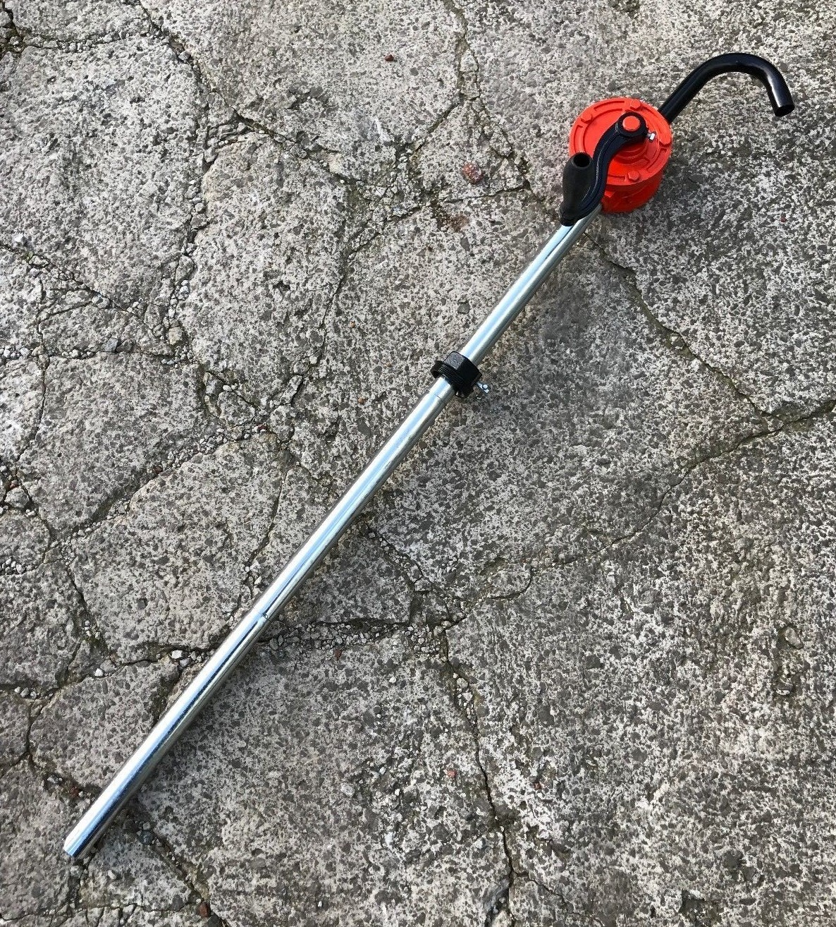

You want a Rotary Barrel pump to do fill-ups, they're amazing.
Crank the thing round fast enough and you'll empty a 20L veg container in a matter of seconds - zero mess as well !!
I loved my old one, could smash near 60L into my Peugeot faster than you could fill it at the petrol station :grinning:

Had one of these and I could empty a 100l drum in no time[emoji23] “Yeah mate this Cherry is deffo going in the forklift. It just makes it easier if I empty this 100l drum into 5 20l drums”[emoji30][emoji23]
Never ran cherry myself but my mates love the stuff‍♂️[emoji23]
