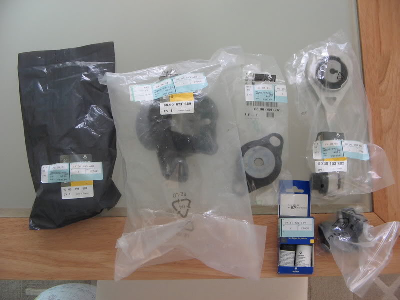

Well I ordered four new engine/gearbox mounts from Renault costing around £160 (trade discount, not a huge saving).
Last night I changed the mounts, the gearbox mounts were a little bit of a bugger, but with it being the first time changing them I would approach it differently next time using a 2 poster ramp instead of a 4.
Anyway its all done now and what a difference:
  • Performance is up, with the lose of movement in the engine, power is being put straight to the road.
  • Handling is better
  • The gear stick/ gearbox feels like new, with postive gear changes and no wobble when in gear.
  • The knock has gone aswell
As a modification, well good maintaince its money well spent and def. recommned it if you think your mounts are on the way out.
