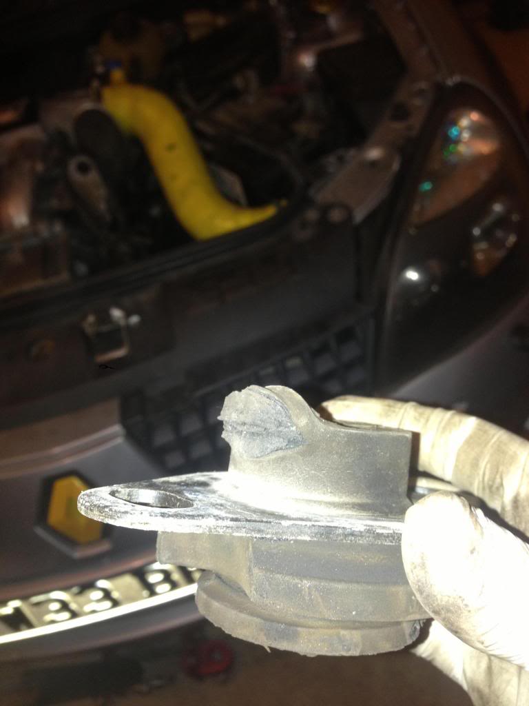

Picking up a cup today. When I test drove it it and pushed it hard it made a knocking noise. I remember my old cup doing this, maybe not as bad though. Is it just tired engine mounts? It's on 80k
loosen the 4 bolts on the upper drivers side engine mount, get someone to pull the engine forward as far as you can and tighten the mount back up, that usually cures it!
this was said mount!
