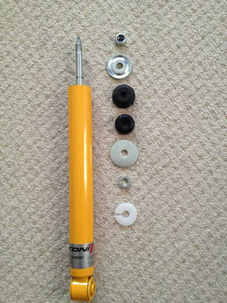

Took delivery of some new koni yellow shocks (rears) today for my 182 as the back right was shot.
The lack of instructions has dumbfounded me to be honest. So could use some advice on order of the rubbers, washers & nuts.
How does this look?
Any advice would be great, thanks
That looks like the right order from memory. Perhaps swap the 2 black rubber pieces around though.

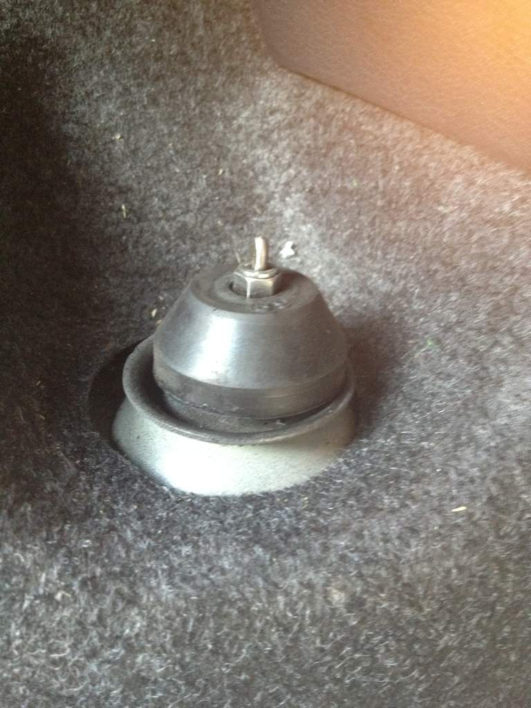

Guys, need a massive bit of help!
Half way through fitting the shocks and cannot get the top nut on. Not sure if I'm just missing something so simple.
There just isn't enough room/thread to get the top nut on. So on the offside i removed the clip on the shock (can be seen in the pic on the shock above, to slip the washer and rubber on lower).
This means there is enough thread but cannot tighten nut as it keeps turning!
If anyone can help it would save my bacon
Had the same problem. You need to try and grip the lower parts with a pair of pliers or grips and then tighten it.

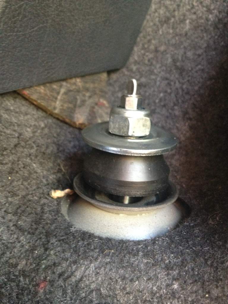

Right, just didn't wish to mark/rip up the shock.

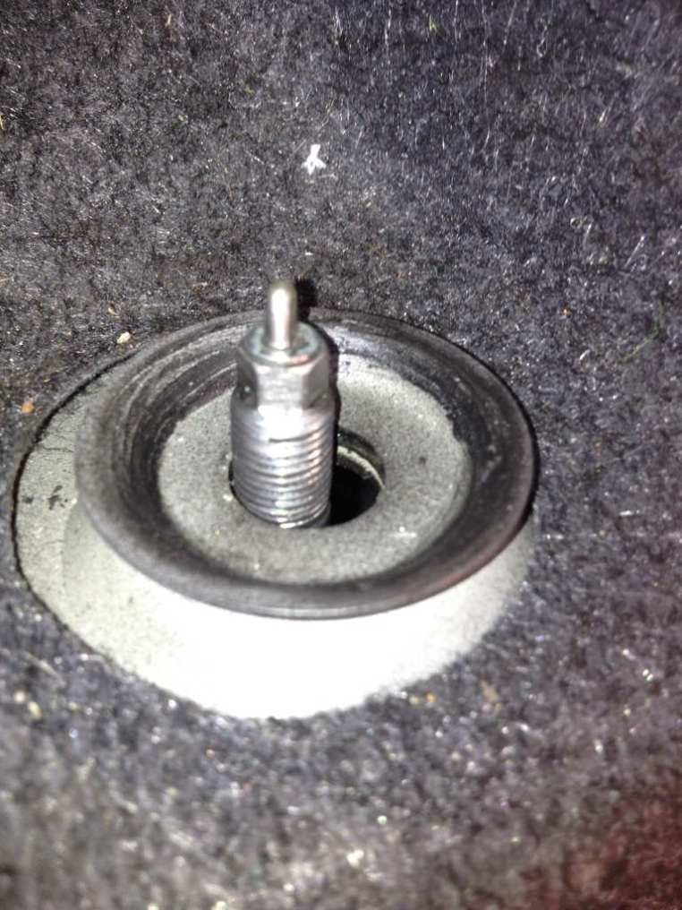

Everything should sit above the circlip apart from white plastic washer? Just cannot get enough shock through to get nut on.
Its only when i remove circlip I can get enough shock up?
Sorry for all the questions, just struggling here.
This is how it looks with the circlip removed and washer fitted below (reading other posts I think it's wrong).
If I use the white adjuster to hold shock & open ended spanner, I presume that would stop it spinning? Just need it sitting correct first.
