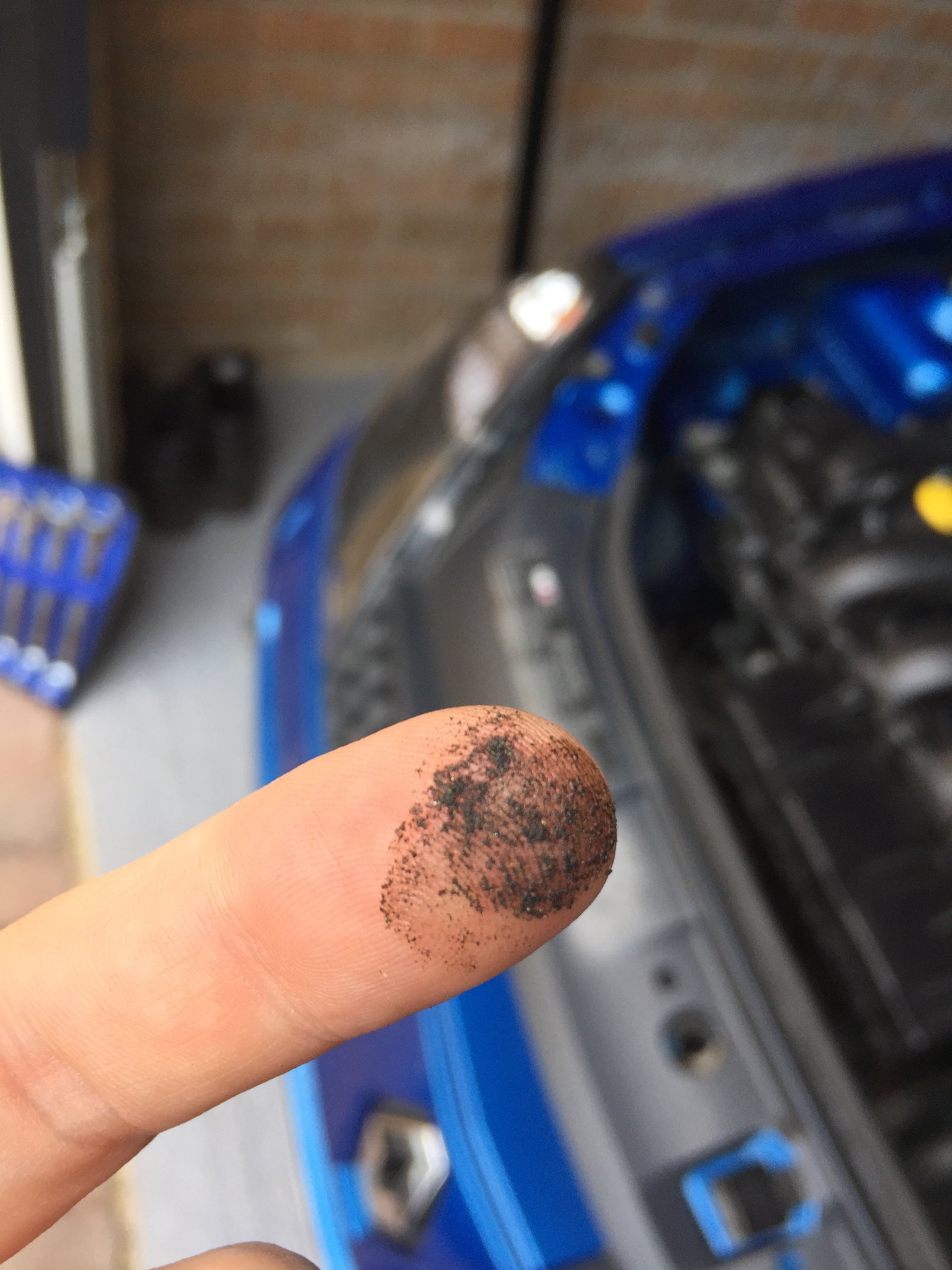

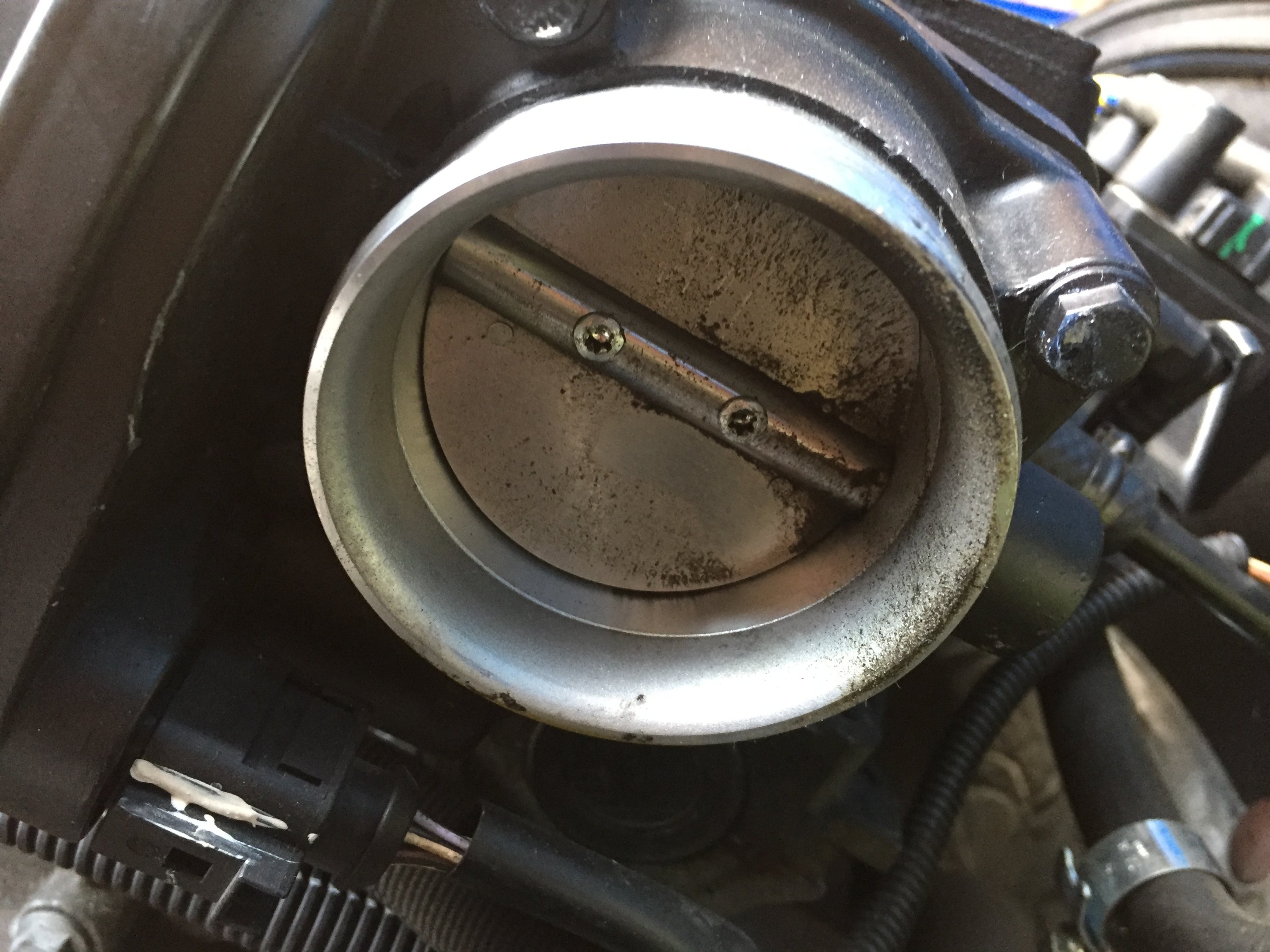

So was in the process of removing a few bits from the car, took off my ktec induction kit and found this in the silicon and tb... I assume a filter should be able to filter dust? I know it’s very dusty atm but the car has literally been used for one trackday in the last month and otherwise has been sat in the garage.

Was the filter ever oiled?
Yes a few times, although I will clean and re-oil it now as I assume this will be the main cause, I was just abit suprised how much was in there tbh. Will give all the intake parts a good clean as well!

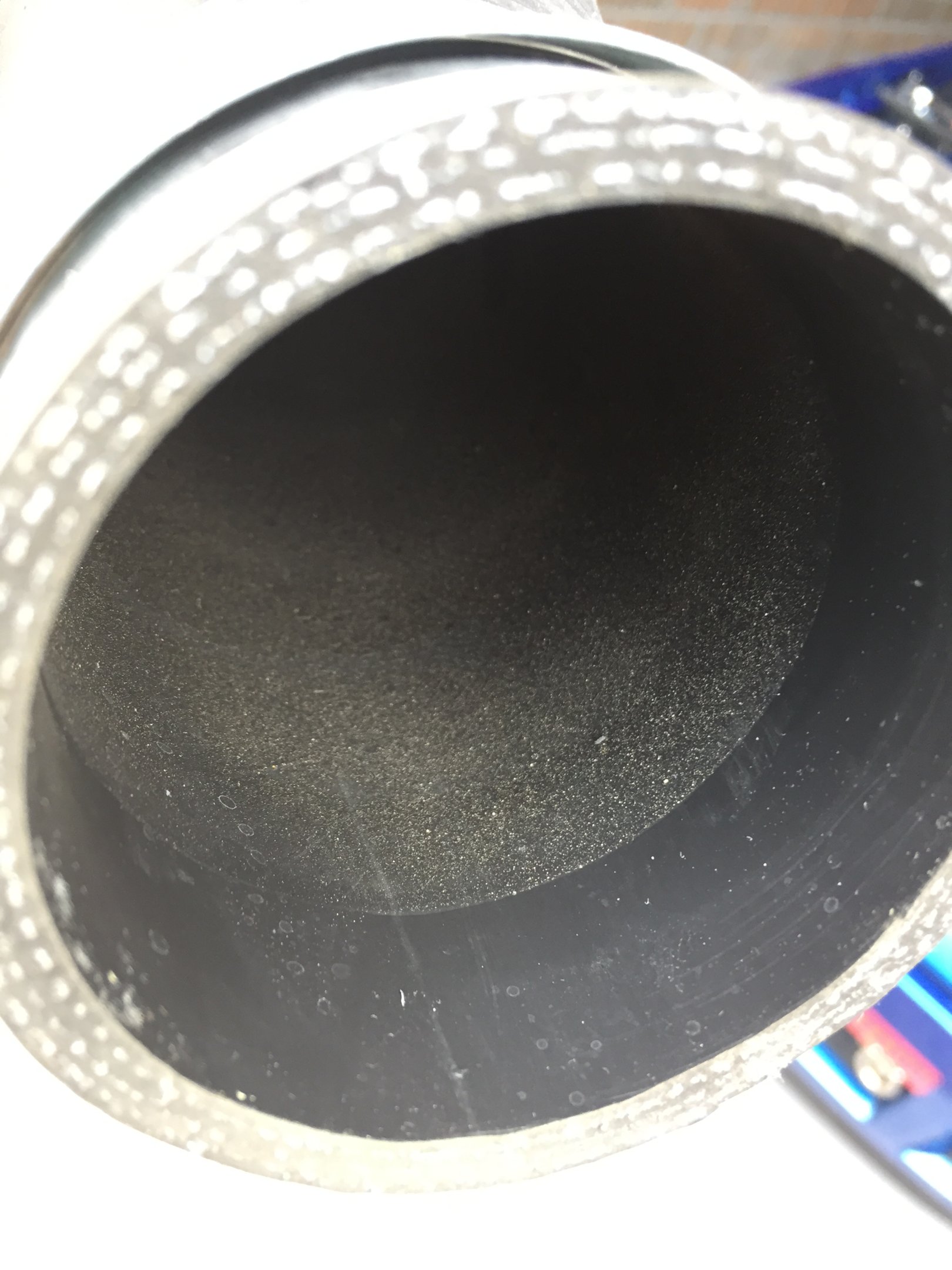

How long since it was last cleaned? I do mine every 4k-6k. Inside of the pipe is clean...
Out of interest, do you clean the pipe as well as the filter? I've just bought a second hand ktec induction kit and was going to wash and oil the filter as a matter of course, but now I'm wondering if I also need to wash the pipe out too. It's black so probably won't show any dirt either...

You will clearly see a layer of dust in the pipe even if its black.
