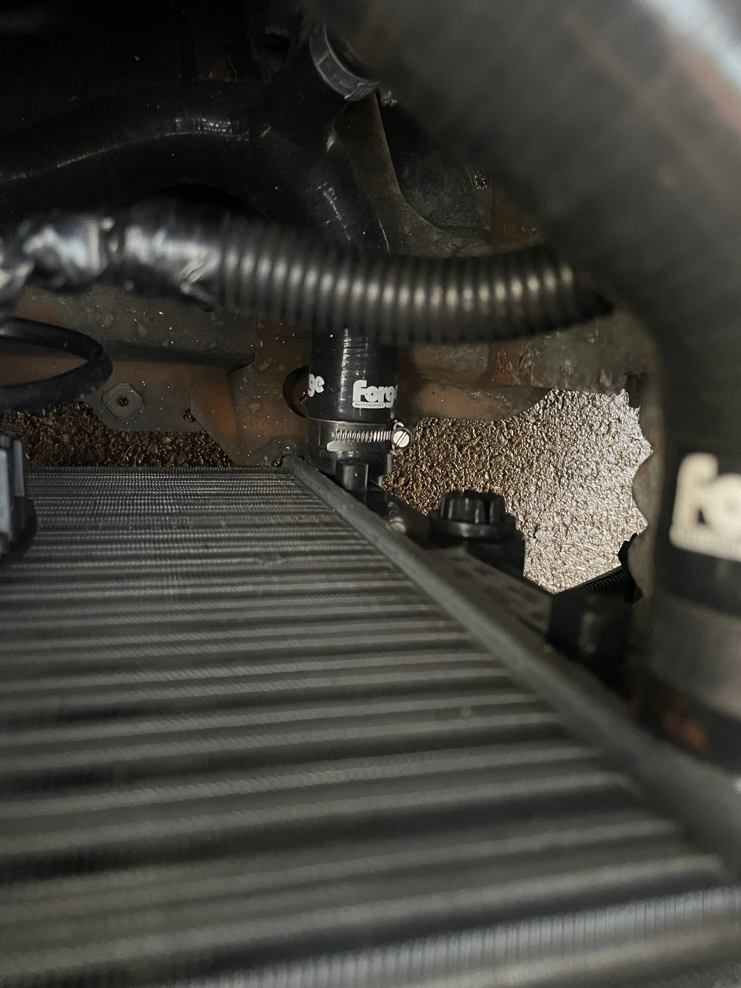

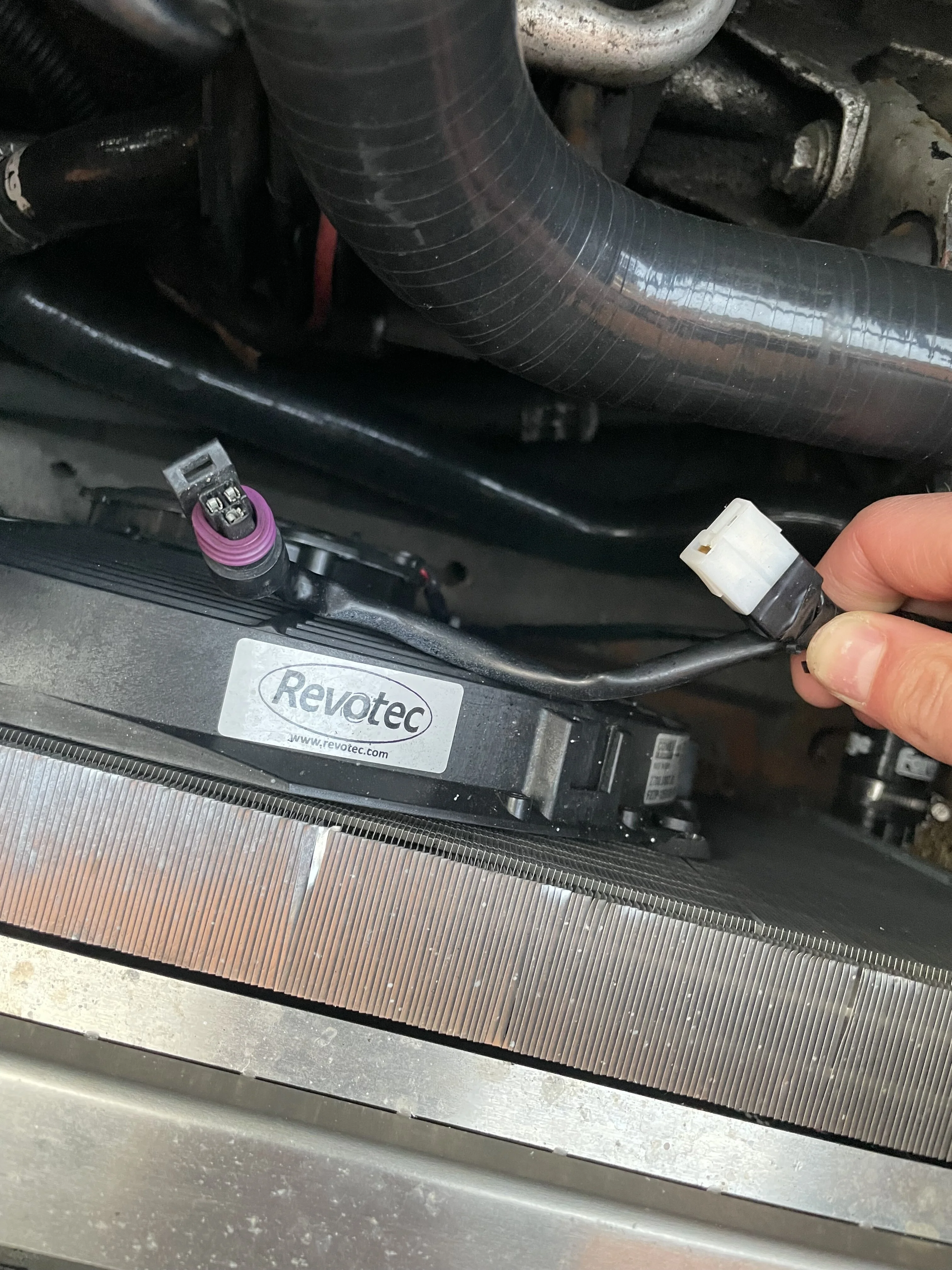

So just gone out to look at the car and see exactly what is what and I am a litle stumped. There is what looks like a new connector on the new fan that was fitted (white plug) and then a second plug that was tapped up, assume done by the garage. Looking at the radiator there is no switch on it, from that thread I found there should be one on it?
What is that second plug for (the one with the purple seal on)?

Edit: the random plug could be for the air con that has been removed according to THIS thread.

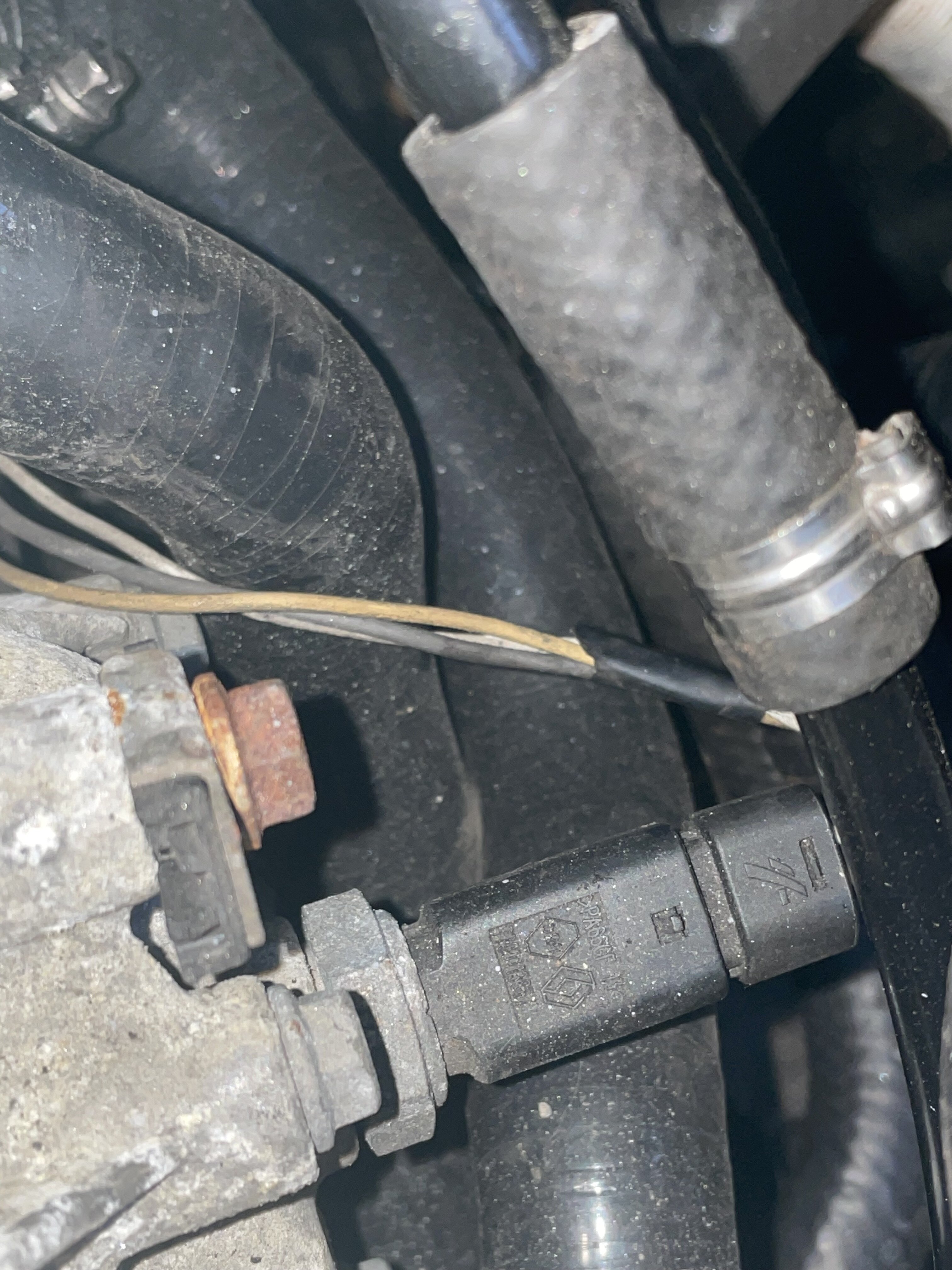

found the coolant sensor, side of the thermostat 🤦‍♂️
But my idea of just wiring a switch in parallel goes out the window as there are three wires going to it....or to put it correctly I hate wiring and can't work it out!
