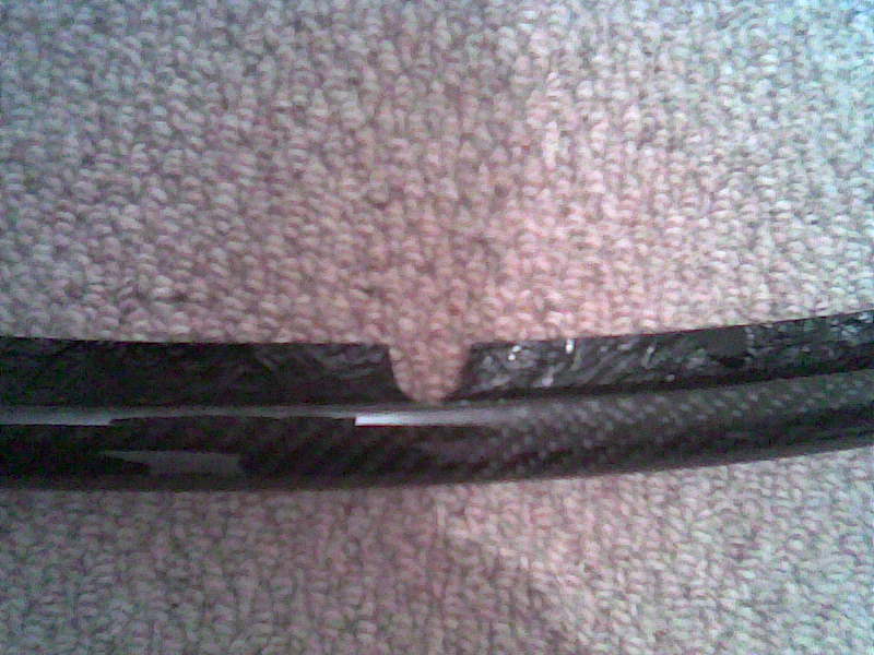

Day it looks like this :S

^ You need to put the holes into it, its not pre-drilled, you need to line it up against the one you had on previously if you can, you dont use what you have shown in the pic lol

The hole in that pic is so that it lines up over teh screws already in the bumper. I think these hold the undertray in place. Hold it against the bumper and you'll see.
Tape it to the bumper in place, and just self tap the screws through the splitter and bumper either side of these holes. will take a bit of arm power though.
