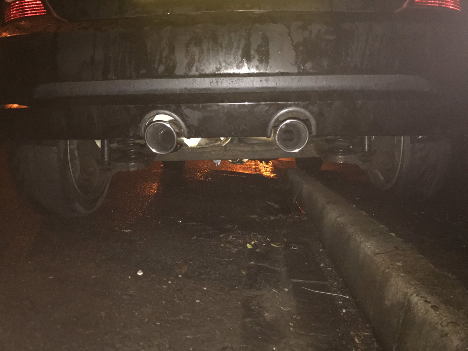

Hello. Could someone help me? I have this exact exhuast system, the tips seem to stick out a lot further and the left one even more than the right almost squinty, any idea what this could be ?

Loads of aftermarket ones have issues fitting.
Have you get decent mounts holding the backbox? Stock ones are toss, they collapse and the exhaust sits on the piss.
Might need to slacken the bolts holding the mounts to the car off, wrestle the backbox into position and then tighten the bolts back up.

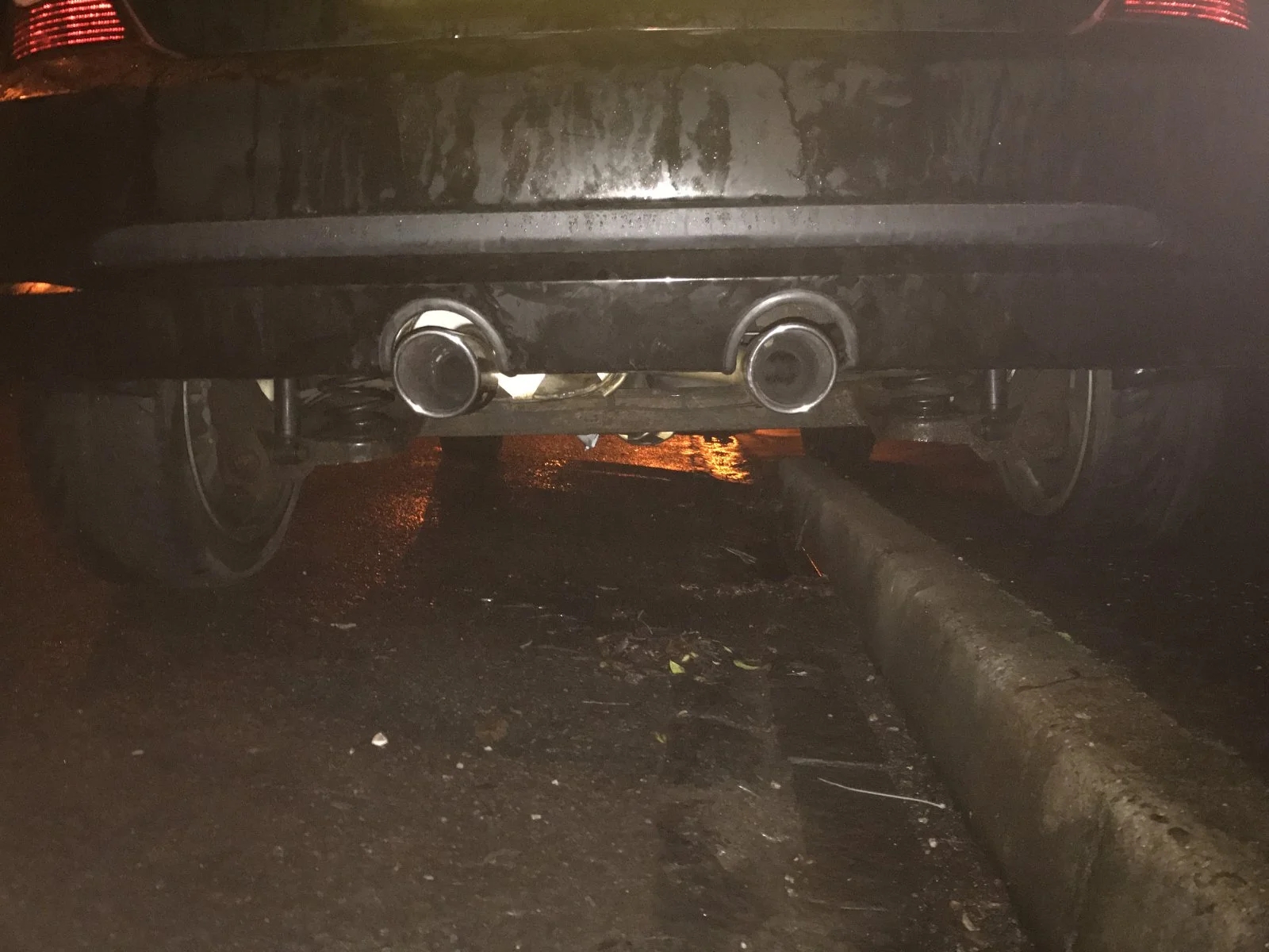

The left pipe is adjustable buy undoing the exhaust clamp that is holding the tip on.
