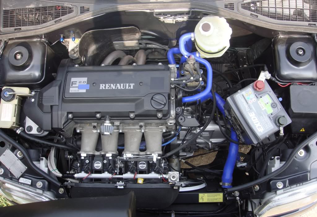

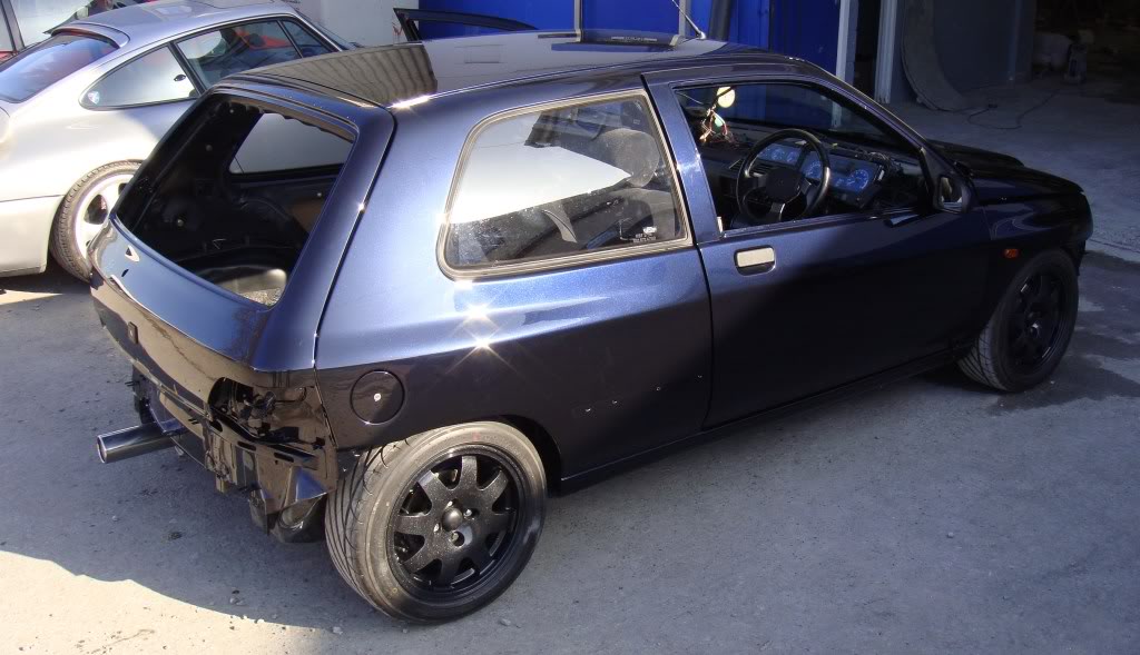

For those of you that are not familiar with this car ill give you a brief spec.
Most things have been replaced with new or refurbished equipment. Andy was very popular at his local Renault lol.

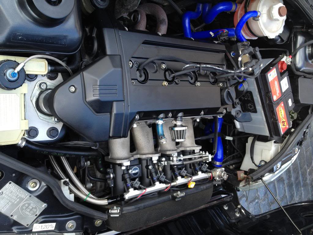

Engine
2.1 over bored Bottom End
Lapel 11:5 High Compression Pistons Standard Rods with ARP bolts
APD Stage 2 Headwork (Port and Polished)
Cat Cam 213 Cam Shafts with Cat Cam Vernier Pulleys (Work Performed @ 519 Automotive)
Jenvey ITB’s (Work Performed @ 519 Automotive)
Chadil Manifold (Work Performed @ 519 Automotive)
Custom Loom (Work Performed @ 519 Automotive)
Canems Standalone Management (Work Performed @ 519 Automotive)
Full Mongoose Exhaust (Work Performed @ 519 Automotive)
K-Tec Racing Mild Steel Supersprint Manifold (Work Performed @ 519 Automotive)

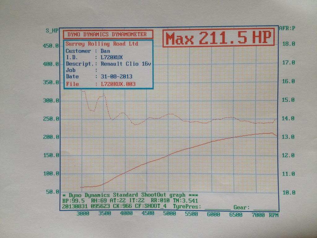

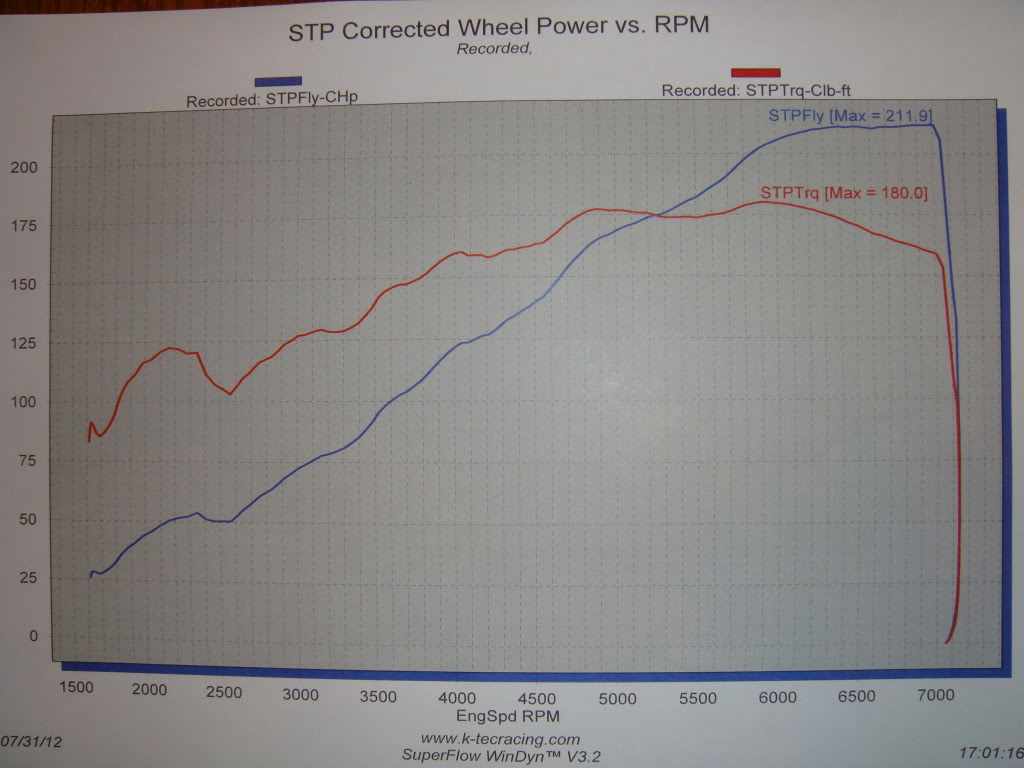

Custom Live Map Peformed by Andy Cutler @ K-Tec Racing Producing Producing 211.9BHP and 180ft/lb
Custom Alloy Radiator
Samco Hoses
Vibra technics Upper and Lower Engine Mounts
Bodywork
New Non Sunroof Skin direct from Renault France £400+
Rust sorted and Full Repray in BMW Carbon Black (February 2012)

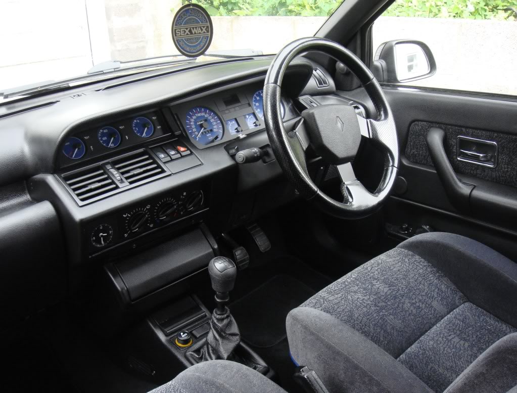

Interior
One off all interior plastic sprayed Black
Williams Seats
Williams Clocks and Aux Dials
Megane Window Switches
Barraca Interior Door Handles

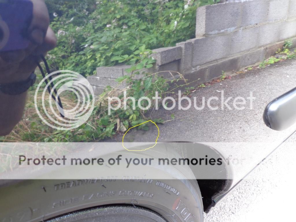

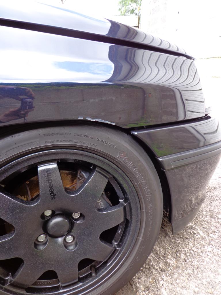

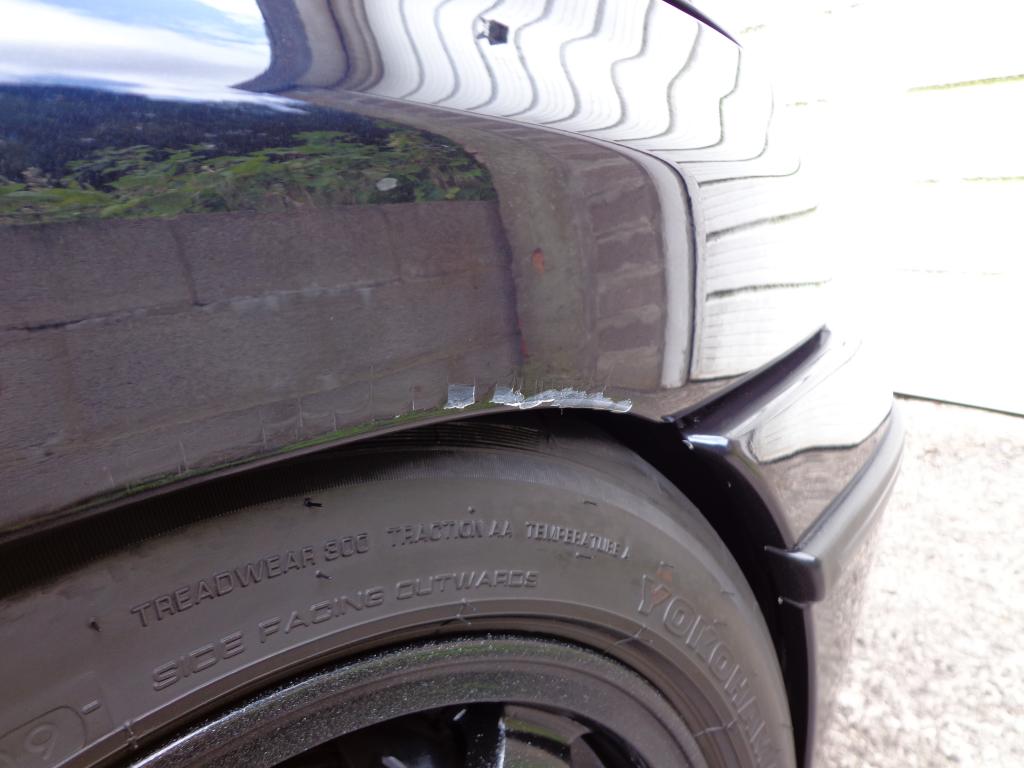

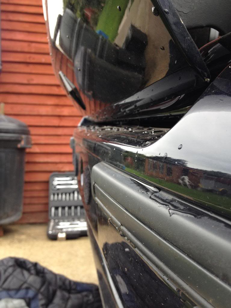

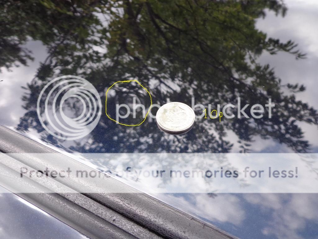

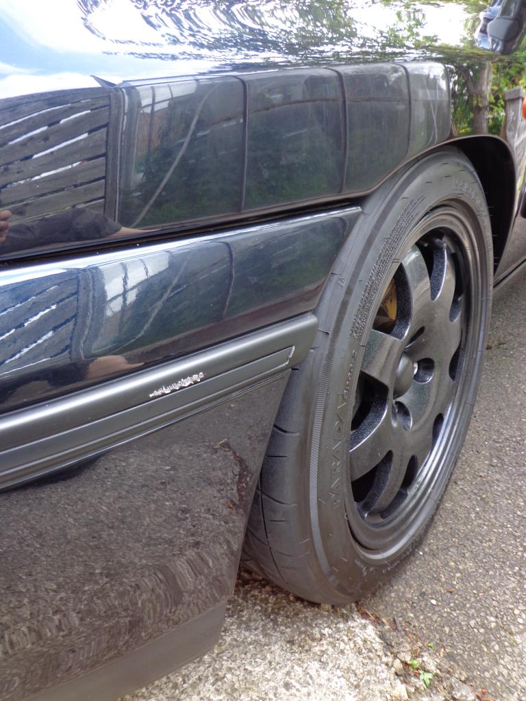

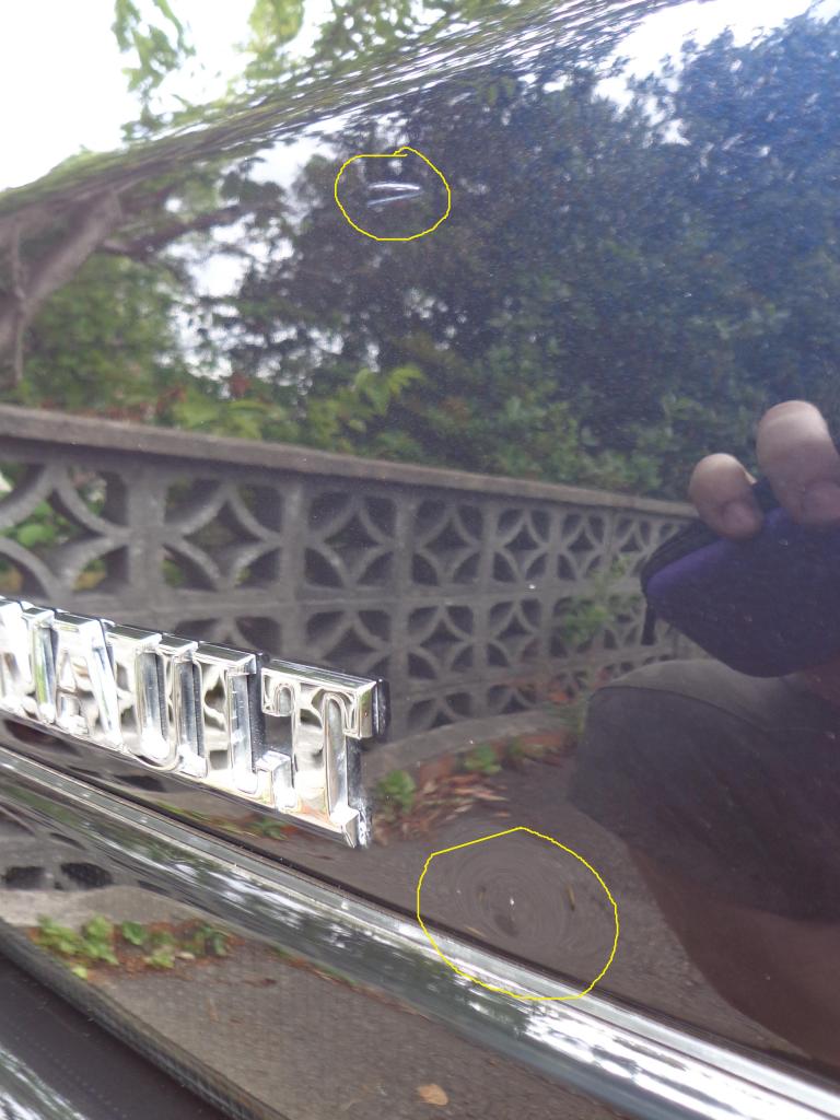

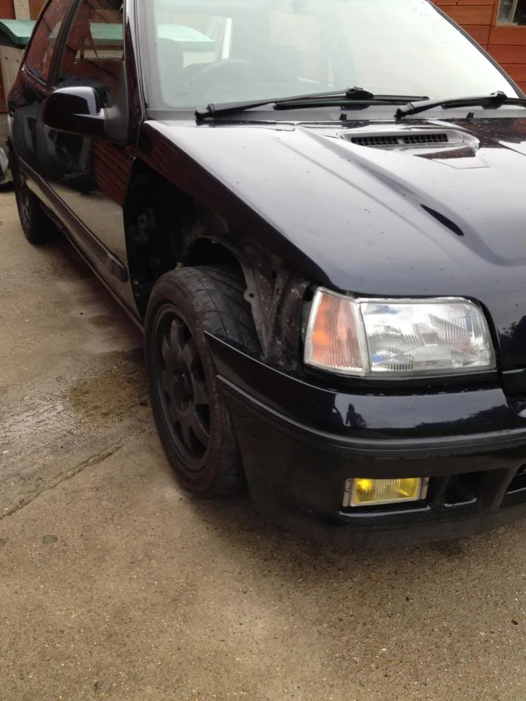

There was a few small bits of damage that Andy had kindly pictured for me prior to viewing the car so I knew up front what damage was there.
Slight bit of bubbling under the paint :(

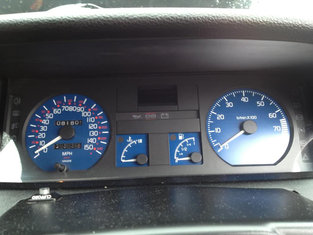

This picture is for my reference this is what mileage I got the car on.

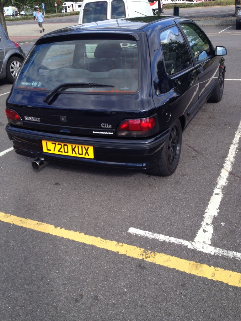

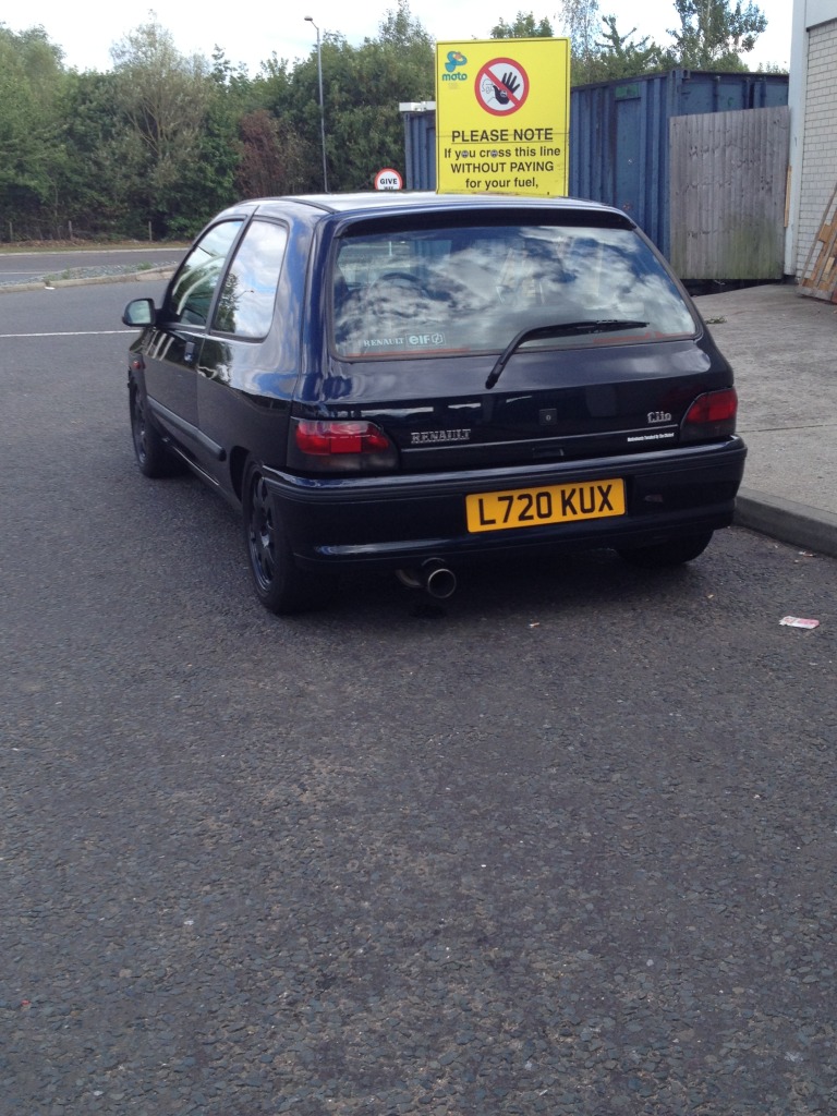

By this point it was about 4pm and I had a nice long drive back to Essex around the M25 on a Friday afternoon. So I set off.
I took a couple of pictures at Reading Services and South Mimms on the way back.

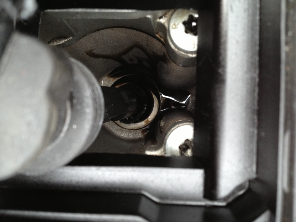

Whilst I was viewing the car Andy had noticed that there was oil in the spark plug wells which could be causing the misfire / hesitation so I knew that this would need addressing. (Thanks again for being honest and pointing it out mate as I didn’t see it at first). Either the rubber seal on the Megane Cam cover had failed or were Andy had modified the cover to make it fit the Williams Head it was allowing oil to go into the spark plug wells. Because of this I wanted to go back to the original cam cover.
Bass_Direct to the rescue! As I had to drive past his garage I gave him a quick call to see if he had a spare cam cover laying about as I wanted to change it back to try and eliminate the oil leak. He did so I picked up the girlfriend (who isn’t impressed with my latest purchase lol) and went round to see Bass. I was also met by Peter nice to meet you mate.
Anyway had a quick chat with them picked up the cam cover and set off again as I wanted to get home after being up since 5 am.
Not what I had in mind but beggers cant be choosers. Thanks again Bass ;)

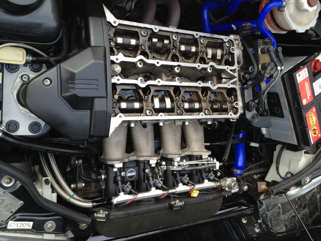

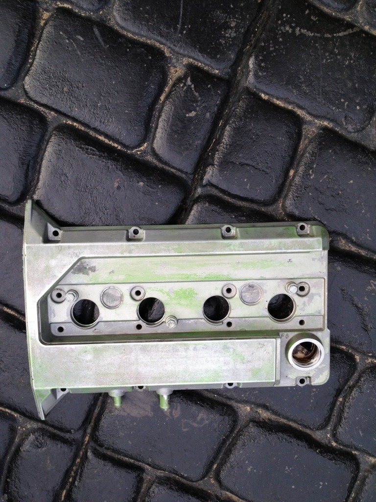

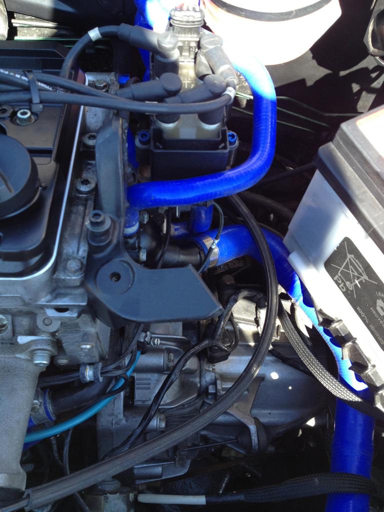

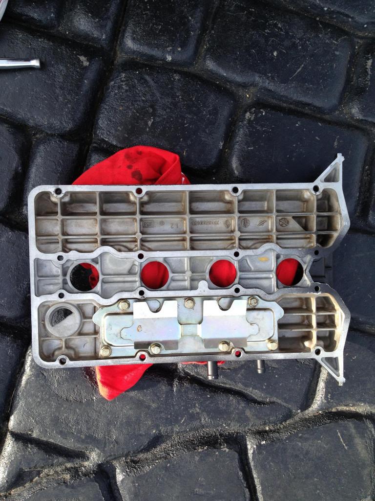

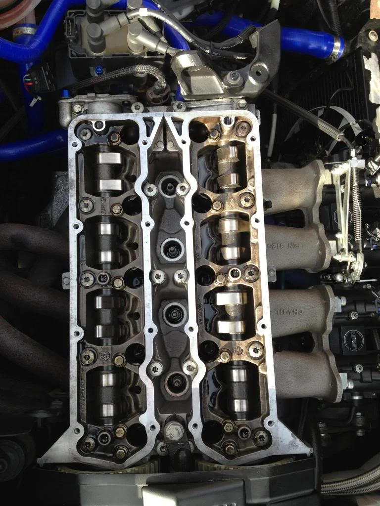

This is the reason why I am changing the cam cover and gasket. Bearing in mind this was only after 5 miles after I had cleaned it so it was losing a bit of oil.
What the engine currently looks like
5 Minutes later and I see the things that cause the lovely lumpy idle. Catcams 213’s.
That was pretty much all I could do to the car apart from try and mop up as much of the oil as possible. The main reason I did this was so I didn’t get the urge to take it for a spin.

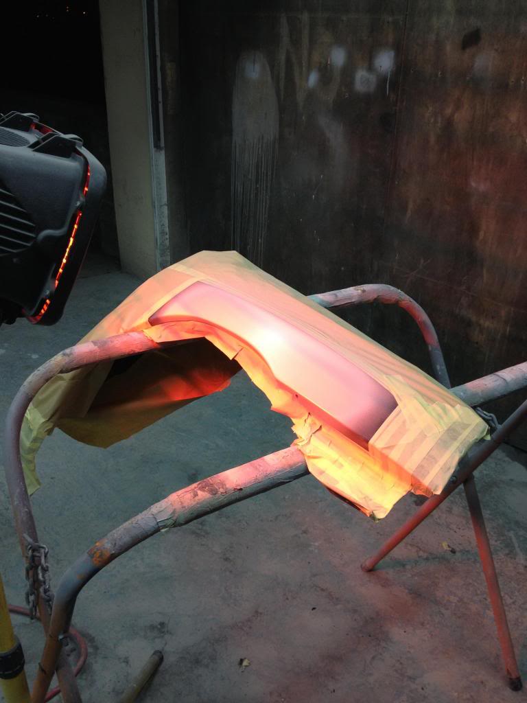

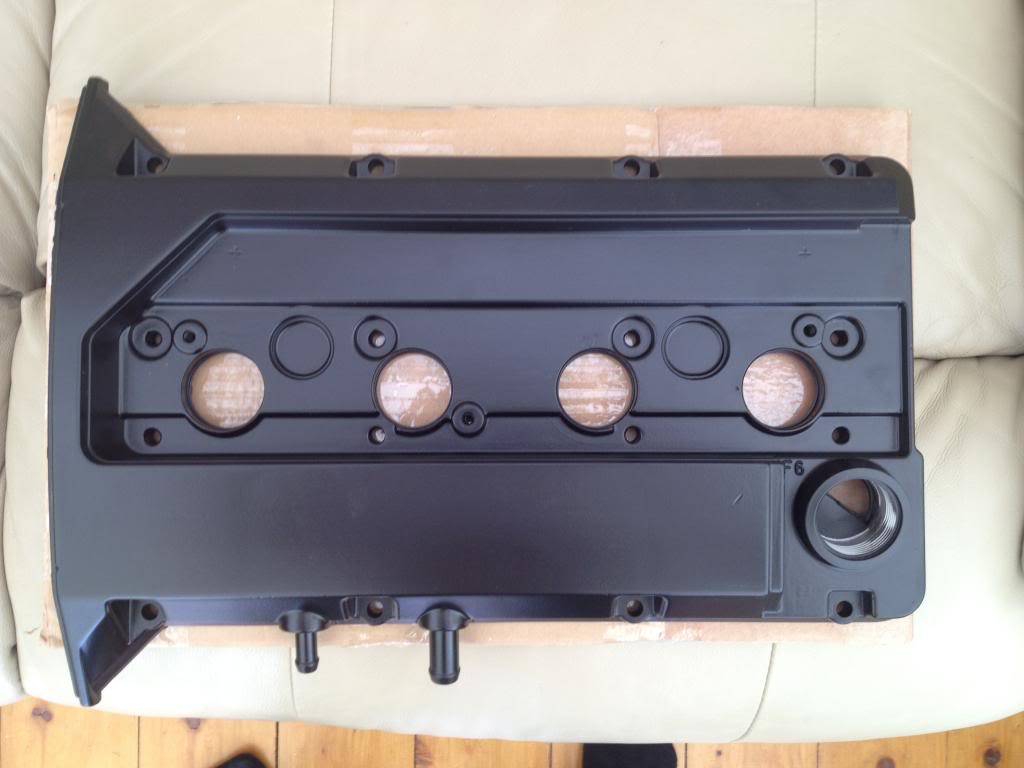

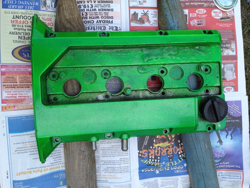

Next I made a start on the lovely cam cover. Slapped a load of nitro morse on it and jet washed it off. That left me with this.
Not overly keen on the finish (although it is getting sprayed) I decided to sand blast it to give it a nice even appearance in preparation for the spray job.
That is pretty much it for now.

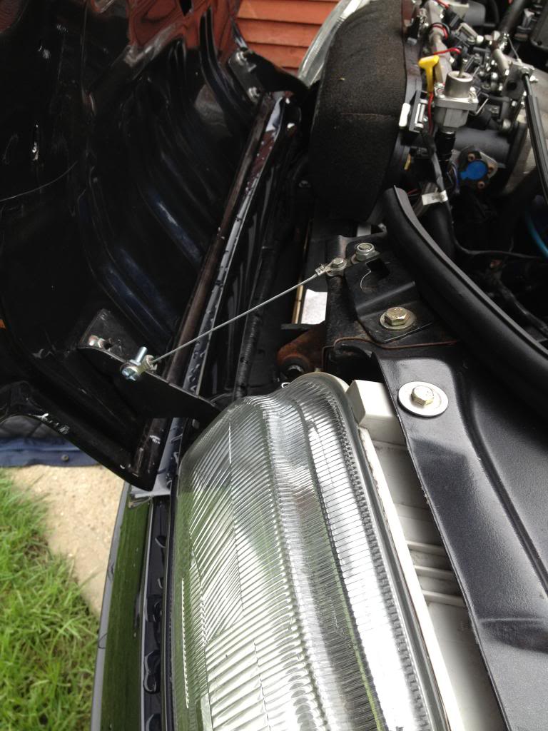

Fix the bonnet hinge to slam panel cable

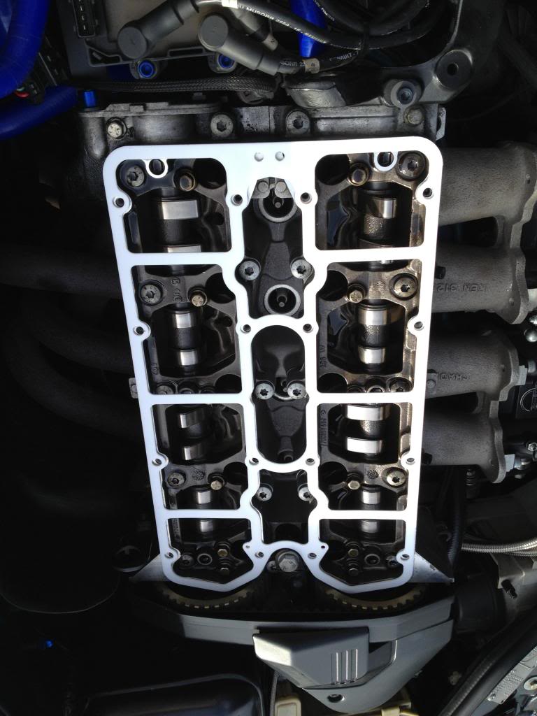

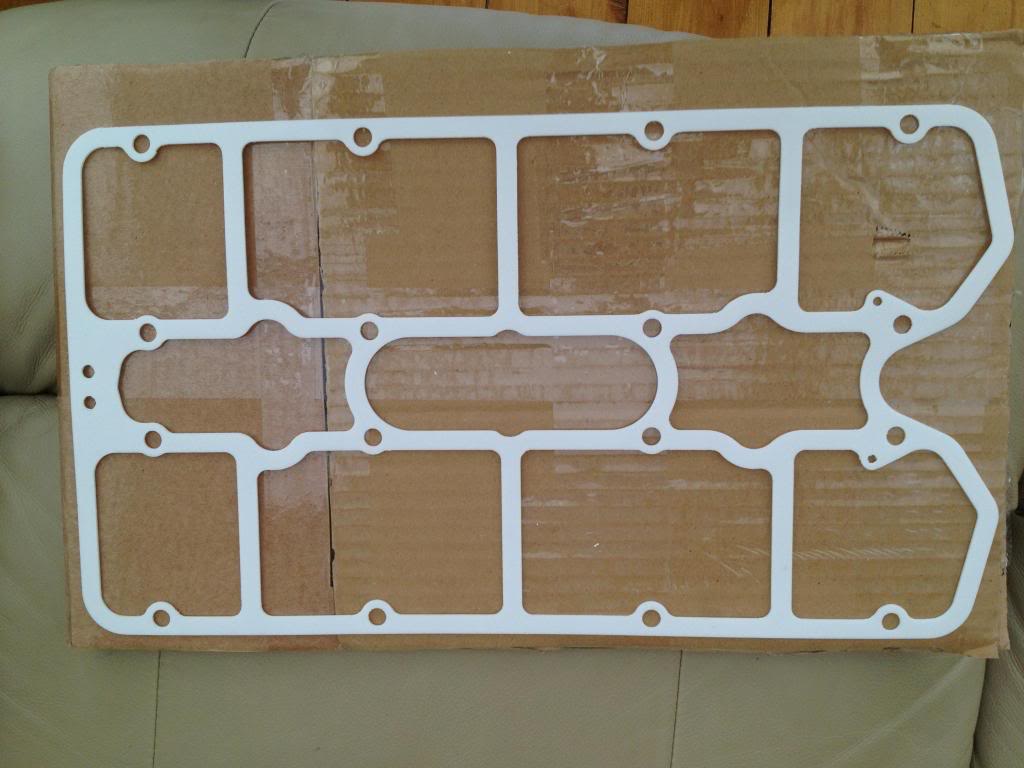

So whilst at work this little gem turned up. A PTFE cam cover gasket off Paddy. Thanks mate.

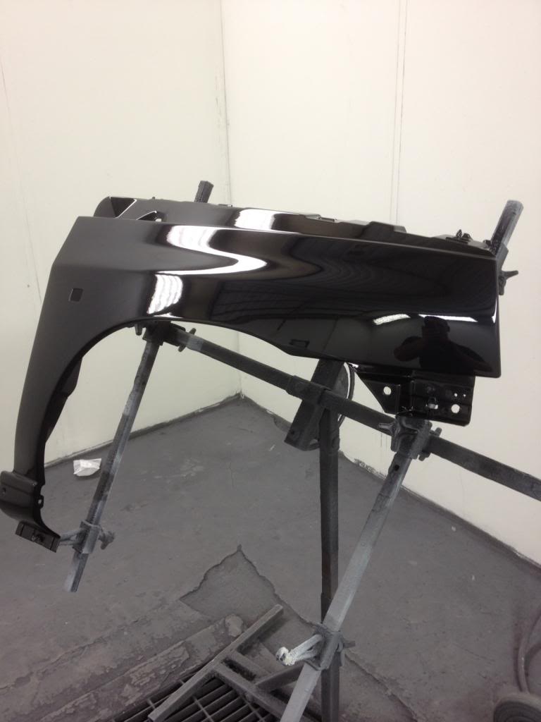

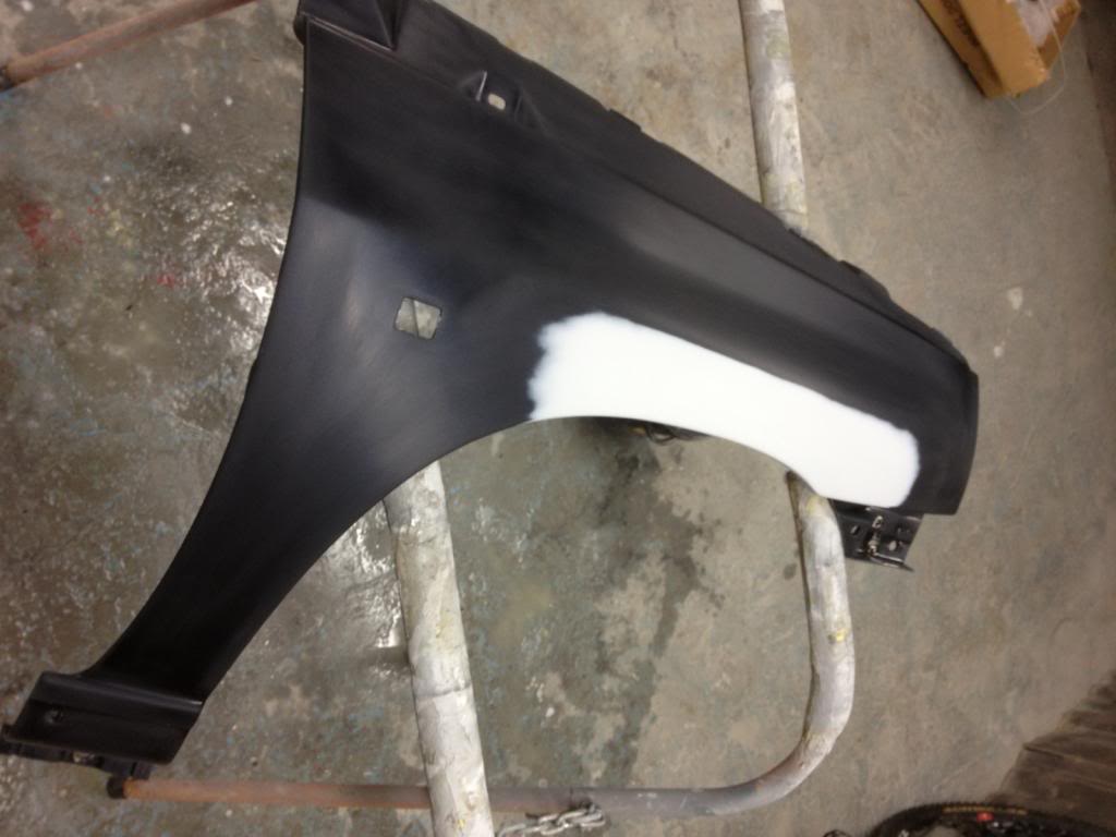

Also had this sprayed at work to go with the black theme under the engine bay.
I then set about cleaning the rest of the oil outside of the spark plug wells. I mopped up as much of it as I could and then removed the plugs to see them in this state.
I gave them a little clean up and put them back in the car. Quick snap of no more oil in the spark plug wells.
Spent what seemed like an age cleaning all of the beat blast media out of the inside of the cam cover as I didn’t want any bits getting into the engine. Bit of liquid a brush, then a cloth to wipe it followed by some compressed air. I then fitted the baffle bit for the breather.
PTFE Gasket in Place
Cam Cover all on and in place. (Excuse the bodge with the breather and blocking one of them off this is temporary until I can get the necessary pipe work to fit a oil catch tank.

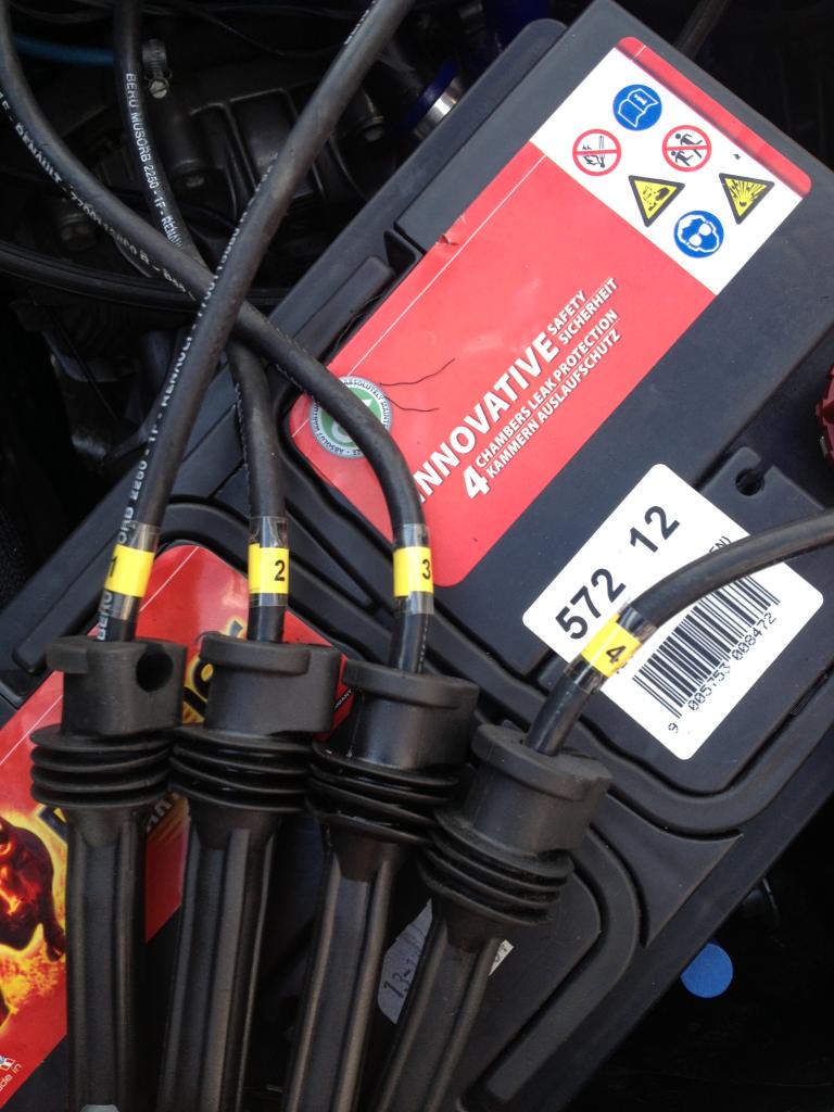

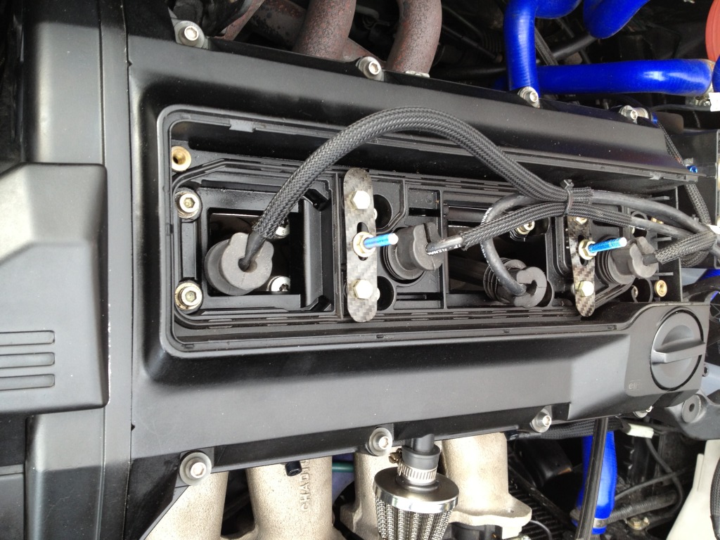

Because of the position in of the coil pack and the ht lead numbers not meaning much I am not sure whether I have put them in the correct order. I ignored what was on the ht leads and just put a lead on number 1 on the coil pack to the first spark plug flywheel end. Then number two to the one to the left of the first, then three and so on. It doesn’t appear to missing like it would if the ht leads were on incorrectly.
The main reason for me changing the cam cover gasket and cam cover was because I did not want any oil going on the plugs as I thought this was the cause of the hesitation under partial throttle. Anyway no more oil on the plugs but I have noticed that it only hesitates under partial throttle when hot. When cold it drives fine. So after speaking with a few of the guys C16v I was recommended by Dave to get a set of these plugs as he had a similar issue with Ronee’s old engine and when he changed to these plugs it sorted it out. Hopefully it is this simple for me....

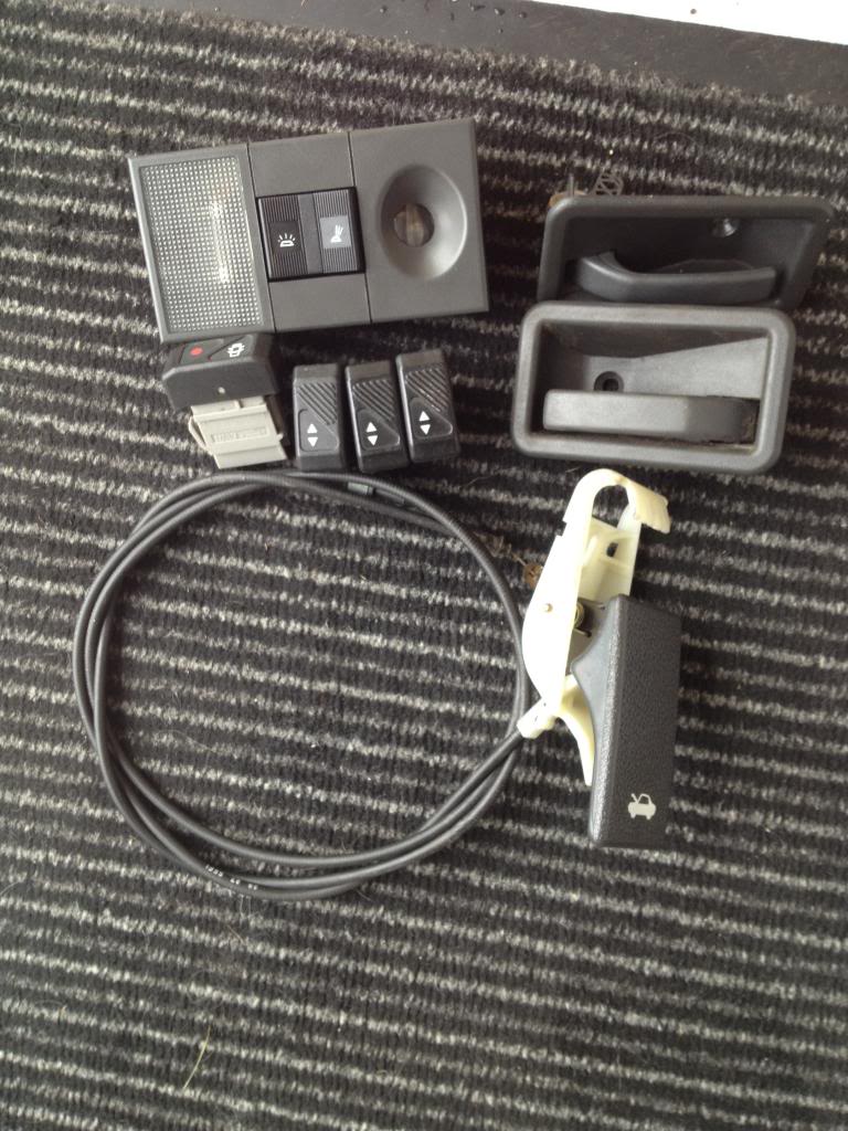

So I had this little parcel turn up from Bubs&Co. Thanks guys.

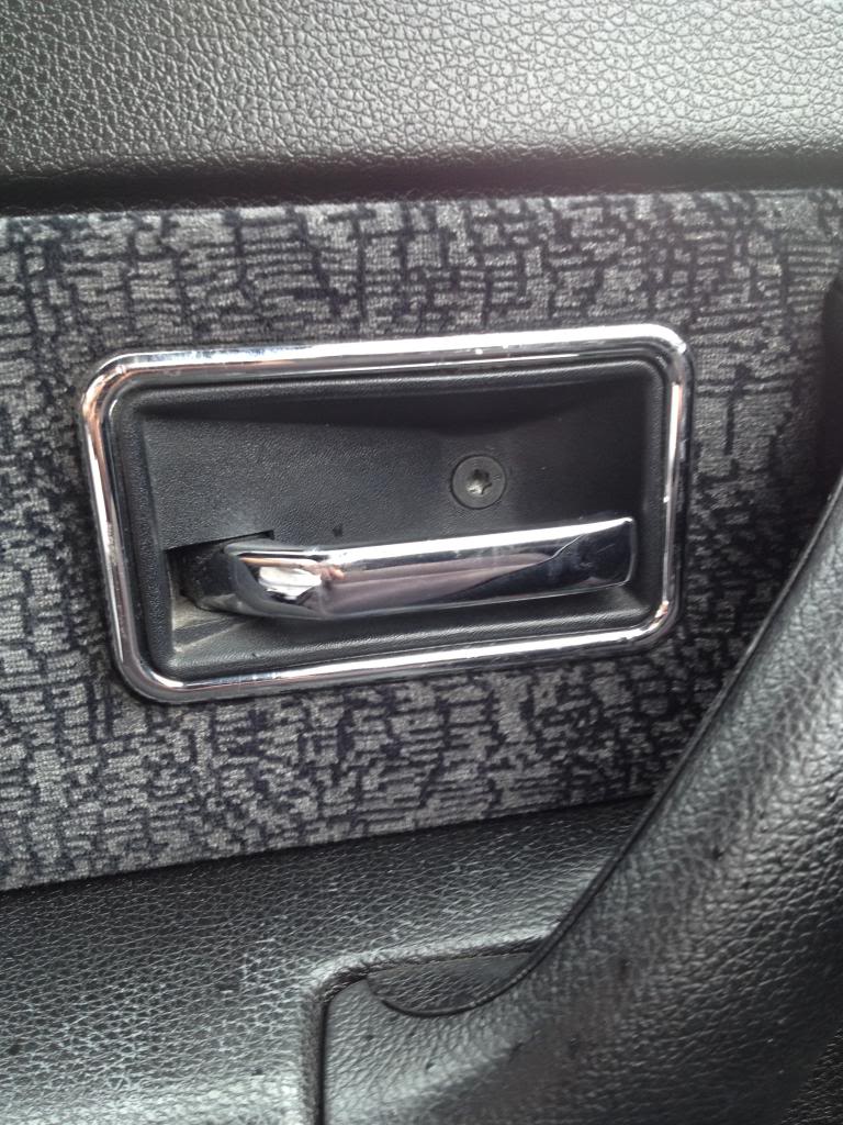

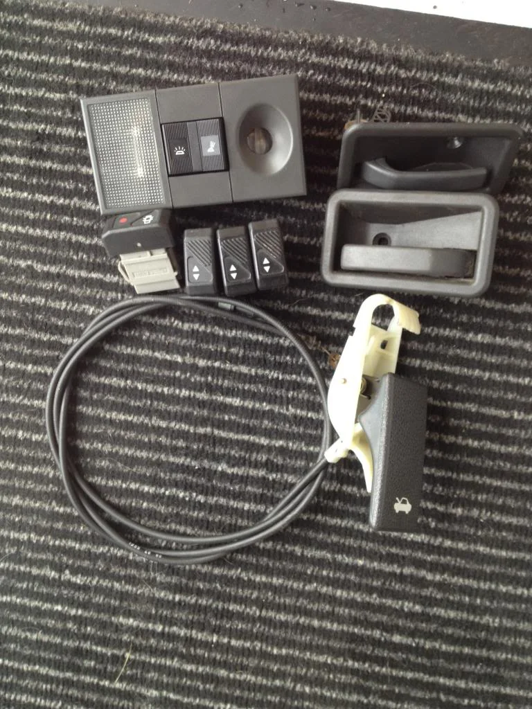

First thing was first I wanted to remove those interior door handles. I set about removing the passenger one and fitting the new ones that Bubs&Co had provided. It was literally on there for 10 seconds before I removed it and put the other ones in place. I much prefer them to the standard ones so these will definitely be staying.

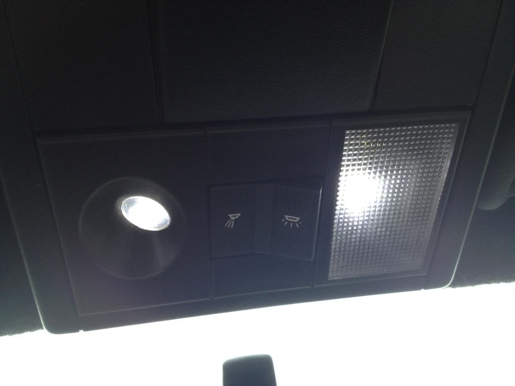

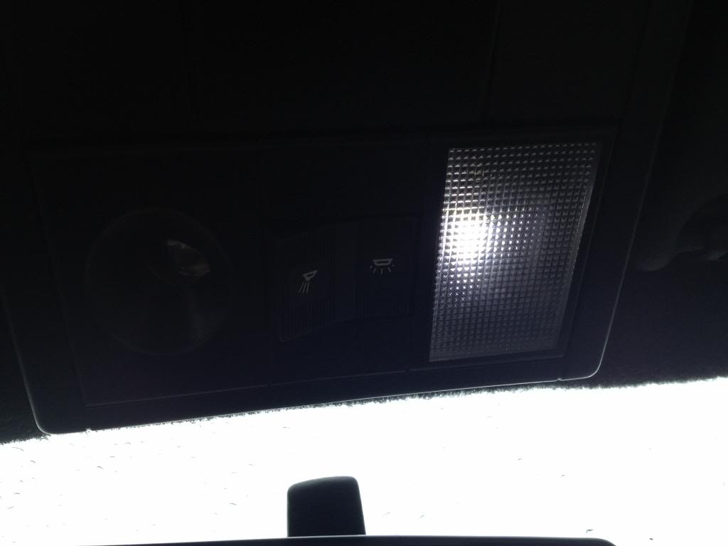

Next was the interior light. This did not work because the switch mechanism was broken so the only way I could get the interior light working was if I opened the door. (Not ideal). I removed the mechanism cleaned it up, put the led bulbs in and played around with the connections on the back so that I could get the LED bulbs to work. It was all working but only when I applied pressure to the back of the plug. I was going to tape it in place or something but my bright spark girlfriend told me to just put it up there as the other plug that was up there would apply enough pressure to make it work. She was right and I don’t like it when she is right when its to do with cars lol. The only problem now is that the led light on the right hand side (the door open one) is light quite dull all the time and I am worried it will drain the battery of the car. I removed it and put a standard one in but if anyone has an ideas that would be a great help.
Before:
After:

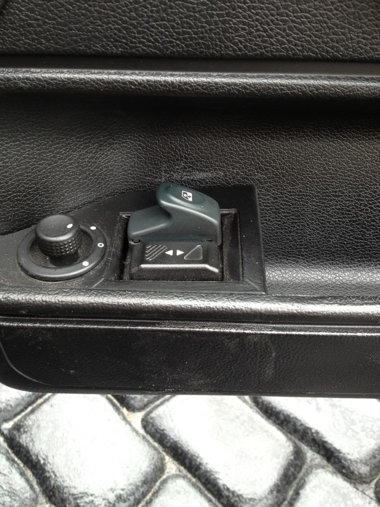

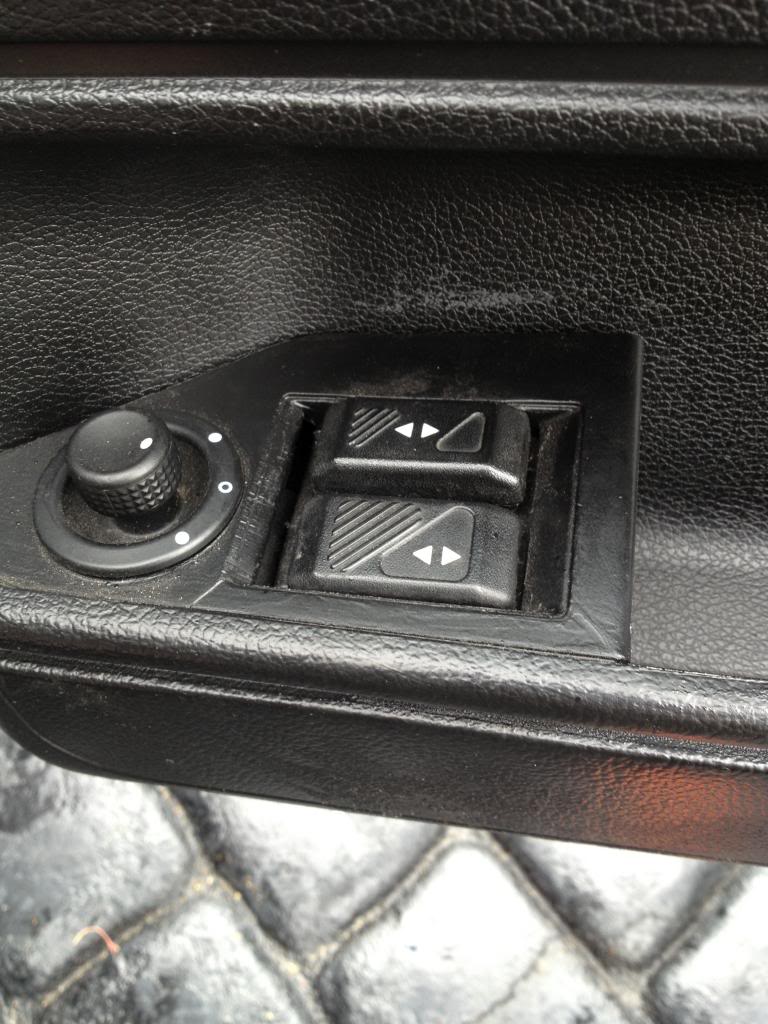

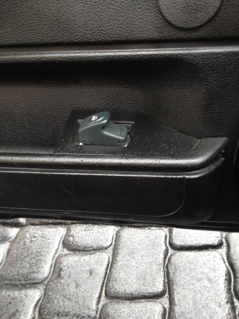

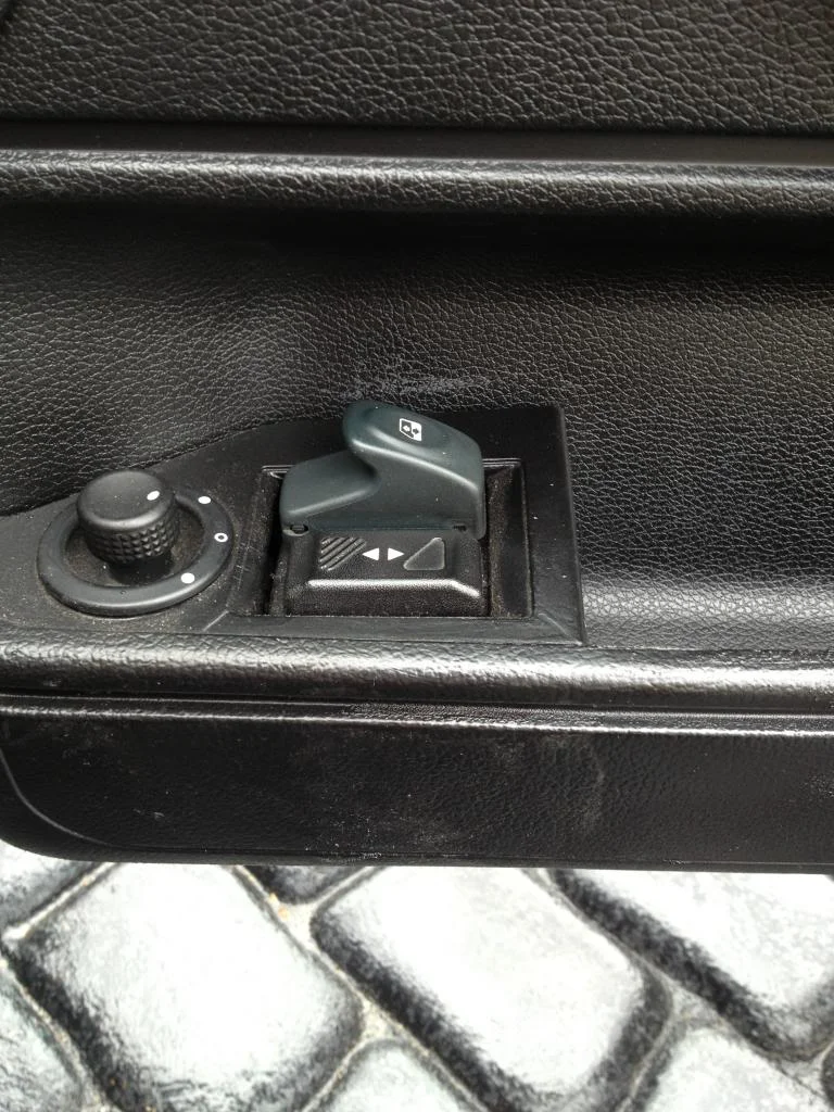

Next on the list was to remove the megane switches. Personally not to my taste so these were removed and standard ones put in place.
Before:
After: (Forgot to get a picture of the passenger side)

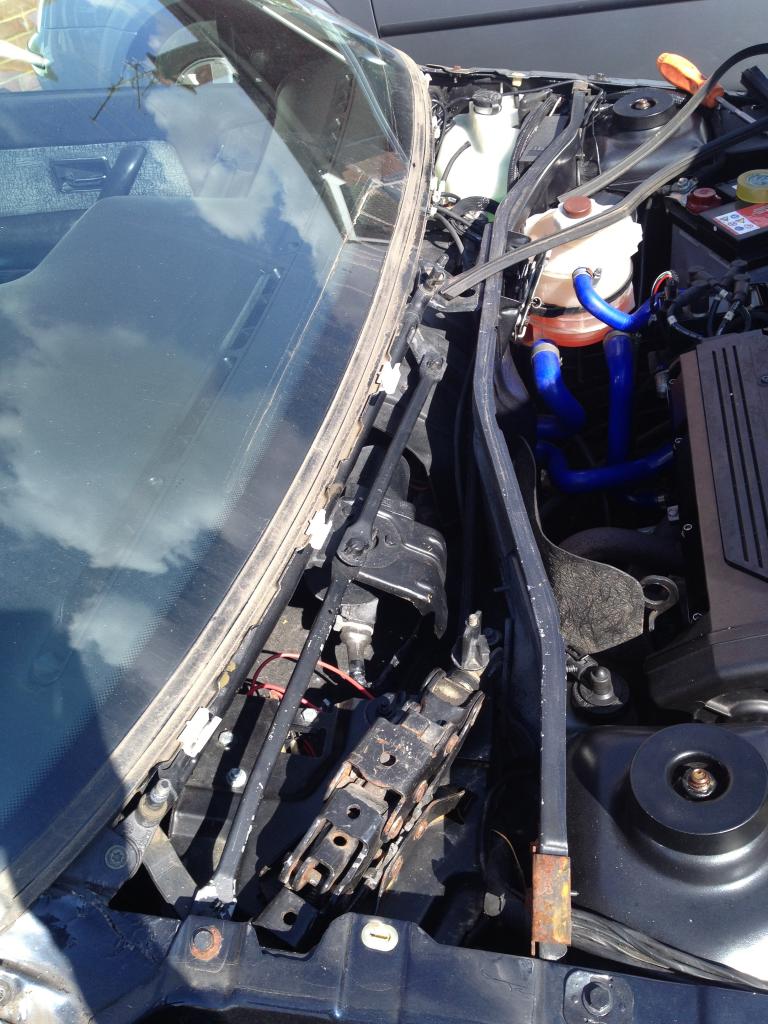

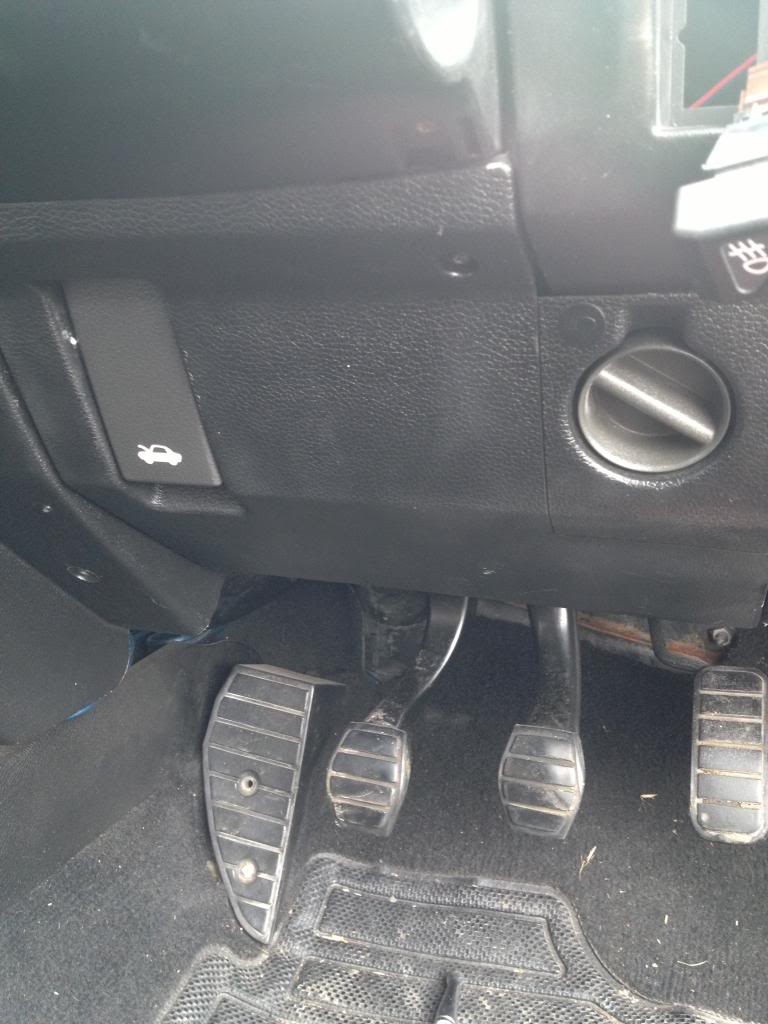

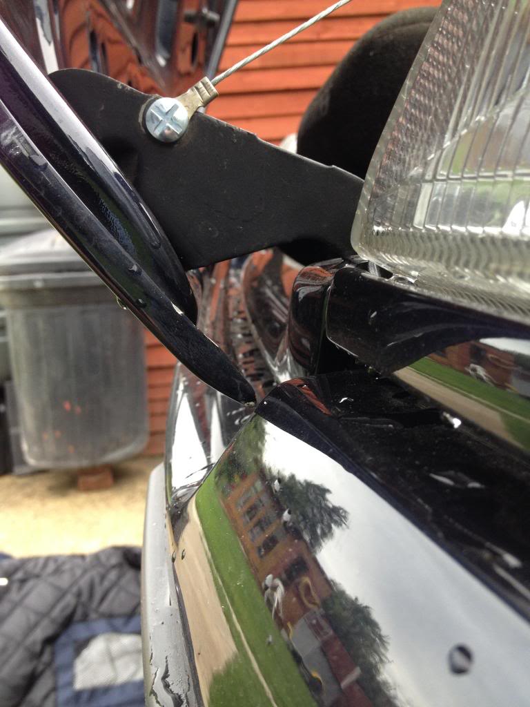

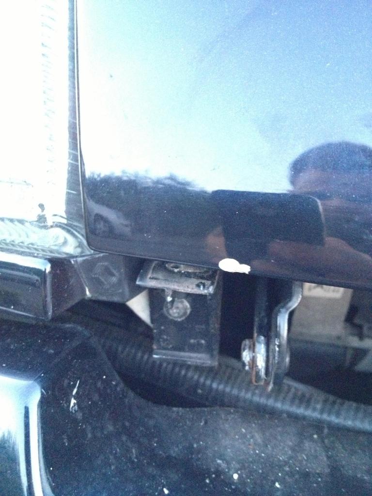

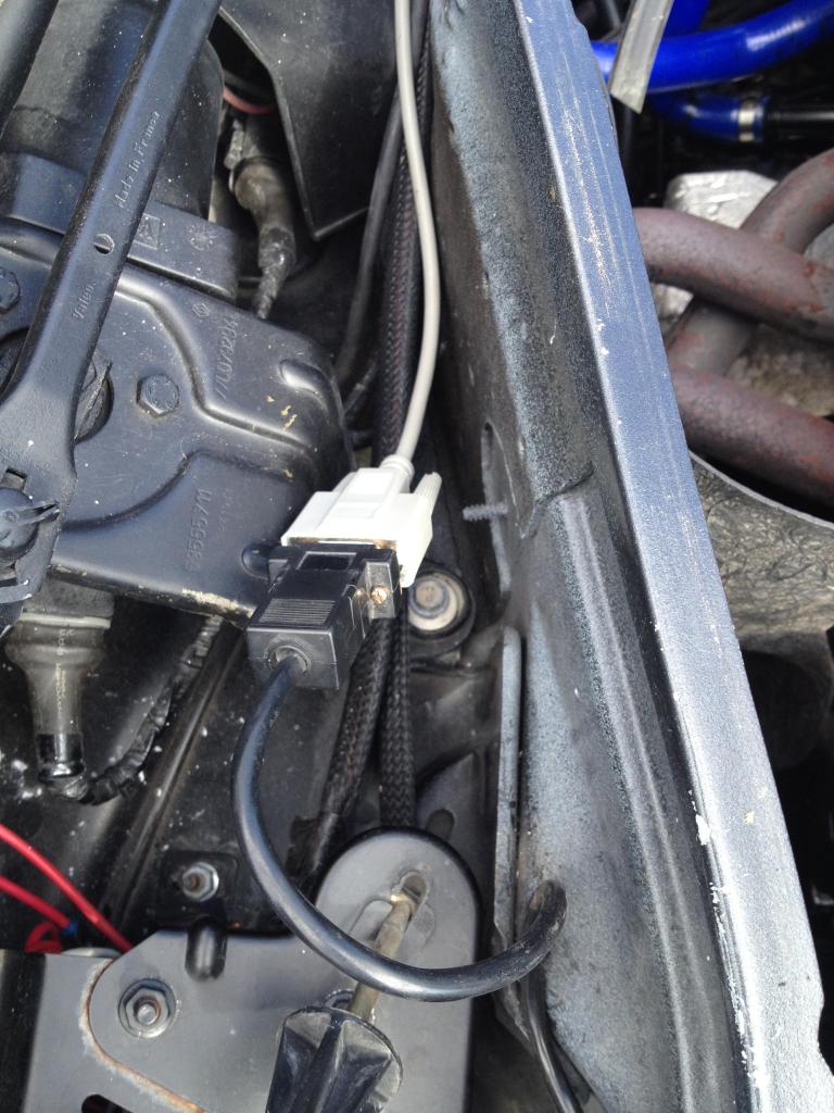

Next on the list was to replace the broken bonnet release catch. This was done quite easily actually. It so much easier than using pliers every time!

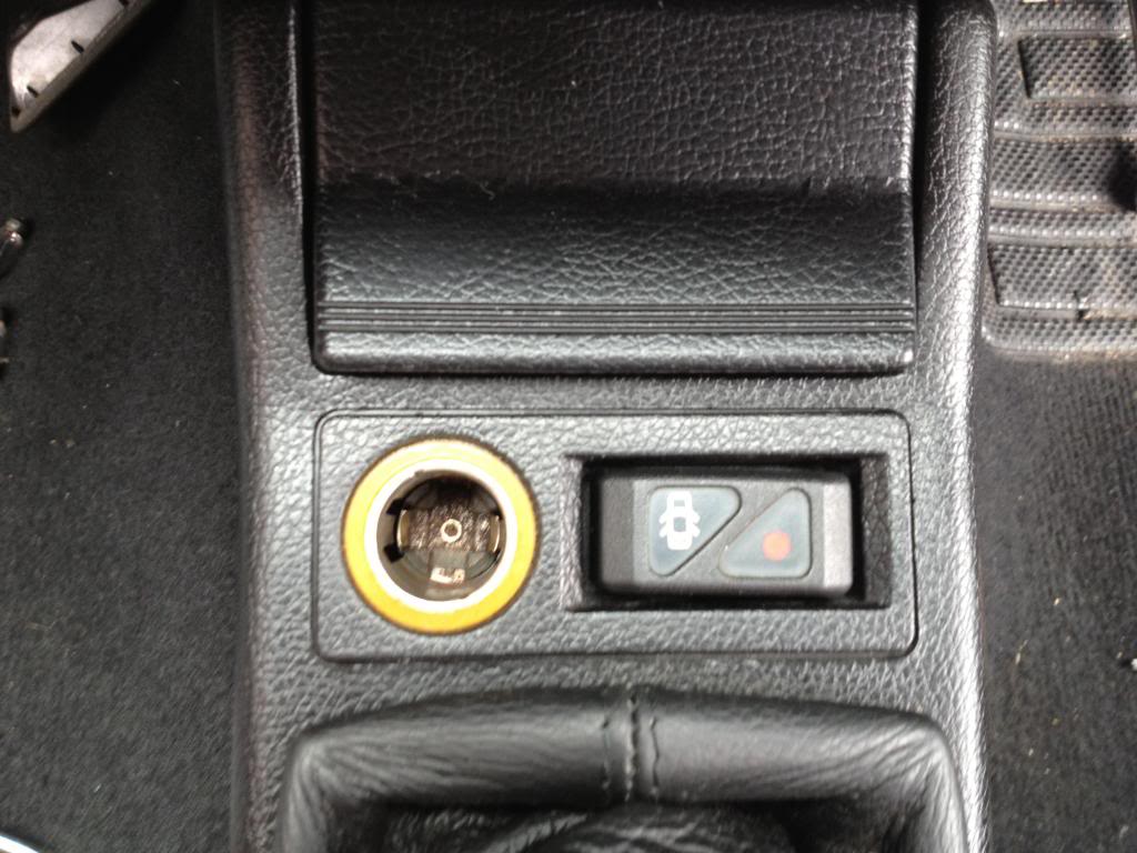

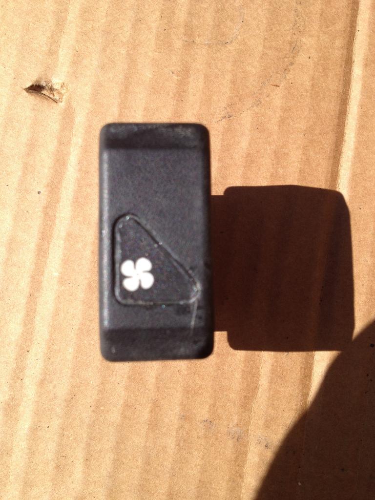

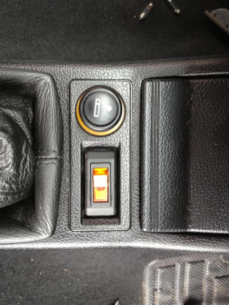

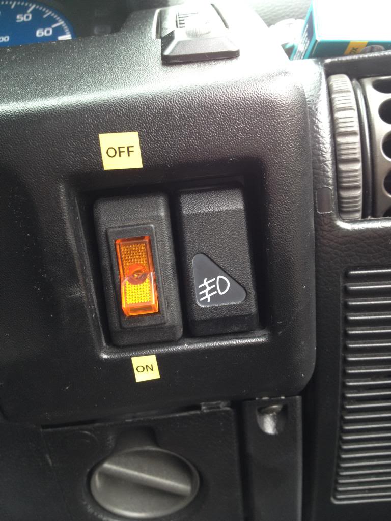

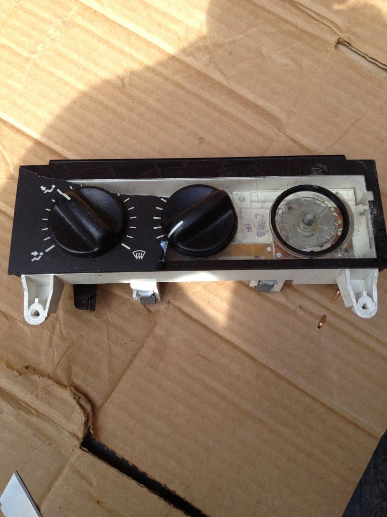

Now for a silly mod just to ensure I don’t forget to put the manual fan switch on for the cooling system. Don’t want the old girl overheating and as she is not my daily these things I am more likely to forget.
Before:
After:
This is the current location for the fan switch (the central locking switch normally goes here).

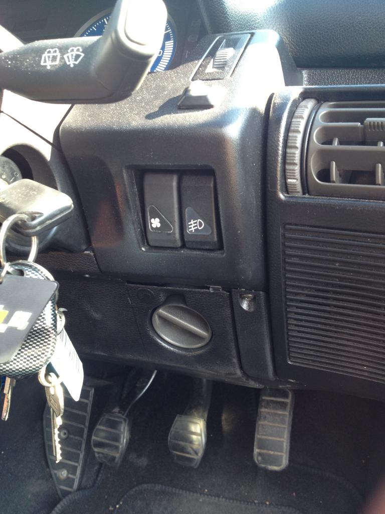

So I replaced it with this switch. Unfortunately I have a different plug and the switch the was provided (and the other 5 spare switches I forgot I had) won’t fit). I snapped some of the plastic on the switch so that I could at least fit it and try it but all that did was blow a fuse which I did not figure out until later when I tried to lock the car when I was out (DOH). So maybe I need a different style switch if anyone can help.
This is just with the switch in place not actually wired up.
Wiring rerun and the fan switch relocated next to the front fog light switch.

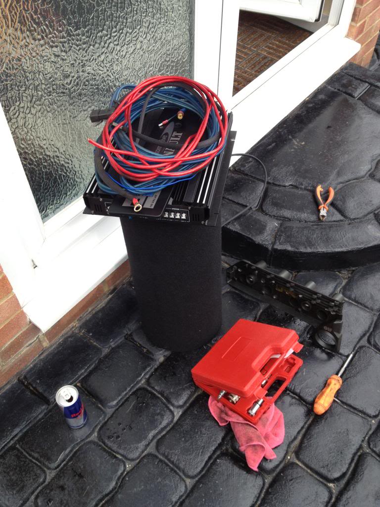

Next on the agenda was to remove all of the sub and amp wiring as I will not be running this. What I should have checked before I did this was that the speakers were not running off of the amp (which they were) so I currently have no music in the car. Going to need to rewire everything in place with the help of Hybrid_Beeson (he just doesn’t know it yet) lol.
All the stuff removed from the car. Sub and Amp is for sale (don’t know what they are worth so hit me up with offers ;) )

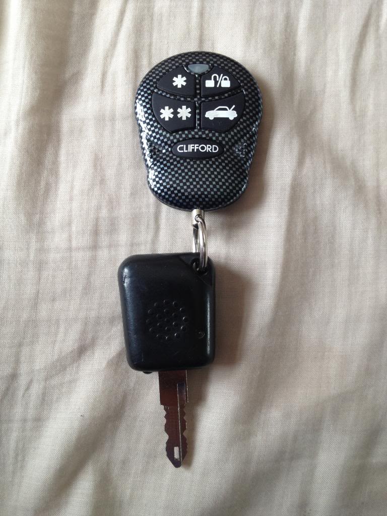

Finally the last part of the update. Andy kindly provided me with a blank key and spare fob for the alarm so I thought it would be wise to get it cut before encase I lose the only cut key that I have.

Fix the bonnet hinge to slam panel cable – Need to do any ideas where to get the cable?

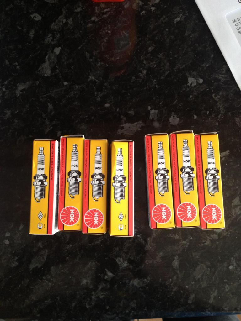

Not an amazing update but I bought some new spark plugs (same as an Aston Martin Vantage) as I wanted to rule out my spark plugs being the issue for the hesitation.
Unfortunately they miss packed and only sent me 7 luckily I only need 4 ;)

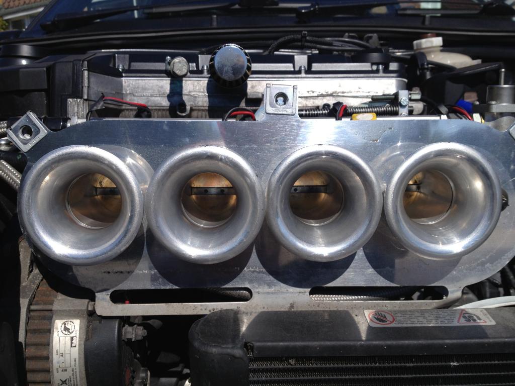

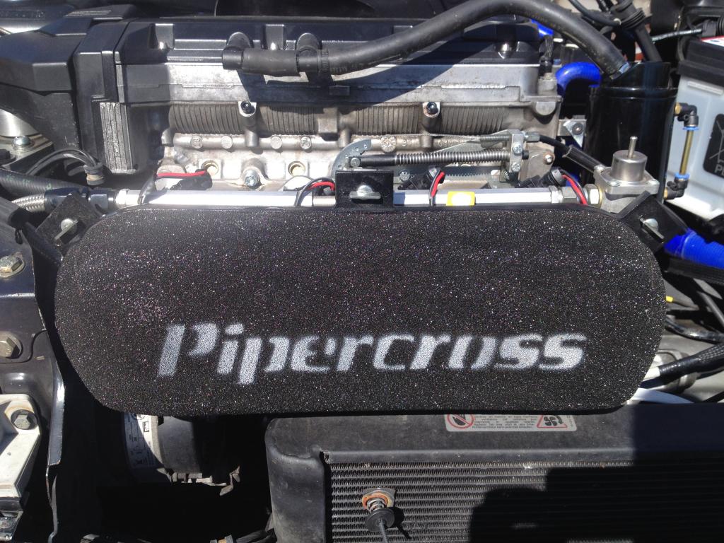

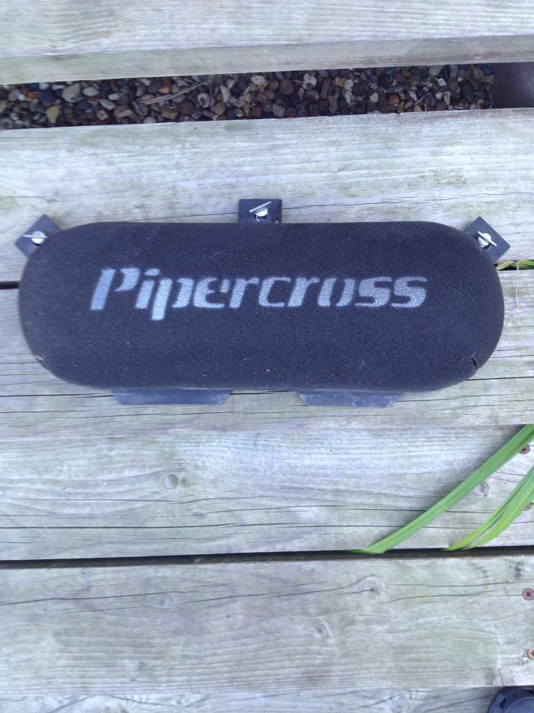

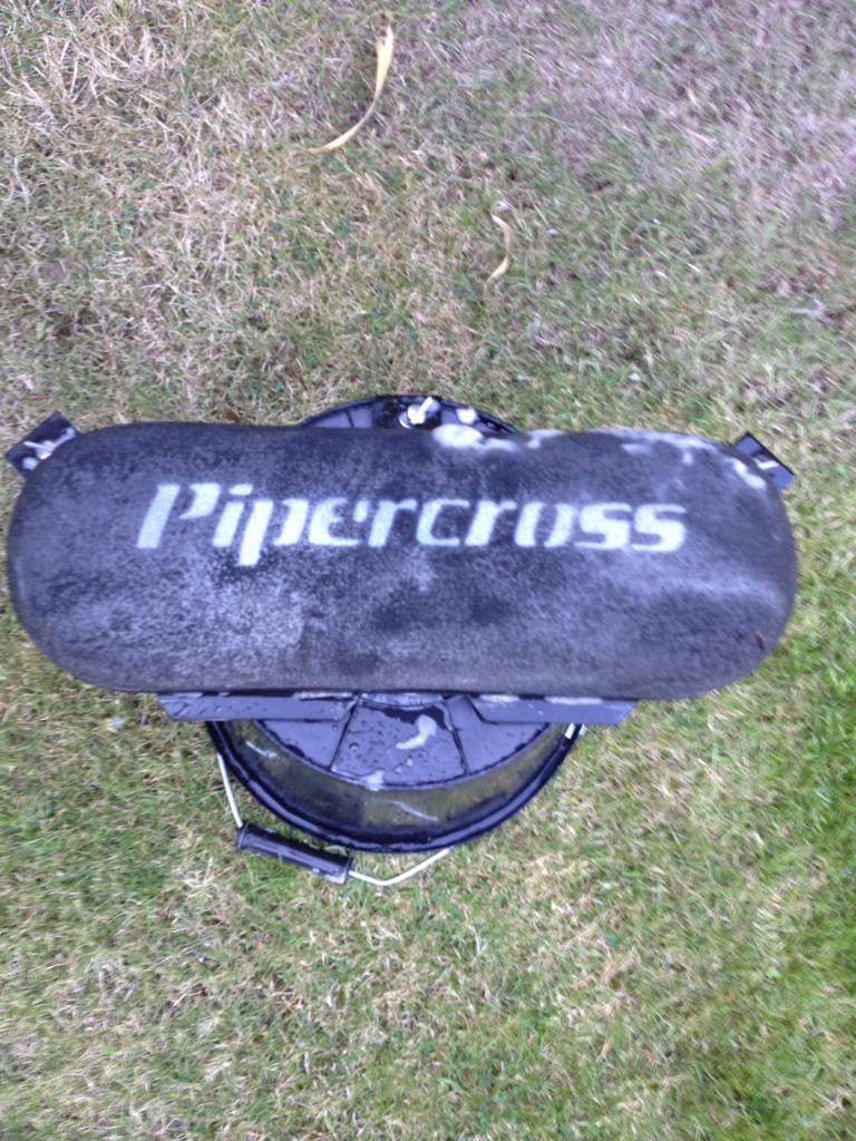

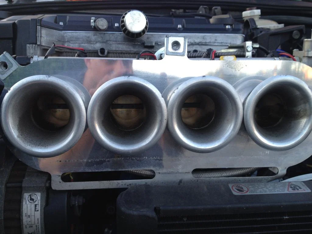

First job on the list was to clean the dirty air filter that protects the trumpets! I had noticed a few days previous that the trumpets looked a bit dirty. I had removed the airfilter to try and explain to the other half how it all works..........in the end she nodded and agreed lol.
Removed:
Cleaning:
Dirty Trumpets:

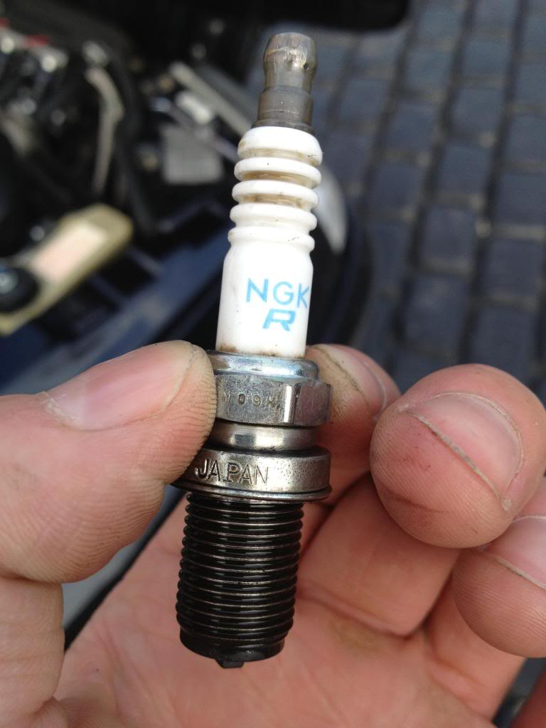

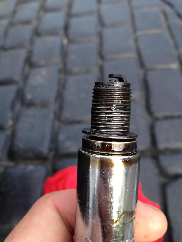

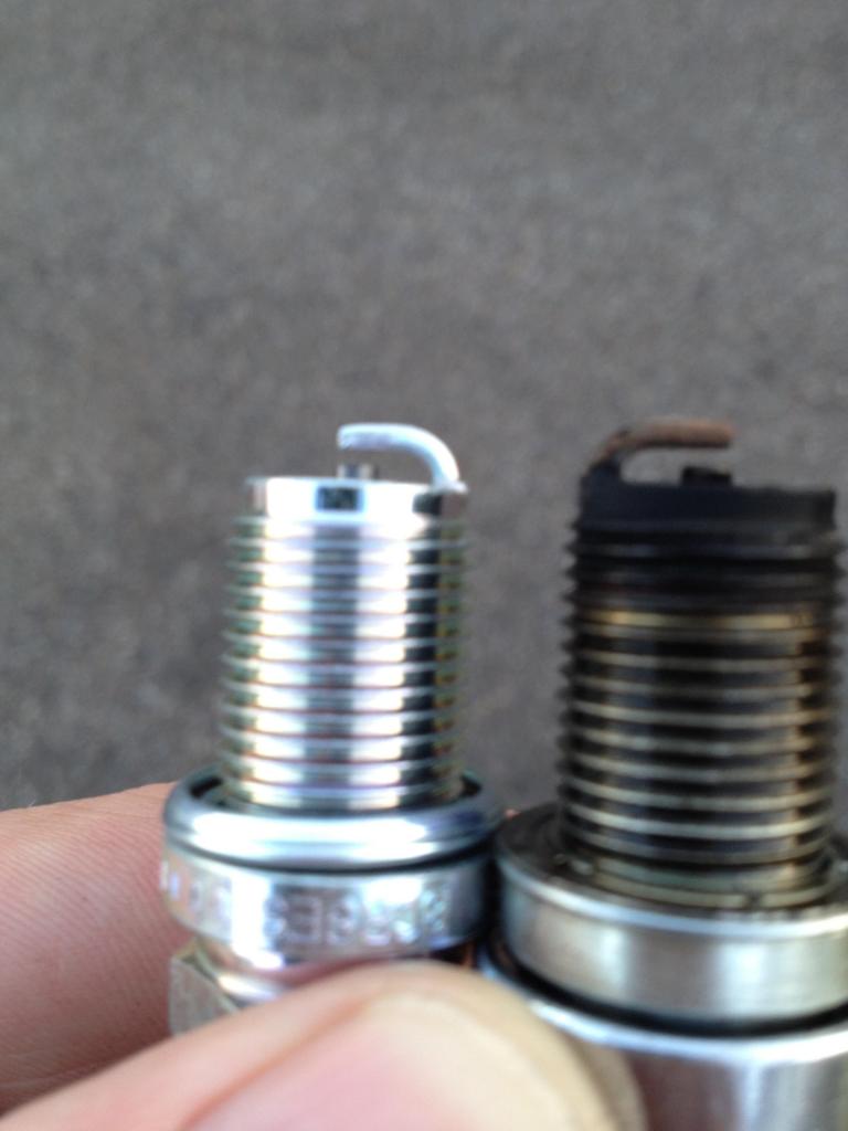

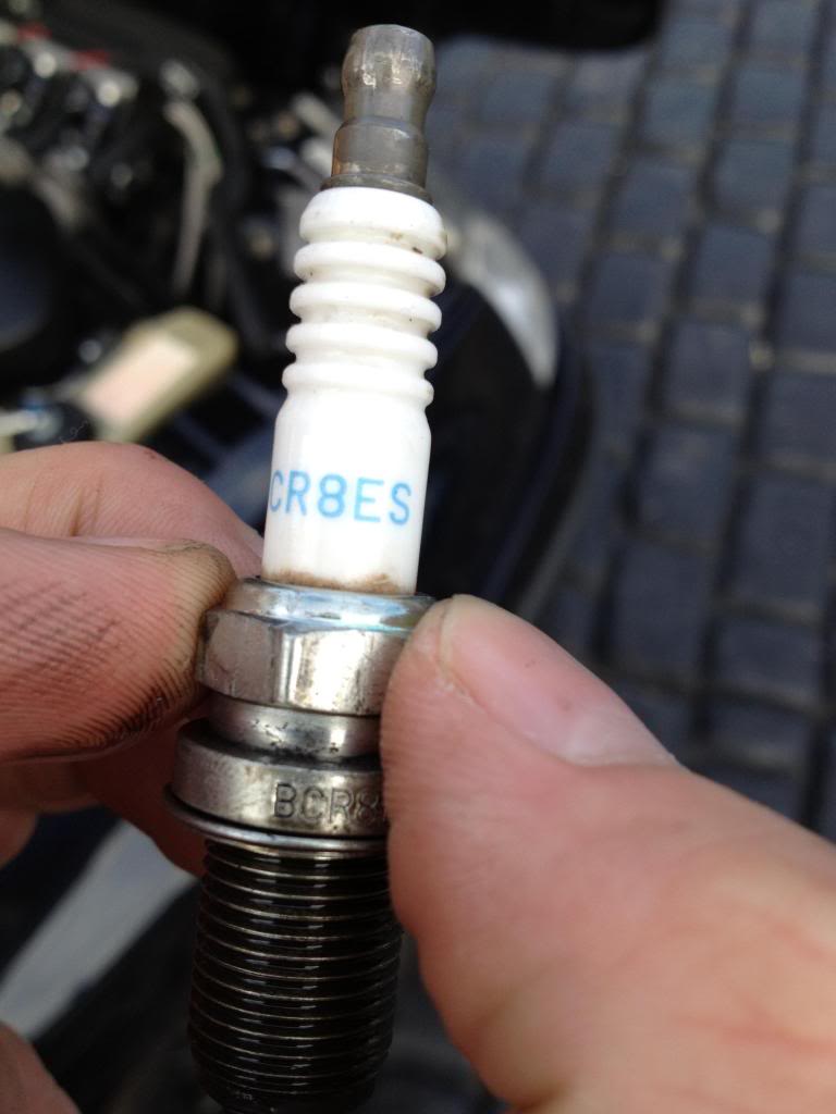

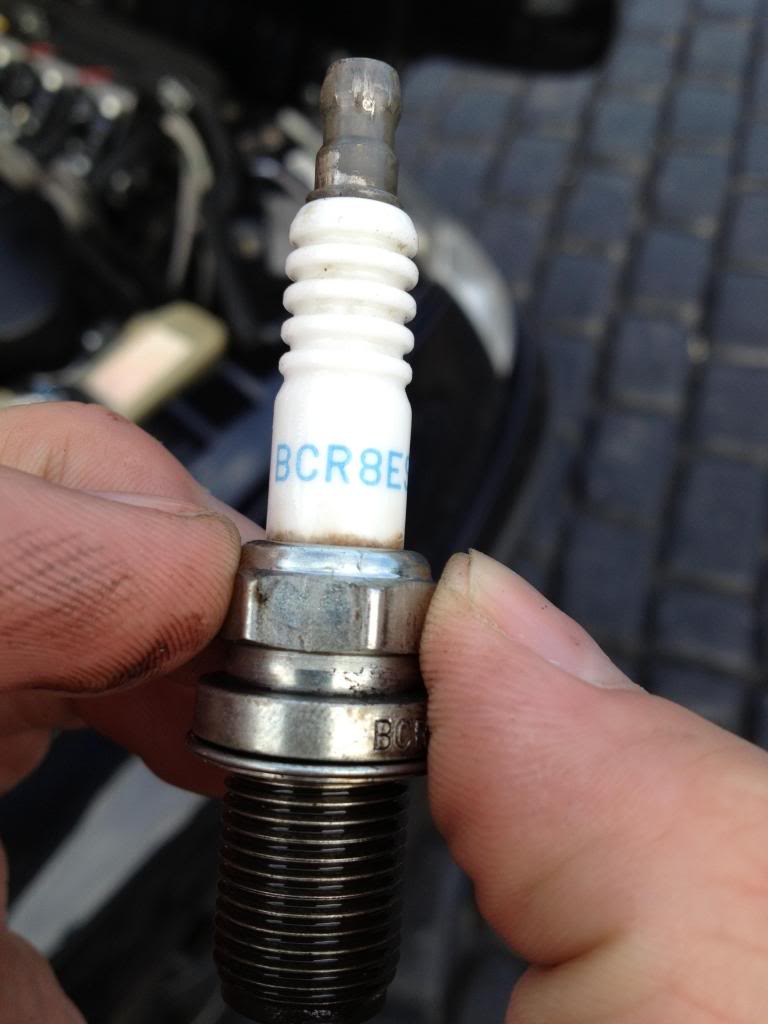

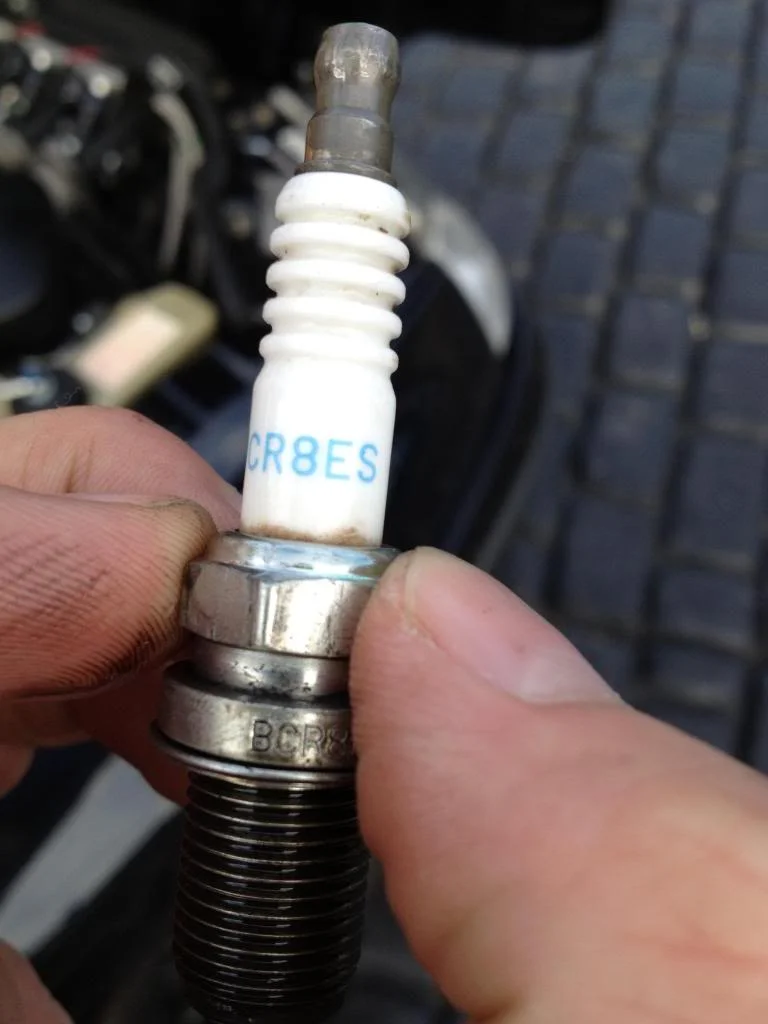

I then got distracted and thought about changing the spark plugs. I have got the mileage written down somewhere when I changed them so need to dig that out to put in here.
You can see the difference between the old and new spark plugs below.

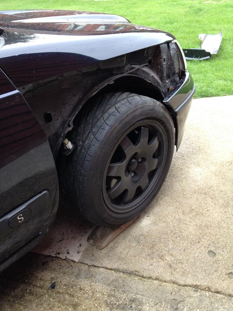

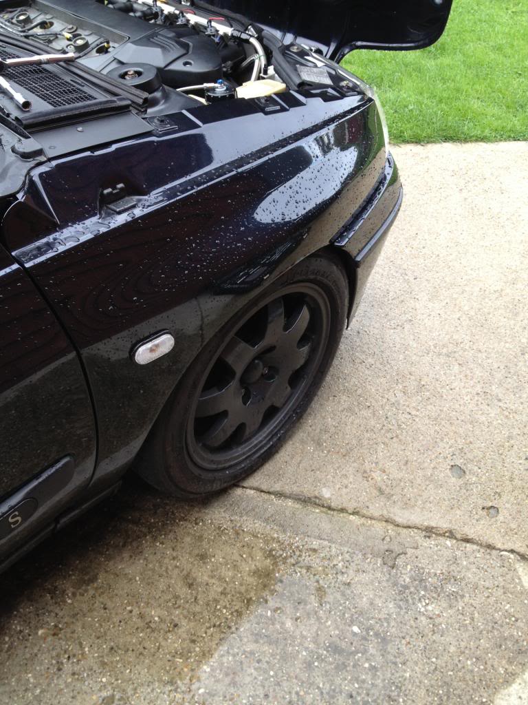

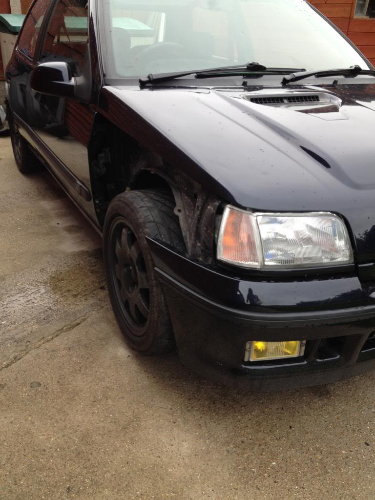

And the damage from the day. Note to self do not try and refit a mk 1 bonnet on your own whilst trying to pop the hinges in the correct place to get the circlips on.....FAIL

Got back on track with cleaning the trumpets today:

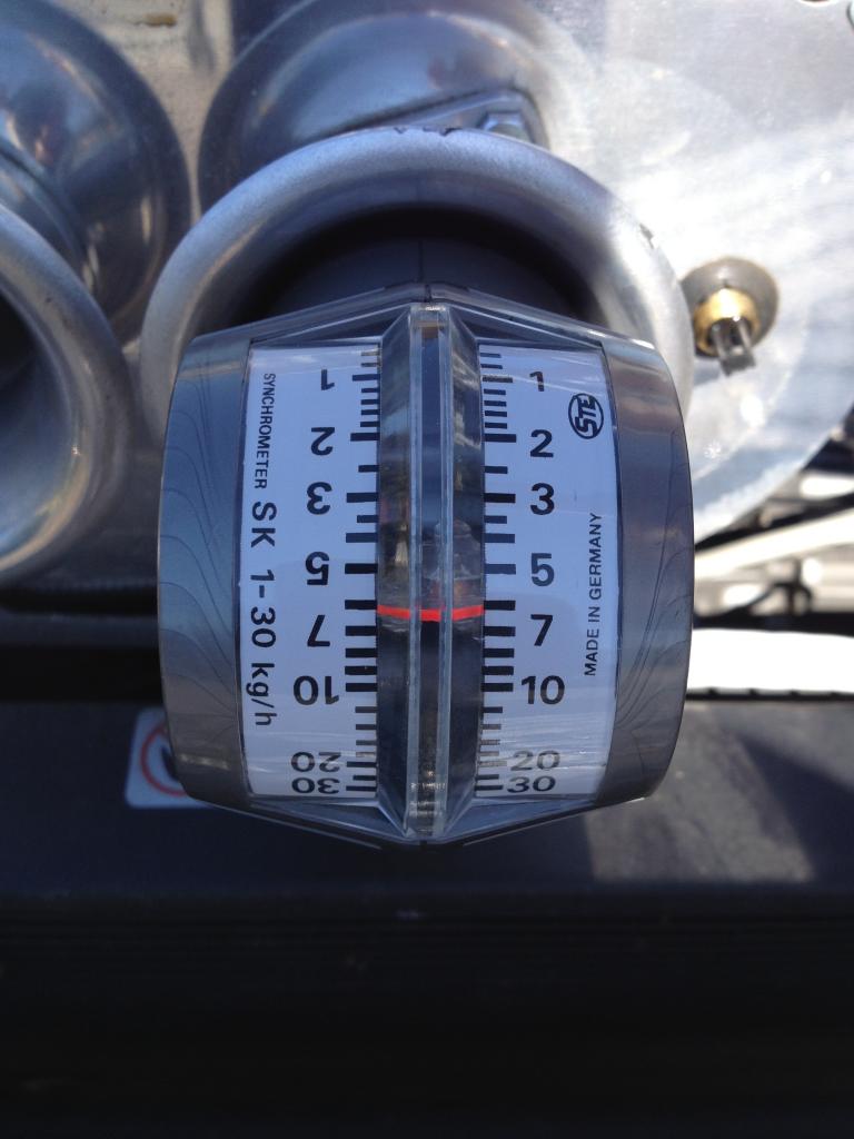

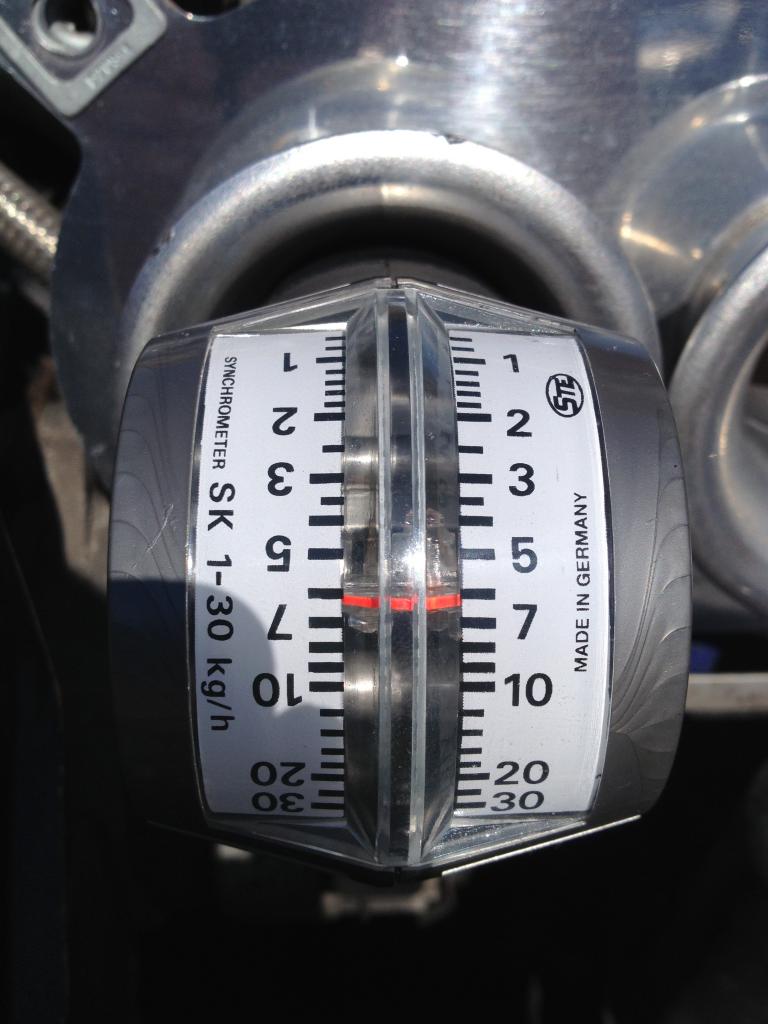

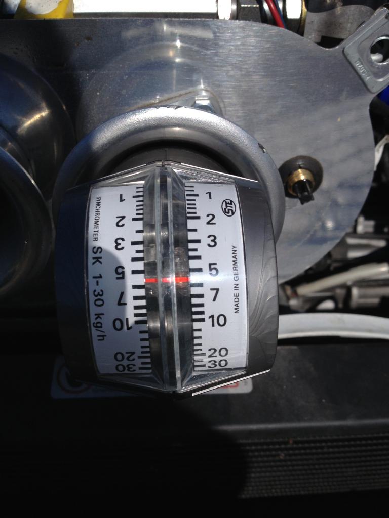

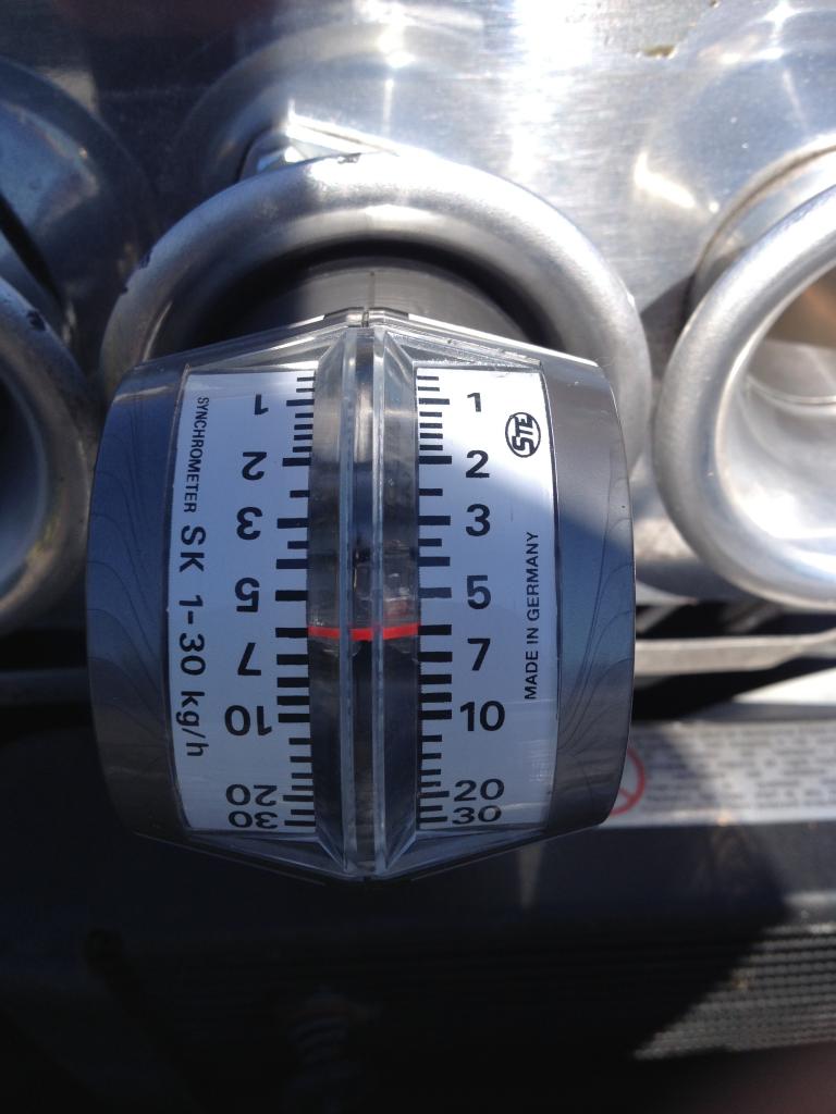

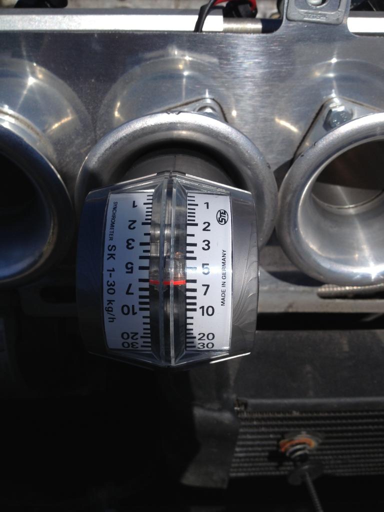

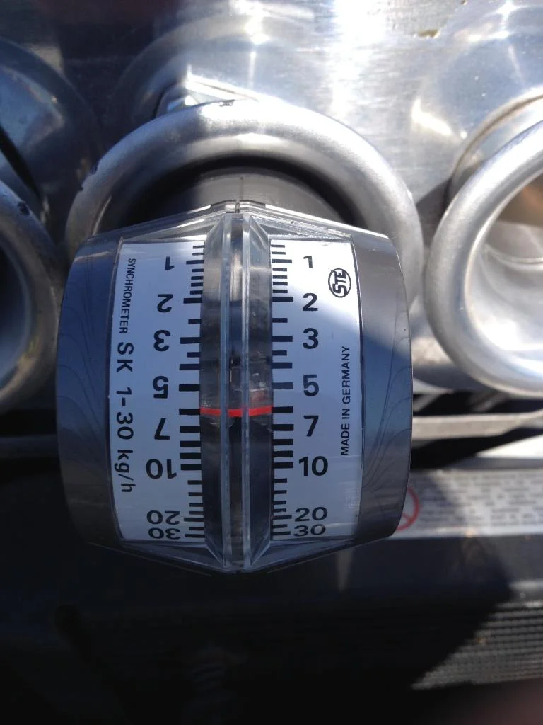

I had also borrowed a syncrometer off of a guy at work so that I could check that the bodies where balanced as this could also possibly be another factor for the hesitation (maybe I don’t know).
Cylinder 1:
Cylinder 2:
Cylinder 3:
Cylinder 4:
As you can see Cylinder 2,3 and 4 are fine where as number 1 was slightly out. So I adjusted it so it was back in line with the others.

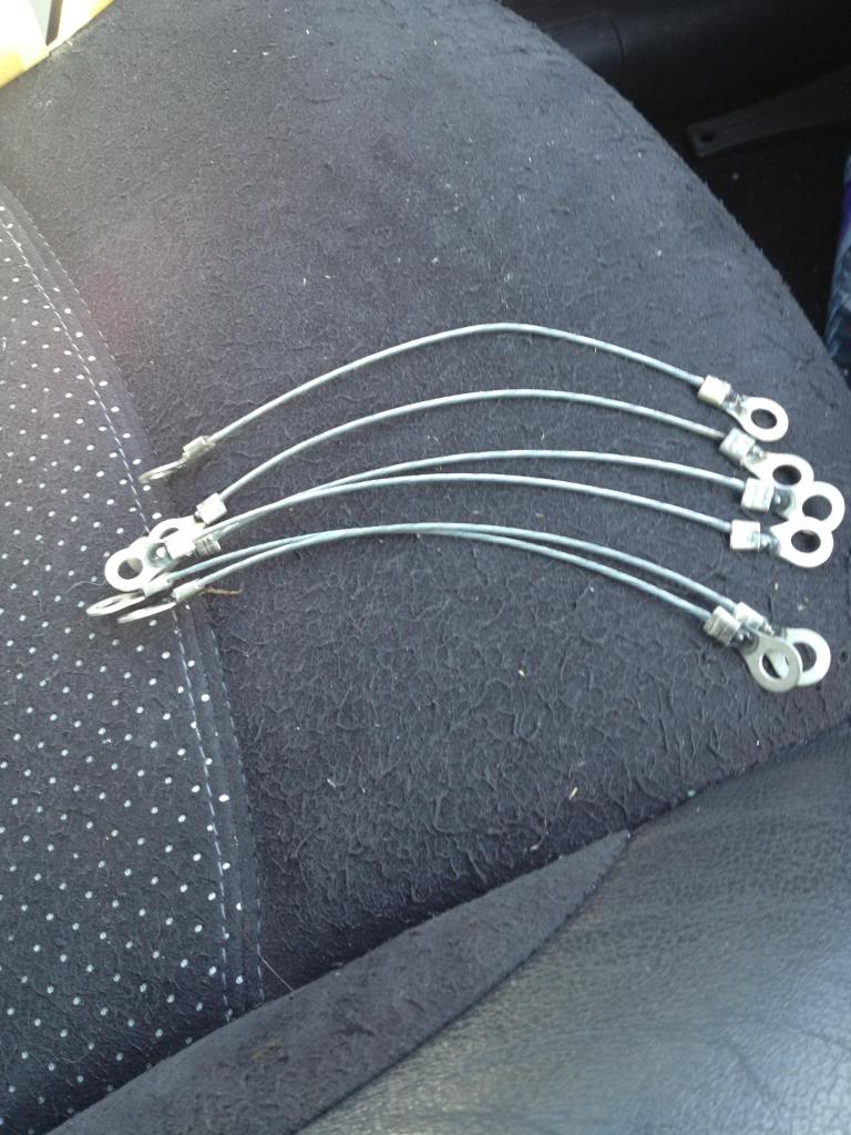

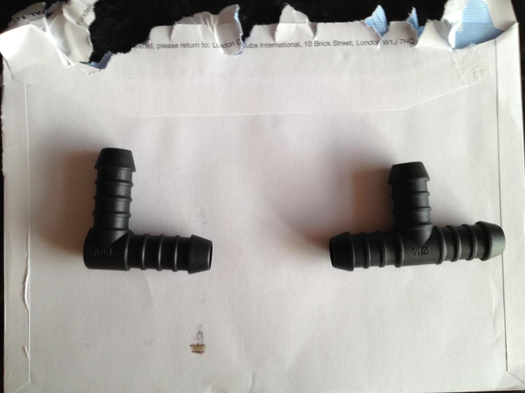

Whilst working on the car these little gems turned up!

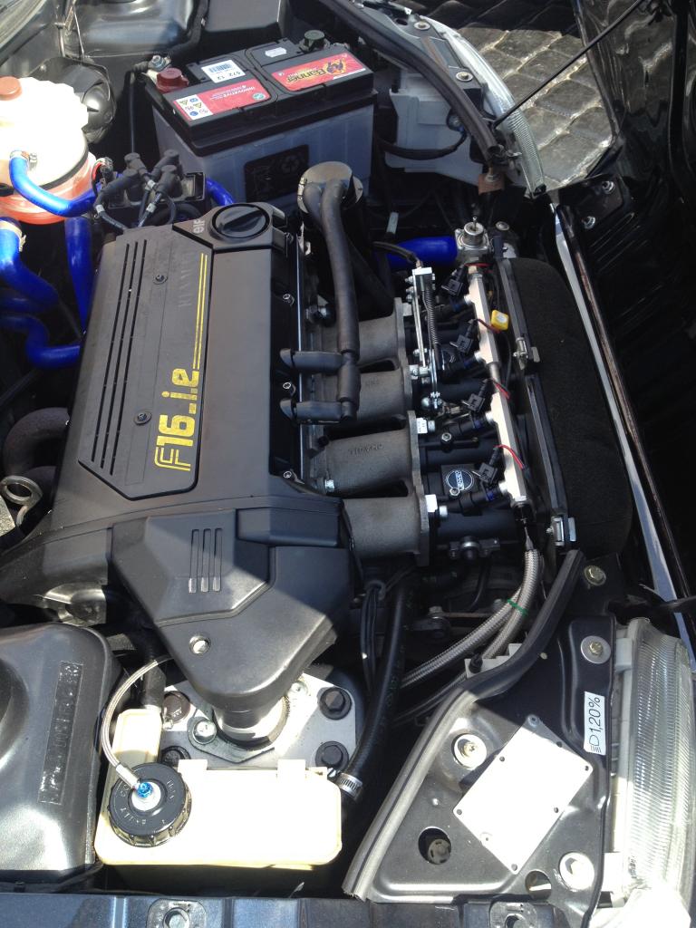

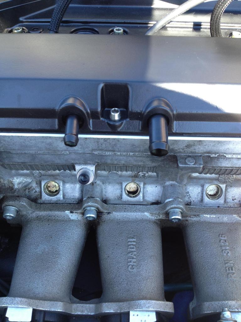

These are what I am going to use to run my oil catch tank as this engine needs one. I'm fed up with cleaning oil off of the inlet manifold where it is dripping from the oil breather filter.
Well it started off like this:
And ended up something like this:
Much better.
I run the pipework for the oil catch tank and then removed the front engine eye hoist point so that I could mount the oil catch tank in its position. I fitted the air filter and gave it s quick spray using this stuff.

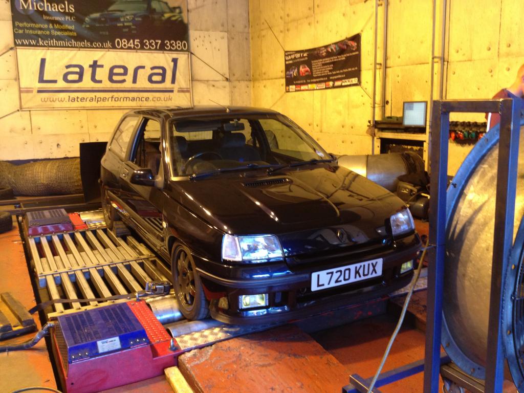

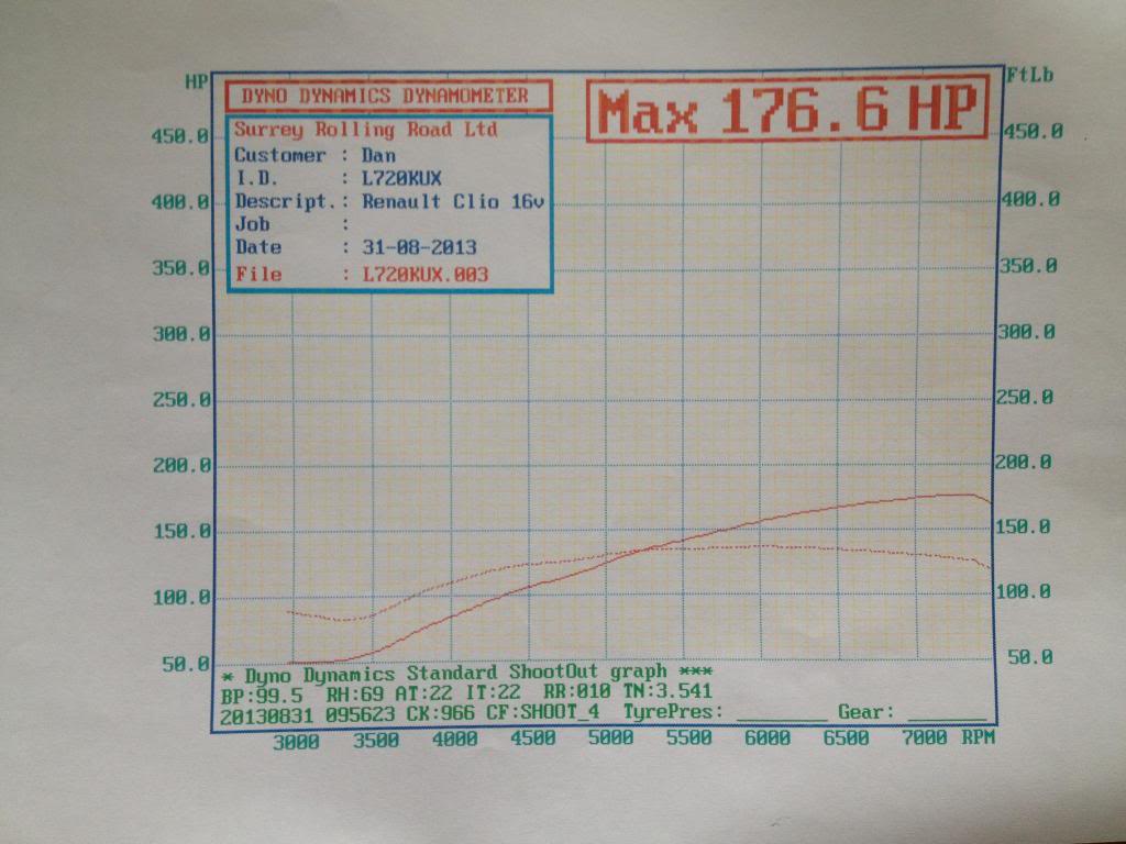

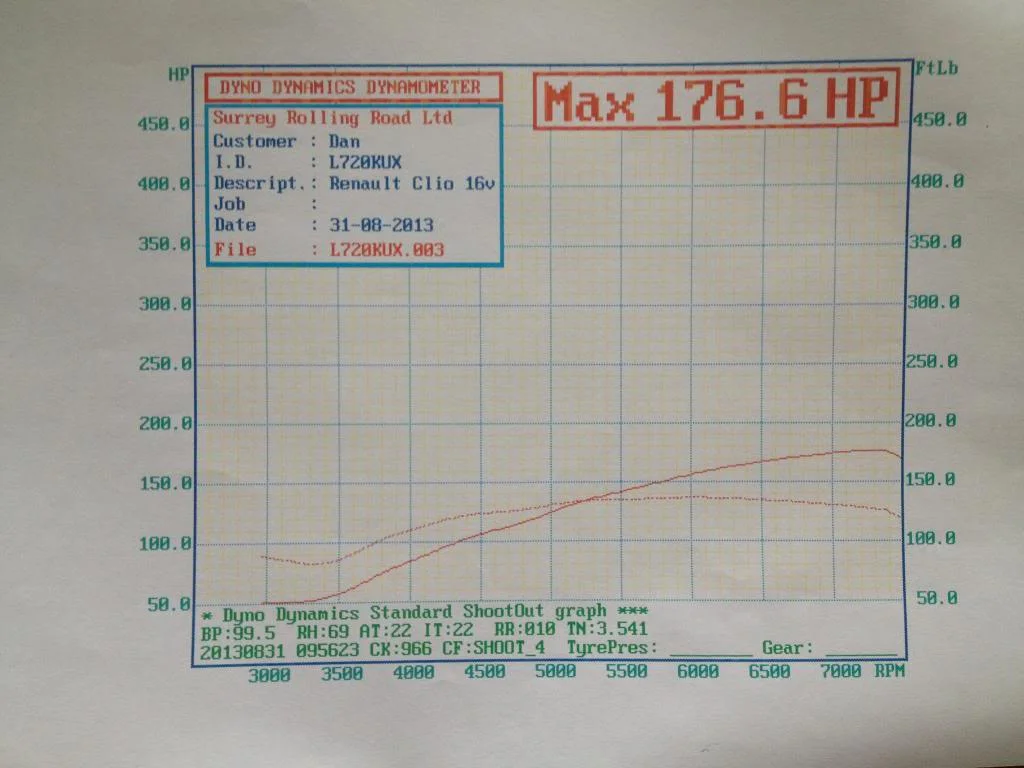

Still trying to sort the remaining bits out for the Surrey Rolling Road day with the C16v and CS guys. I started working on the car again.
I had made a new cable for the slam panel to bonnet hinge (prevents the bonnet hitting the front grill but my first attempt wasn’t up to the job!
[/URL]
I wasn’t happy with the fan switch as it looked out of place and not OE so I destroyed my spare heater controls
To make this
In place looking pretty OE:
Then I taped on some new numbers to the ht leads so that I wouldn’t have to worry about putting the wrong lead on the wrong cylinder.
Fitted my HT lead tray, run the ht leads in there, did the screw mod so that you don’t have to use the crappy plastic screws that always fall out and fitted my F16 ie cover.
Looking a lot better know although I am not happy with the F16ie cover it looks tatty so after the rolling road this will be removed and resprayed.
Next job was to remove the scuttle panel.
Two reasons for doing this:
  1. Danny@519 had said that he believes that the fan does not cut in on its own because a wire may have pulled out of its connection on the ecu so I wanted to investigate this.
  2. I wanted to extend the wiring for the serial port so that I could run it to inside the car. (If I ever need to plug a laptop in)
Scuttle off:
New extended cable:
Screwed in to place:
I did have a look at the wiring and it does look like one has snapped (forgot to picture DOH). I did ring Danny to confirm with him and we both think that this is the culprit. I'm just waiting for Danny to send me over the wiring diagram of the ECU so I can confirm that this is the correct pin for the fan switch as the last thing I want to do is blow the ECU up!
So put that all back together and carried on with my next job.
I then decided to get rid of these:
And replace with these:
Much better IMO but I know not to everyone’s taste.

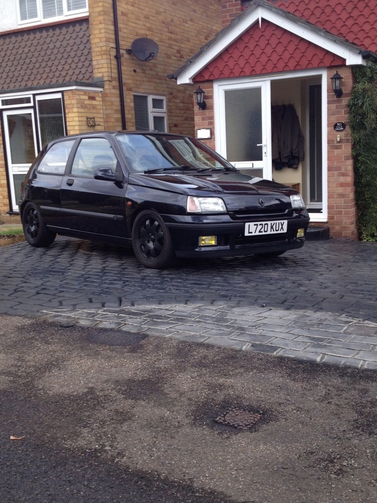

Little picture of how I left her:
Saturday 31[SUP]st[/SUP] August 2013 SURREY ROLLING ROAD DAY
So it was the day of Surrey Rolling Road. I got up nice and early picked my mate up and then drove up to meet Bass, Laine and Kirstie. Had a good old drive up there with Bass chasing a new C63 AMG (and overtaking I might add). It was a funny drive.
Handed the keys over and off onto the roller she went.
I might add this was the only photo I got!

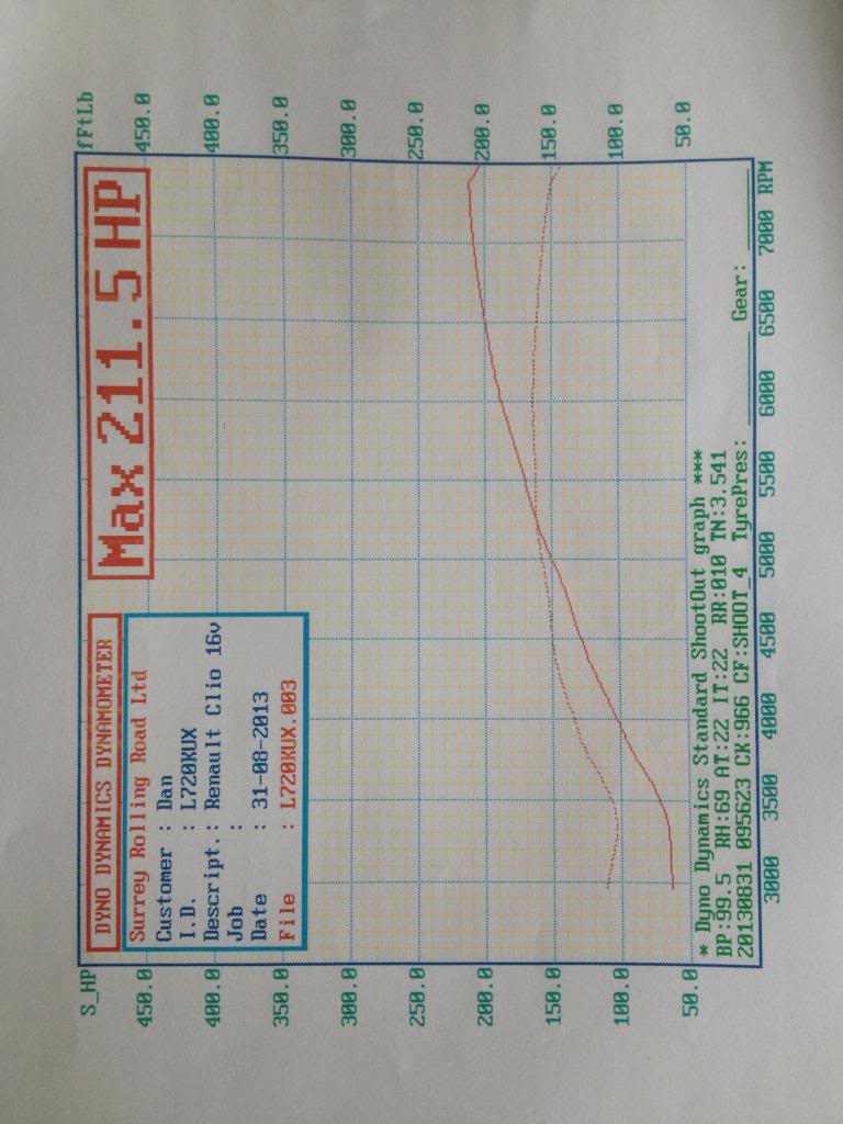

Here is the video of the graph. I believe bass got one of the car being run up on the rollers if you have got that mate sling it over
Overall very pleased with the figures although I'm not too happy with the AFR’s she is running a little bit rich for my liking. I do however believe that the lambda sensor may be the culprit as the partial throttle hesitation was really bad on the way back from the rolling road as the car was hot! So plan is to change that and see how it goes. I may look into a remap if the afr’s are still out on the next rolling road. If I do look into a remap then I am probably going to change something that should hopefully give her a few more horses.
Anyway the graphs:
BHP and Ft/Lb:
BHP and AFR’s:
ATW Figure:

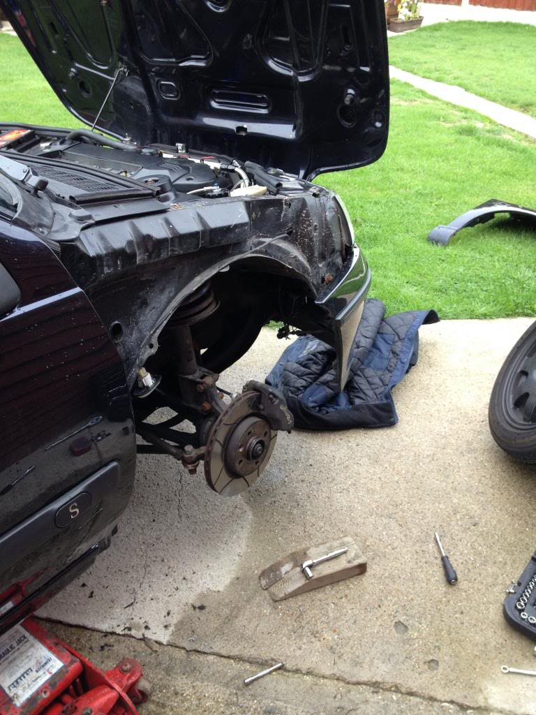

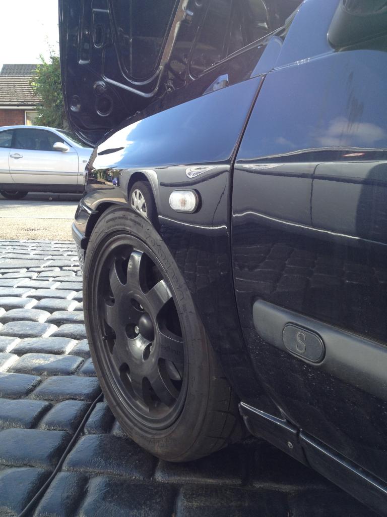

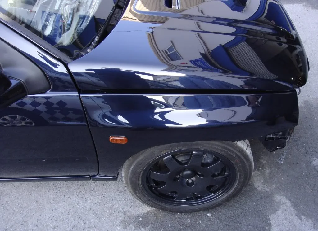

I have decided to get my front offside wing resprayed as it has a bit of chipped paint (that is progressively getting worse due to speed bumps and the wheel hitting the arch occasionally). This damage was already here when I bought the car but I have since made it worse lol.
I sold my last engine out of my old project to clio_eggy who is a sprayer from Cardiff. I got talking to him a couple of weeks ago about repainting the wing for me as I could potentially drive it over to him the week I'm at Bristol (this week). He sorted me out a really good price so I set about removing the wing from the car.

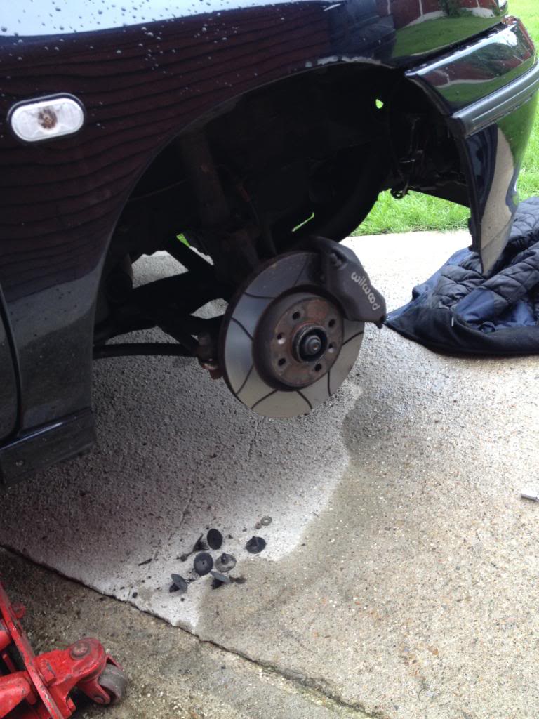

Before I started:
Wheel off arch liners out:
Wing off:
Was quite pleased it only took 15-20 minutes including jacking up the car and getting all the tools. Happy days.
Back on the floor:
Poor car looking sorry for itself lol:
Whilst I was at the car I thought I would try out my revised bonnet hinge to slam panel wire. I fitted it and let the bonnet hang under its own weight and it didn’t pull through. I then applied a bit of pressure to it to put it under more tension and all seemed good.
Its the perfect length and does not foul against any of the paint work happy days.

Replace the Megane Electric Window Switches - Complete

Spark Plug Change – Complete

I had put the wing in the hire car and travelled up to Bristol (where I was working this week). It was a long day and an early start. After doing a full days work I headed over to meet clio_eggy (Tom) (1 hour drive). I drove over into Wales which was a nice drive and met up with him (after getting lost as I couldn’t pronounce the road names) lol.
So I met Tom for the second time after he came down to pick my old track car engine up. Big Mike was also there aswell. I had a bit of a chat with them whilst Tom started prepping the wing. An hour later after chatting away Tom got the wing to this stage.
I was pretty much dead to the world at this point as it was about 9.30pm and I had left at 4.45am this morning and I still had an hour’s drive back to the hotel.
So I set off leaving the wing in Tom’s capable hands.
The next day I got a text from tom showing that he had got the wing to this stage and it was ready for paint. Happy days! The boy don’t hang about.
The plan was that I would collect the wing Thursday night before I go home on Friday morning. Whilst I was over there I thought I would meet the welshies down the pub for a catch up as I hadn’t seen Alex and James in a while. Dave was also meant to be coming but unfortunately couldn’t make it in the end.
Thursday 19[SUP]th[/SUP] September
So after work I headed back over to Wales to meet up with guys, collect my wing and go for some food with the guys.
I was a bit baffled by this on my drive up there this was going down the M5. It was raining aswell which made it a bit more funny! TBH that is something I would have expected to see in Wales haha.

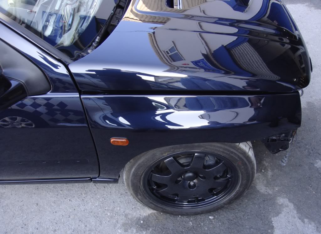

I arrive to meet the guys and I'm handed this:
I am really happy with the work that Tom has done. Hats off to him. A quick turnaround as well and was very well priced! I cannot grumble at all. Thanks again mate really appreciate it.

I think the wideband at SRR is reading wrong, as it's the same AFRs here on mine as it was when orignially mapped
I've already had a chat with Charlie about it. Don't know why the result was like that there.
All I can say is driving the car back it was like a completely different car! It was so smooth and felt perfect! So happy with the work Danny done! Thanks again mate
