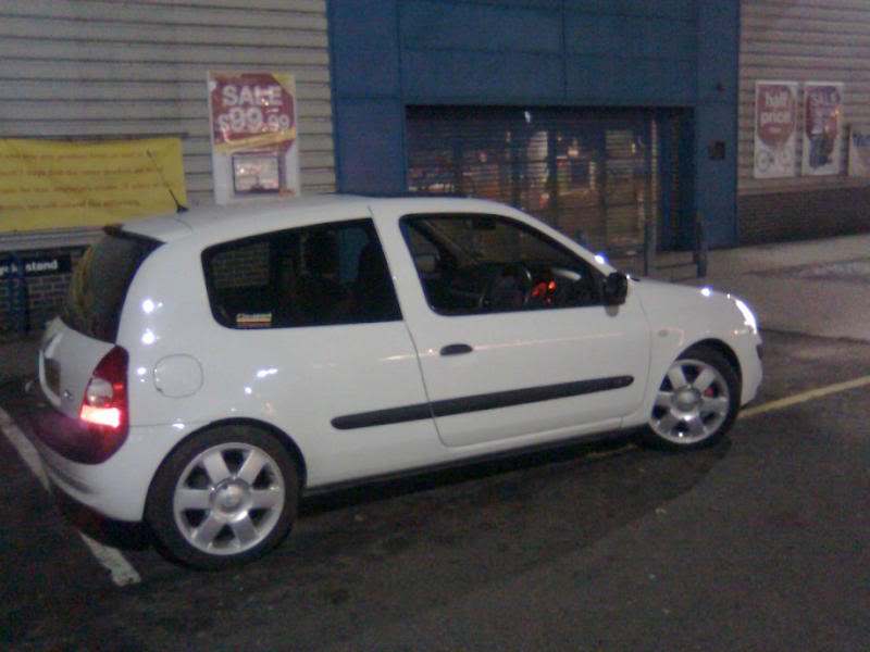

laguna rims fitted
  LY 182
think they look quite nice myself, and definately more grip.
for anyone wishing to fit these to the non sport models-the lagunas they come off use a 205 55 16 tyre which frankly are huge and are no good for the clios as on the front the tyre fouls the shock by quite alot.
so you will need some skinnier 195 45 16s and it all clears quite well
what do you think?
  LY 182
lol, yeah cheers middo - suppose i should mention too i got them from cit-ren and they came 2 days earlier than they told me they would turn up, which is always a bonus

Nice alternative to making it look exactly like an RS model like everyone else does.
I like it.
  Audi TT 3.2 V6
good choice on the wheels. as people have said same as i used to have on my clio, ive sold it now and its no longer in the club so your still unique to the club :)
  Audi TT 3.2 V6
with 195/45/16 tyres the rolling radius is near as dammit the same as standard wheels, not enough to put the speedo noticeably out anyway.

ive got some of these in the post :) bought end of december, was worryin they were 5 stud? do look good on the car i agree :)
looks good, still dont look as good as the 172ff wheels IMO, but atleast its something different
  Audi TT 3.2 V6
Cant believe u beat me :(
defo 4 stud! you may find you need 5mm spacers on the back wheels as mine rubbed the arch liners, either that or cut some of the arch liner away.
  LY 182
yeah i just deleted my rear arch liners.
while i had it on the ramp i found the source of a rattle ive had for a while which was the cat, noticed i had a shock leaking and that on the wheels i bought it must have been run with a split cv gaiter for a while as 2 were caked thick in cv grease on the inside.
so after smashing the insides out of the cat fitting a shock and spending a considerable chunk of my life cleaning the wheels im happy!
