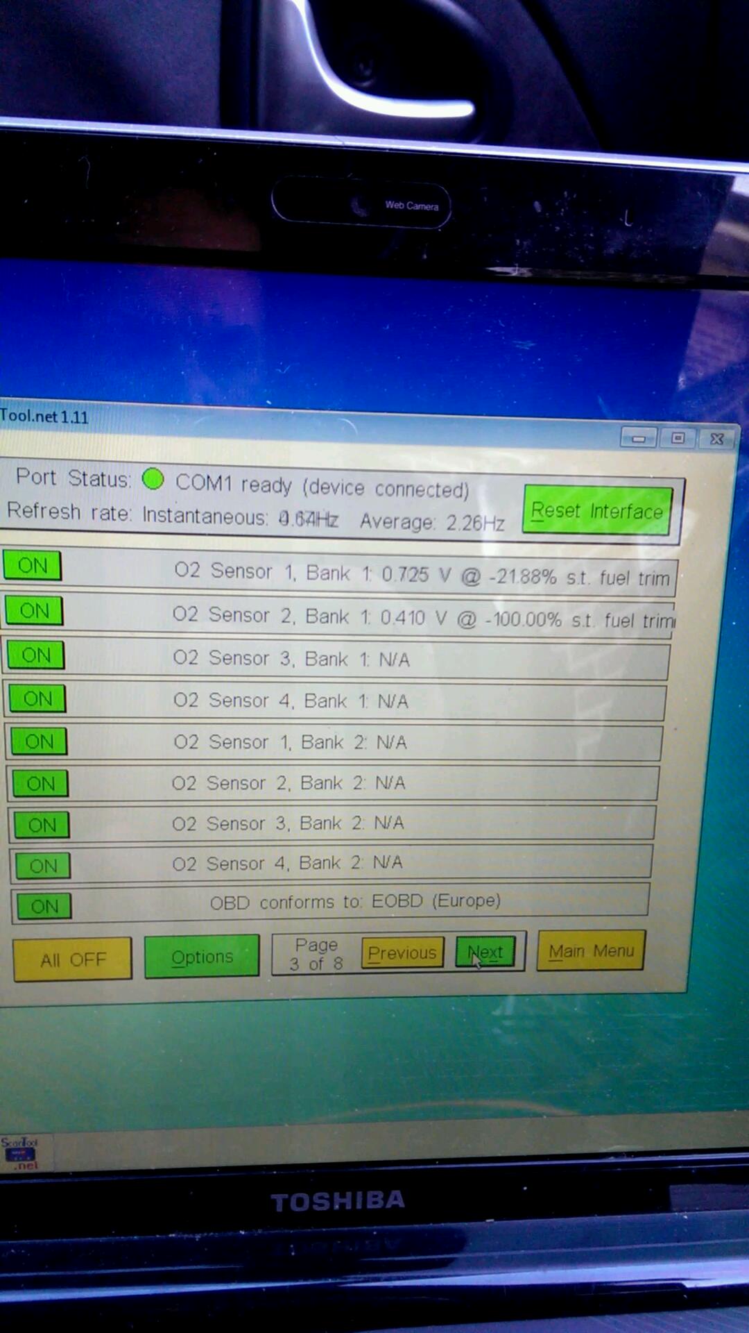

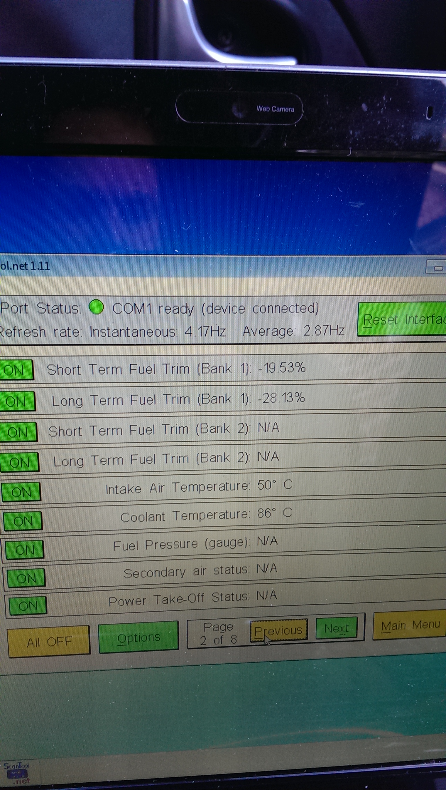

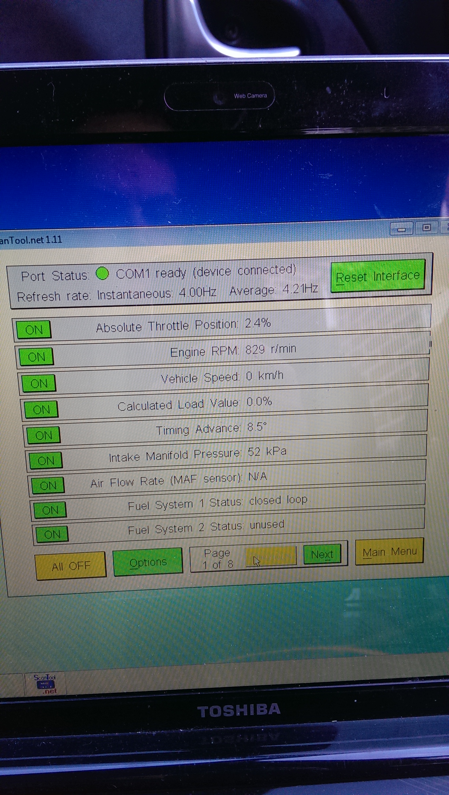

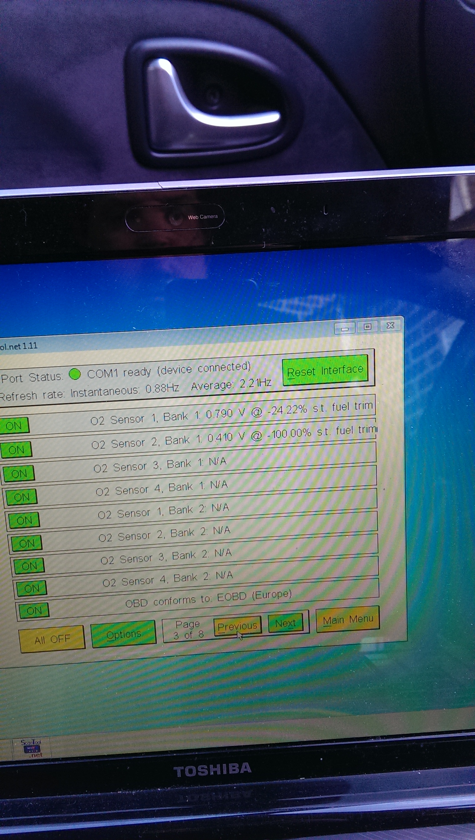

So I've got an issue with both pre and post cat 02 sensors....in fact the post cat 02 sensor is shot for sure....
My problem is I'm unsure if the pre cat one is knackered too!!! I'm gonna put some stills of freeze frames on and I'm hoping somebody can help me out...
The problem is the short trim fuelling is always in the negative 20 odd % extremely rich and never comes the other way??? Voltage is perfect fluctuates within the perameters as it should... Anybody got any thoughts please...

My only I said really is the rich rich rich negative condition on the short fuel trim? Never goes any where near lean....
As for the voltage on the o2 sensor it acts like any good sensor stays within its limits voltage wise and really quick reacting as you would expect.
