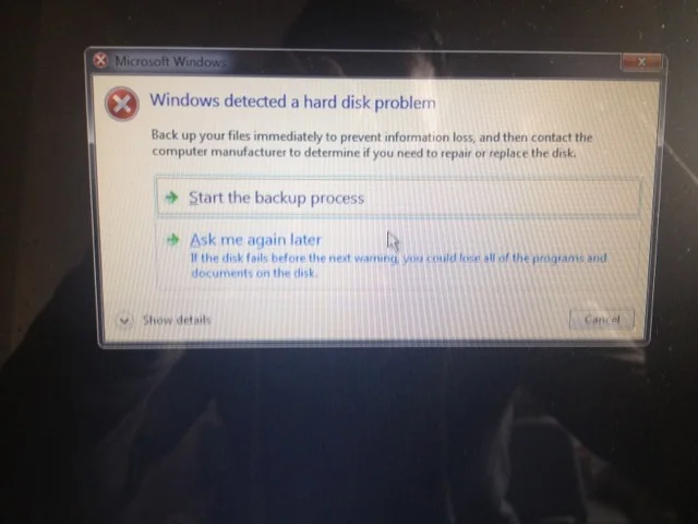

Im in a bit of trouble with my laptop. I have a warning saying my hard drives failing and its running v slow.Ive done virus checks etc they are all removed. Ive backed everything up on an external hdd now but still it is not running well.
I have used a program called hdtune and it says Relocated sector count (current23) data 2002 I have read this is not good!!!!
Can you think of anything I can do to fix it or do I need to replace my HDD.

To be honest if I ever have any doubt about the reliability of a HDD I will stop using it. Don't want to think you fixed it then one day lose all your data. HDD are dirt cheap these days so just back up all your personal data and use it as a reason to do a fresh install of windows. I don't bother with systems restores, I just start from a clean OS. Each to their own...

To be honest i cant use it properly the way it is running so it looks like a new hdd is required.
Am i right thinking if i buy the new one and fit i will be able to install my windows 7 from system recovery discs i have made?
What type of hdd should I look to replace with? SDD maybe? Can i be sure it will fit?
